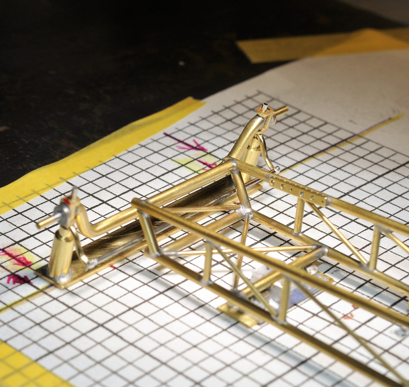

Pete - Thank you, making them was actually pretty straightforward & I'm pretty confident now that when it's complete and off the jig, it will sit flat (it better right?)  and be properly aligned etc.  Oh, the reason for the shiny brass, I had to solder the thing up so I scuffed it with sandpaper 1st..........it IS shiny though.  Thanks again & how are you making out with those valve cover clips?  Maybe a pic at least of what you're making?   I'm very curious as I know they must be extremely tiny.
Brad - I wanted to share that the 1st pic is from behind the axle. I took the pic with the tie rod brackets (.3mm) in place but you're right, they are not soldered on as yet.  The reason being I want to try custom ones that were pretty cool looking from that time period but to get the proper ride height for the axle with the wheels in place I had to put them on.  I think of them as "spacers" at this point.  Does that make sense?  And btw, you don't miss a "trick".

This morning I got the tie rod brackets done, quick mock-up.  The first pic was kind of what I was going for, I liked the curves/shape of the bracket and more importantly it positions it out of the way of the panhard bar & shocks eventually.  No machining these buggers. The curved part is 1.0mm rod and the top soldered piece is 1.2mm tube to attach that the pin will go through and the bolt hole for the tie-rod itself was a #79 bit.   This pic shows what I was hoping to emulate to some degree of accuracy.

Great oogly googly moogly!! Swoopy tie rods indeed. Those are some seriously sweet tie rods. I can't imagine the patience that took.Also looks like they may be relatively close to the ground depending on your tire height unless the jig you have the axle posed with shows actual ride height.

Pete, 2 pieces soldered together.
Brad, the bottom of the rod is a hair over 6" in scale off the ground.  If you look at the pic of the 1:1 I posted, you can see how low to the ground that bracket is / ends to the ground.   All good.

The only thing I got done this week was the shock towers but I'm happy that they turned out the way I'd hoped. The look was 2 sides to each shock tower joined together with welded (in my case soldered) tube in between therefore a gap all the way around for some perspective.  After machining a general shape I super glued all 4 brackets together to shape them with some sanding sticks. Then I heated them to separate them, cleaned em' up and soldered them together.  They are NOT soldered onto the chassis as of yet.  This was a big step though towards completing the front suspension.  Cheers, tim

Just resting on top of the rails for a quick mock-up.
