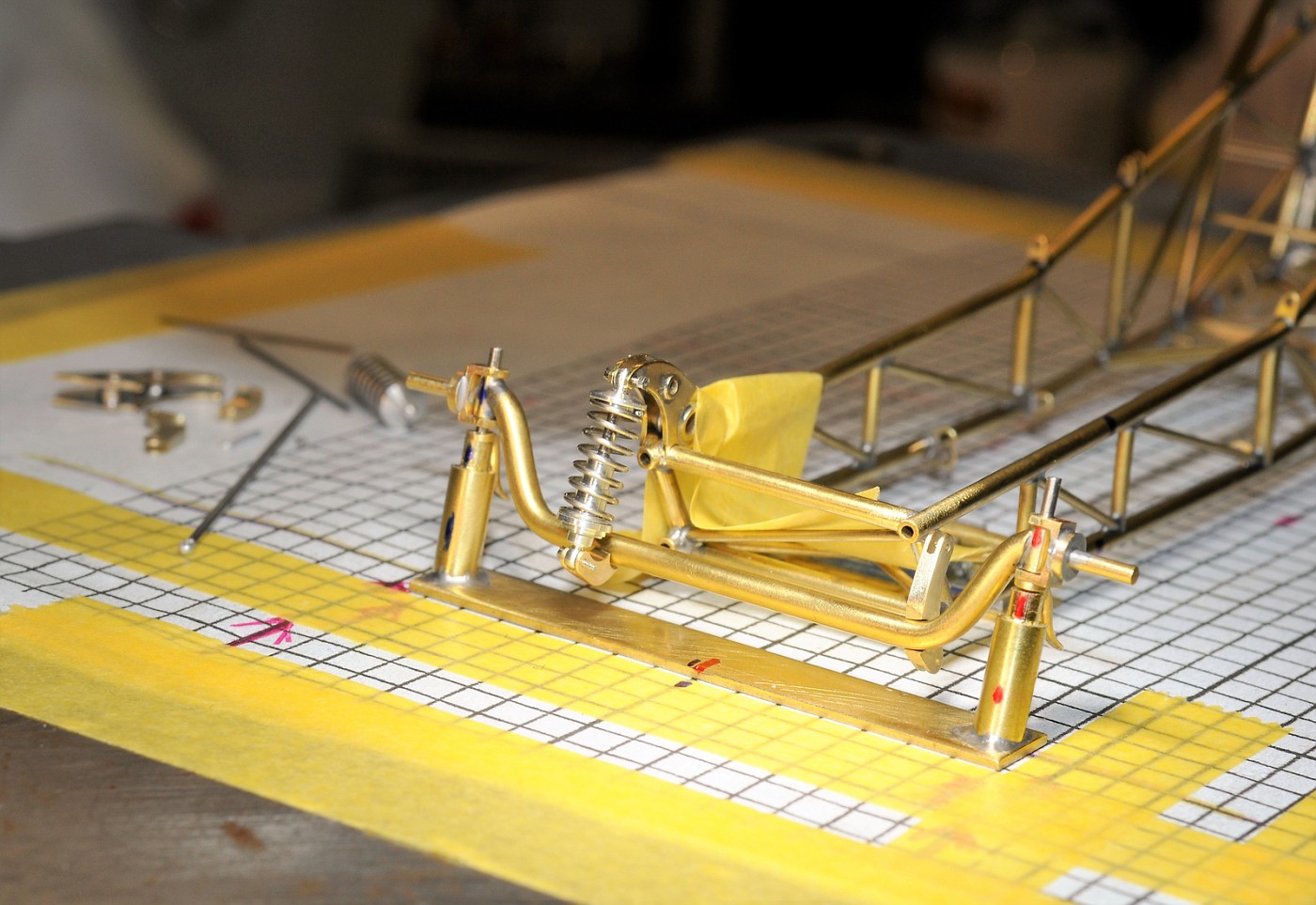

Codi Posted April 12, 2017 Author Share Posted April 12, 2017 (edited) Getting closer Dave. I finished the necessary brackets now I have to drill the chassis for the 4 link brackets and assemble it all. The only missing piece to fab yet is the panhard bar but I'll get to that after I get the shocks and 4 links in proper position. Don't laugh at my bracket drawings okay.........promise me!! cheers, tim well, okay, you can laugh Dave if you must.............it's a long ride to Jersey!! Edited January 14, 2019 by Codi Quote Link to comment Share on other sites More sharing options...

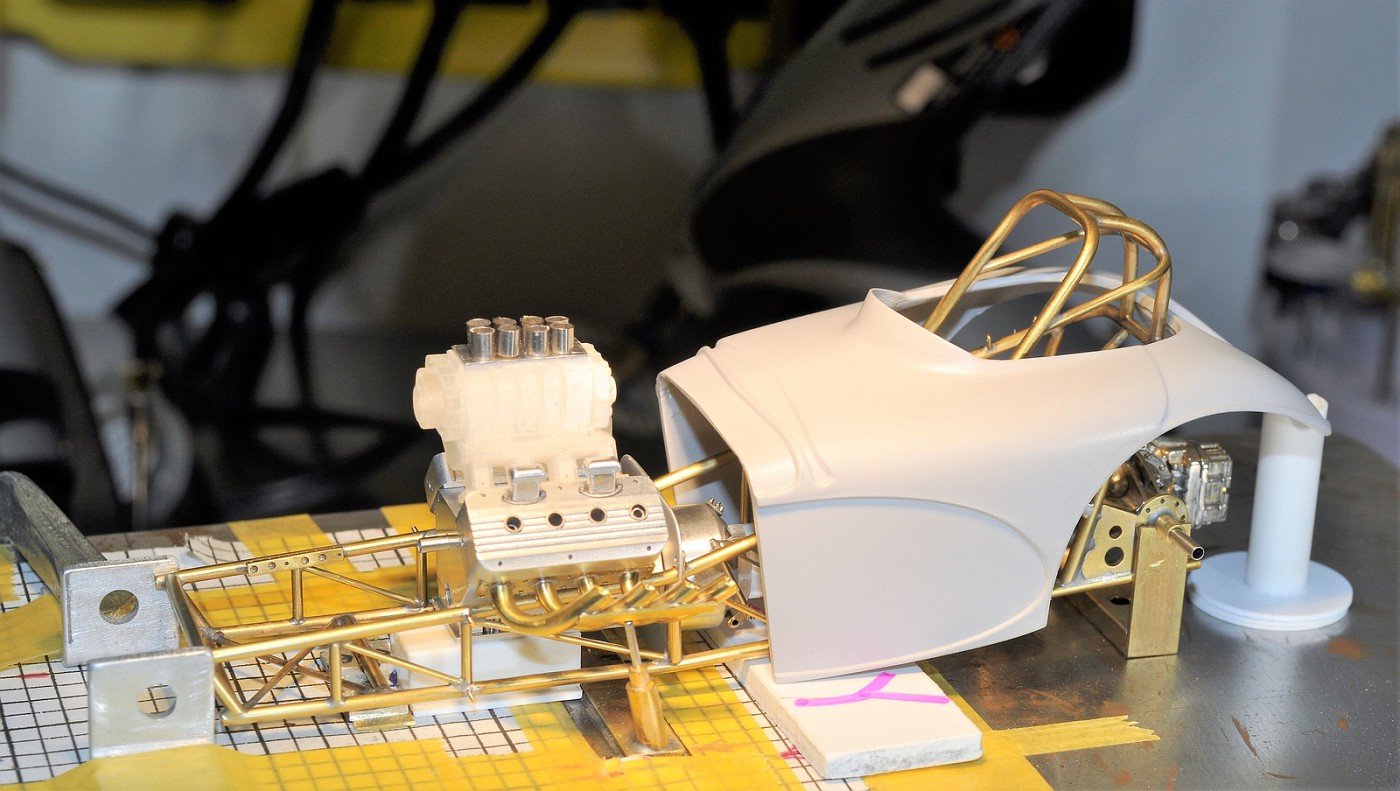

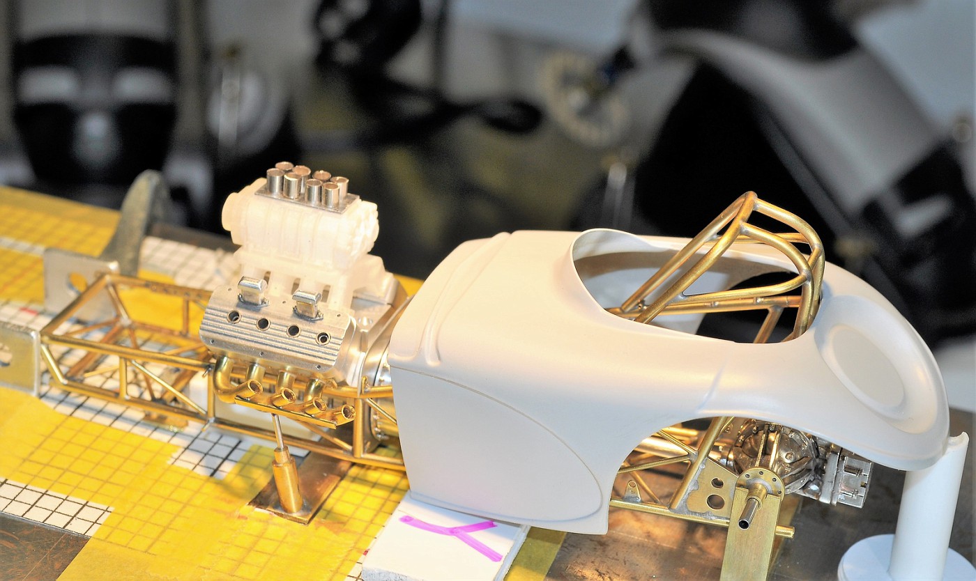

Codi Posted April 24, 2017 Author Share Posted April 24, 2017 (edited) Still here Brad, snuck off with Dave to the NNL East show. My first in 40+ years and really enjoyed it. I met Leonard as well....super nice guy and he had his Camaro there. What a nice build, there were quite a few and the vendor areas were packed. Only the shock towers to put on and the front's done. I'll have those on this week but I was messin' around today looking forward to returning to the engine to finish that part up. I won't be doing the scoop after all and will do the Crower Injectors with them exposed. I cut up quickly some 2.5mm stainless steel tubes and placed them on top of the blower for giggles & to get an idea as to what it might look like. I also lowered the engine (this was bugging me for quite a while) by 1.0mm. Makes a big difference to my eye and I stare at this thing way too much. Couple quick mock-up pics to verify everything works and fits properly (it does) and now I'll finish up the front suspension. I'm really anxious to get onto the Crower. The 3D printed manifold & blower were from Chris btw. I'm going to use the manifold AND the blower if I can't machine the blower design that I want for the car. The pieces are VERY nice that he sent me. Thanks again Chris! Couple pics to tide you over Brad. cheers, tim Edited April 24, 2017 by Codi Quote Link to comment Share on other sites More sharing options...

Randy D Posted April 24, 2017 Share Posted April 24, 2017 You know I love a good mockup Thanks for the fix my friend!!!!! Randy Quote Link to comment Share on other sites More sharing options...
