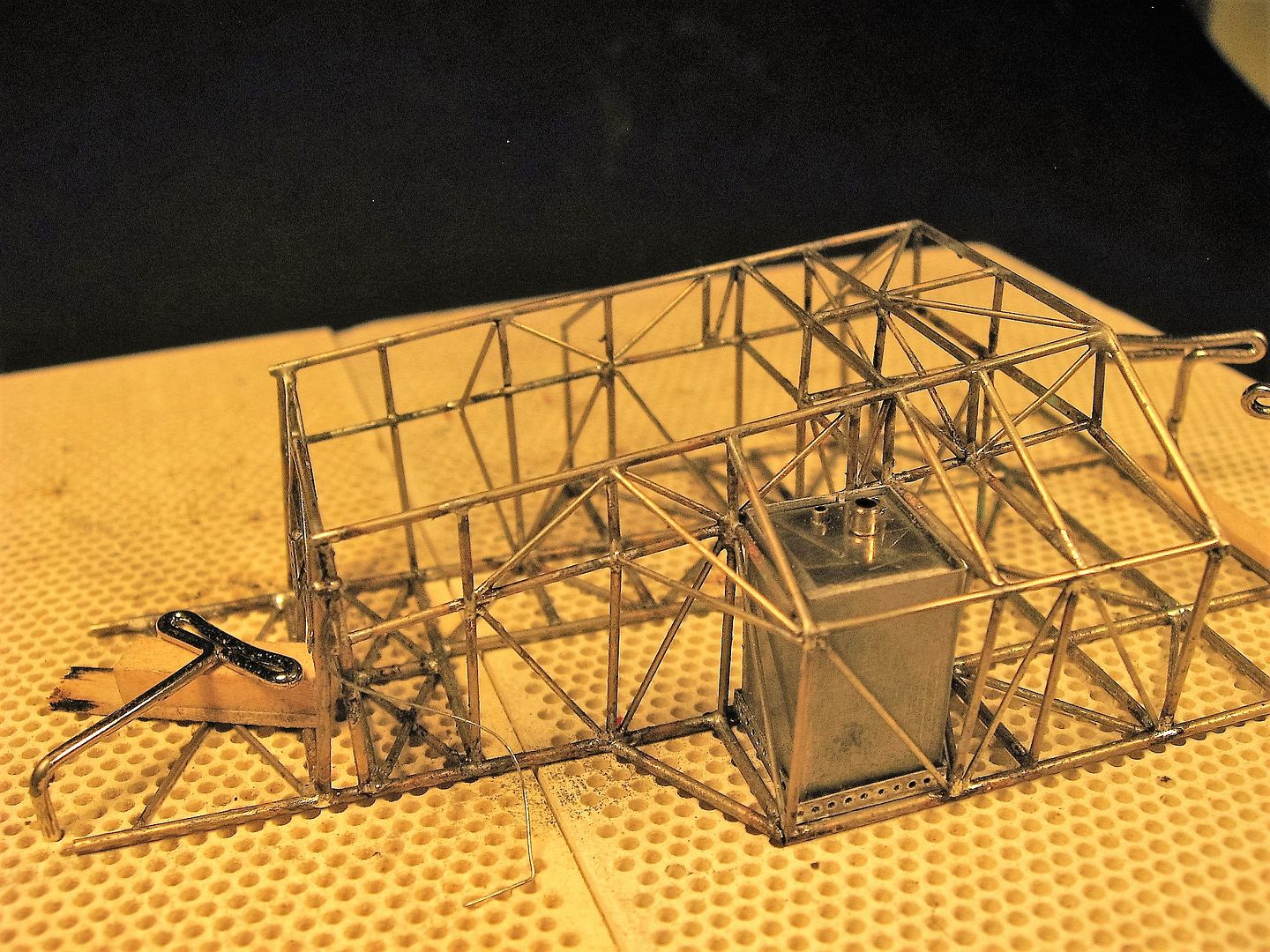

Jimmy Wilson Posted September 26, 2016 Posted September 26, 2016 Where did you get the work surface you are soldering on?Great work.Thanks,Jimmy

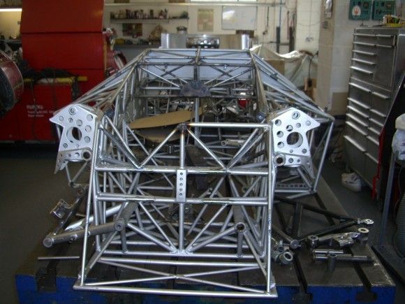

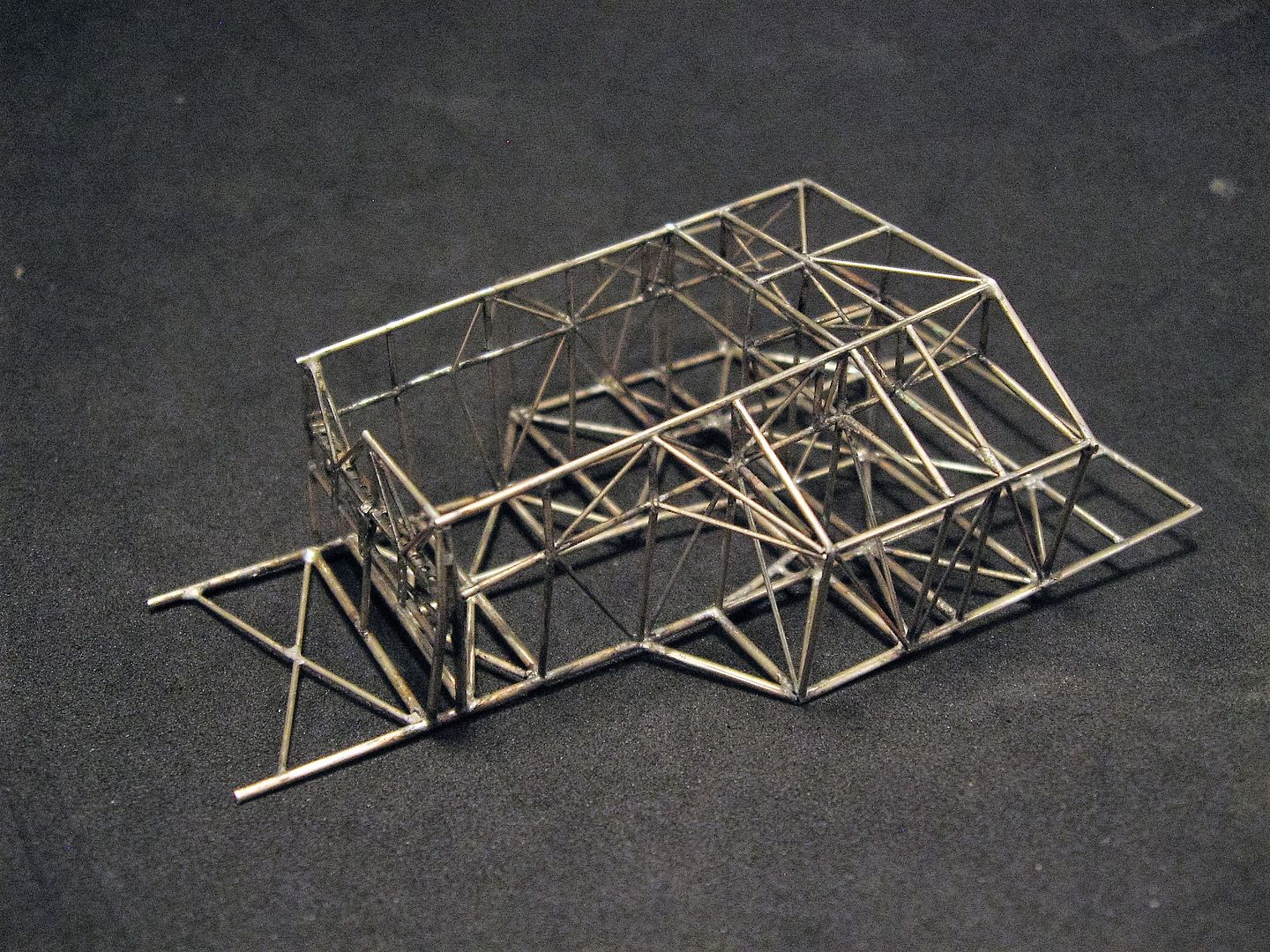

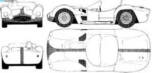

Randy D Posted October 22, 2016 Author Posted October 22, 2016 Hi Folks, Tim, Thank you Sir, can't wait to see what you come up with Hey JT, Thanks buddy and I look forward to doing the DSC and GSL double double again with you guys in '17 Tom, Thanks for looking in. I use what drawings I can find on the web and work with the few known measurements to come up with my construction plans..... Samples from the web.... Hi Bob, Glad you like it ! Jimmy, here is a link to the ceramic pad.....http://www.jewelrysupply.com/Honeycomb-Soldering-Board_p_11468.html Thanks Richard!! Appreciate the kind words Michael Thank you Dave. This car has a large oil tank that nestles into the frame and it's mounted on some brackets. Using some printer's plate ally sheet stock that my friend Brad N. supplied me with when I visited his home last year I made one up.... Ref. pics... Progress on the frame That is all for now, Thanks for looking in! Randy

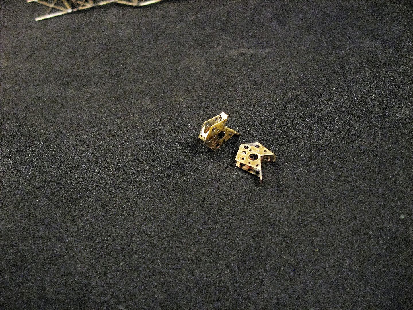

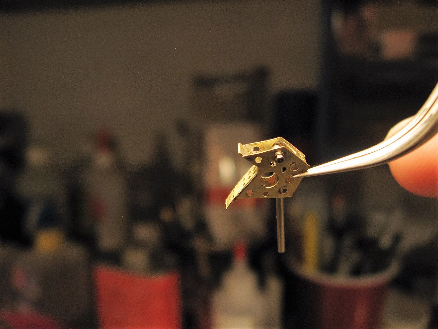

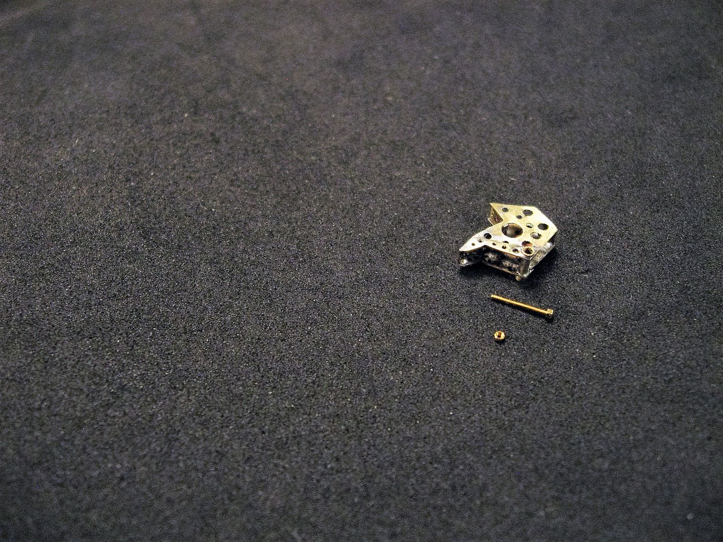

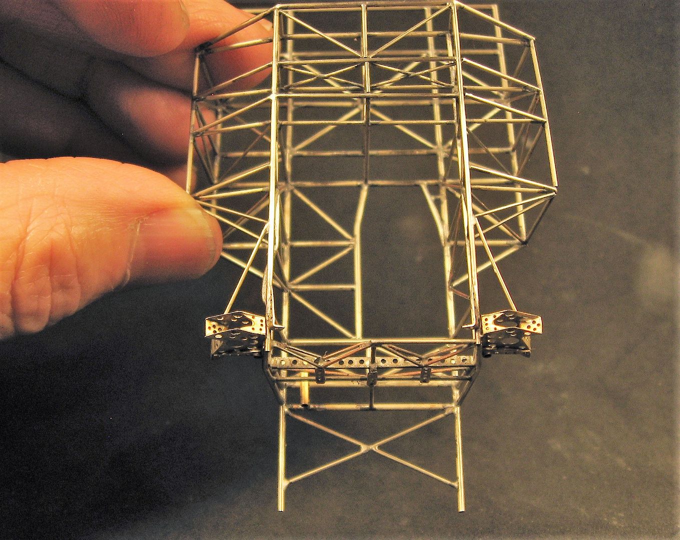

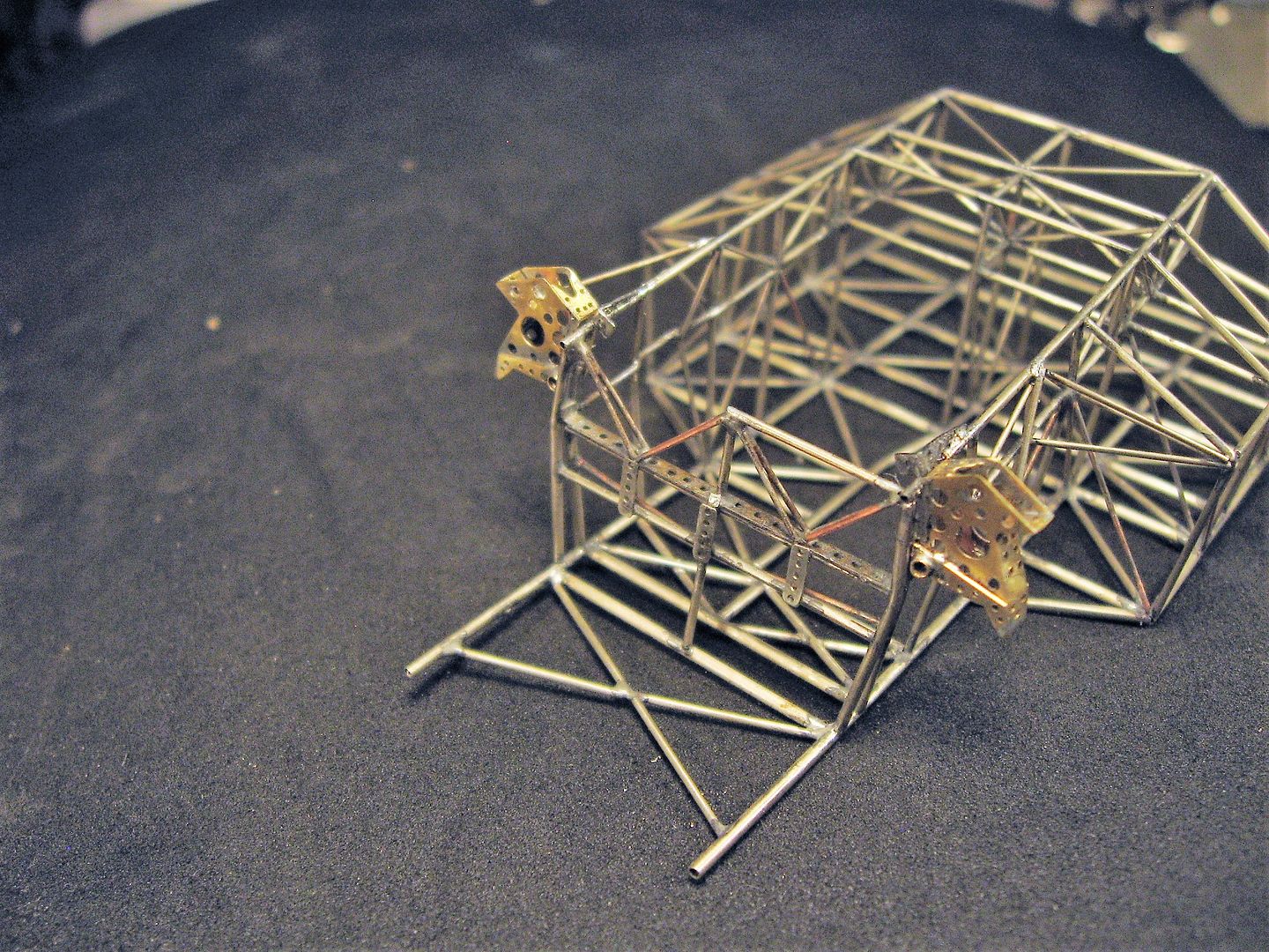

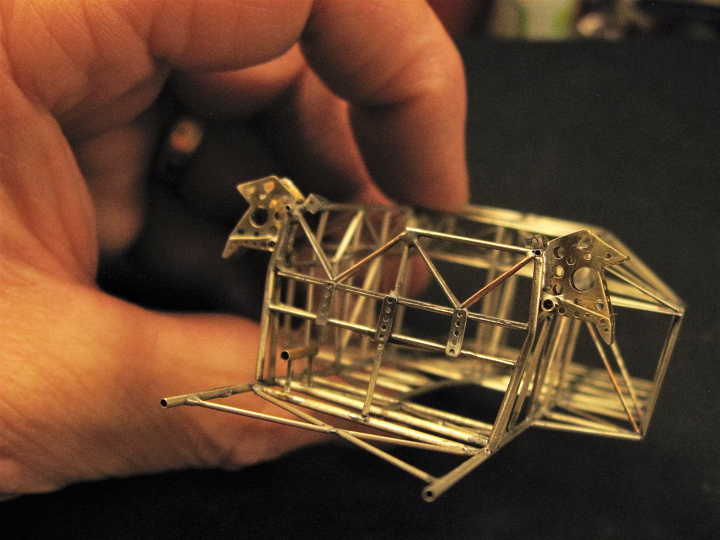

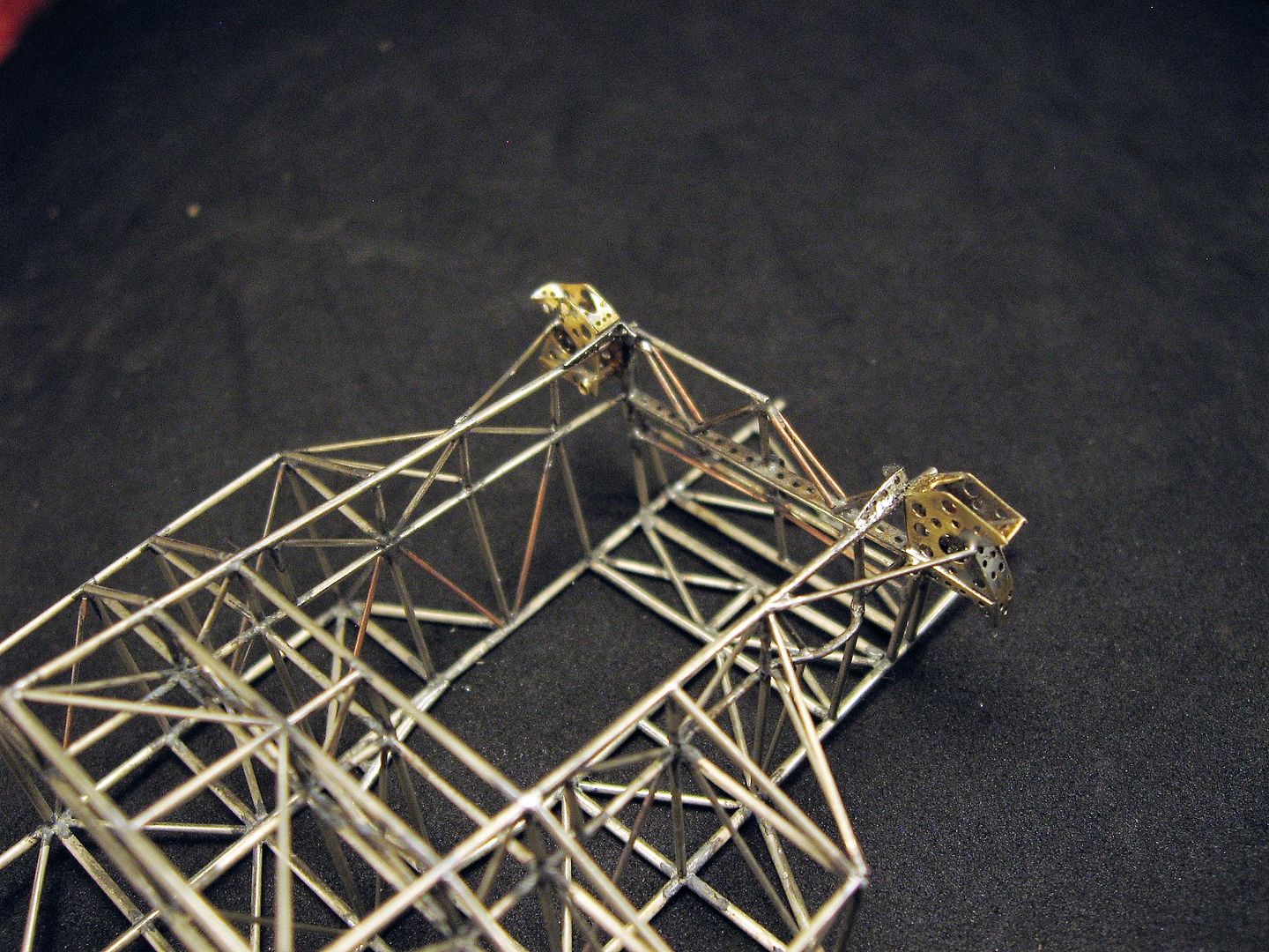

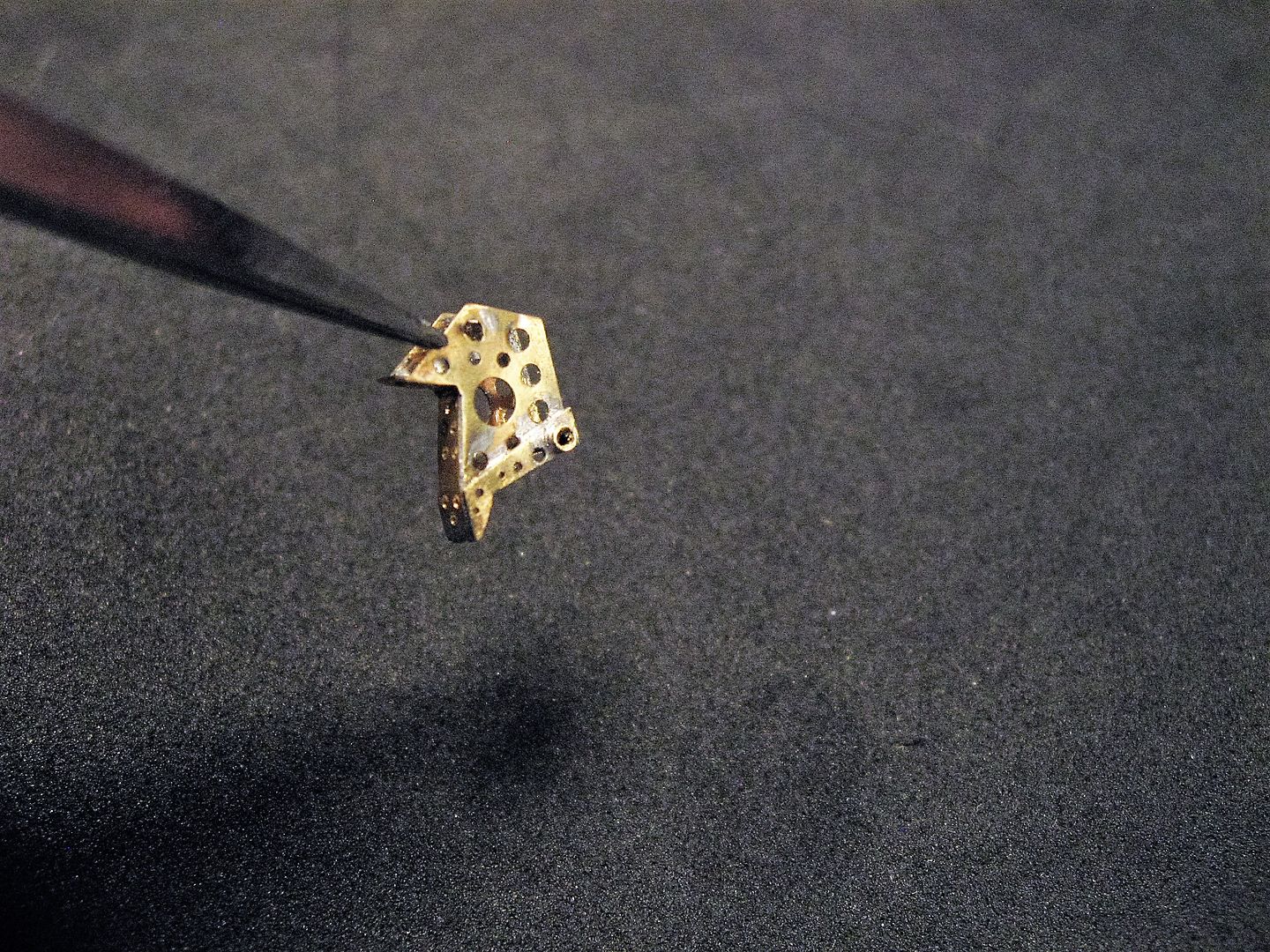

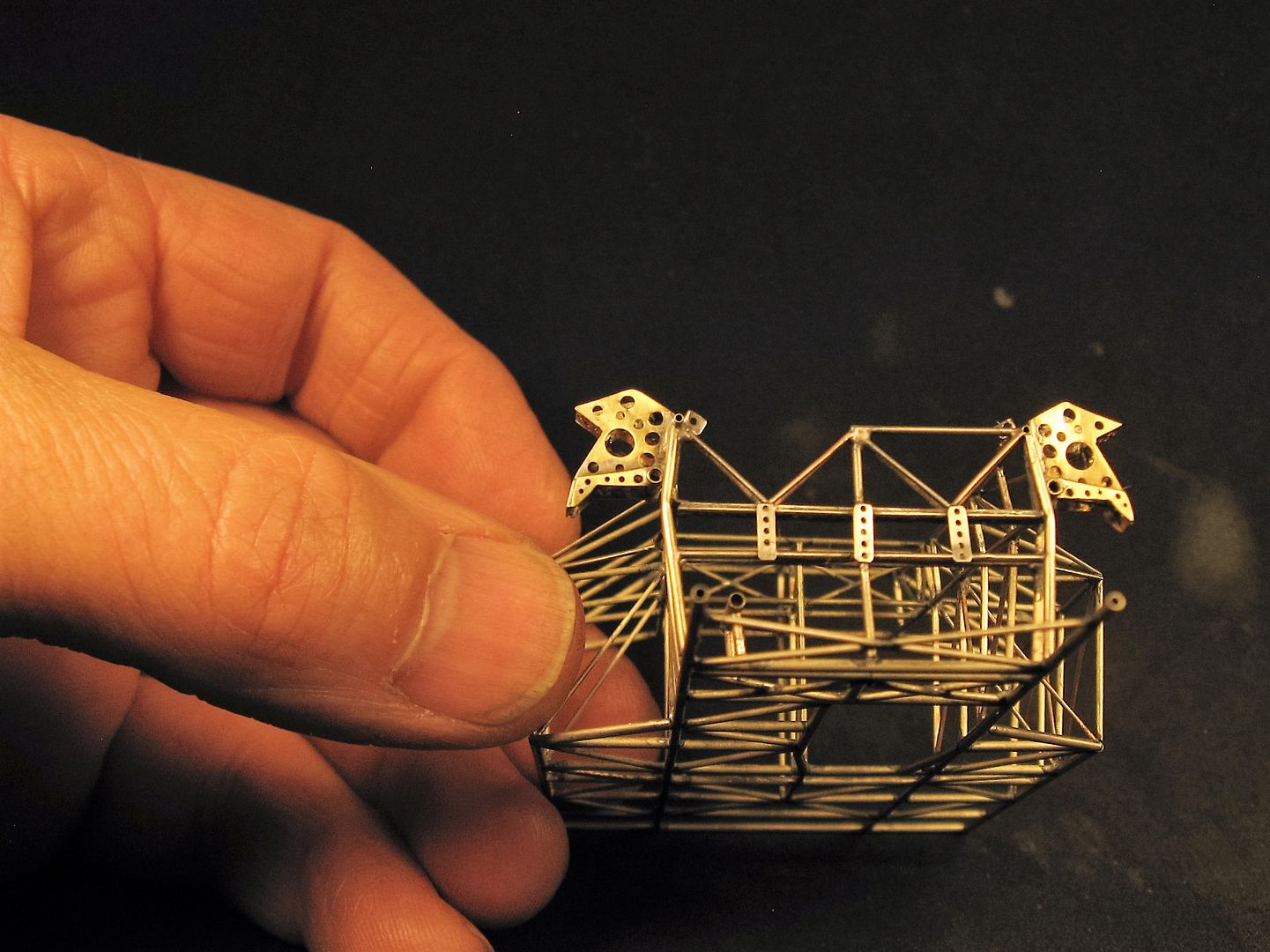

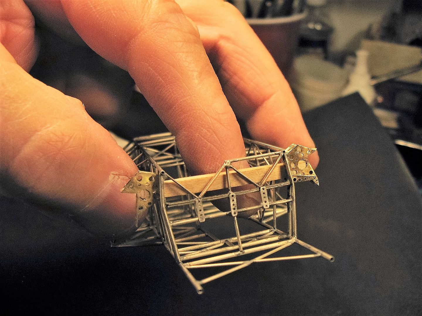

Randy D Posted November 3, 2016 Author Posted November 3, 2016 (edited) Hi Folks, Thanks Bill ! Hi Bruce, about time you get to work Pete, Appreciate those kind words!! Thank you Richard Ben, You are too kind sir Working on the front shock towers... Ref. pics... Making up mine from sheet brass stock, drilling lots of holes! Shown with a .6mm bolt (6.0mm long) for attaching the upper A arm.. Mocked up on the chassis. The three brackets you see are to mount the steering rack. They are Pro tech items available from Laski Scale Specialties. That is all for now, Thanks for looking in! Randy Edited November 3, 2016 by Randy D

Randy D Posted November 12, 2016 Author Posted November 12, 2016 Hi Folks, Hi Joe, Always appreciate your comments Hey JT, Look forward to it!!! Are you coming to DSC? Thank you Richard! Tim, You are so correct my friend Thanks RandyC Bernard, Did you really have to drop that in my build thread???????? Just kidding Thank you for those links. That was all new to me and you are right, I find someone like that very humbling and inspiring!! Hey Art, Thanks buddy! Now that you got the store up and running you need to back to bench!!!! Thank you Lanny!! Small progress.... Got the shock towers in place... That is all for now, Thanks for looking in! Randy 1
