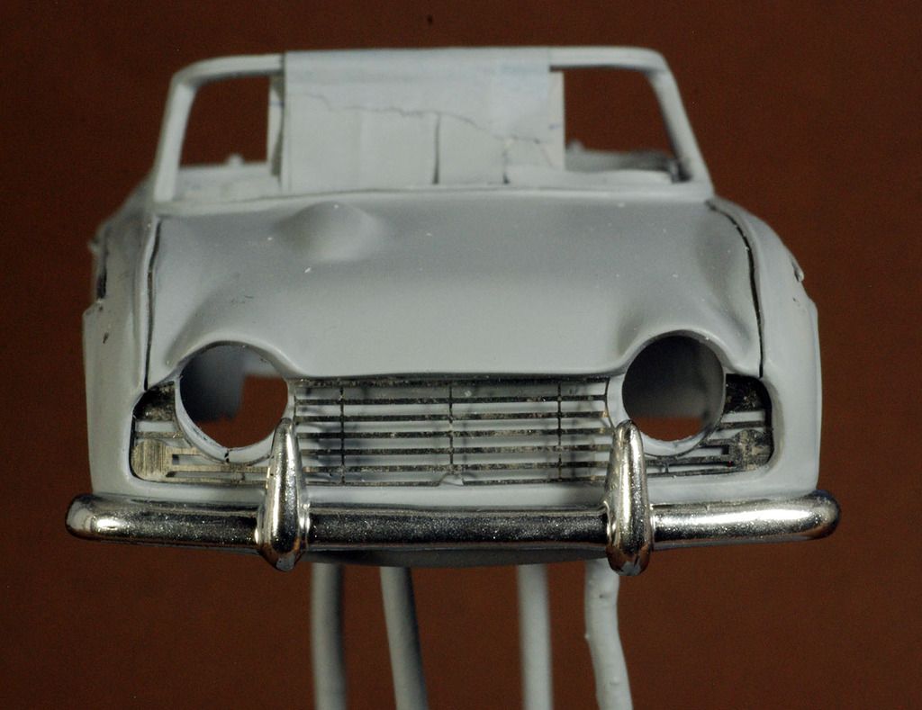

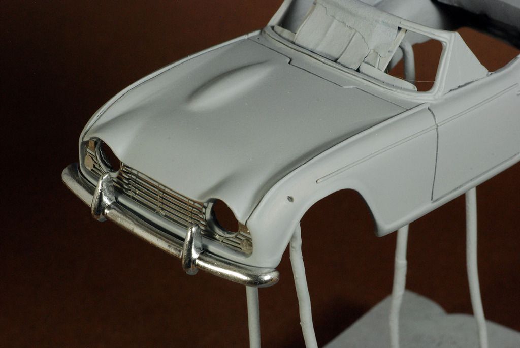

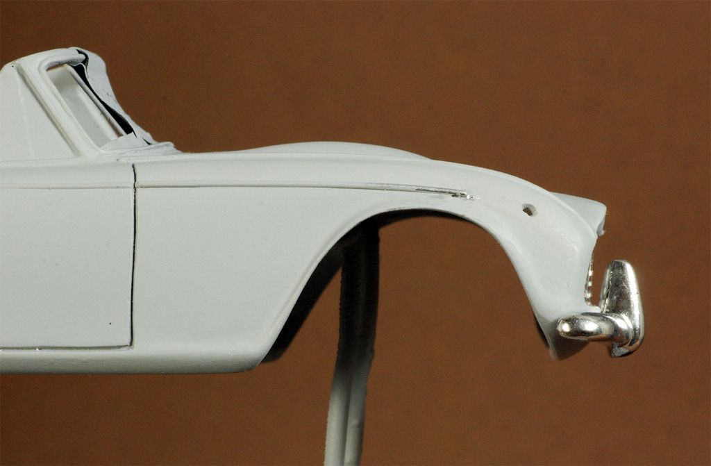

Foxer Posted May 20, 2017 Posted May 20, 2017 (edited) I'm currently working on a '59 Dodge Street Machine using a Johan promo. After experimenting with a parts box bumper, I sanded off the mold lines on the edges of the front bumper and then used a polishing kit to remove all the scratches. I then used a 4mm Molotow pen to "re-chrome" where I sanded. It came out fantastically good and you can't tell the difference between the chrome plating and the Molotow ink. I'll post pictures as soon as I can. I can't wait to try the Molotow pens to "chrome" some resin grilles and/or bumpers. I too wanted to try chroming a bumper and I just happened to have some TR4 bumpers in gloss black ready for Alclad. They've been sitting over a year waiting fo me to do the dreaded Alclad. It's having to do a perfect gloss black that keeps me from a lot of Alclad ... the Alclad goes on easy for me. So, this is the front bumper. The paint wasn't perfect and I didn't do a lot of prep work, I just wanted to test it and strip later if needed. I did the tight corners first with a 1mm and used the 2mm and 4mm to see how each did on a large area. I'm pretty much sold on using these pens on "large" pieces. The ink flows well and everything levels off better than any paint I ever used. It also covered the black paint like it was white! After this success I sanded the rear bumper to about 2400 grit and am waiting for it to dry more before handling for photos. Edited May 20, 2017 by Foxer
