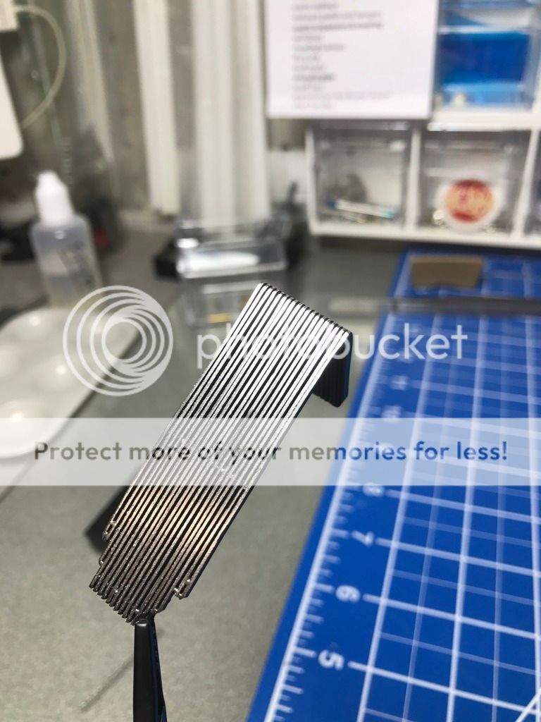

gtx6970 Posted March 10, 2017 Share Posted March 10, 2017 Ive not noticed any issue without cleaning the pen tips. Ive used them and put the cap back right away. Take it back out a few days later with no issues. That said, One thing I will say. Once you put the 'chrome ' on ,,,don't handle it it any way. Even after its dried for a few days. I used it to trim the window frames on one and even with minimal handling the chrome looses it brilliance quick.From here on ,I'll use them for what I bought them for....... Interior detailing only Quote Link to comment Share on other sites More sharing options...

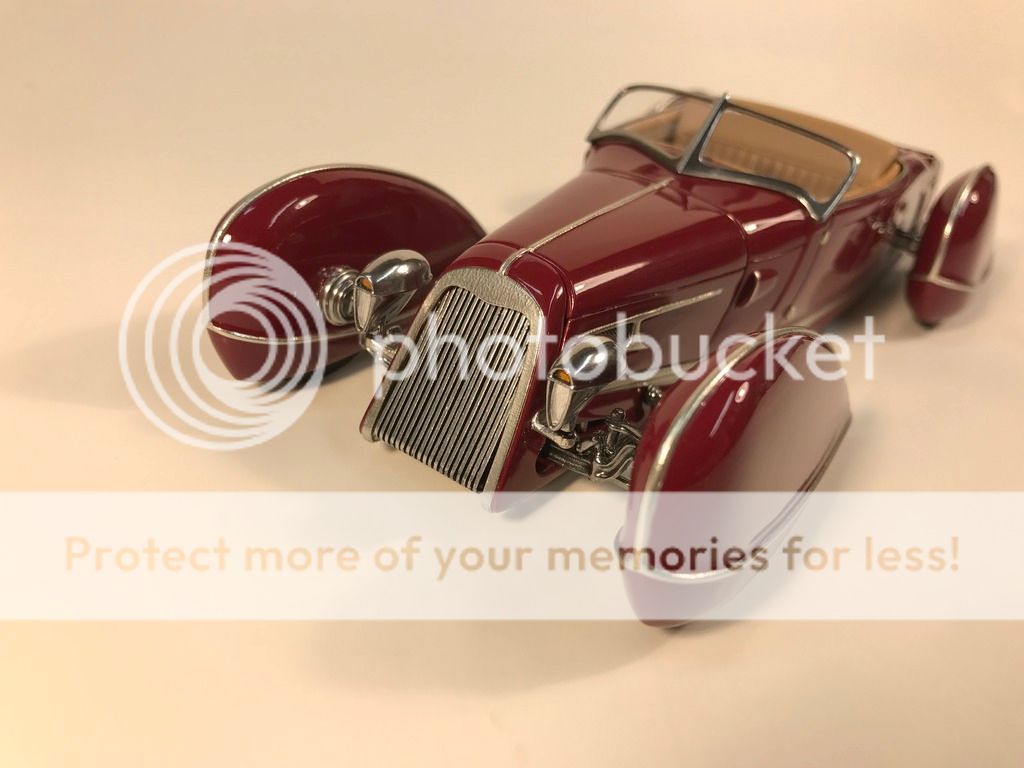

Draggon Posted March 10, 2017 Share Posted March 10, 2017 I tried it on the edges of a couple of rims where the chrome has worn off. It looks perfect upon application, but not quite as much after it dries. One of them was a chrome steel rim which has a very narrow, sharp edge. I would not be able to foil that, and regular silver paint looks horrible. The molotow marker is a great solution. I expect it might be unnoticeable on a tire, or a finished model. It'll be perfect for interior chrome. Quote Link to comment Share on other sites More sharing options...

StevenGuthmiller Posted March 11, 2017 Share Posted March 11, 2017 That said, One thing I will say. Once you put the 'chrome ' on ,,,don't handle it it any way. Even after its dried for a few days. I used it to trim the window frames on one and even with minimal handling the chrome looses it brilliance quick.From here on ,I'll use them for what I bought them for....... Interior detailing onlyThis has been my fear all along for applications on bodies.I suspected that it would most likely not be durable enough for exterior trim.I'm with you Bill.Interiors & touch up only. Steve Quote Link to comment Share on other sites More sharing options...

Ramfins59 Posted March 22, 2017 Share Posted March 22, 2017 I got the 1mm. 2mm & 4mm Molotow Pens from Model Roundup. I used the 4mm one to "chrome" the rear bumper on one of those Airstream camper trailers from Greenlight that my wife picked up for me from ToysRUs. It worked great... Looks just like chrome. Will try to post a picture. Quote Link to comment Share on other sites More sharing options...
