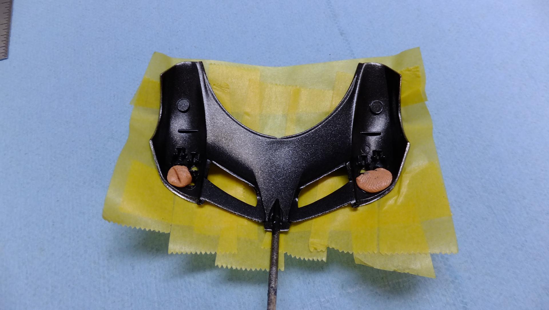

Rider Posted October 4, 2018 Posted October 4, 2018 19 minutes ago, Dann Tier said: Yes it is!....very tiring work too... Have you ever tried liquid latex? I use it for this type of masking I use tape to mask the edges then back fill the rest with latex. I also use it for tight radius areas. Cut a narrow bit of tape for the edge then back fill the rest with liquid latex. I buy the stuff used in the sculpting/mold making industry in pint containers, it cleans up with ammonia. It has saved me sooooo much time for this type of tedious masking, I buy cheap brushes of various widths from the dollar store. I will add it can't be used for edging on it's own in exposed areas as it tears the paint when being removed because the overspray won't stick to it leaving a ragged edge behind. I found this out the hard way, ugh. Keep up the fantastic work dude.

Dann Tier Posted October 4, 2018 Author Posted October 4, 2018 13 hours ago, Rider said: Have you ever tried liquid latex? I use it for this type of masking I use tape to mask the edges then back fill the rest with latex. I also use it for tight radius areas. Cut a narrow bit of tape for the edge then back fill the rest with liquid latex. I buy the stuff used in the sculpting/mold making industry in pint containers, it cleans up with ammonia. It has saved me sooooo much time for this type of tedious masking, I buy cheap brushes of various widths from the dollar store. I will add it can't be used for edging on it's own in exposed areas as it tears the paint when being removed because the overspray won't stick to it leaving a ragged edge behind. I found this out the hard way, ugh. Keep up the fantastic work dude. Thanks, Lloyd!, that's a clever idea!!

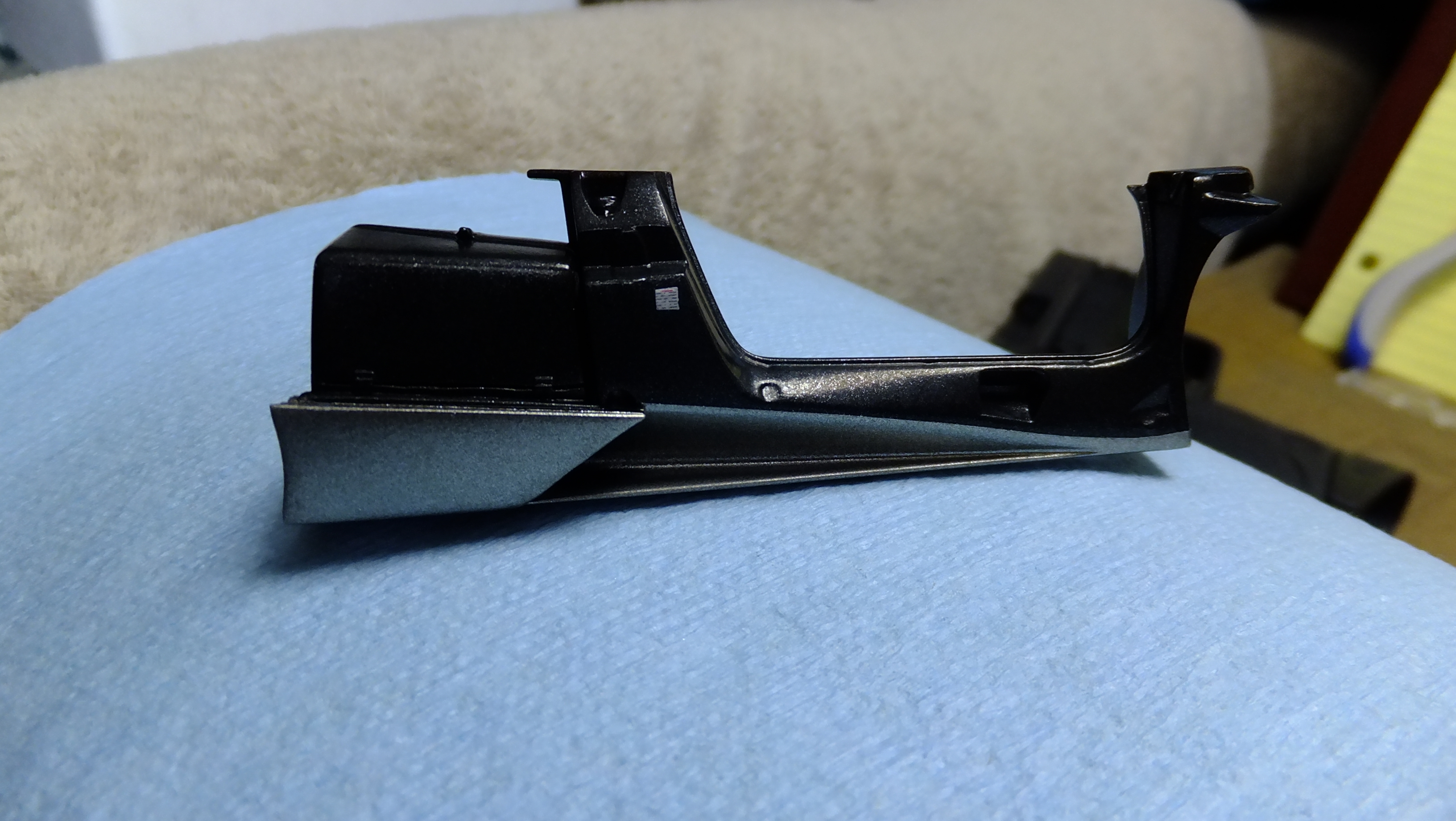

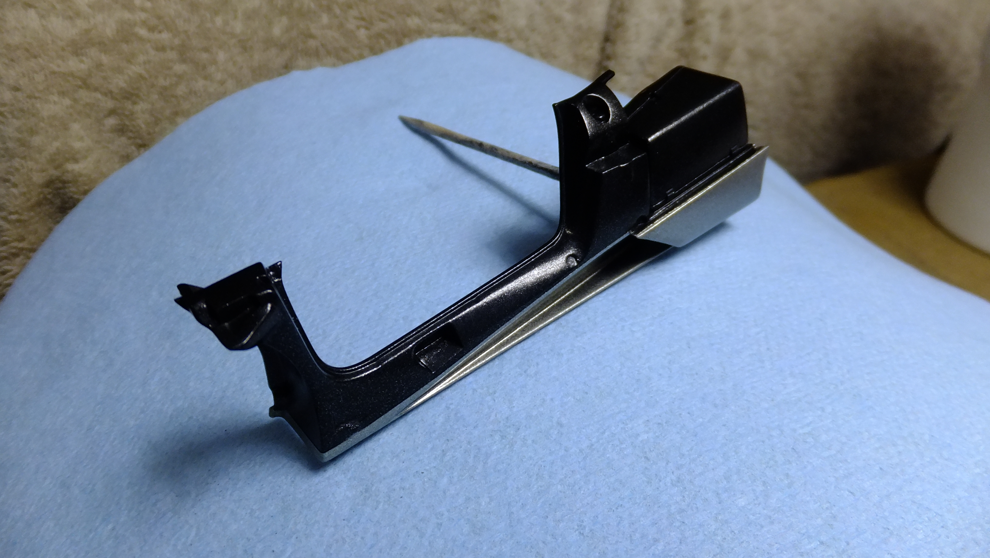

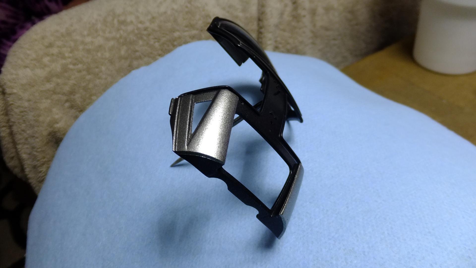

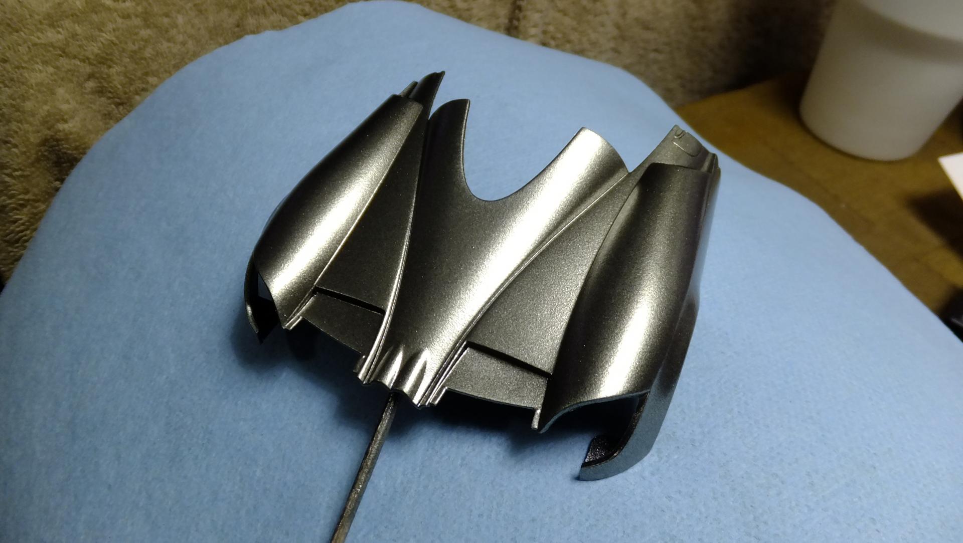

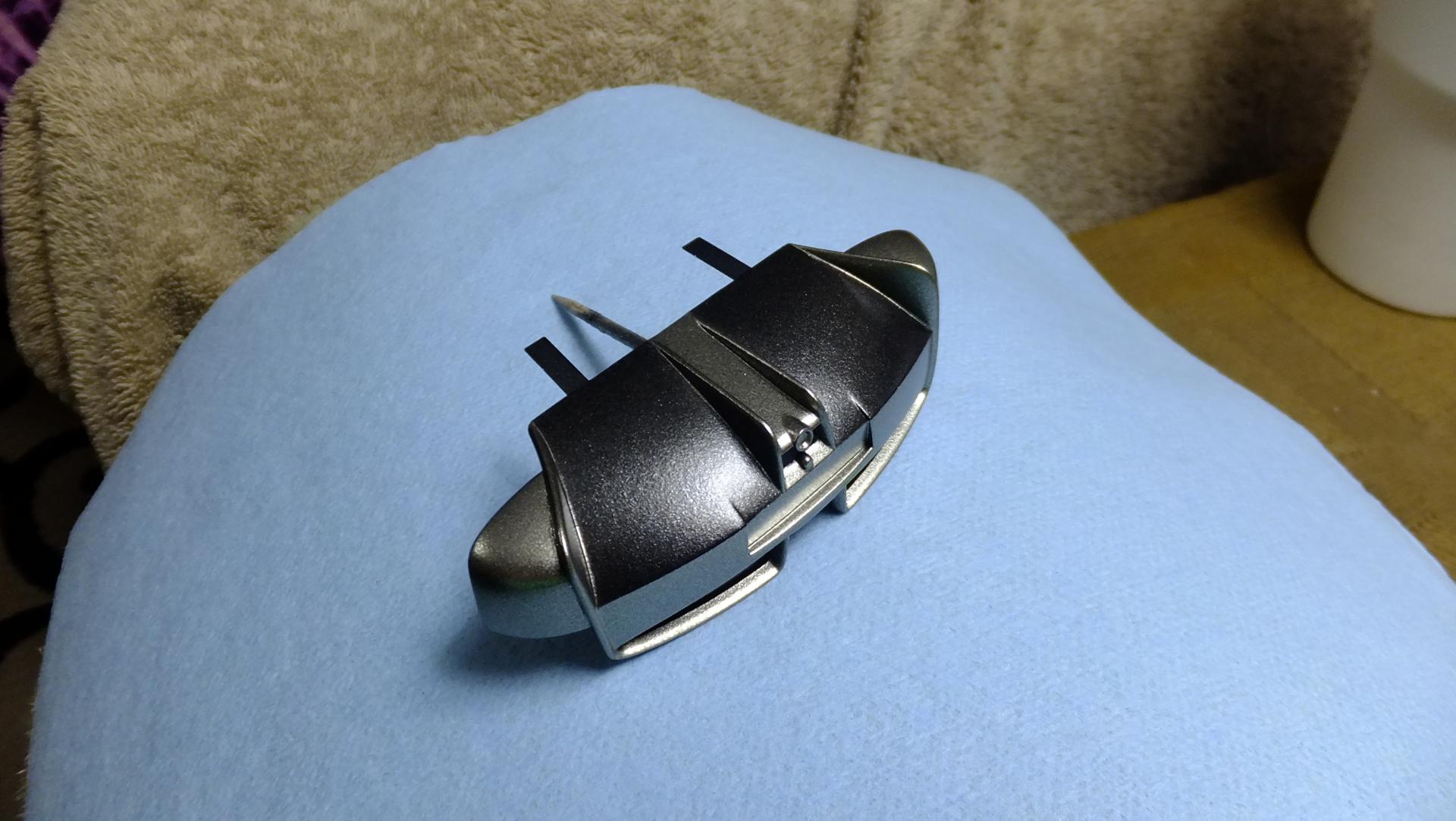

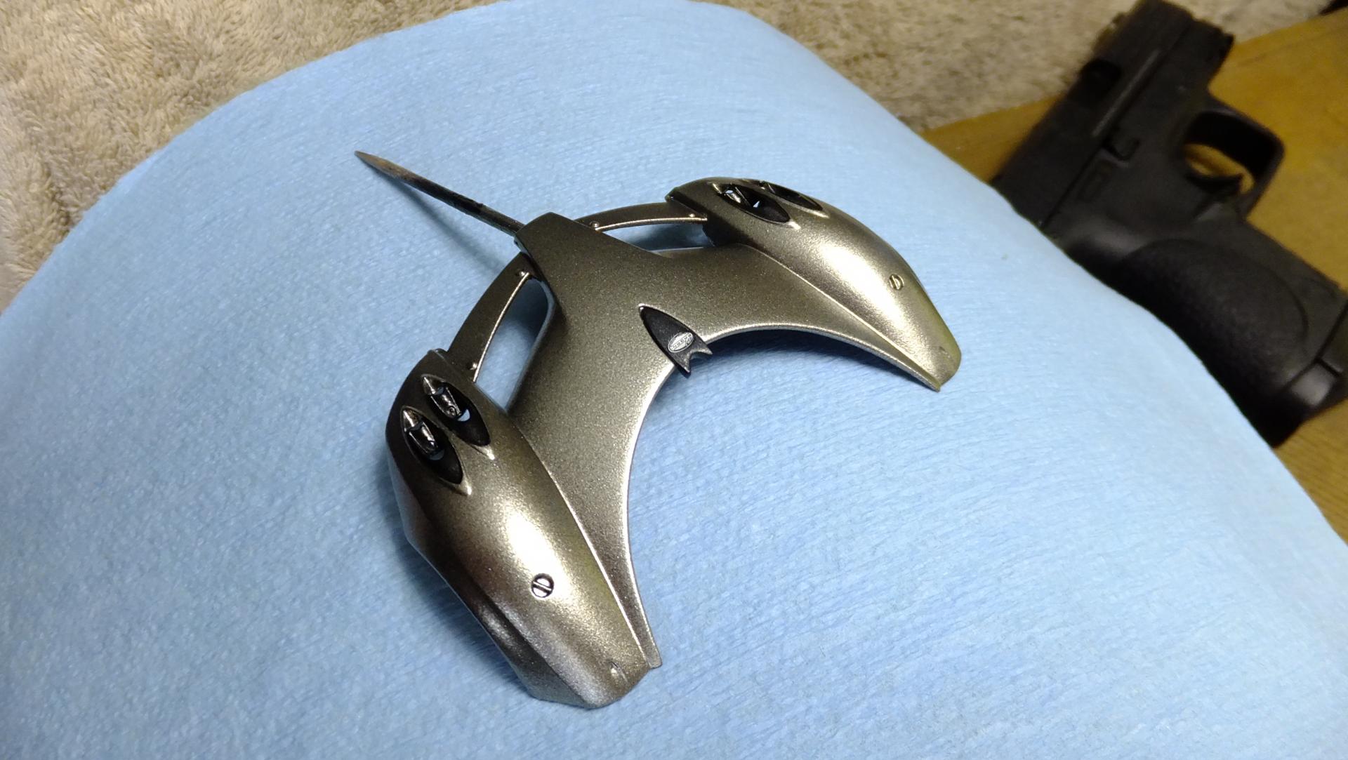

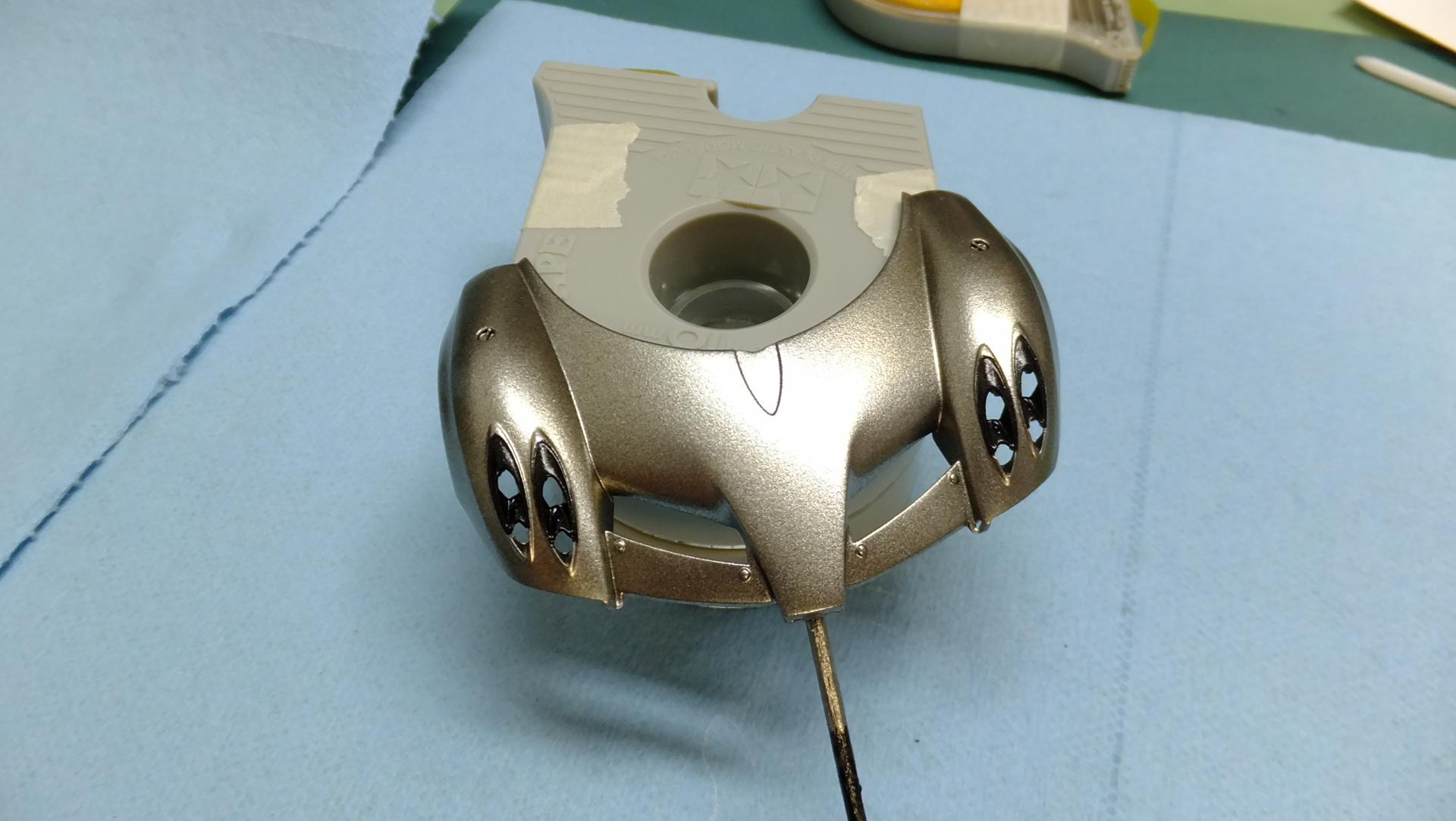

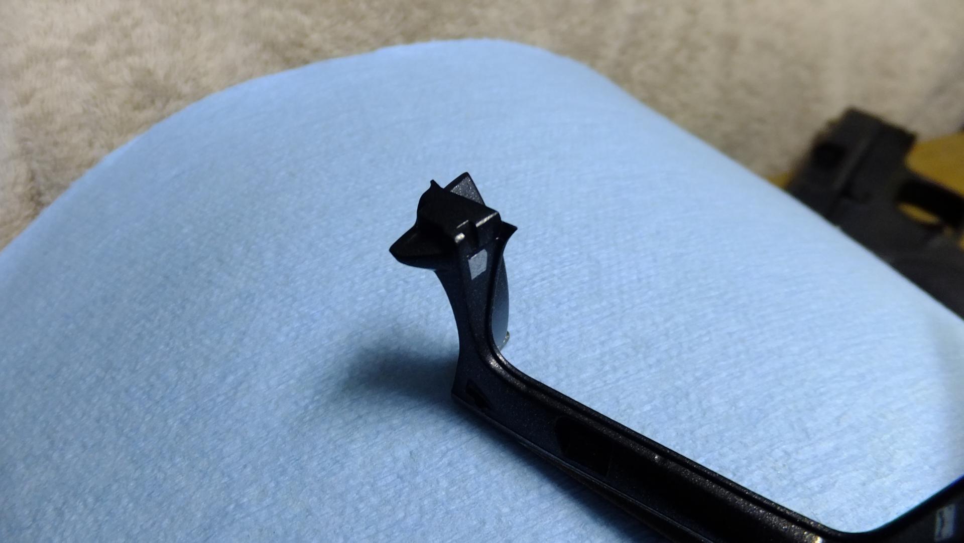

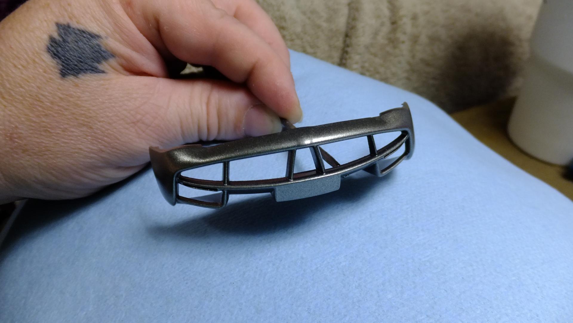

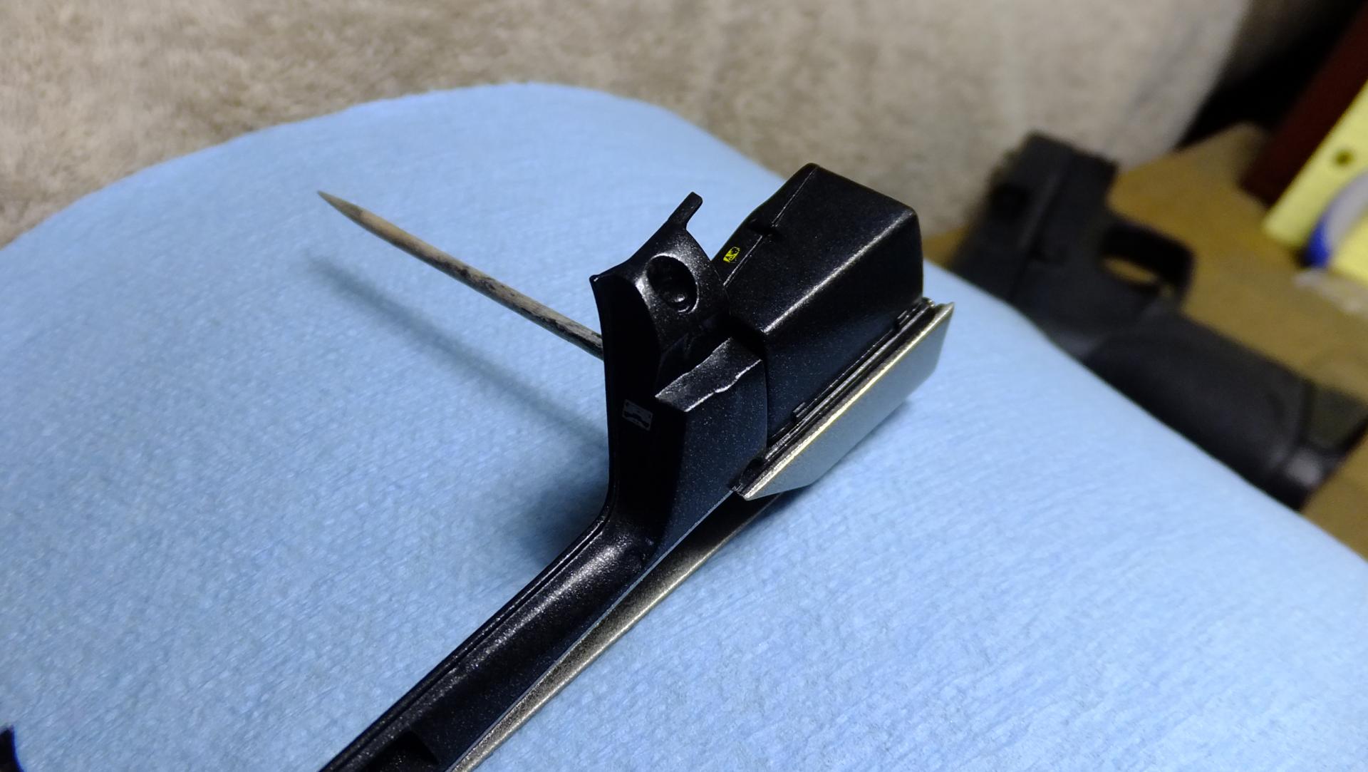

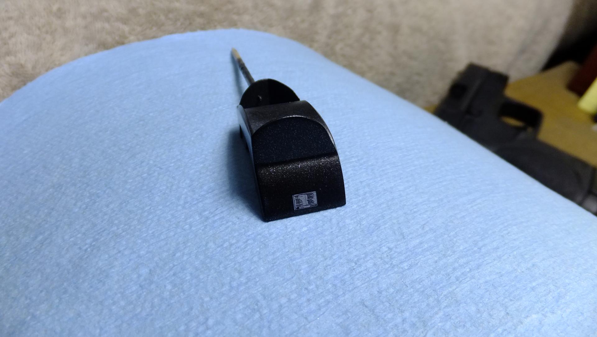

Dann Tier Posted October 4, 2018 Author Posted October 4, 2018 Small update here; I literally just got done masking, and spraying the last of my CF details.....headlamp housings, and under belly of the rear fascia. Noticed how I masked-off the lower headlamps like the real cars....

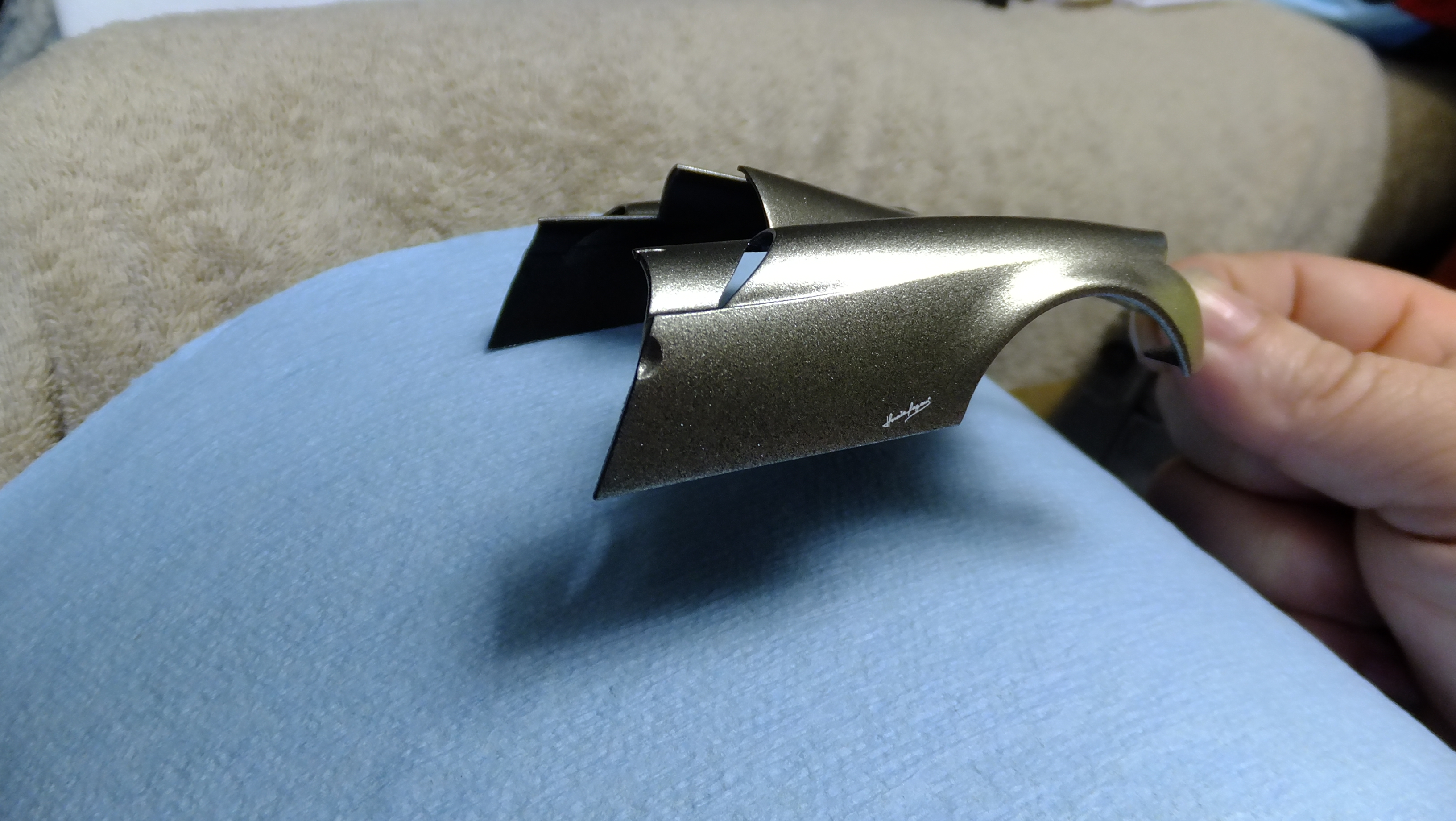

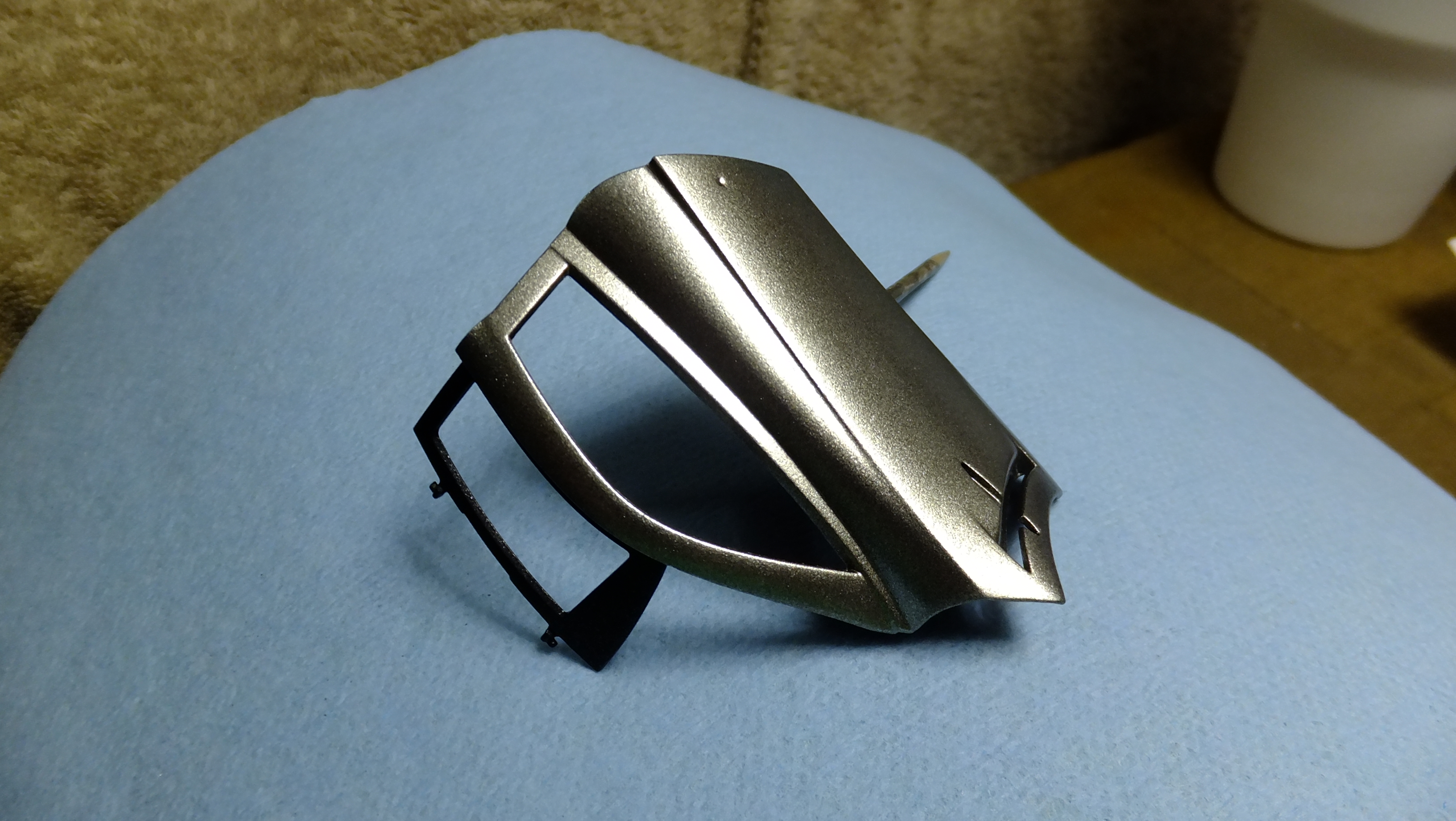

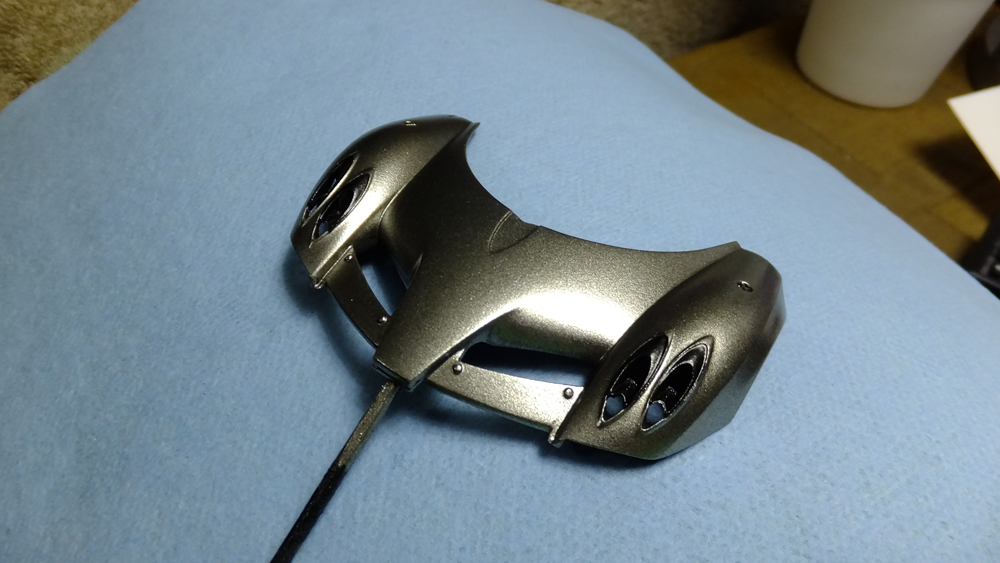

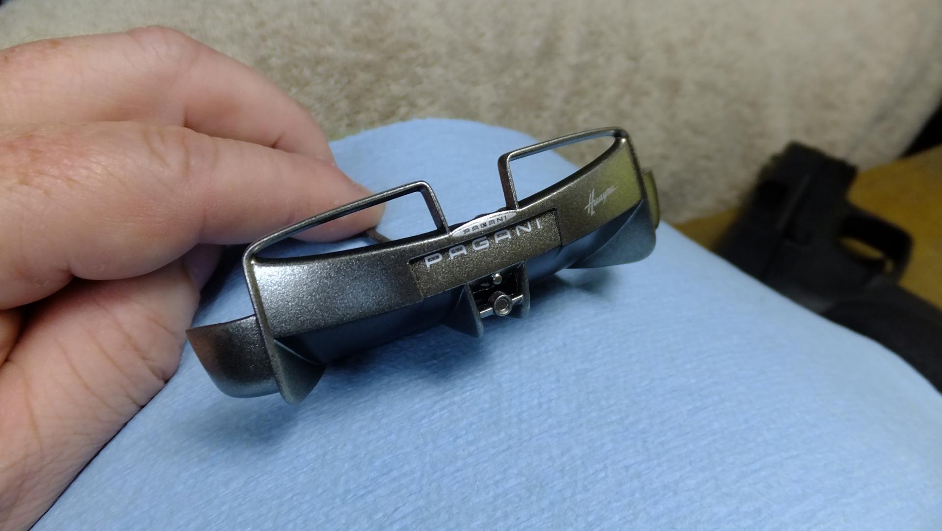

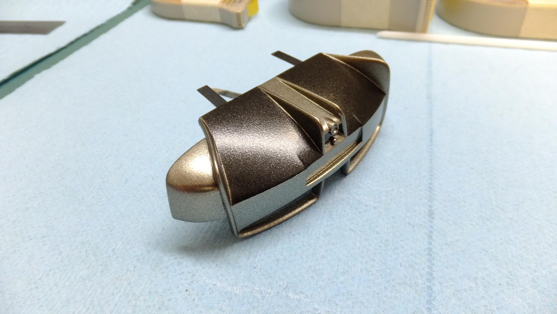

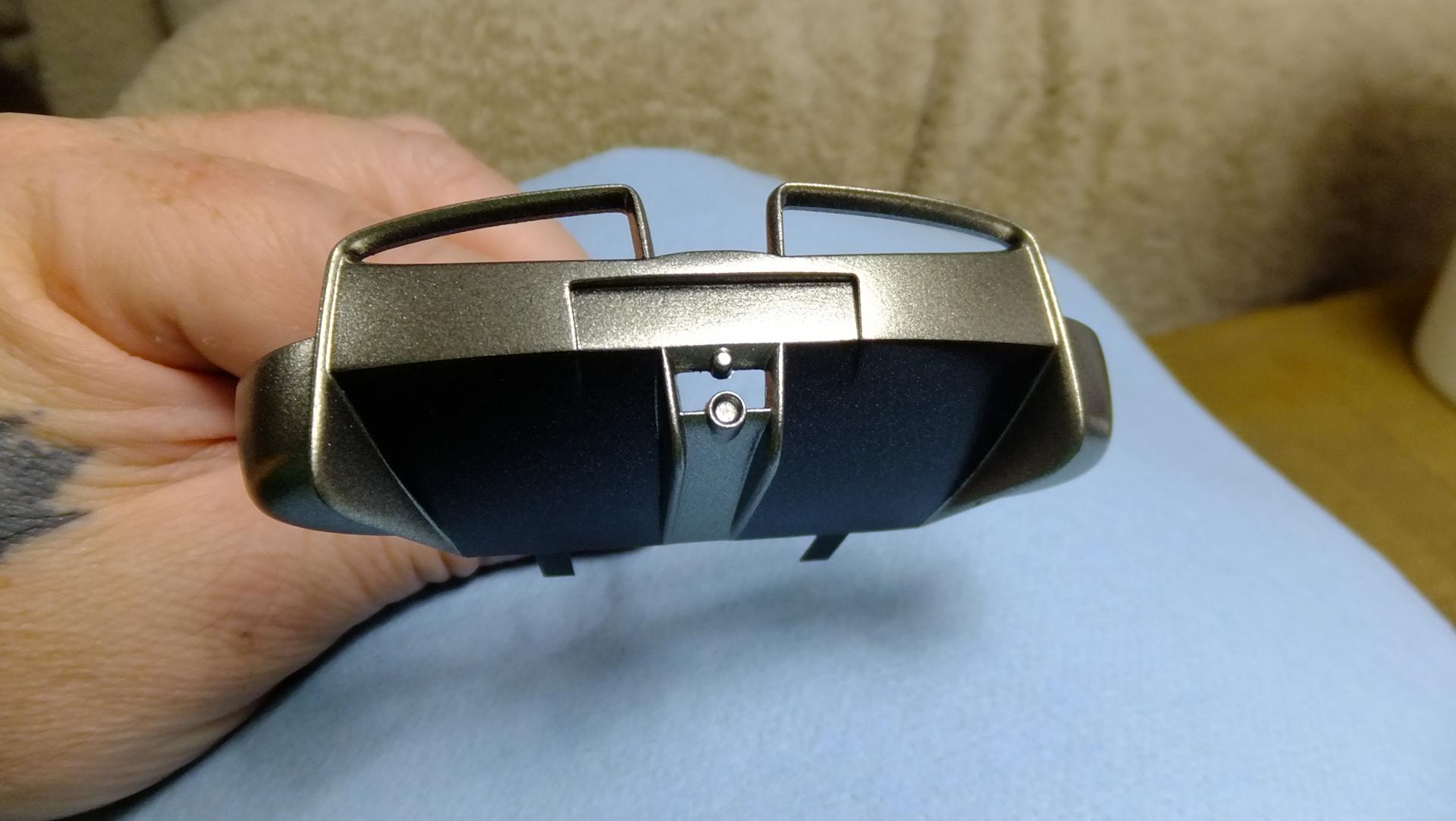

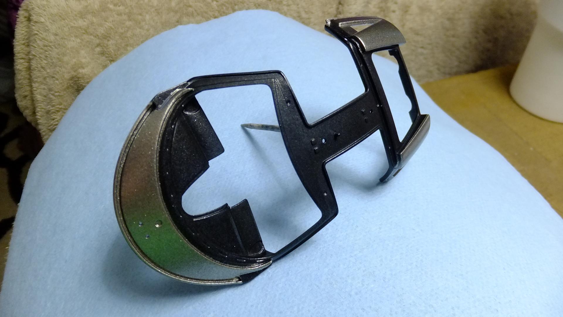

Dann Tier Posted October 5, 2018 Author Posted October 5, 2018 Here are the rest of the body parts finished, waiting for decals and clear.....
