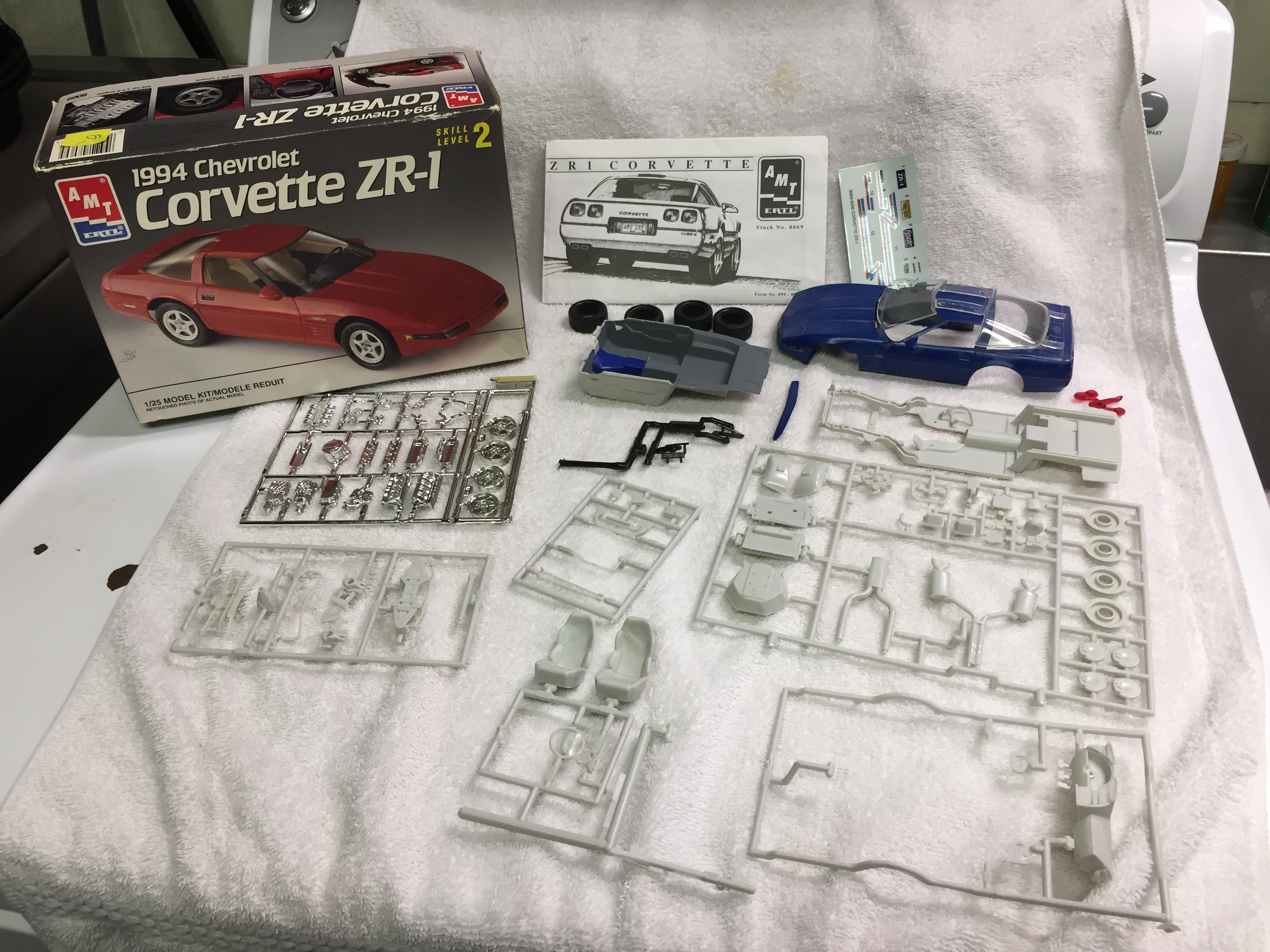

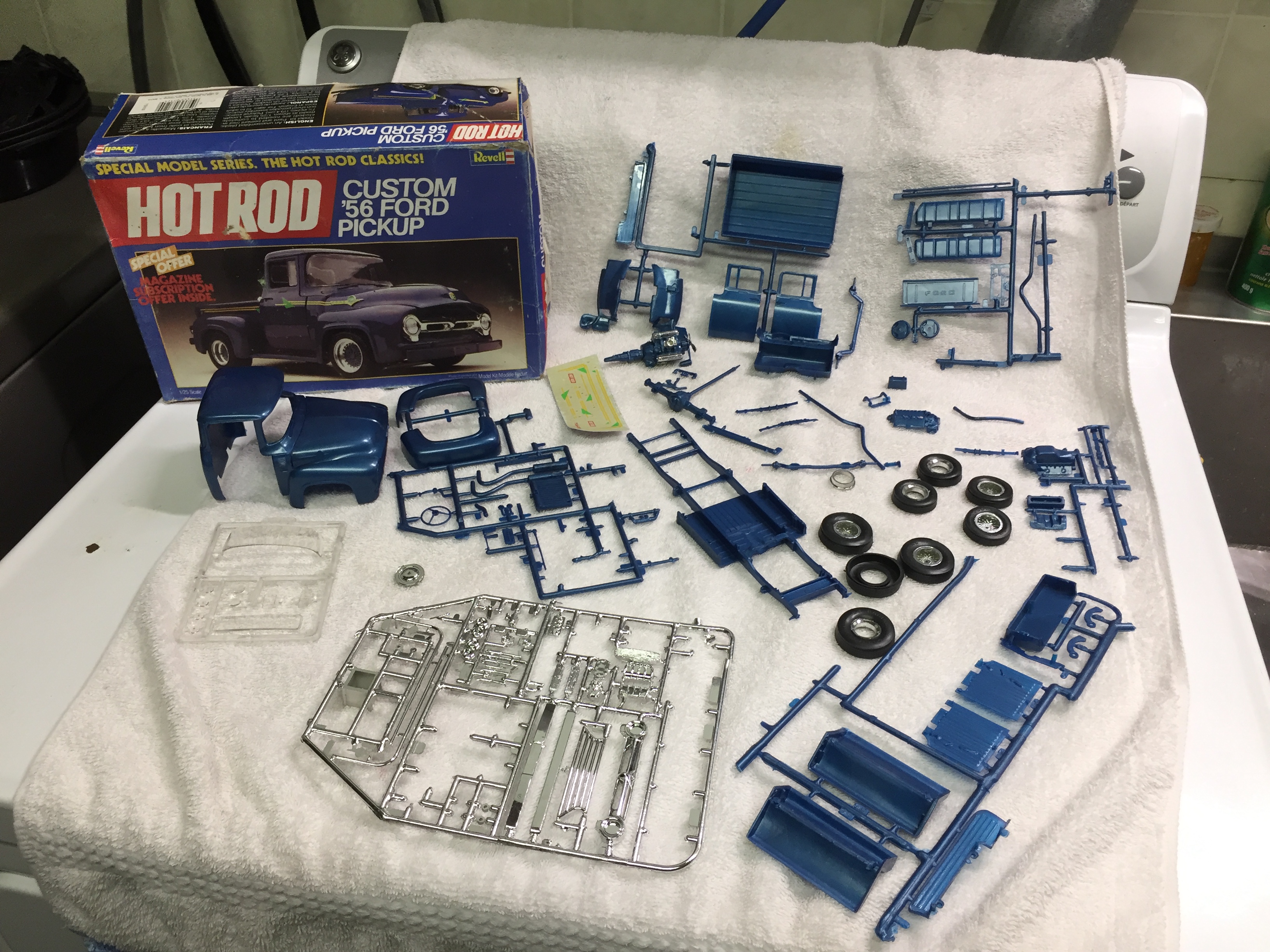

I went to a local flea market today and bought these three pre-owned models for $25. They seem to be fairly complete. The Mercedes is missing the windshield and the A pillars are broken and missing. There is no instruction sheet for the Ford Pickup. There was another seller there that had an AMT Silhouette with no instruction sheet that I wanted, but she wanted $60. for it, so I passed thankfully!

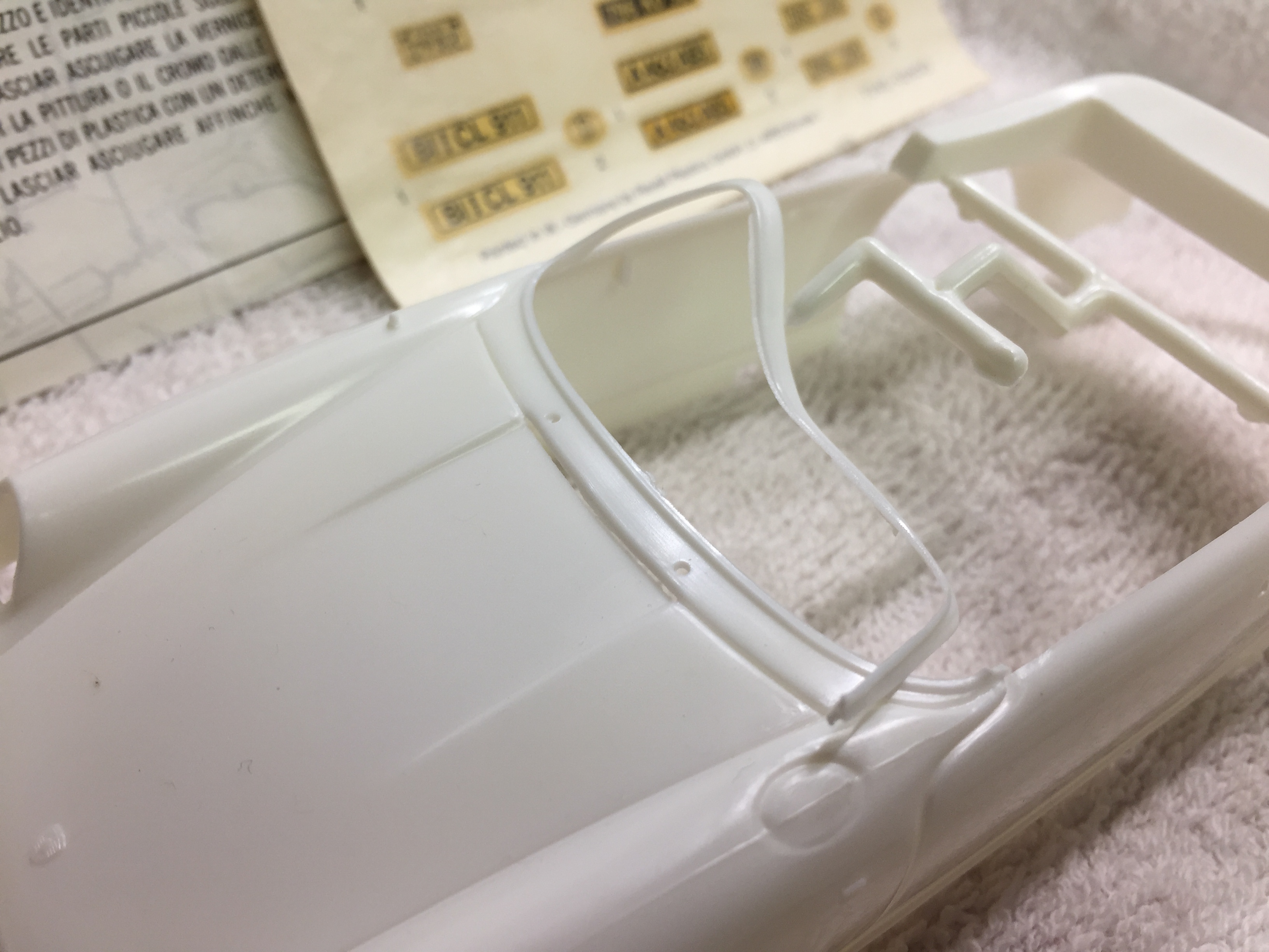

I got a tip from a customer about another flea market where I scored these for $15. I will have to go through the instructions and take inventory of what is missing. I also got a box full of chrome parts. The windshield frame on the Porsche is kind of melted, so I am not sure if I can fix that?

Don't use heat on that windshield frame. You'll ruin it.
You MIGHT be able to bend it back into shape enough to glue the windshield to it. I restored a model recently where the windshield frame was quite bent, but I was able to super-glue the windshield to it and now you'd never know it. That one wasn't as bad as this.
You might end up having to scratchbuild it.

Does anybody have an idea how to fix this?
Perhaps consider building a Speedster, with a cut down windscreen. Google one for a photo reference.

The Corvette, '64 chevy, Ferrari and Porsche are all complete. The 56 Ford p/u may be complete?? The '39 chevy is missing one front shock. The '65 Chevelle "parts" car is missing the engine, tires, clock and one muffler. I am heading back to the flea market today to see if I can scrounge up some more parts. The guy I bought them from said he had 2300 models in his lifetime, and is thinning them out!

Yup, my thoughts here too.
Or graft a complete windshield frame from a monogram flatnose kit, they seem to be everywhere - cheap!
I may be able to cut one off a junker I have somewhere, if you want it. I'll give you the whole frame and cowl area, you trim to fit.

Take the glass. Cover it in tape to protect it. Then tape the windshield in place and then tape the frame to the windscreen. You might get lucky and get some shape back, but I honestly doubt it. If you do you'll have to fill in what likes like missing plastic on the drivers side with some strips then shape it. But I'm thinking the speedster option might be more realistic. Other option if you want a stock look, cut the whole thing off, put the windscreen in place (as above, covered in tape to protect it), then fab your own surround?

That was my first thought ;)
Is that the old Revell kit from the early 80s? Or a newer tool like a fujimi type?

Since it's Revell, I'll assume it's the former. But since you have it - I had to ask.

I've used a dehydrator to re-shape parts. Construct a wooden form, insert it into the opening, and place the kit in the dehydrator. You might need to do this in stages, using smaller forms and graduating to the final size.
This is a '48 Ford I recovered using the dehydrator. When I put the color coat on, I left the body on a Tamiya paint rack, then placed the whole thing in a dehydrator. The spring tension on the paint rack widened the body...so I added a couple of cleats to some scrap plywood, wedged the body in there, and put it back in the dehydrator. The body came out the correct width, although I had to tweak the front pan which had curled upwards while the body was being "narrowed".
