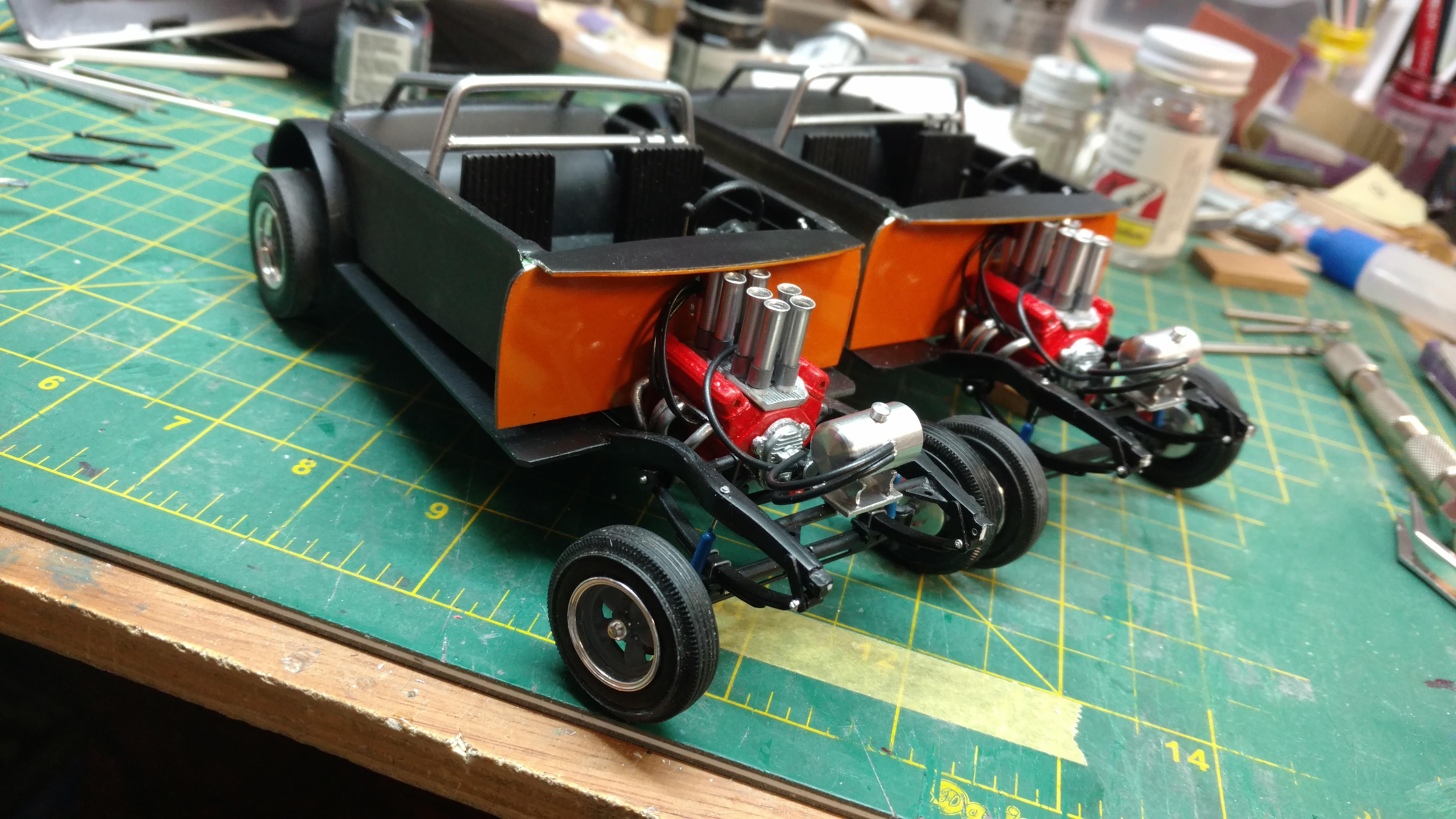

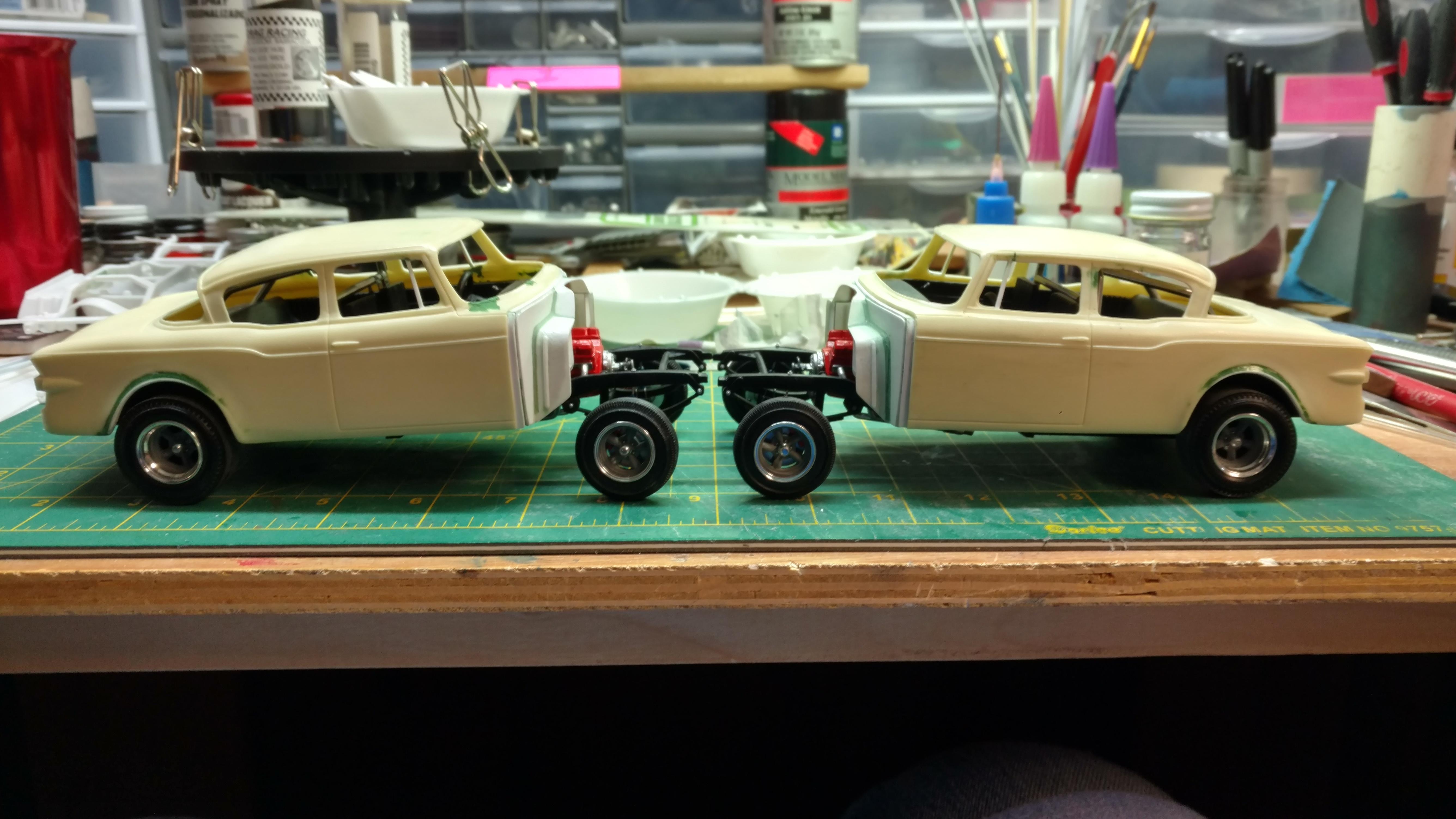

64SS350 Posted December 19, 2020 Author Share Posted December 19, 2020 This morning both bodies are officially fitted to their respective chassis. Added detail to firewall areas. Quote Link to comment Share on other sites More sharing options...

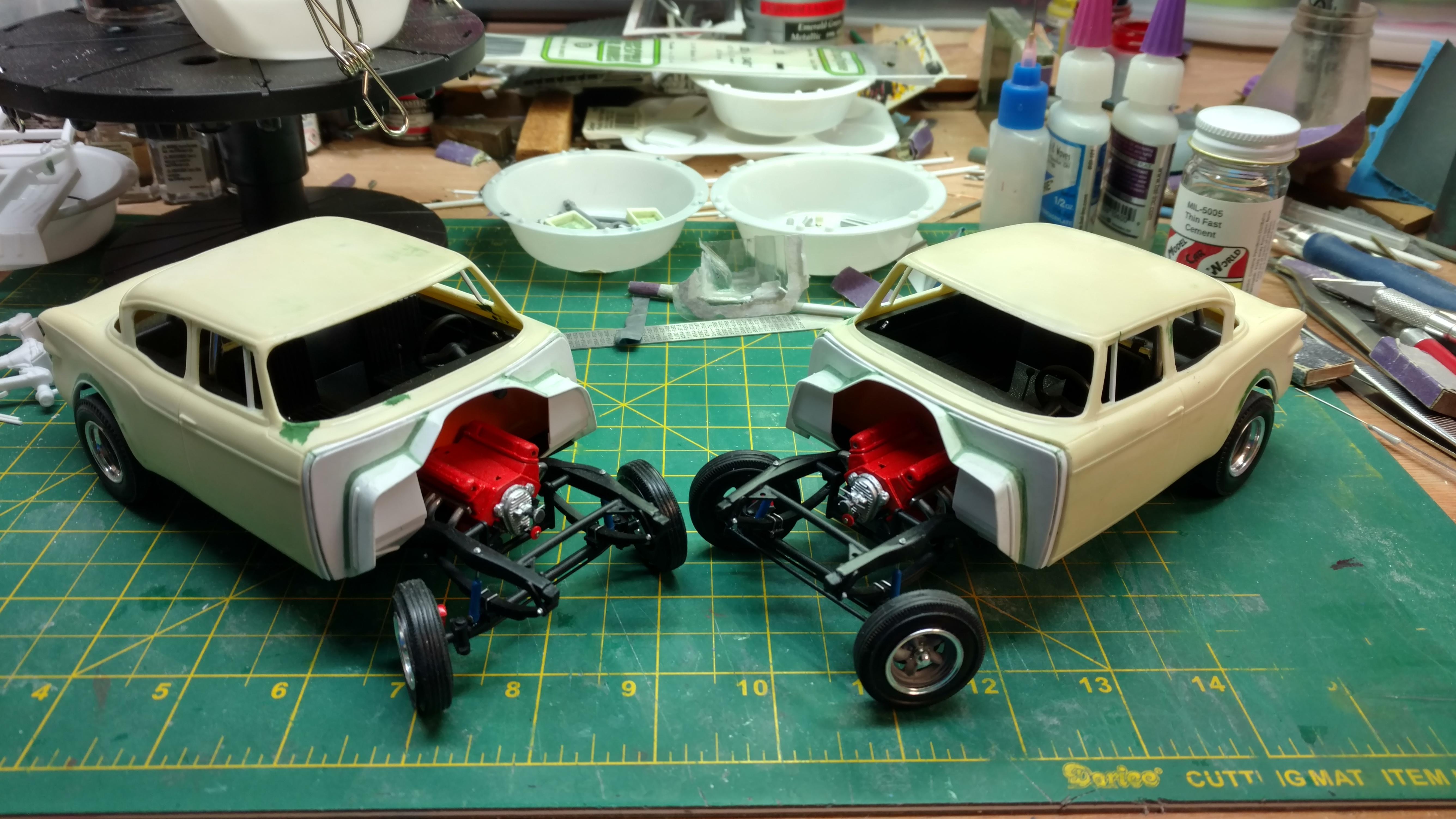

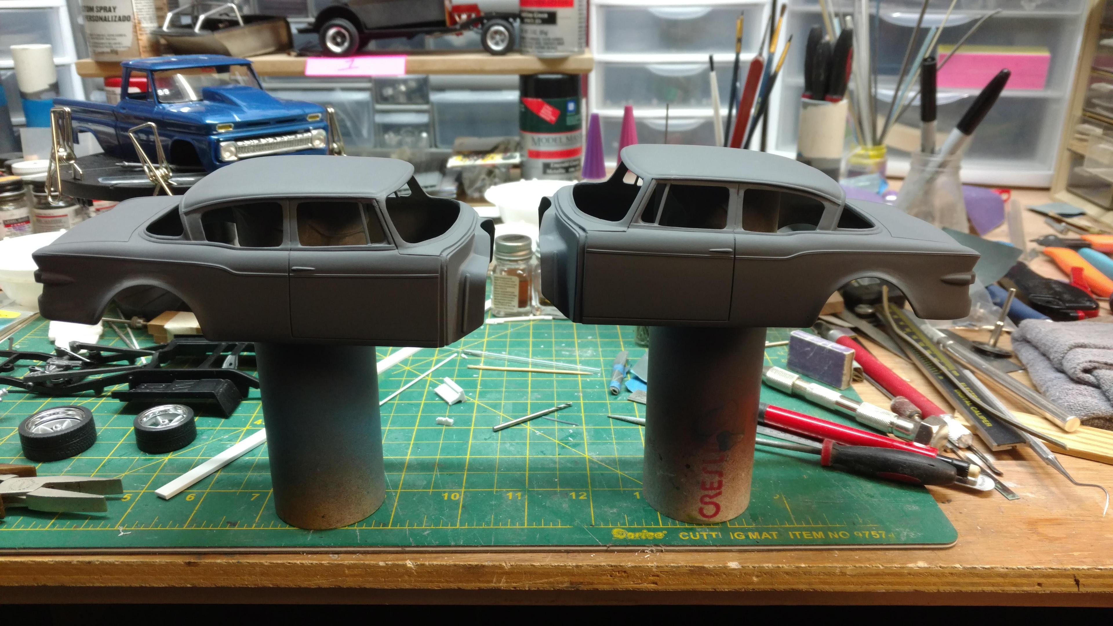

64SS350 Posted January 15, 2021 Author Share Posted January 15, 2021 I believe both bodies are ready, some light coats of spot primer, seal primer, a wet sand, then shooting some color on the insides of the interiors and front clips. Quote Link to comment Share on other sites More sharing options...

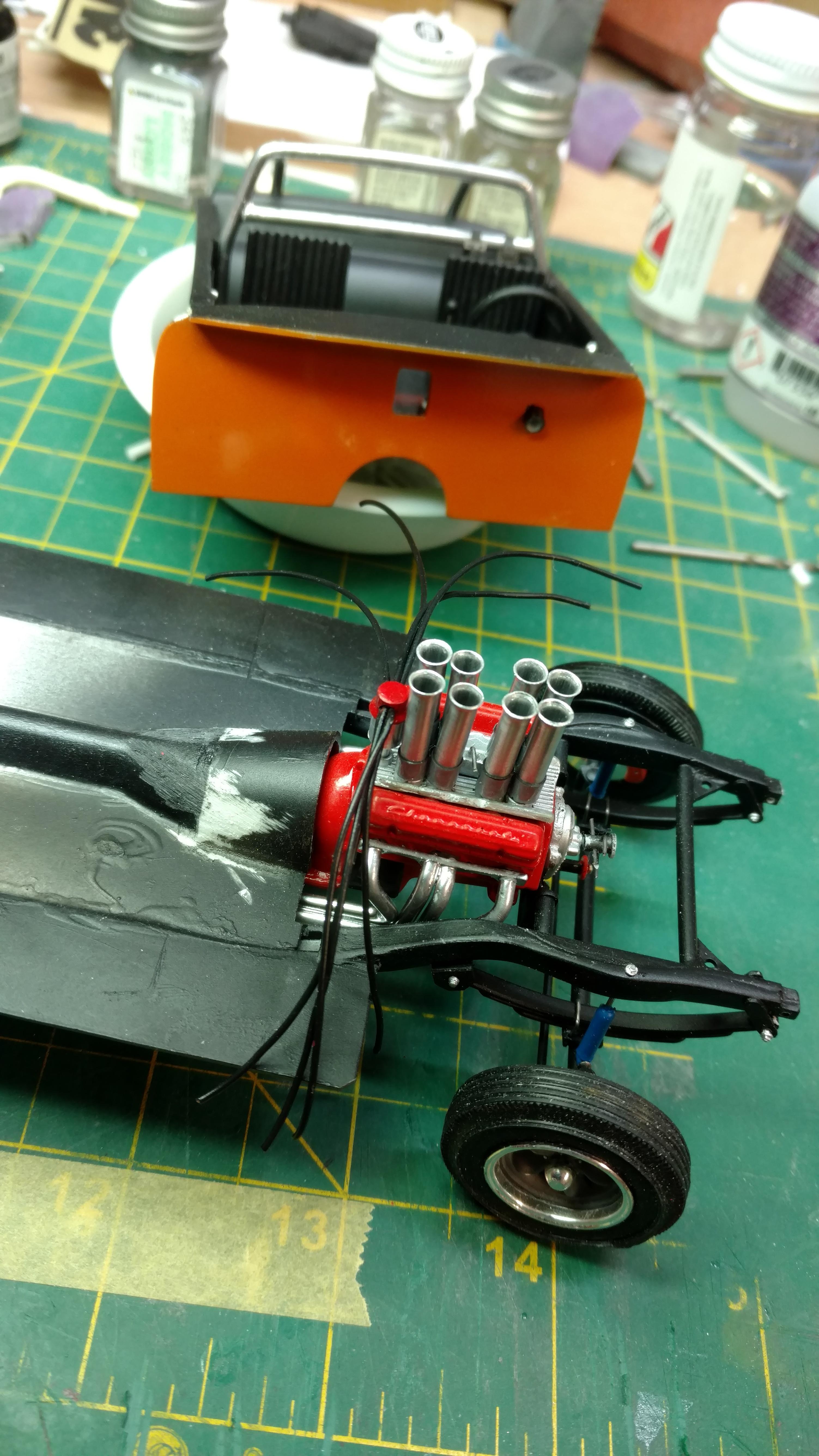

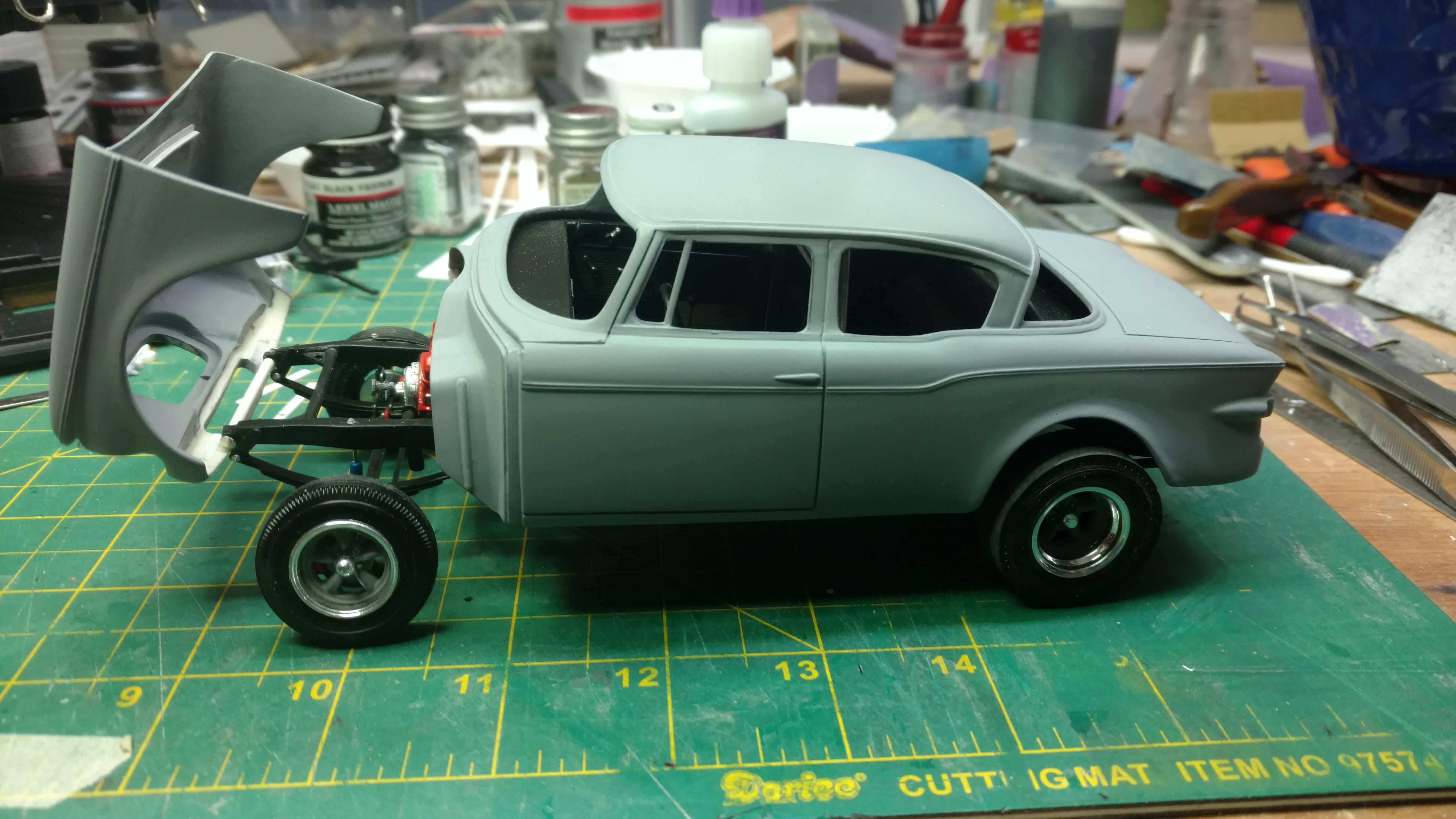

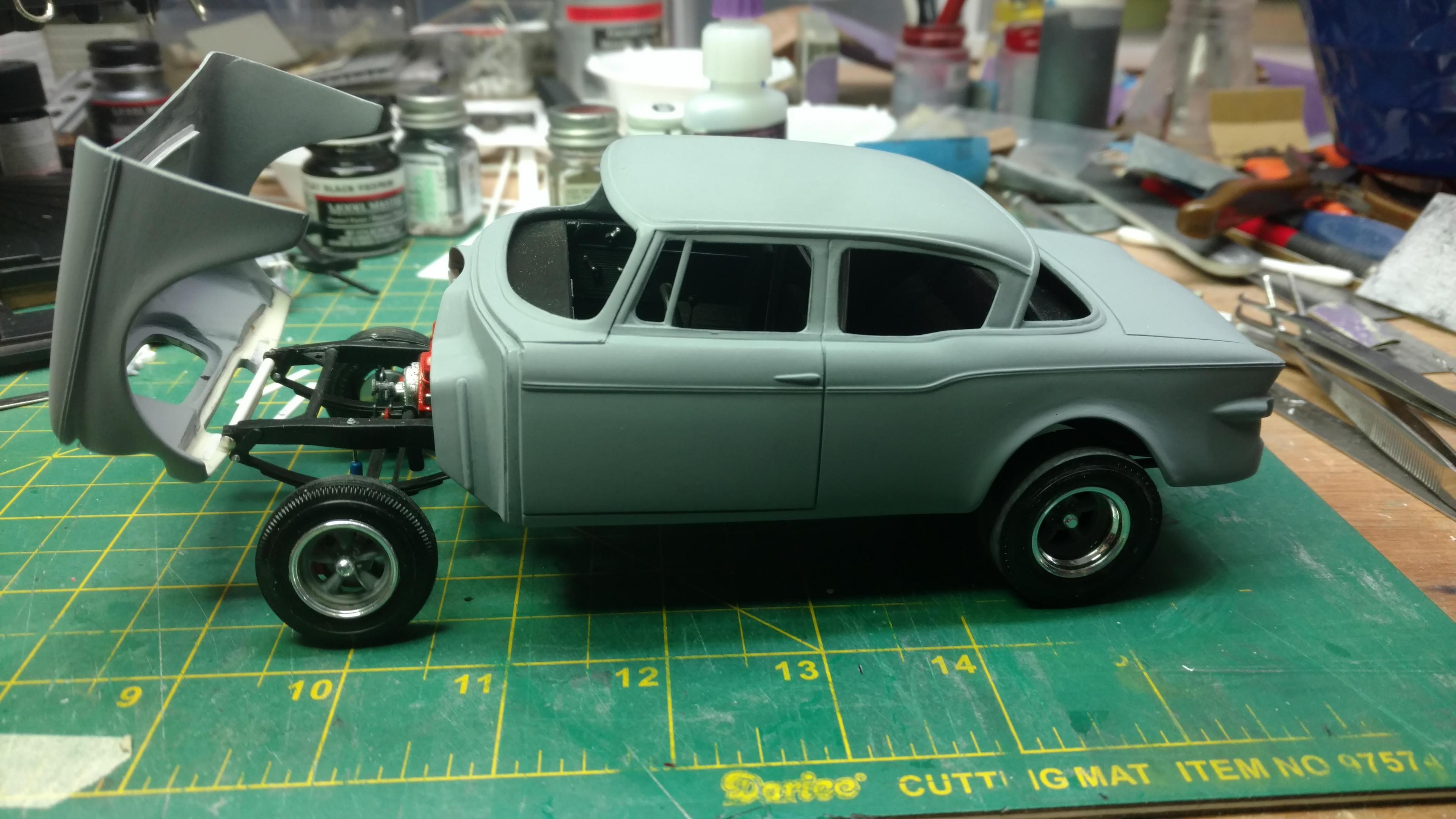

64SS350 Posted January 30, 2021 Author Share Posted January 30, 2021 Had/have some back peddling to do, forgot a detail on the firewall, plus tweaking the front clips to fit and tilt. Here's one... Quote Link to comment Share on other sites More sharing options...

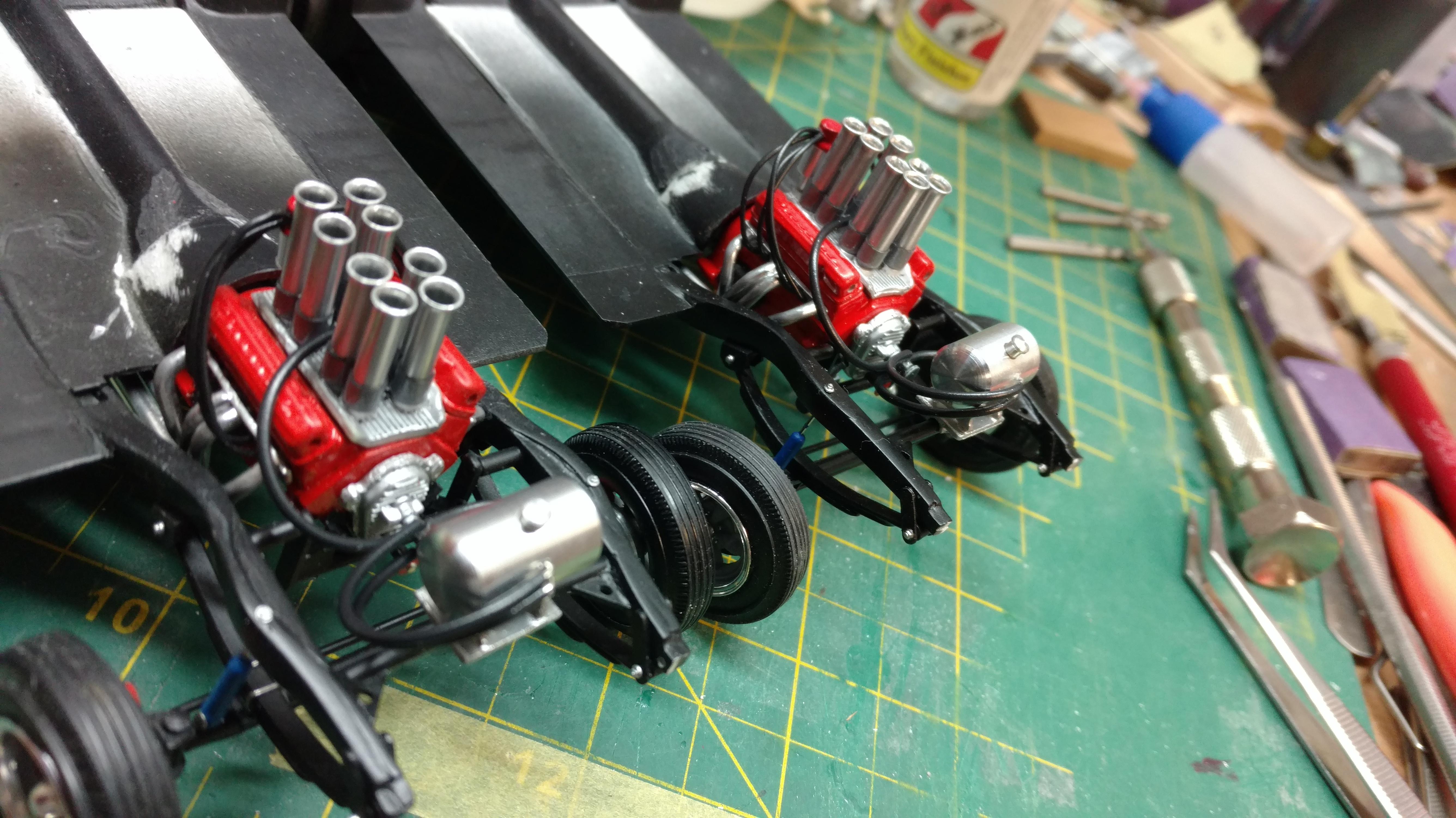

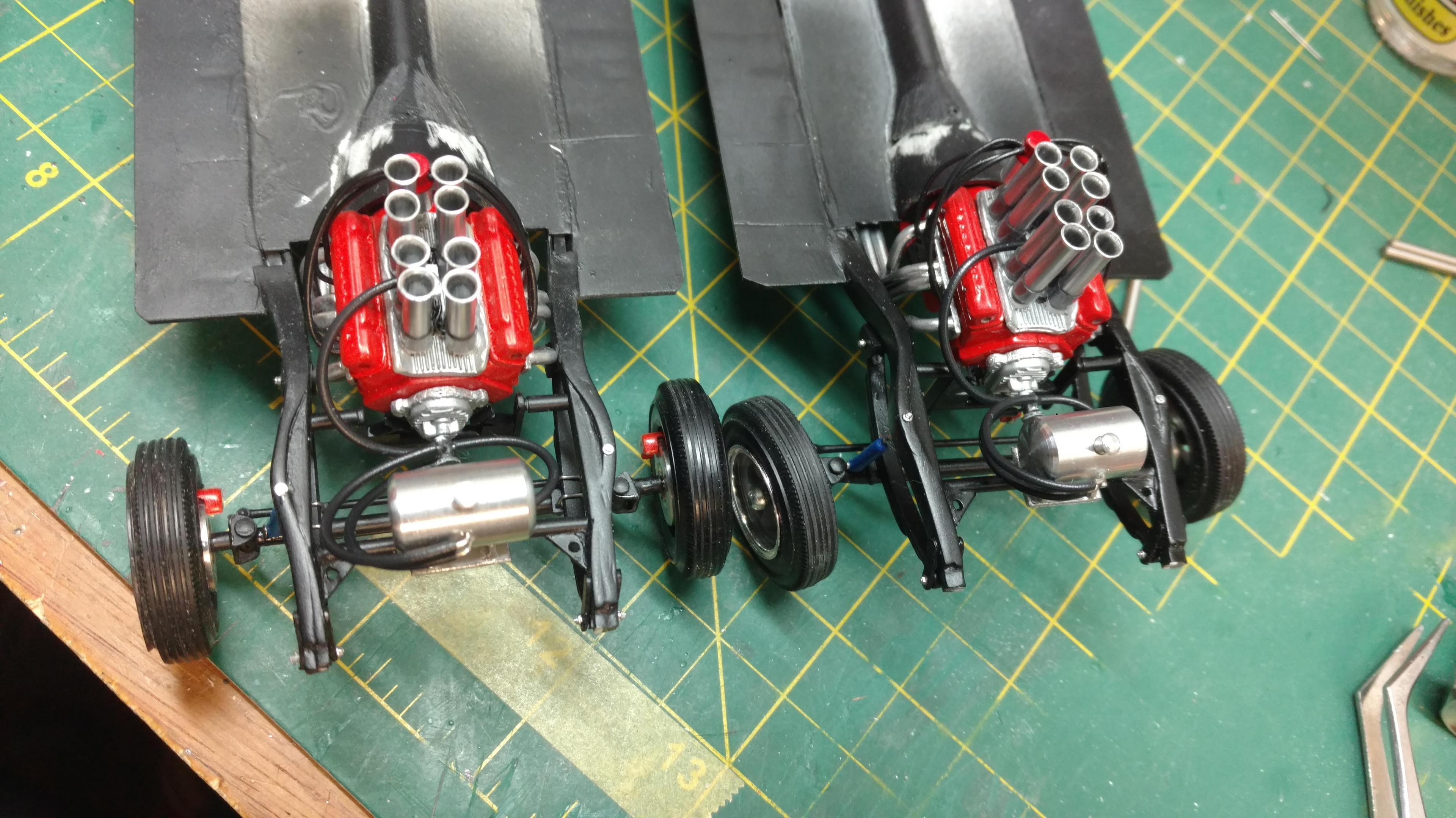

64SS350 Posted February 14, 2021 Author Share Posted February 14, 2021 Ok, more backpedaling. While fitting the second front clip, realized some how the axel was too far forward. Refitted the whole front axel and repainted the entire chassis to look uniform. Finished one intake so far. Quote Link to comment Share on other sites More sharing options...

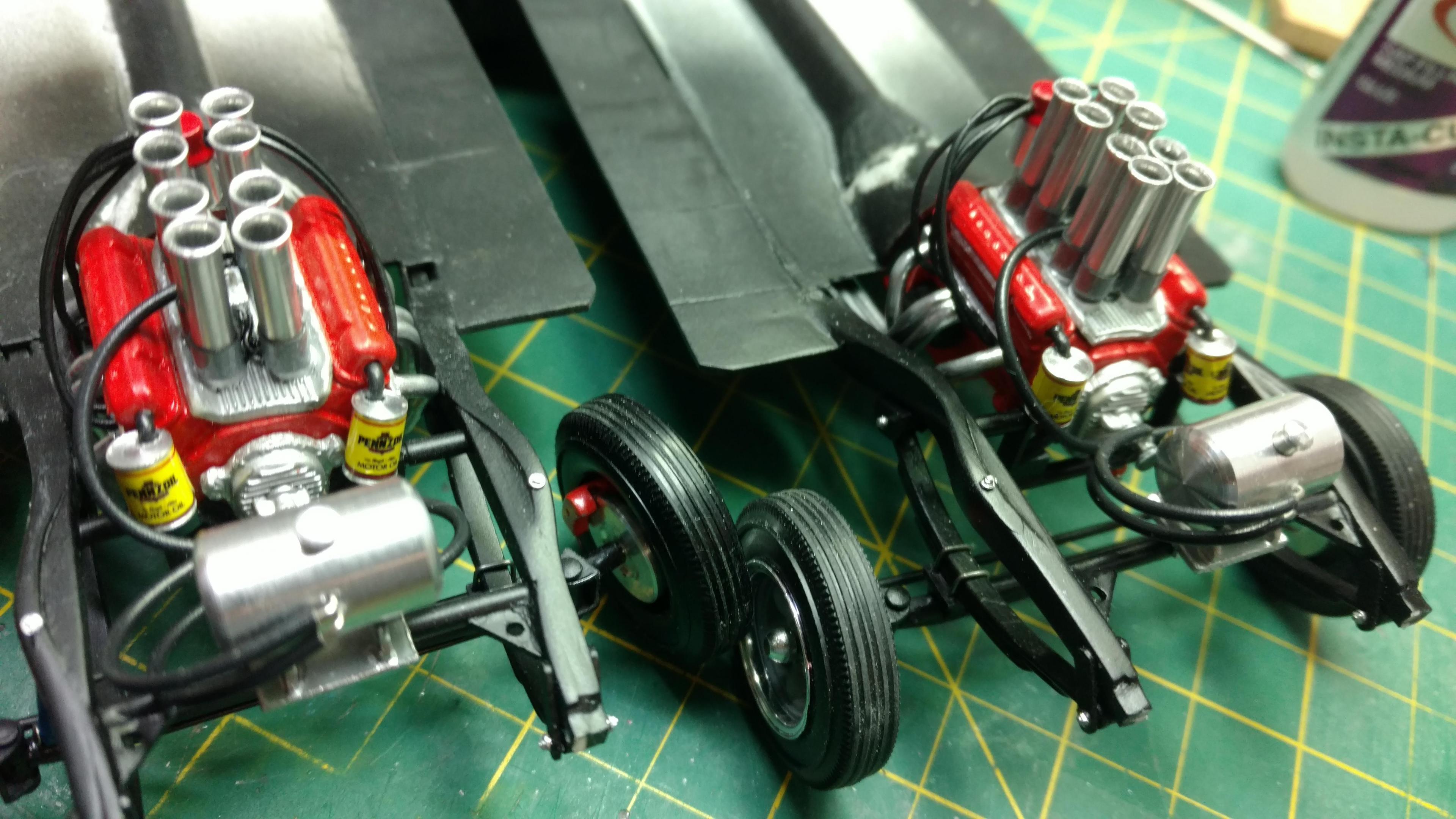

64SS350 Posted March 5, 2021 Author Share Posted March 5, 2021 Engines are 99% , I found my source of decals for the overflow oil cans, so now I can finish those. I used the same line for gas as before, if I find more, I will stock up! This is an old phone line from my house, it has a solid core wire. Simply pull the wire, and it slips beautifully over a .021 straight pin with no glue! Quote Link to comment Share on other sites More sharing options...

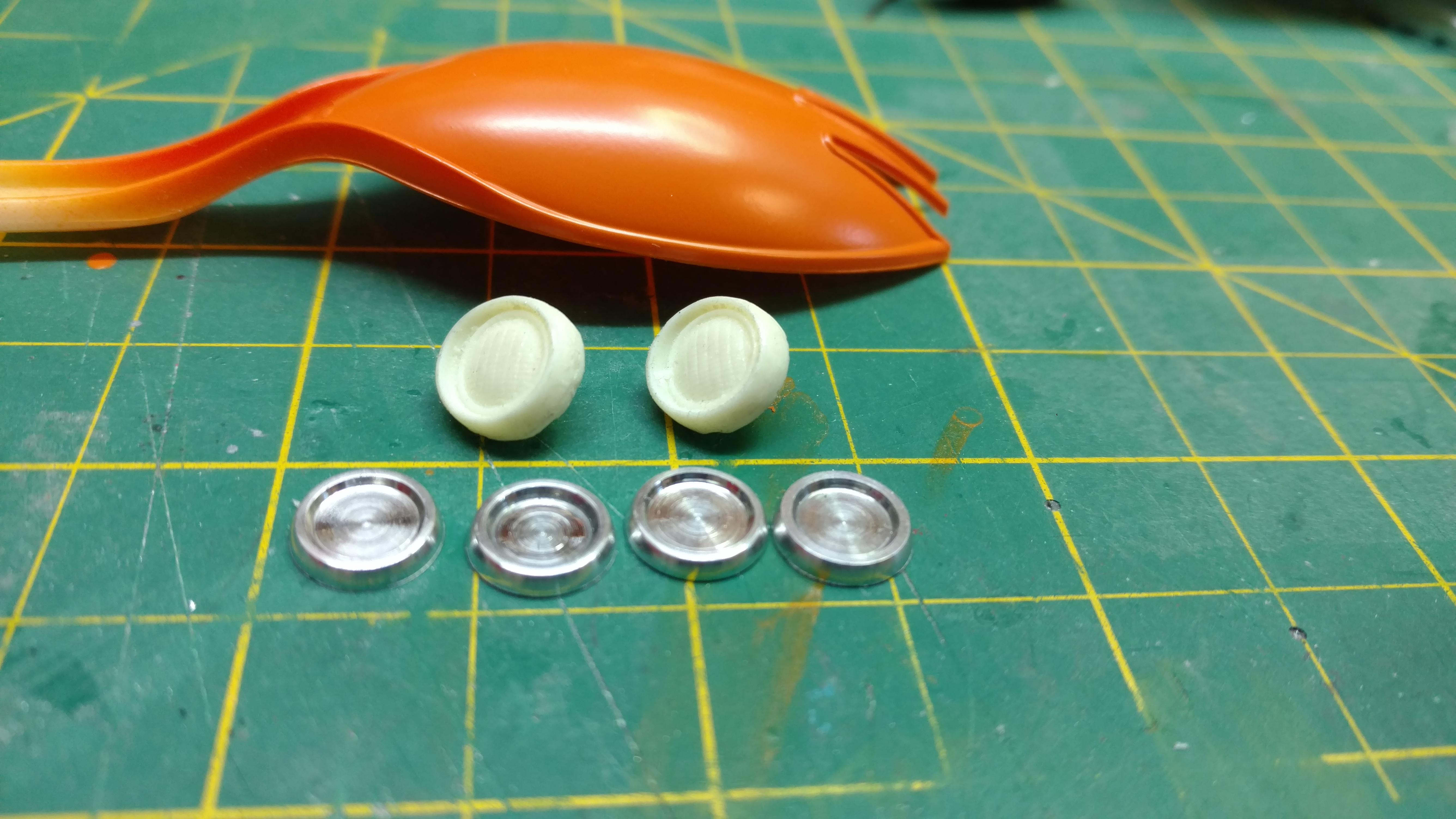

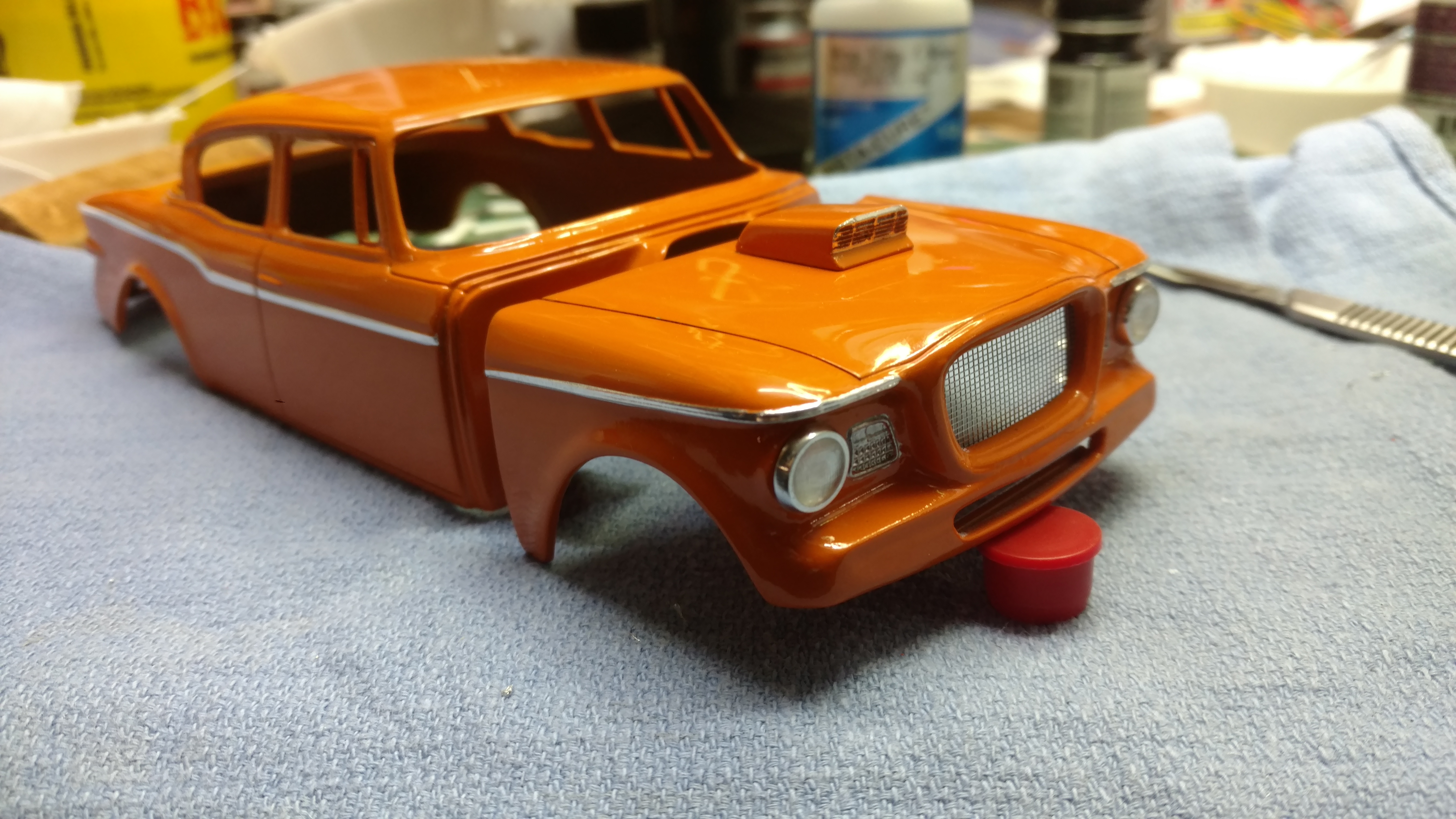

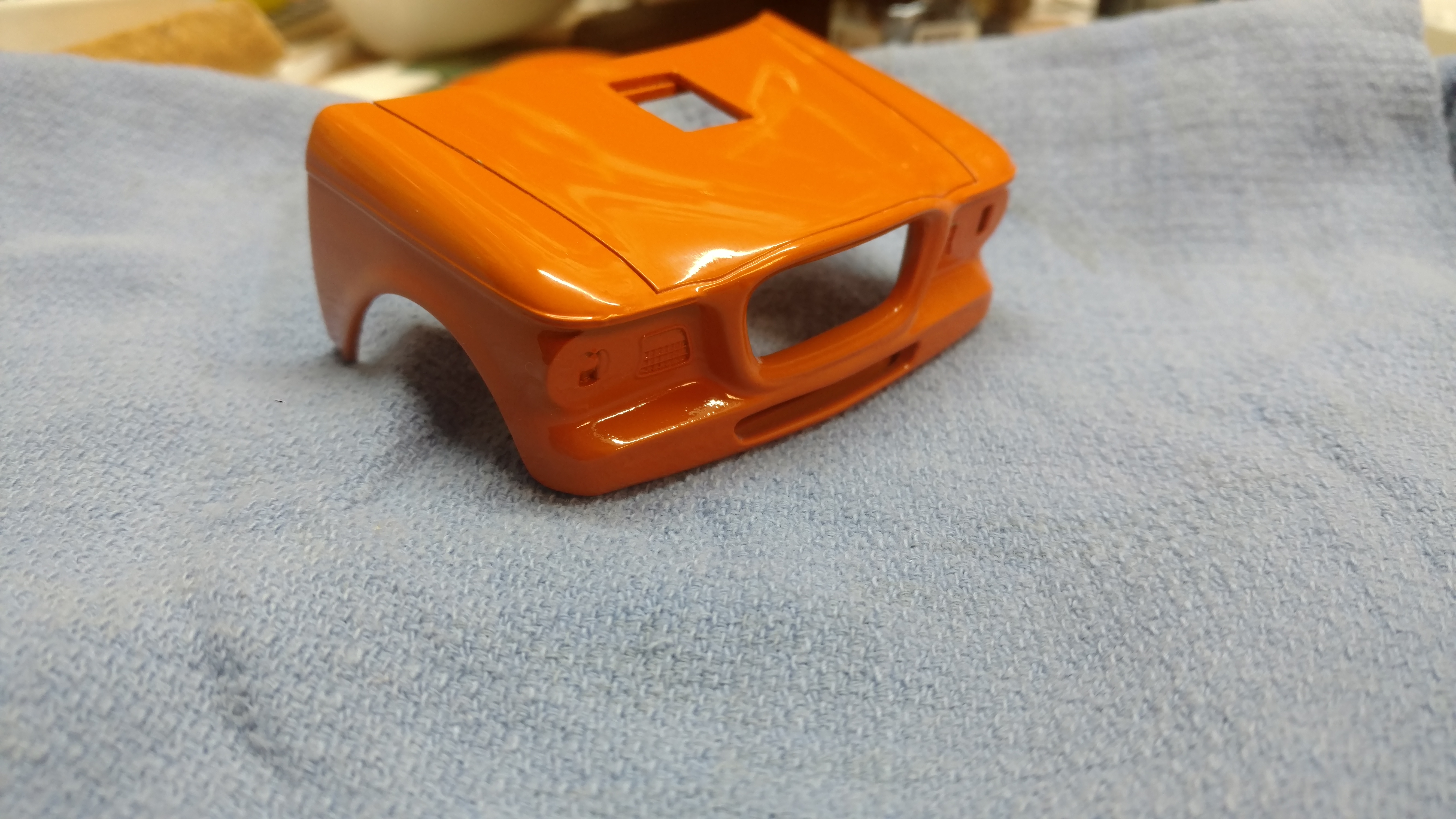

64SS350 Posted April 4, 2021 Author Share Posted April 4, 2021 Shot some color on the underside of the bodies and front clips last week. Finished the headlight bezels. Ugly resin ones compared to more realistic and proportionate aluminum. Happy Resurrection Sunday! Karl Quote Link to comment Share on other sites More sharing options...

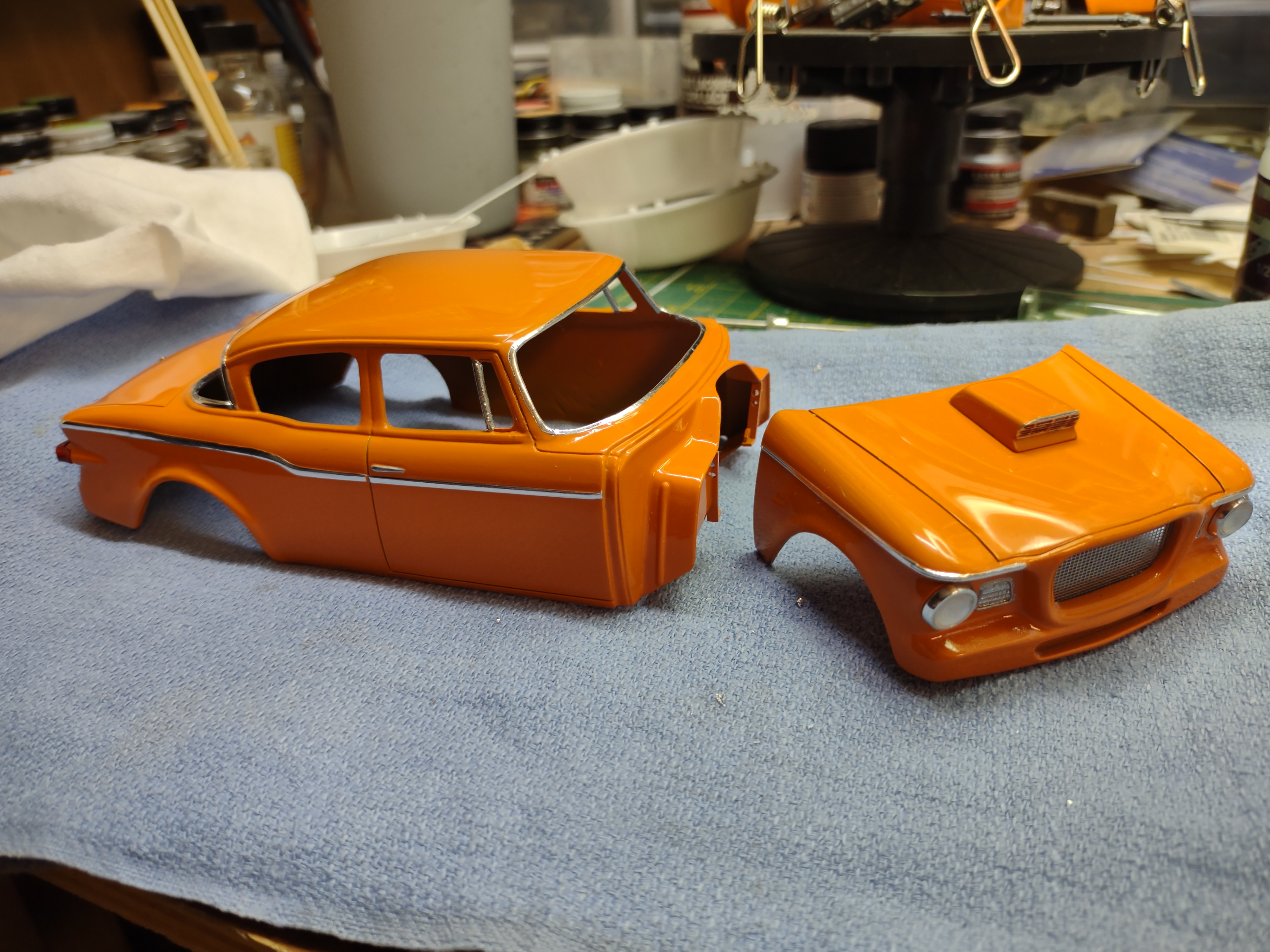

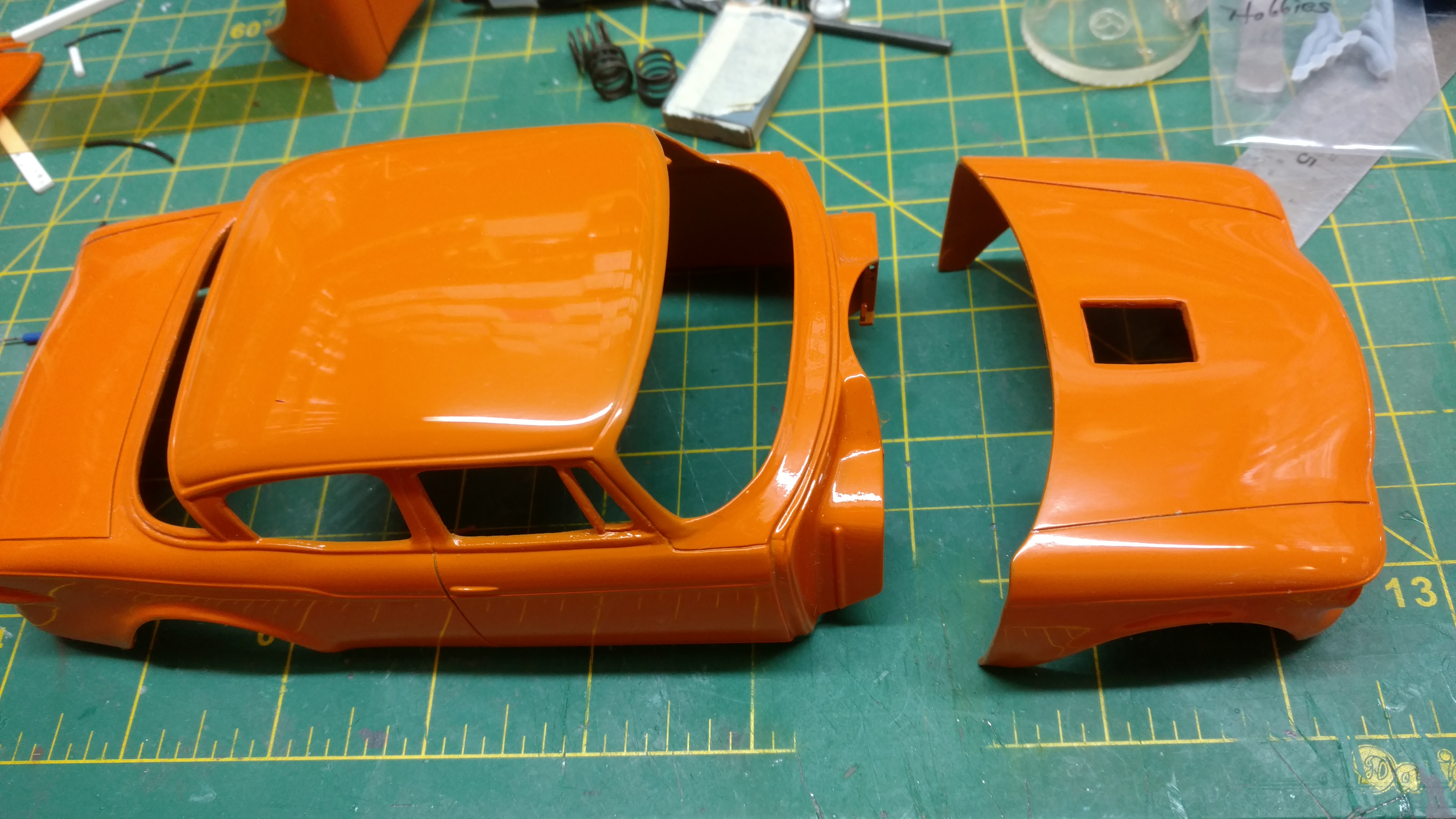

64SS350 Posted April 11, 2021 Author Share Posted April 11, 2021 Finally got some color on the bodies, using base coat/clear coat. Quote Link to comment Share on other sites More sharing options...
64SS350 Posted May 24, 2021 Author Share Posted May 24, 2021 Not a lot to show right now, I cleared the front clip underside, let it sit for a few weeks (while finishing details of our wedding...), and am now wet sanding both bodies. Thanks for watching! Quote Link to comment Share on other sites More sharing options...

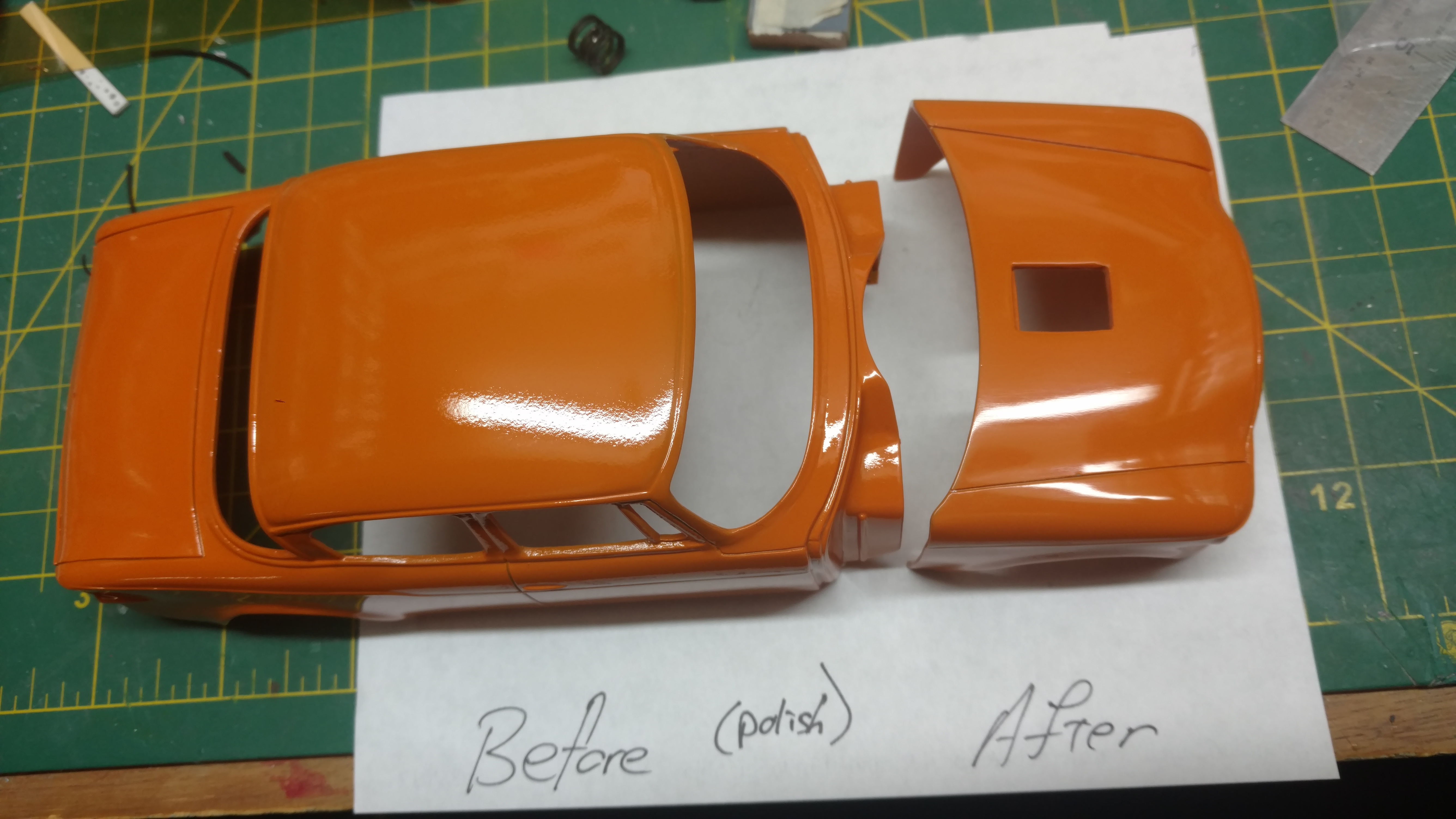

64SS350 Posted June 8, 2021 Author Share Posted June 8, 2021 Some pics of one cleared and polished body. I still see some polishing marks, will have to go over it a bit more. 1 Quote Link to comment Share on other sites More sharing options...

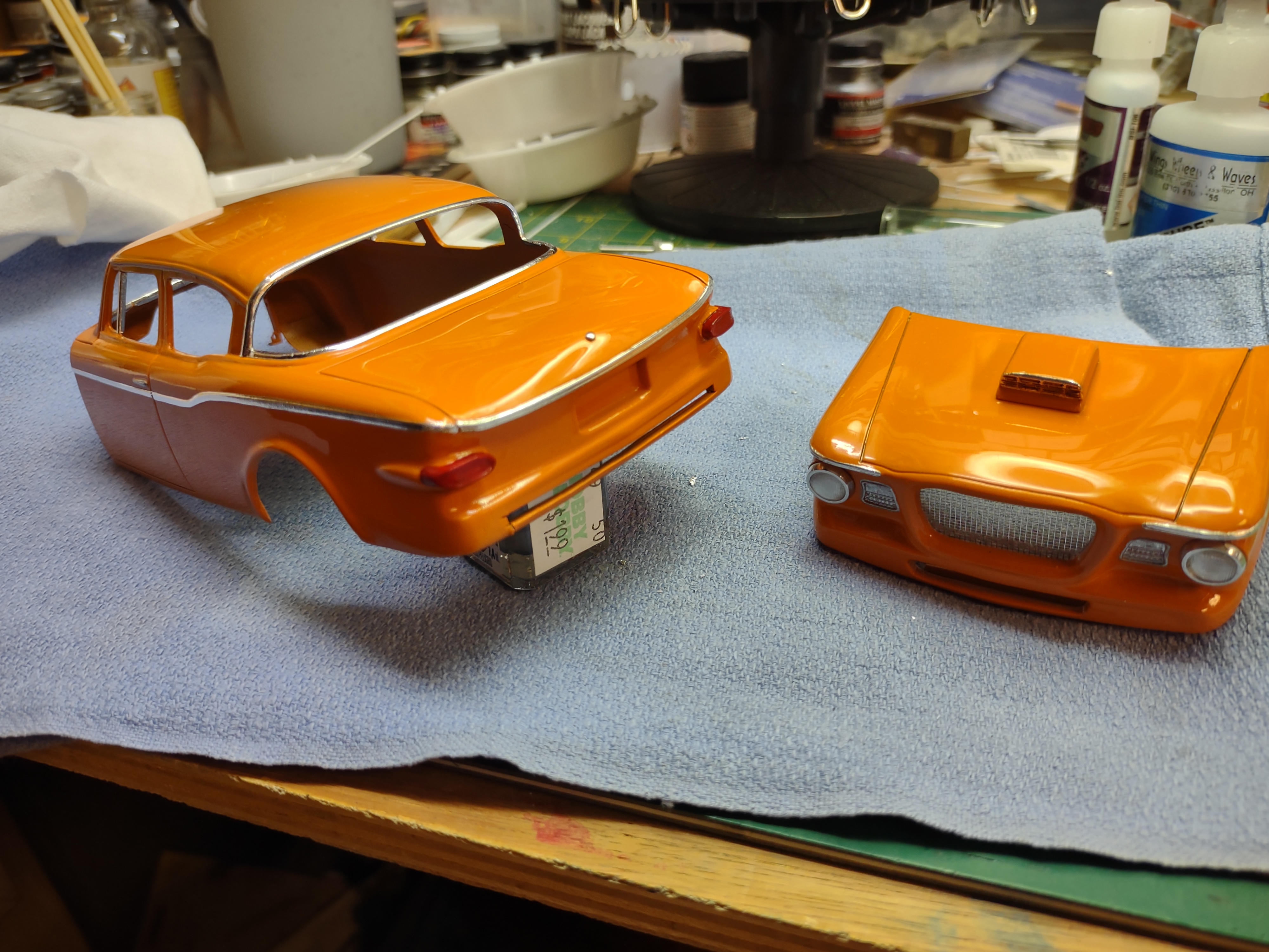

64SS350 Posted June 20, 2021 Author Share Posted June 20, 2021 BMF complete, taillights added Quote Link to comment Share on other sites More sharing options...
