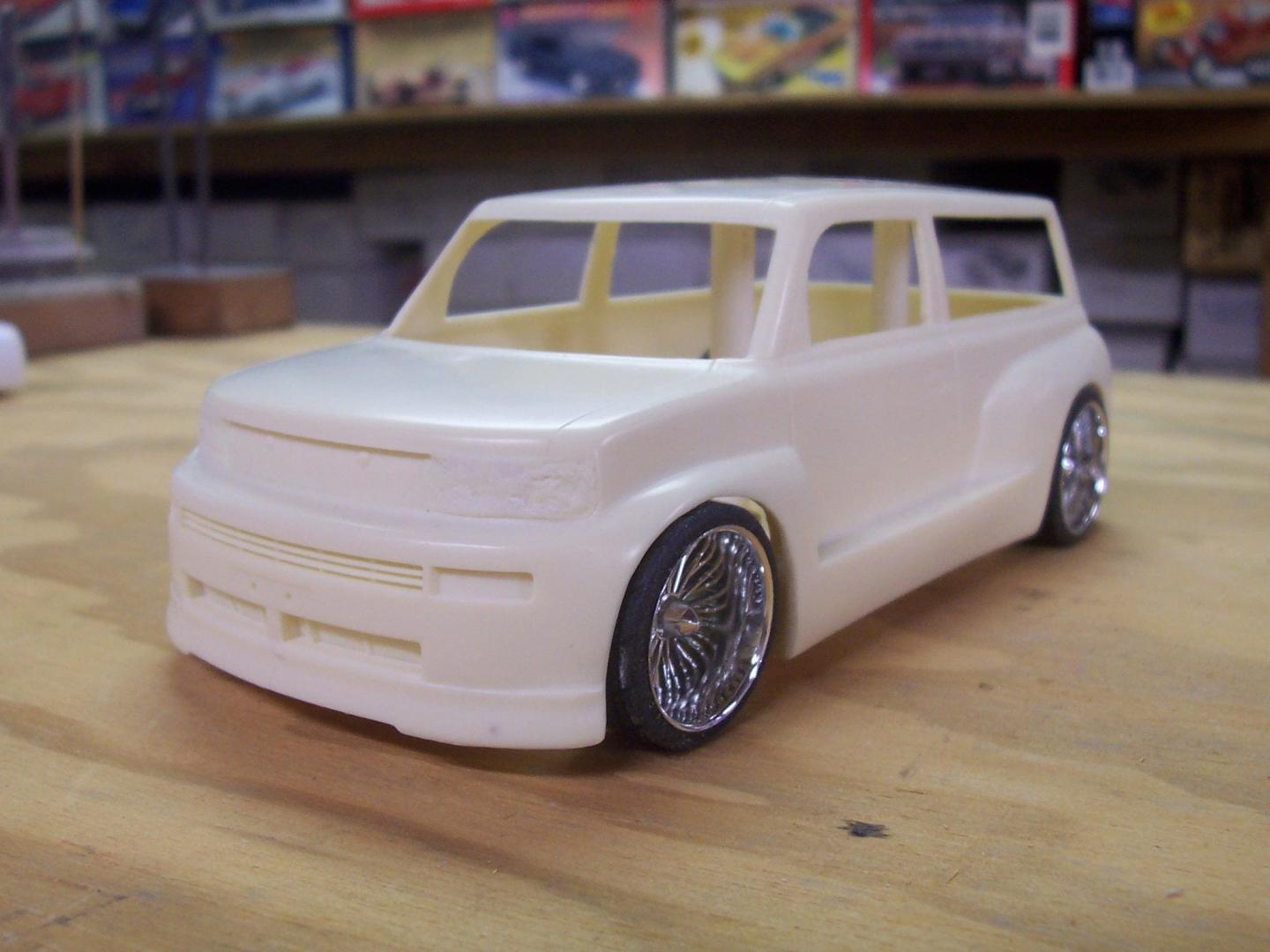

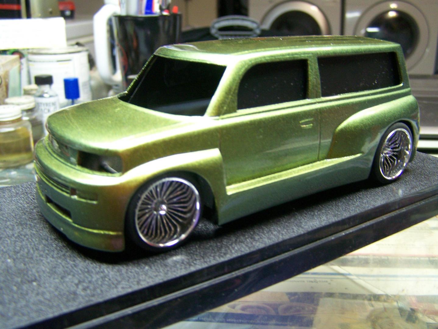

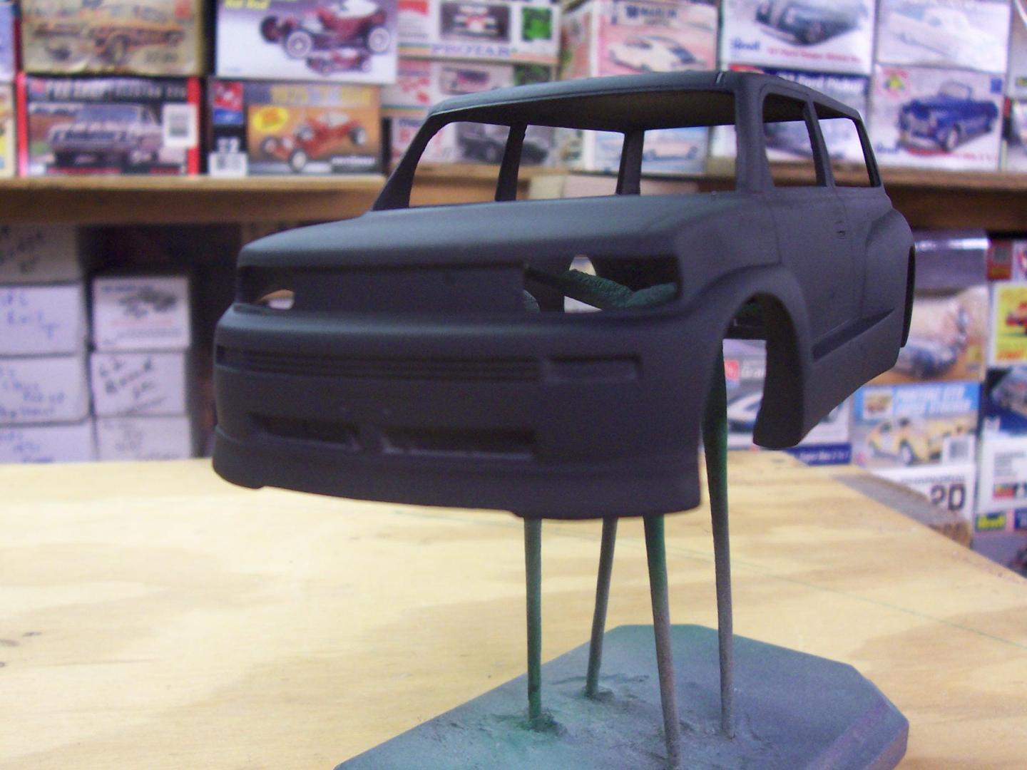

dave branson Posted October 3, 2019 Posted October 3, 2019 Okay here is mine for the next build. This a RMR resin kit I started about 15 years ago time to get it done.

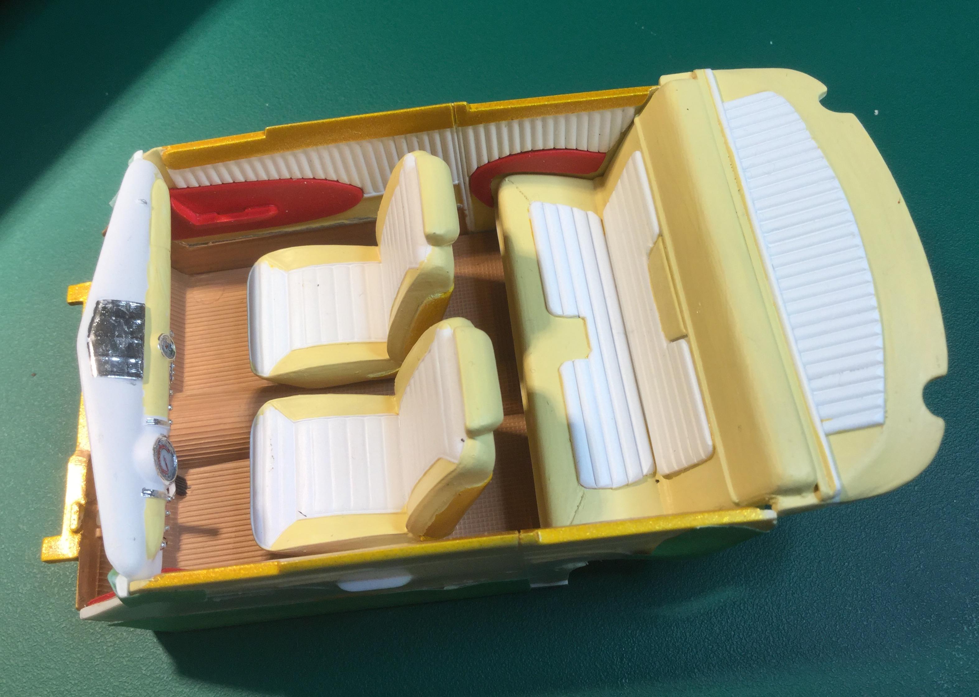

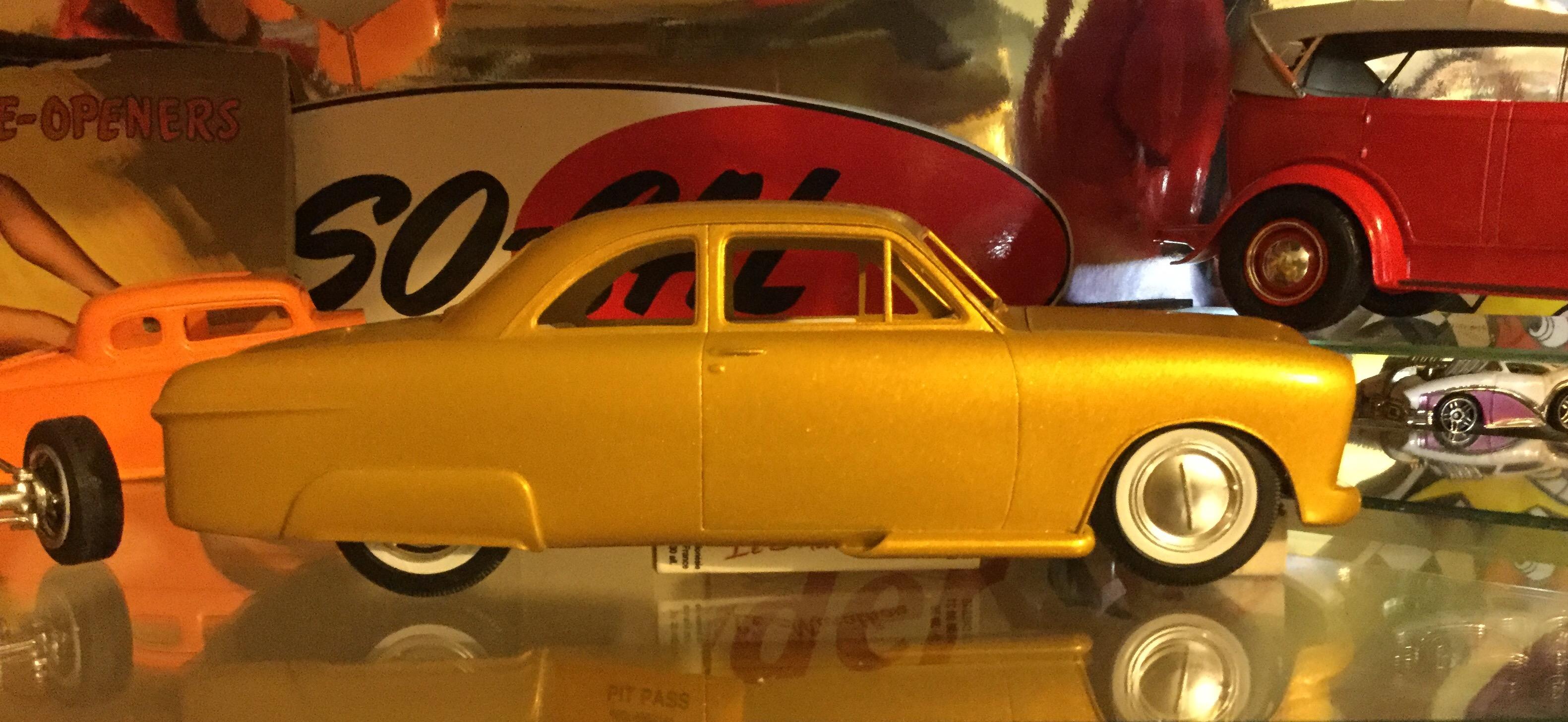

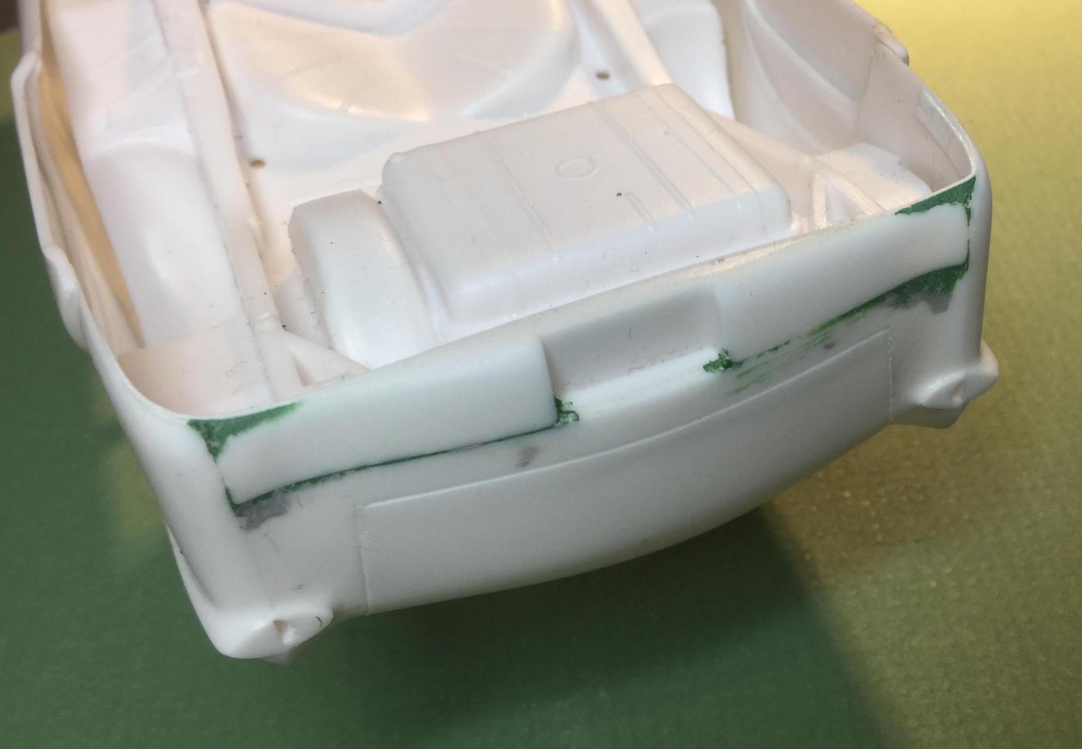

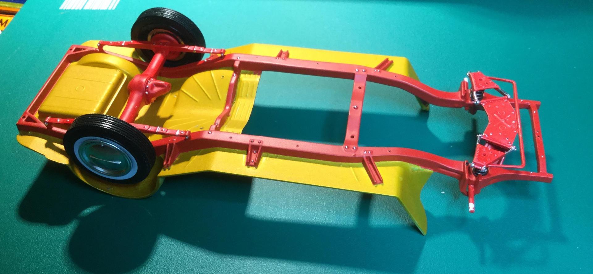

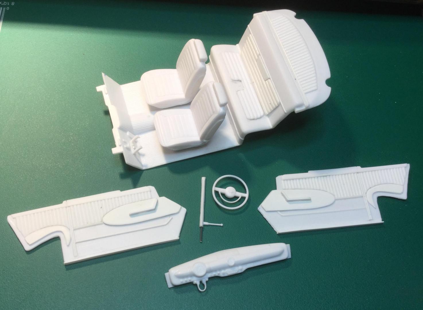

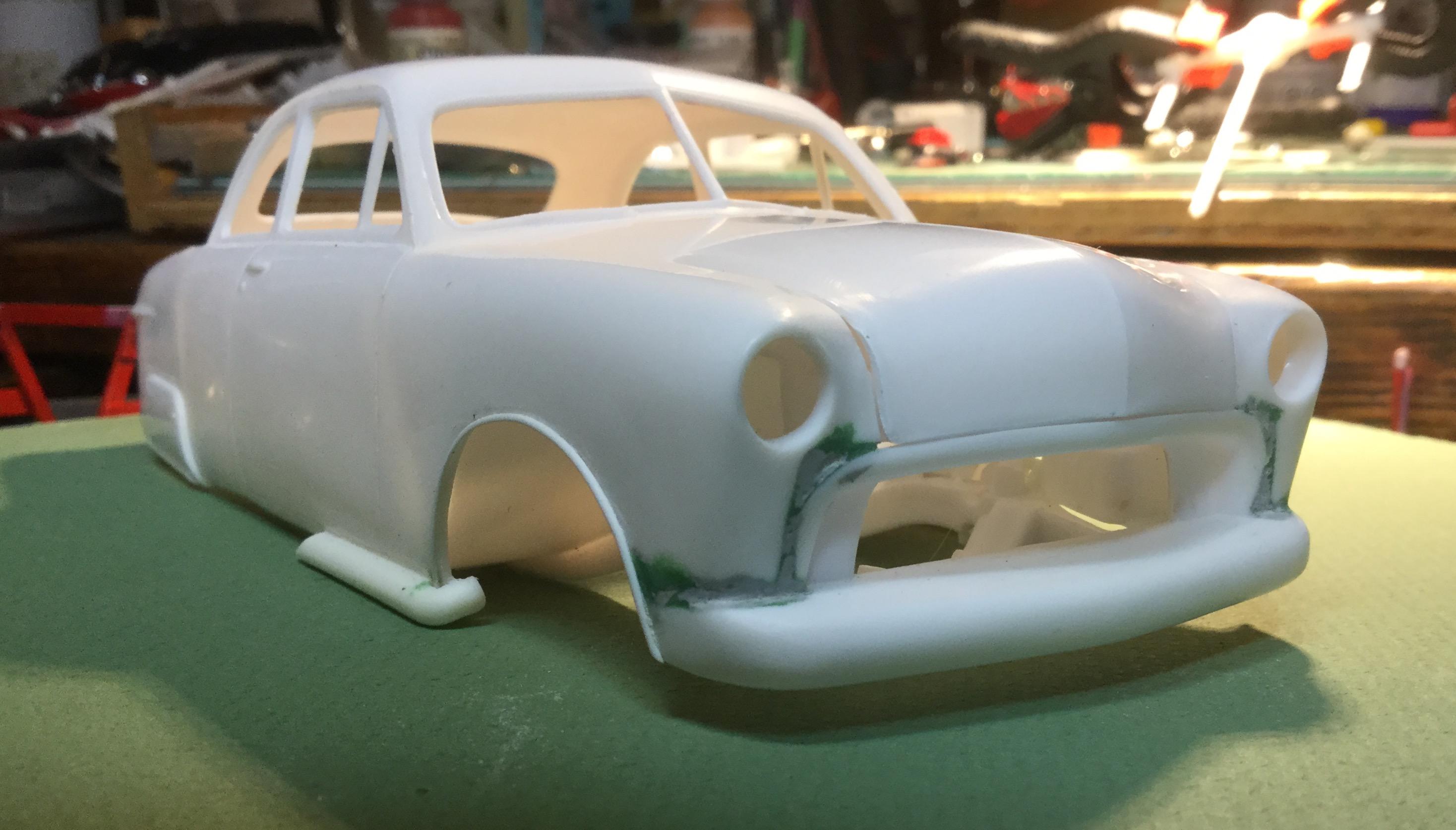

Misha Posted October 3, 2019 Posted October 3, 2019 Here is my entry for the next round, a Shoebox project that dates back to 8 February 2017 using the most recent re-pop of the venerable AMT kit. I found the kit to have quite a bit of flash around the body mold lines which required a fair amount work to clean up. To massage the body I used the custom front and rear belly pan treatments, removed the chrome side trim and added a trim ring around the front fender wheel cutout with skirts on the back. Also added custom fairings for the side lake pipes. The hood required a further finessing to have it fit with added thin strips to the leading edge. The basic interior tub was rebuilt by cutting away the side panels and flipping them side to side to provide a blank canvas upon which to build the custom pleated door panels. The rear seat received a similar treatment as did the rear parcel shelf. Buckets from a 64 Fairlane filled the front portion using the stock dash and steering wheel. Underneath the chassis is featured in red with additional details picked out in a variety of metal finishes. The wheels are from the 40 Ford panel with the bladed Moons. The Y-Block Ford is from the 56 Vicky kit and is in the beginning stages of construction. The body was primed in Tamiya grey followed by the Testor Inca Gold. I particularly like the scale finish to the metalflake. So here she sits... waiting for completion to join the street ranks and cruise! Cheers Misha

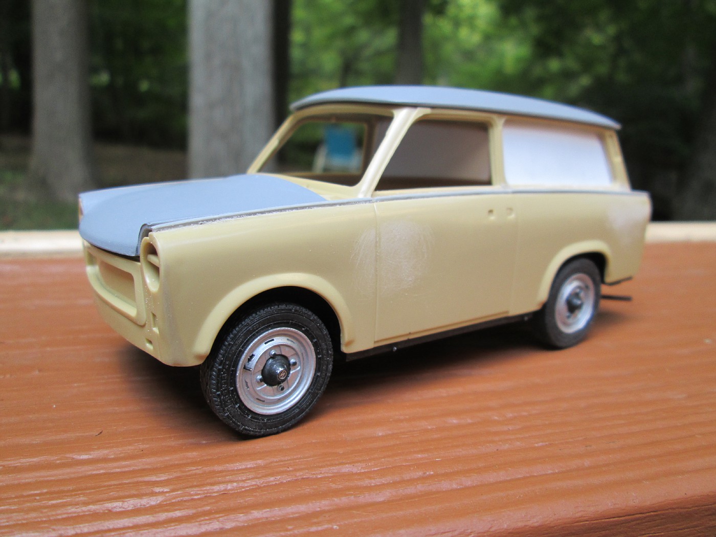

Tom Geiger Posted October 3, 2019 Posted October 3, 2019 (edited) We are off to a great start with some super models! Let's see them all done! Okay, I'll offer up one Trabant 600 Universale Panel Wagon. Last saw light of day in 2014. Geoff Brown got me back looking at it with the completion of his kit. He had messaged me to inquire about it's status... that was enough to pull it off the stagnant model shelf! And it currently looks like this. Primer gray, about 3/4 done. And our goal is one little East German postal van. Edited October 3, 2019 by Tom Geiger

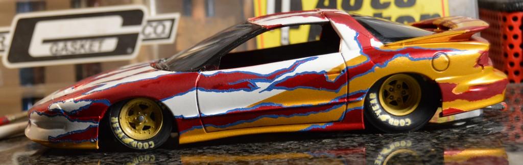

Straightliner59 Posted October 3, 2019 Posted October 3, 2019 (edited) I taped the body off, last night before work, and shot more red, when I got home, this morning. The pattern is a bit more uniform, now. Next, I need to mix the blue One Shot for the stripes. I hope I can achieve the color I want, with what I have on hand. I don't really want to have to spring for a can of Process Blue, but... Once I touch the blue to the body, I am committed--then, it will have to be striped, completely. That might eat up the entire quarter! Edited October 3, 2019 by Straightliner59

Straightliner59 Posted October 4, 2019 Posted October 4, 2019 As a show of good faith (?), I have already painted almost half the stripes! I mixed One Shot Dark Blue and White, to create a mid-toned blue. I am surprised how easily it's gone on. Of course, that's what it's made for. The paint's a bit rough, but, I am sure i can fix it, by the time I am done! I was kind of going for a sort of controlled chaos, to reflect the edges of the torn tape, since those can no longer be seen. It looks more finished, with the outlines, I think. Questions comments and critiques are always welcome!
Snake45 Posted October 4, 2019 Author Posted October 4, 2019 On 10/4/2019 at 8:05 AM, Straightliner59 said: As a show of good faith (?), I have already painted almost half the stripes! I mixed One Shot Dark Blue and White, to create a mid-toned blue. I am surprised how easily it's gone on. Of course, that's what it's made for. The paint's a bit rough, but, I am sure i can fix it, by the time I am done! I was kind of going for a sort of controlled chaos, to reflect the edges of the torn tape, since those can no longer be seen. It looks more finished, with the outlines, I think. Questions comments and critiques are always welcome! Expand Fabulous! You might actually be the FIRST one this round to GITTER DONE! Drive on!
