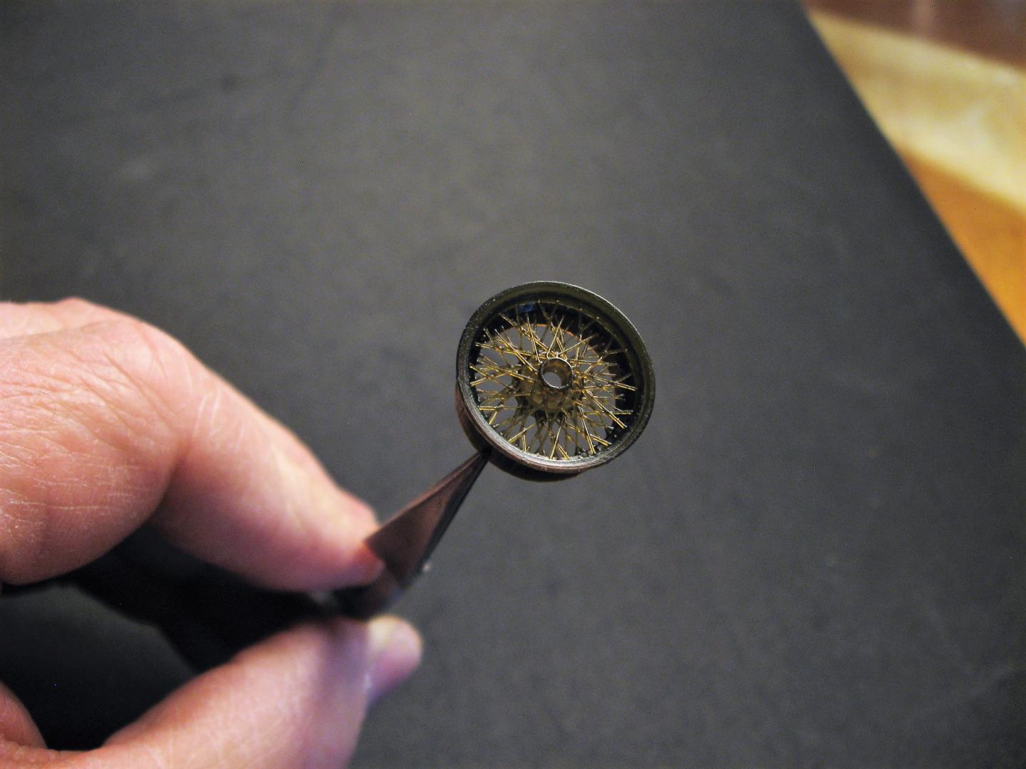

Ace-Garageguy Posted December 14, 2018 Author Posted December 14, 2018 ^^^ On another thread, I mentioned that a vendor I met at the November show here was showing some exquisite 3D-printed prototype wire wheels, and these are them. Now that the cat's entirely out of the bag, all I can say is that they are SO good, they're almost beyond belief. They look far better to me than any PE-center wire wheels, and much better than most of the hand-laced wires as well. The detail is fantastic. Notice that the individual spokes have the appropriate bend at the hub end, and include a tensioning nut at the rim end. And also remember the image you're seeing here (if you're on a PC) is far larger than these are in reality. As soon as these are available, I'll be loading up.

BigTallDad Posted December 19, 2018 Posted December 19, 2018 On 12/13/2018 at 9:49 PM, Ace-Garageguy said: ^^^ On another thread, I mentioned that a vendor I met at the November show here was showing some exquisite 3D-printed prototype wire wheels, and these are them. Now that the cat's entirely out of the bag, all I can say is that they are SO good, they're almost beyond belief. They look far better to me than any PE-center wire wheels, and much better than most of the hand-laced wires as well. The detail is fantastic. Notice that the individual spokes have the appropriate bend at the hub end, and include a tensioning nut at the rim end. And also remember the image you're seeing here (if you're on a PC) is far larger than these are in reality. As soon as these are available, I'll be loading up. Out of curiosity, are those awesome wheels printed in two different colors or have they been painted?

BigTallDad Posted December 19, 2018 Posted December 19, 2018 OK, let me re-phrase my question. Can a 3D printer print more than one color at the same time (such as steel rims and gold spokes, as shown above)?
Ace-Garageguy Posted December 19, 2018 Author Posted December 19, 2018 2 minutes ago, BigTallDad said: OK, let me re-phrase my question. Can a 3D printer print more than one color at the same time (such as steel rims and gold spokes, as shown above)? The answer is...it depends. Some filament printers can indeed print with multiple colors, even with multiple materials. The goo+UV-printed wire wheels shown above? I honestly don't know what the deal is there. The prototypes I saw in person were black. Everything black. With the process shown in the video that accompanies this thread, I don't really see how multiple colors could be achieved (but I'm very far from being anything like an "expert" on this tech).
Randy D Posted December 19, 2018 Posted December 19, 2018 Ray (BigTallDad), Sorry for the late response ! The rim pictured above is raw, just as it comes out of the printer. It was printed with a translucent greenish yellow resin. The thicker parts such as the wheel rim are much darker than the spokes. I believe Bill is correct concerning liquid resin printers but the technology is changing so fast who knows ??? Ray (Flat32) and Doug, thanks to both you guys for the info as actual users of the next step up in printers, great stuff !!! Randy
