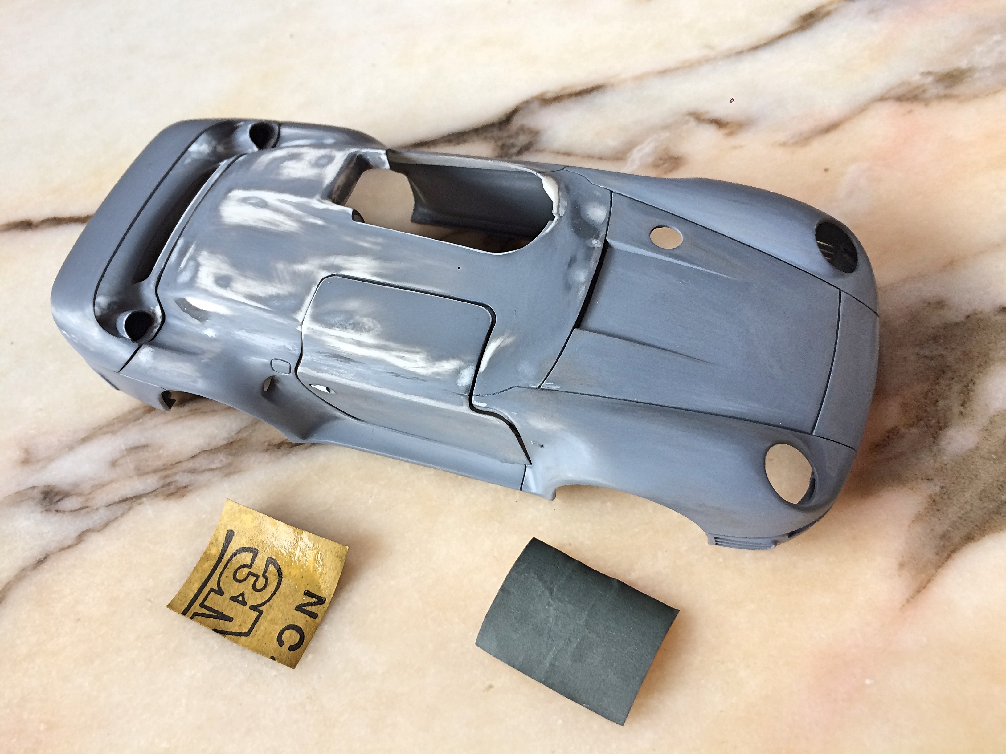

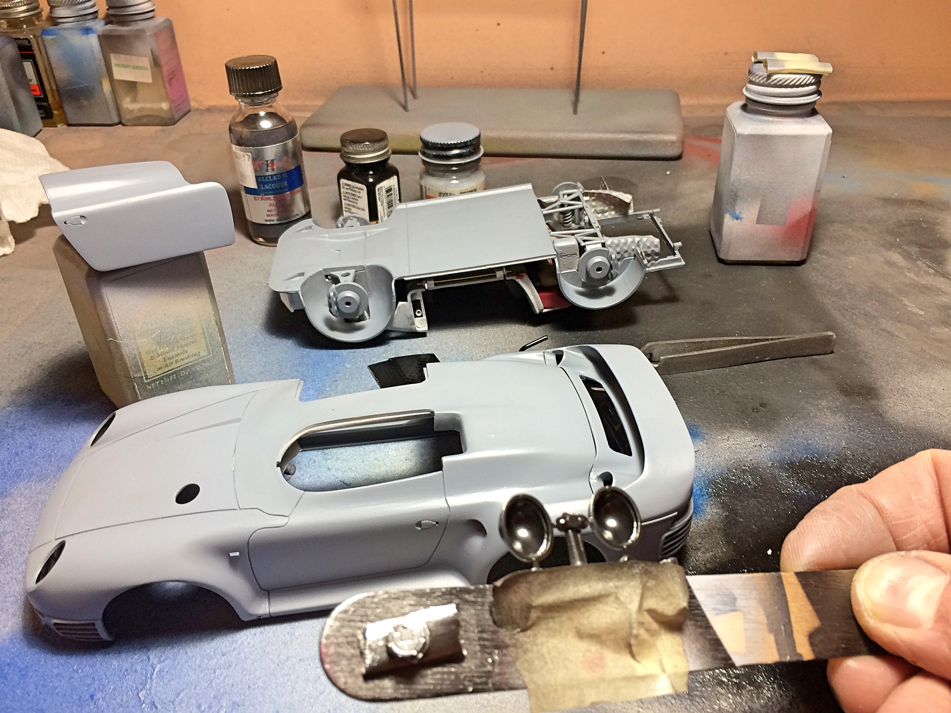

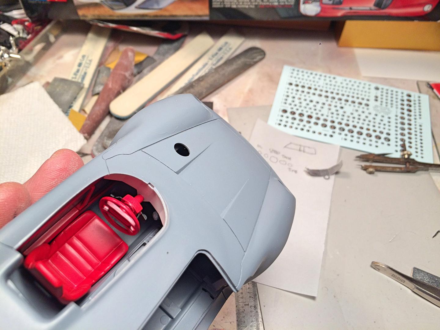

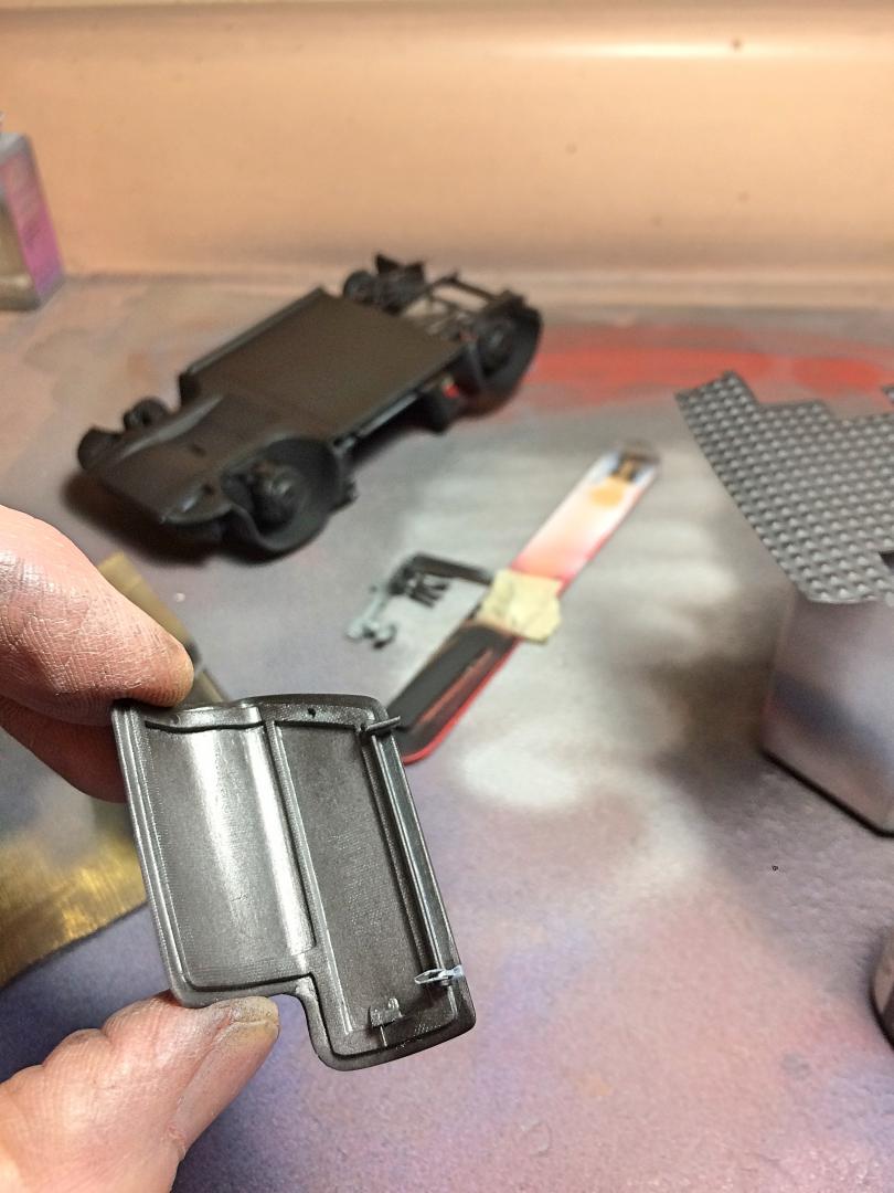

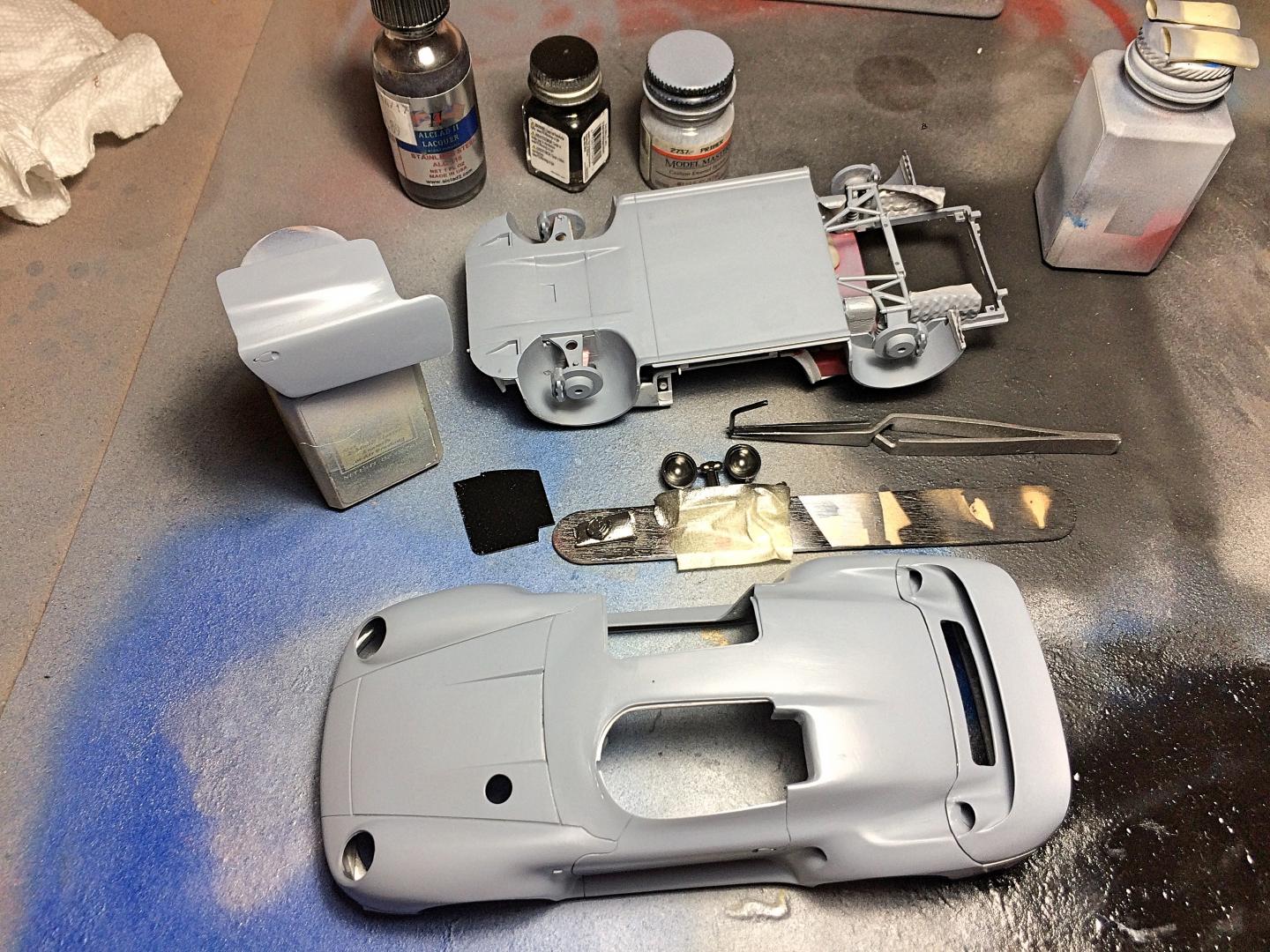

89AKurt Posted December 13, 2018 Author Posted December 13, 2018 Thanks for all the comments! I like different and off-the-wall subjects. Today I airbrushed the first coat of primer, which revealed all the missed spots for sanding and filling. I also made a few more parts, one tiny detail was door latches, because the P-D is using them, so I designed a flush lever. I wanted black headlights (Hella does this), so painted gloss black with a mist of stainless steel Alclad.

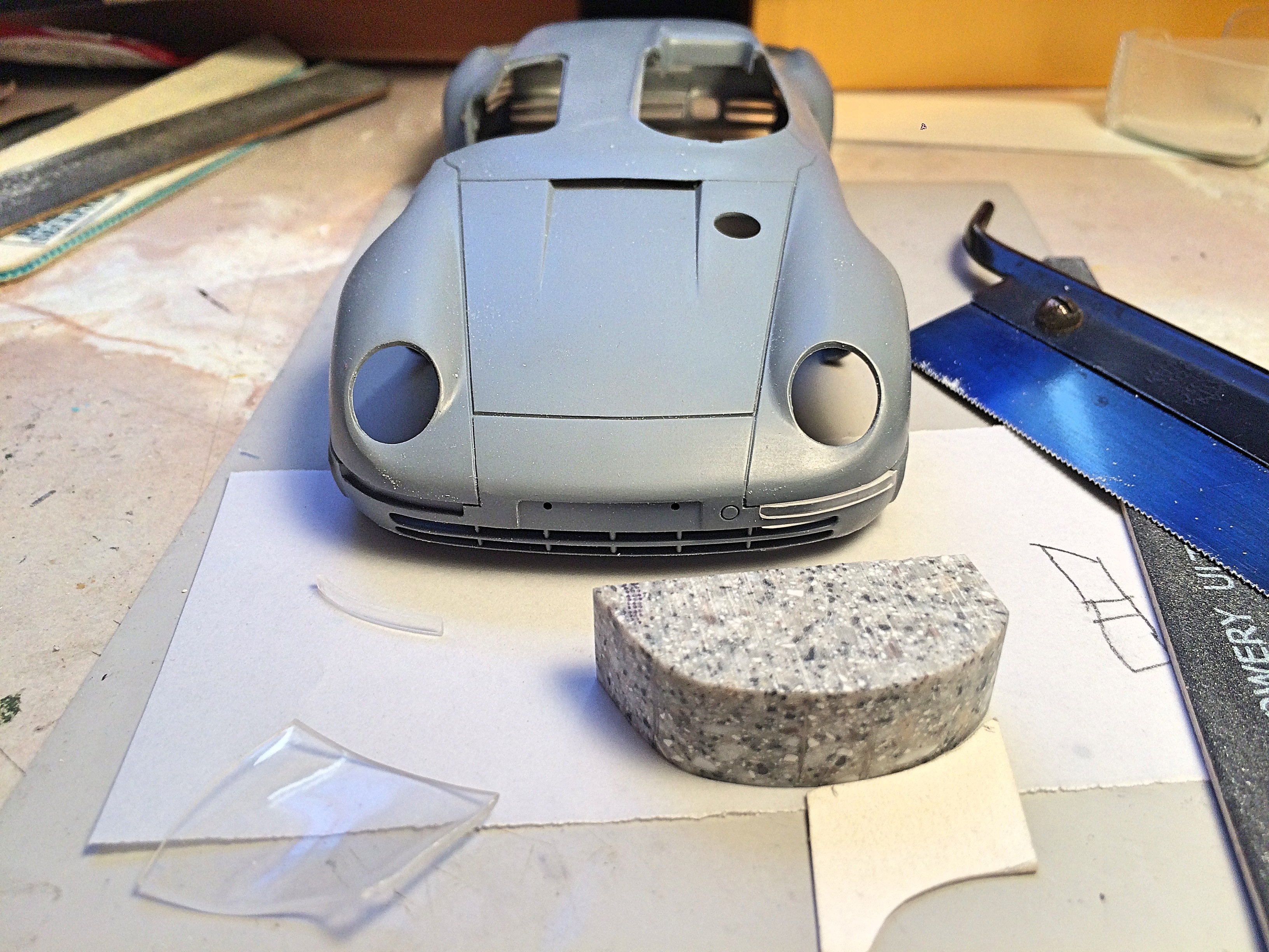

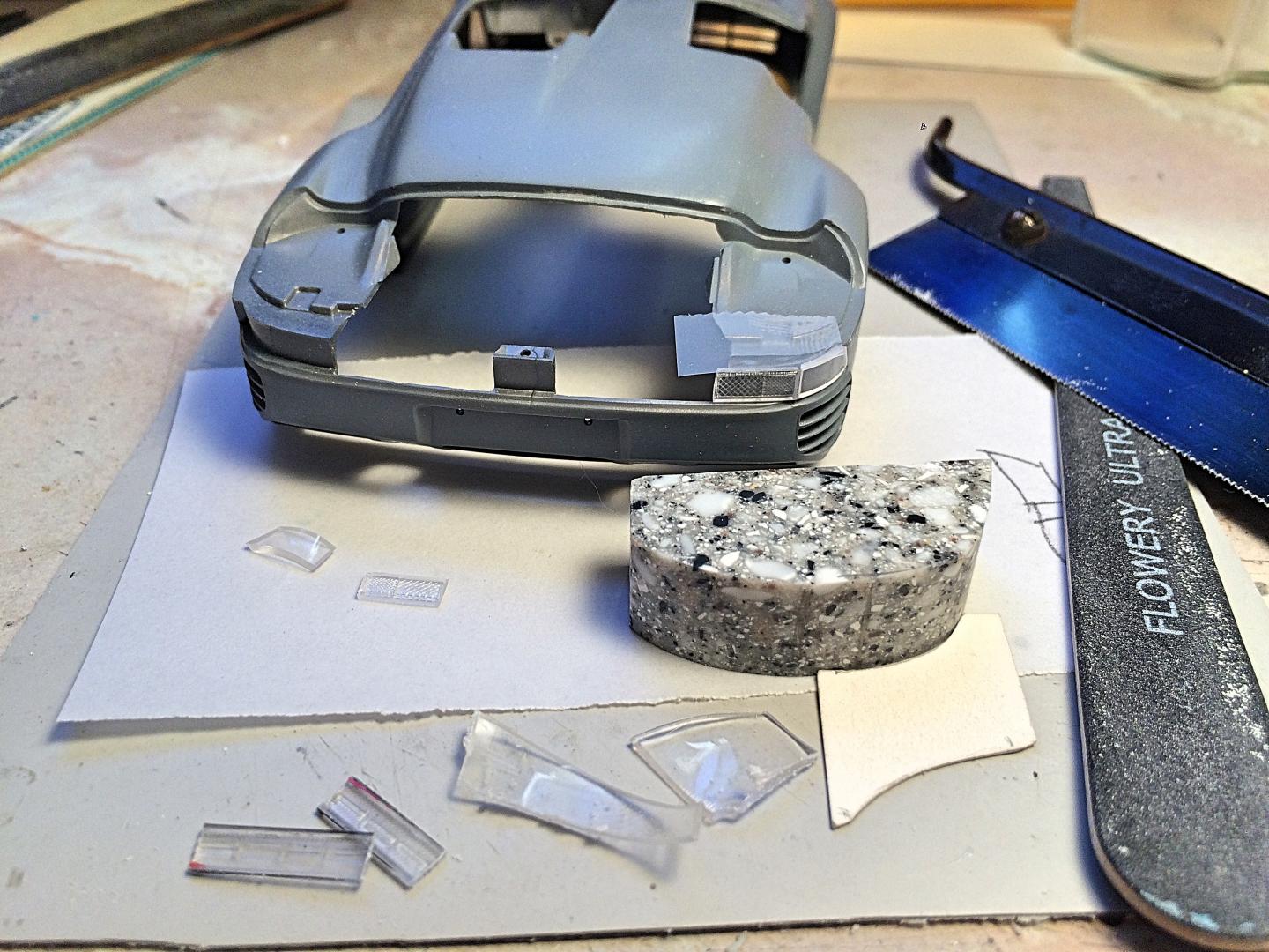

89AKurt Posted December 14, 2018 Author Posted December 14, 2018 Dann: More like Bat**** crazy! Wonder if there is a Gattling gun this scale, enough space for ammo. Today I realized the front turn signals and taillights go to the other model (duh!), so fabricated new lenses. Parts box windows, Corian scrap meets disk sander using a cardboard profile, heated "window" over the cooktop electric burner while holding with needle nosed pliers, when the piece started to sag I quickly set on the pattern and lightly pressed down hoping fingerprints wouldn't become a feature. The result was really sloppy, but like picking the best part of a chunk of wood, or perhaps evaluating as a diamond cutter would (that's really a stretch here ha ha), I sawed out the basic size, and then sanded to final shape. Planning to lightly spray the inside black, then the red or orange. Good thing the lenses are basically flat with a simple curve, cars nowadays have such crazy designs this wouldn't work.

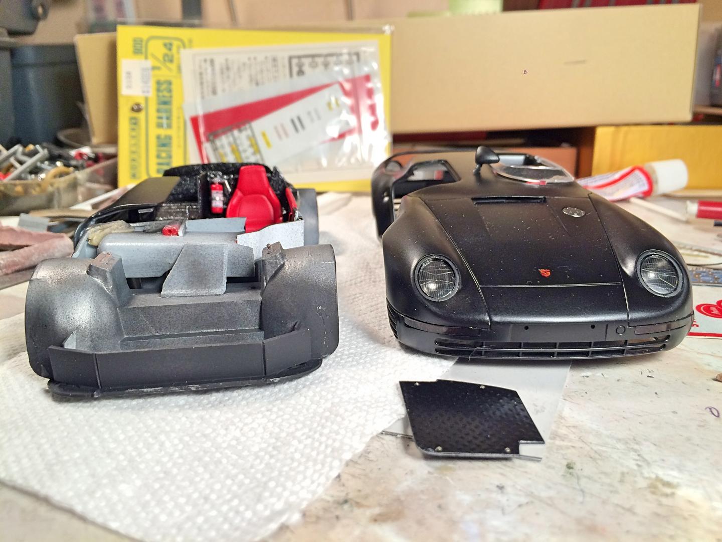

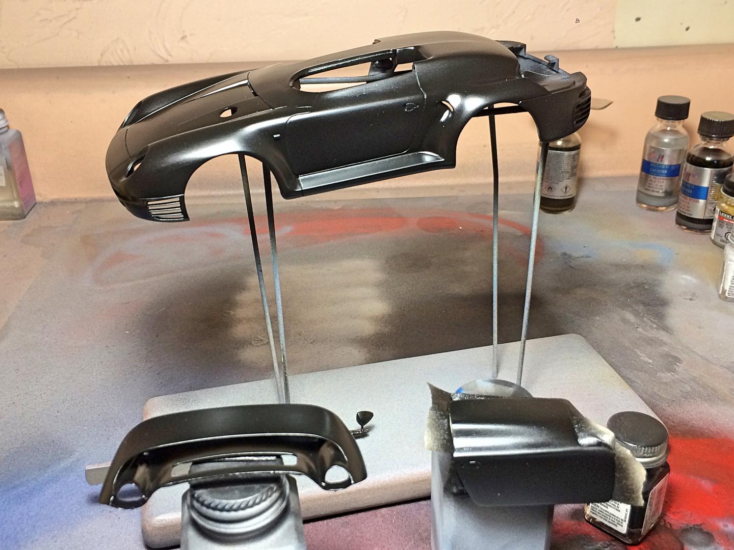

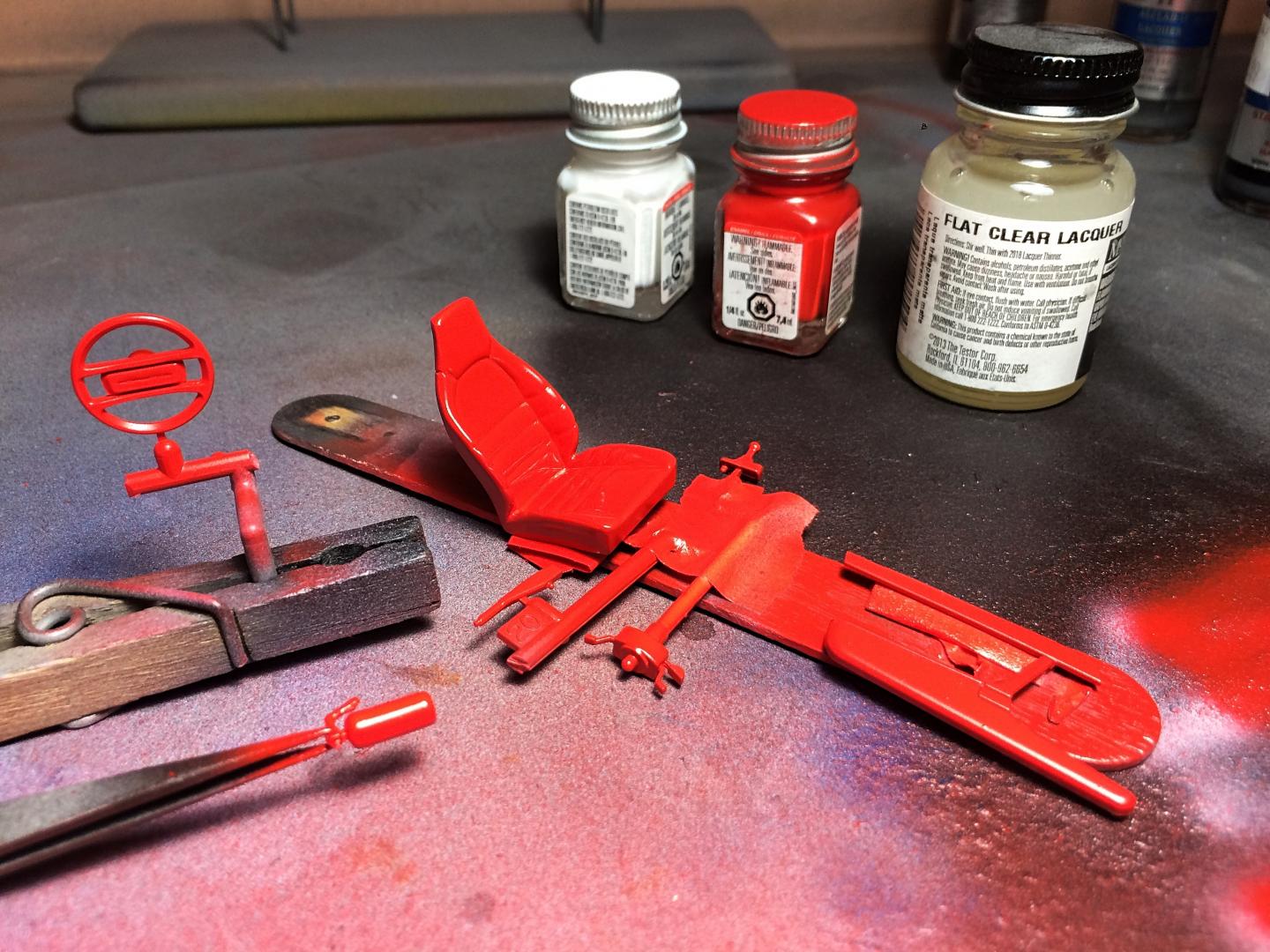

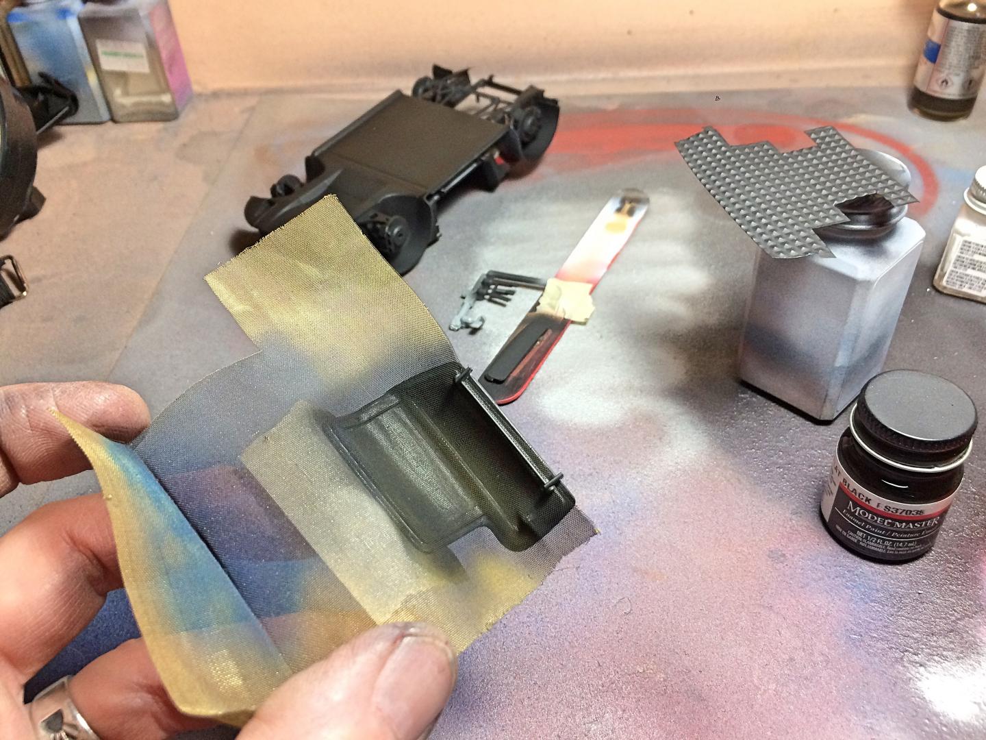

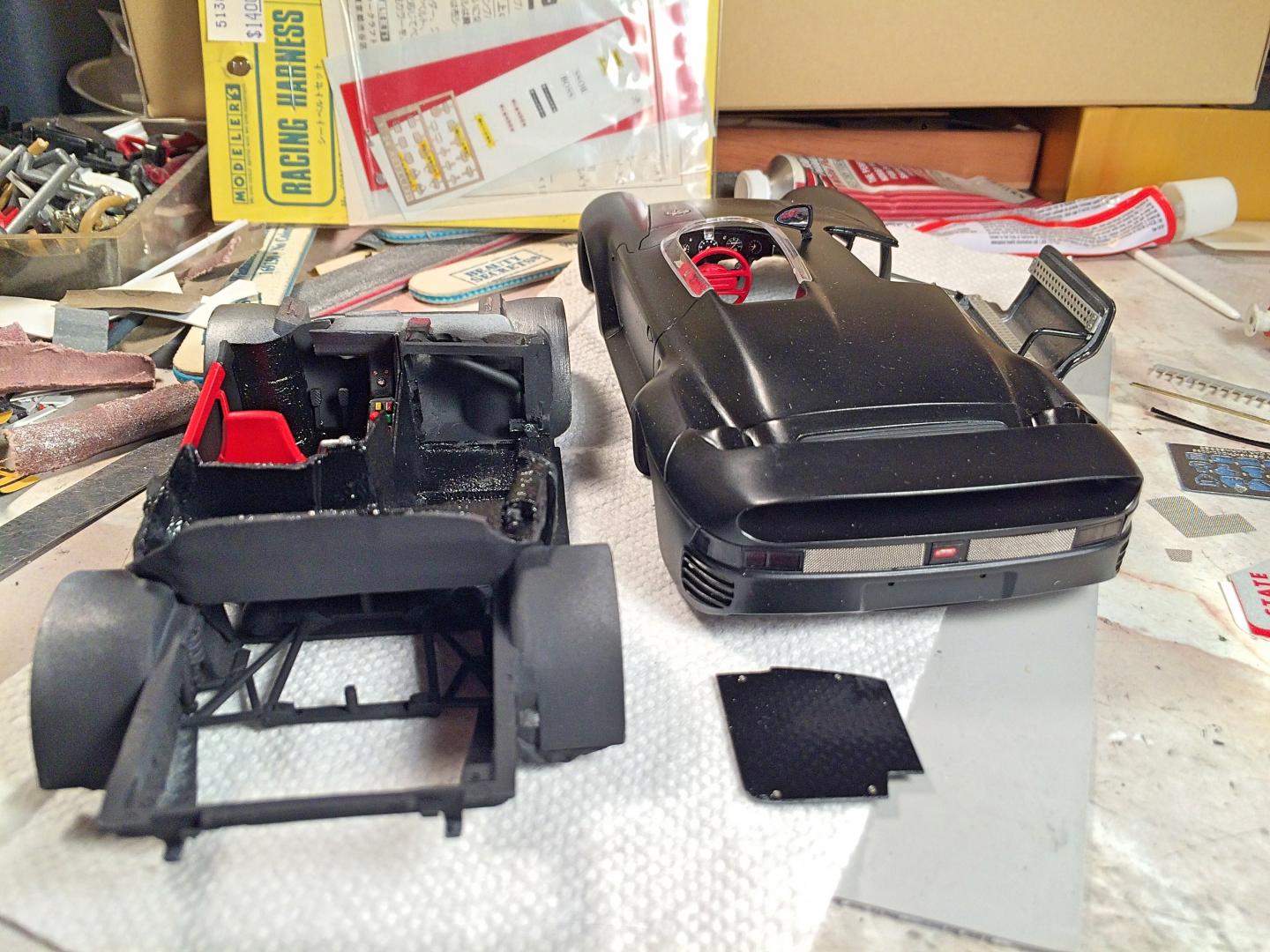

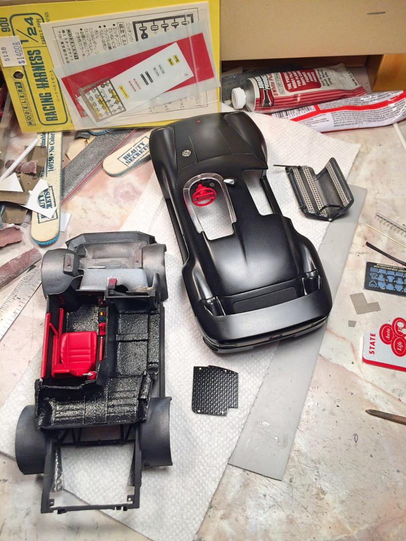

89AKurt Posted December 16, 2018 Author Posted December 16, 2018 The exciting stage, PAINTING! I decided the interior parts needed to be red, since I found a fire extinguisher in the parts box. I also didn't like the aluminum dash, so made a new one from plastic sheet. Have instrument decals picked out. Getting the body right has been a pain, wet sanded the primer and sprayed another coat. Experimented with creating a carbon-fiber finish on the inside of the door. Sprayed flat aluminum, then pressed down brass screen and sprayed flat black. I'm thinking about the Lamborghini Setso Elemento, which is 100% c-f. For this application, it's adequate, might spray gloss clear over it. Sprayed the body semi-gloss black. Can never avoid lint, so now I'm wondering how to fix that since polishing is out of the question. Just need to cut the interior glass panel, do seat belts (race car set for the seat, a belt to supplement the door for support), and do Rhino Liner in the interior to hopefully hide the lousy putty work. I might get this one done!
Dann Tier Posted December 16, 2018 Posted December 16, 2018 (edited) This is so brilliant, bud!!!....I've seen ALOT of custom models, but VERY few look good enough to have actually been a car...….yours IS totally realistic!!! For keeping bits out of your paint, try using canned air between every coat like I do....I VERY rarely get anything stuck to my finishes. Edited December 16, 2018 by Dann Tier
tkzwolf Posted December 17, 2018 Posted December 17, 2018 This is really cool and original. I really like the way the door lowers.
89AKurt Posted December 17, 2018 Author Posted December 17, 2018 On 12/15/2018 at 7:27 PM, Dann Tier said: This is so brilliant, bud!!!....I've seen ALOT of custom models, but VERY few look good enough to have actually been a car...….yours IS totally realistic!!! For keeping bits out of your paint, try using canned air between every coat like I do....I VERY rarely get anything stuck to my finishes. Thank you! I'm all into realistic, off the wall, but I'm obsessed to a point, been telling the little guy to stuff it, I want to finish this instead of redo. I should deep clean my paint booth when I get to doing a show standard quality. Even when I do, the static charge from sanding the plastic acts like a magnet. I should try airbrushing in the .... [public forum shut up before getting into trouble]. 2 hours ago, tkzwolf said: This is really cool and original. I really like the way the door lowers. Others and you, thanks! But notice I didn't open the drivers door. I'm anxious about final assembly with paint.

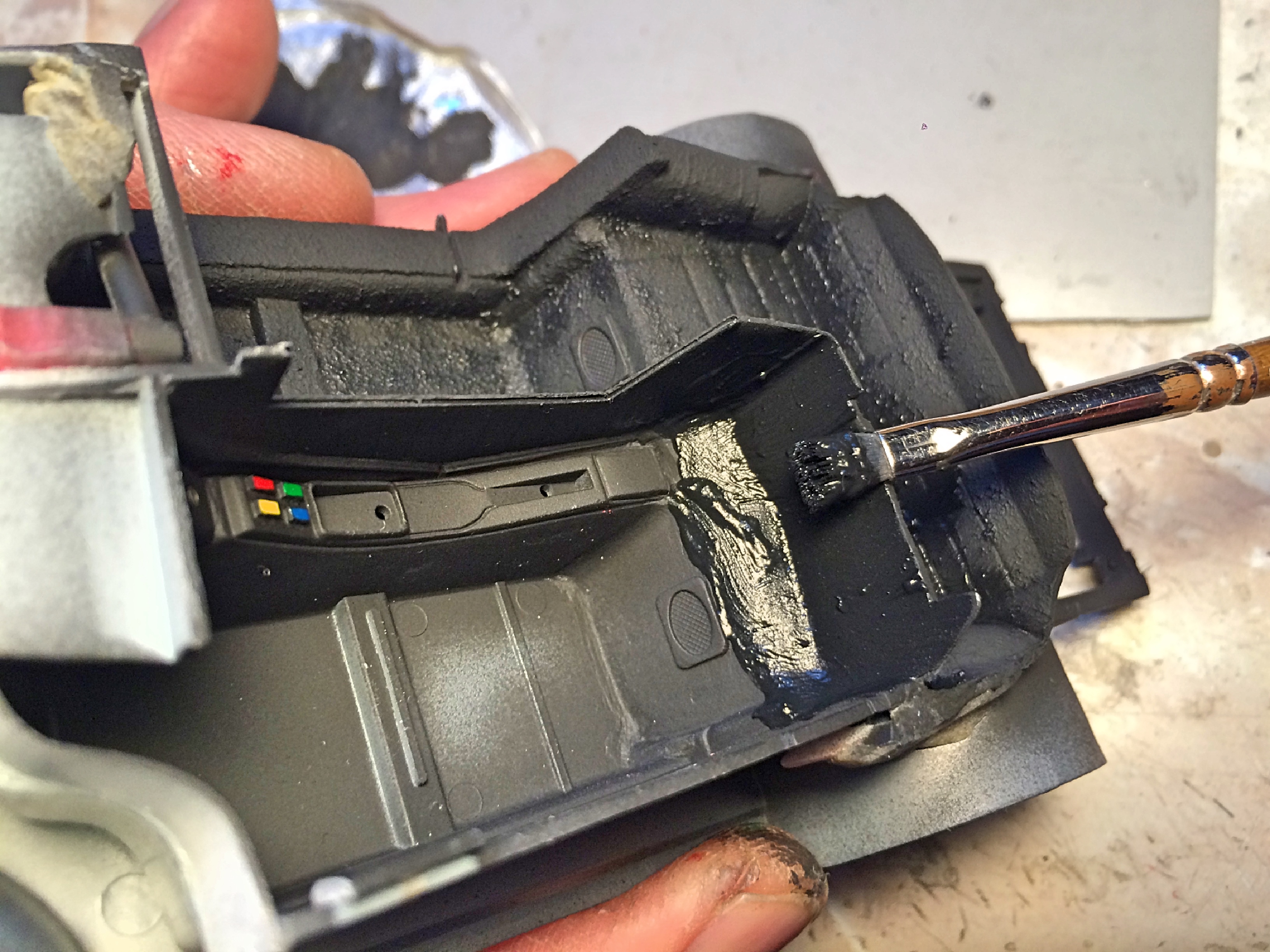

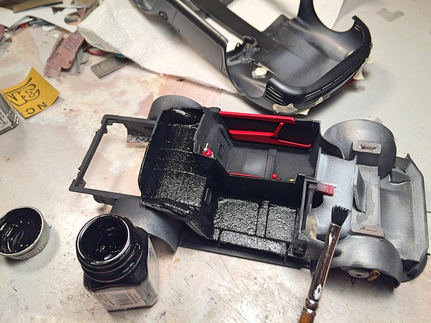

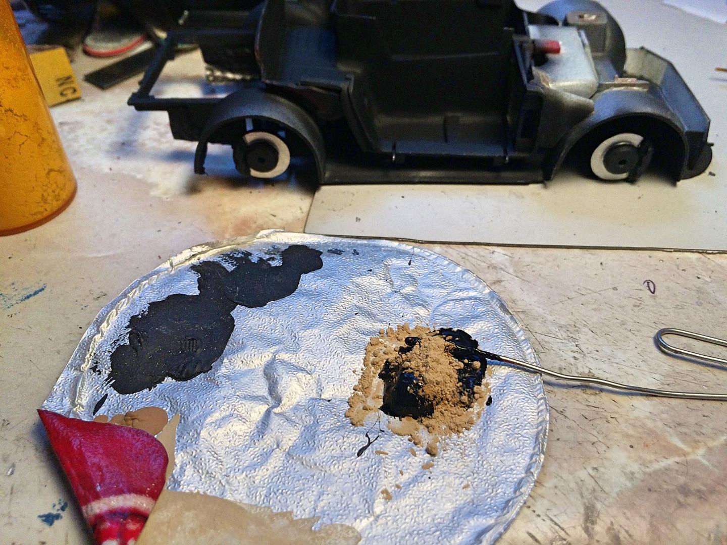

89AKurt Posted December 17, 2018 Author Posted December 17, 2018 Today I got into the obsessed and possessed mode, but had to go see Christmas Carol the musical at the college, it was so good I wasn't thinking about all the things I needed to do. LOL I tried something new, wanted to do a 'Rhino Liner' finish in the interior, to hide the rough putty in the corners (imagine sanding the inside corners of a box). I could have done carpet, but this is a working vehicle. Since I have almost 10 pounds of 'Polyblend' non-sanded grout left over from doing tile, mixed with 'Ceramcoat' acrylic paint, about half/half, gooped it on and stippled with a short brush, adding to the rougher areas until I was happy. For once, I enjoyed brush painting. I had to paint over with gloss black, with the same technique. I would say this was the reason I stopped working on this project, glad to get over this hurdle! I had some detail painting to do, normal stuff. Fabricated the fire extinguisher mount, simply cut an aluminum strip, bent at a point to mimic a buckle, used an aftermarket decal. I also have nice aftermarket instrument decals, so those are in, with an air duct screen, various switches and lights made with photo-etch screws. Finished the door detail, after spraying clear inside. Added the grab bar, and mounting plates and p-e bolt heads. The mirror has a film salvaged from an LCD camera display, it's really thin plastic with much more realistic mirror than foil or chrome-plated parts can do. I had fine stainless steel mesh left over from a Fujimi kit, so the hood ducts and rear openings are done. The lights are done, I'm happy with the black headlights (I got Hella black headlights for my Jetta which was the inspiration), but too dark for the other lights. Last details to be done are the seat belt for the seat, and one to support the door. Then license plates. Then I can put it together for the last time, which means...... THE HINGE.

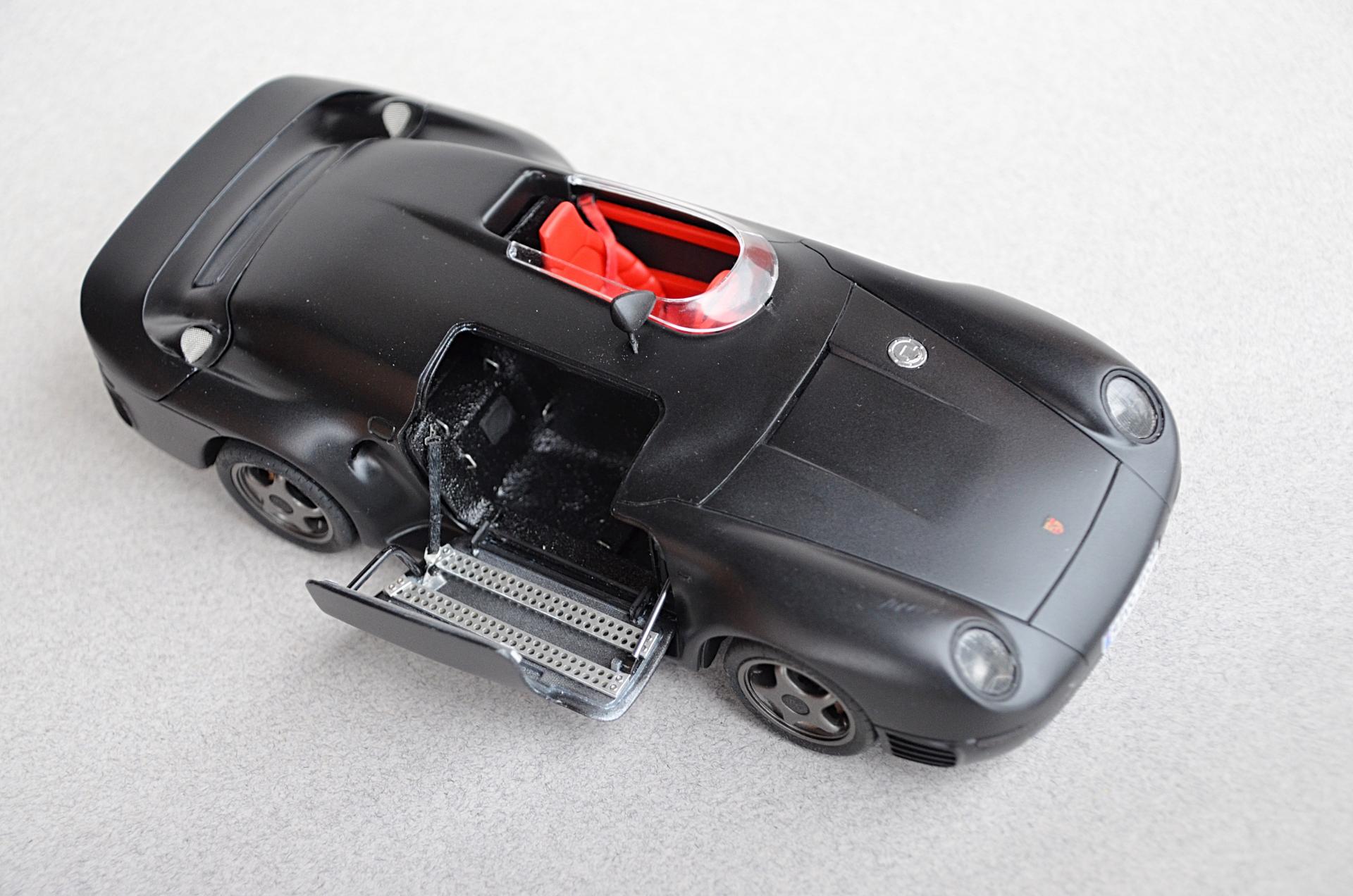

89AKurt Posted December 18, 2018 Author Posted December 18, 2018 I've seen some good applications of it, and it's not really off subject. I might start a topic just about it! 99% DONE!
mitchy Posted March 3, 2019 Posted March 3, 2019 Fascinating. I am a professional movie camera Grip, the guy who fixes the camera to where it needs to be fixed. Quite often to moving motor vehicles.... I can’t imagine nowadays the camera operator would willingly ‘hang out’ of such a track racer. It is a very interesting project, but now you need a realistically harnessed-in operator with a big Panavision or Arri camera for that close-up high speed racing action! Good colour choice too - camera tracking vehicles are almost always finished in matt black to prevent unwanted reflections. Great stuff, thank you
