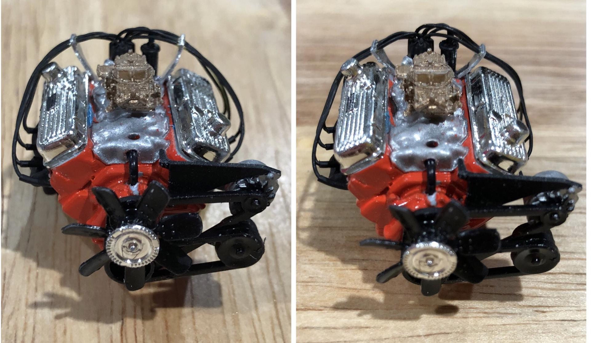

Snake45 Posted January 20, 2019 Posted January 20, 2019 3 hours ago, MrObsessive said: Just a mock up of the carb on the manifold for the time being. I made a couple brackets for the spring and throttle. Magnificent carb & detail work! But frankly I couldn't live with that gap between the intake manifold and heads. I don't build many engines anymore, but when I do, this is one of the few things I pay attention to--a solid connection between the heads, block, and intake. I'll spend considerable time getting these mated up, even if it involves making "gaskets."

MrObsessive Posted January 21, 2019 Author Posted January 21, 2019 @Snake45 Yeah, nothing's permanently 'set' at this point. One sticking point for me in regards to the heads and manifold is the color. Some pics I've seen show the heads are aluminum. Others show they're painted the engine block color. Was this an option for the L/88? Was this year specific? (1967 vs. '68?) Race heads? Anyone? @Superbird McMonte That engine is looking great! I hadn't paid attention to the wire looms and looking at the ones I have, mine could stand to be not so 'flat'. More work to do on this one. Gotta make the exhaust manifolds not quite so 'empty' looking, although the emptiness is on the inside, this should be no big deal. Also, getting the alternator pulley to line up with the other pulleys is going to be a bit of a challenge due to my scratchbuilt bracket. The trick is to get them to line up in some fashion by tacking them in place, then once I'm OK with that, permanently epoxying it to the heads with tiny brass rivets/bolts.
Snake45 Posted January 21, 2019 Posted January 21, 2019 L88 heads were aluminum. Just did a quick google-image search and most of them seem to be unpainted aluminum but I also found several pics of them painted Chevy Engine Red. I'd say you could go either way, your call, unless you're attempting to replicate some particular car (they were rare enough that this is possible). But many more L88s were swapped into cars than ever left the factory in new Corvettes, I believe, so modeling a "swap" is entirely feasible.
Superbird McMonte Posted January 21, 2019 Posted January 21, 2019 (edited) 42 minutes ago, MrObsessive said: @Snake45 Yeah, nothing's permanently 'set' at this point. One sticking point for me in regards to the heads and manifold is the color. Some pics I've seen show the heads are aluminum. Others show they're painted the engine block color. Was this an option for the L/88? Was this year specific? (1967 vs. '68?) Race heads? Anyone? I found some were painted and some weren’t. It seems like Motion painted most of theirs. At least that’s what I see on unrestored cars. If you want people to quickly identify it as an L88, paint them aluminum. Edited January 21, 2019 by Superbird McMonte
Tommy124 Posted January 21, 2019 Posted January 21, 2019 Hi Bill, I will be following along and enjoying this Corvette resto like the one you did before. Your work on the engine looks terrific to me!
JJ Deuce Posted January 21, 2019 Posted January 21, 2019 just did a quick image search of the inventory at Pro-Team Corvettes. several L88s restored by Nabors Bros. and others have unpainted heads. These guys don't get much wrong in a restoration, and I'd be really surprised if they missed on something that visible.
ismaelg Posted January 21, 2019 Posted January 21, 2019 Bill, My understanding is that L88s were unpainted as they were intended for racing. Paint doesn't make it any faster. However, it was very common for customers to have aluminum heads (both factory and aftermarket) painted to disguise them as regular heads. My suggestion, paint them aluminum to show their true nature. If painted it will look like a regular head. Thanks,
MrObsessive Posted January 21, 2019 Author Posted January 21, 2019 Thanks for the info guys! I did go ahead and paint the heads Alclad Dull Aluminum. No pics right now as it's soon bedtime for me and I won't be setting foot downstairs again till this evening to get ready for work. Yes, they do look more distinctive painted this way, so I'm glad I went through the extra trouble.
Snake45 Posted January 21, 2019 Posted January 21, 2019 I suspect that some street racers painted their bare L88 heads to disguise the fact that that's what they were.

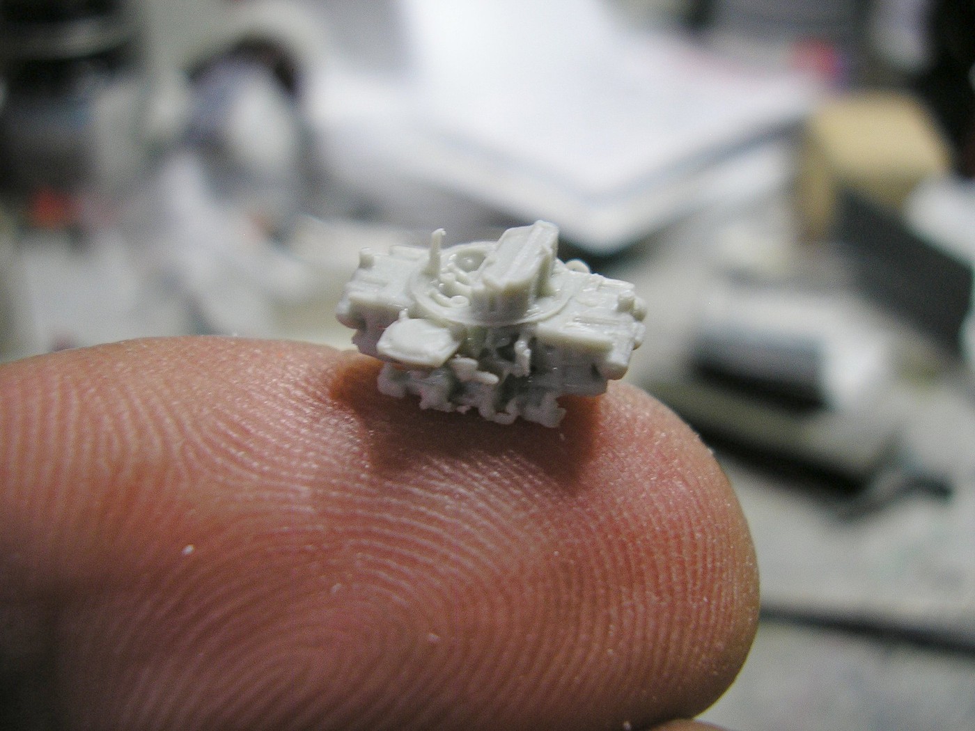

MrObsessive Posted January 24, 2019 Author Posted January 24, 2019 Just now, bisc63 said: That carb is INSANE! Oh Yeah! Joseph is the BEST in the biz! It doesn't get any better than this! You can almost smell that Sunoco 260!

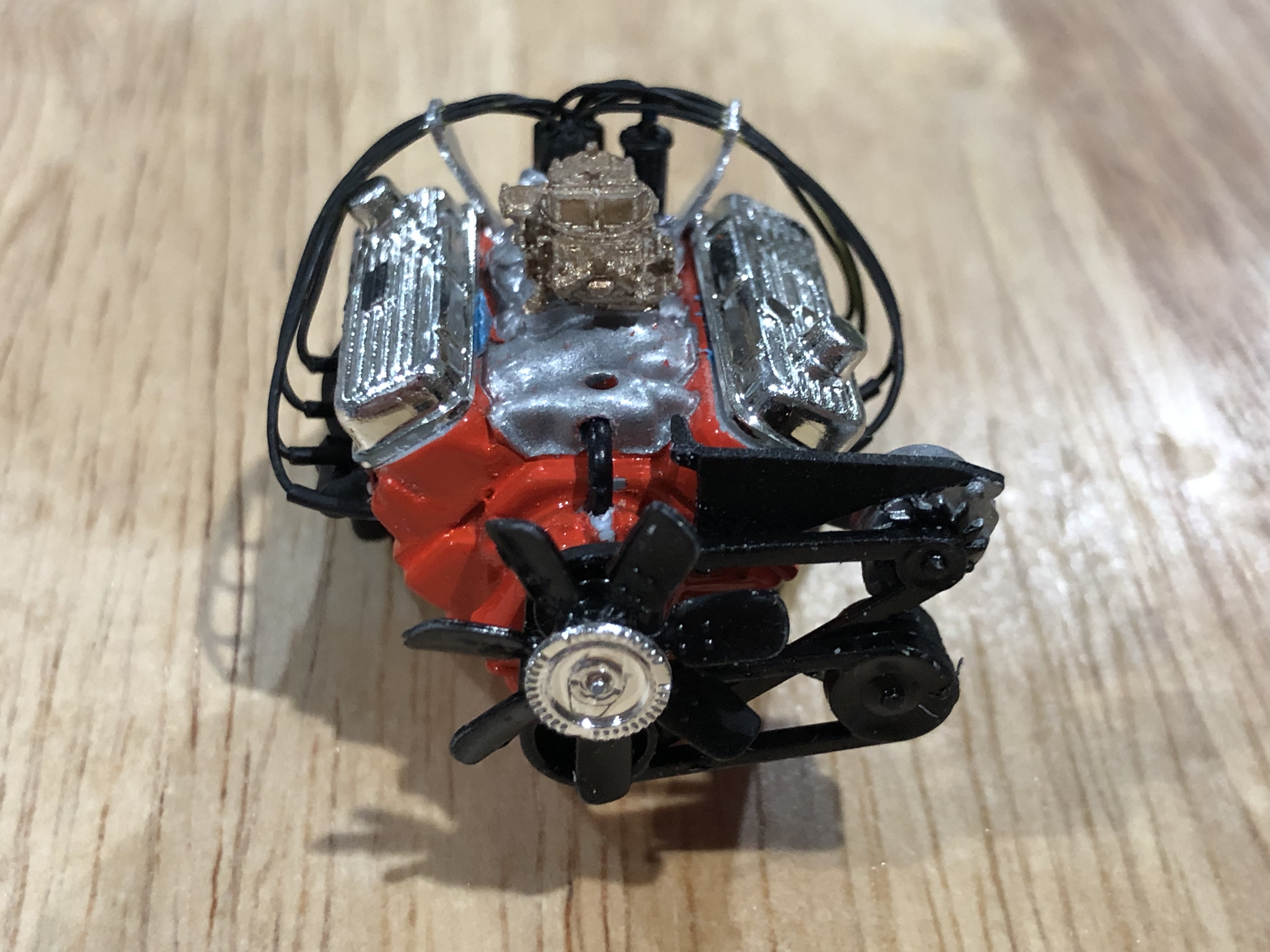

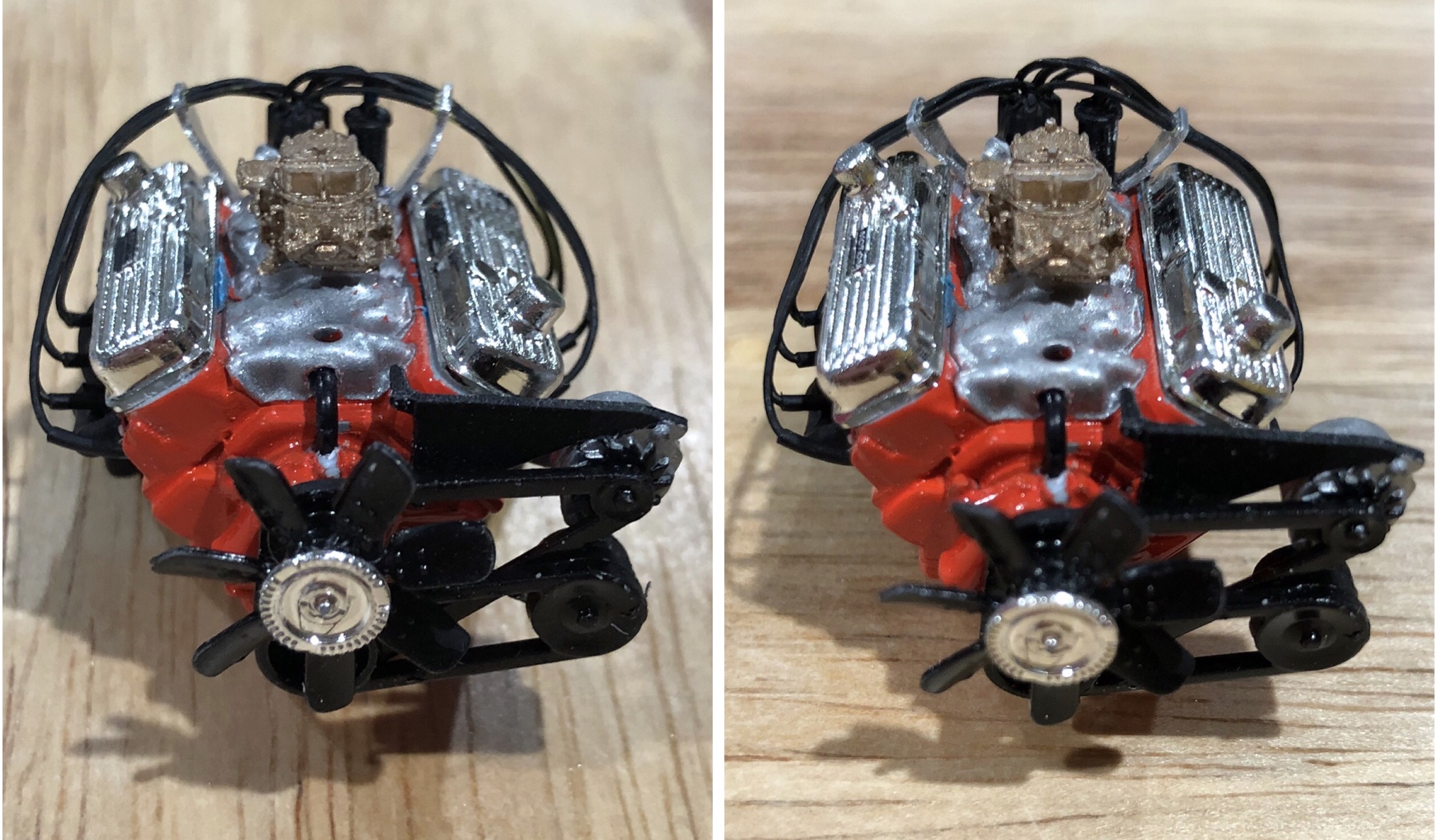

MrObsessive Posted February 2, 2019 Author Posted February 2, 2019 Just a mini update for the moment. Got the engine all done as far as I'll go with it for now. The fan I won't try to put on until it's time to put the engine in the chassis. Since I modified the pulleys somewhat, I don't want to be surprised by 'scraping' or binding against the radiator. Speaking of the chassis, that's next on the agenda. Got the old paint stripped off for the time being and then it'll be repainted. I thought about adding brake and fuel lines, but I'm going to let that go for this particular 'Vette. Way down the road I have another 'Vette planned which will be more detailed and I'll add that. Since this was essentially a race car for the street, I won't bother with adding heater hoses and such. Not many of these had heaters so it's no biggie. I have the air cleaner for it which I really had to hog out the inside so it'll sit down on the carb much better. That's in the tank now getting stripped and I'll repaint that gloss black, with the perimeter in some sort of dull gray to simulate the seal that ended up against the scoop inside the hood. If there's clearance troubles.............well I'll just leave that off. Thanks for checkin' in guys!
Snake45 Posted February 2, 2019 Posted February 2, 2019 I believe the L88 cars were delivered without heaters, and maybe without radios too. They were supposed to be for "off road" use. Good looking engine. I see you got the intake and heads mated up, looks a lot better now! BTW, I should be seeing our mutual friend at the toy show tomorrow.
MrObsessive Posted February 2, 2019 Author Posted February 2, 2019 There's a blanking plate on the dash where the radio is supposed to be and of course, there's no shielding for the distributor which makes it nice as I wanted to take some 'artistic license' and use those orange plug wires. On the firewall, there's some sort of cover on the heater box, so whatever car they modeled, it more than likely had no heater. Last I knew, George was in the hospital and I take it he may be back home but I don't know how well he's doing health wise. I had heard this at our club meeting a few weeks ago........his wife had emailed someone in the club about him.
