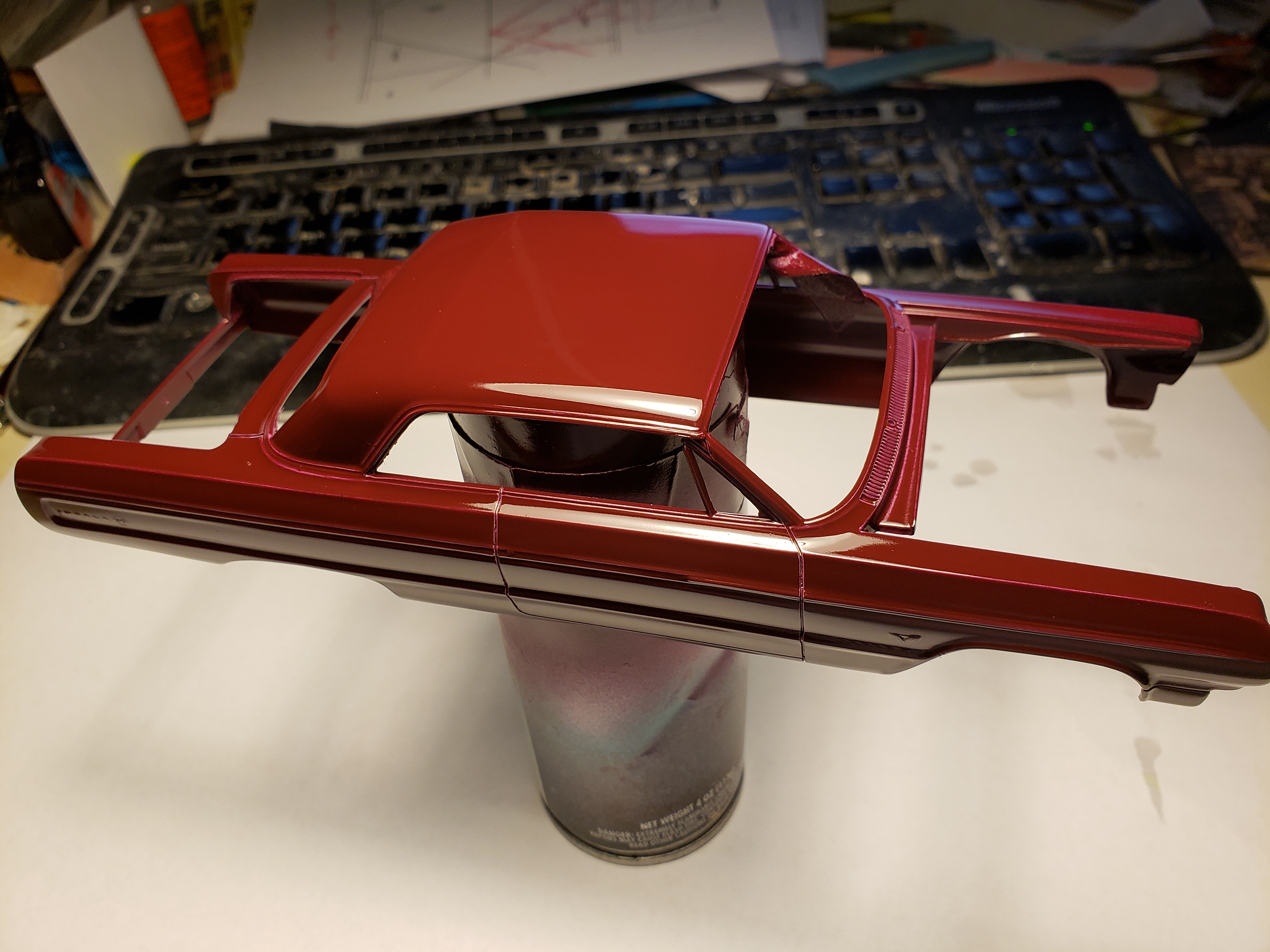

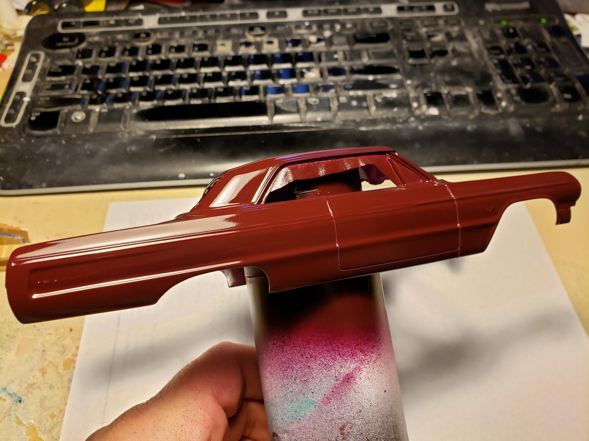

jjsipes Posted February 7, 2019 Posted February 7, 2019 I thought I would take advantage of the little warmer weather here in Maryland this week since I've been working what seems like non-stop and try and get my 64 Impala painted. Primed with Tamiya Gray Primer and then a couple coats of Tamiya Maroon. Did go as well as I had hoped. Paint ran off high spots and panel seams. Guess I'll have to wait the cooler weather out and scuff and repaint. I like the color though. I started a 50 Oldsmobile with this color but after the first coat it looked like it was going to be purple looking but i was determined to see this one through for the color.

NOBLNG Posted February 8, 2019 Posted February 8, 2019 So why would the paint draw away from the seams? Too thin of paint? Or is there a sharp edge like flash that needs to be sanded smooth?

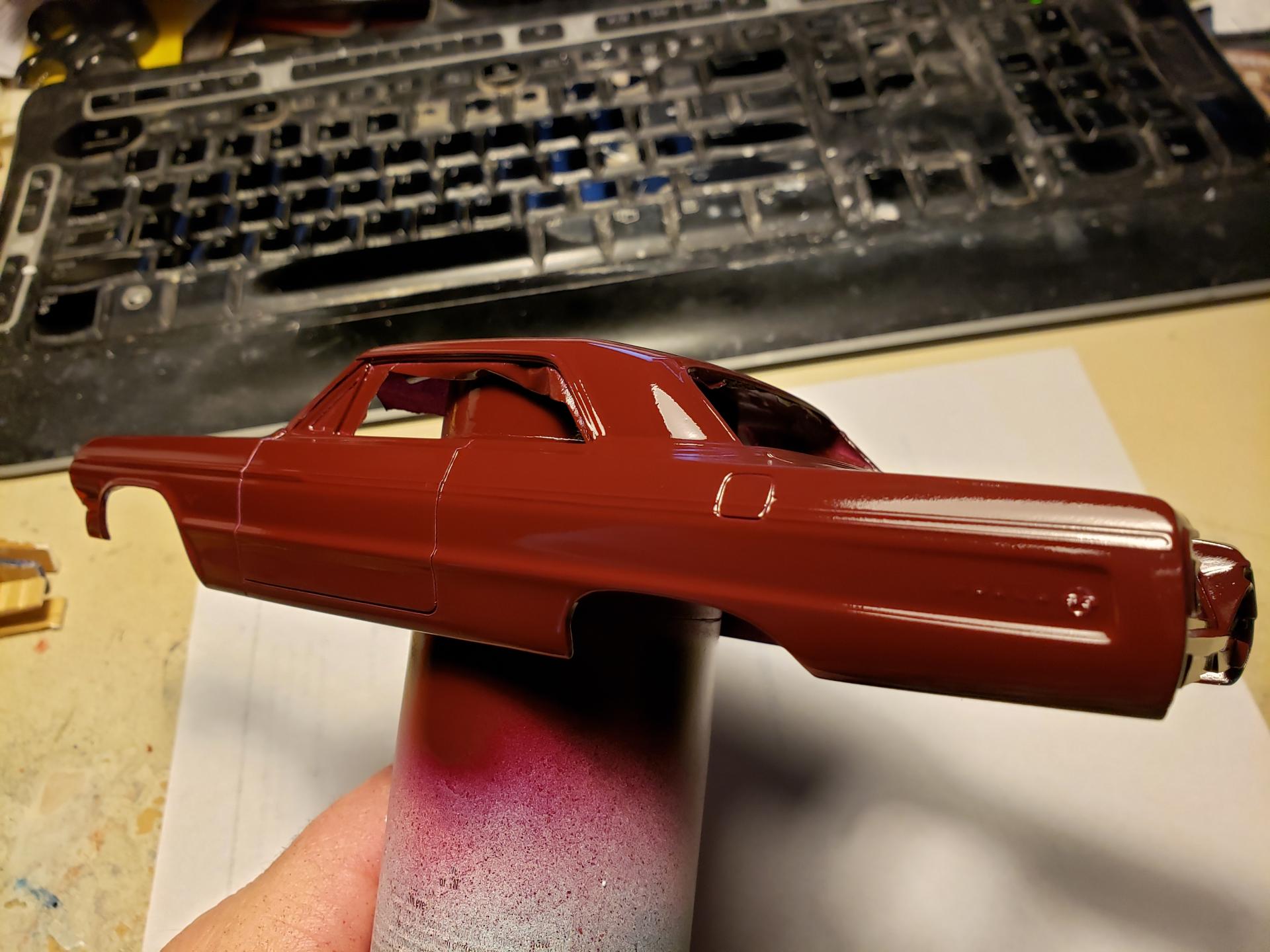

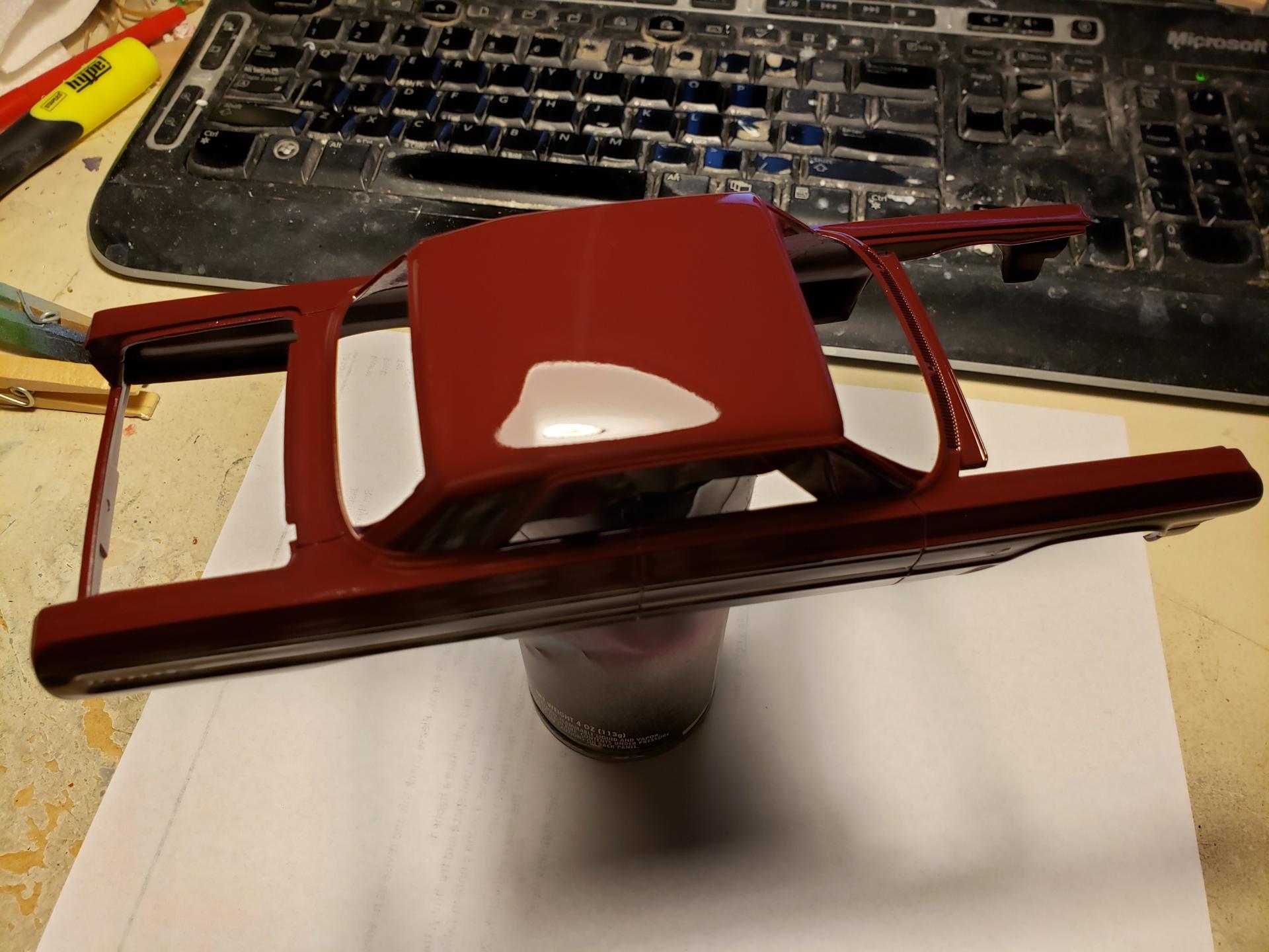

jjsipes Posted April 12, 2019 Author Posted April 12, 2019 While allowing the paint to dry on my 57 Bel Air, thought I'd get this back out and reshoot it. Better this time around, not perfect but atleast its all covered.
Brutalform Posted April 12, 2019 Posted April 12, 2019 Looks fantastic. I’ve had that happen many times with Tamiya Maroon. I’ve had it happen with the paint, and other times it happens after the clear is layer down. I wonder if other colors do it, but it’s just not noticeable? Not really sure but the maroon really sticks out.
dino246gt Posted April 12, 2019 Posted April 12, 2019 Woah, that roof sure looks samoooooooth! Sweet, and perfect '64 Impala color!

MrObsessive Posted April 13, 2019 Posted April 13, 2019 Jason, that paint is SUPER SLICK! This is one car that Revell IMO did get right as far as the body shape. Even better than AMT's '64 annual. As far as the paint, cars with sharp edges like that can be tricky to paint. One trick I've used in the past is to take some 600 grit sandpaper and slightly knock down the edges. More than likely, that's where the parting lines were located (along the tops of the fenders) and that's where the sharper edges would be. The same sorta goes for the door shut lines. I'll take a balsa wood block wrapped with 400-600 grit sandpaper and try to make the door lines as even as possible by leveling the troughs from the molding process. Certain Tamiya colors I don't think the pigments are as tight as others and they tend to want to 'draw away' in spots. Keep up the beautiful work!
Oldcarfan27 Posted April 13, 2019 Posted April 13, 2019 Paint looks perfect to me. You don't even to color sand it to knock down the orange peel. I'd leave it alone.

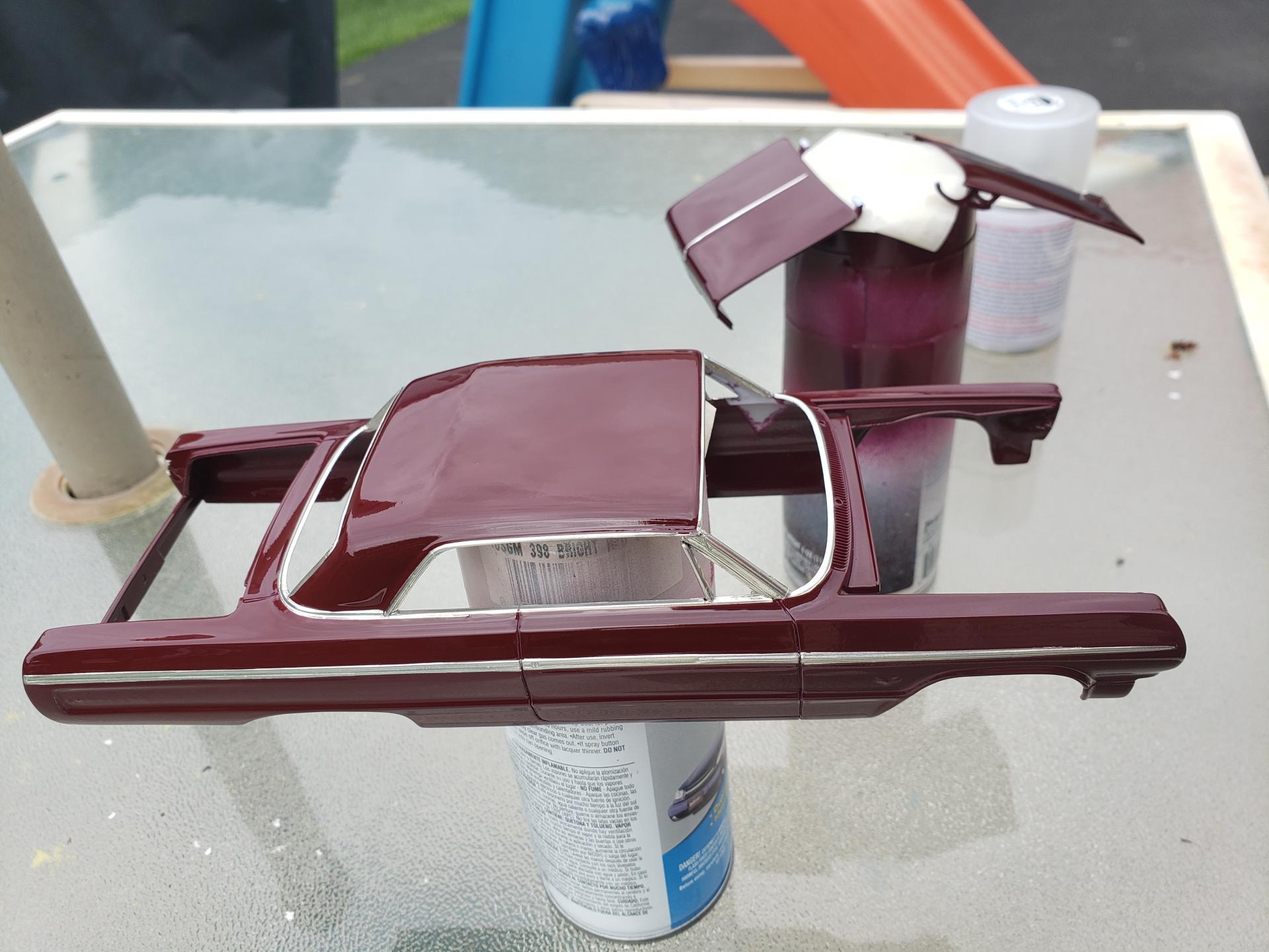

jjsipes Posted April 25, 2019 Author Posted April 25, 2019 (edited) Bare-metal foil completed. Just sprayed Tamiya Clear on it. Not perfect but will do. Edited April 25, 2019 by jjsipes
