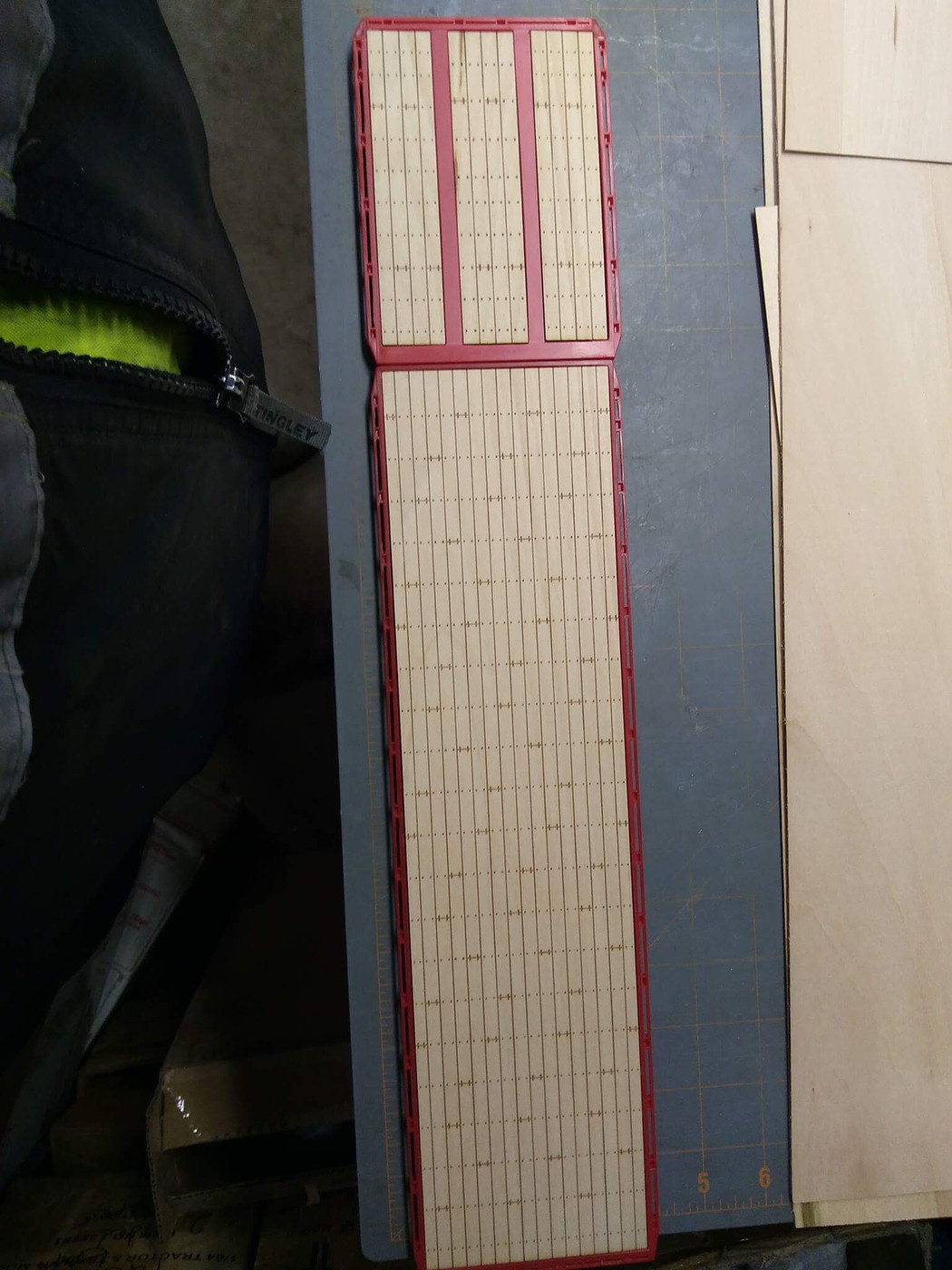

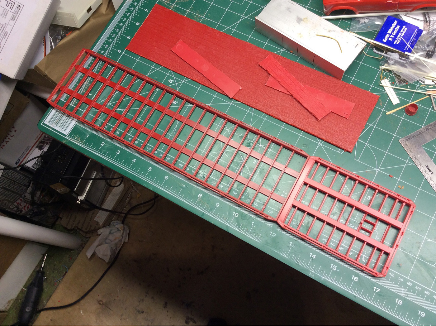

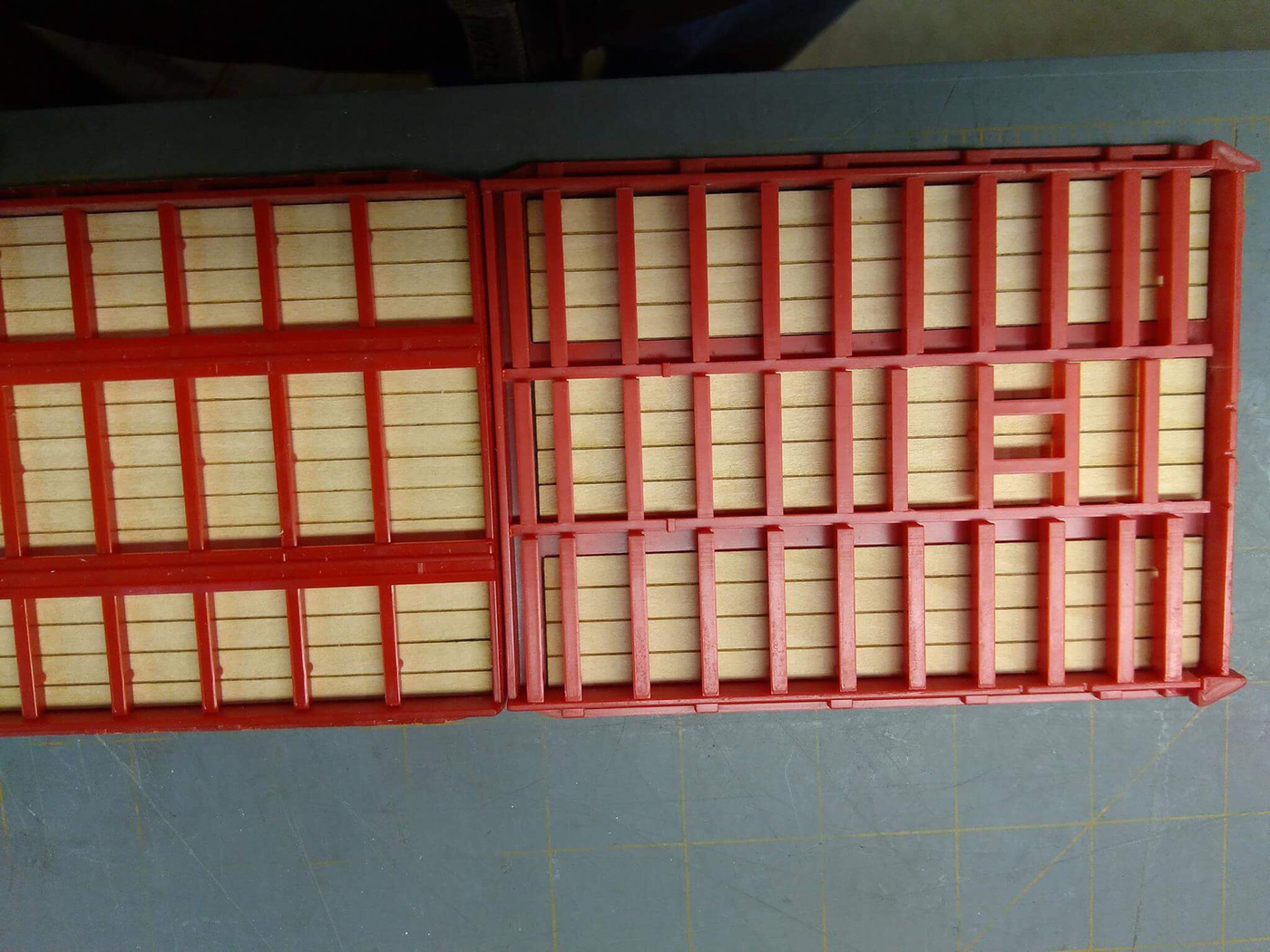

Oldmopars Posted March 16, 2019 Posted March 16, 2019 I am working on the deck of my low boy trailer. I want to use real wood and found Craft Sticks in several sizes at HL. Now I need to decide the proper width for the boards. I did some looking on the web and all I have been able to find are 3in, 5in and 7in deck boards, however when I measure the deck boards on the fake wood that comes in the kit, it is 10.75in wide. 10.75 in scale is .43 and would require fewer cuts and fewer overall boards. Have you seen 10+in deck boards on trailers? I have done some redecking of trailers and I just do not remember how wide the boards were.

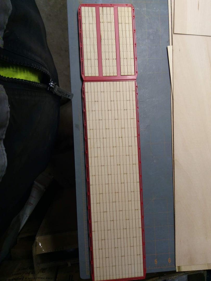

Dieselhead Posted March 25, 2019 Posted March 25, 2019 I'd agree with Tom, there's no real standard, it's pretty much whatever fits. I would get some sheet balsa (Hobby Lobby, Michaels, etc), put it on, and just play with the widths, and then score the board with a knife to create the illusion of boards. Do it deep like panel lines, wash it dark and I think it would look great.
gotnitro? Posted March 25, 2019 Posted March 25, 2019 Good tip using a large sheet..if I may suggest using Basswood instead of balsa. Grain is smoother and imo better appearance over airplane wood . I bought a piece about 4 inches wide by roughly 20 inches at hobby lobby last year if I recall its 1/32 " thinnest I could find

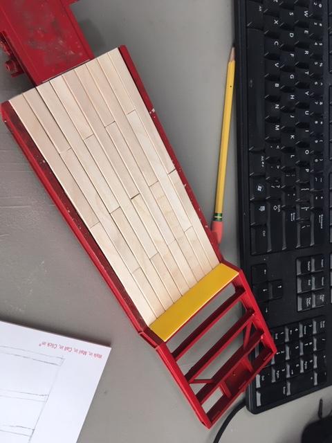

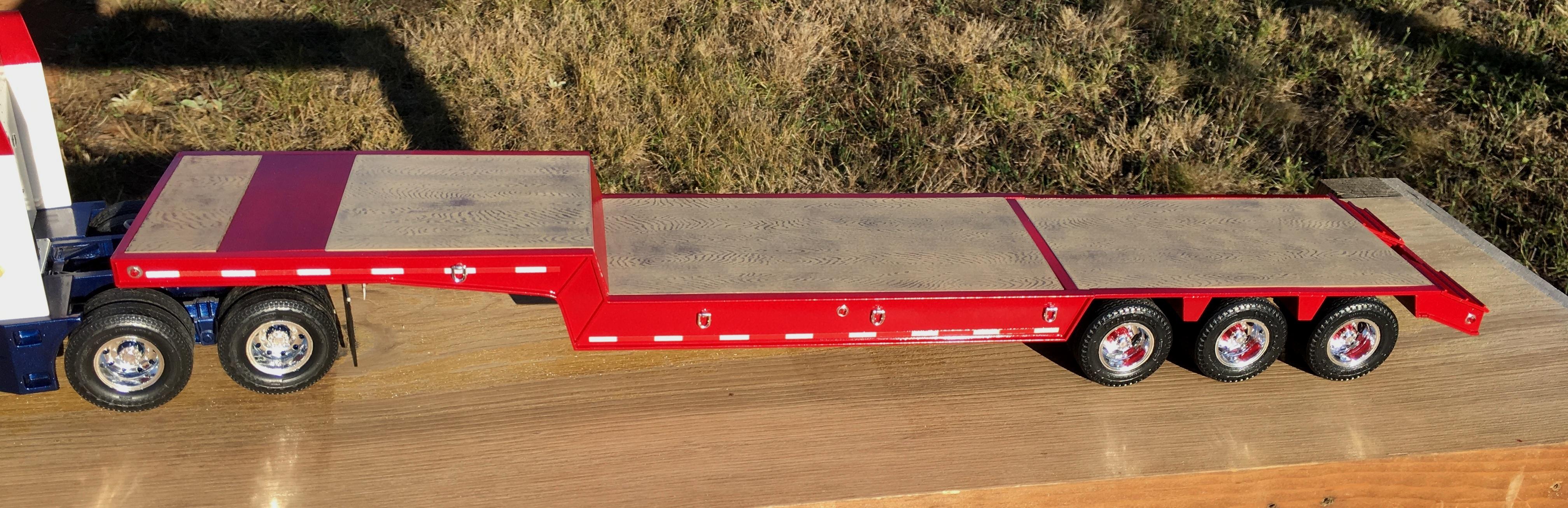

Oldmopars Posted March 28, 2019 Author Posted March 28, 2019 (edited) Well this is my second attempt. I need to weather it up a bit to make it look more like the deck of a truck used to haul a Dozer, but I think I am getting there. These work out to a scale 9in, so a little wide, but not too bad. Edited March 28, 2019 by Oldmopars
Sam I Am Posted March 29, 2019 Posted March 29, 2019 I like it. I can hardly wait to see it with a wash on it.
redneckrigger Posted March 30, 2019 Posted March 30, 2019 Scott, that looks great..............a bit of weathering and it will look just like the real deal after a bit of service. I use balsa, and as it is quite soft, I beat it up a bit with dents and dings and sometimes even some tears and splinters in it and stain it with actual used dirty motor oil and grease. Personally, I find that the actual oils and grease work better than trying to replicate something.

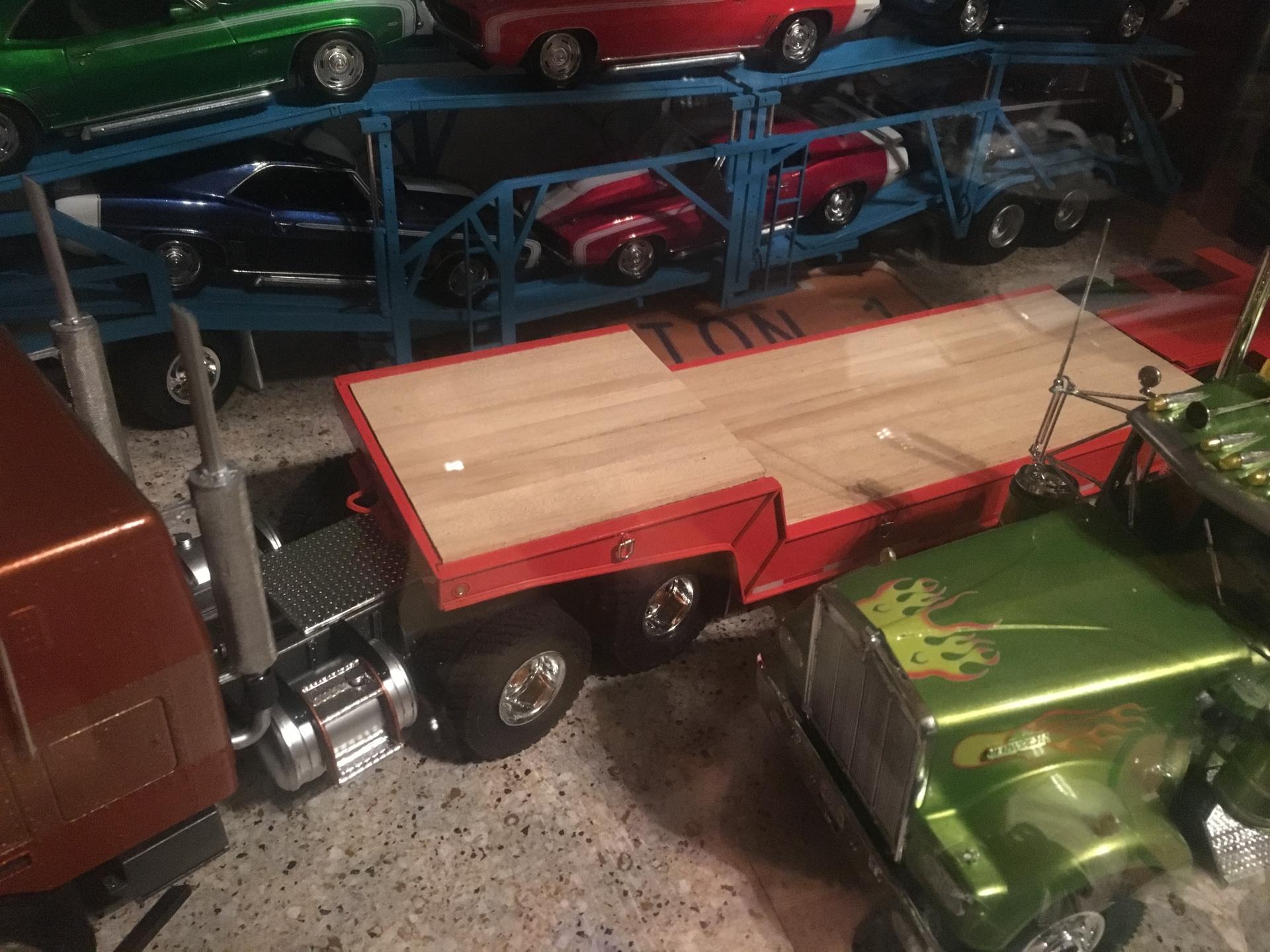

Ben Posted April 2, 2019 Posted April 2, 2019 (edited) For my ERTL Great Dane flatbed build, I cut the fake plastic wood out and then had a guy cut and print the deck pieces on a thin sheet of balsa wood. All the printed screw heads reside directly above each bed crossmember. Edited April 2, 2019 by Ben

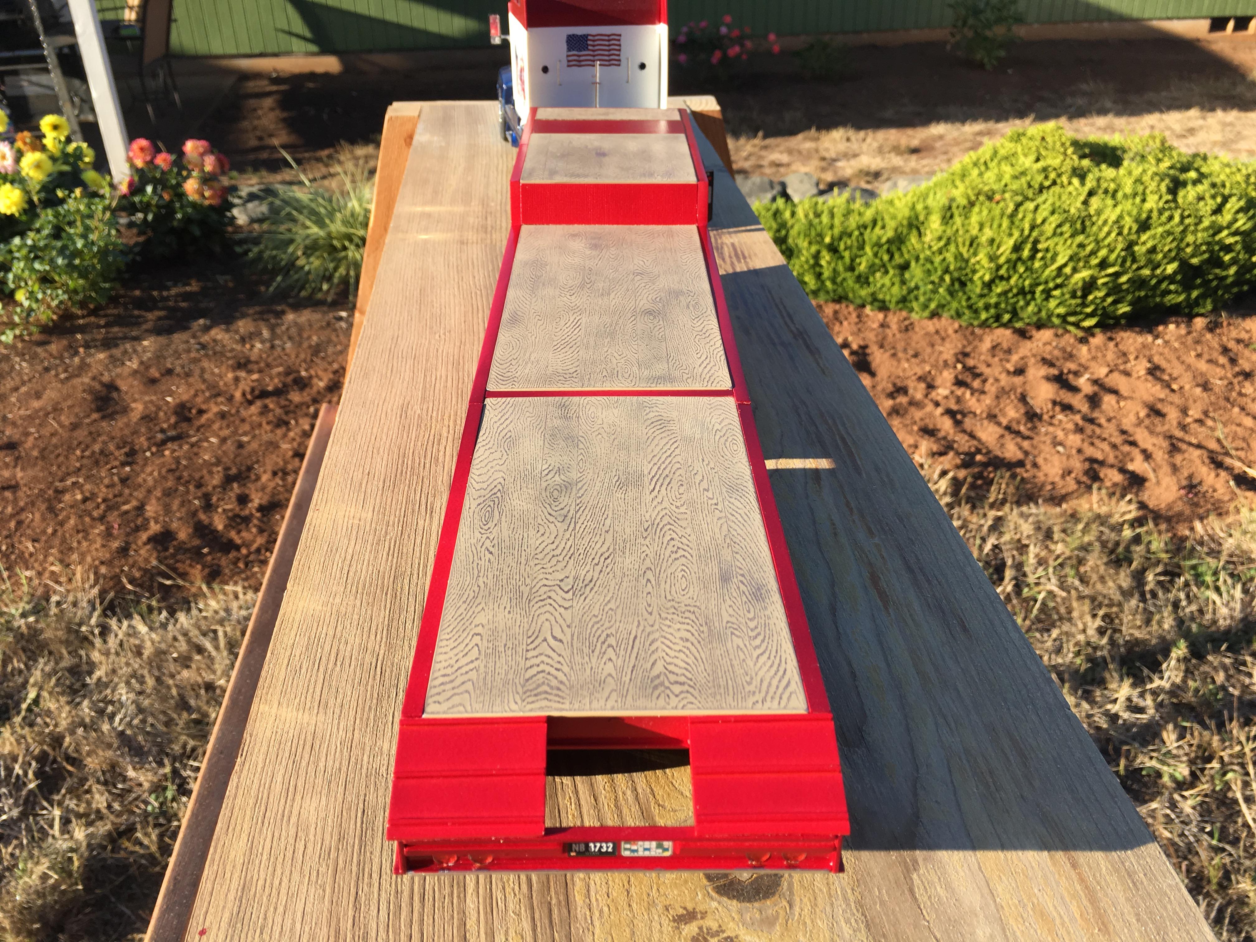

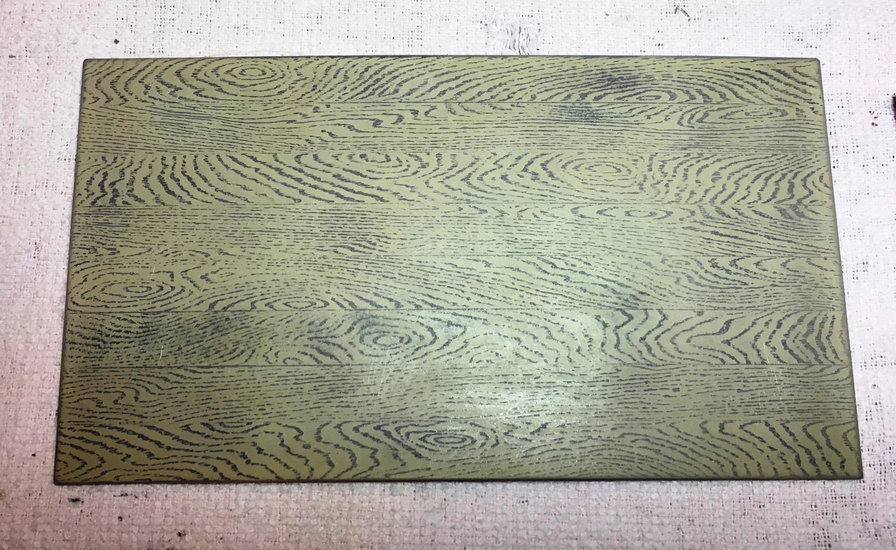

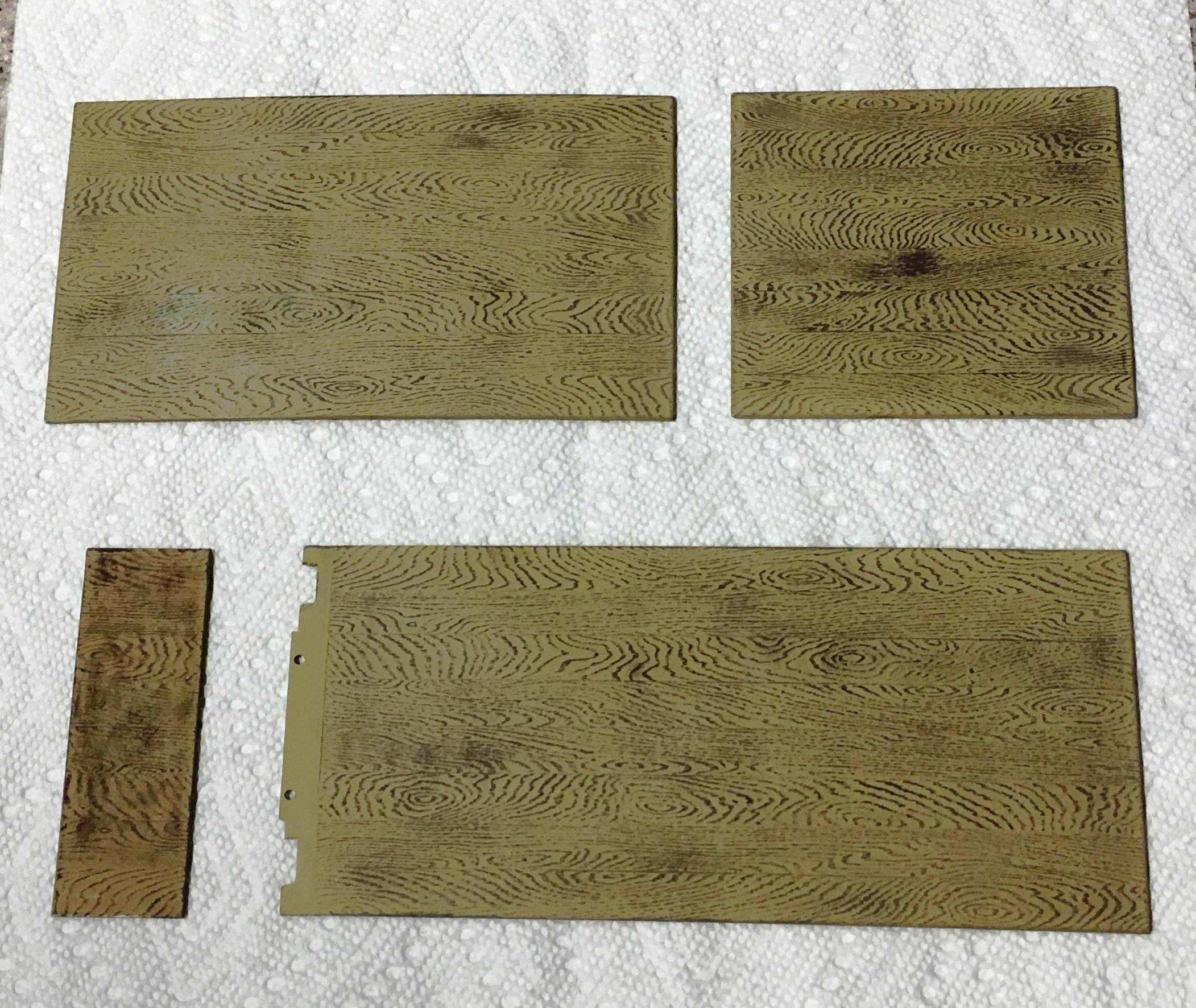

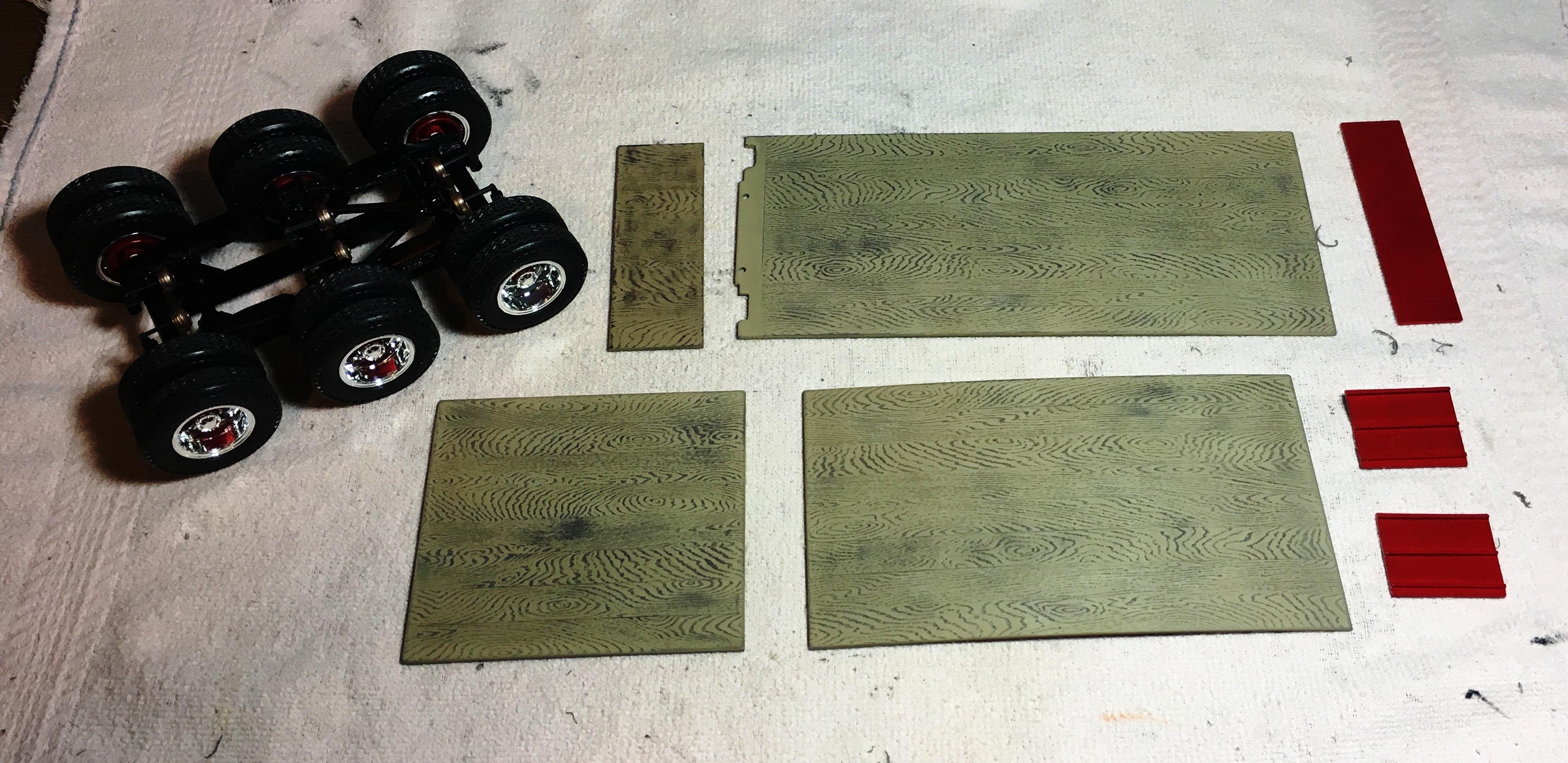

Bills72sj Posted December 1, 2019 Posted December 1, 2019 I may be posting this a bit late but, I actually used the wood grained plastic from the kit. I obtained extras and lengthened the frame so I would be able to park 3 cars on it. To get the wood grain relief to show I painted them with Testors Root Beer brown lacquer (no primer). After that dried, I painted them with Tamiya flat tan. Next was sanding (I hate sanding) very gently until the dark brown started to show. Fortunately I did not reveal any bare plastic. Some spots are not perfect but it turned out reasonable.
