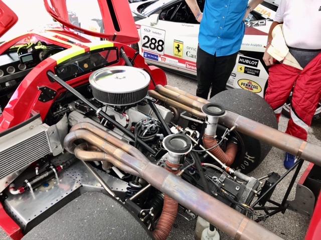

Scale-Master Posted November 19, 2021 Author Posted November 19, 2021 I milled the 7/16 bolts and washers for the headers. And wrapped them with heat insulation… 1
