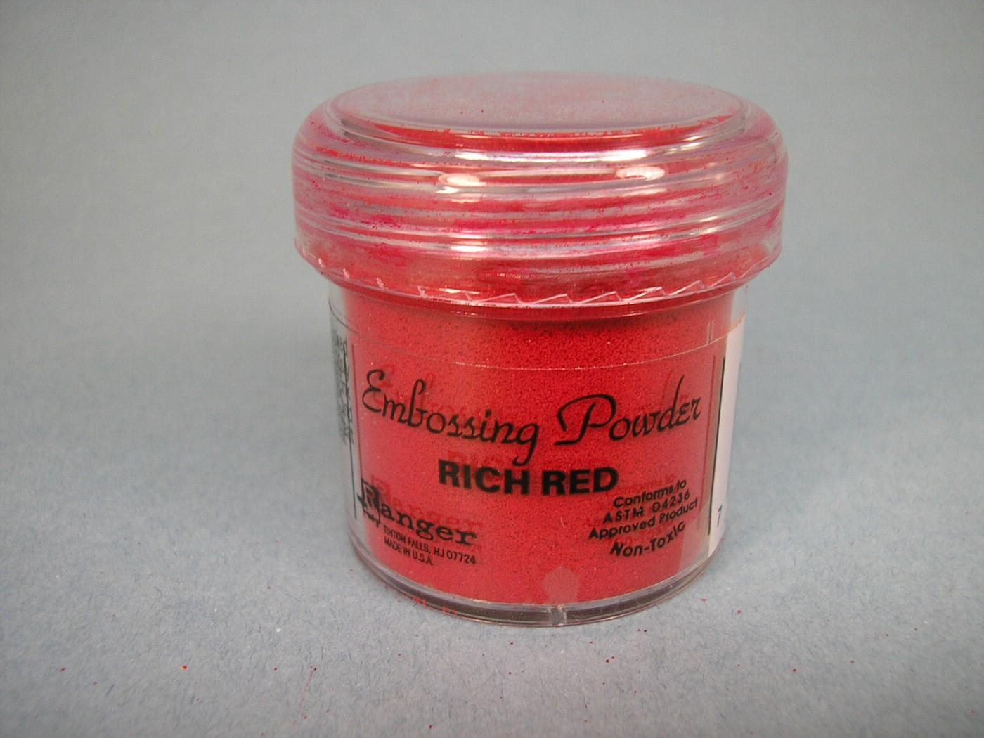

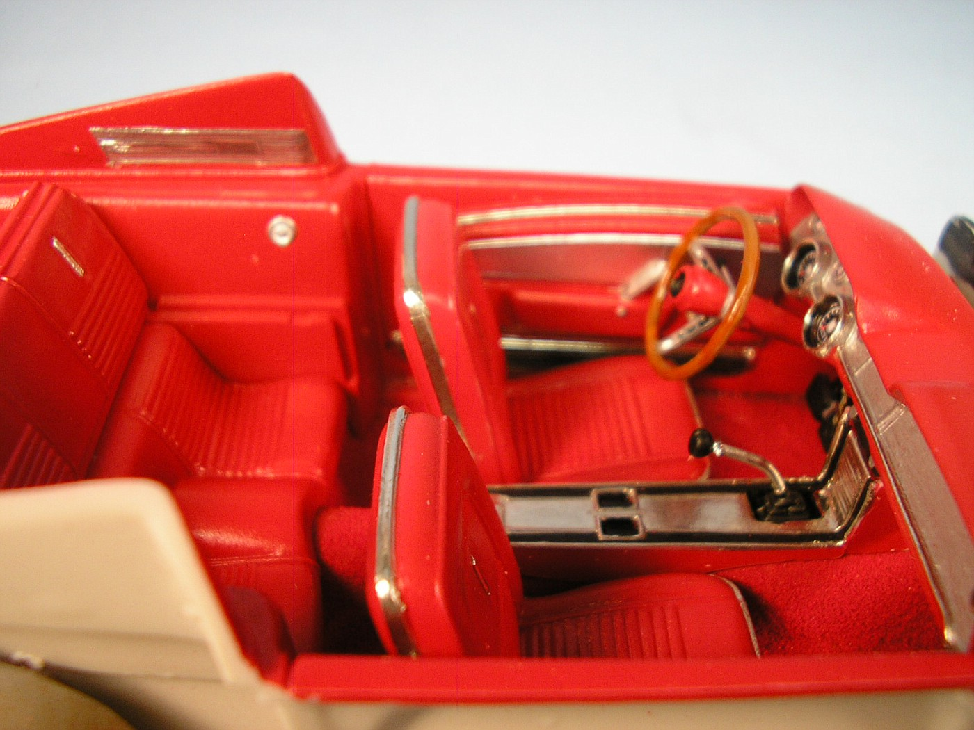

MrObsessive Posted August 26, 2019 Posted August 26, 2019 I'll echo what Steve said. Flocking has its place, but IMO it's better suited for larger scales for the reasons you mentioned. It can come out clunky/splotchy looking but David's tip is a good one. Still, the fuzziness of flocking still seems a bit out of scale to my eyes for 1/24-25th scale. Here are a couple pics of models I did with the red embossing powder. You can get this in all sorts of colors and it has just the right texture that can be seen in carpets like 1:1's for example. Here's the brand of embossing powder I use. You can check your local arts and crafts shop, or they're all over the place on eBay. Hope this helps! ?

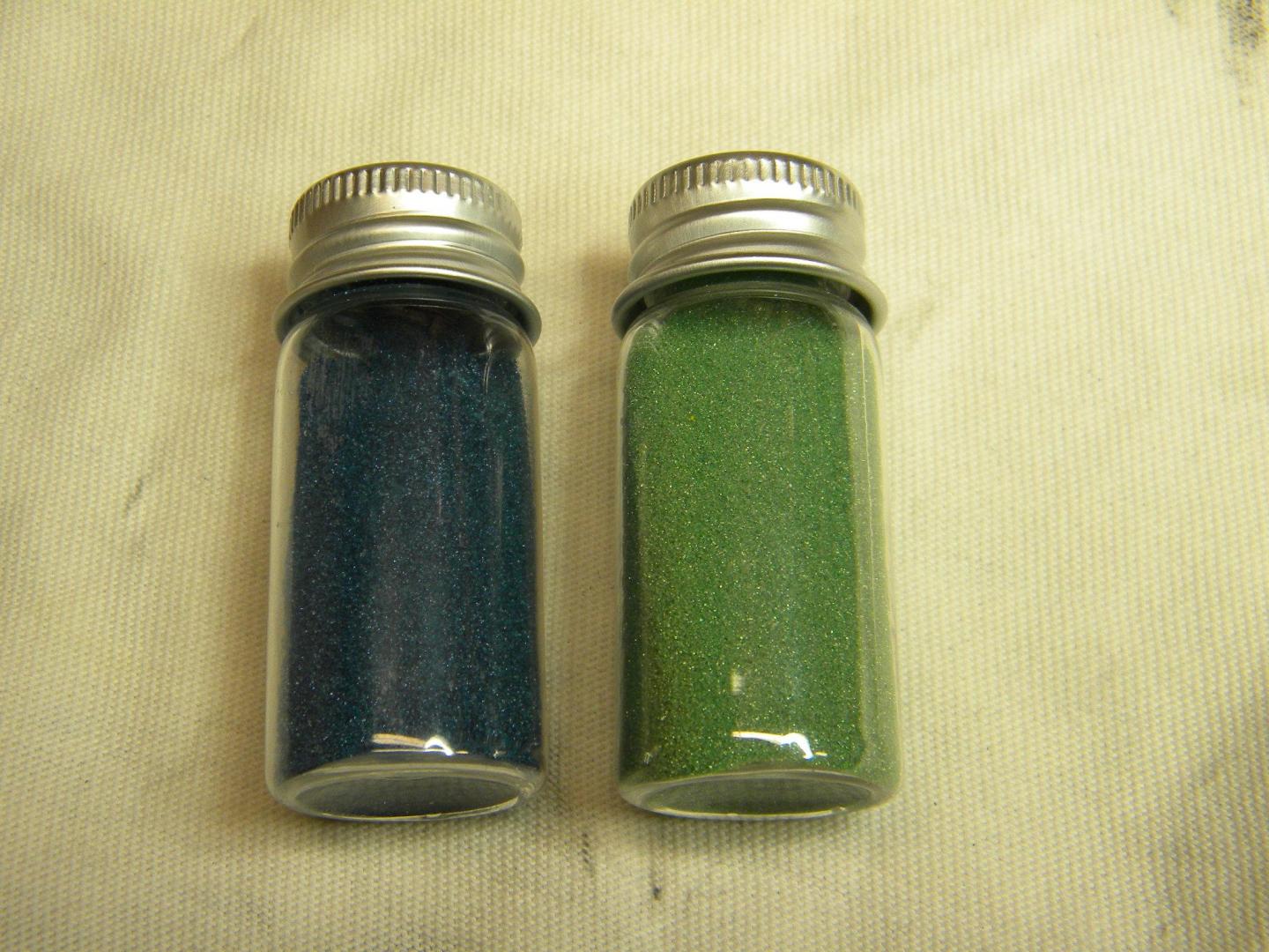

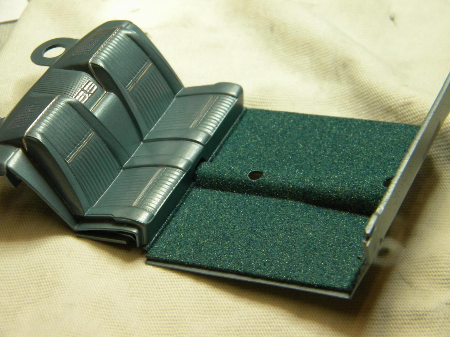

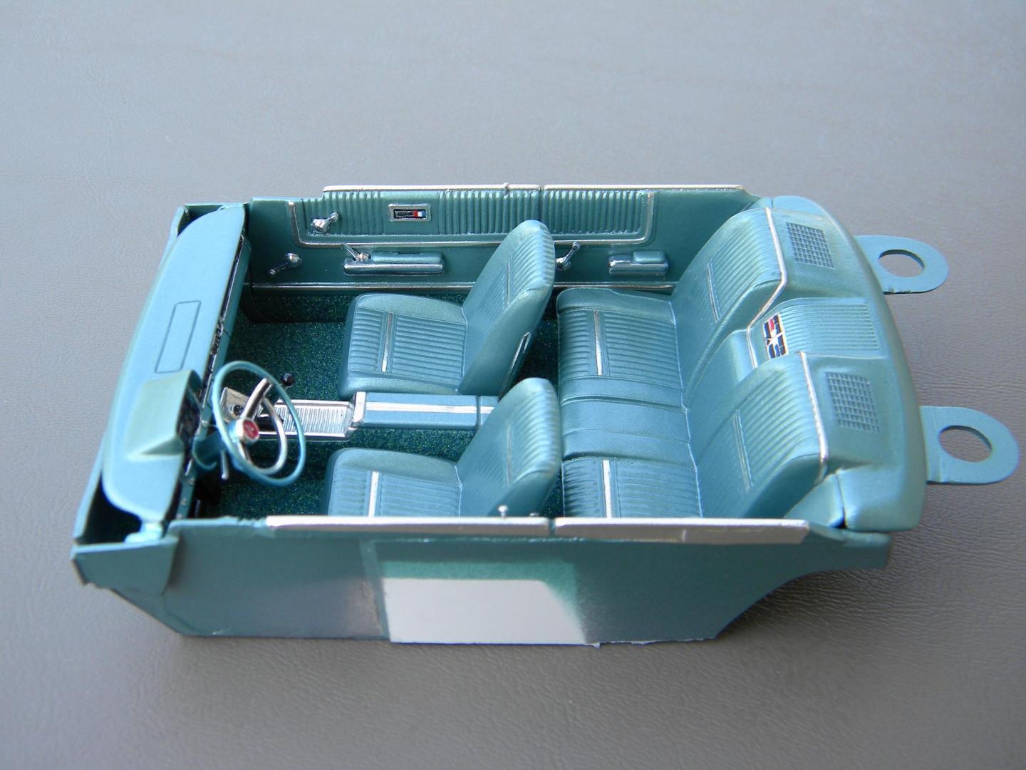

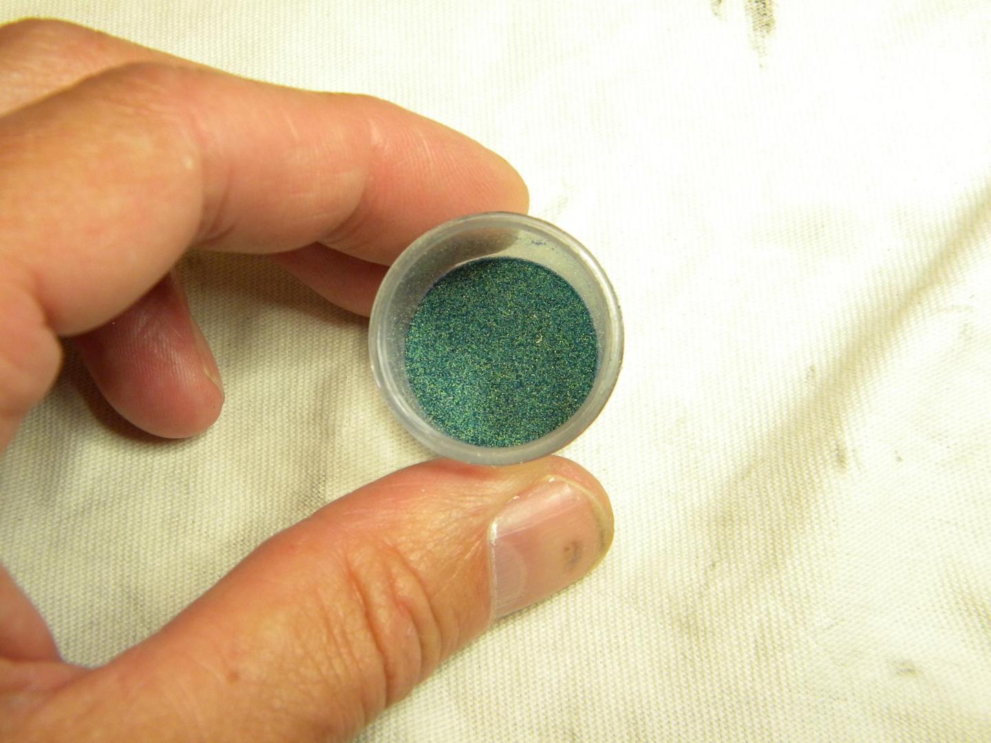

StevenGuthmiller Posted August 26, 2019 Posted August 26, 2019 (edited) I use the same "slightly thinned Elmer's glue" method for the embossing powder. I never bother with any sort of strainer or shaker. I just dump it on and shake it around over a piece of newspaper so that the excess can be returned to the jar for later use. A couple of nice advantages of embossing powder are the ability to mix colors, and the ability to paint over it. I like the metallic embossing powder set that I bought several years ago. I believe it gives a nice "salt and pepper" appearance to the carpet. It might be a little too much for some, and I guess a lot depends on the vintage of the car you're building, but it comes in solid colors as well. If you don't have a matching color for your project, it can easily be sprayed over with the color of your choice. The powder can also be mixed to achieve the color you desire. The '65 Plymouth floor pan pictured above is a combination of blue and green metallic embossing powders. Steve Edited August 26, 2019 by StevenGuthmiller
