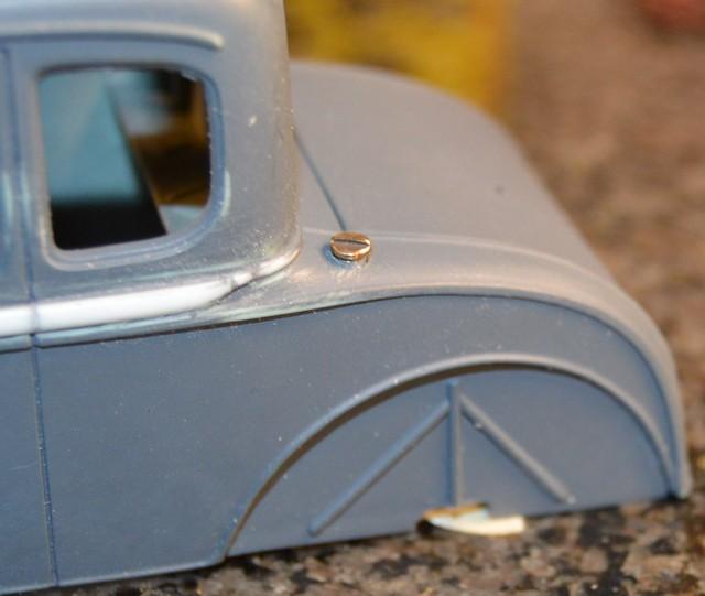

Straightliner59 Posted May 12, 2020 Author Posted May 12, 2020 3 minutes ago, slusher said: Some very impressive work Sir.... Thank you, Carl. I'm enjoying it, immensely! In fact, I just poked a hole in it, for the filler nap/neck. I think it suits the look I'm after, pretty well.

espo Posted May 12, 2020 Posted May 12, 2020 I like the way the gas tank filler turned out. That is how I would think it would look after years of use. The body character lines really define that area of the body.
AmericanMuscleFan Posted May 12, 2020 Posted May 12, 2020 Good job Daniel! This gas filler cap found it's definitive place on your model and it looks great! Another piece of the puzzle done...

Straightliner59 Posted May 12, 2020 Author Posted May 12, 2020 1 hour ago, espo said: I like the way the gas tank filler turned out. That is how I would think it would look after years of use. The body character lines really define that area of the body. 47 minutes ago, AmericanMuscleFan said: Good job Daniel! This gas filler cap found it's definitive place on your model and it looks great! Another piece of the puzzle done... David, thank you! When I remembered I had that bottle of Blacken-It, I knew what I was going to do. It worked out just as I had hoped it would! Thank you, Francis! I think it found its place, for sure!

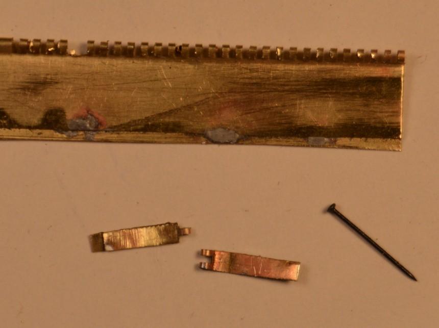

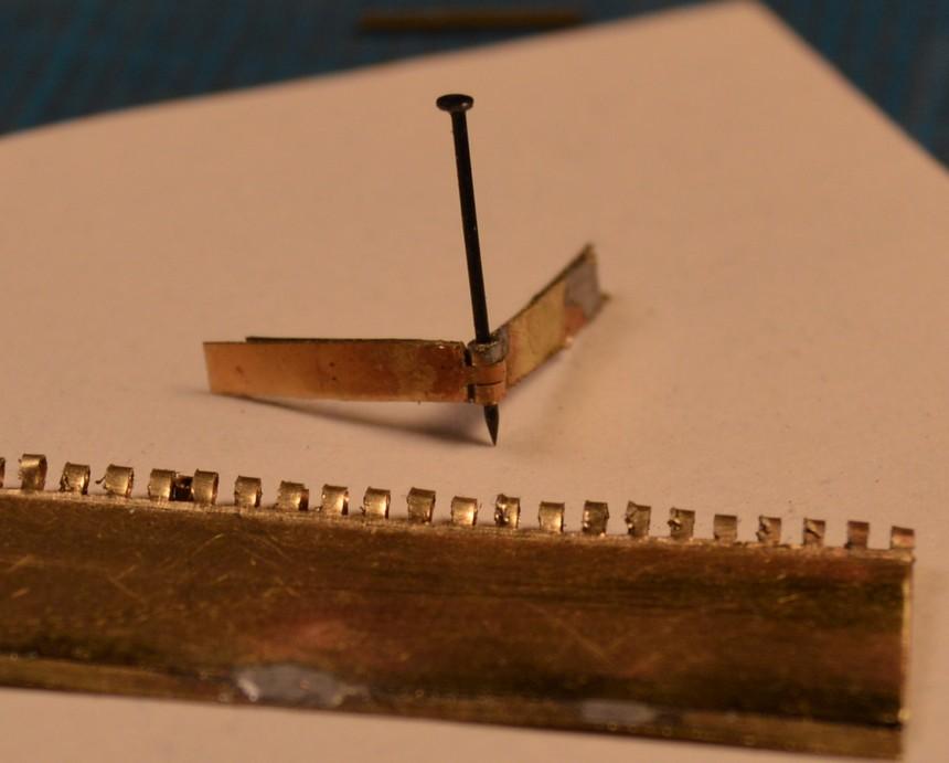

Straightliner59 Posted May 12, 2020 Author Posted May 12, 2020 Started working on some door hinges. I crimped some .005" brass sheet around 1/32" brass tube, and soldered it, a bit. Then, I put it in the machinist's vise and passed a .032" square end mill through it, creating a sort of piano hinge. From here, I can use a pair of Wiss snips to cut individual hinge halves, as shown. I will hit them with another round of solder, once they're properly shaped. I think, too, that, once they are final-soldered, I will be able to file them to an even more delicate size. They work nicely! Now, as Mr. Sapiro suggested above--do I have the guts to work on that 'A' pillar? Stay tuned! Thanks for looking! As always--questions, comments and critiques are welcome!
AmericanMuscleFan Posted May 12, 2020 Posted May 12, 2020 Finally the doors will work...lol. That's great Daniel, this is exactly how I would have tried to make the hinges and I don't see any reason why it couldn't work. Thanks for sharing!

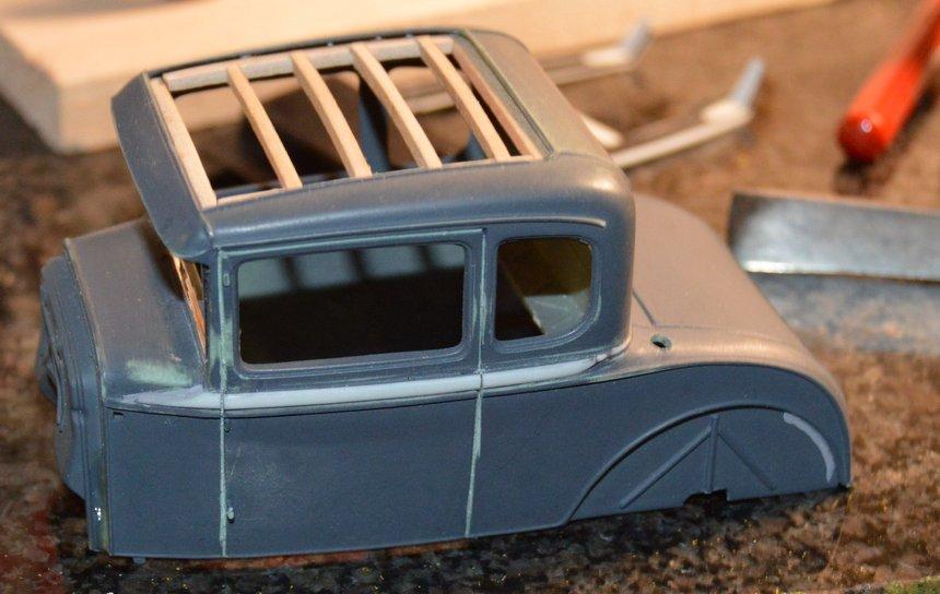

Straightliner59 Posted May 17, 2020 Author Posted May 17, 2020 In prelude to cutting out the doors (I've begun the process by dragging a saw blade, and the back of an X-Acto blade through the lines), It seems important to have the header and windshield frame in place. I think it may help some with rigidity. We'll see! Anyway, I have the frame and header home. That allowed me to tack the roof framing in place. I added some .030"X.040" Evergreen to the sides of the floor pan, to cover up some gaps that were visible, when the interior door panels were in place. She's getting there. Questions, comments and critiques always welcome! Thanks fer lookin'!

1930fordpickup Posted May 21, 2020 Posted May 21, 2020 Dan you are brave cutting out those doors with the top being separate pieces from the bottom. This is still looking nice.
David G. Posted May 21, 2020 Posted May 21, 2020 I think you've made a wise decision deciding to reinforce the structure before making the cut. I'm very interested to see how this plays out. Thanks again for taking the time to share this with us. David G.
