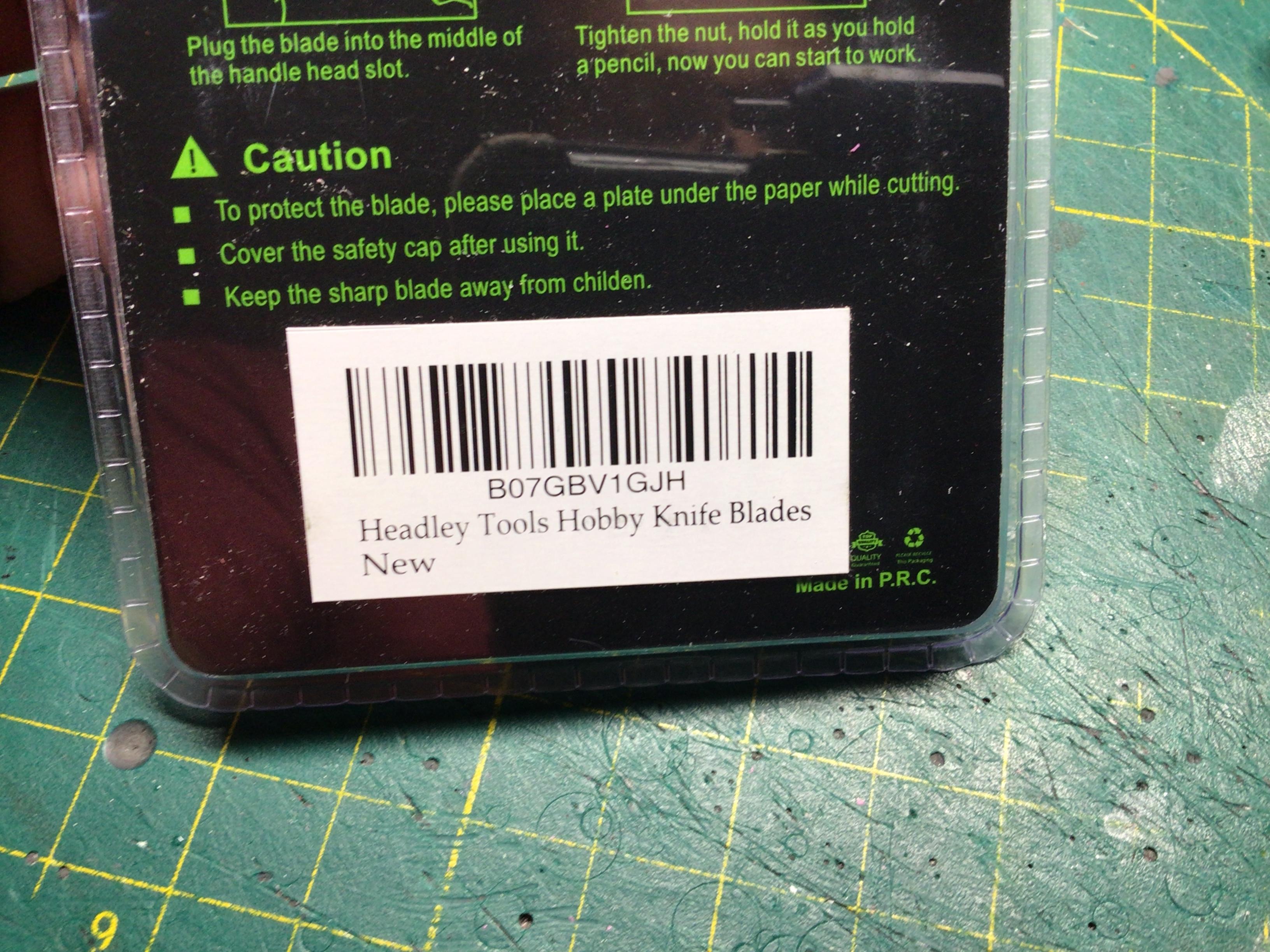

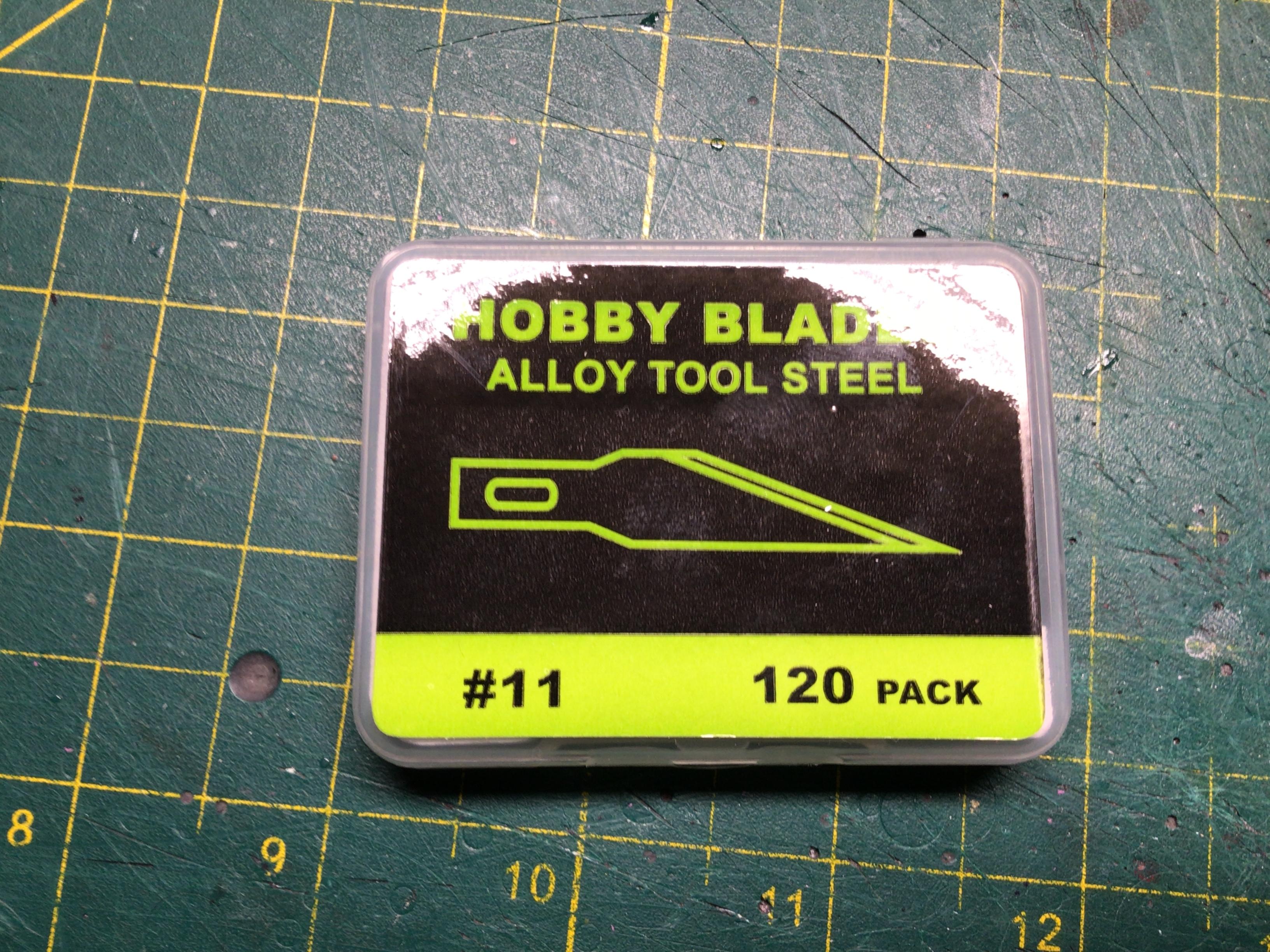

NOBLNG Posted November 24, 2022 Posted November 24, 2022 (edited) On 11/23/2022 at 3:19 PM, StevenGuthmiller said: Amazon still carries these "American Line" blades. Steve I couldn’t find them on Amazon.ca today, so I ordered some of these. The reviews were pretty good on them. The cheaper DIYSELF ones had horrible reviews. EDIT: These ARE made in china. A fresh one cuts styrene nicely. Edited November 28, 2022 by NOBLNG

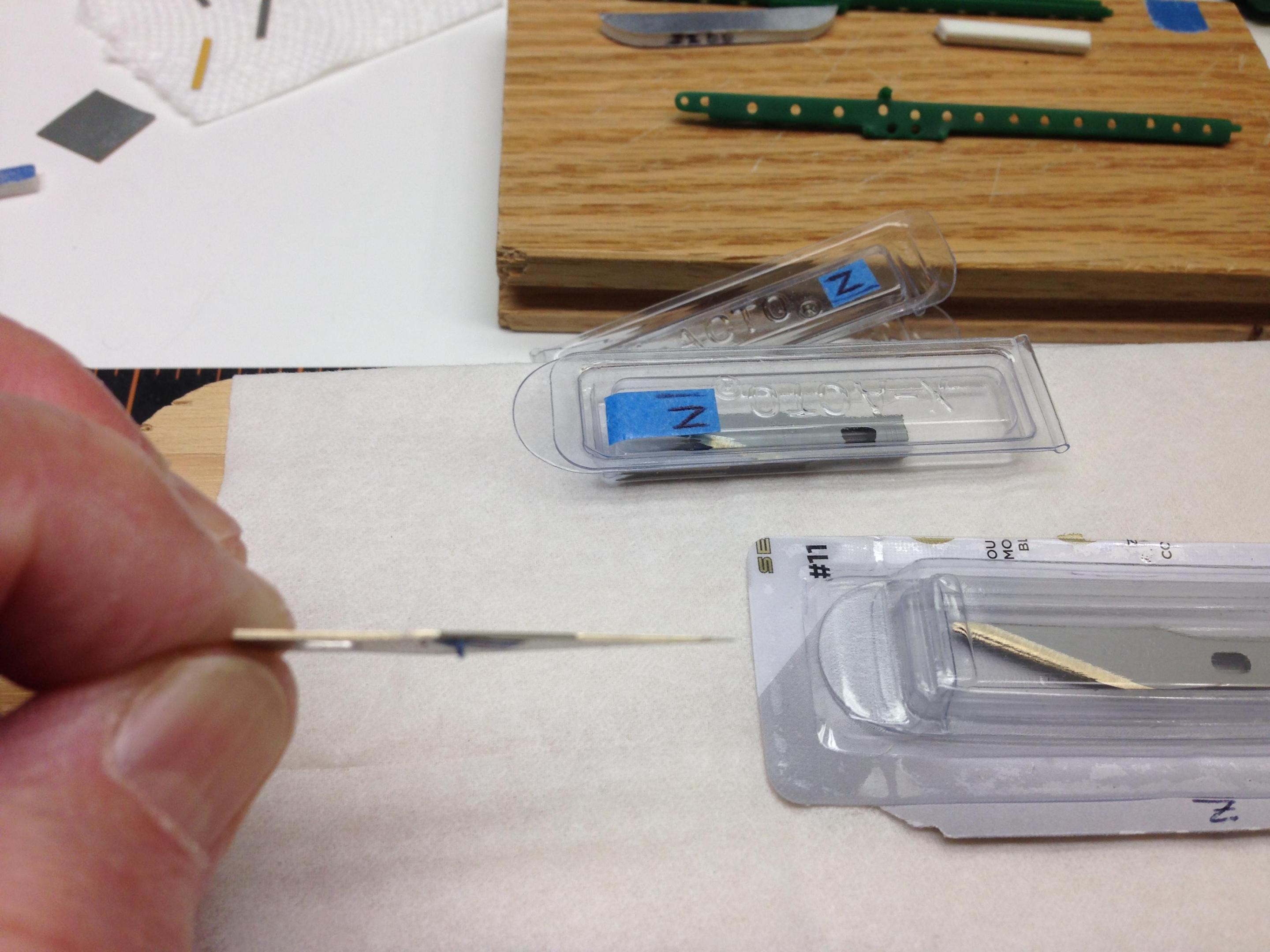

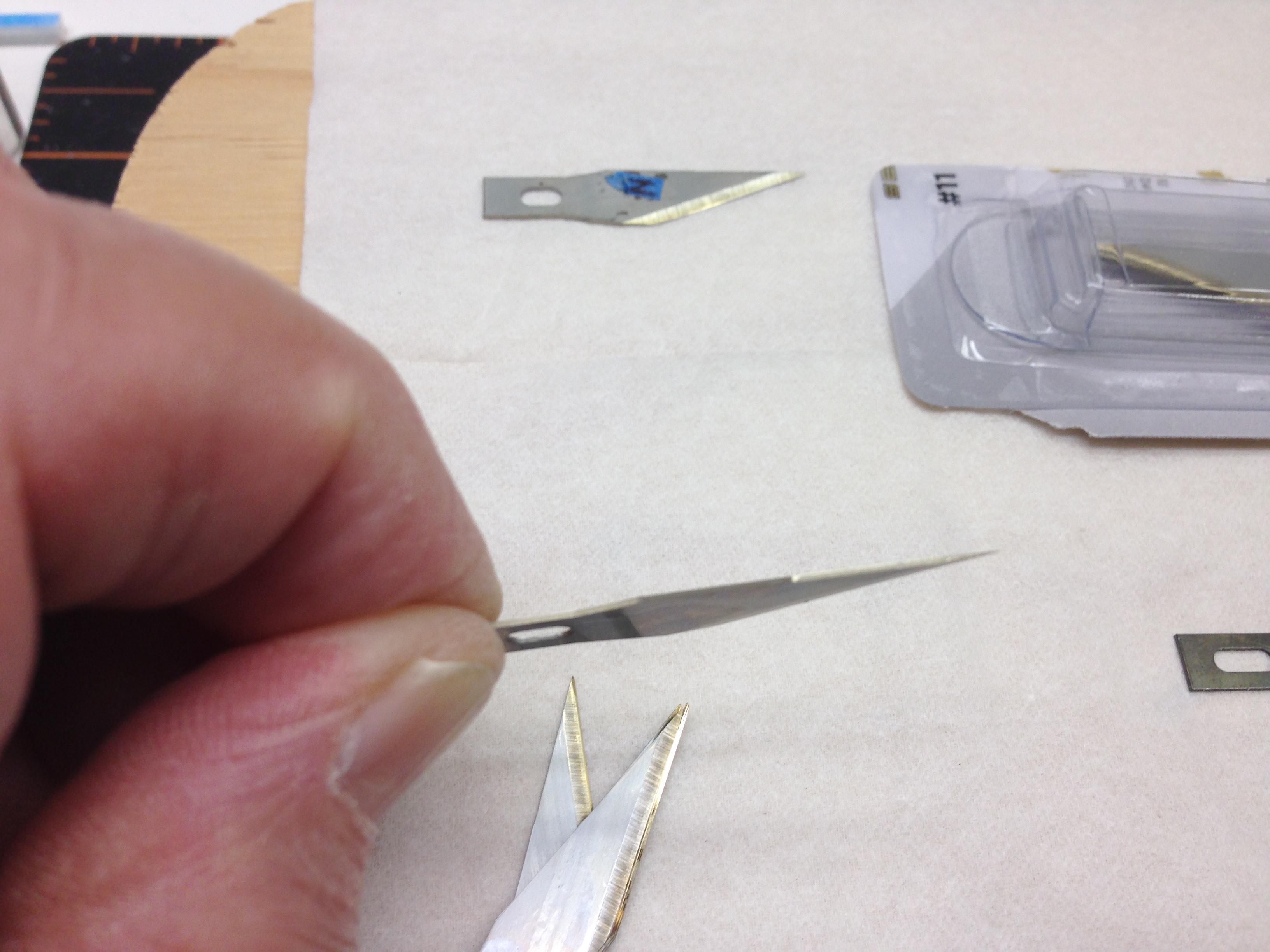

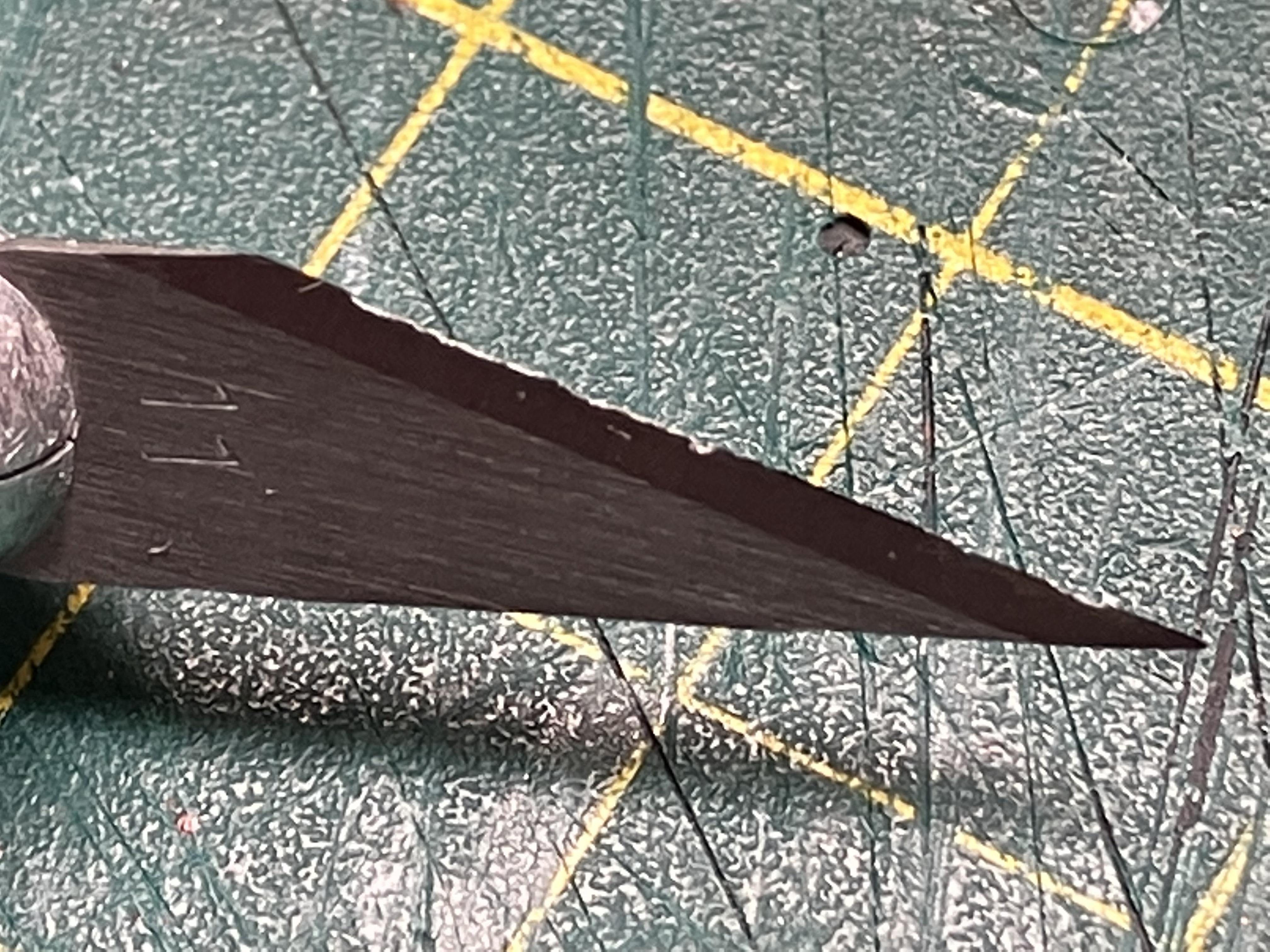

LL3 Model Worx Posted November 24, 2022 Posted November 24, 2022 9 hours ago, Joe Nunes said: One thing I have found useful over the years is having a sharpening stone and a fine grain honing stone on the bench. I use the X-acto Z blades exclusively and find that a quick swipe or two over each stone as needed will help to extend the usefulness of the #11 blade. Joe Do the z blades you use also have the mold line scraper on the back side? I've got some of the old Z series from years ago that have that on them... I do really like that feature!
Joe Nunes Posted November 25, 2022 Posted November 25, 2022 In truth I didn't know there was a mold line scraper on the X-acto #11 Z blade. I came down to the shop and checked the back of the blade. There is a slight difference on the edge if that's what you are referring to as a mold line scraper. Joe

LL3 Model Worx Posted November 25, 2022 Posted November 25, 2022 40 minutes ago, Joe Nunes said: In truth I didn't know there was a mold line scraper on the X-acto #11 Z blade. I came down to the shop and checked the back of the blade. There is a slight difference on the edge if that's what you are referring to as a mold line scraper. Joe Yes! That is the perfect mold line scraper tool. I have a dedicated mold line scraper from Citadel for miniatures and its basically the same exact thing as the back side of that blade. Works fabulous. 1

LL3 Model Worx Posted November 25, 2022 Posted November 25, 2022 1 minute ago, Joe Nunes said: Thank you for the blade information and now I can get a bit more use of the old blades. ? Joe You are more than welcome. I remember discovering it by mistake one day. I picked up a different handle than I intended with a Z blade and realized it removed material far easier when using the back side than the other blade I had reached for. Then I realized the difference in the shape. Then I realized that it's a intentional feature for scraping...after comparing to an actual scraper tool. I keep one in a handle at all times now mainly for the purpose of scraping mold lines. It's crazy why the normal blades don't have this feature. Happy coincidence. 1
Bainford Posted November 25, 2022 Posted November 25, 2022 12 hours ago, LL3 Model Worx said: Yes! That is the perfect mold line scraper tool. I have a dedicated mold line scraper from Citadel for miniatures and its basically the same exact thing as the back side of that blade. Works fabulous. Every day is a school day. I had no idea. I always thought that was just a manufacturing artifact. Thanks for the info. 2

NOBLNG Posted November 28, 2022 Posted November 28, 2022 The ones I ordered above cut styrene nicely, but will NOT score a brass rod. 1
Joe Nunes Posted November 28, 2022 Posted November 28, 2022 Wow ?, must be some soft metal in those blades. Take care using those. Joe
