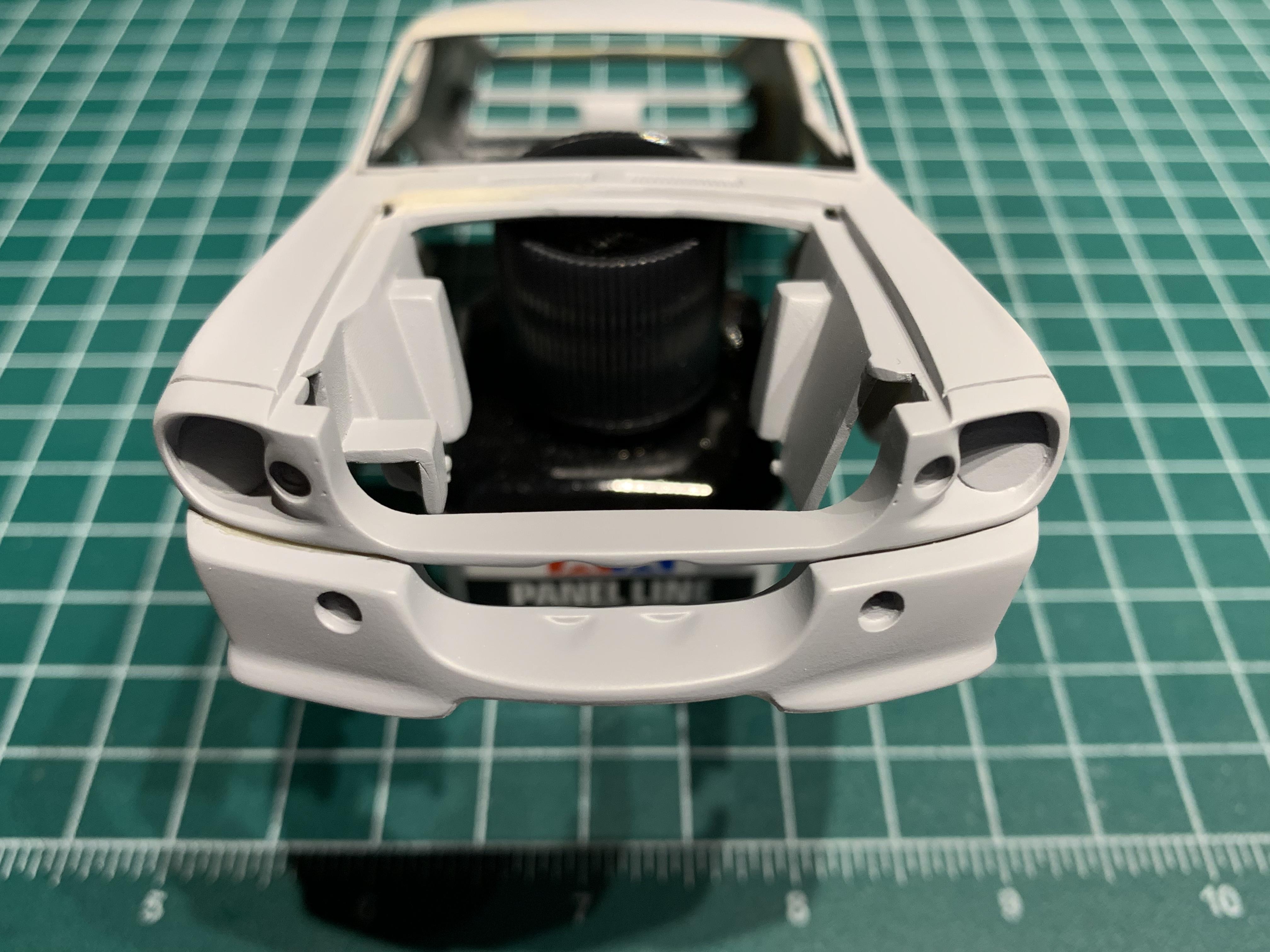

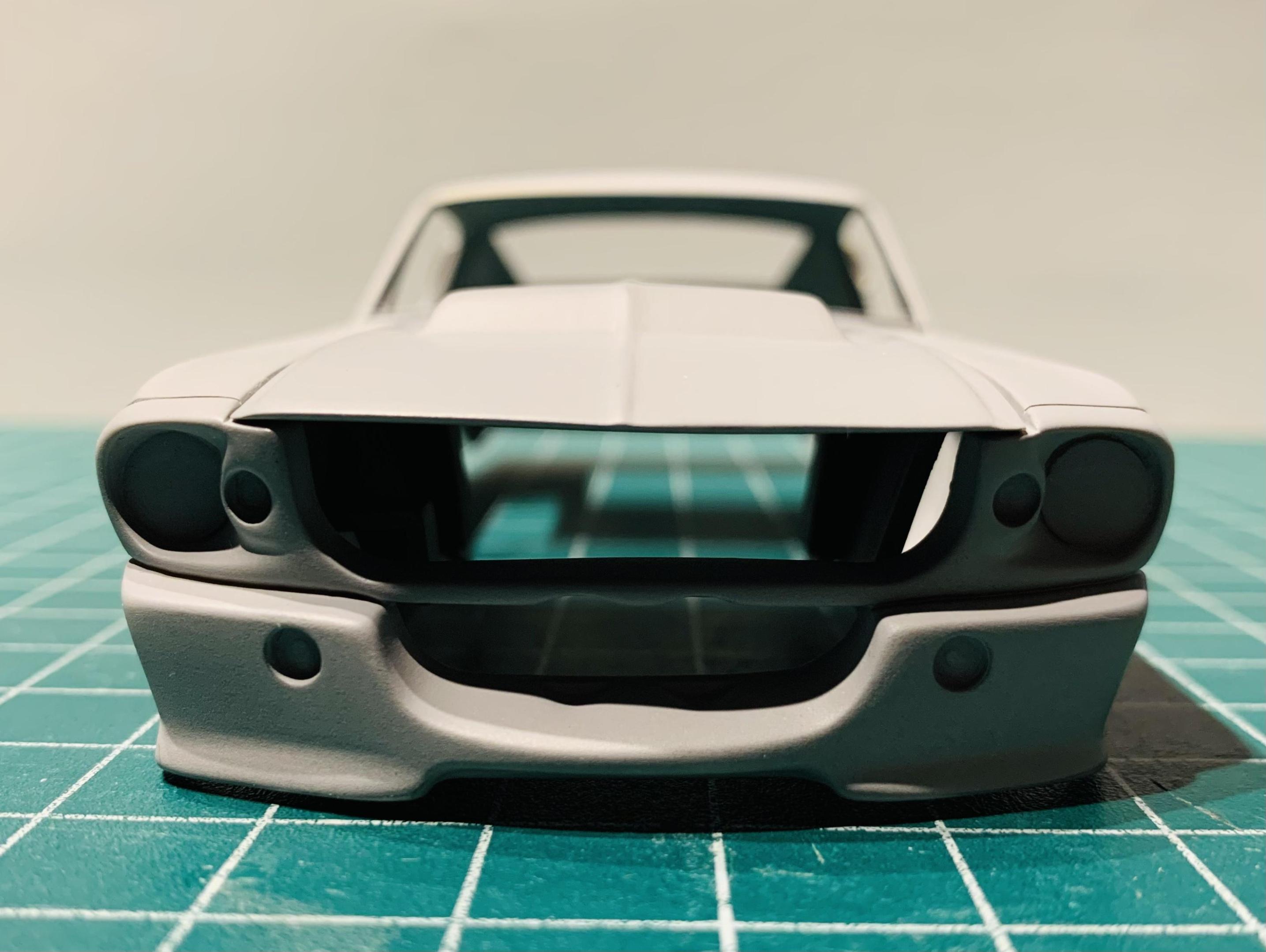

adamelvis Posted November 7, 2021 Author Share Posted November 7, 2021 Fairly pleased with the front end fix. Just need to sand out a few pin holes and then leave it be. Next job is to install the trunk hinges and the trunk alignment. 1 Quote Link to comment Share on other sites More sharing options...

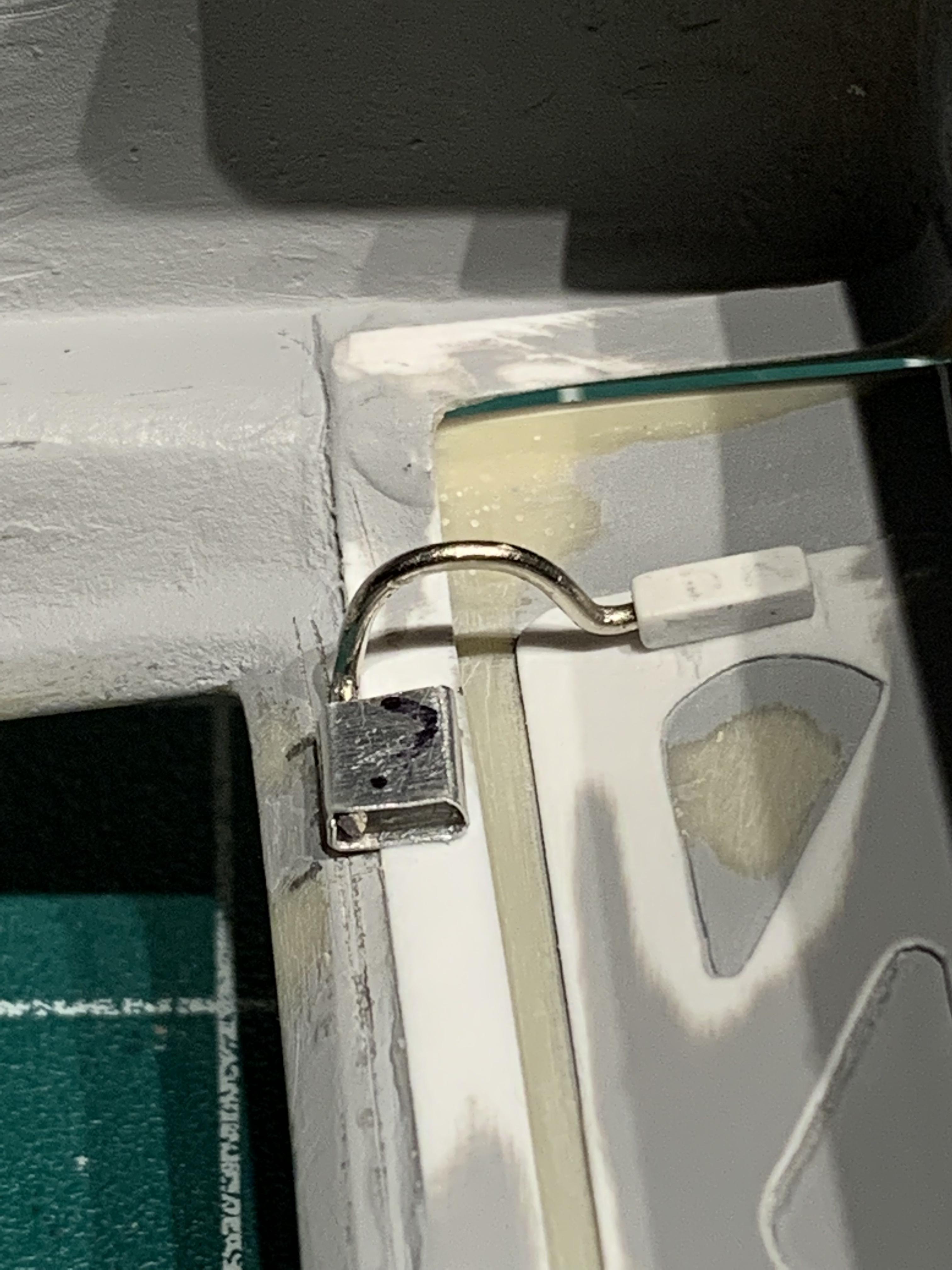

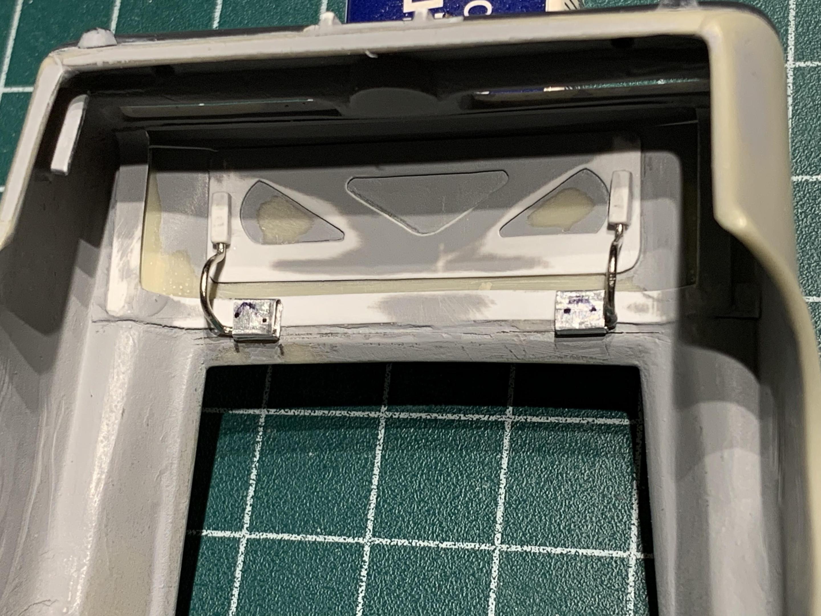

adamelvis Posted December 21, 2021 Author Share Posted December 21, 2021 Trunk Hinges.. ???? This has been very challenging. I have gone through 4 different variations on custom hinges for this car. The trunk lid is not flat and is shaped to the back contours of the 67' Mustang. Finally figured on a mount that allows you to slide it out and then flip it up. Have to get this thing working so I could display all the work and details that will be inside. Adam Quote Link to comment Share on other sites More sharing options...

David G. Posted December 25, 2021 Share Posted December 25, 2021 Nice work on the hinges. David G. Quote Link to comment Share on other sites More sharing options...

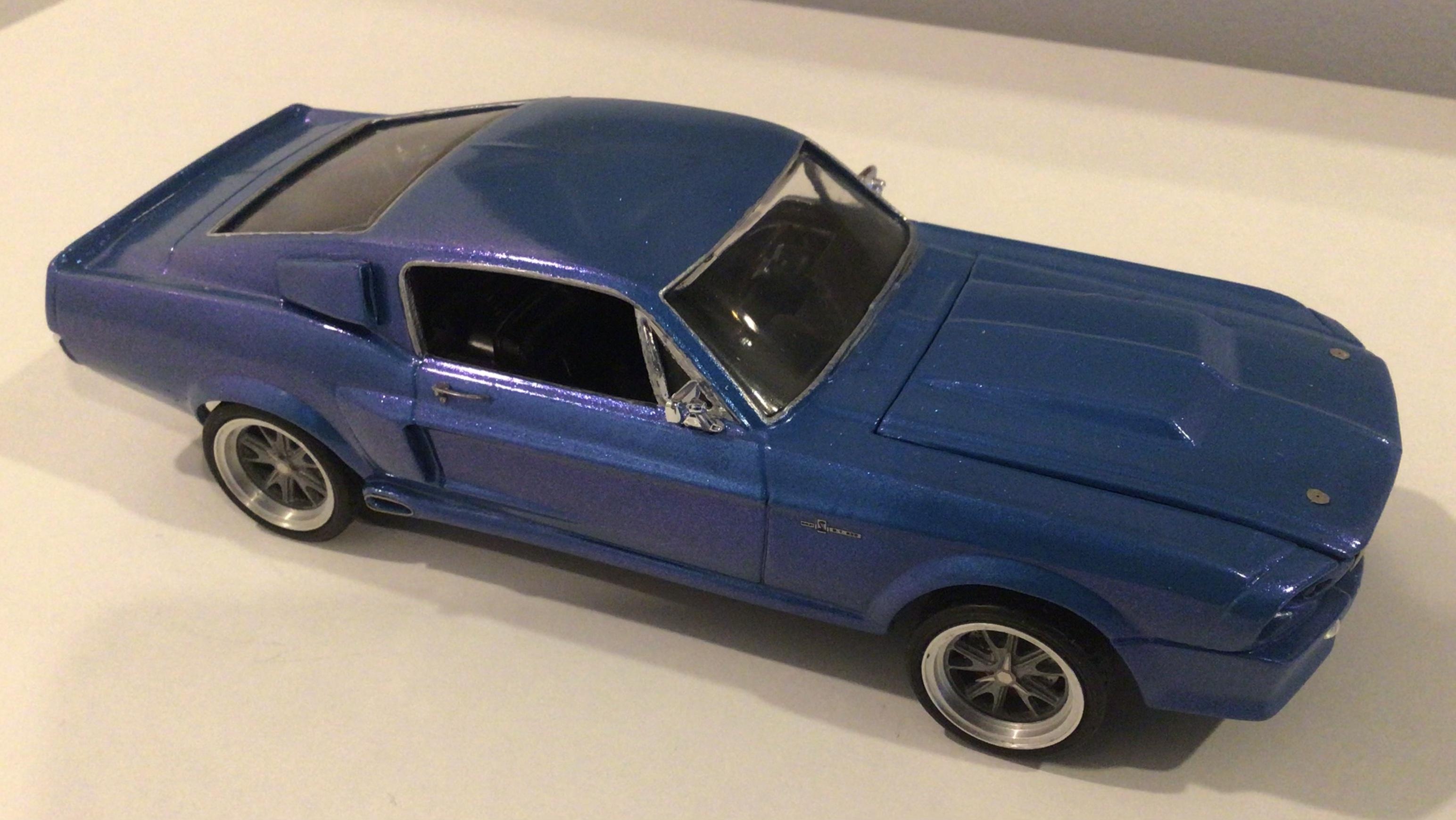

vamach1 Posted November 29, 2022 Share Posted November 29, 2022 (edited) On 5/3/2022 at 7:31 PM, adamelvis said: Hello Guys, Sorry its been a while since I posted on this build. I have been working on this project for 2 1/2 years on and off. It started to get to me after a while and was turning into work, rather than a hobby. It didn't seem like I was making any progress. SO, I figured I would take a break from Eleanor and start my Fast & Furious Paul Walker Tribute Project (3). First build would be the Mitsubishi Eclipse and I thought I could just bang this one out and say that I finally completed something..!! But, I have OCD and the need to add more detail to my builds, LOL. Well.... Six Months Later and this build is about 70% completed. Just need to paint the body, complete the engine details and do final assembly. You can check it out at my other topic under "Brian's 1995 Mitsubishi Eclipse from (The Fast and the Furious)" As for the Eleanor ...... I'm still working on her. LOL !! Stay tuned for updates and new photos. TCB, Adam Hope to see yours finished soon. I did not go crazy with my conversion kit and went a different route on color from the Foose build. I have seen a lot of clones in many other colors besides the metallic gray. I painted a very light coat of color shift paint over Ford blue. Edited November 29, 2022 by vamach1 1 Quote Link to comment Share on other sites More sharing options...

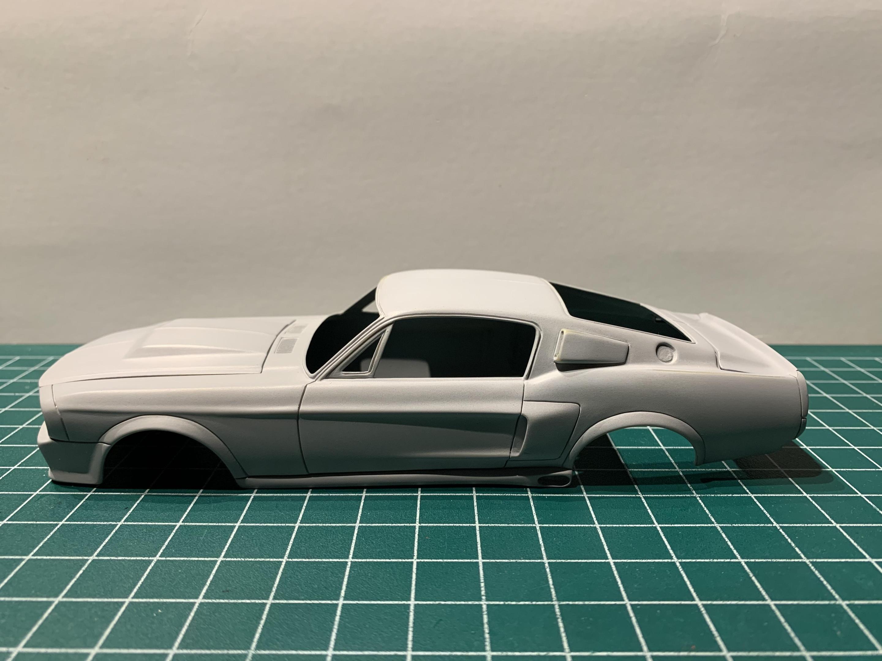

adamelvis Posted December 12, 2022 Author Share Posted December 12, 2022 Primed & Sanded. Ready for the Metallic Black base coat. Afterwards, I will be laying down the tape for the stripes. 2 Quote Link to comment Share on other sites More sharing options...
gman Posted December 12, 2022 Share Posted December 12, 2022 That is looking extremely good so far. I was impressed by the 1:1 when that movie came out, and it looks like you are doing that 1:1 justice. Quote Link to comment Share on other sites More sharing options...

David G. Posted January 22, 2023 Share Posted January 22, 2023 It's nice to see this one back on the bench. Looks great in primer. David G. 1 Quote Link to comment Share on other sites More sharing options...

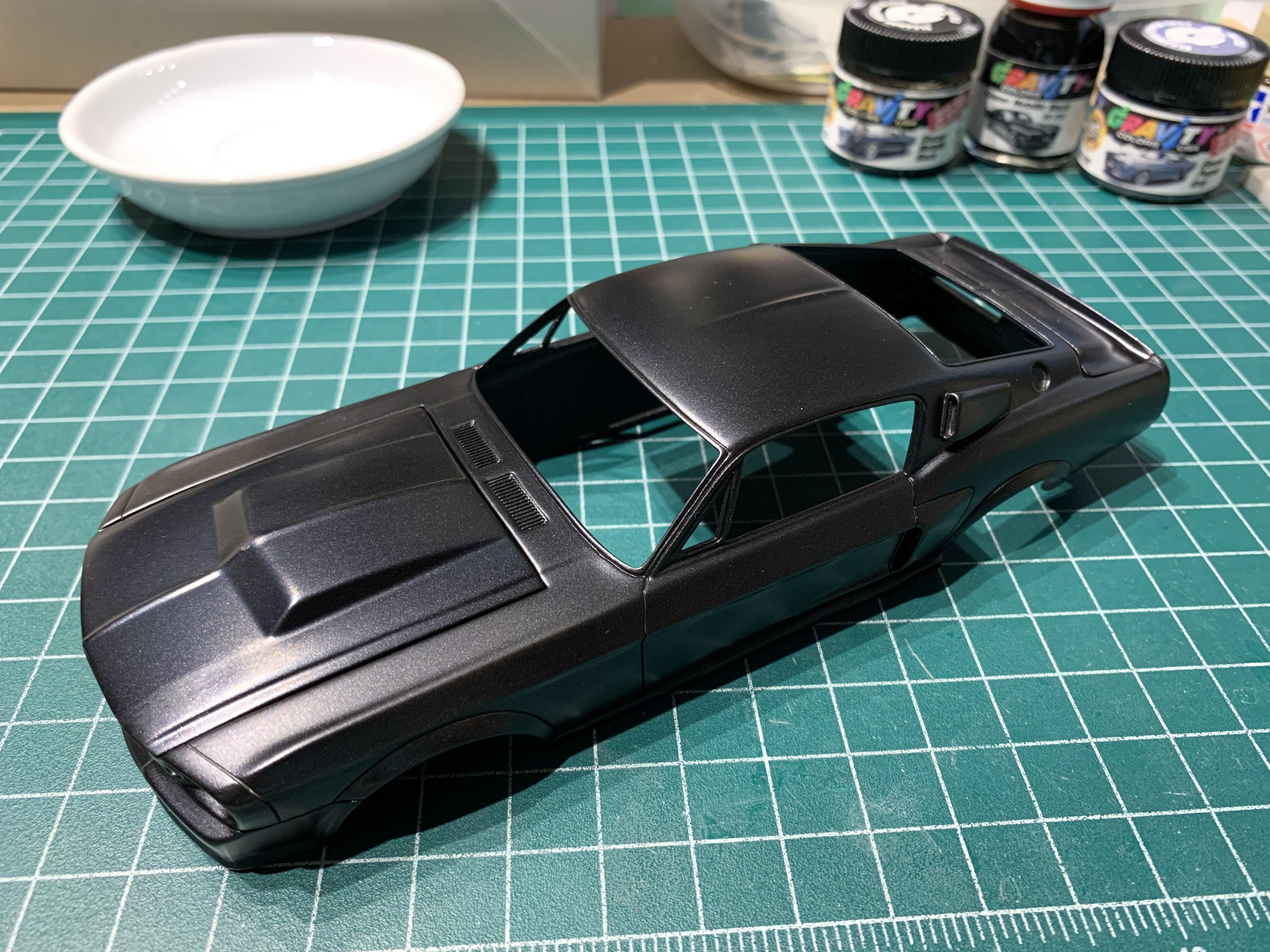

adamelvis Posted January 29, 2023 Author Share Posted January 29, 2023 Finally a colour other than Primer .. LOL! This is the first base coat of the “Eleanor Metallic Black”, which will be the colour of the stripes. Need to sand out a few dust particles and will spray another coat. Then I will lay down my stripes with tape. TCB. Adam 1 Quote Link to comment Share on other sites More sharing options...
David G. Posted January 29, 2023 Share Posted January 29, 2023 The bodywork looks nice and smooth under the paint. David G. 1 Quote Link to comment Share on other sites More sharing options...

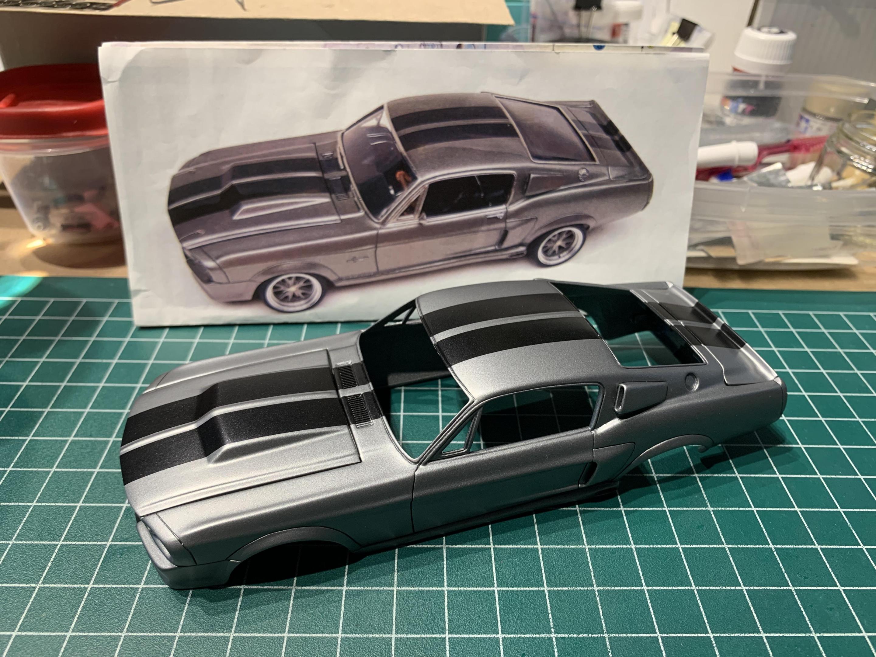

Mattilacken Posted February 16, 2023 Share Posted February 16, 2023 Sweet! 1 Quote Link to comment Share on other sites More sharing options...
speedy5963 Posted February 16, 2023 Share Posted February 16, 2023 Very nice build, love the detail work in this 1 Quote Link to comment Share on other sites More sharing options...

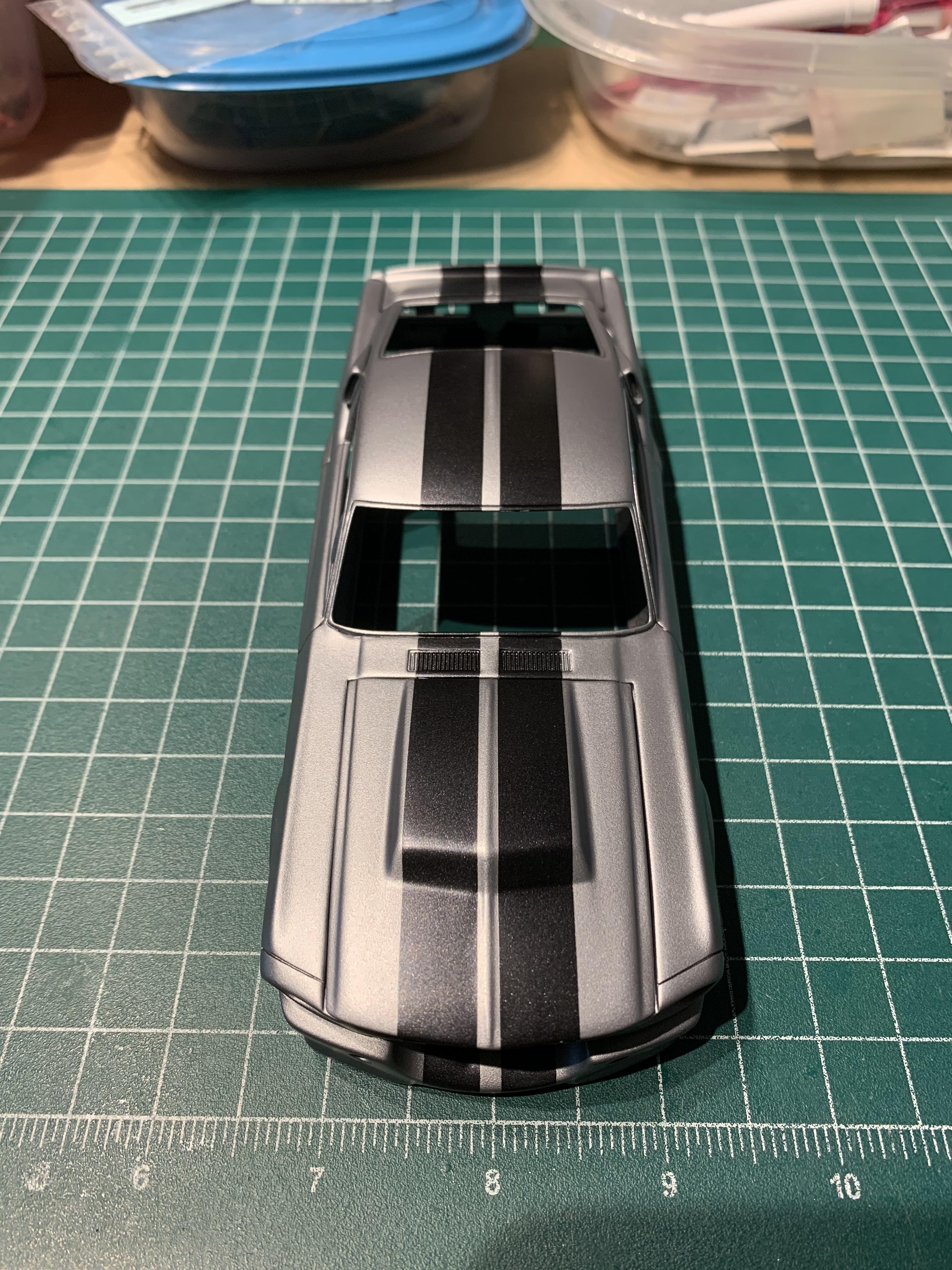

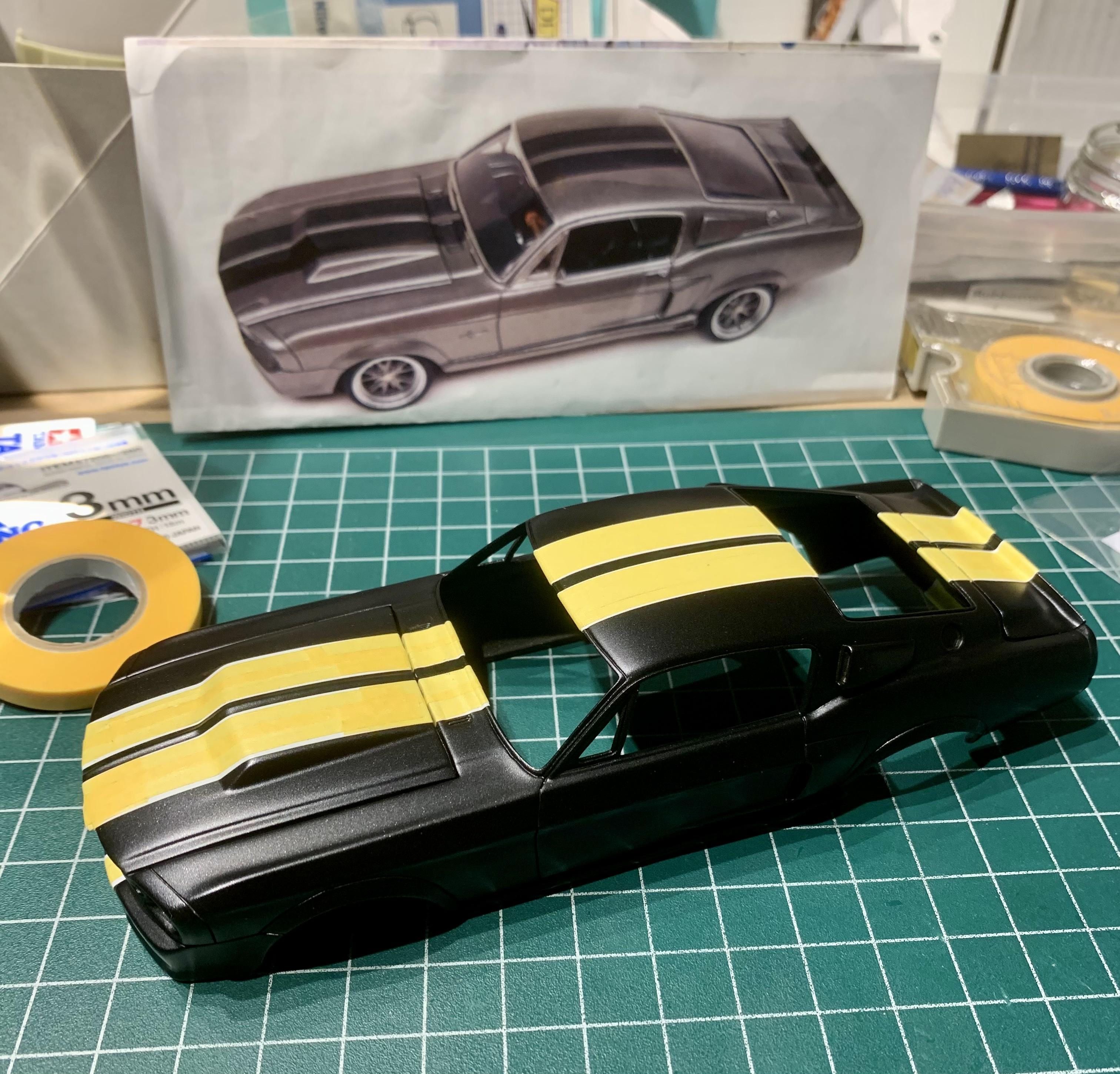

adamelvis Posted February 16, 2023 Author Share Posted February 16, 2023 Couldn’t be happier with the outcome of the stripes. Zero bleed through with the tape. I used a combination of Tamiya yellow Masking Tape and Tamiya Masking Tape for Curves. Next is the decals and then Gravity Colors 2K Clear Coat. TCB, Adam 3 Quote Link to comment Share on other sites More sharing options...
KWT Posted February 17, 2023 Share Posted February 17, 2023 That's coming together nicely 1 Quote Link to comment Share on other sites More sharing options...
