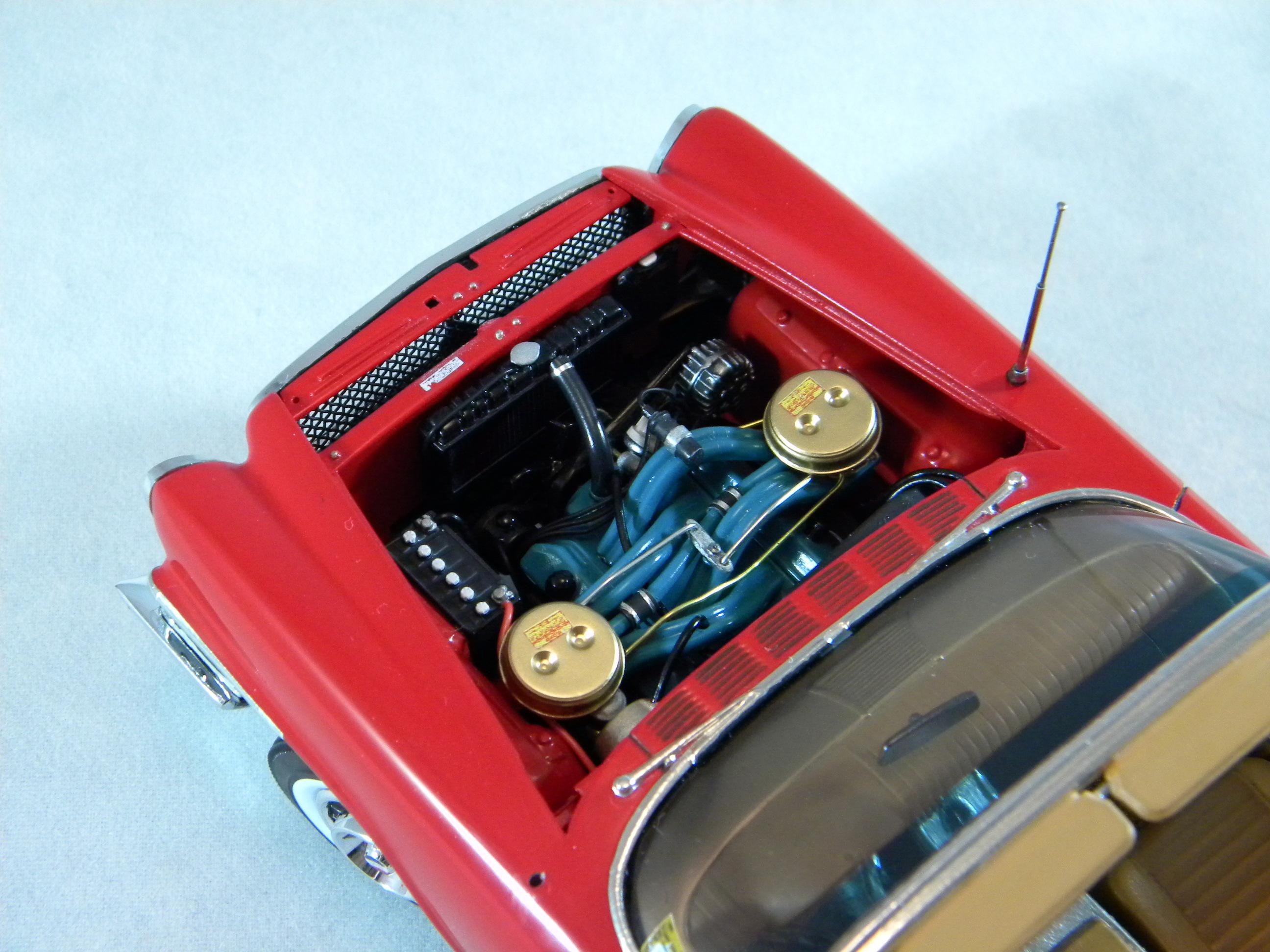

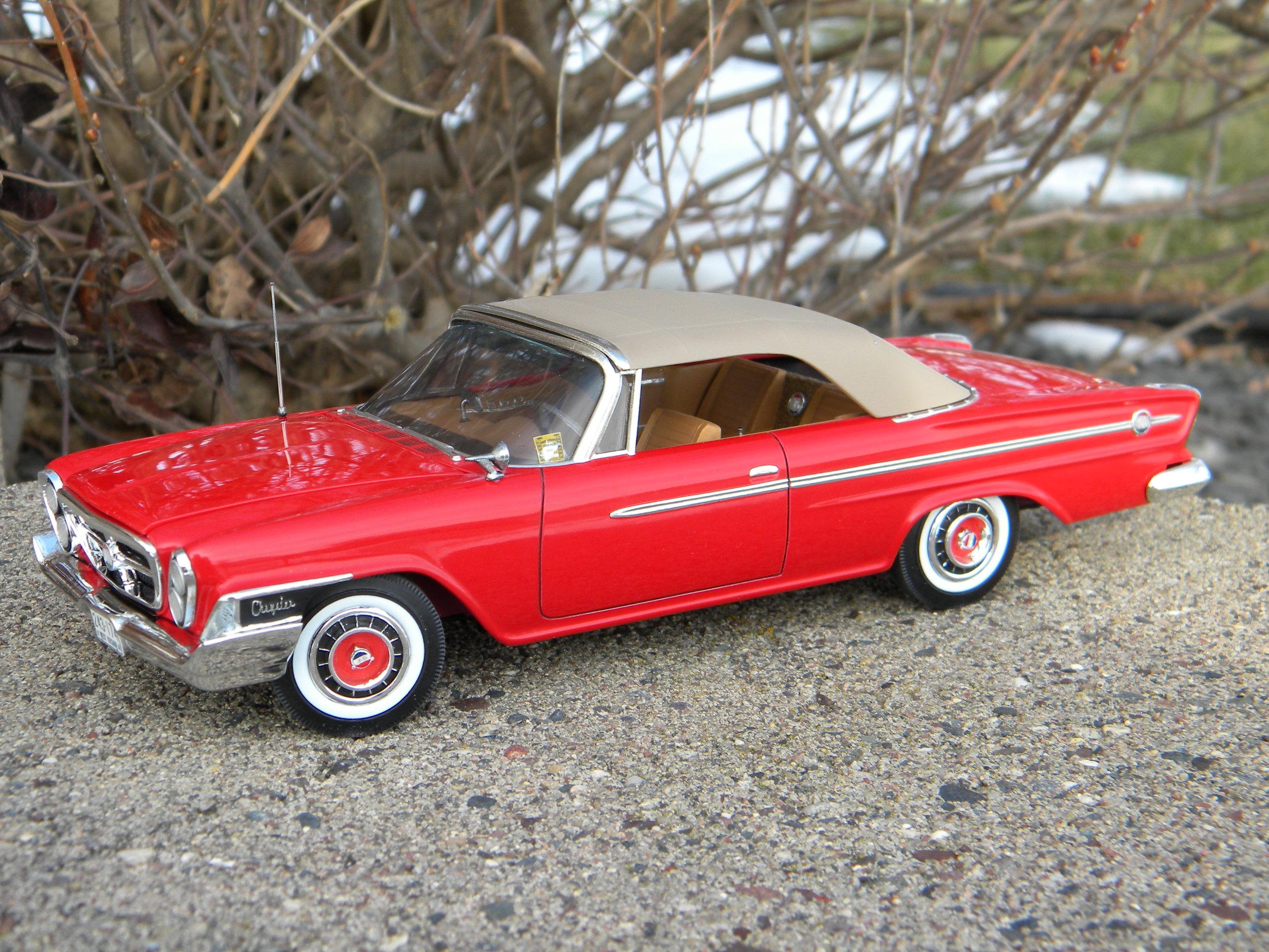

StevenGuthmiller Posted January 22, 2020 Posted January 22, 2020 One of my most successful restorations was probably a Johan '62 Chrysler 300 that I received on a trade from Al Rich, (thatz4u) It was in relatively nice condition, but still required a good amount of modification to look right, especially in regards to the convertible up top. Steve
Scott8950 Posted January 22, 2020 Posted January 22, 2020 39 minutes ago, StevenGuthmiller said: One of my most successful restorations was probably a Johan '62 Chrysler 300 that I received on a trade from Al Rich, (thatz4u) It was in relatively nice condition, but still required a good amount of modification to look right, especially in regards to the convertible up top. Steve A local 4x4/ performance shop has one of those engines in the showroom, its complete with intake, carbs, and air cleaners. They have a 426 hemi complete but its got a hole in the block from kicking a rod out.

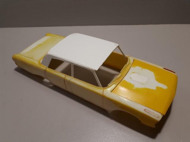

Alan Barton Posted January 22, 2020 Posted January 22, 2020 Yeah, definitely a big fan of the restos! Tom, that 57 custom is exactly the combination of parts that I used on my very first 1/25th scale build, after graduating from 1/32 scale Lindbergs, Pyro, Aurora and Airfix.. Many of the hot rods in my collection are restos as it was the only way I could afford a copy, especially in the eighties before all the re-issues. My latest build is for our annual club diorama. We are going to do multiple themes of American Graffiti. I had been given a gluebombed AMT Galaxie - the body, hood with a hole, and the complete weirdly painted interior. I have no idea what year this Galaxie is because Every single chrome trim, body line or moulding had been filed from the body!!!!! It could be a 61,62 or 63 - the experts here may be able to tell. I have a mint 63 chassis that will go under it but as you can see, i have started roughing a 4 door Town Sedan roofline so that I can do the iconic rear-axle-ripped - from - the-police-car-scene. Got a long way to go but near enough WILL be good enough for this project and I don't have to pay eBay prices to get started.

Alan Barton Posted January 22, 2020 Posted January 22, 2020 Thanks Steve! I will use that photo to correct the mouldings around the front. At this stage I only have the custom grille for a 63 to fit into the front but I have til July to find a 61 - I do have a childhood build of the 61 convert so maybe I should resin cast that one? In the diorama it will be standing on it's nose as the rear axle leaves the building , cops at the wheel and a bit of smoke and dust from underneath. Looking forward to it - it's been fun so far! Cheers Alan

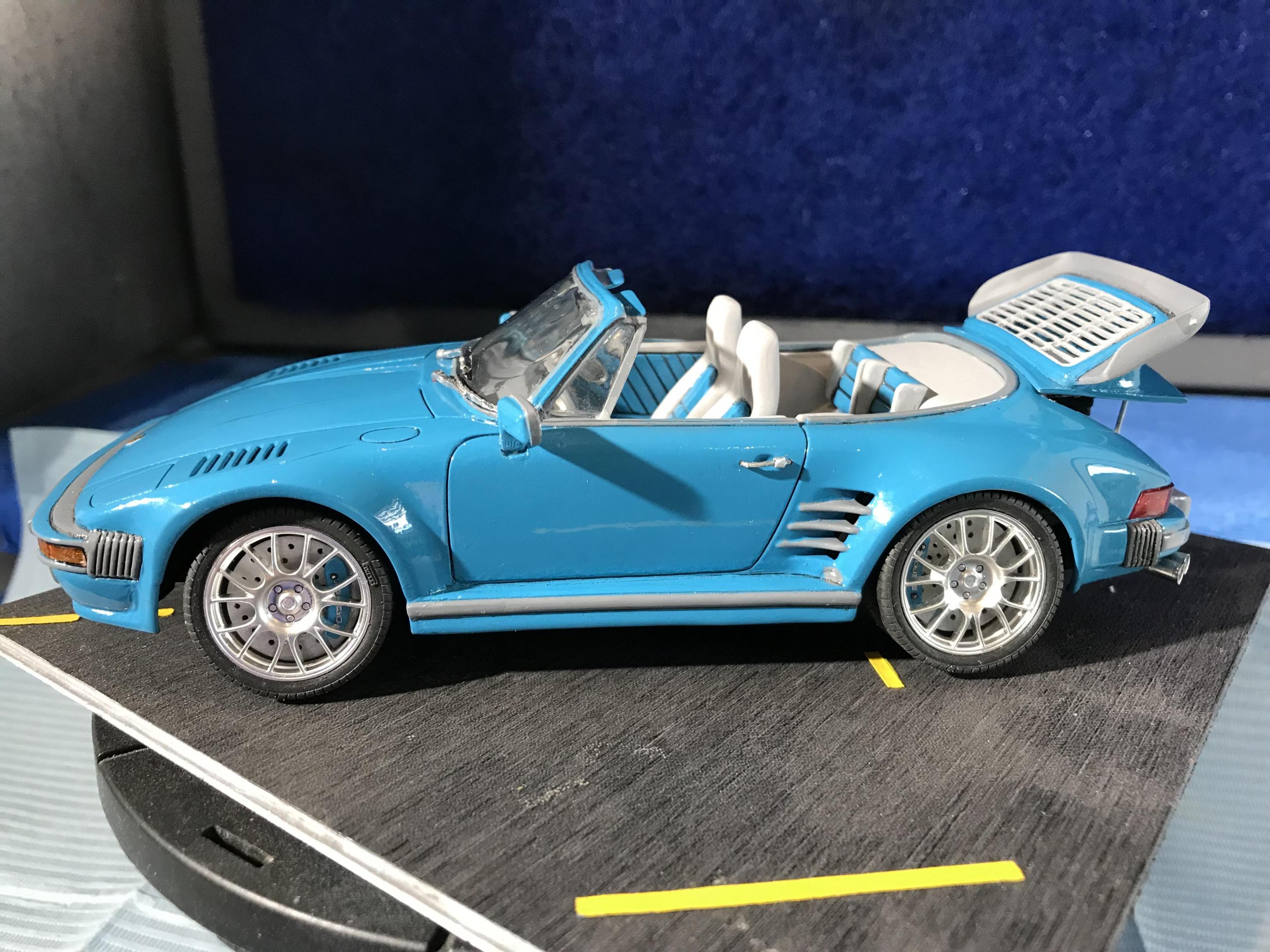

Twokidsnosleep Posted January 23, 2020 Posted January 23, 2020 I enjoy doing the glue bomb rescues as well. Perhaps I like torturing myself. I am doing an a/c Cobra on here right now and did this Porsche Slant nose a year ago. Actually I use the opportunity to try out new things and techniques I resin cast the rear deck for the Porsche, made brake disks and callipers and pretty much remade the running gear in brass.
Snake45 Posted January 23, 2020 Posted January 23, 2020 1 hour ago, Twokidsnosleep said: I enjoy doing the glue bomb rescues as well. Perhaps I like torturing myself. I am doing an a/c Cobra on here right now and did this Porsche Slant nose a year ago. Actually I use the opportunity to try out new things and techniques I resin cast the rear deck for the Porsche, made brake disks and callipers and pretty much remade the running gear in brass. I remember that! It was a GREAT rebuild! I have the same kit, also missing the engine lid. Another member here donated a second glue bomber (with lid) to the cause, so now I have enough parts to build up at least one, and almost enough to do a second, if I had the rear deck. Oh well.
Twokidsnosleep Posted January 24, 2020 Posted January 24, 2020 On 1/22/2020 at 5:19 PM, Snake45 said: I remember that! It was a GREAT rebuild! I have the same kit, also missing the engine lid. Another member here donated a second glue bomber (with lid) to the cause, so now I have enough parts to build up at least one, and almost enough to do a second, if I had the rear deck. Oh well. If I could cast that rear deck well enough to appease my OCD I would do it for you in a heart beat It just isn’t 100%, one of the reasons I have it propped open there are aftermarket Porsche rears and wings
Bugatti Fan Posted January 27, 2020 Posted January 27, 2020 Scott, I really like what you have done to that old Porsche model. Not only the restyling but also your choice of colour scheme. Funnily enough I have an old Revell Porsche Targa Snapkit that one of my kids made (badly) about 25 years ago in my stash. Got me thinking! I also have the remnants of an Airfix Lotus Cortina that I attempted to customise way back in the 60's. Now that my skills have improved over the years I will be attempting to restore it back to how it should look.

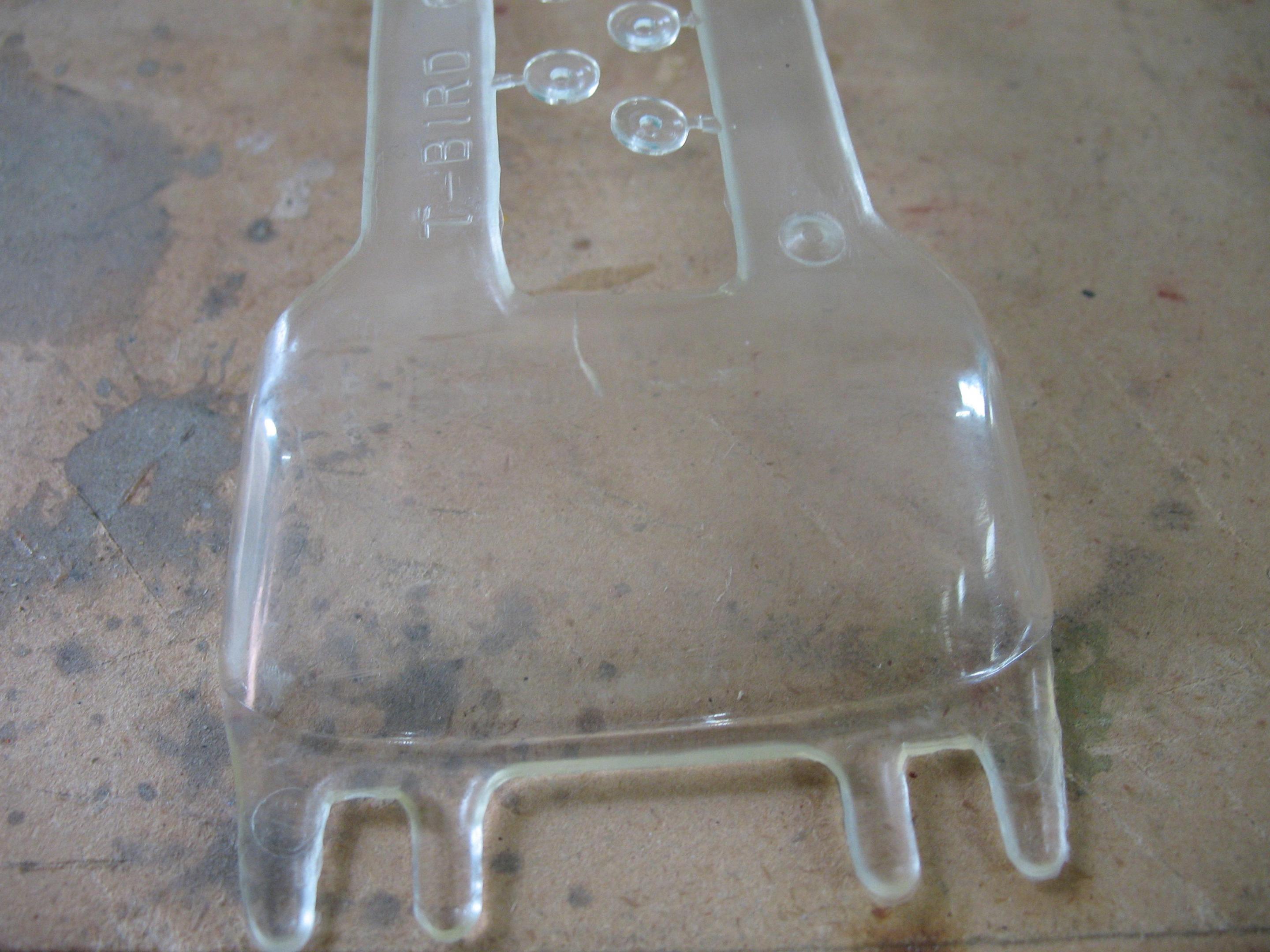

Mike999 Posted January 27, 2020 Posted January 27, 2020 Not strictly a restoration. But I just learned something that may help others doing restorations: some old AMT promos are built to survive nuclear war. Another board member needed some parts from a '62 T-Bird hardtop. I've had that promo for a long time, to part out so I can build a "mainstream" hardtop. Using the newer AMT '62 T-Bird kit and a resin hardtop body, promo hubcaps etc. Collectors may have heart attacks, but '61 to '63 T-Bird promos are plentiful and fairly cheap, even on eBay. I thought it would be simple: just remove the 4 screws and everything will fall apart, right? Wrong! Those promos were mostly put together by heat-swaging; melting the plastic together. Getting the interior out required cutting thru 4 plastic "washers" that were melted to it. The rear bumper/tail lights were a real challenge. The tail lights pass thru the back bumper, into round tabs molded into the body. Then they're heat-swaged to that tab. The tail lights are pretty delicate parts. I carefully scraped at them with a knife until they released from the round tab. The dashboard is also heat-swaged into the interior. I want to save the swing-away steering wheel for the conversion. Some good news, I guess: the engine isn't molded as part of the chassis. It's an insert, so if you can remove it, you basically have a kit chassis you can drop an engine into. It appears to be heat-swaged AND glued in. And some weird news. Even though this was a promo, the 4 custom headlights from the kit are on the glass. You can see them in this shot of the back window:
Twokidsnosleep Posted January 28, 2020 Posted January 28, 2020 (edited) 11 hours ago, Bugatti Fan said: Scott, I really like what you have done to that old Porsche model. Not only the restyling but also your choice of colour scheme. Funnily enough I have an old Revell Porsche Targa Snapkit that one of my kids made (badly) about 25 years ago in my stash. Got me thinking! I also have the remnants of an Airfix Lotus Cortina that I attempted to customise way back in the 60's. Now that my skills have improved over the years I will be attempting to restore it back to how it should look. Splash Miami Blue...lovely paint was looking for a beach/ surf vibe with it Edited January 28, 2020 by Twokidsnosleep
