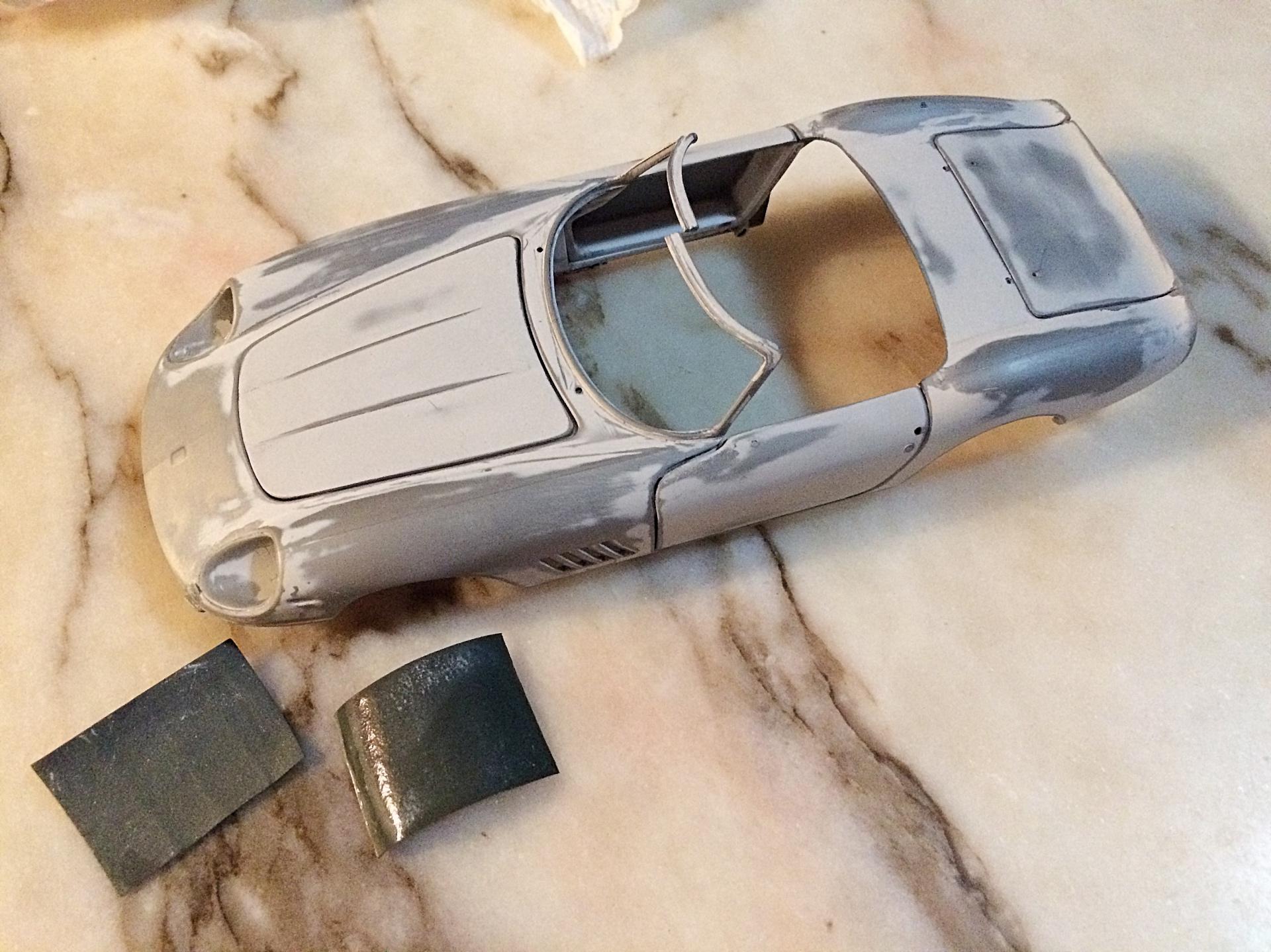

I just started using this, but the grey version in the bottle, with lacquer thinner.  Hobby Lobby does not have the white.  I'm posting this disaster to show how brake fluid does not exactly have as much effect as other paints.  I was very impressed how it stuck to the body.  So far, so good!
So the bottled primer performed well, and had nothing to do with the reason for stripping the paint?
Thanks.
Correct.  I screwed up with the color layer.  I was a bit concerned when airbrushing, appeared lumpy orange peel, but when it cured, leveled out.  I have a little project to brush paint this primer, so will give a report if you want.

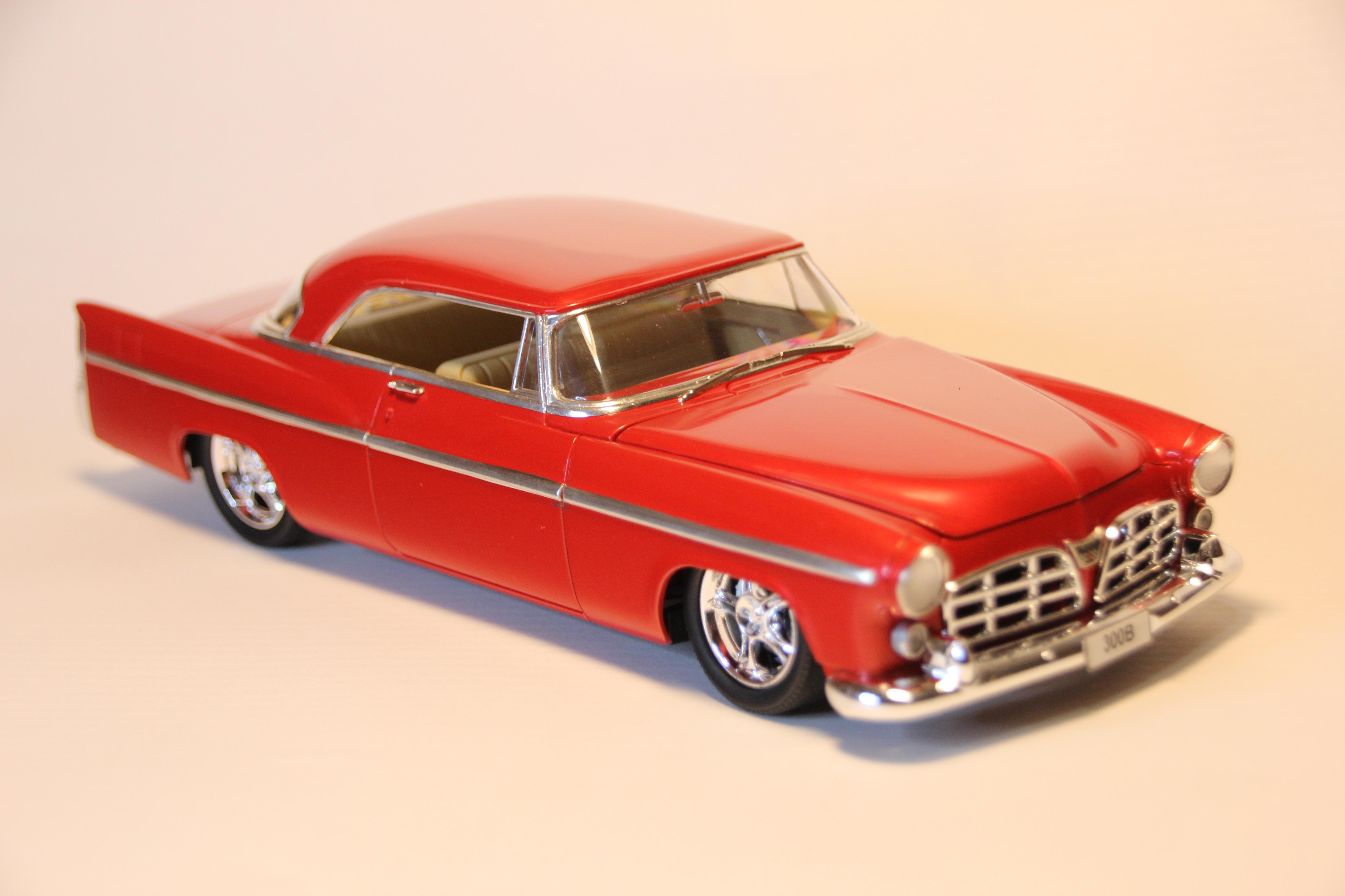

300B below was painted with white primer and mica red all from bottles. Also clear coated with Tamiya lacquer clear and polished out
Doesn't look too shiny in pix but it is
