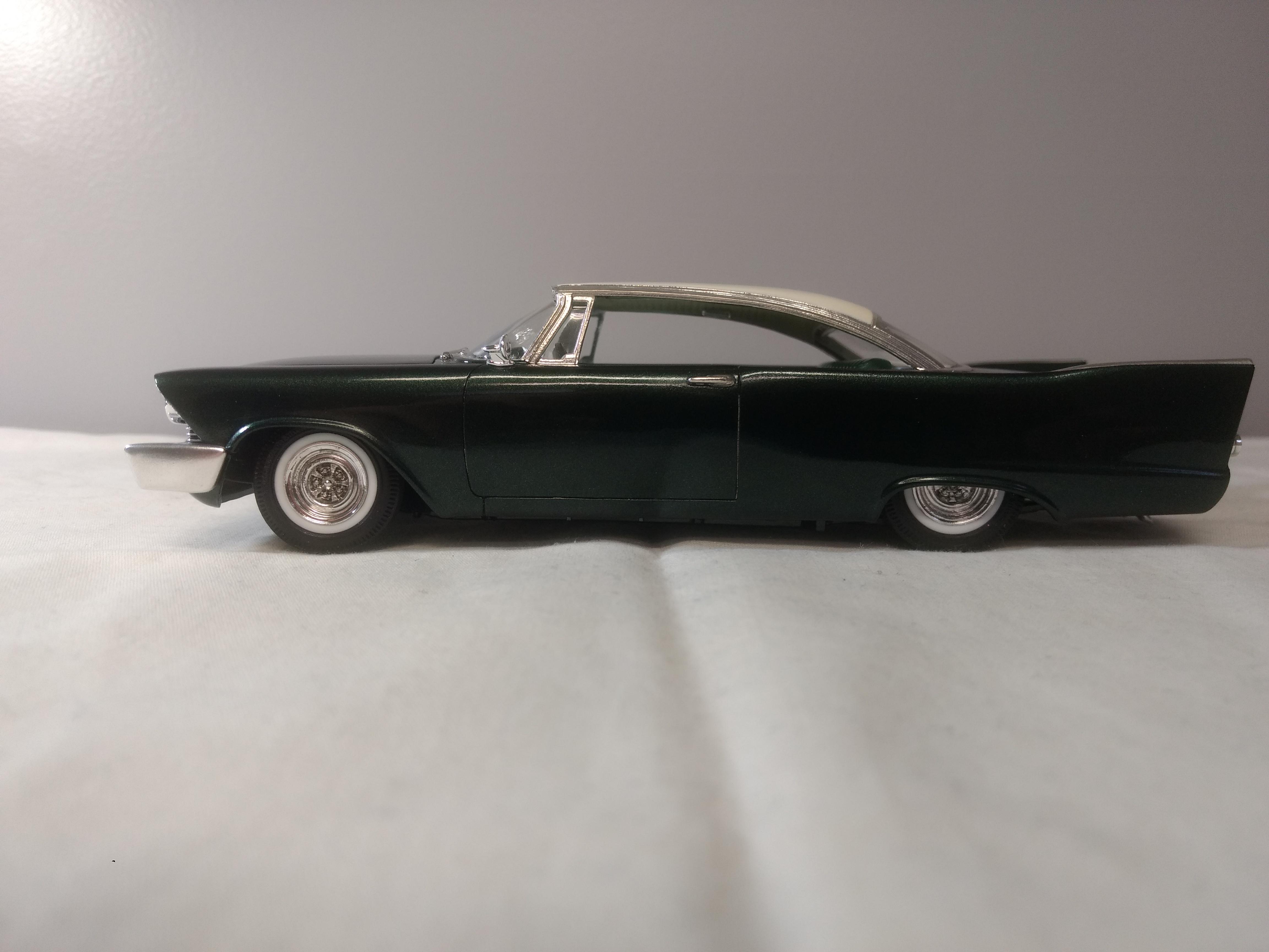

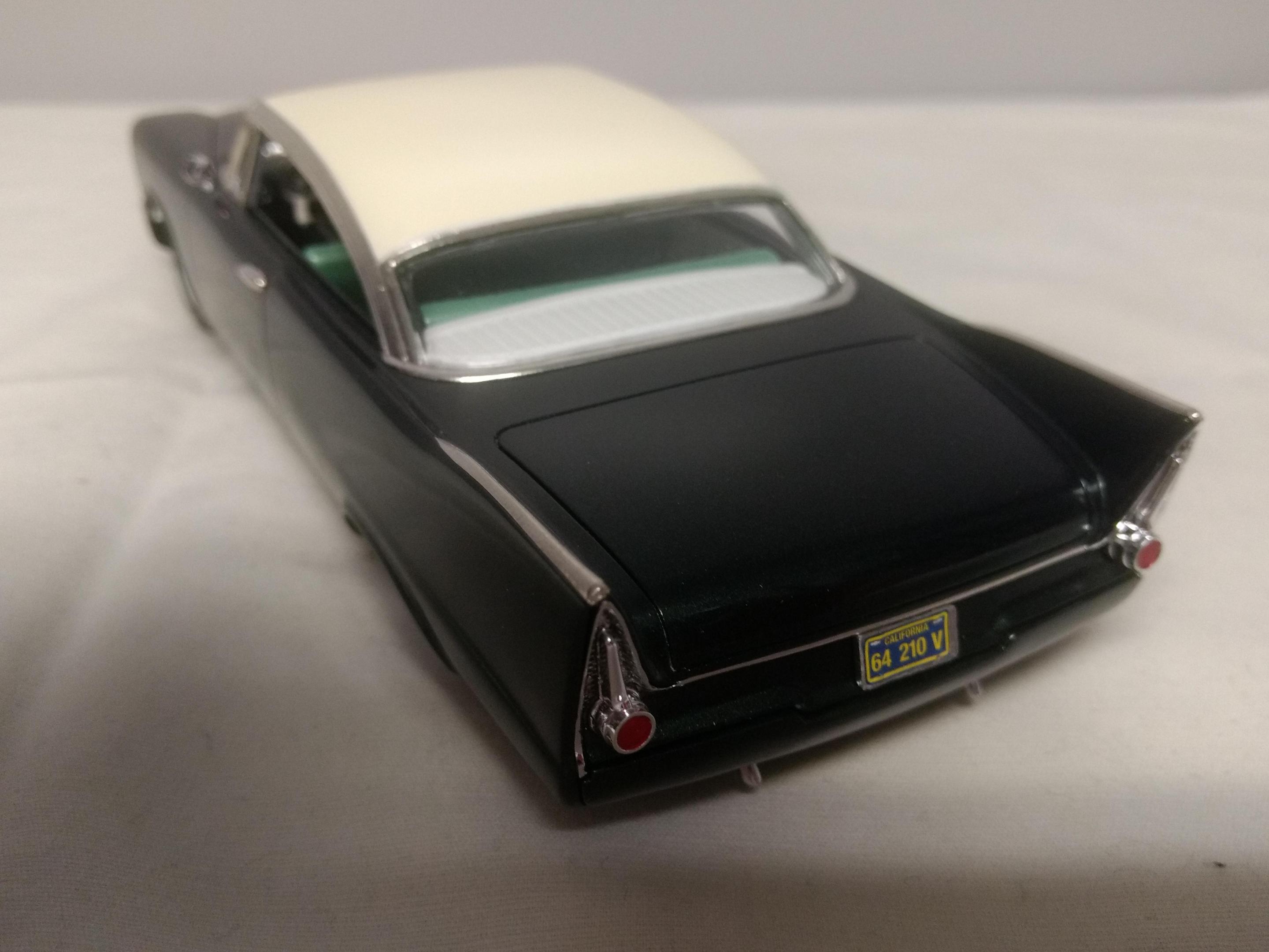

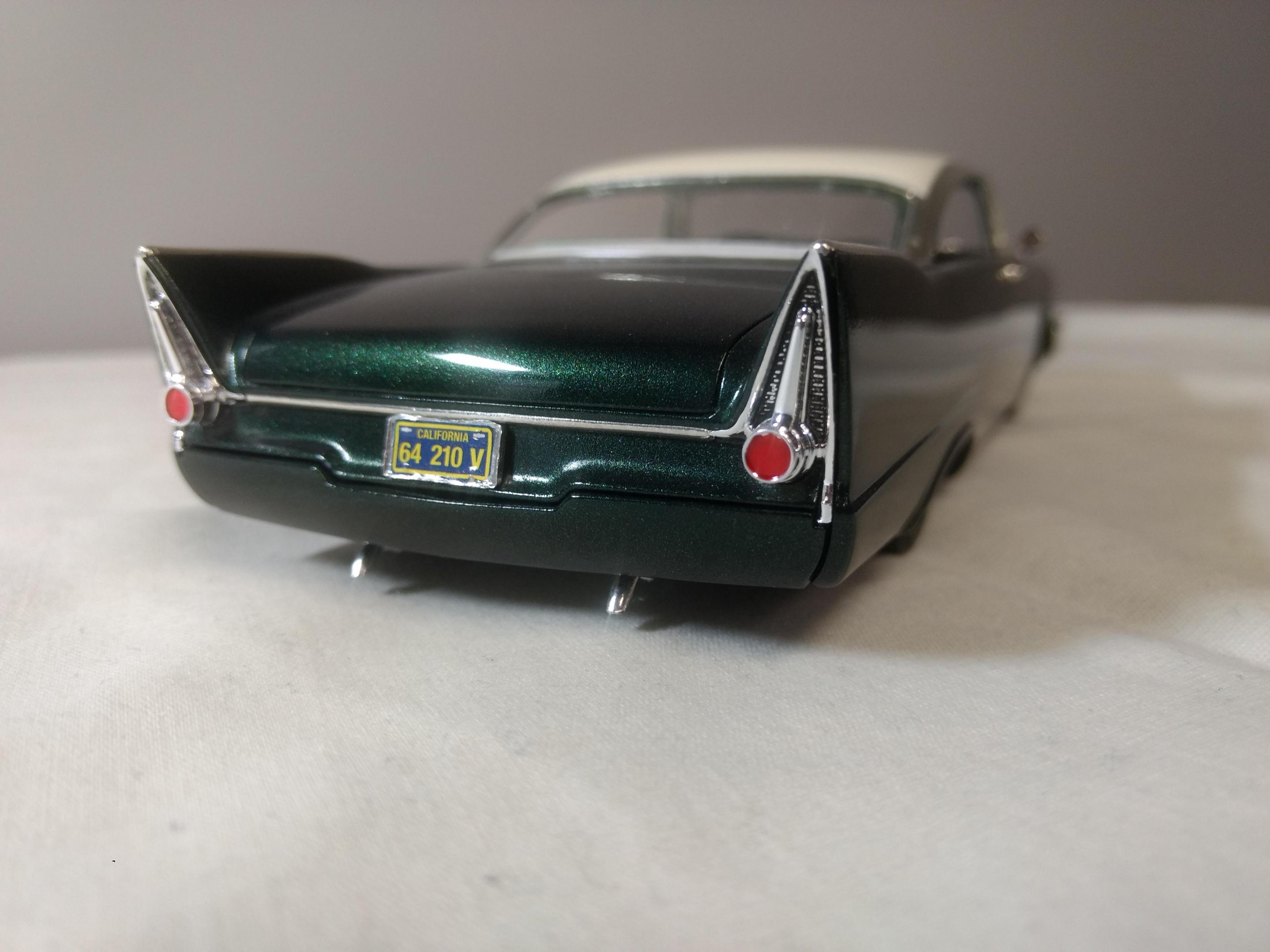

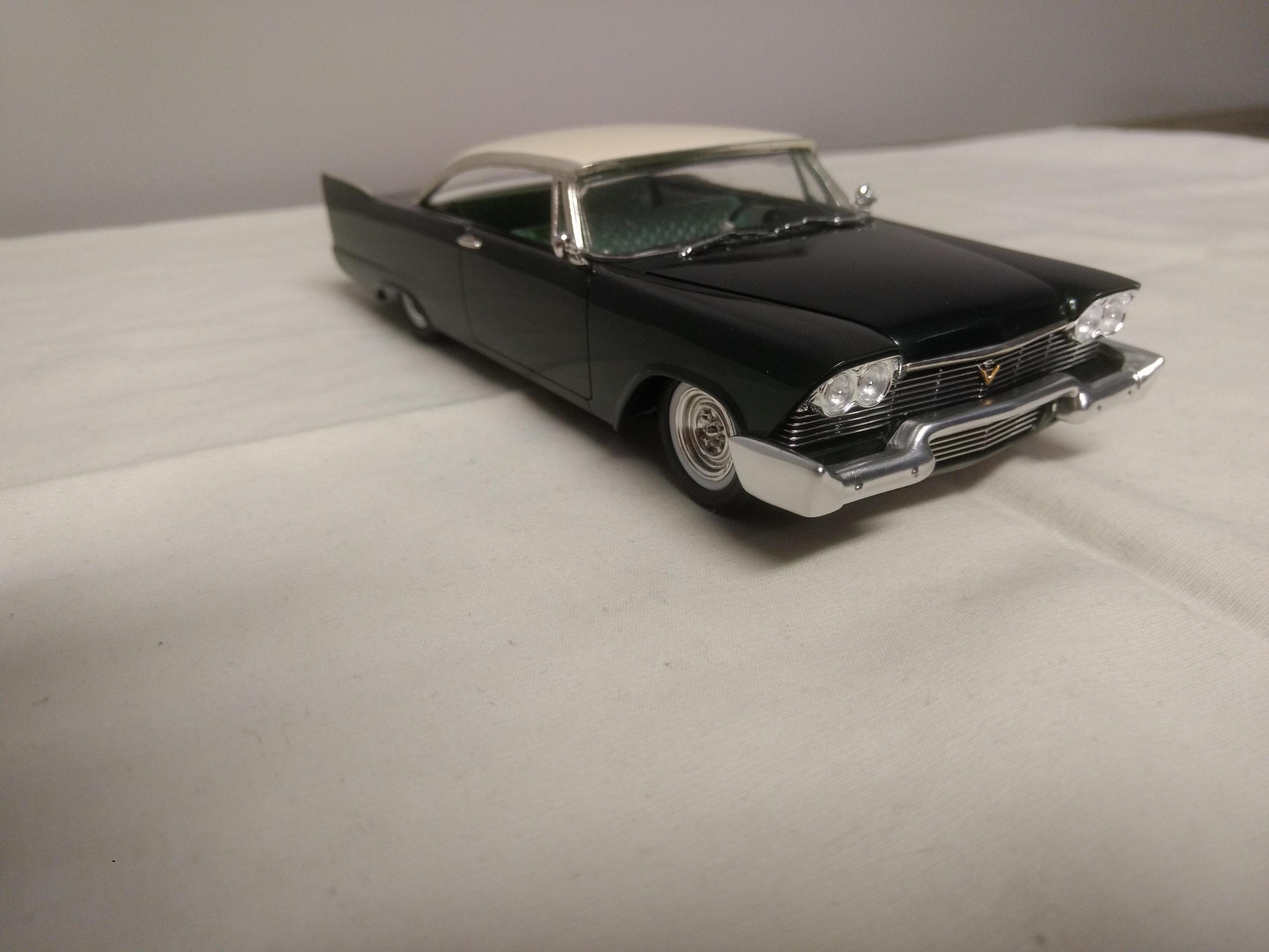

asfastasu Posted April 10, 2020 Posted April 10, 2020 Bought this kit at a swap meet and immediately tore into it. I was inspired at the time by Steve Bouttes? custom Oldsmobile he was building in a dark green. Don't think I reached his quality but I tried?. Shaved the side trim and most everything else, except the door handles. Lowered it quite a bit, had to raise the driveshaft tunnel in doing so. Removed the rear bumper and wish I would've filled in the rear roll pan. This too, was a strip and repaint as the testors clear I used was an older can and wouldn't dry, even after sitting for 2 weeks. The paint is a duplicolor GM pearl green touch up paint from Canadian Tire cleared with Tamiya ts13. The roof is Tamiya racing white. The interior was flocked and the rear and front seats are the custom pieces from the 62 Pontiac Catalina. The door panels and rear package tray have tuck n roll made from Plastruc panels. The engine is the kit supplied mess. It looks mainly like a big block Mopar to me so I modded the intake to resemble a big block and added the distributor to the front and added my own cast copies of Johan air cleaners from the 62 Chrysler 300 kit. I made my own Lucas style headlights using pieces from the same Catalina kit, the wheels too. I can't stand the front bumper and wish I would've done something different, I might still change it eventually. Was aiming for an early sixties custom. 1
Can-Con Posted April 10, 2020 Posted April 10, 2020 Cool. ??? Fun sanding all that side trim off, eh? When I did mine I used a Dremmel with a small 80 grit drum ,, wish I had a belt sander for it at the time, it was so thick !
asfastasu Posted April 11, 2020 Author Posted April 11, 2020 Thanks guys. Yeah, lot of work taking that side molding off. I think I used a chisel tipped exacto blade to get the bulk of it off.
Tom Geiger Posted April 11, 2020 Posted April 11, 2020 (edited) I like it overall, very cool custom! Per your comments on a different front treatment, I would suggest losing the center of the bumper for a top to bottom grill look and then reduce the mass of the remaining bumperettes to tuck them in. Edited April 11, 2020 by Tom Geiger

asfastasu Posted April 11, 2020 Author Posted April 11, 2020 2 hours ago, Tom Geiger said: I like it overall, very cool custom! Per your comments on a different front treatment, I would suggest losing the center of the bumper for a top to bottom grill look and then reduce the mass of the remaining bumperettes to tuck them in. Thanks, that's a possibility. I was also considering a bumper from a 57 Fury, which I think, is available in resin.

stitchdup Posted April 11, 2020 Posted April 11, 2020 Very cool, it looks very slick with the trim removed

crazyjim Posted April 11, 2020 Posted April 11, 2020 Very nice build. Looks so much better with the side trim removed.
espo Posted April 11, 2020 Posted April 11, 2020 I like the way you built your custom here. You mentioned the rear roll pan, but I think it looks fine. Sanding the large expanse of the body sides must have been fun. The paint finish is also smooth and looks great. As an aside on the engine. Your engine matches the appearance of the one year only 350 cu in 305 hp 2 four barrel engine. In '59 they increased the bore and became the 361 cu in with the same horsepower rating and a single 4 barrel. This engine was also offered in two versions for '60 with the option of duel four barrels and 310 hp. This block also had another bore increase too 383 cu in. The standard 383 with a single 4 barrel was rated at 325 hp with a 2 four barrel option both rated at 330 hp. The top 2x4 option had a torque rating of 469 lbs @2800 rpm and was called the Ram. The normal 2x4 had a torque rating of 425 lbs @ 3600 rpm. With a difference of 44 ft lbs and at a 800 lower rpm you have to wonder what all they did with the Cam and Heads. This information is from one of my old Motor's Auto Repair manuals copyrighted 1962. More information than you might want, but you got the engine correct on this.
