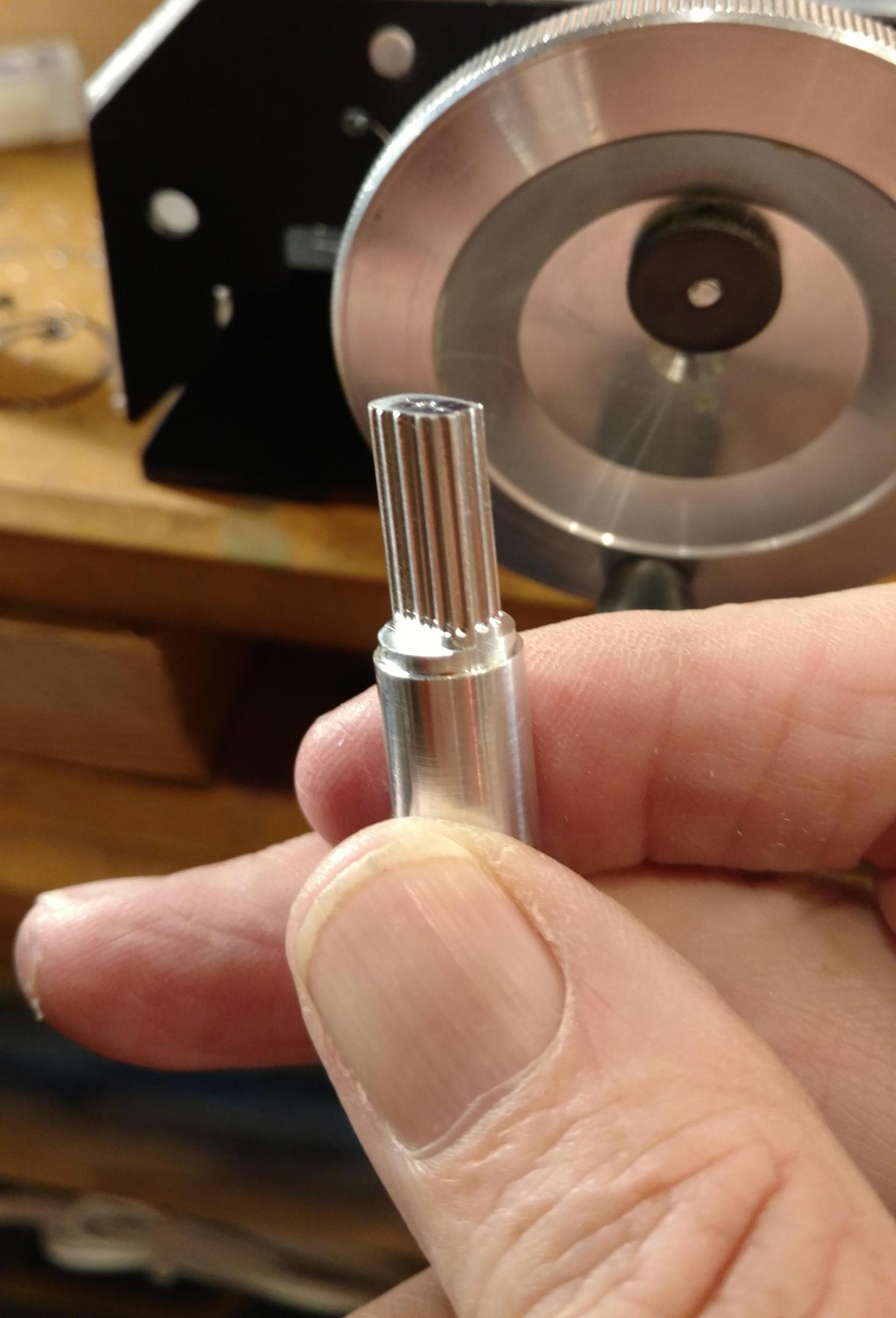

Pete J. Posted May 6, 2020 Posted May 6, 2020 11 hours ago, Bugatti Fan said: The Sherline history is interesting. I read about how the company was formed originally in Oz. I had a brochure of theirs some time ago from a UK distributor, but not heard anything of them being available in the UK over recent years. I guess they are not being marketed in the UK at present. If they do not make metric machines there is probably very little demand on this side of the pond! I must admit that I am a little surprised that the US is still using the inch system after all these years. The UK went over to Metric in the early 70s. The funny thing was that in the early days many of the 'metric' drawings were simply converted from imperial, and phased out as new products were actually designed in metric. I was brought up on Feet and Inches but now find metric so much easier to use. We also at about the same time decimalised our currency from pounds, shillings and pence to the present system of 100 pence to the pound. The old system was so cumbersome with twenty shillings to the pound and twelve pence to the shilling equating to 240 old pence to the pound! Yes Sherline is available in metric. As long as I have know metric machines have been available. It is just a matter of fitting both the mill or lathe with a differant lead screw and saddle nut. No need to change anything else. The hand wheels are the same for both metric and english measurements. This brings up and interesting point. I always work in tenths, hundredths and thousandths, so factors of 10 just like metric so the metric system has no advantage with this kind of work. Now if we were working in fractions rather than decimals, that is where the english system is complex and if you get into feet, yards and miles then it becomes much like the old currency issues. Just stay with inches and decimals of inches and it works fine. Since you are a Bugatti fan I thought I would close on something that is currently on the bench.

Pete J. Posted May 7, 2020 Posted May 7, 2020 1 hour ago, IbuildScaleModels said: HAHA Pete! I agree that the sherline is a hobby machinist's tool that can be useful for fabrication of other tools and parts. But of course it raises the question... more money to give room for expansion? Or less money for a tool that does exactly what it needs to be used for? It's a tough ballpark to be in... Hell I am even debating financing one, not my favorite option, but from there I can make a milling machine smaller and more suited to my needs. Kind of a contradiction, I know. I might get one just to build a smaller mill/lathe setup, then sell off the sherline. One thing is for sure, you can go big and scale down, but hard to start small and scale up especially when it comes to tools. Justin Justin, it is hard to categorize the Sherline as a hobbyist tool. You may like this story that I got straight from the master machinist there. The ball end tool(for making concave and convex parts) was originally created in response to and ophthalmic surgeon so he could make his own artificial eyes for his patients. In the plant they ship literally hundreds of machines monthly to commercial customers who need machining capability on a small scale. They are also very popular at engineering schools to teach the basics of machine work. Although these machines may not be for everyone, there are plenty of companies out there that don't need full sized machining capability either. This is very much a niche tool. Hobbyists are far from the majority of people who purchase these machines.

Pete J. Posted May 8, 2020 Posted May 8, 2020 4 hours ago, STYRENE-SURFER said: What is the average cost of all the tooling, accessaries needed? I'm guessing it is just about the same as the initial investment. An old production machinist talking here, who never had to purchase my own tooling ETC.? If I were to guesstimate, I would say you are pretty much spot on, but I would think that with end mills and other bits and pieces, I'm pretty close to double the original purchase in accesories, but then that is well over 10 years of working with the machines.
Pete J. Posted May 8, 2020 Posted May 8, 2020 3 hours ago, NOBLNG said: Charles and Pete...what scale are those beauties? Awesome work!? The Bugatti engines are 1:24 scale. That makes some parts very small.
