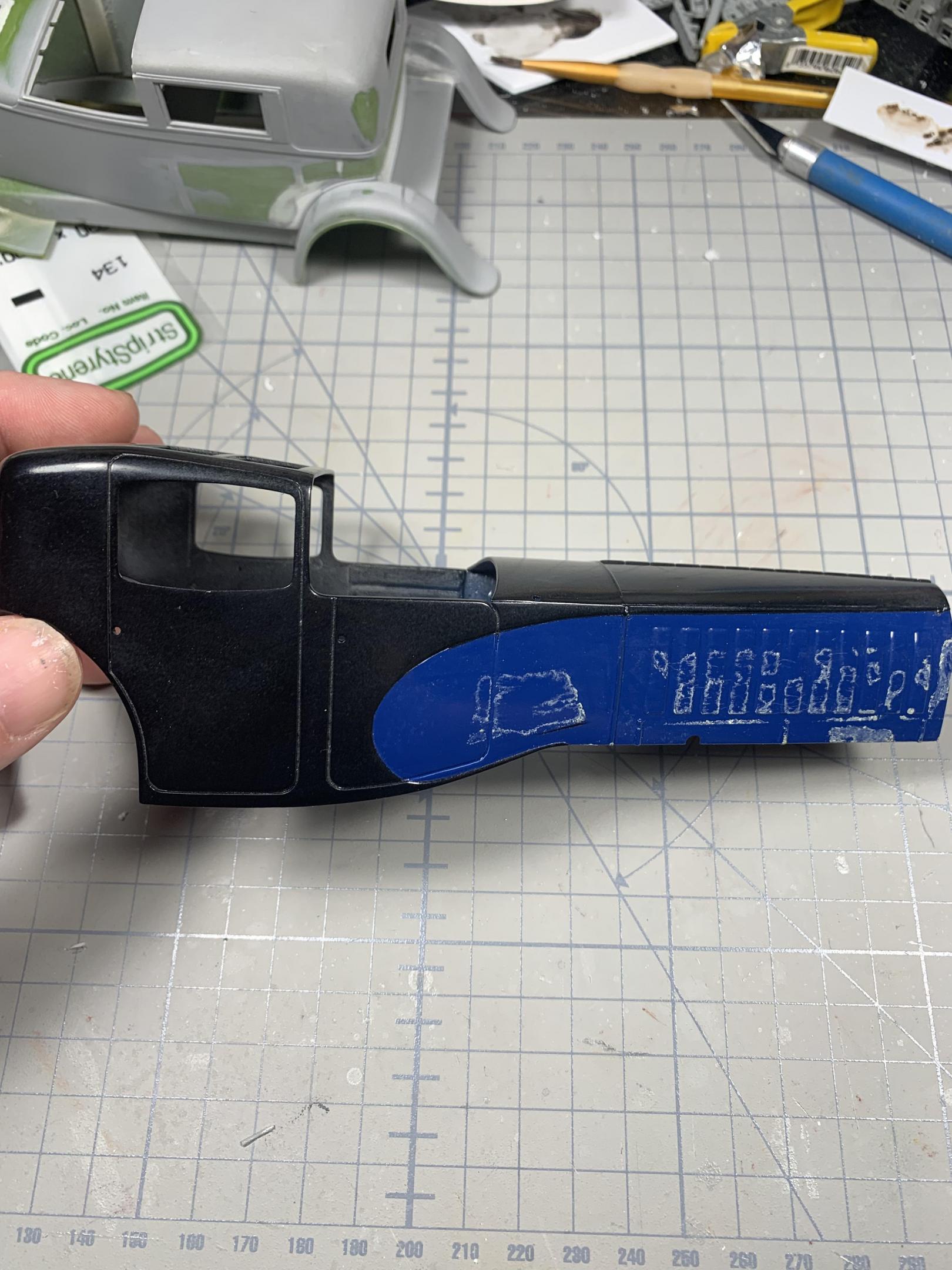

LDO Posted June 18, 2020 Posted June 18, 2020 I dug out this project from 2005/2006. It is painted with Tamiya spray can lacquers. Colors separated with Tamiya masking tape. I would like to avoid stripping the paint and starting over. The work was done while I was deployed to Afghanistan. Thanks
Snake45 Posted June 18, 2020 Posted June 18, 2020 First thing to try is fresh masking tape. Sometimes that will pull it off. Then you might try Windex. Rubbing alcohol would probably remove it, but is likely to damage the Tamiya lacquer. TEST it somewhere first to see. I've heard of WD-40 and Goo Gone working but have never used them. Again, TEST them on the actual paint.
Draggon Posted June 18, 2020 Posted June 18, 2020 Goo Gone will definitely eat the paint off. Probably damage the plastic too. Perhaps just letting it sit in a pan of warm soapy water for awhile. I agree with Snake, windex might work.
gman Posted June 18, 2020 Posted June 18, 2020 I can confirm that isopropyl alcohol will ruin Tamiya lacquer paint jobs ? I laid out a 2 tone paint job on some interior panels, and after spraying the second color and lifting the masking tape, it left a bunch of adhesive behind...I broke some of my trusty 70% isopropyl alcohol out (used many times over enamel 2 tone schemes), and began to swab off the residue. Much to my surprise, it took the lacquer off with the residue. I avoid inexpensive masking tape like the plague now, and life has gotten much simpler. I have used naptha (lighter fluid) to remove masking tape residue, but not over Tamiya lacquers. Tape residue gets harder to remove as it ages, so I would suggest trying whatever you use on something that doesn't matter before using it on a paint job you don't want to strip. The milder the solution, the better. Dilution is an option, but will reduce the effectiveness of a solvent in removing the residue also.

Can-Con Posted June 18, 2020 Posted June 18, 2020 I'd try some polishing compound. Might be able to rub it off with that.
Matt Bacon Posted June 18, 2020 Posted June 18, 2020 Try lemon juice? The “Sticky Stuff Remover” I have is based on lemon/orange extract (and you can smell it!). Does the job very well on BMF or Tamiya masking tape residue... not tried it on something that old, but worth a shot... best, M.
StevenGuthmiller Posted June 18, 2020 Posted June 18, 2020 WD-40 should do the trick nicely. I use it all of the time for foil and tape residues. Won't damage the paint, but be certain to wash the model in soap and water after treating with the WD, especially if you plan on doing any more painting or foiling or anything else that you want to stick. If you happen to have access to an old Avon stash, look for "Skin So Soft". It's the best thing that I have ever used for removing tape residues. It works great for taking warning labels and bumper stickers off of your vehicles as well. Steve
Bucky Posted June 19, 2020 Posted June 19, 2020 (edited) The AVON trick Steve mentioned should work well. A word of caution about using WD40....it really has to be COMPLETELY cleaned off before trying any more coats of paint. I worked at a mechanical contractor in Detroit for a while, and we built paint systems for the Big Three, plus a couple of the Japanese concerns to use in their assembly plants. They would routinely send inspectors to our shop, and if they found any WD40, or similar products, they would cancel our contract. The claim was that the stuff would cause fisheyes in the paint. Can't have that on a new Cadillac, or Dodge Ram!! Edited June 19, 2020 by Bucky
StevenGuthmiller Posted June 19, 2020 Posted June 19, 2020 2 minutes ago, Bucky said: The AVON trick Steve mentioned should work well. A word of caution about using WD40....it really has to be COMPLETELY cleaned off before trying any more coats of paint. I worked at a mechanical contractor in Detroit for a while, and we built paint systems for the Big Three, plus a couple of the Japanese concerns to use in their assembly plants. They would routinely send inspectors to our shop, and if they found any WD40, or similar products, they would cancel our contract. The claim was that the stuff would cause fisheyes in the paint. Can't have that on a new Cadillac, or Dodge Ram!! Absolutely. Washing in a good degreasing dish liquid like Dawn will remove the WD. But yes, if you are concerned about leaving any residue from the WD, use something else.......if you can find a good alternative. Steve
LDO Posted June 19, 2020 Author Posted June 19, 2020 Ok. I tried WD-40 and it worked great. On one side, there were a few tiny spots that just would not go away. After cleaning several times with Dawn, a close look revealed that the spots were chipped paint. Kind of strange that it only happened on one side of the car. That’s OK, though. I can do some more masking and spray on some more blue. Maybe it sounds weird, but spraying more paint is a better option than stripping paint and starting over. I would like to finish up the cars I started while deployed and keep them together as a group. That deployment was so boring...I can’t describe it to someone who hasn’t done that. Working on model cars helped me keep my sanity.
Pete J. Posted June 19, 2020 Posted June 19, 2020 10 minutes ago, LDO said: Ok. I tried WD-40 and it worked great. On one side, there were a few tiny spots that just would not go away. After cleaning several times with Dawn, a close look revealed that the spots were chipped paint. Kind of strange that it only happened on one side of the car. That’s OK, though. I can do some more masking and spray on some more blue. Maybe it sounds weird, but spraying more paint is a better option than stripping paint and starting over. I would like to finish up the cars I started while deployed and keep them together as a group. That deployment was so boring...I can’t describe it to someone who hasn’t done that. Working on model cars helped me keep my sanity. Ok, sorry to hear that you used WD-40 and have to repaint parts. Like Bucky mentioned above, I use to use WD-40 for various things in the shop but it and paint really don't get along at all. Any tiny droplet of it on the surface is guaranteed to cause a fish-eye. I will get as far away from my models as possible if I have to use it. The stuff carries on the air currents like you wouldn't believe. I have never found any way to get it off except sanding down to bare plastic. If you find a way. Let me know. I'm all ears.

El Roberto Posted June 19, 2020 Posted June 19, 2020 I remove it with mineral spirits, very mild and doesn't affect many paints except enamel.

LDO Posted June 19, 2020 Author Posted June 19, 2020 2 hours ago, Bucky said: WD40 can possibly cause stress cracks and/or crazing on polystyrene. I didn’t soak it in WD-40. I put some on a paper towel and rubbed off the tape residue, then cleaned off the WD-40.
StevenGuthmiller Posted June 20, 2020 Posted June 20, 2020 21 hours ago, Pete J. said: Ok, sorry to hear that you used WD-40 and have to repaint parts. Like Bucky mentioned above, I use to use WD-40 for various things in the shop but it and paint really don't get along at all. Any tiny droplet of it on the surface is guaranteed to cause a fish-eye. I will get as far away from my models as possible if I have to use it. The stuff carries on the air currents like you wouldn't believe. I have never found any way to get it off except sanding down to bare plastic. If you find a way. Let me know. I'm all ears. I have used WD for cleaning adhesive residue, cleaned with dish soap and painted again with no issues on several occasions. As "peteski" stated, it's just a lubricant. It's not some kind of nuclear waste. 4 hours ago, LDO said: I didn’t soak it in WD-40. I put some on a paper towel and rubbed off the tape residue, then cleaned off the WD-40. Make sure the parts are well scrubbed and cleaned and give it another shot of paint Lee, and let us know the results. Let's put the WD-40 myth to bed once and for all. Steve
StevenGuthmiller Posted June 20, 2020 Posted June 20, 2020 (edited) By the way, WD-40's main ingredients are Varsol, (mineral spirits) and mineral oil, which is also the main ingredient in Skin So Soft. Apparently the mineral oil is the ingredient that works so well for removing adhesive residue. Steve Edited June 20, 2020 by StevenGuthmiller
Reegs Posted June 20, 2020 Posted June 20, 2020 9 hours ago, StevenGuthmiller said: By the way, WD-40's main ingredients are Varsol, (mineral spirits) and mineral oil, which is also the main ingredient in Skin So Soft. Apparently the mineral oil is the ingredient that works so well for removing adhesive residue. Steve IIRC Skin So Soft was a good insect repellent, too.
stitchdup Posted June 20, 2020 Posted June 20, 2020 I've used those cheap spray deodrants you get in the pound/dollar shops. spray a load on to the sticky bits and let it sit for a few mins then simply wipe it offwith a lint free rag and give the parts a good wash with dish soap and water. I t will remove/leach out the colour enamel paints. I havent tried it on bare plastic and pretty much all my paint on bodies is auto acrylics. I think it may damage fresh paint (even auto acrylics) so be sure not to use it on new paint.
Howard Cohen Posted June 20, 2020 Posted June 20, 2020 (edited) It is interesting that none of you suggested using a product made for styrene plastic model cars...NOVUS 1 and 2 will remove tape/glue/BareMetalFoil adhesive residue without damaging any paint Edited June 21, 2020 by Howard Cohen
