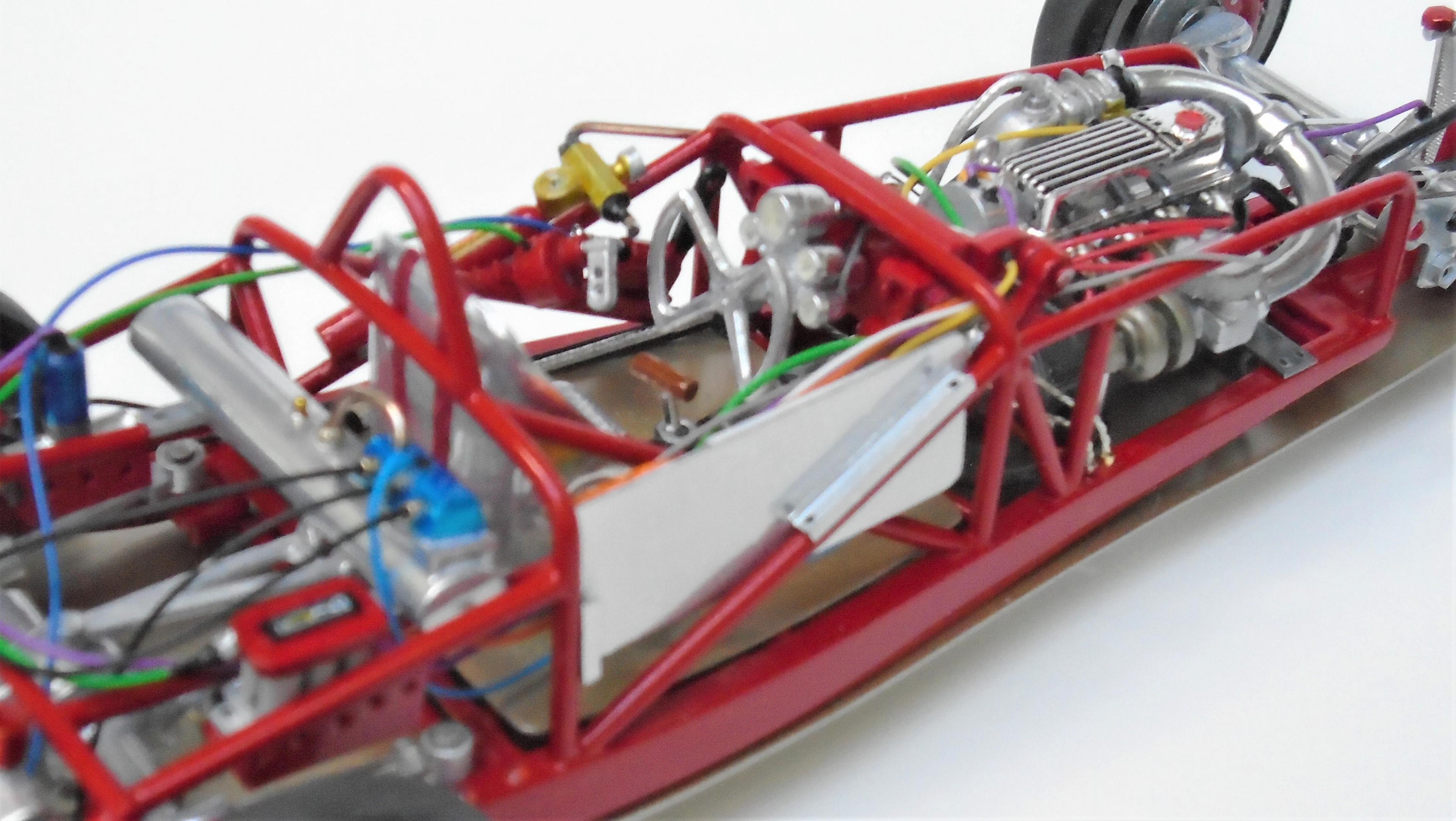

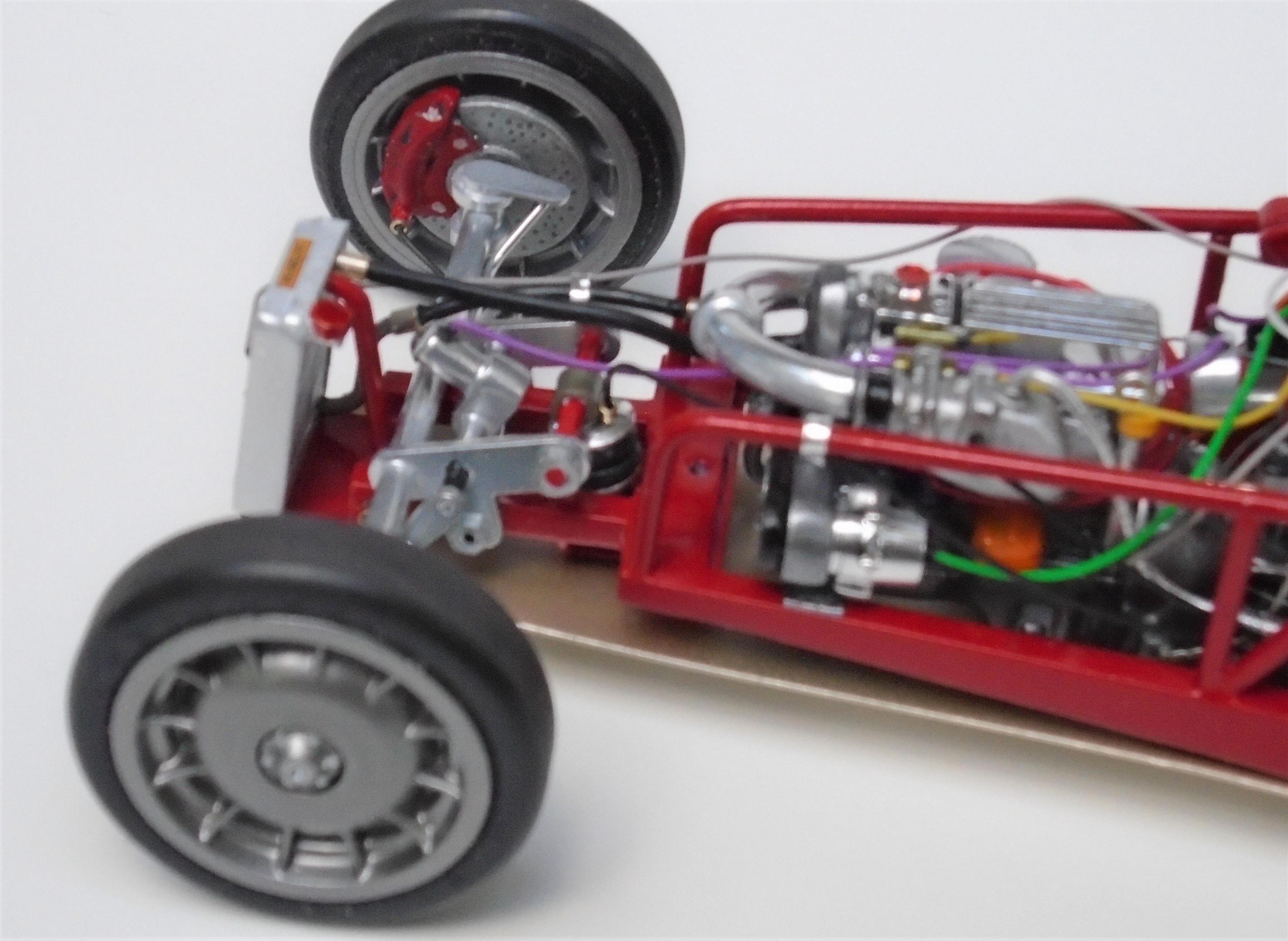

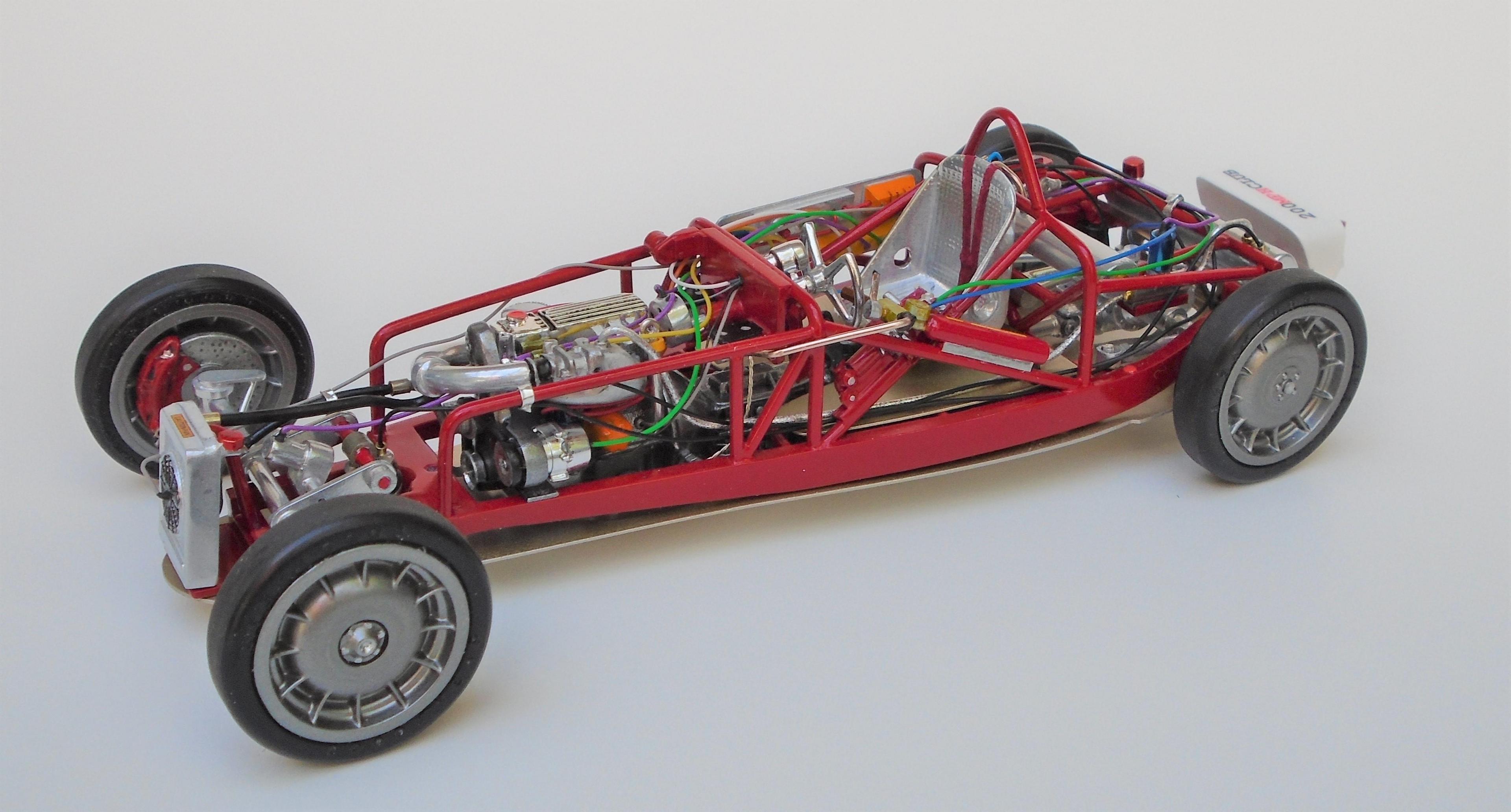

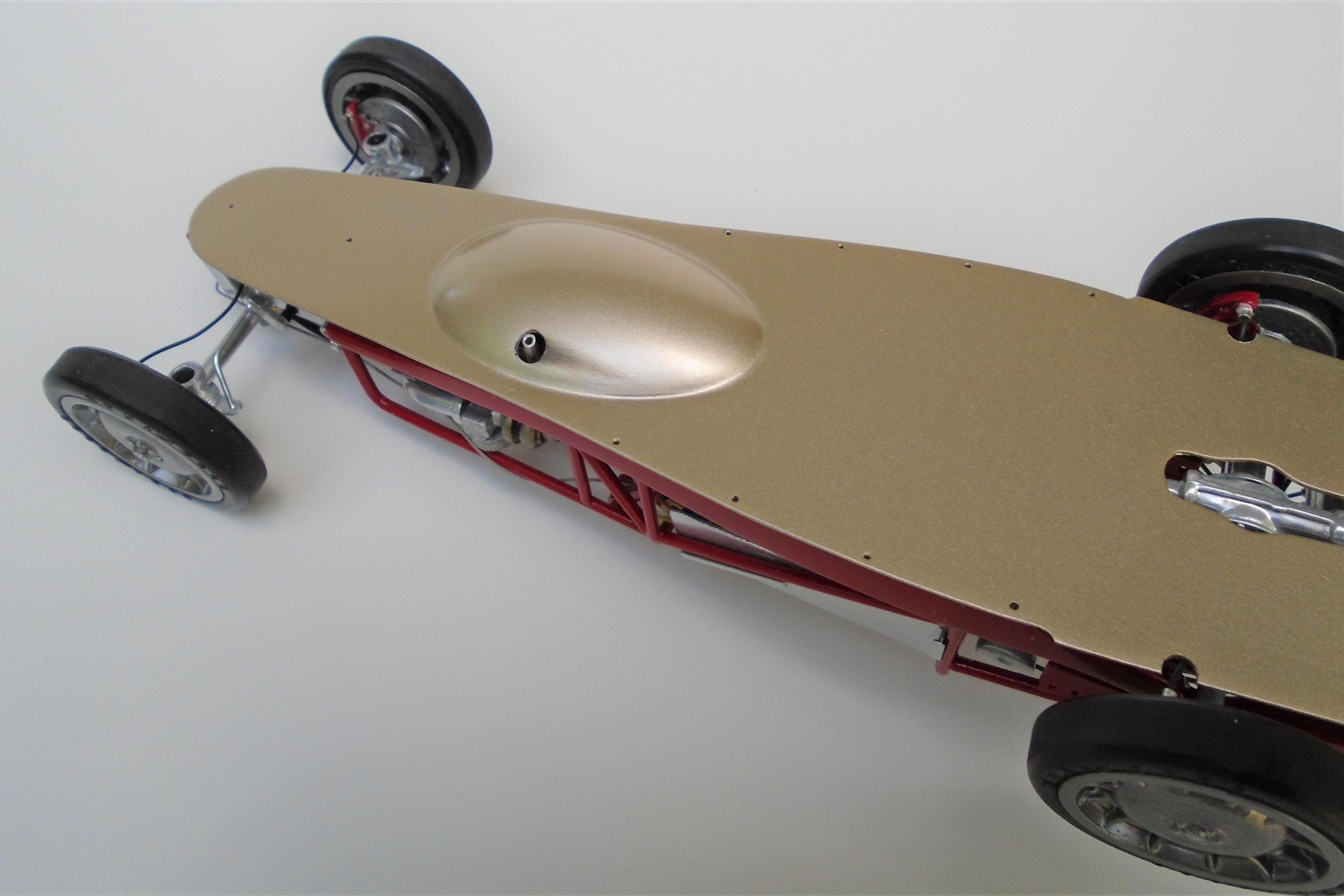

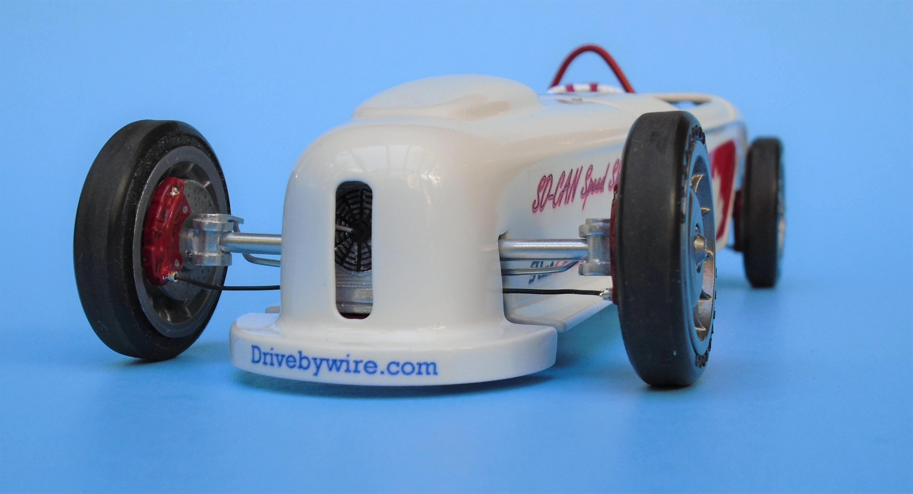

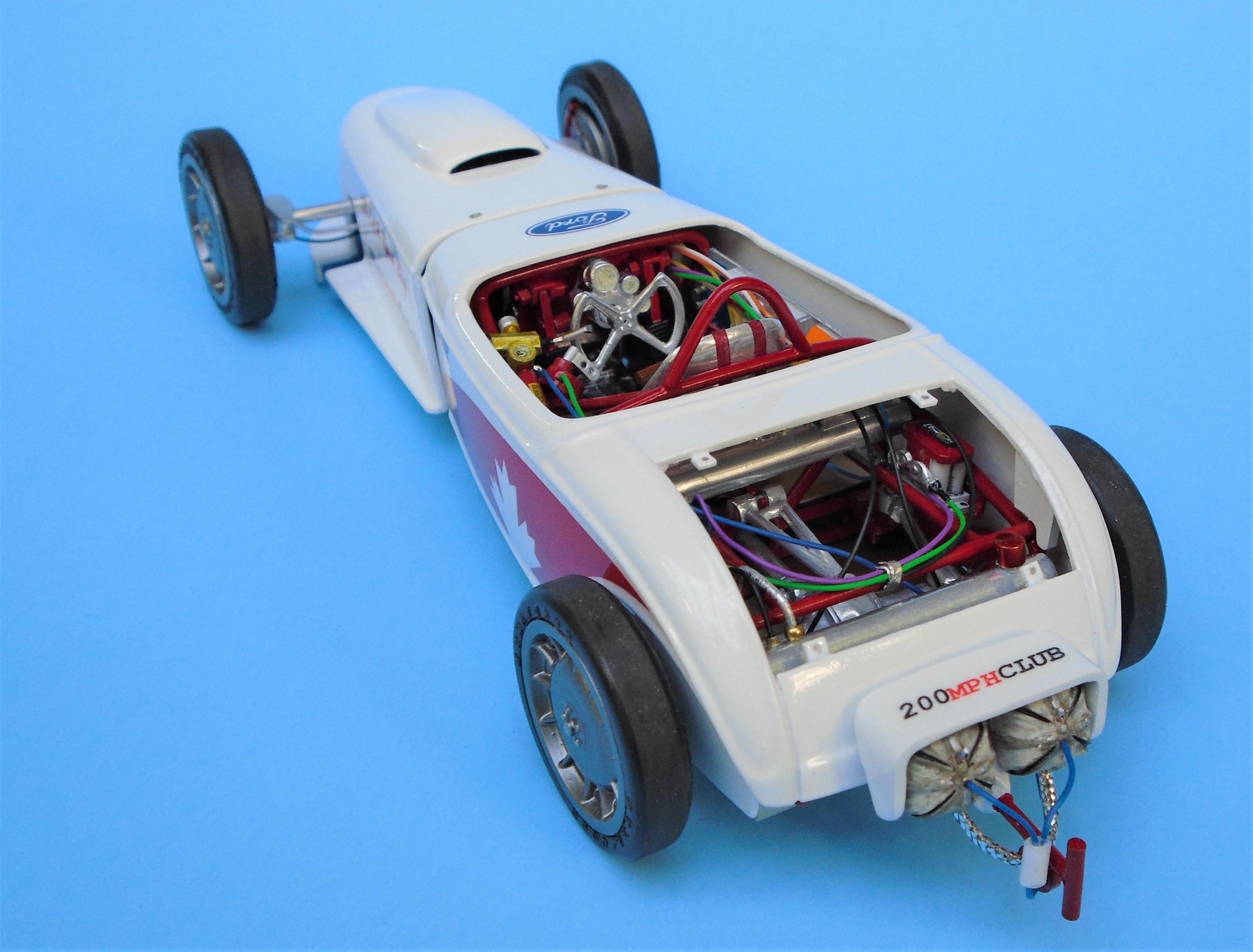

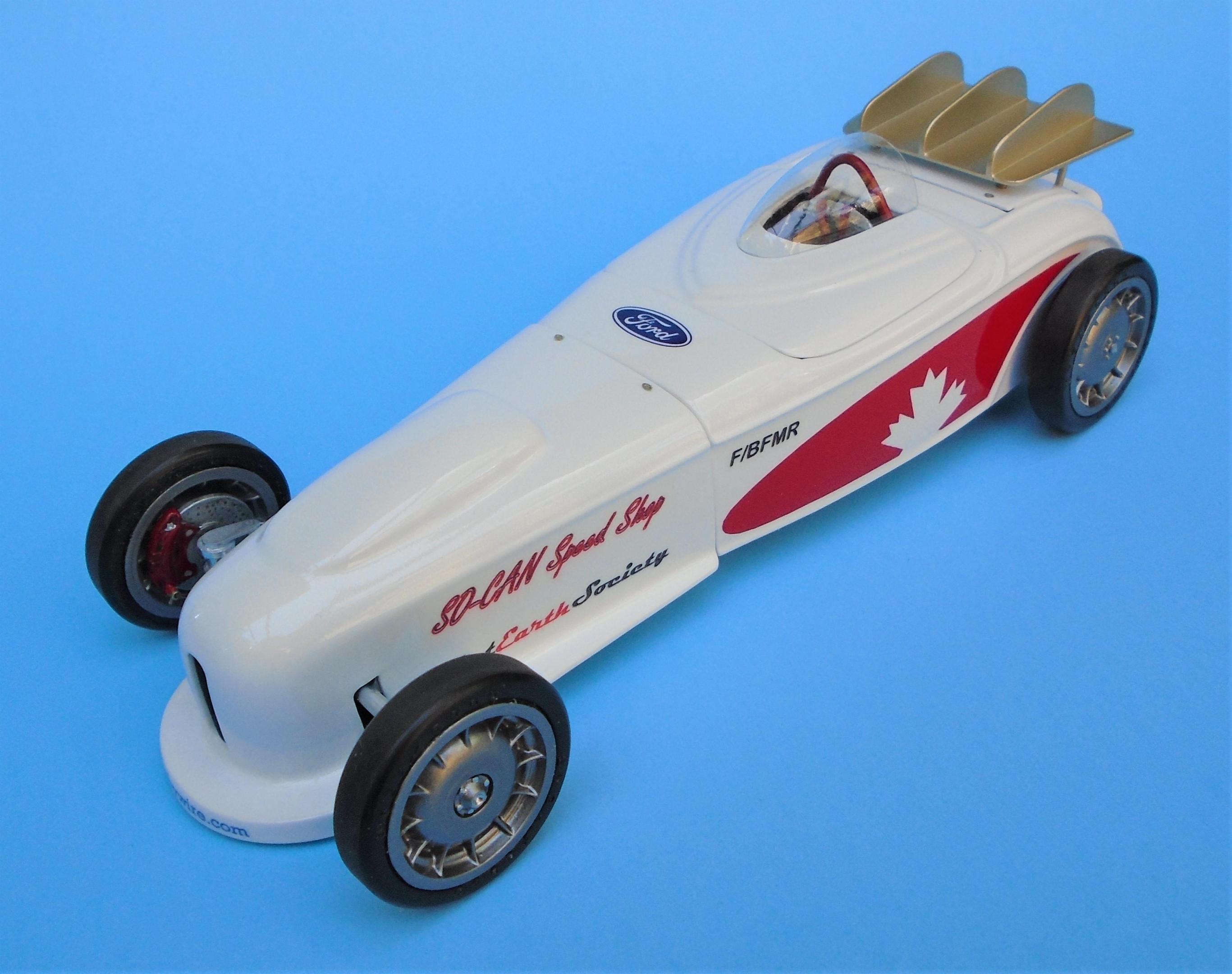

Was very active during the pandemic. and found time to build my annual Lakester. This 32 roadster (AMT'S) is my latest member of the FLAT EARTH SOCIETY.
What if a Cannuck was to challenge the famous So-Cal Speed shop car on the salt?

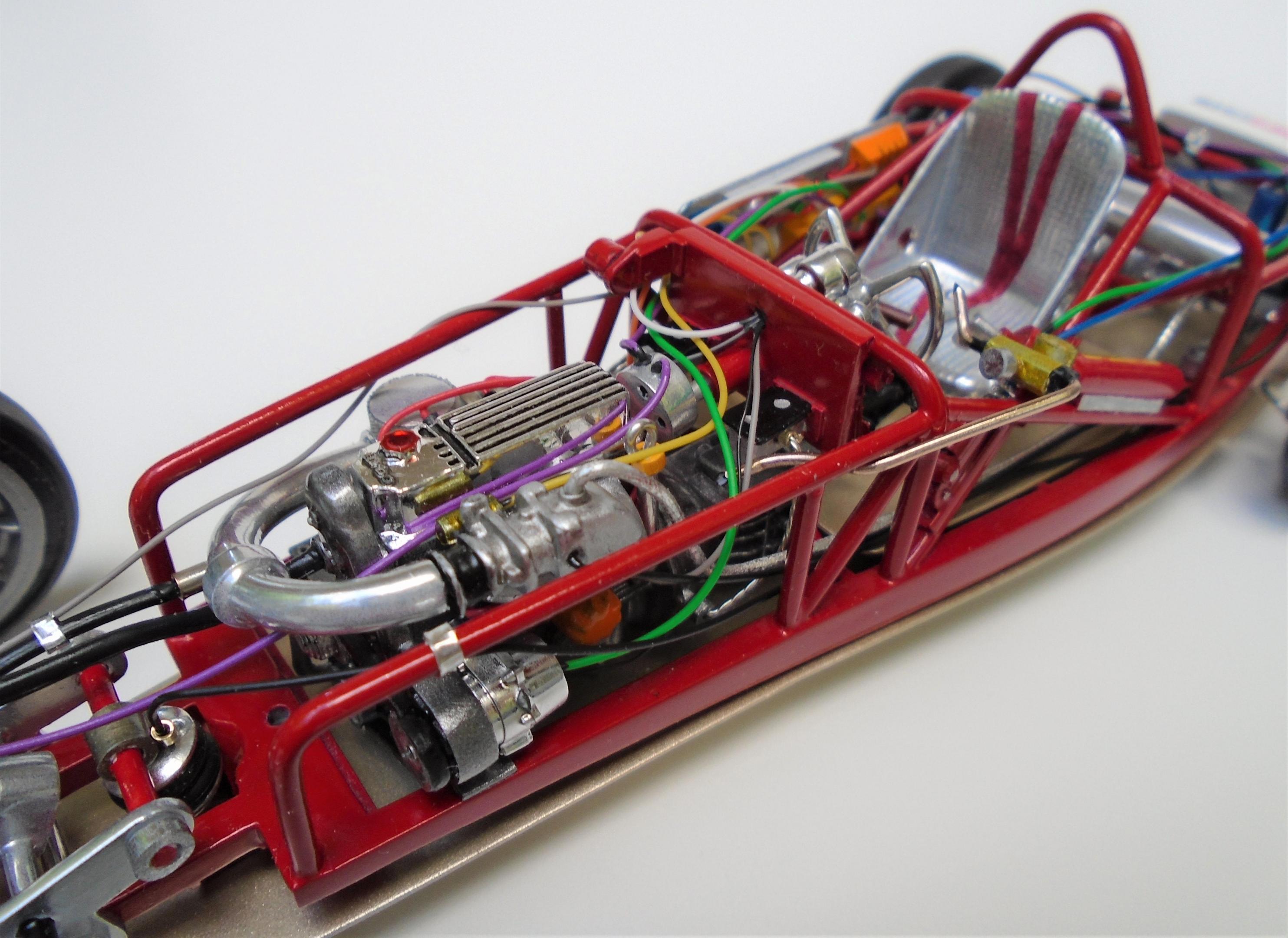

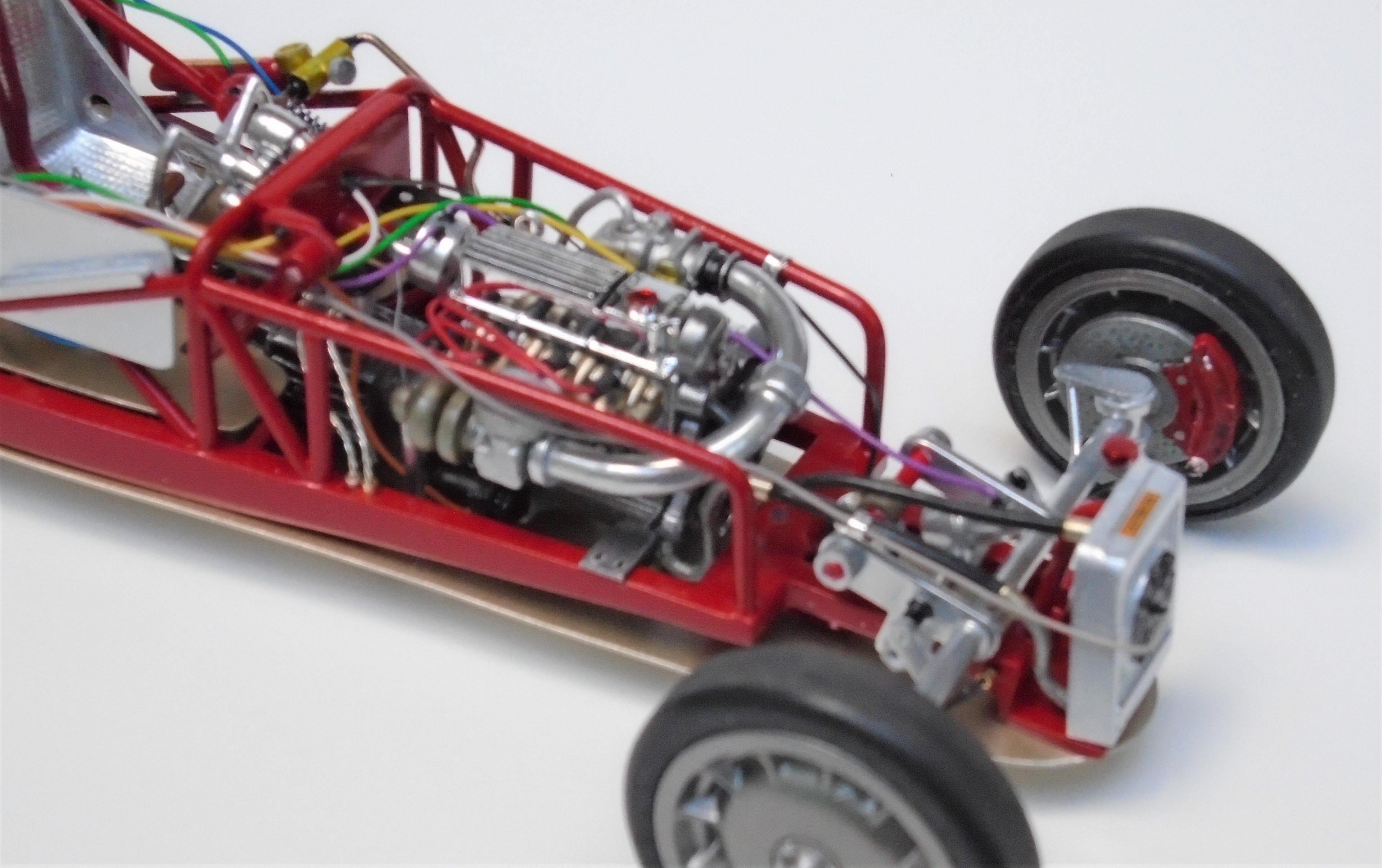

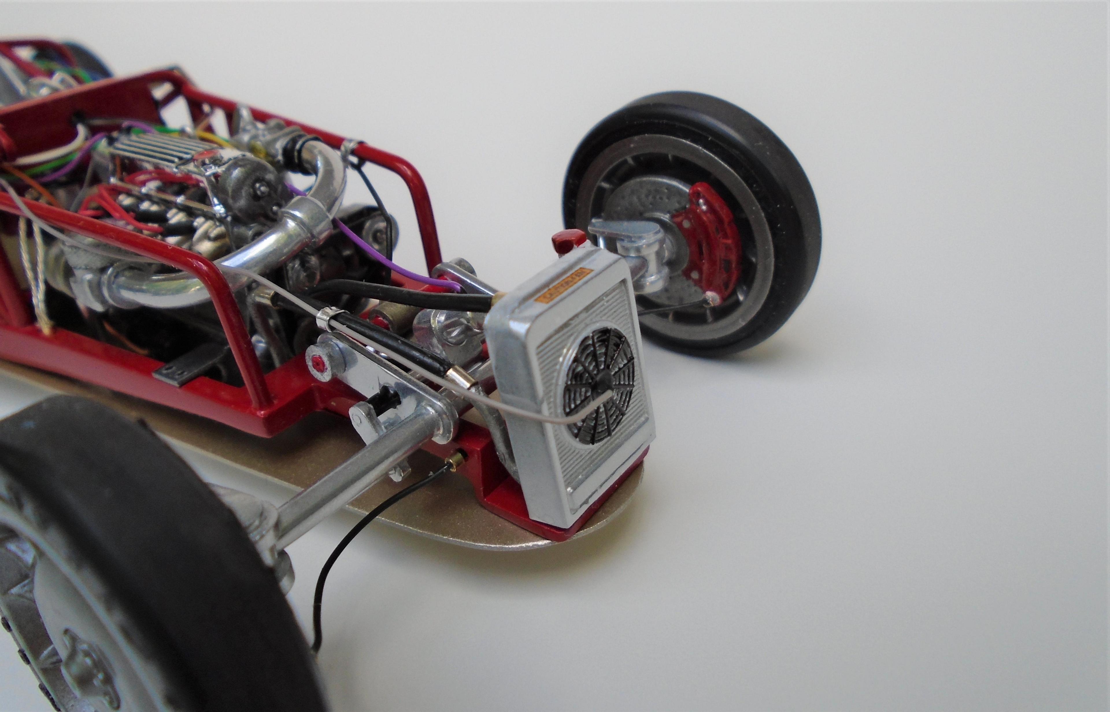

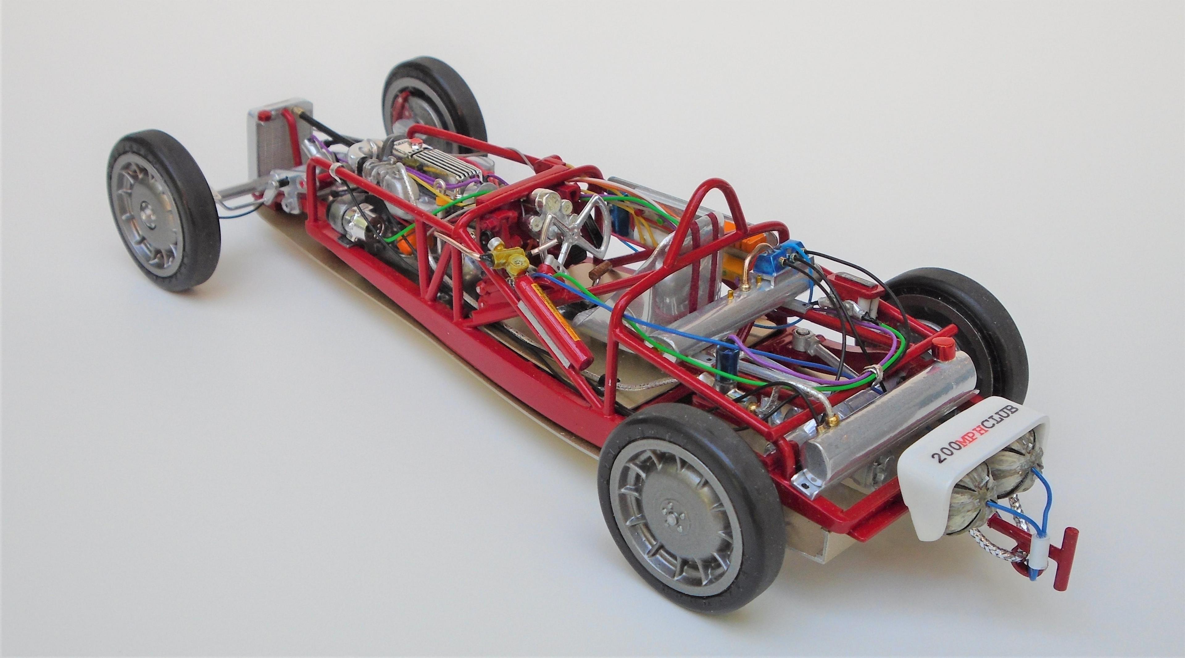

It is a mostly scratchbuilt frame, based on the Phantom Vicky rails, but all the cage, belly pan, suspensions, instruments, tanks, axles, air-ride shocks, Optima battery & all are scratchbuilt. The engine is from Monogram's Turbo Coupe TBird, heavily modified. Scartchbuilt electrical panel, brake & clutch hydrulic cylinders, fire extinguisher, floor pan, etc.
The front section is made of Monogram's 36 Mercedes hood top, sheet plastic side panels, Haye's TBird inverted scoop, a pencil eraser "nose cone", some fabrication, and the rear wing is made of a Gilette cartridge blades tray. The belly pan bulge is a plastic spoon, and the clear canopy is from a lightbulb blister pack. The tonneau cover was made with an Avanti roof panel.
Fully wired & hosed. Rolling stock & rear quickchange section from MT's Challenger. Custom decals. Tamya's pure white + Italian red lacquer panels.
Hours of fun with styrene. Long live the salt!

That's a very creative and beautiful model. Great detailing on the chassis and body.
What tires and wheels did you use?

Hi Roger!
Thanks for the comments. The rolling stock comes from Mickey Thompson's Challenger Streamliner (Monogram's), painted magnesium with Alclad. The front and rear axles are scratchbuilt, the front one being a mono-air shock "canteliver" system, to adjust riding height on the fly, just before the "Measured MIle"... For a while I juggled with the idea of encasing the wheels in aerodynamic pods (teardrops)... but they are so well molded, I changed my mind.

Wow, Claude, this might be your best salty yet!  The detail throughout the chassis is not only beautifully crafted but extremely believable.  Anyone who has visited Bonneville will know that a lot of the race cars there are "busy" - there are components stuck wherever they fit and then plumbed accordingly. Not all of them are as attractive as this one!  And your graphics - they are laser sharp!  Those Challenger wheels were the perfect choice - I have just one and I think it is time I had it resin copied!

Hi Alan!
Thanks for the comments. Much appreciated.
To your point about the fact the car is tightly "packed"... I agree. As we know, frontal surface is the enemy on the lake, because of air drag. I hesitated between the AMT or Revell roadster variety at the beginning ( I had both on hand), and chose the AMT because of its light "sectionning", a well documented fact among Deuce afficionados. Sleeker, but more packaging constraints. Hence the inverted snorkel scoop and belly reveal: even a small L-4 was too tall! Also had to make the turbo intake tube go in front of the engine, versus above it (OEM).
All in all, a pleasant packaging challenge.

Totally believable- your craftsmanship equals your imagination. Just needs some salt on the tires! This would be a good candidate for the real or model section!

I rather like those disc brakes !
you ARE planning to bring this to the last GSL contest -  right ??
Hi Andrew!
The discs are from a Revell Ferrari California found in the trash bins at a local event. Nicely detailed box stock.
