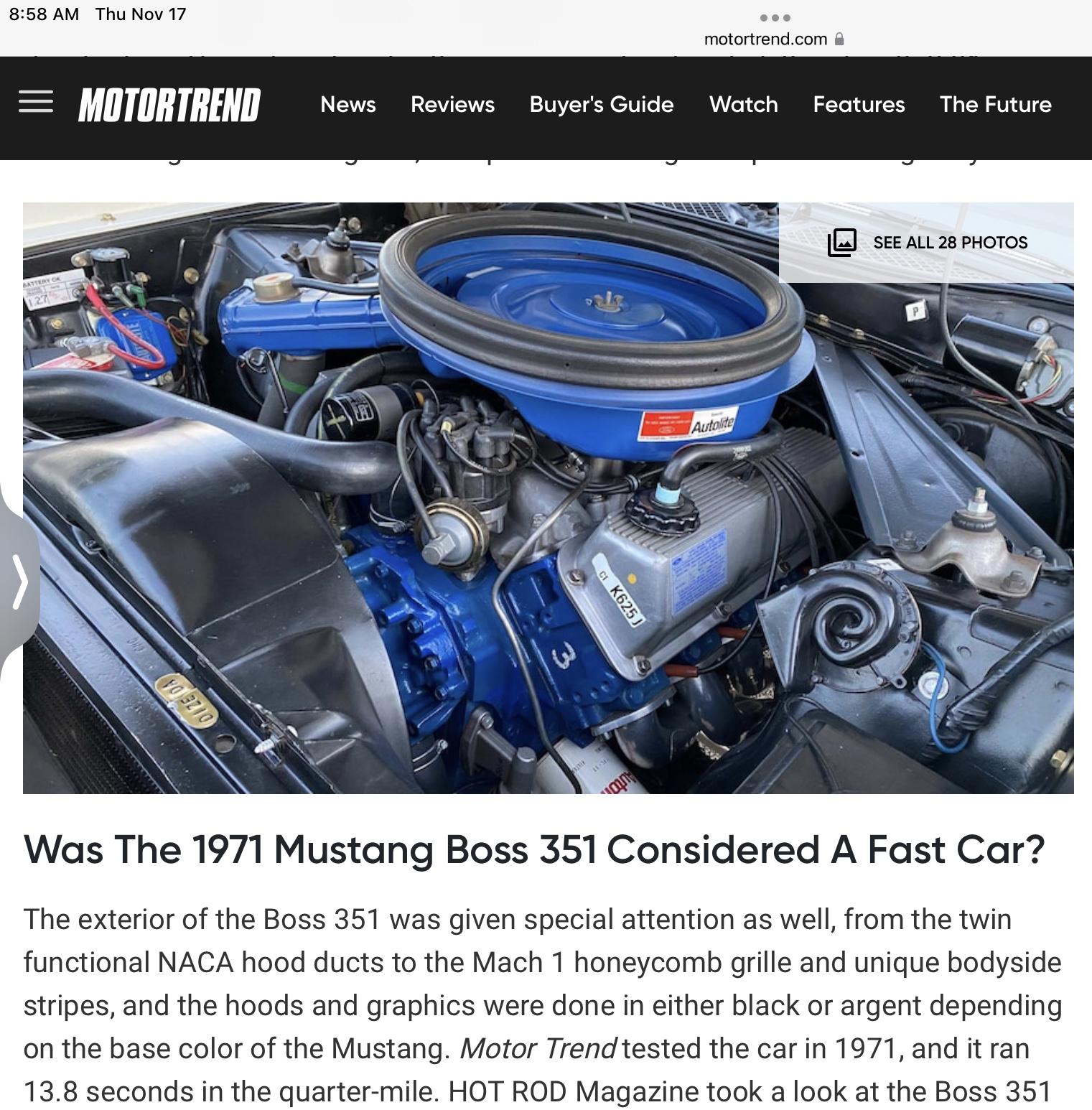

sfhess Posted November 17, 2022 Posted November 17, 2022 (edited) Timer? Don't you mean "lightning whirler"? That took me a minute. At least you didn't call it a "dizzy". Heads and valve covers look like Cleveland. I bet if you painted the intake blue ahead of the first runner it would look more like that is part of the block. (Actually a Windsor distributor does not go through the manifold. You can remove the intake without disturbing the distributor. I have done this.) In the engine picture it looks like the coil is mounted to the water outlet area and the upper radiator hose is sitting on the timing cover flange. Edited November 17, 2022 by sfhess

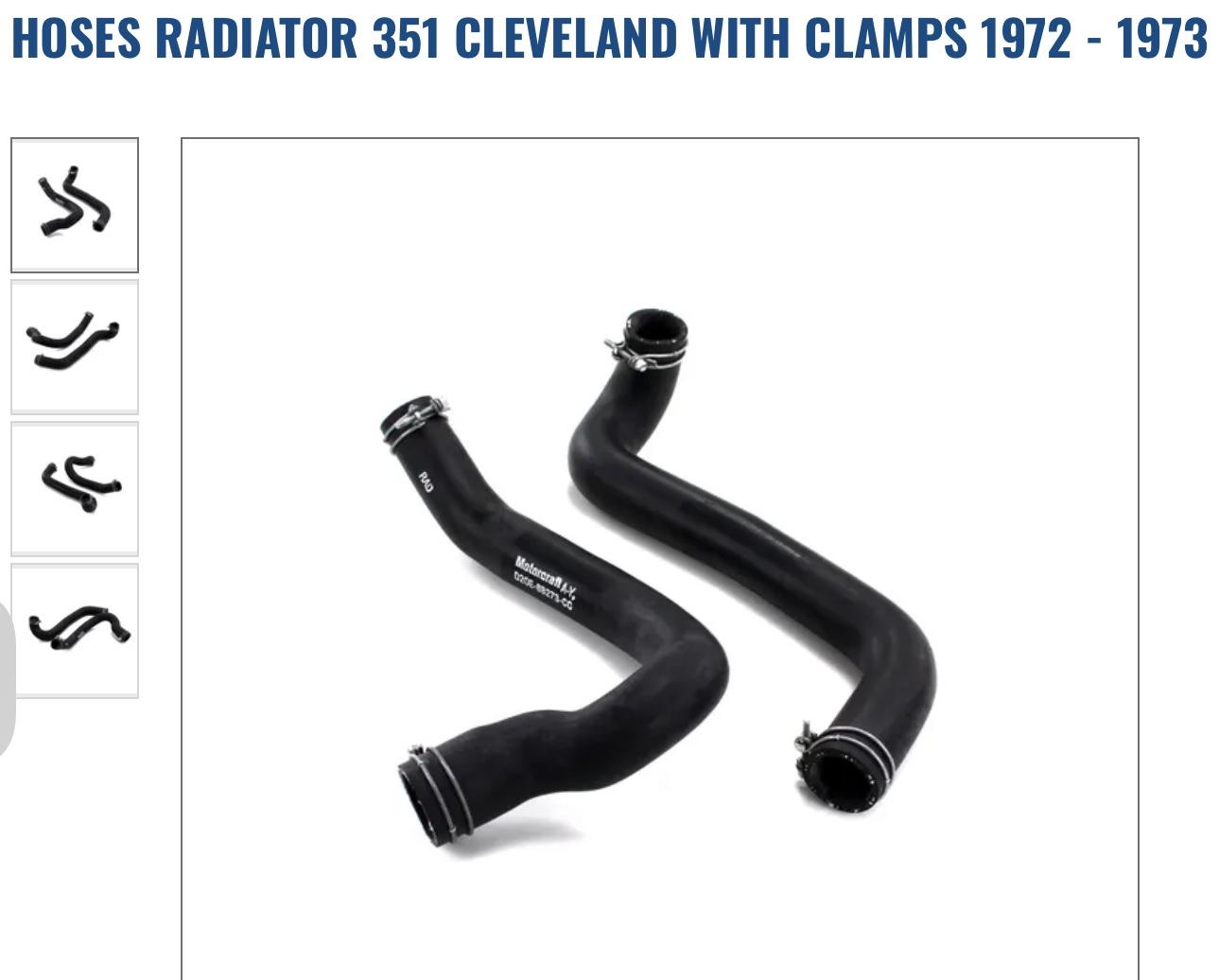

tim boyd Posted November 17, 2022 Posted November 17, 2022 7 hours ago, PintoKING said: That Revell engine looks like a 351 WINDSOR, and not a 351 CLEVELAND engine. The "W" as in WIndsor had the timer going THROUGH the intake manifold, but the "C" as in Cleveland had the timer going directly into the block. A VERY nice kit nonetheless, judging by the pictures. I want one. Whoa....wait a second on this. I can assure you that the Revell team was aware of the importance of the 351 Cleveland in developing this kit. Like many of you, I would be thoroughly disappointed if the engine turned out to be anything less than 100% Cleveland... Qiuck internet search includes this info: THREE EASY VISUAL DIFFERENCES BETWEEN THE 351W AND 351C/351M. Radiator Hose. On a Cleveland/Modified engine, the radiator hose (and thermostat housing) sticks vertically right out of the top of the engine block. Windsor engines have the radiator hose and thermostat installed into the intake manifold, where it exits from the front of the engine. Valve Covers. Windsor valve covers use 6-bolt covers, whereas the Cleveland/Modified uses 8-bolt covers. Timing Chain. Cleveland/Modified engines have the timing chain recessed into the front of the block itself, and its timing cover is essentially just a flat piece of metal. The Windsor’s timing chain attaches to the front of the engine and has an external timing cover typically made of cast aluminum. It is a little difficult to see from the box art side panel image, but it sure looks to me like the radiator hose sticks out of the front portion of the engine block, just as it should on a Cleveland. My point here is "let's be careful not to jump to definitive conclusions until we have the kit's engine parts in our hot grubby hands". Then let the you-know-what hit the fan in the radiator shroud if applicable.... TB 2 1
vamach1 Posted November 17, 2022 Posted November 17, 2022 9 hours ago, 1972coronet said: Uh-oh! I just noticed that, too! That's definitely a Windsor 351 in that kit! At least the heads resemble the "335 Series" (Cleveland, 'M', and 400) -- hope that Revell fixes that! The radiator hose bends at ninety degrees and goes straight down. The box art picture obscures that angle. Don’t freak out people.

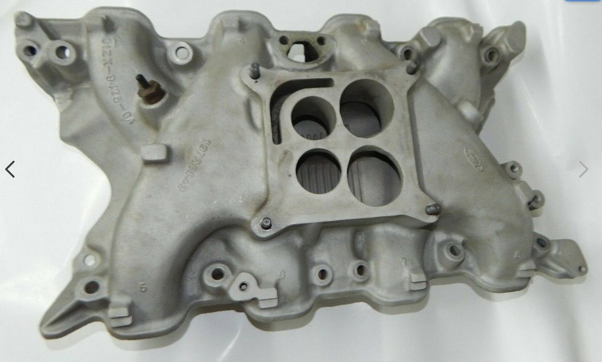

1972coronet Posted November 18, 2022 Posted November 18, 2022 47 minutes ago, vamach1 said: The only downside is now when I look at all the MPC and AMT 71-73 kits in my collection I am lose all interest in building any of them. One interesting item on the MPC 428 engine is the presence of the Therm-Actor A.I.R. system. We have not seen a closeup of the kit part [intake manifold] but for those that want to modify it to look like the EOM part here is what it should look likeDid that same intake find its way onto the 1972 351-CJ? I recognise the 1971 part number casting [D1ZX] -- it that exclusive to the 1971 351 H.O. (et al.)? Does the '72 351-CJ have a D2ZX casting?
vamach1 Posted November 18, 2022 Posted November 18, 2022 1 hour ago, 1972coronet said: This chart shows only the 71 Boss having the aluminum intake manifold. Other sources say the 72 HO also had one. As far as I know all of the 351CJ Q code engines had a cast iron manifold. 1 1
