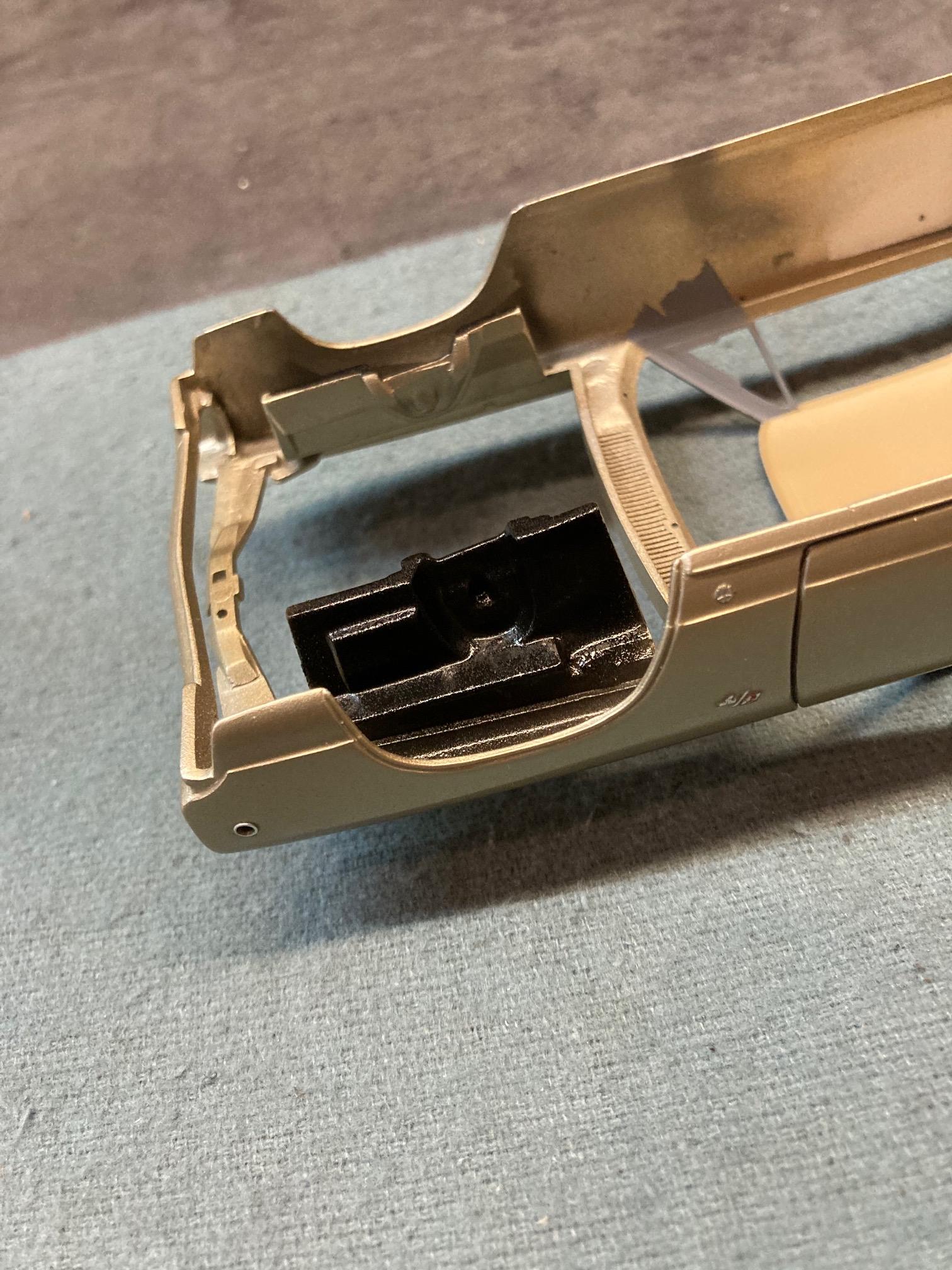

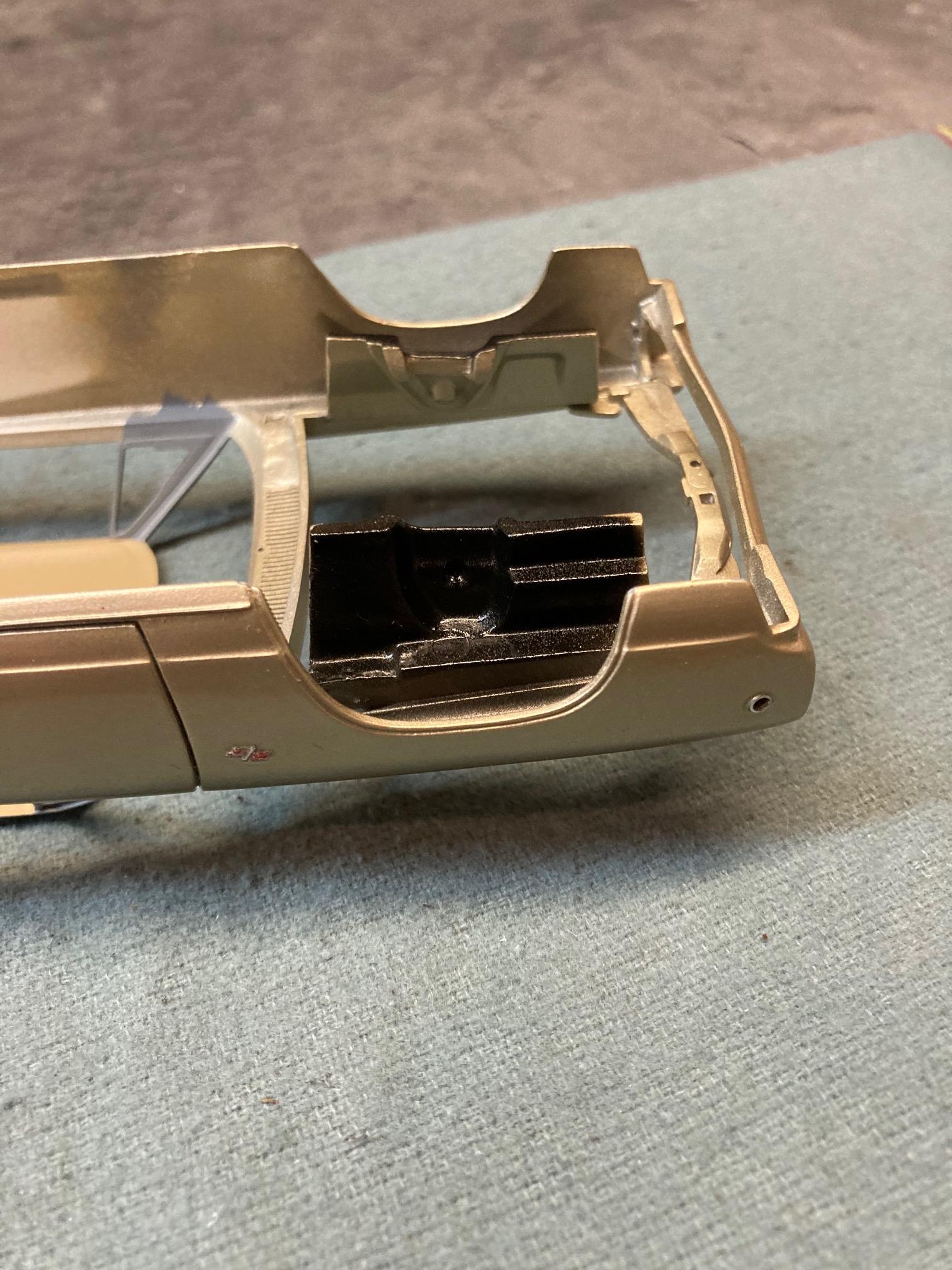

StevenGuthmiller Posted November 29, 2021 Author Posted November 29, 2021 Thanks guys. Didn't get a lot of time at the bench this holiday weekend, but I did manage to get the headliner sprayed with some Tamiya TS-46 "Light Sand", the front of the radiator bulkhead shot with flat black, and the wheel well portion of the firewall "undercoated" with some MCW "vinyl top" paint. Next I will shoot the top, and then the front fender wells. Steve

StevenGuthmiller Posted December 1, 2021 Author Posted December 1, 2021 Thanks everyone! My next task was to mask and spray the undercoating on the front wheel wells. What a masking nightmare! I wound up masking and spraying one side at a time to make the masking more manageable. It worked out okay, but what a PITA!! No room for getting any over spray on any exposed surfaces at this stage of the game! Steve

StevenGuthmiller Posted December 2, 2021 Author Posted December 2, 2021 Here are the results of my vinyl top plan. As I stated above, rather than try to mask the trim, or sand it after paint for foiling, I decided to use the trusty "foil under paint" technique and foil it first. I foiled, then masked to try to get as little paint on the trim as possible. Then I shot a few light coats of Duplicolor black primer, a couple of light coats of MCW "vinyl top paint" and then a final coat of black primer. I then gave it a little rub down with some WD-40, followed by a washing to shine it up a little. I made one very advantageous discovery during this operation. The paint that I used did not stick well at all to the foil, which made it very easy to remove the paint from the trim with nothing more than a little light scraping with a sharpened tooth pick! No thinner required!! Keep in mind though, that being as the paint did not adhere well, that the foil needs to be cut close to the trim to be certain that it does not flake off where you don't want it to. Steve 1

StevenGuthmiller Posted December 3, 2021 Author Posted December 3, 2021 1 hour ago, absmiami said: does the WD 40 give it a little sheen ?? ??? Yeah, but that was just me experimenting. I had never used the MCW vinyl top paint before, and I thought it looked a little too shiny. So I sprayed another light coat of the black primer over the top........at which point it looked too dull. So I rubbed a little WD over it to help bring back a little of the sheen. Steve

StevenGuthmiller Posted December 4, 2021 Author Posted December 4, 2021 Thanks everyone. After some contemplation, I decided that I wasn't happy with the finish on the vinyl top. It was too shiny for me. So I added a couple of coats of black primer, rubbed it down a little, and finished with a little Armor All. It's still a little blotchier than I would like, but then again, this model is supposed to represent a car that's a few months old, so it shouldn't be perfect. In any event, I like it better now. Steve
