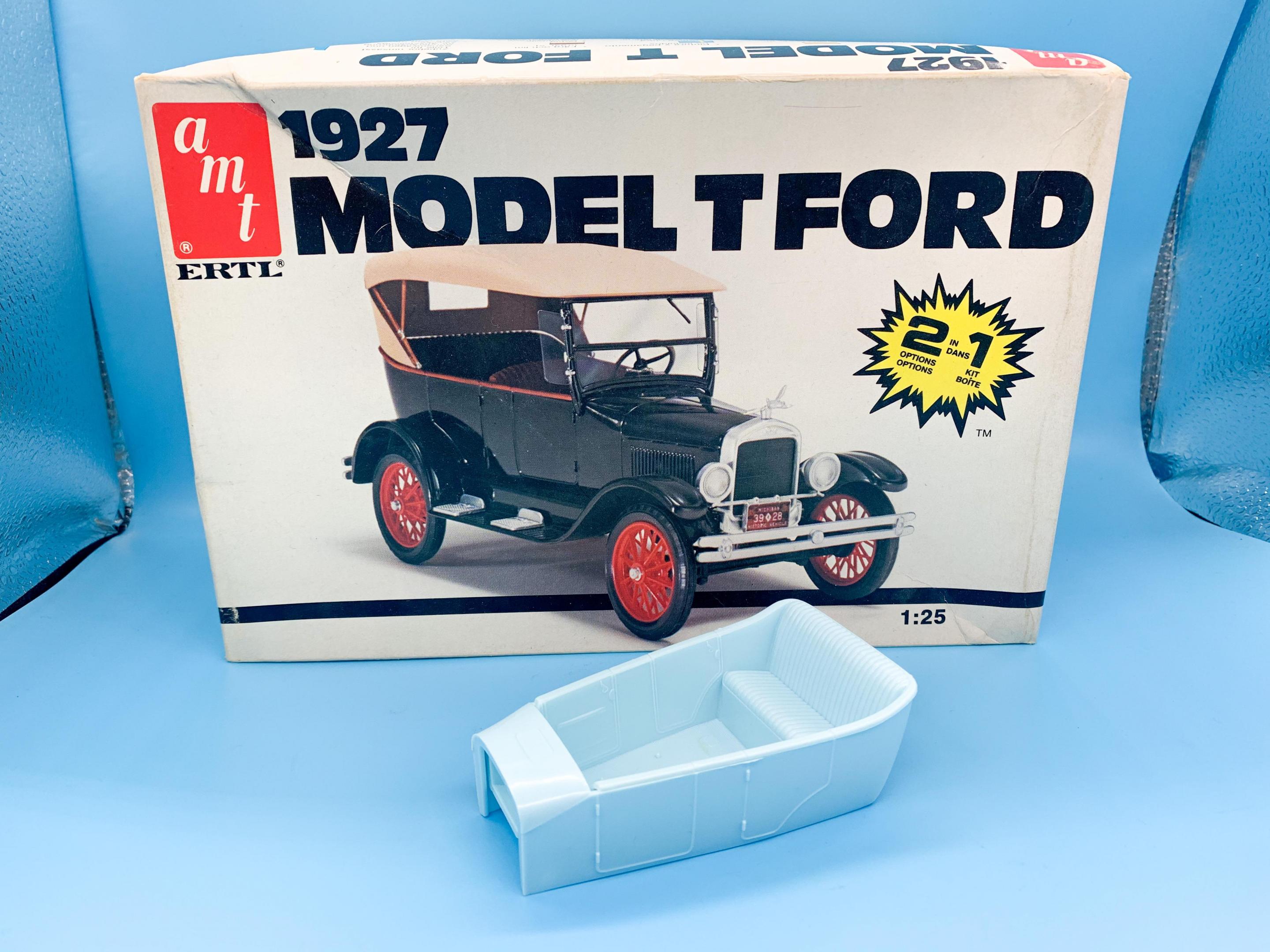

My wife and I moved from New York to Indiana just over a month ago, and I got a nice new workshop set-up and have been dying to get into some projects.  I’ve got a couple of builds in-progress that are ALMOST ready for assembly but both needed some touch ups on the paint (one from a little damage incurred when we moved and the other through me using some paint I wasn’t familiar with and not doing as nice of a job as I was happy with).
So, almost reluctantly, rather than sit at the bench wondering waiting for paint to dry, I pulled out this AMT T kit that I’ve been thinking about building for a few weeks now:
I got really inspired by a build by @tim boyd that I think I saw in one of the mags, and then rediscovered on his Fotki page recently - I won’t post his picture without permission, but you can see it here:
https://public.fotki.com/funman1712/tim-boyds-124th--12/boyd-street-rods-ra/boyd-phaetontouring/dsc0089.html
As Tim notes in his comments about this build, it represents an early 60s style hotrod with the stock T engine augmented with some fancy bolt-on speed parts - and I really like how the kit looks right as he’s built it there.  Now, this issue of the kit doesn’t contain the cool front end setup that he’s used, those motorcycle front wheels or those quad headlamps, but I’ll still be able to make something inspired by his build a little at least without straying too far from what’s in the box.

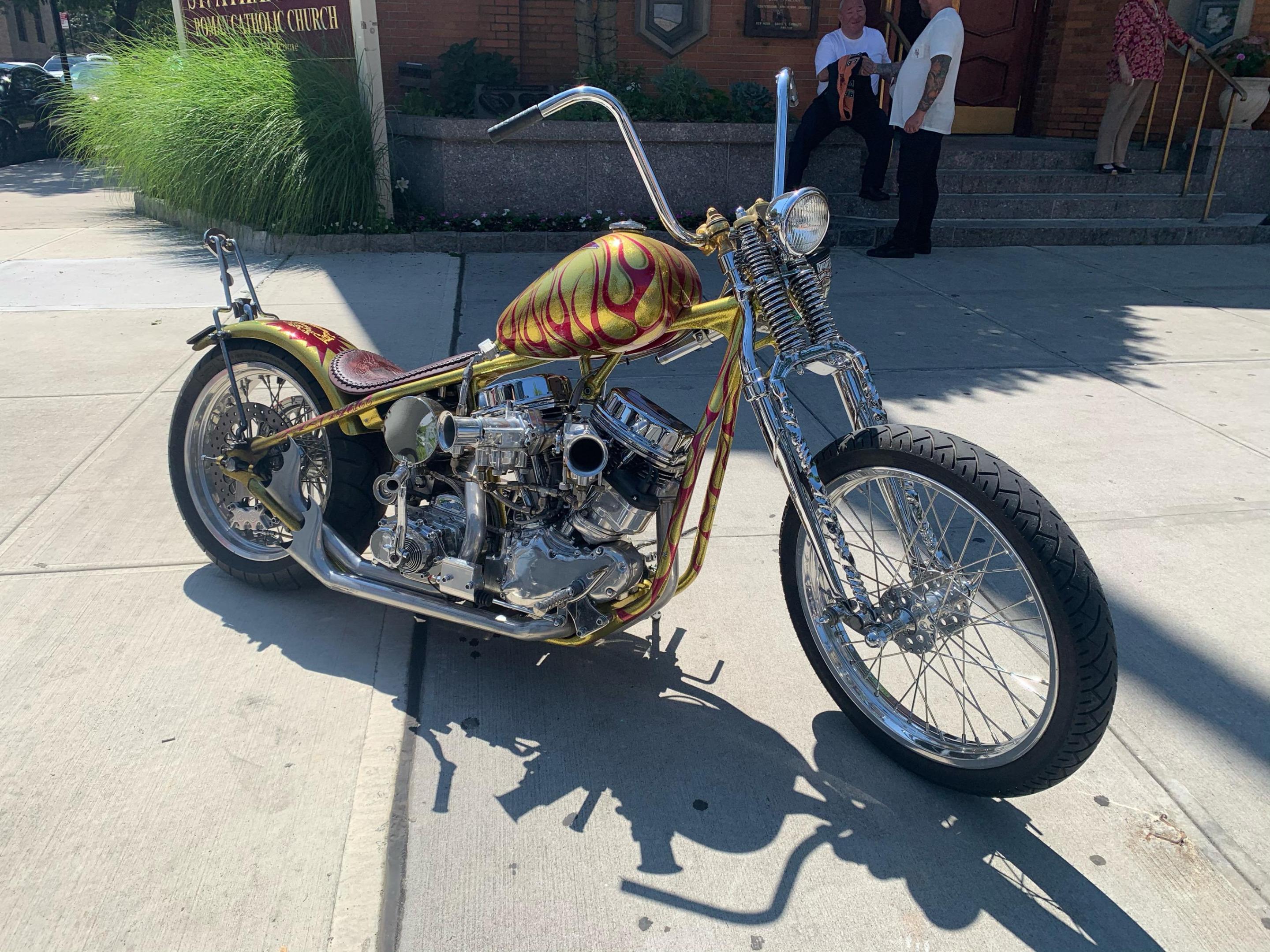

I’ve also been checking out a lot of Indian Larry motorcycle builds lately, having seen one of his bikes in Brooklyn in the summer, and I really like this trick that he would do to have a flamed paintjob with the flames moving vertically instead of horizontally...kinda different and cool, so I might try and incorporate a little of that style into the paintjob here:
Nothing quite as wild as this particular bike, but maybe something a little different anyway.

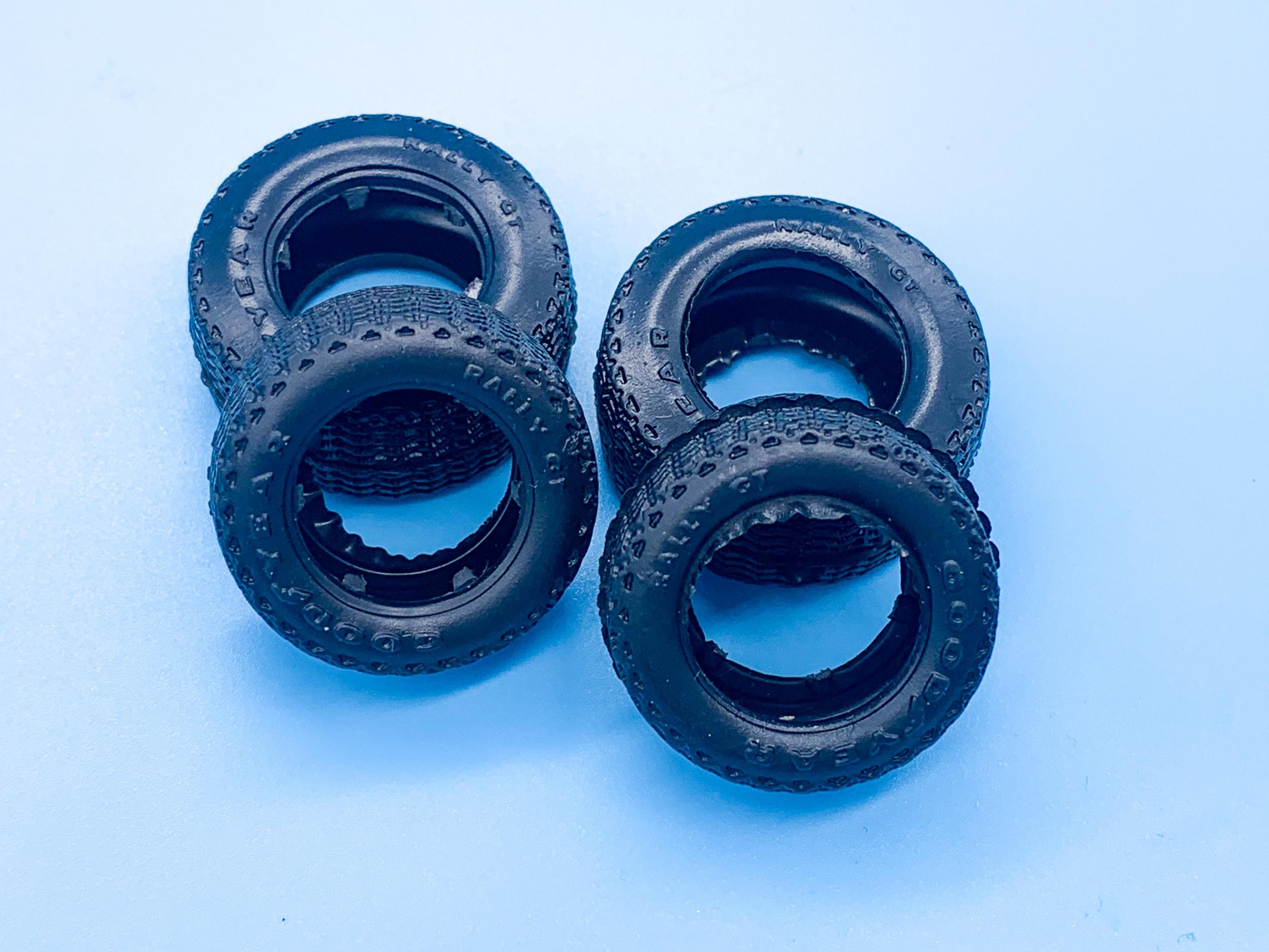

I usually like to do a quick mock-up before I start getting into a new build, but right away I can tell you I won’t be using these tires:

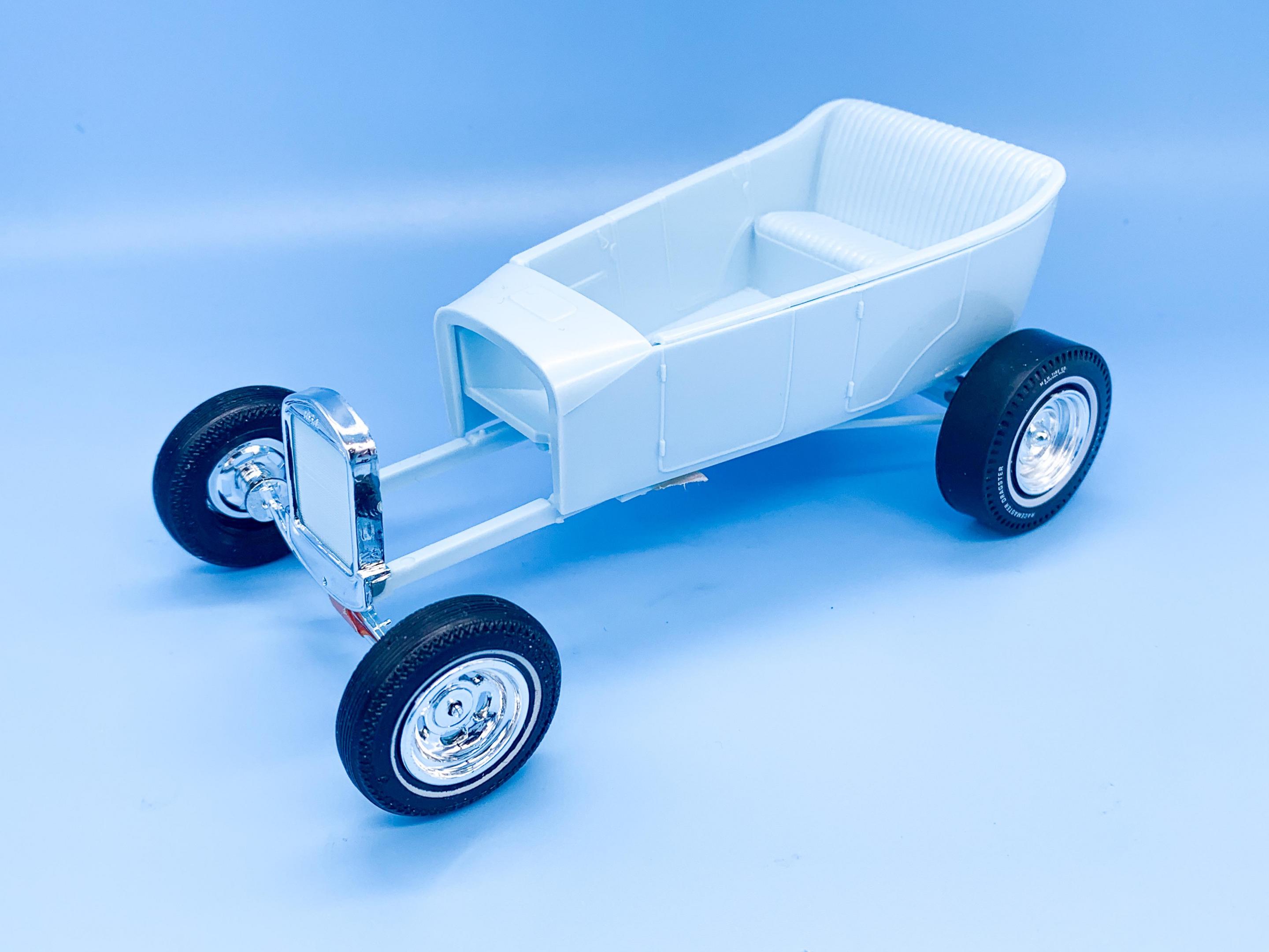

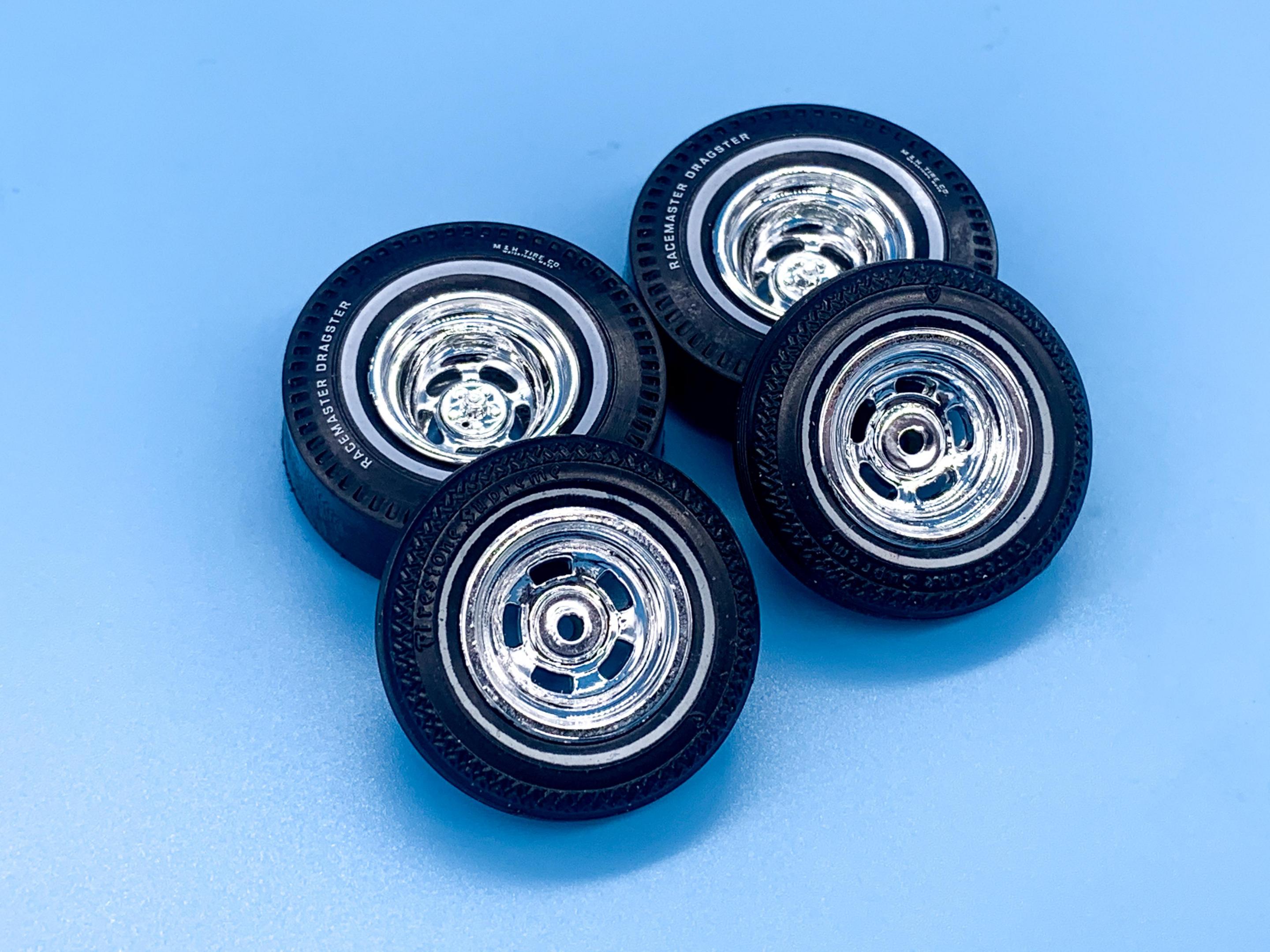

A quick look through the parts box for something nicer that I can use without too much fuss - these are a nicer option I think;
Not sure where the fronts came from, but I guess the rears are from one of the Round 2 reissues (50 Ford maybe?)

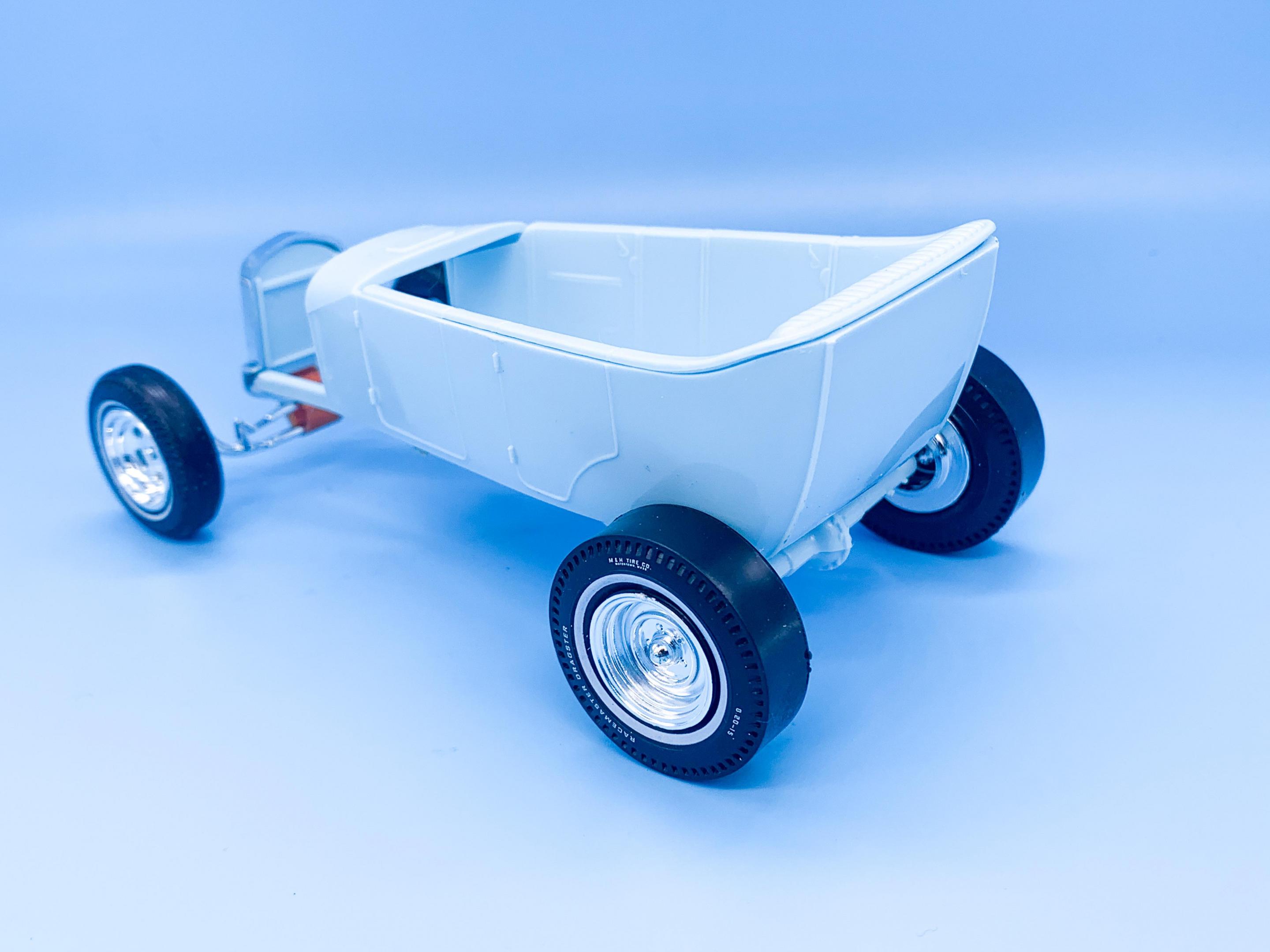

And, that issue resolved, a quick mock-up:
I made a conscious decision lately to try and build some of these kits that interest me box stock, or close to it, as best I can before starting to mess with every little thing too much, so I’m going to kind of go with what AMT intended for the most part with this one (although I’ve already got plans for a couple more)...as usual though, I can’t leave well enough alone so we’ll see how that goes

I remember watching an episode of something on cable TV where Indian Larry twisted the iron for the front springer on this bike. It was incredible!
That bike still looks about the same today - tonnes of cool little details and stuff to notice!
4 hours ago, cobraman said:
Those tires are a much better pick.I never liked those ones in the first pic.
Me either - I’d be only slightly more inclined to use them if they were almost completely hidden from view under some big swooping fenders, but even then I still wouldn’t like them much ?

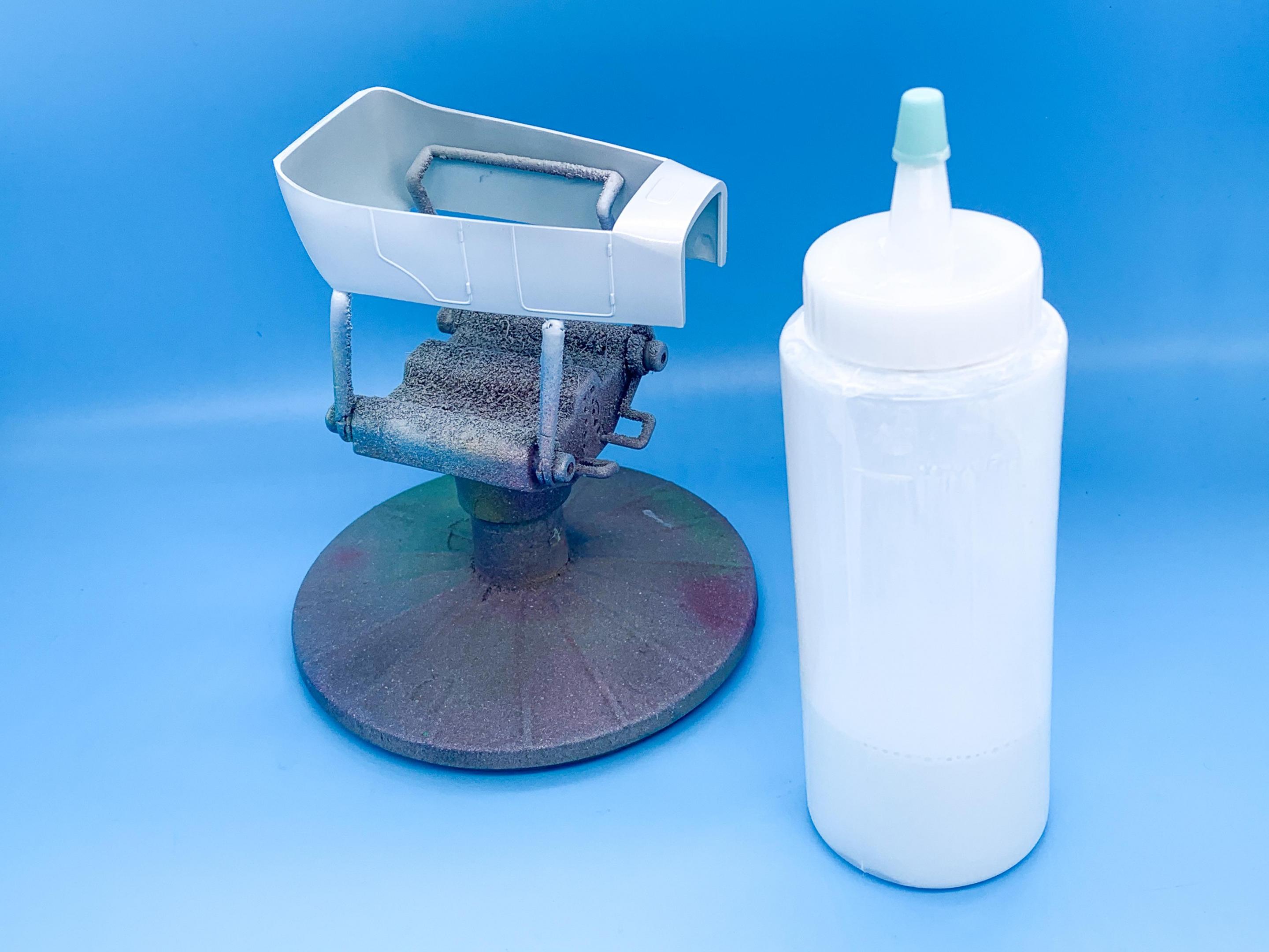

Tiny update today - got the body smoothed out and ready for some primer...been having the worst luck with Rusto primer lately so I decanted yet another clogged can so I could airbrush it.  I can’t figure out how this stuff is like water and SUPER thin yet the cans still manage to clog.
Regardless, got a first coat of primer down - I’m excited to get some color on this thing this week! ?
Thanks fellas!

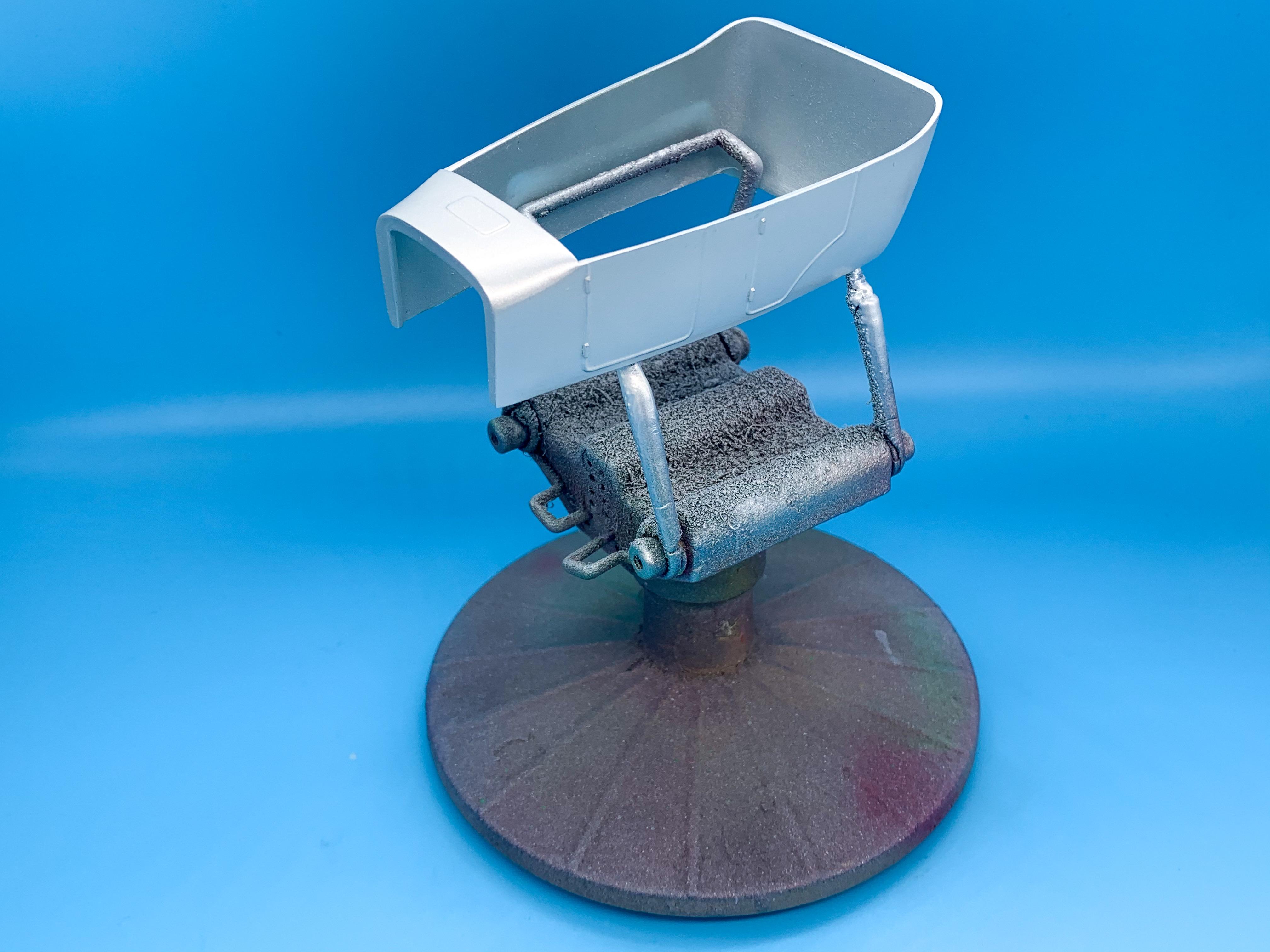

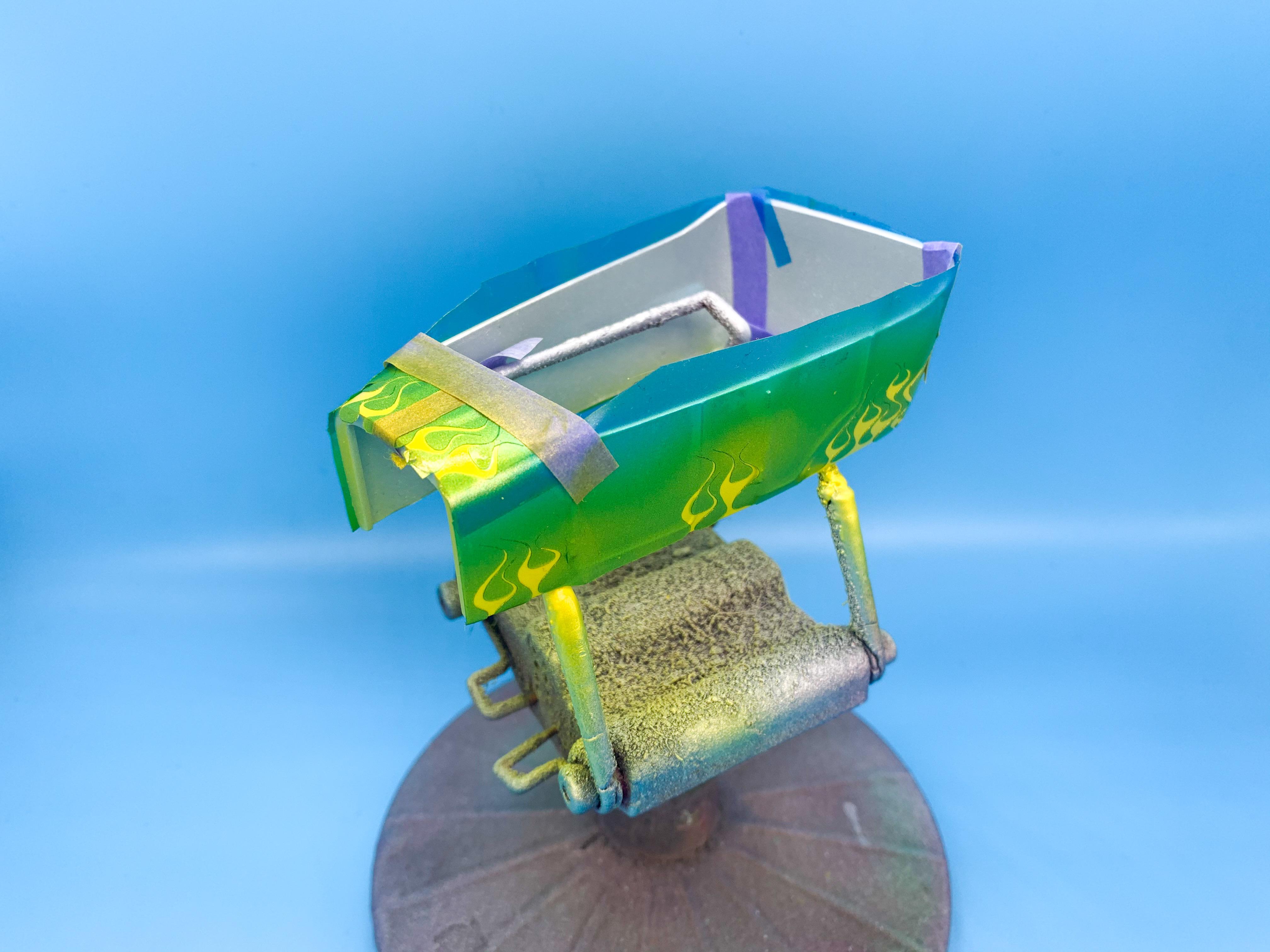

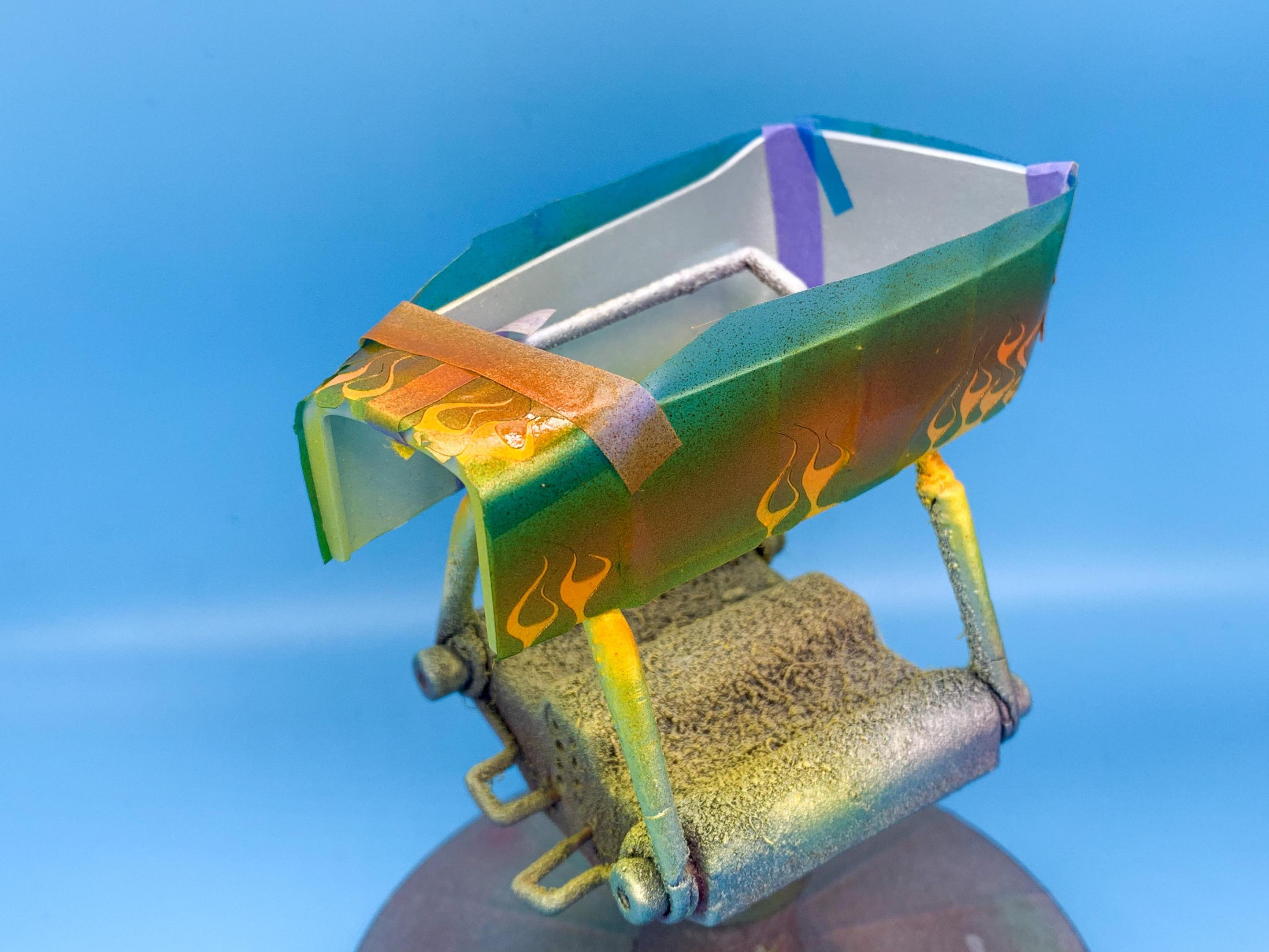

Got some paint on the body - first up, Wicked Colors pearl white:

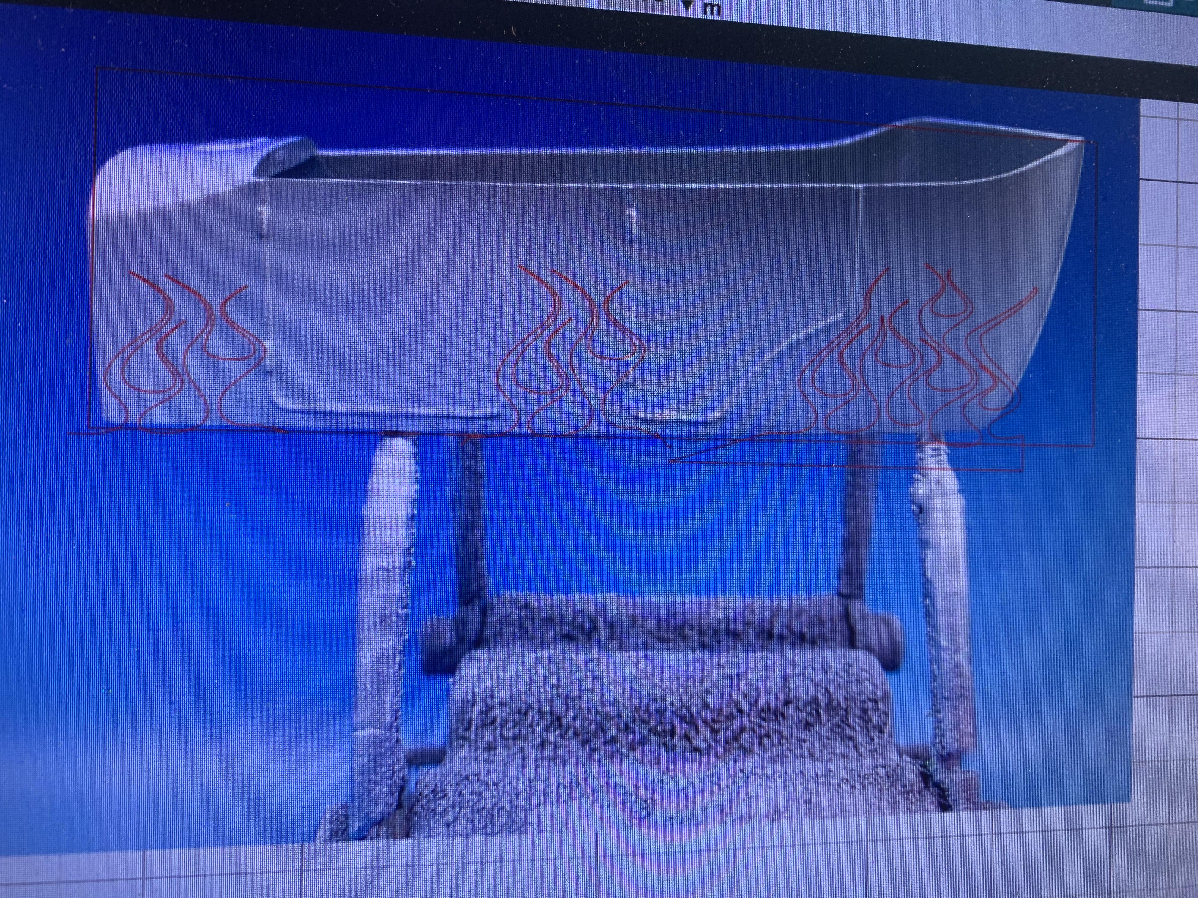

Then, after a coat of clear to protect the base color, I designed some vertical flames:

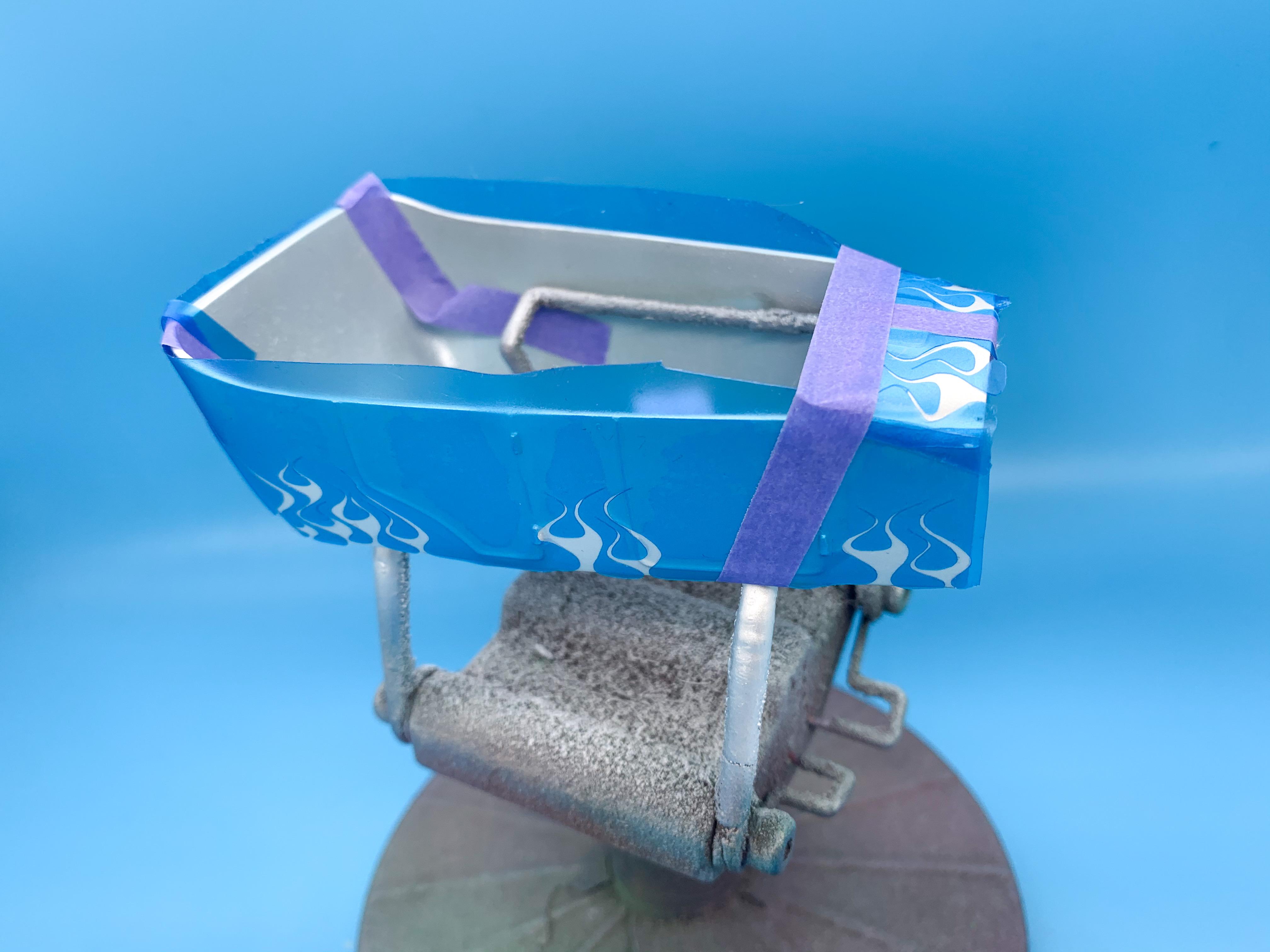

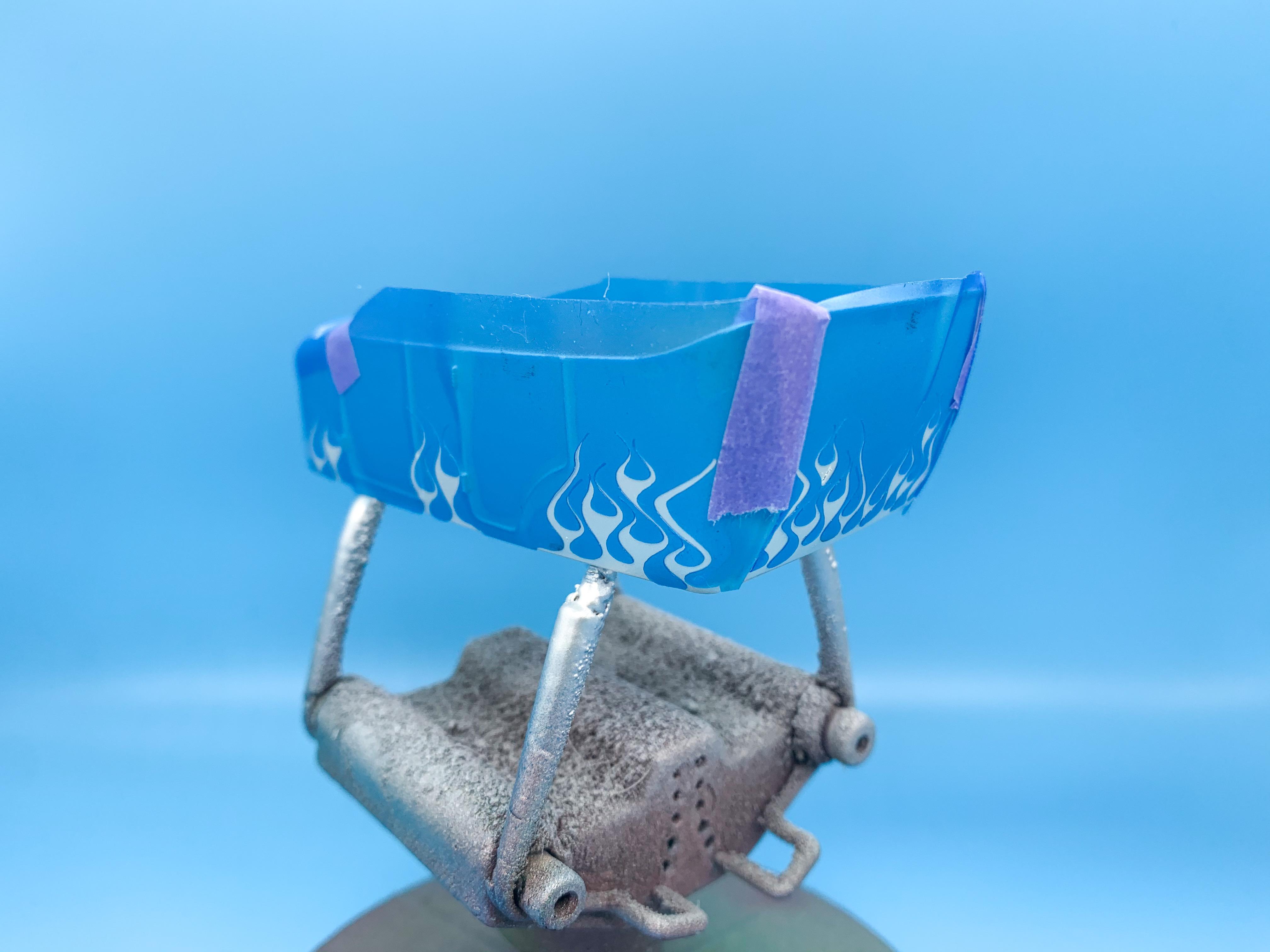

Then cut and applied masks:

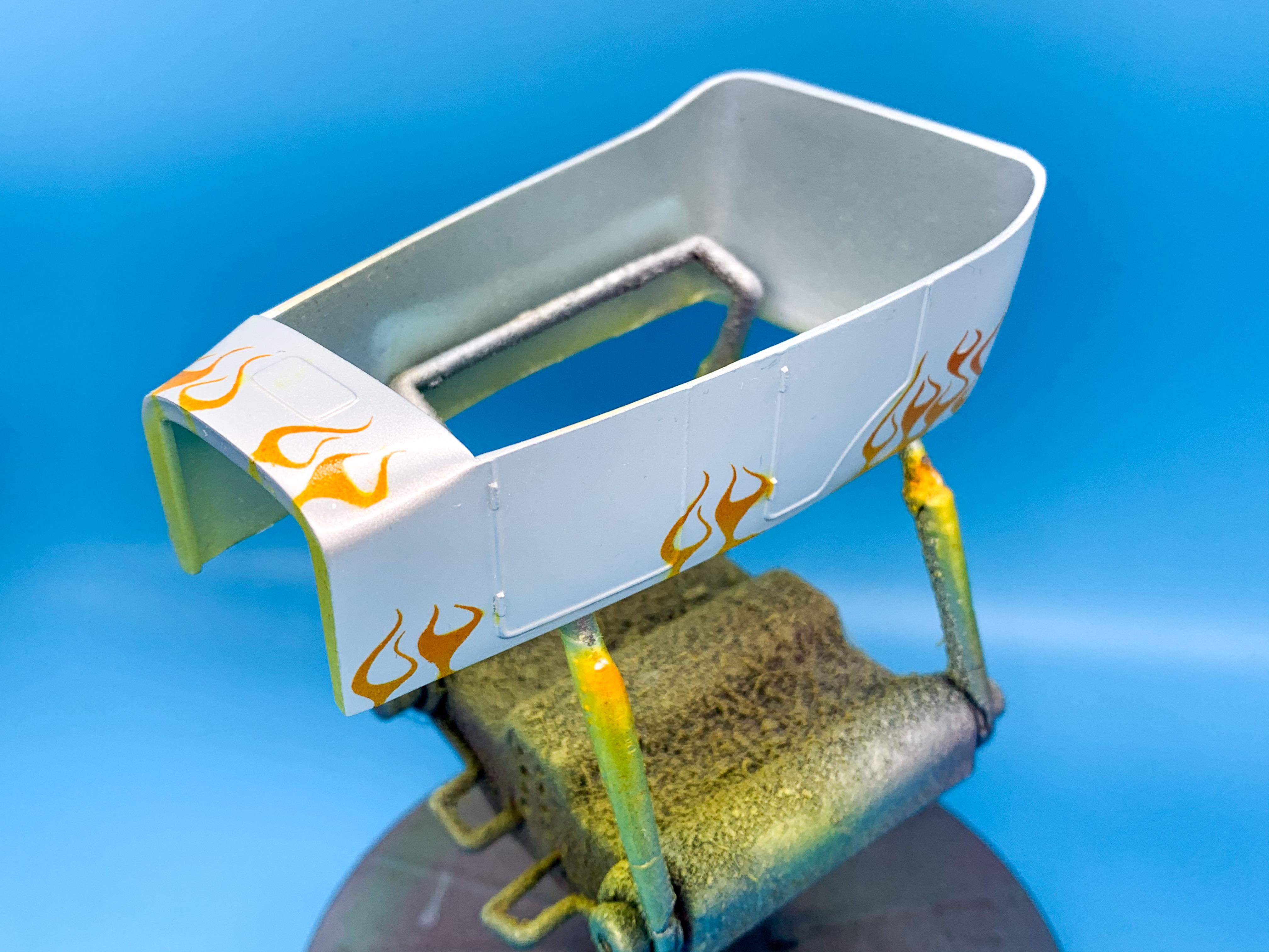

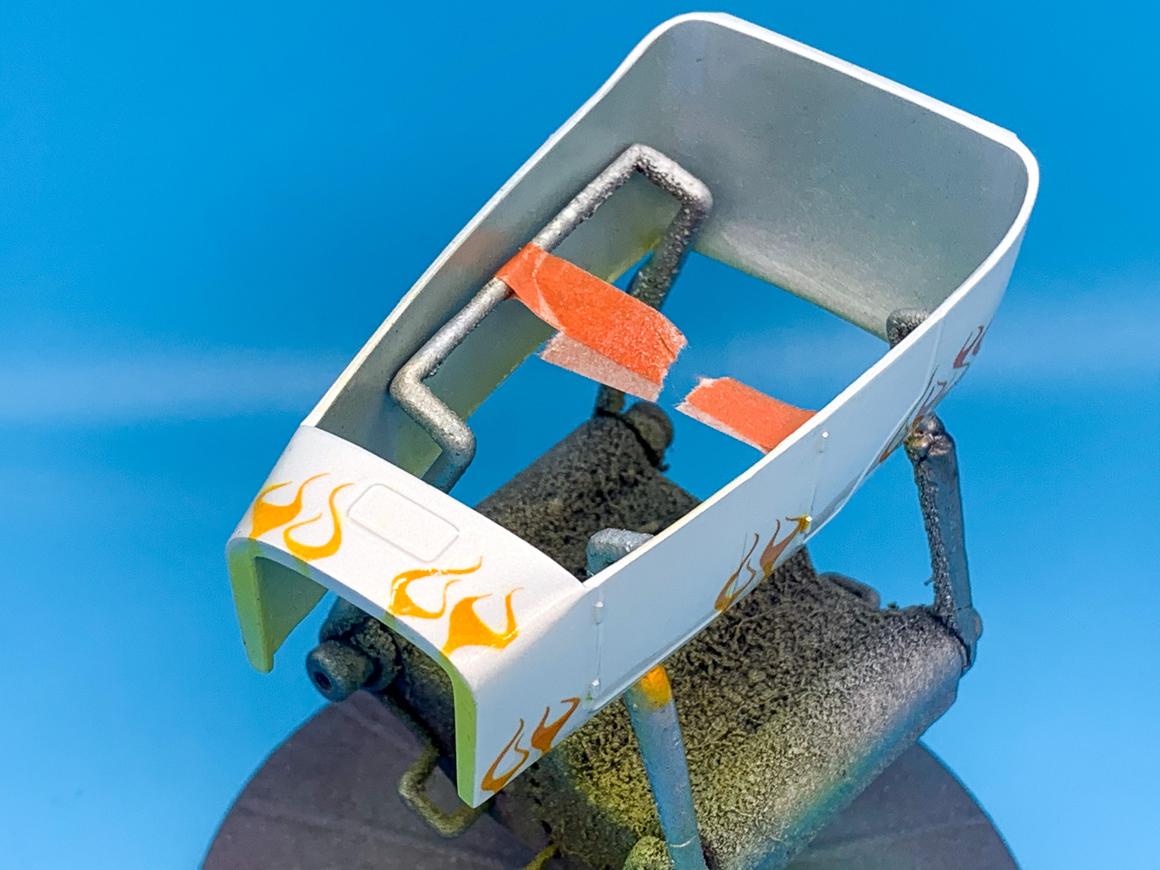

Then a coat of candy yellow:
Then, some candy orange:

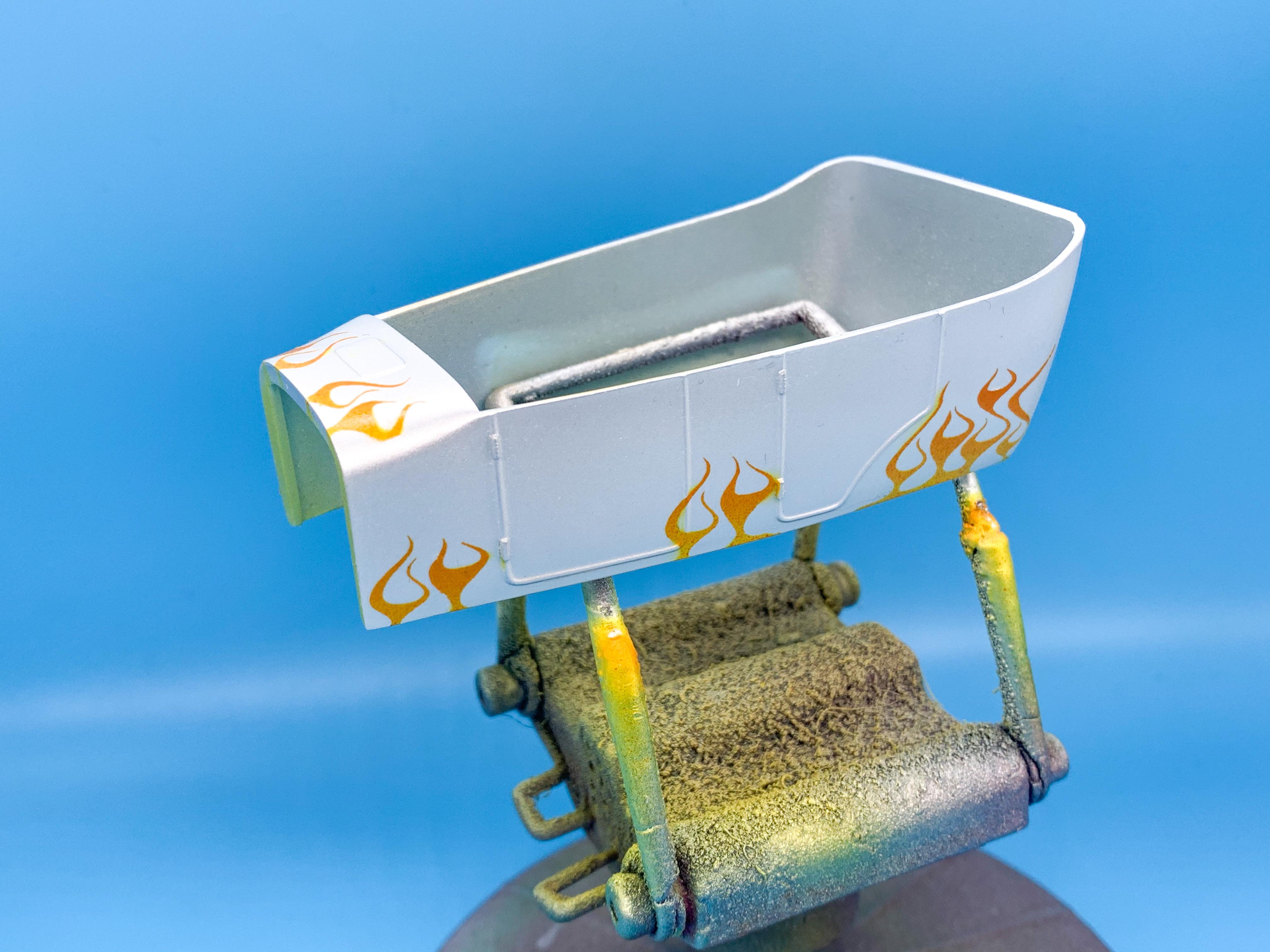

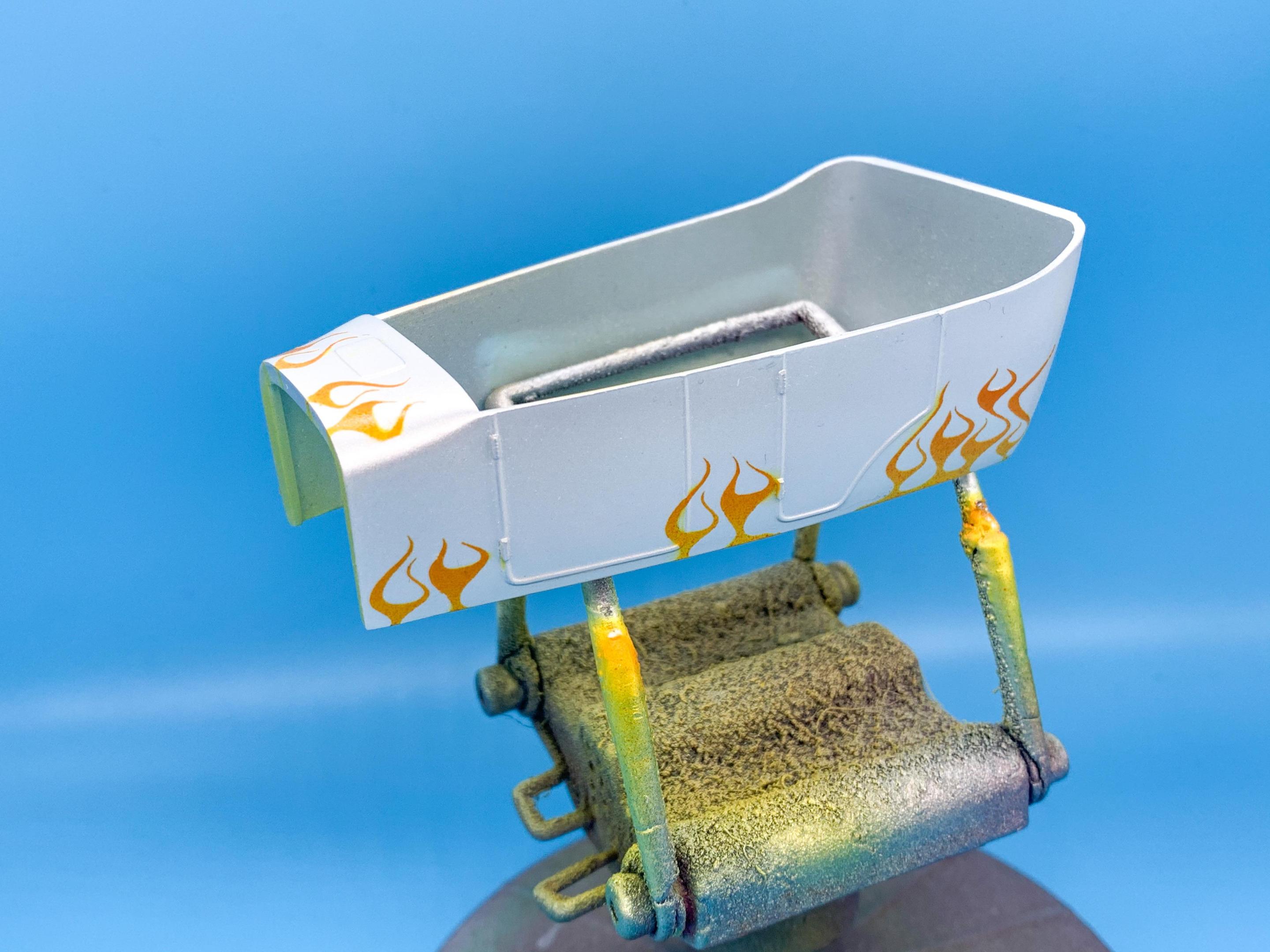

And then peel back the masks and hope ?
Came out pretty cool I think - something a little different!
I’ll do a little clean-up with thinners once the paint has set up a little bit here and then bury it all in some clear.

Tiny update - cleaned up the flames, shot some clear!  Can’t wait to see it in the daylight - the pearl white especially looks really sparkly under some gloss!  More progress tomorrow hopefully!

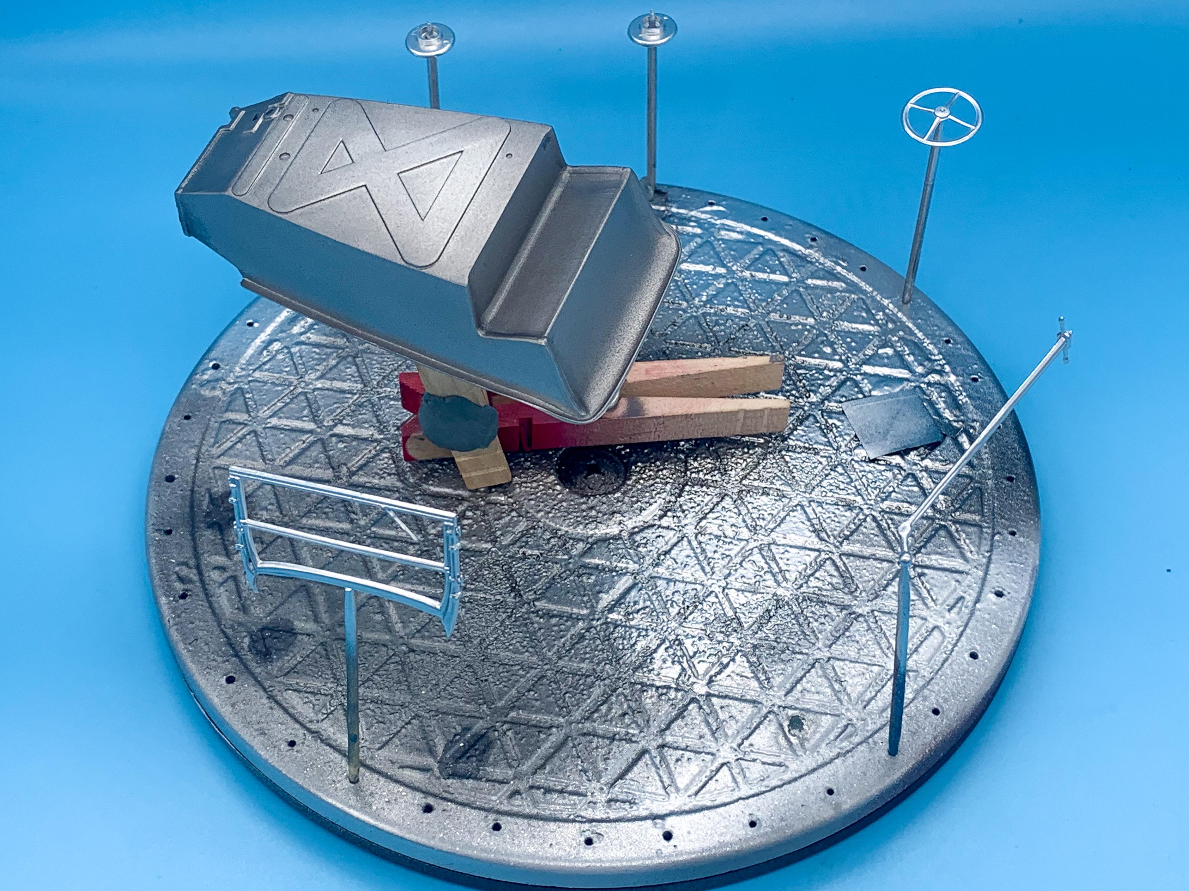

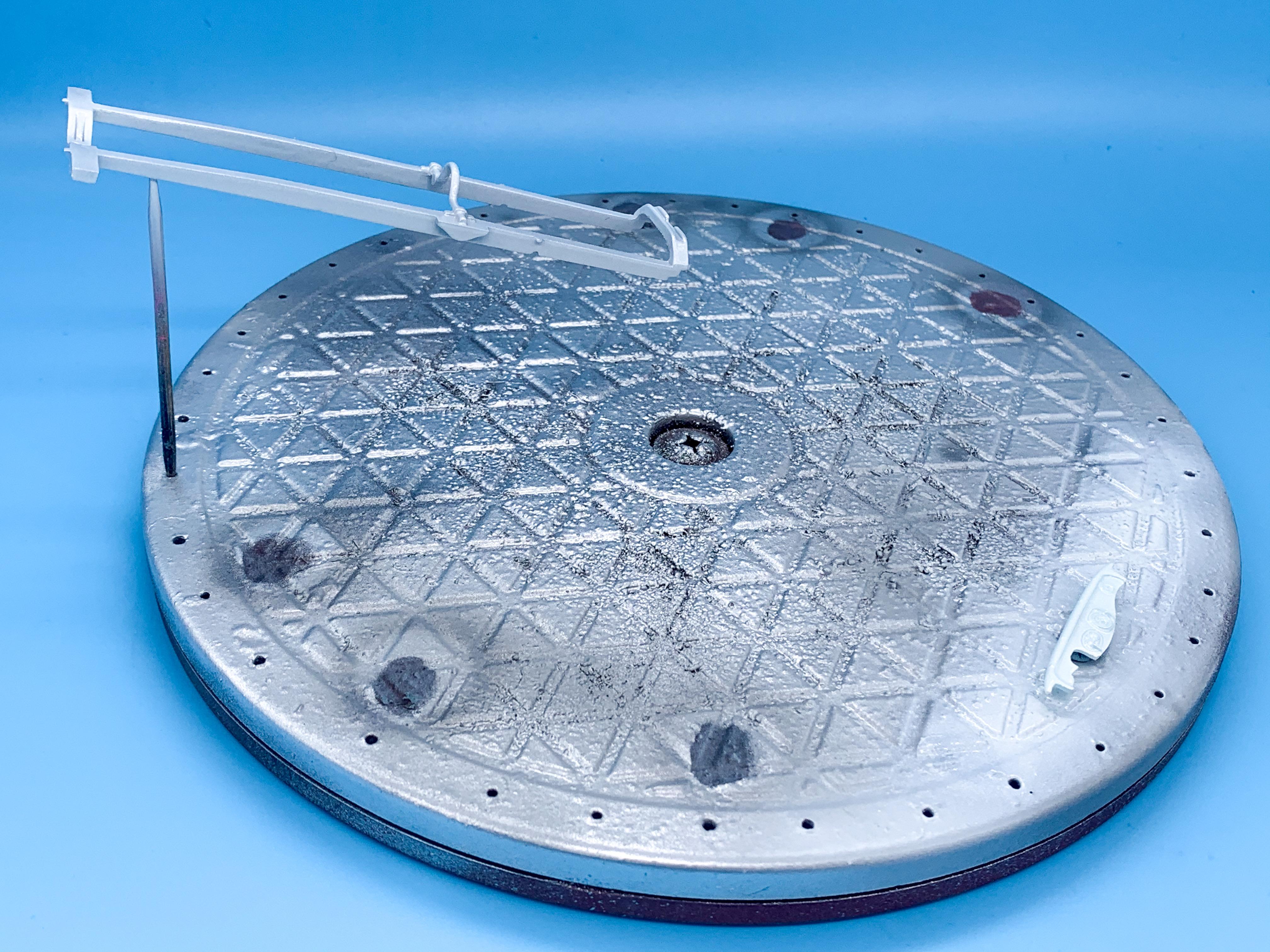

Shot the frame and the dash in matching pearl white;

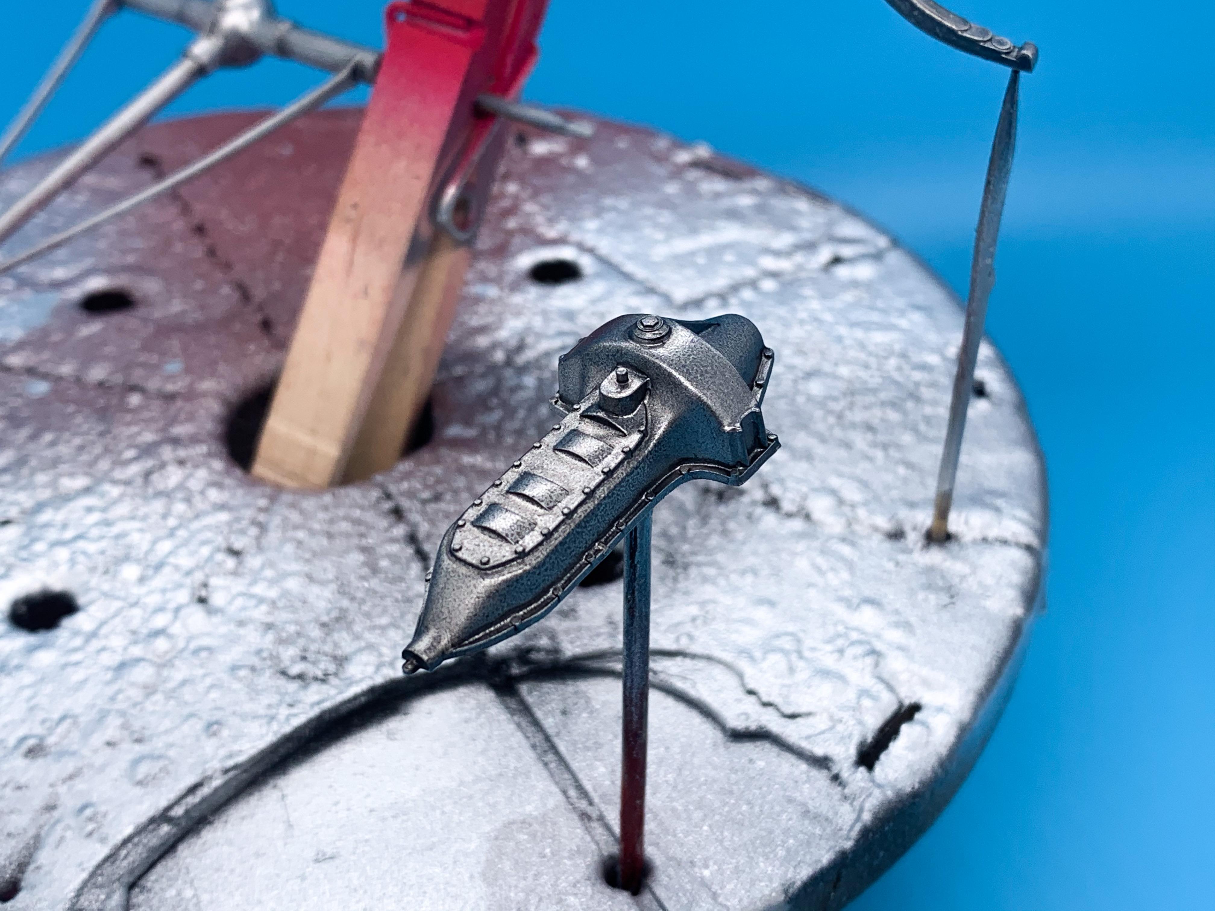

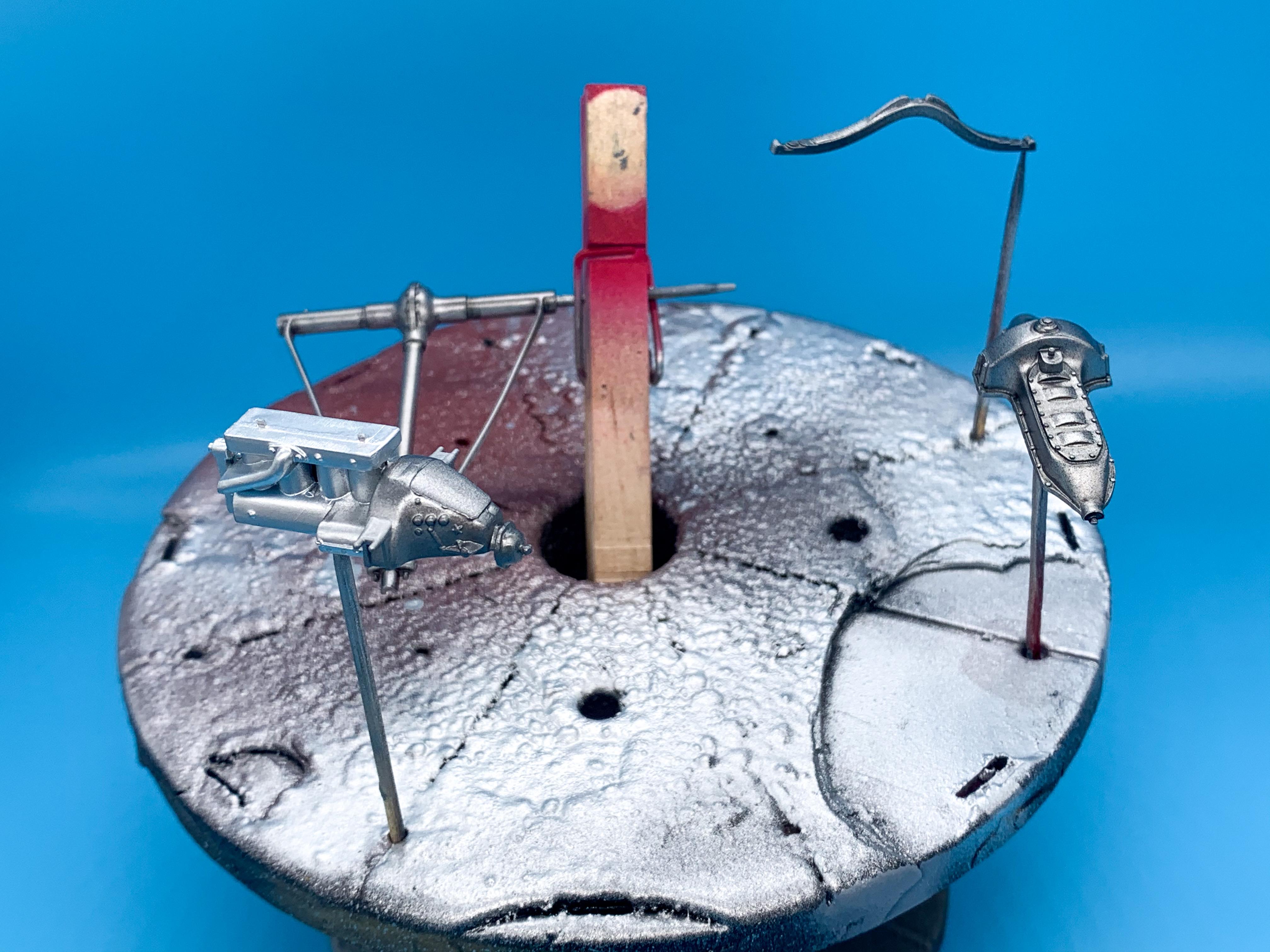

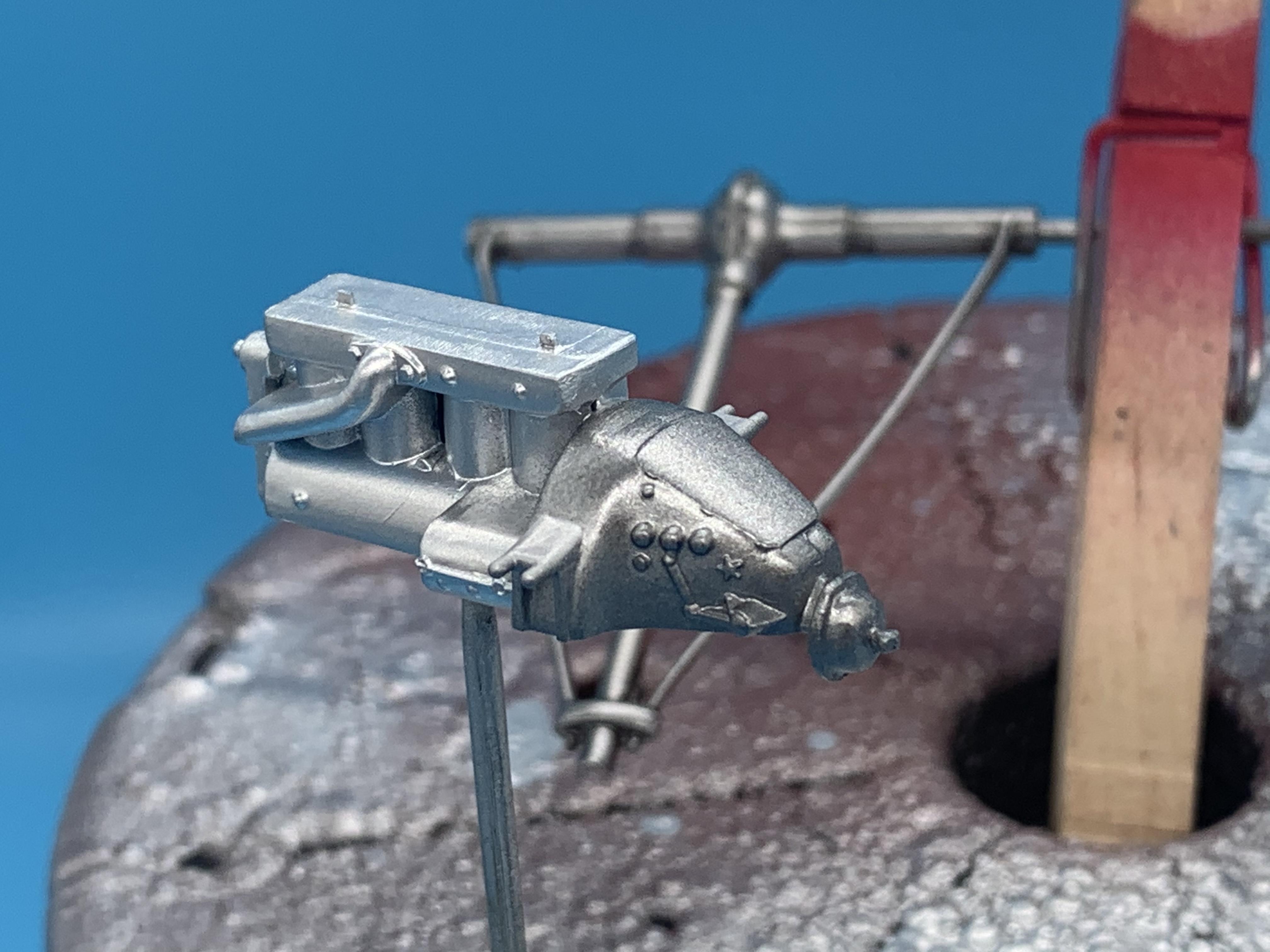

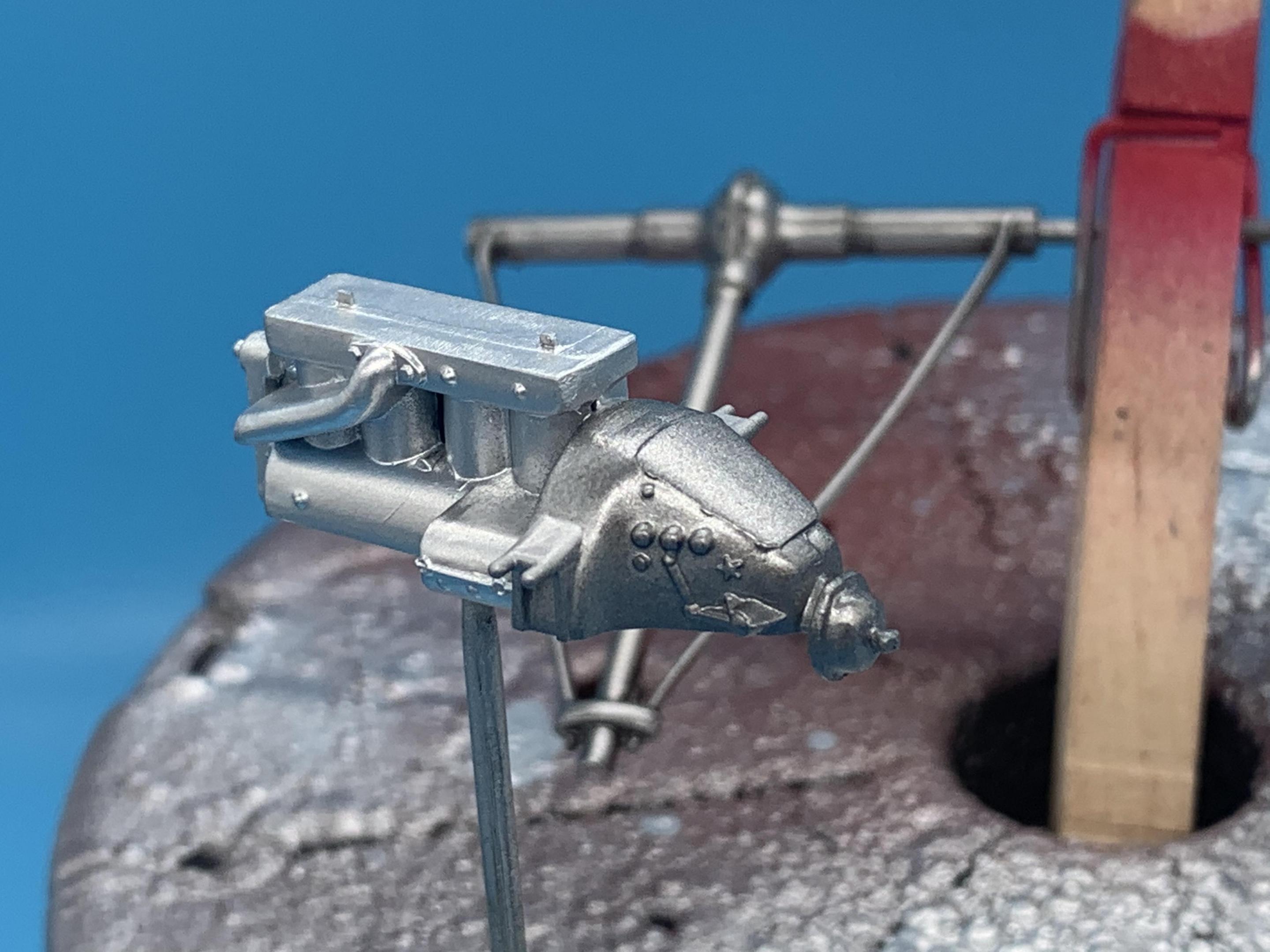

And shot a bunch of the ‘metal’ parts:
Lately, I’ve been enjoying using Duplicolor silver as a base - as you can see from the block above it gives a decent bright aluminum shade right out of the can, but you can give it a light mist of something like Vallejo steel and give a polished metal look in the flavor of your choice.  For example, I wanted a polished steel kind of look for the pan;

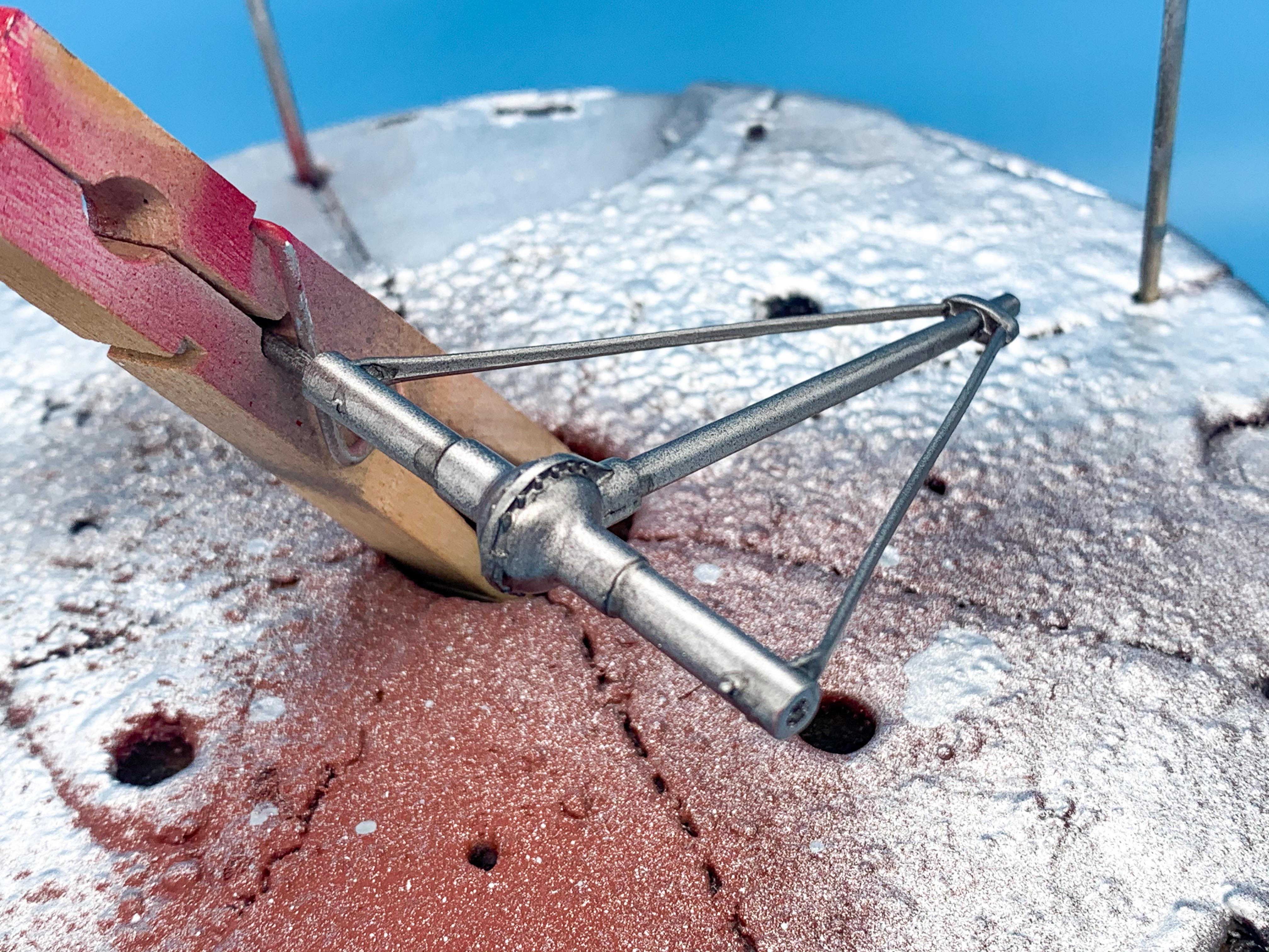

And a variation on that for the rear axle assembly:
I’ve used some washes of watercolor ink to bring out the detail in these parts a little, but the combination of the two paints gives a decent realistic bare-metal type of finish I think.  I’ll add a very light dry-brush of silver to both of these before I’m done, but I’m pleased with the general effect.  I’m going for a “real old but cared for” kind of finish to the metal parts - a little natural ageing in terms of color but without a bunch of gunk and rust and stuff on them.
Meanwhile, I read a thread on one of the Model T sites about a guy who’s making aluminum blocks for 1:1 Ts, and I thought that would be a cool thing to replicate, so I’ll be using the Rustoleum silver to give a shiny-but-not-chrome-y finish to the block on this one - with a darker steel tone for the trans:
Still some parts to pick out on this, obviously, with some different colors but more on that tomorrow!

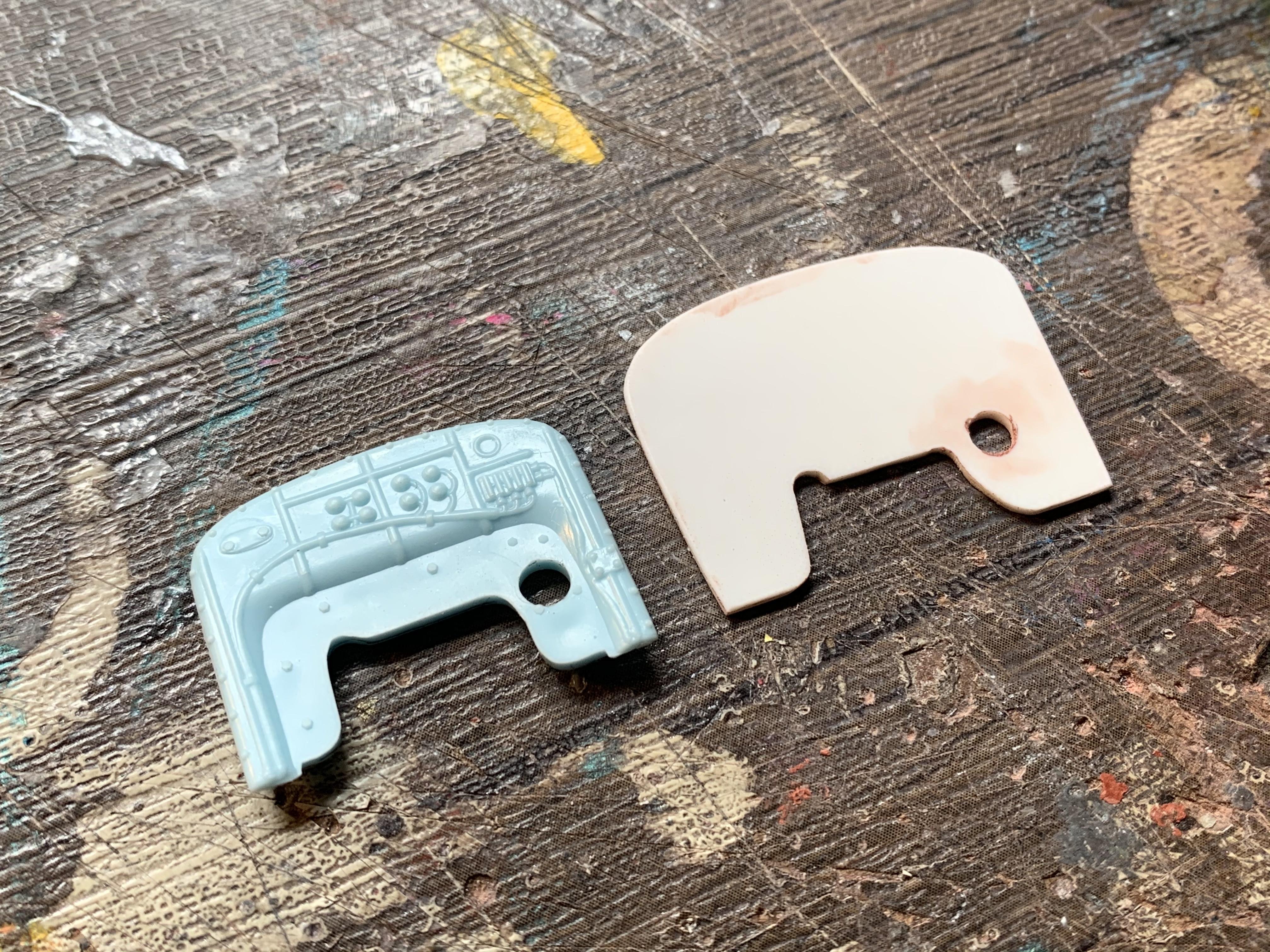

And another small deviation from kit was to make a smooth firewall like Tim’s build that inspired this one...
I’m not sure if my kit was missing this part, or it was on the sprue with the other cool parts I’m missing compared this this earlier version...but nothing a little styrene sheet couldn’t overcome;

Every time I see your flame jobs it blows me away how sharp and precise you get the outlines.  Are these stencils handcut or do you use a some sort of computerised cutter? Either way they look awesome.  I think Von Dutch did vertical flames once but other than that, you never see them.  A subject like this is just wacky enough to make it work!
I’m using a Silhouette Portrait scrapbook cutter to cut Oramask 813 masking film - but nothing to stop you doing it by hand either!  I wish I was good enough to consistently get what I want with a pencil, but a computer helps me at least make things symmetrical and repeatable easily...thanks for the kind words Alan!

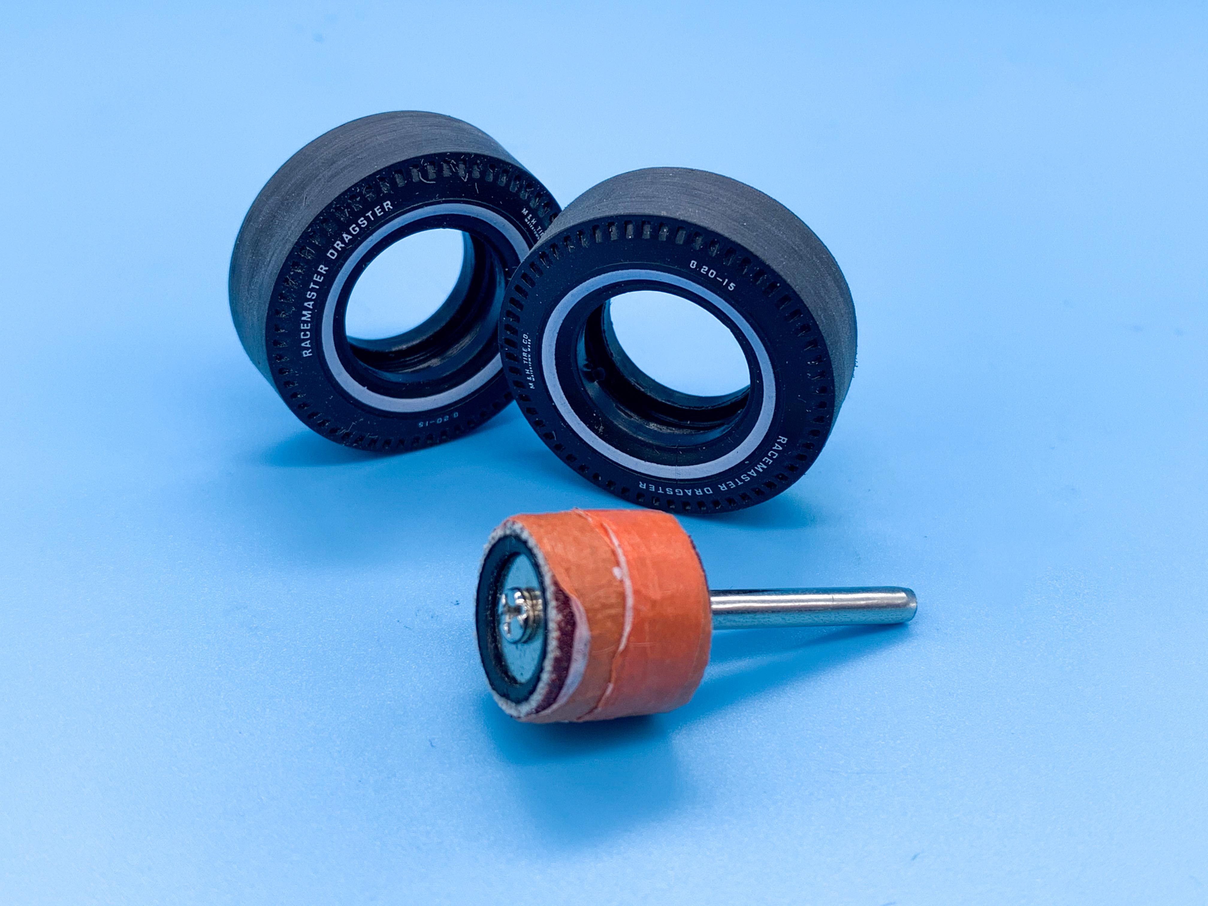

De-shone (de-shined?  Un-shinified?) the tires...

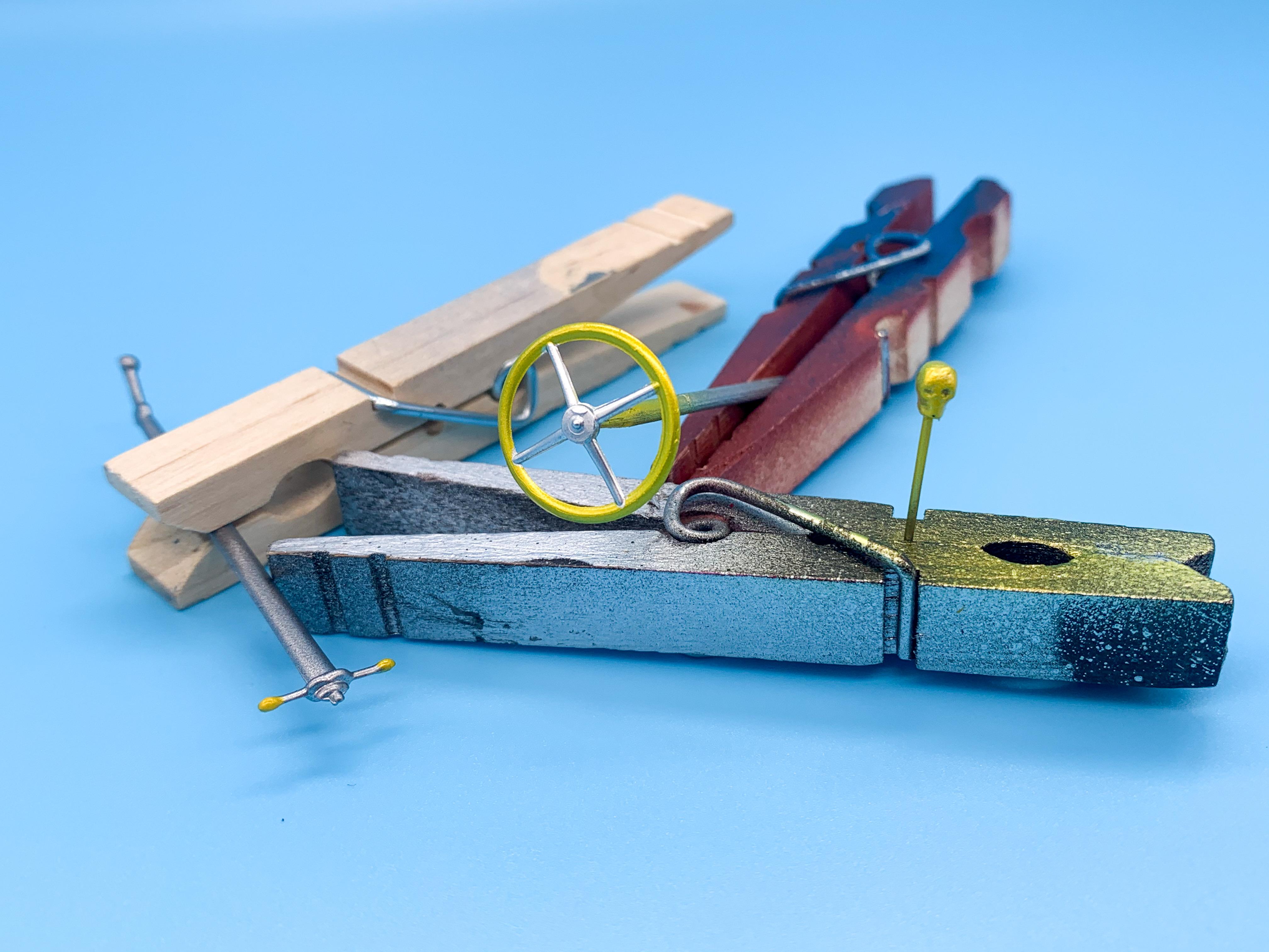

Started painting some little interior parts - used the stock steering column and wheel, but I’ll change the shifter for a wire one with one of my little resin skull-heads:

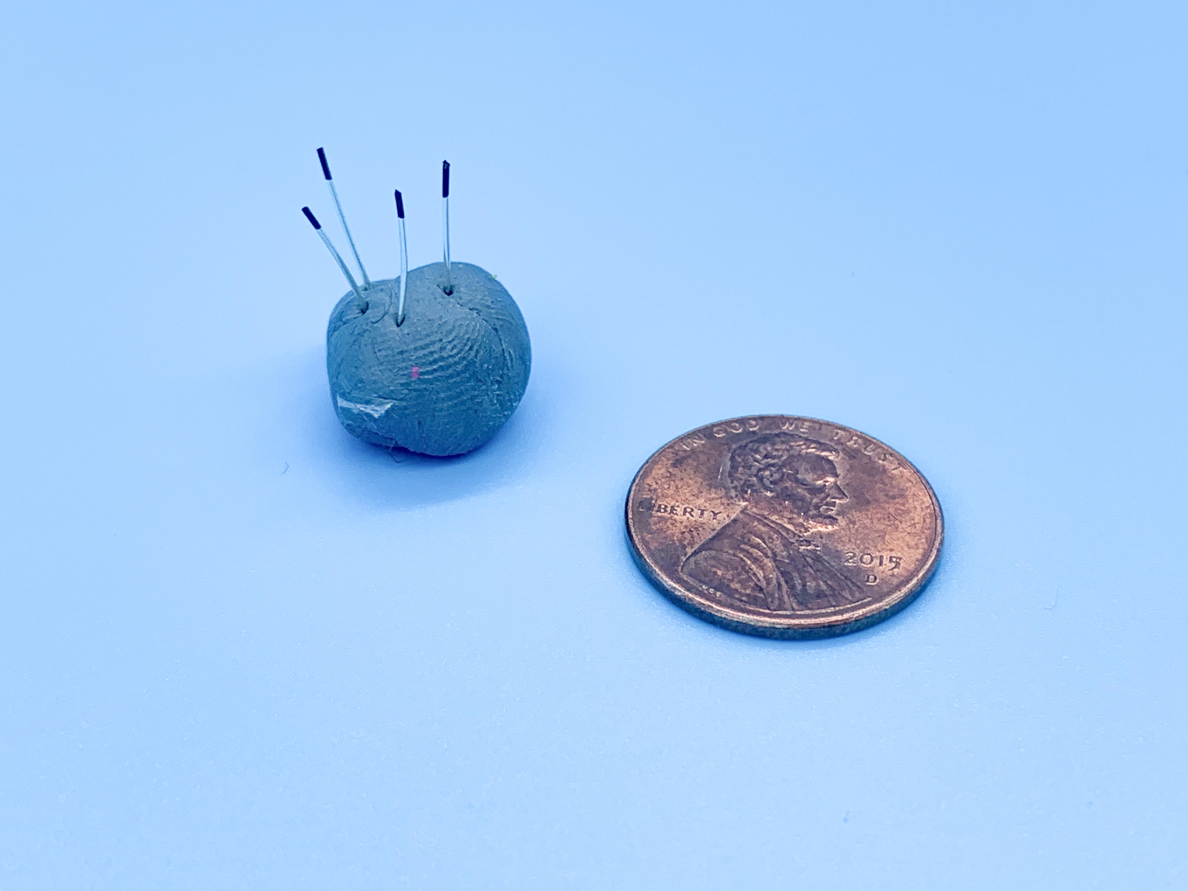

Made some valve stems for the wheels (thin gauge wire dipped in some black paint):

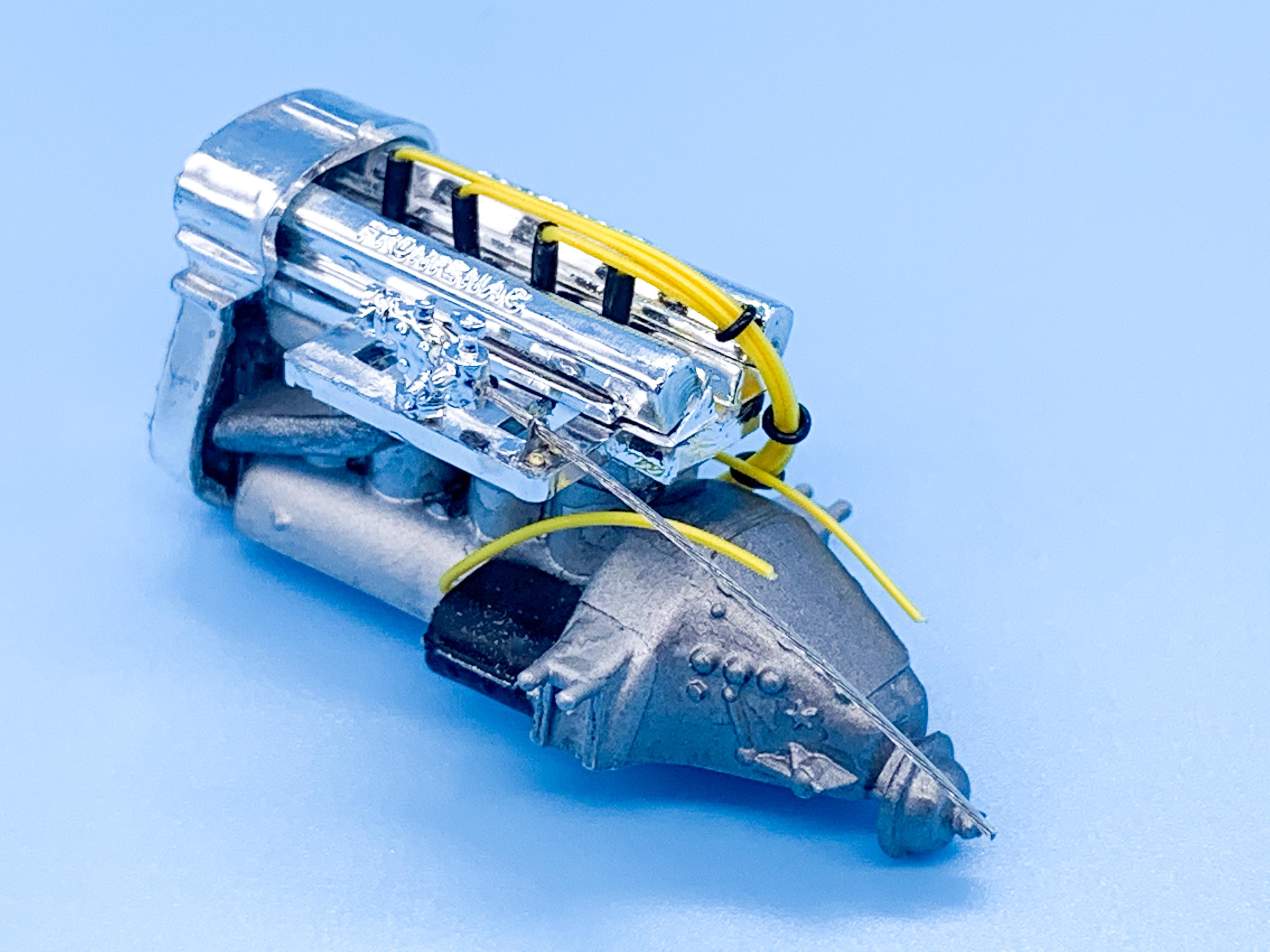

And wired up the engine:
And fitted the carb and a fuel line (not that it’s super visible anyway, with all the silvers and chromes on there...
Got some little touch-ups and further detail painting to do on the engine now that I’ve finished doing those little bits, and now that’s far enough along I can get the frame together!  More soon!
