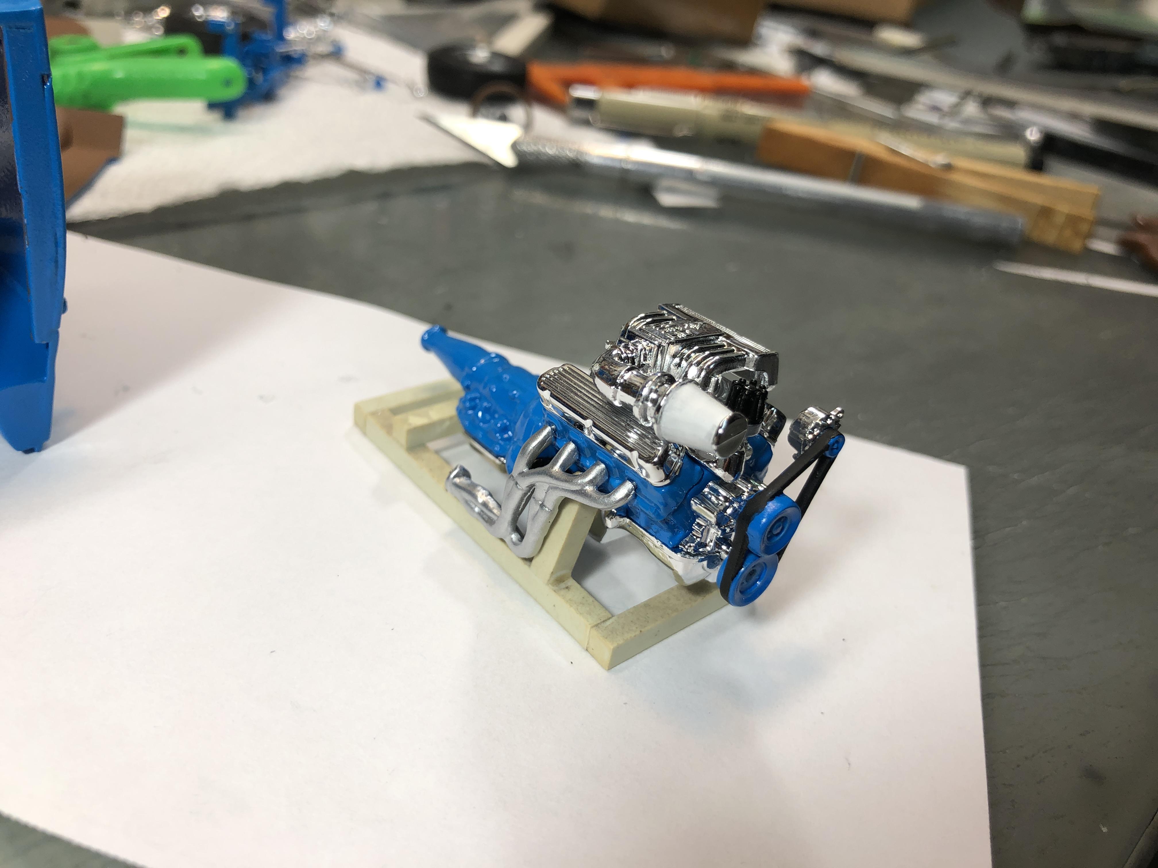

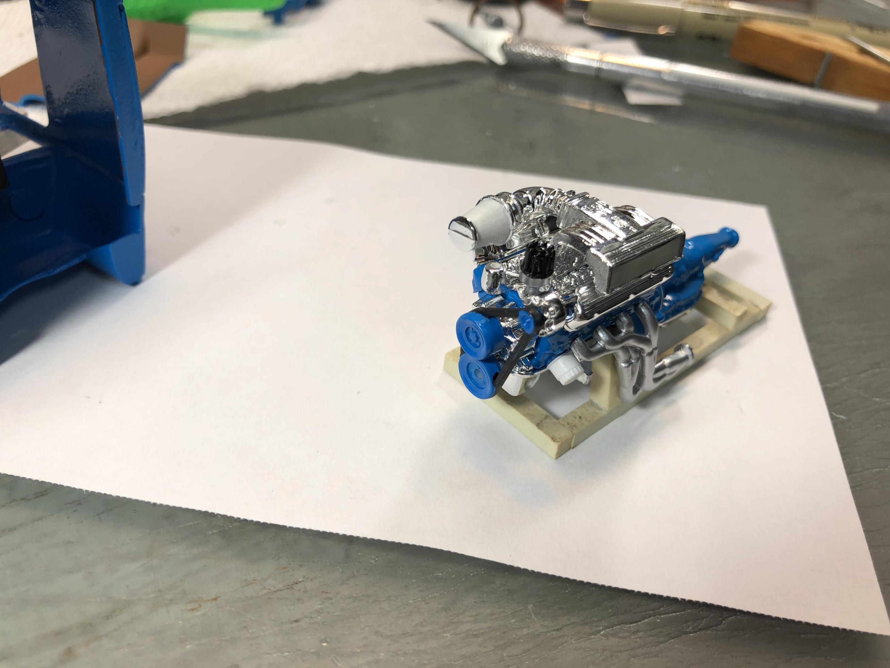

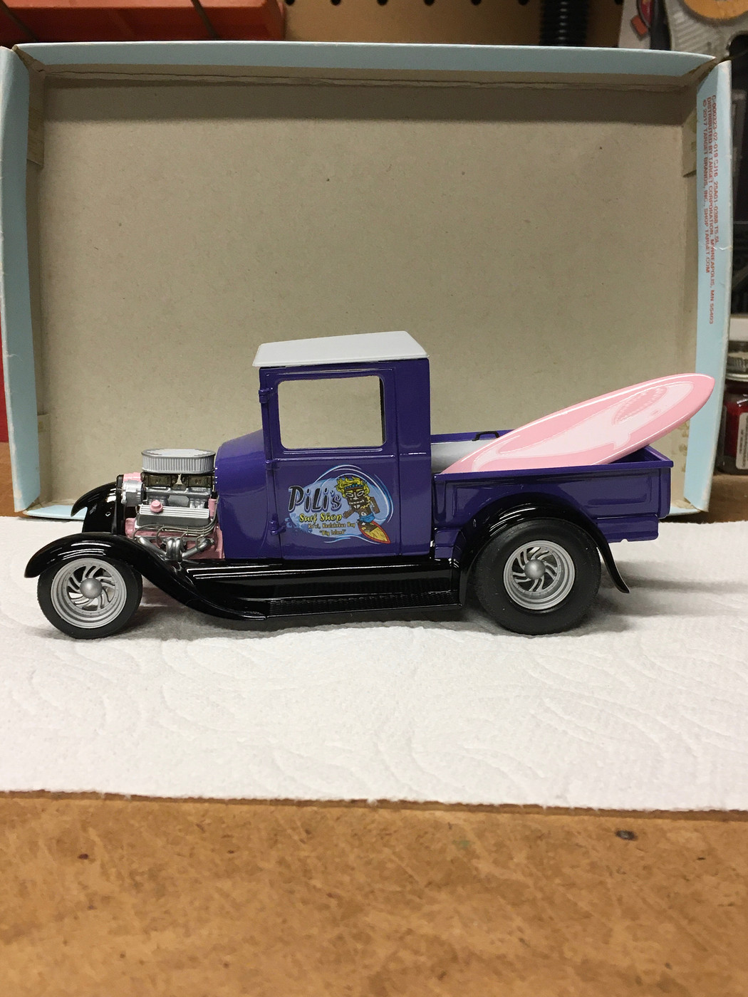

I haven't been doing too much on my pickup lately. Putting in windshield tonight. Final assembly always drags for me....I did get the SBF powerplant going...a lot of BLING!!!! -RRR
Edited by Rocking Rodney Rat
  • Like 1
Won't be able to hide this under a hood! Shinny distraction draws the eye to the chrome backed by an ample amount of Oval Blue!! Excellent presentation, Brother!!!  -KK

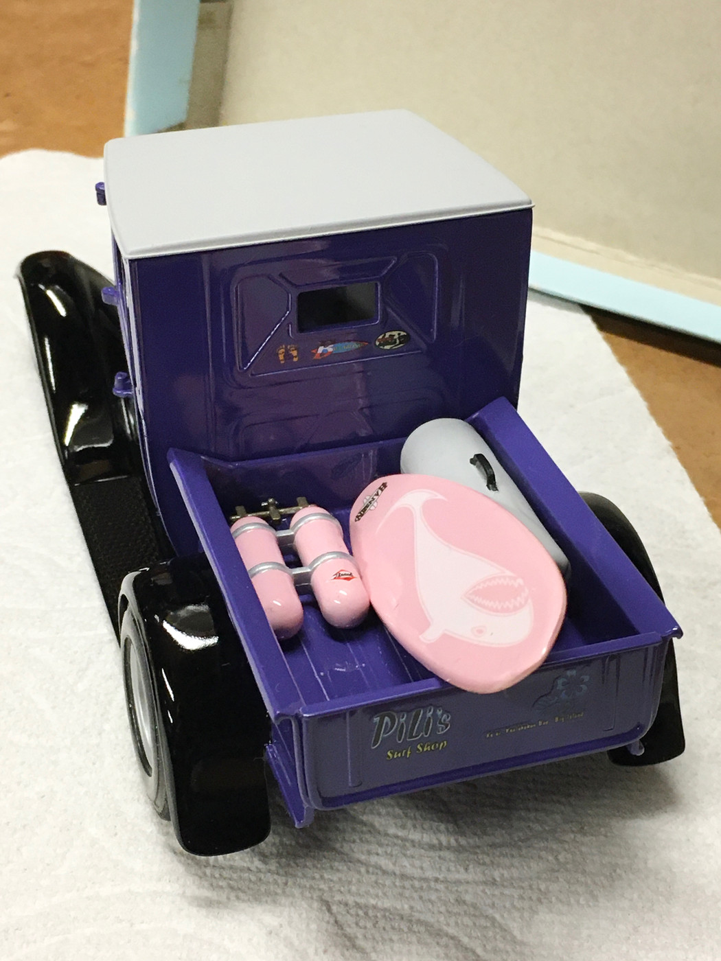

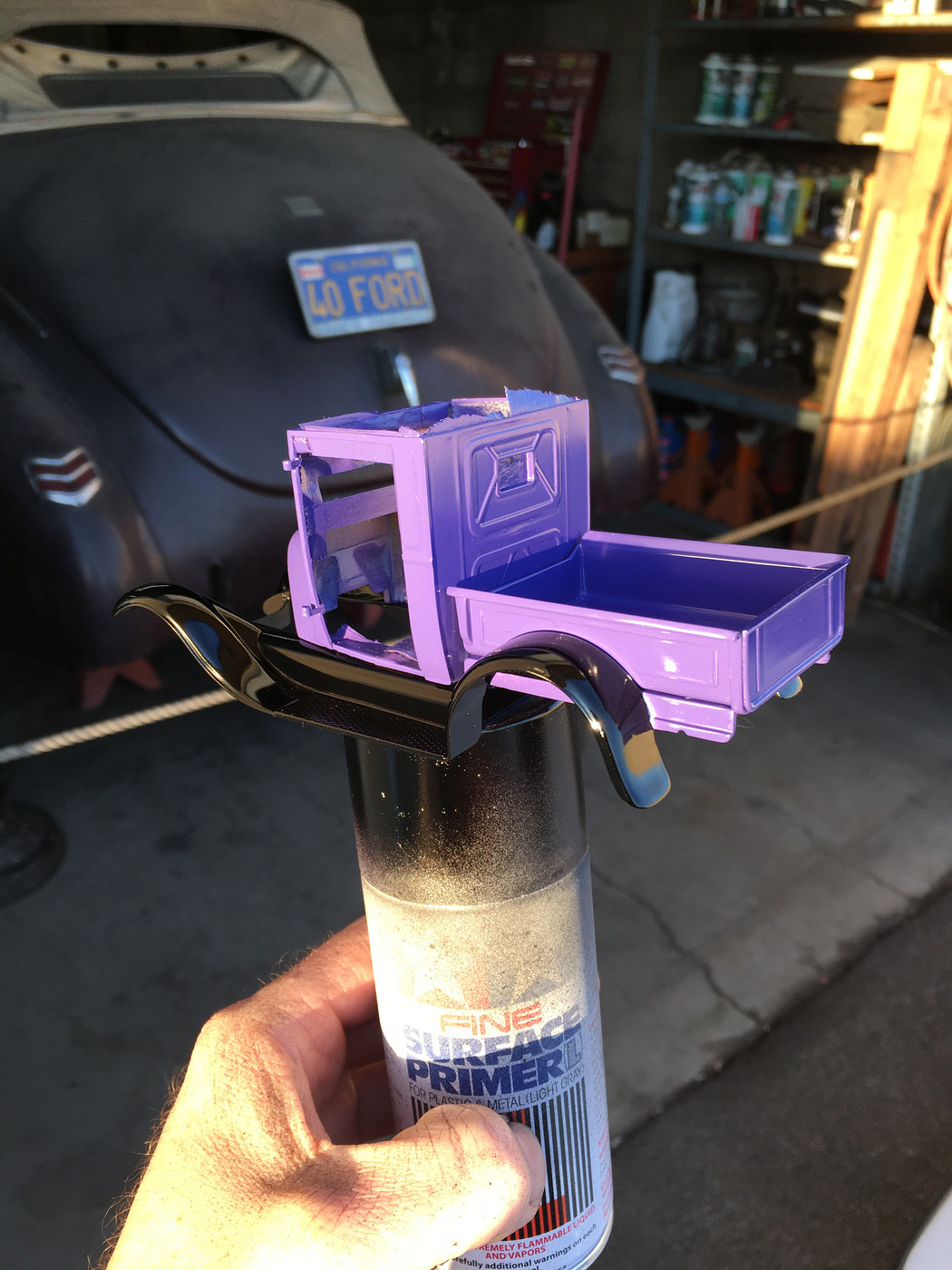

Wait no further, here's a huge update!
I know my own progress has been lagging a bit but for good reason. I've been focused on getting this thing painted over the last 5 days. The week prior the weather was a bit cooler and wetter than I felt comfortable with so I had to wait for some Sun and 70's this week.
Everyone knows what primer looks like so I won't bore you with that. I will say that before primer I prepped the body parts by wet-sanding with 600g, sprayed Tamiya fine gray primer, wet-sanded that with 1500g, and another thin coat of fine gray just to make sure there was no bare plastic showing anywhere. No sanding, paint, decals, clear.

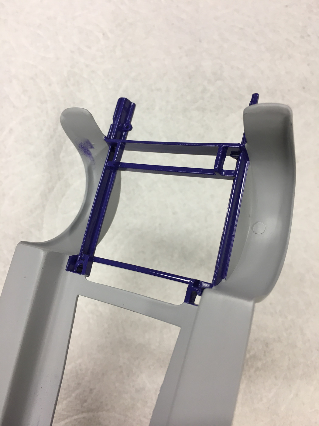

On day 1 the first order of business was extensive masking of the fenders and inside of the cab to keep the Tamiya Purple (mostly) where it belonged. Not shown are the doors and front shell.
On Day 2 more extensive masking up the now purple bed support structure and spraying the rest of the fender unit Tamiya Black.

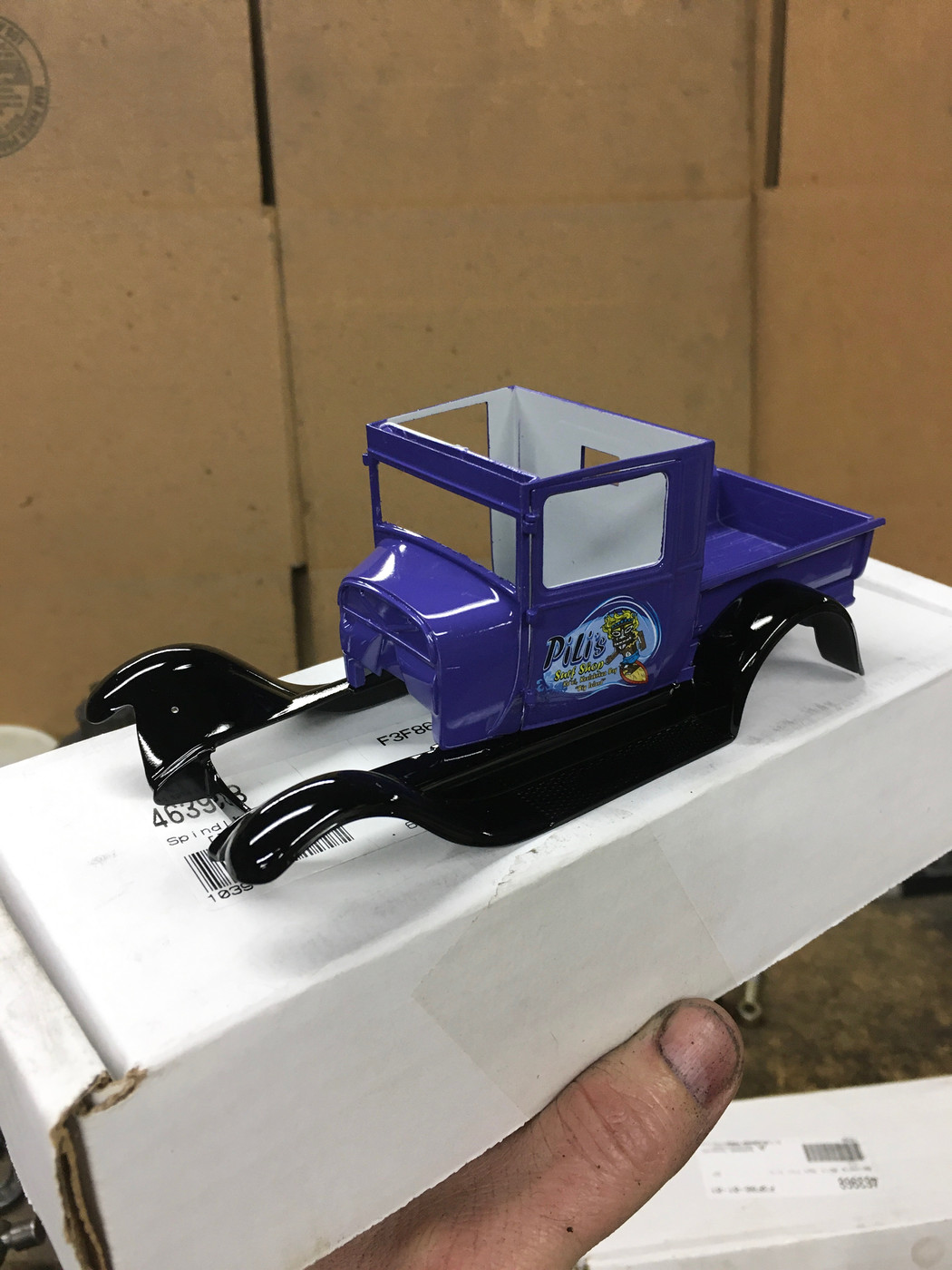

Pulling the masking tape off of the bed support structure resulted in this:

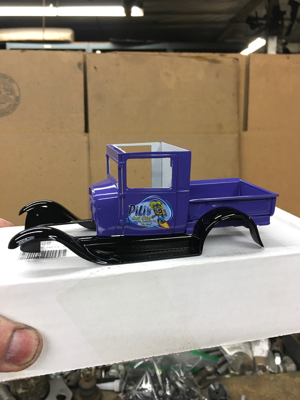

On Day 3 it was decals which I allowed to set up over night and on Day 4 it was time to seal everything in with Tamiya Clear. Finally all of the tape was pulled out of the cab protecting the gray interior finish.
I couldn't wait to bring everything home for a mock up on the bench. This should give you all a very clear vision of where this thing is headed! Won't be much more to post as I wait a few weeks for the paint to fully gas-out so that it's safe to polish and wax. Then final assembly will commence. In the meantime I do still need to mask the top sides of the fenders, cab and bed so that I can spray the undersides flat black. I also have a touch more to do on interior detail painting then I'll show that group of parts. Let me know what you all think!
