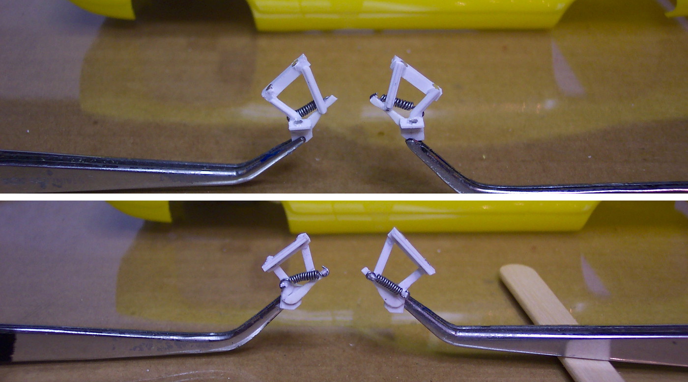

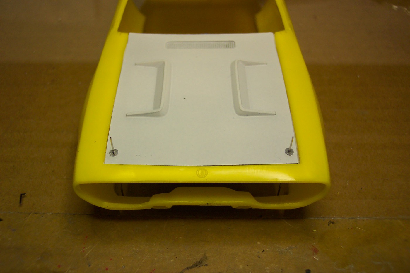

TooOld Posted November 24, 2020 Author Posted November 24, 2020 Before prepping the body for paint there are a couple of things I want to add , one is these hood pins . After looking at some photos I marked the location of the pins on the hood . Of course they don't line up with the plastic pads I added to the fenders . I didn't want to make new pads so I checked the size of the scuff plates against my locations and decided to move the pins outward and then drilled the holes . The next issue was that the "eye" end of the pins wouldn't go through the scuff plates (top image). After some careful filing , and ruining two pins , I have two that will drop through the scuff plates (bottom image). I'm glad that's done . I still need to add some material to the underside of the fender pads so the pins can be epoxied in place .

TooOld Posted November 29, 2020 Author Posted November 29, 2020 I hadn't planned on gluing the hood pins now but figured if I waited something wouldn't fit . . . or I'd ruin the paint gluing them in place . So after adding some material underneath I used CA to glue them in place . Earlier I also transferred the hole locations from the Charger body for the rear spoiler . The last couple of days I made the hood hinges . Thanks Steve for the great idea of using magnets ! Thin strips of .008" thick sheet metal were added to the hood and inner fenders using CA glue . Those tiny magnets are much stronger than they look !
