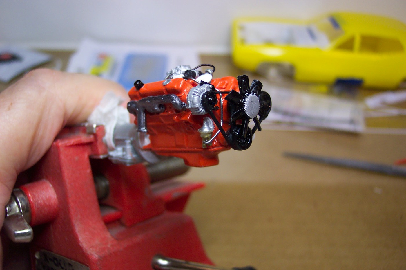

TooOld Posted October 29, 2020 Author Share Posted October 29, 2020 Yesterday I started on the engine from the Charger kit , not an expert but I'm guessing it's a 383/440 engine ? After white primer I masked of the block and sprayed the transmission Flat Aluminum , then masked the trans and painted the engine Hemi Orange . Carb , coil , and exhaust manifolds installed . Distributor base is for a MAD distributor , I added the vacuum advance and hose . I also added a PCV Valve and hose , and the brass fitting for vacuum hose to the brake booster . Yesterday I also painted a bunch of the smaller parts but turns out I rushed things a bit . The belts/pulleys have A/C and I want to remove that so time to cut it apart . I forgot to take a pic so I've added the drawing from the instructions . I'm also cutting up the belts from the Roadrunner kit and will combine the two . Modified belts/pulleys on the engine . Boy those belts are big ! I usually thin the belts with a file but this time I'll snip them one at a time and replace with .020" x .040" strips . It's much easier than you may think . I didn't do the inside belts since they're not really visible . Looks like I need to add a lower alternator bracket ! Finished belts ! Quote Link to comment Share on other sites More sharing options...

1972coronet Posted October 29, 2020 Share Posted October 29, 2020 12 hours ago, TooOld said: Yesterday I started on the engine from the Charger kit , not an expert but I'm guessing it's a 383/440 engine ? The engine in the 1971 Charger represents a stock 440 Magnum . Yes , in-scale , this engine could be any 1970-1978 383 / 400 or 440 *in "real" life there is a difference between those displacements' engine families ; means nothing in-scale , however . That "383" engine looks quite lovely ! All it needs is a decal for the air cleaner lid which reads : "383 Road Runner Engine" . I must inquire , however , as to why you decided to scrap the A/C setup (?) . You've already got the correct bonnet for an A/C equipped car (the standard bonnet) , as the Air Grabber couldn't be had with A/C . Keep up the great work ! Quote Link to comment Share on other sites More sharing options...

TooOld Posted October 29, 2020 Author Share Posted October 29, 2020 1 hour ago, 1972coronet said: The engine in the 1971 Charger represents a stock 440 Magnum . Yes , in-scale , this engine could be any 1970-1978 383 / 400 or 440 *in "real" life there is a difference between those displacements' engine families ; means nothing in-scale , however . That "383" engine looks quite lovely ! All it needs is a decal for the air cleaner lid which reads : "383 Road Runner Engine" . I must inquire , however , as to why you decided to scrap the A/C setup (?) . You've already got the correct bonnet for an A/C equipped car (the standard bonnet) , as the Air Grabber couldn't be had with A/C . Keep up the great work ! Thanks for the info John , I figured externally it could be any big block . I do have a 383 Roadrunner decal for the air cleaner lid so I'm all set . As for removing the A/C , it's just a personal preference . I think the engine looks much nicer without the compressor sticking up in the front ! Quote Link to comment Share on other sites More sharing options...

TooOld Posted November 2, 2020 Author Share Posted November 2, 2020 (edited) Finally had some time yesterday to get a bit more done on the engine . Lower alternator bracket was added , and I modified a Chevy fuel pump to resemble a Mopar pump and added fuel line made from solder . Also made a fuel filter out of styrene rod . Oil filter glued in place and I added a dipstick . I modified the air cleaner housing by opening up the snorkels , adding vacuum lines , and I added the hose to the valve cover breather . Here's the housing decal artwork I created a while ago . It lost a little resolution when reduced but still looks pretty good . And the finished housing . It still needs coat of clear . Edited November 2, 2020 by TooOld Quote Link to comment Share on other sites More sharing options...
TooOld Posted November 2, 2020 Author Share Posted November 2, 2020 Finished Engine . To be continued . . . Quote Link to comment Share on other sites More sharing options...

1972coronet Posted November 2, 2020 Share Posted November 2, 2020 Spectacular work ! Super nice 300hp 383 ! That thermostatic air cleaner is gorgeous on its own ! Quote Link to comment Share on other sites More sharing options...
