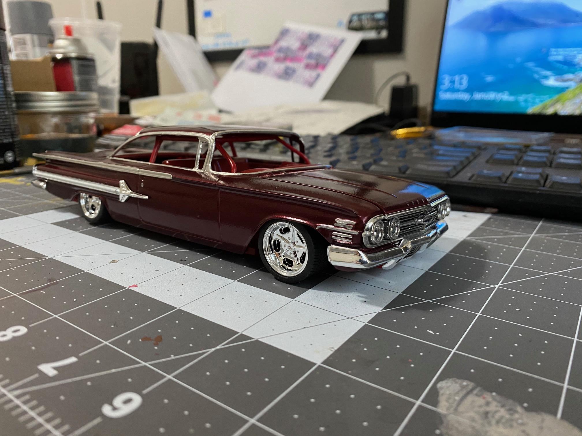

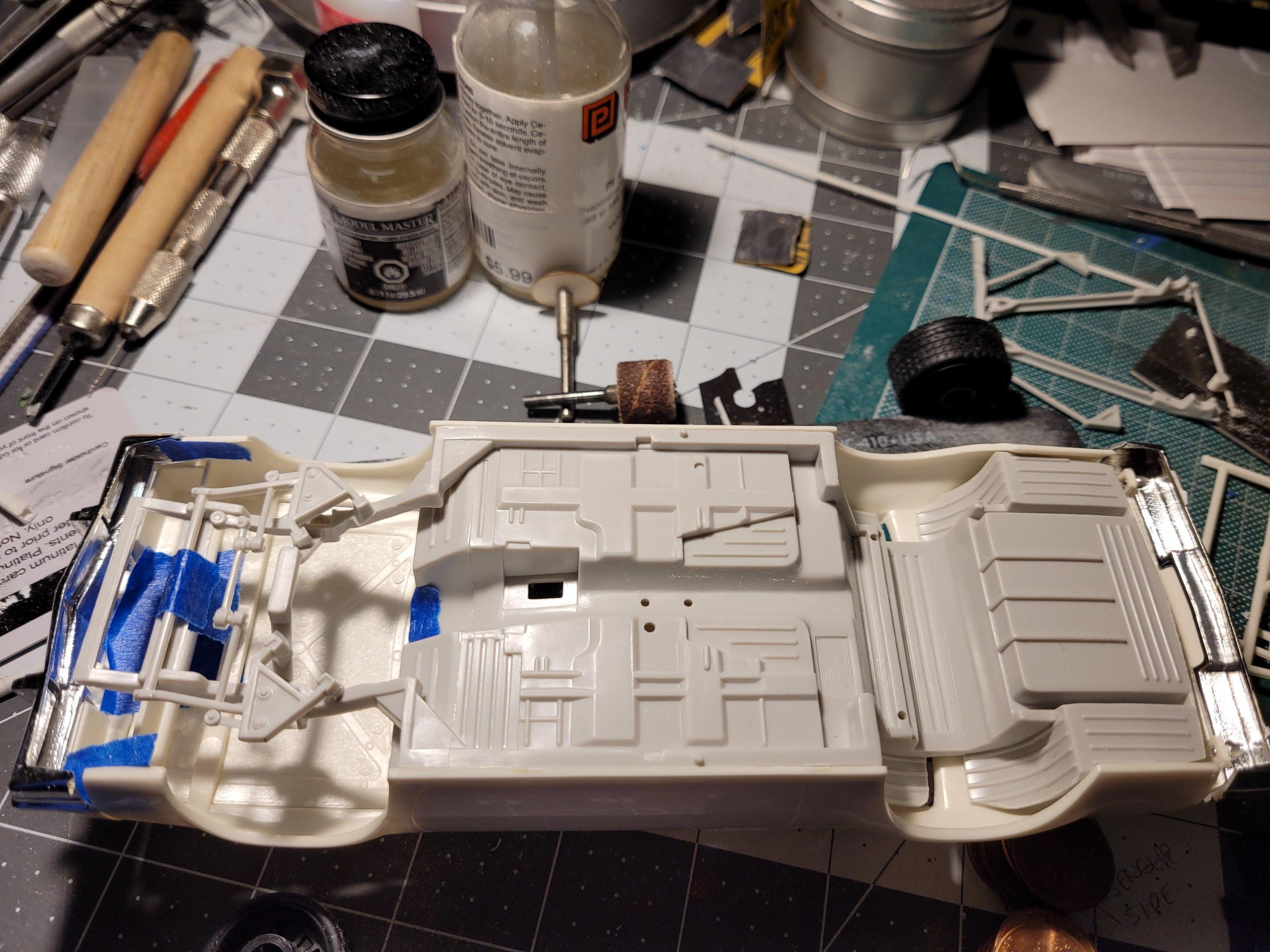

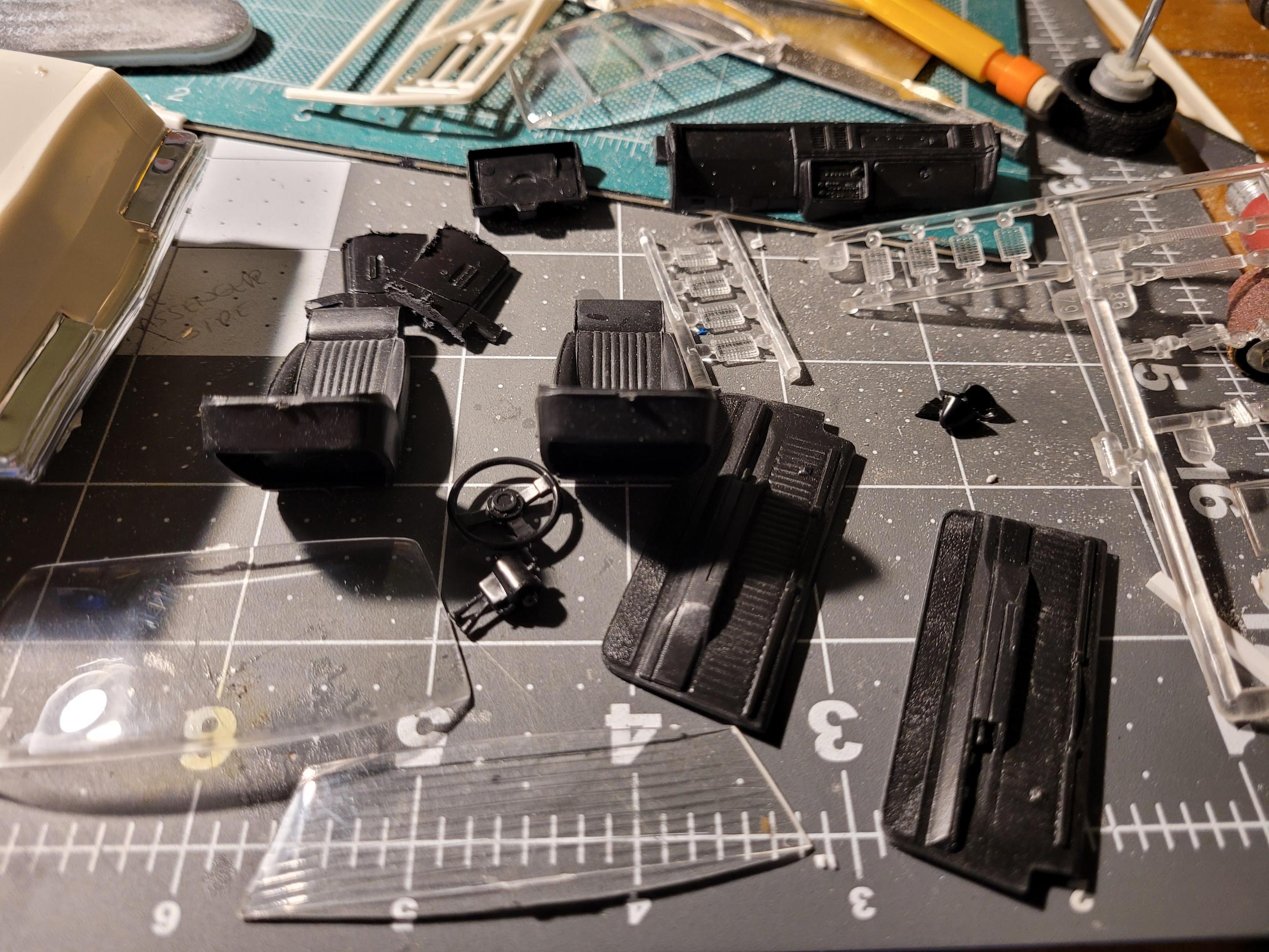

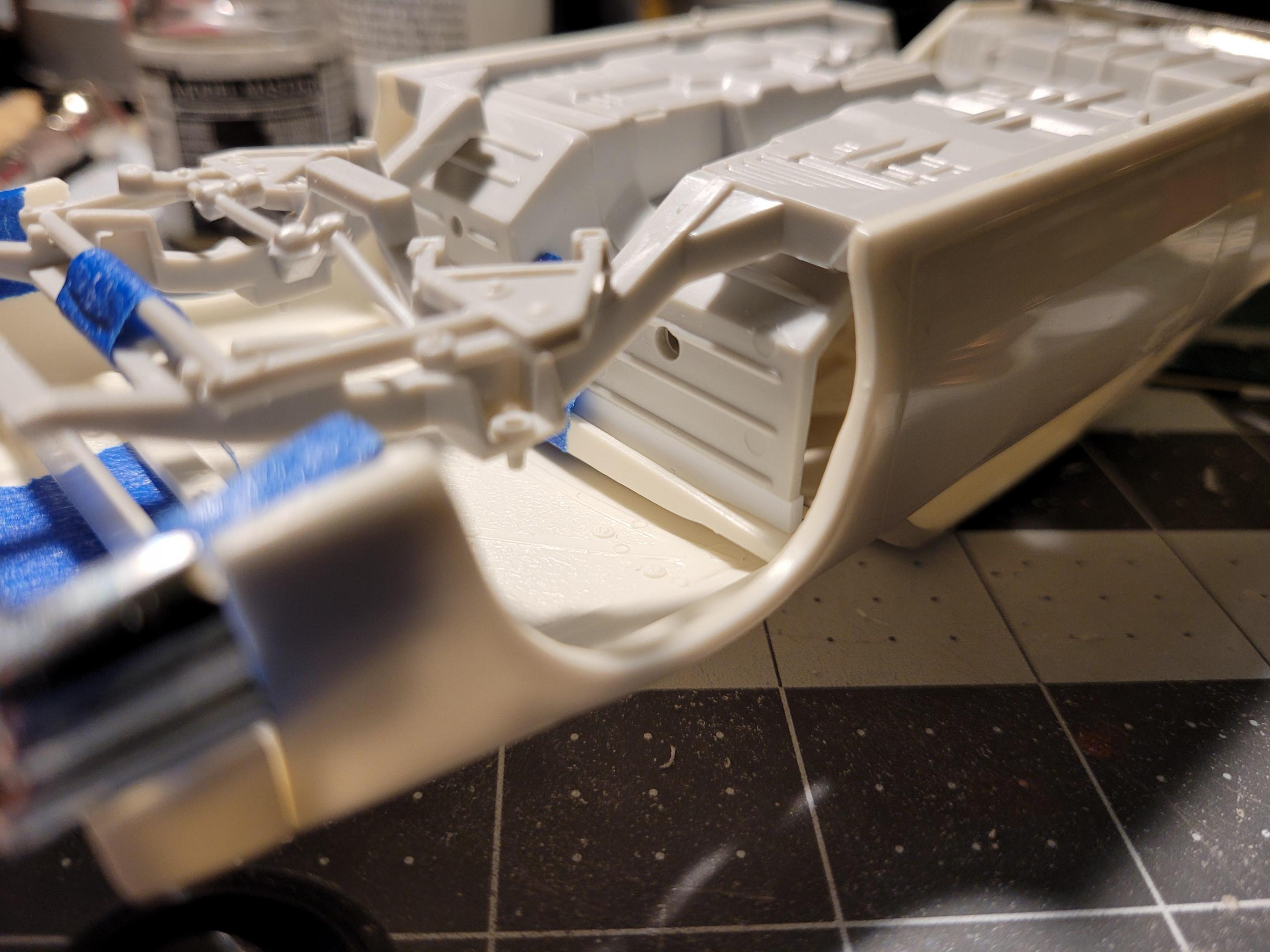

Oldmopars Posted January 2, 2021 Posted January 2, 2021 Well, I am almost done with the chrome. 1960 Impalas have a large amount of chrome. This will help with it being in disguise. Looks like a street rod, race car underneath. The wheels I ordered came in, they have 3 bar sinners, not sure if I will use them or not, we will see. I am on hold for a week or 2 till the engine I ordered comes in. However, I still have a ton of time, so I am not worried. I have a lot of work let to do to the chassis, but I need the engine before some of it can get done. I will fix the chrome on the front fender, I just need it to be dry before I screw it up worse.

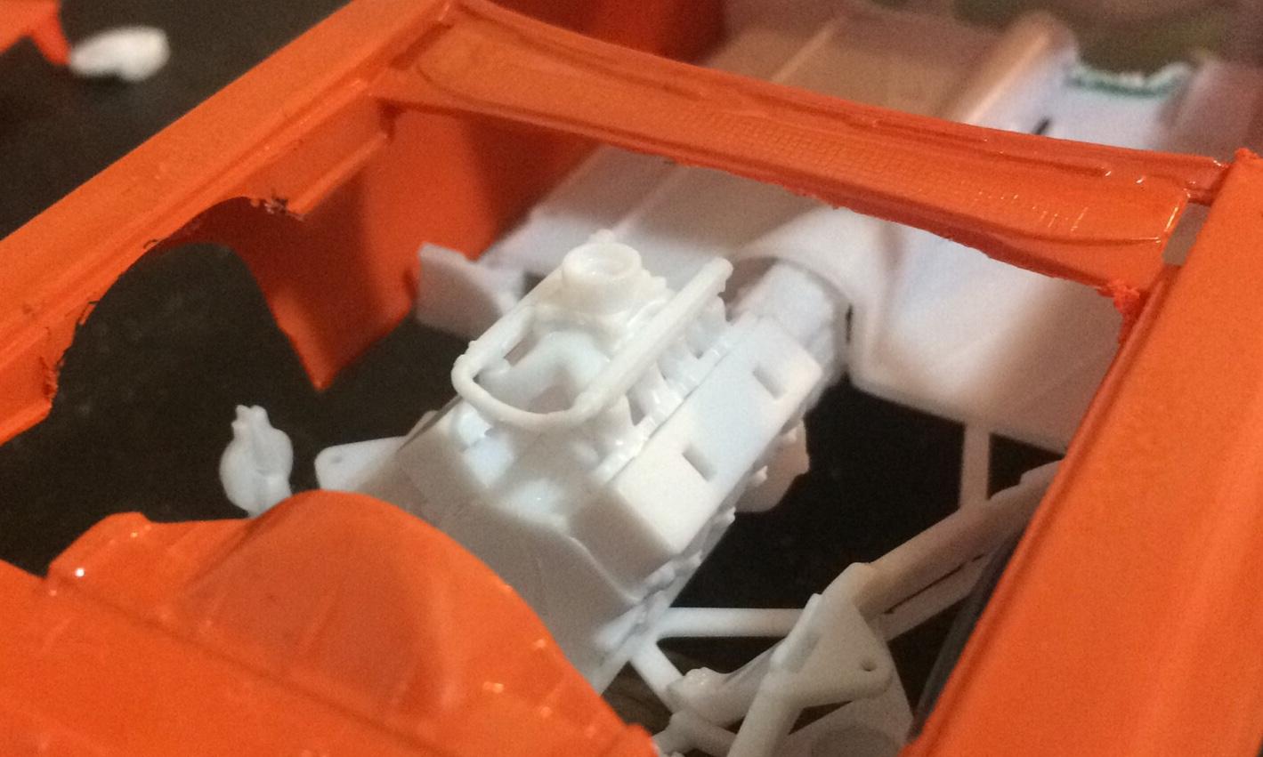

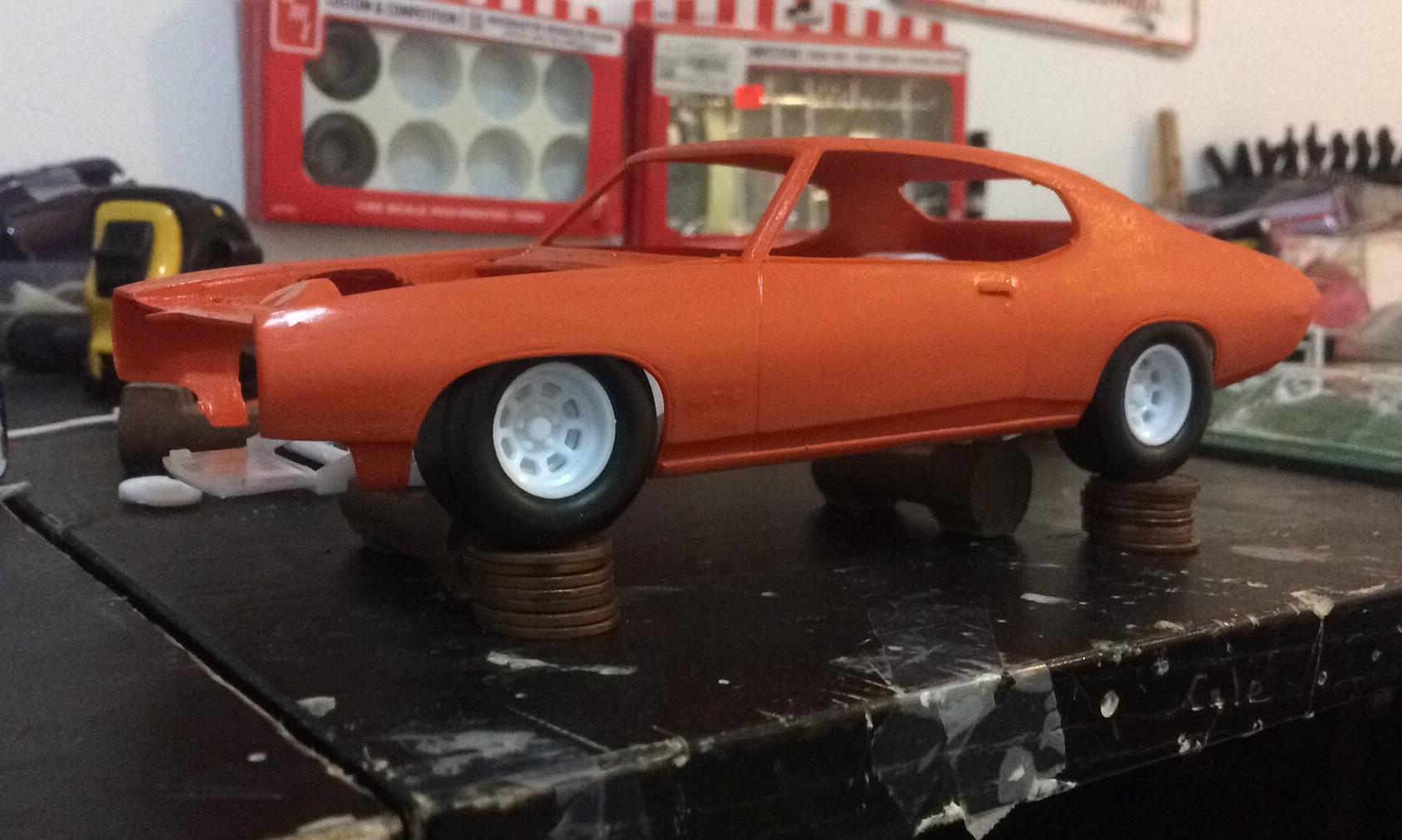

426 pack Posted January 3, 2021 Posted January 3, 2021 (edited) On 1/3/2021 at 3:47 AM, disconovaman said: Now you're talking! Two-Lane Blacktop with a Nascar hiding under GTO sheet metal ??? Just make sure the driver tells the truth about what he has under the hood! ??? Expand Yeah it’ll probably get some sort of forced induction hiding under the hood...... I got it mocked up after a little trimming. Edited January 3, 2021 by 426 pack

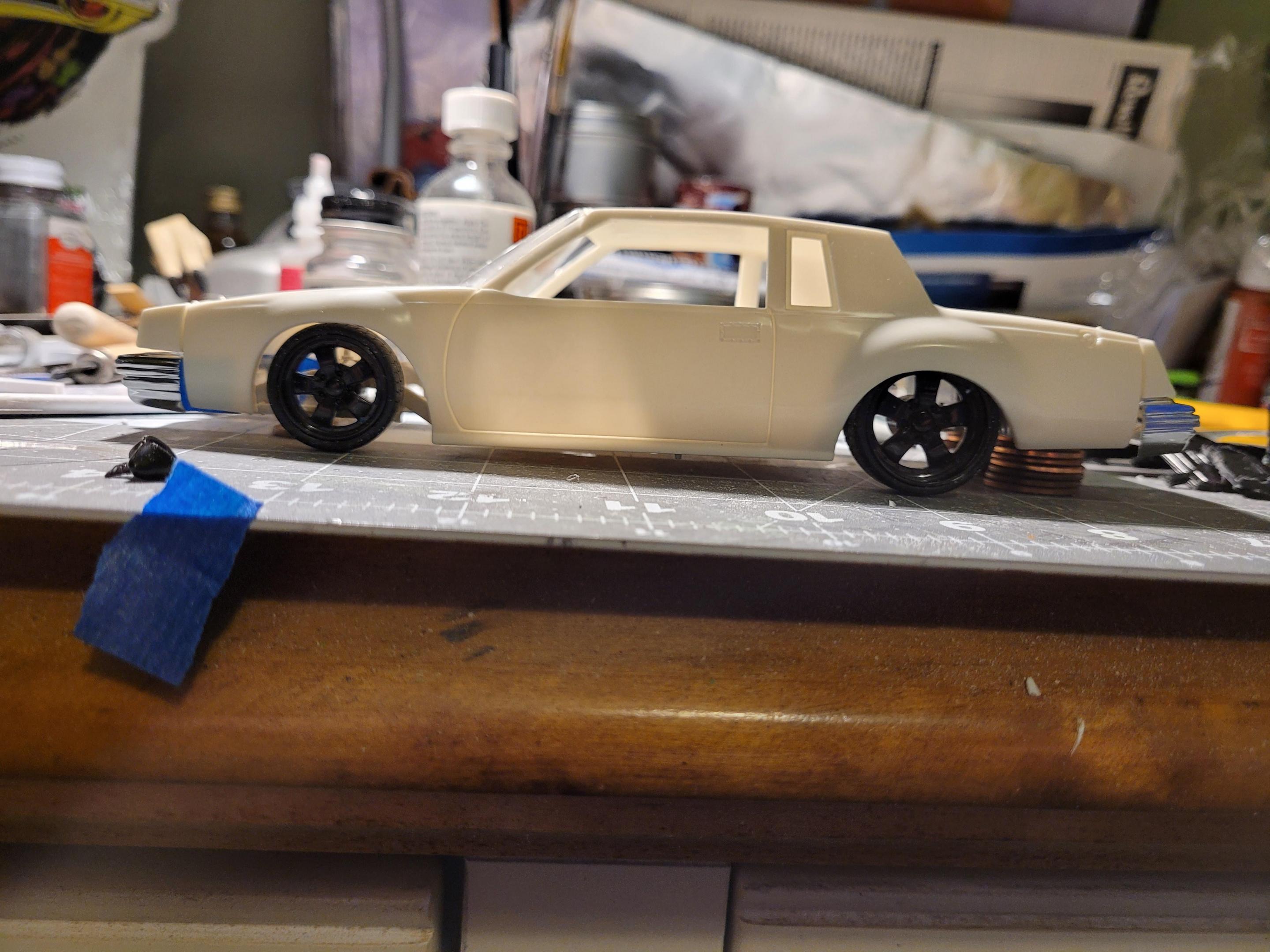

Pat Minarick Posted January 3, 2021 Posted January 3, 2021 Ok got the newer Nascar chassis fitted to the Grand Prix body and going to use cage from the old chassis. . Not sure what rims and tires im going to use yet. Stole a few things from a Grand National kit , glass door handles, mirrors,and going to use alot of the interior and seats.

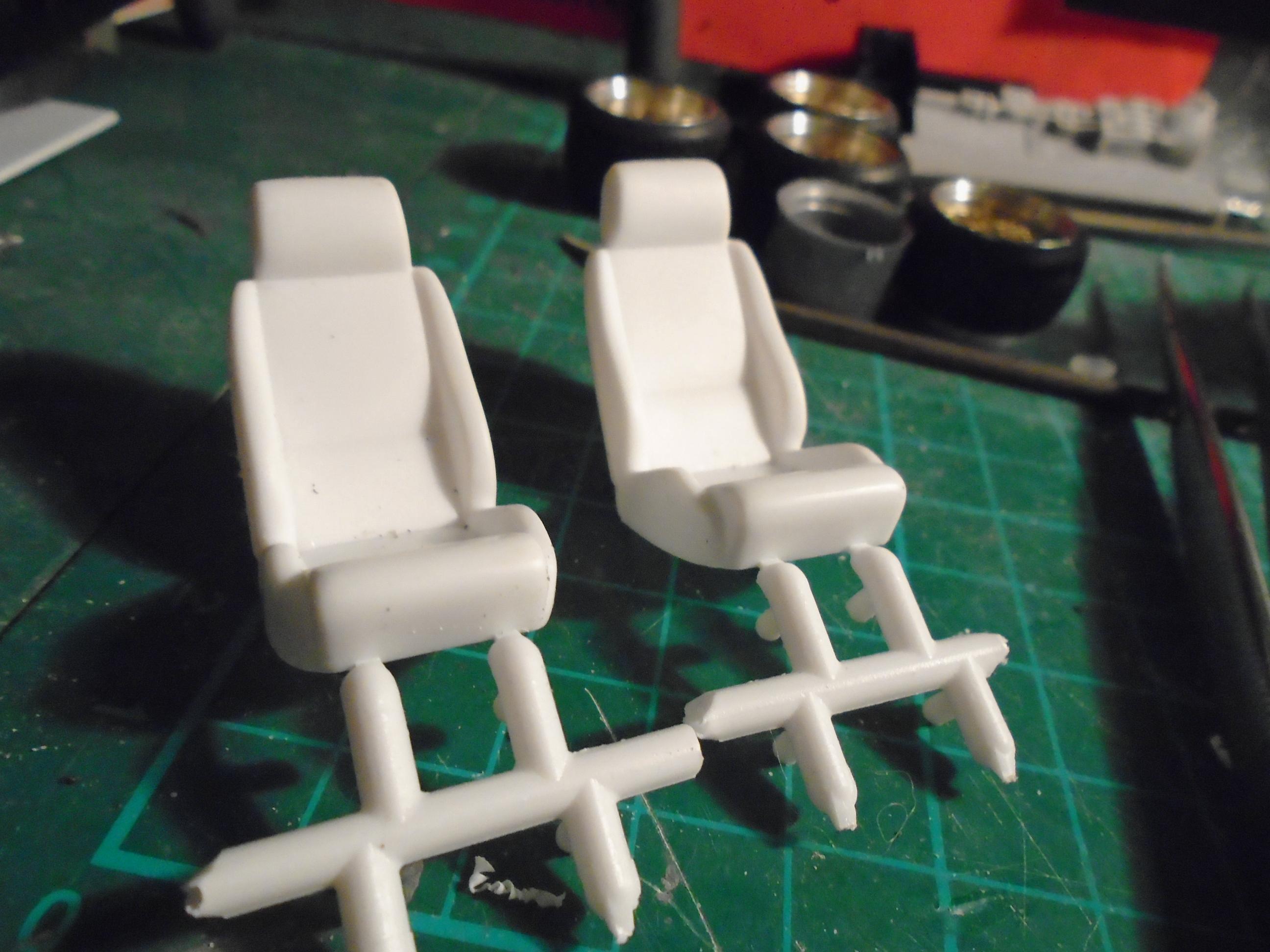

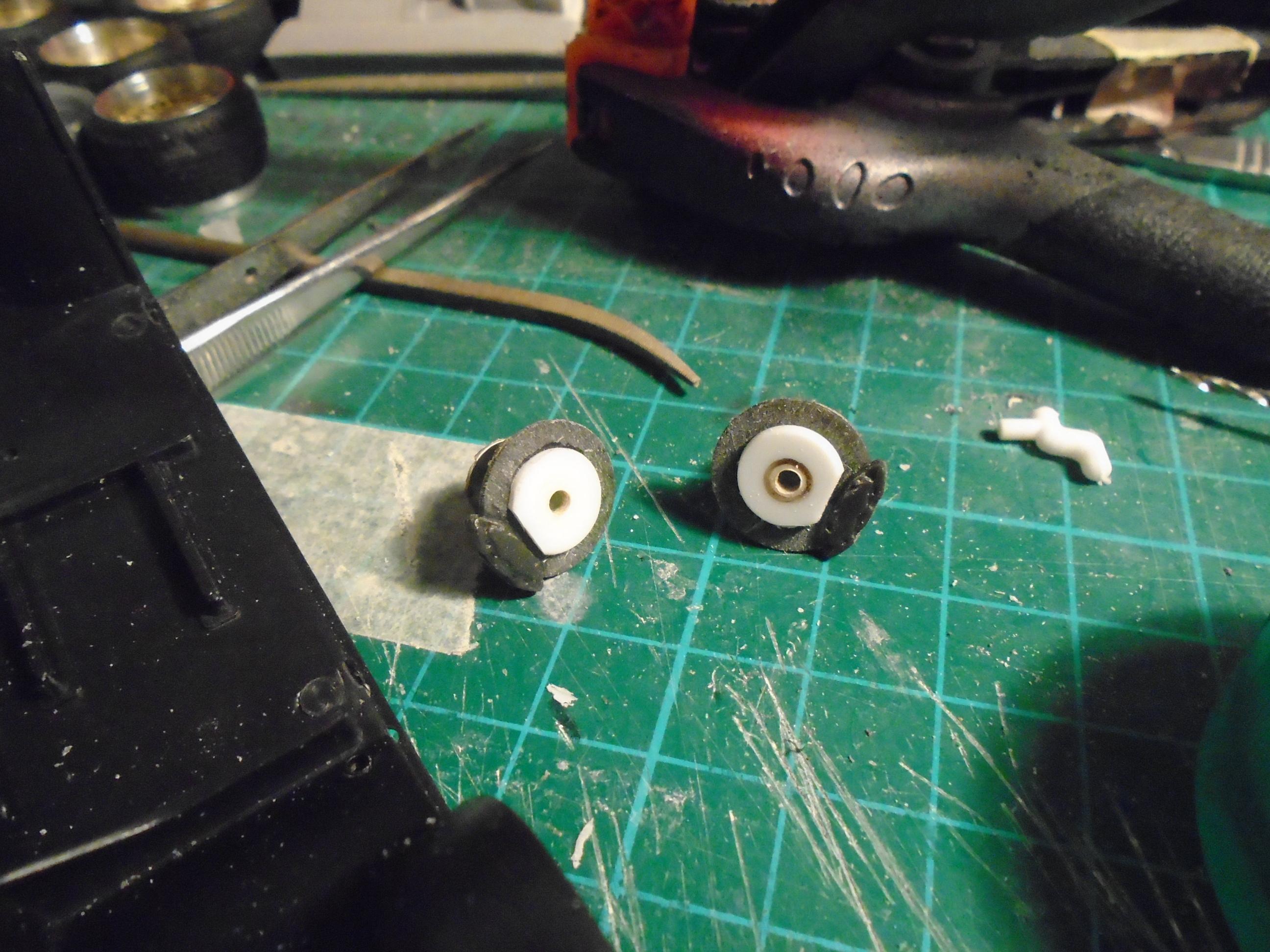

stitchdup Posted January 3, 2021 Posted January 3, 2021 Aw man, you guys are flying ahead. This afternoon I pulled out the escort and tried the stock interior only to find its little use with out removing a lot of the race stuff so instead I pulled a pair of more comfortable recaro style seats out of the spares box. and glued the backs on as its a long drive in a race seat. Next I pulledout the uscp cossie engine to see what needed to be changed which led to cutting the gearstick mount from the centre hump and a bit of filing underneath so it wasn't hanging down too much I then turned my attention to the engine bay and its fit to the body. Turned out the fit left a gap at the sides and front so I used some angle strips to lose the gaps so that now it snaps in place and most likely wont need glue to hold the chassis in place after this I tried the lower sppoiler in place only to find the chassis wouldn't let it sit where it should so I ground the front of the chassis at an angle so now the spoiler fits where it should It will need a little filler later but for now the chassis is fitting without interfering with any of the body. Next I turned my attention to the front crossmember. I'll be giving it a lower stance so to enable this I put a couple of small extensions on the strut mounts and I'll be drilling them out once the glue sets. Now because I'm using a bigger set of rims I needed to do something about the brakes. After searching through my leftovers I found a set of corvette brakes that fit inside the rims but the calipers were hitting the back of the wheels, and they lacked any sort of hub detail so to fix this I cut a couple of squares from some styrene and drilled a hole in the centre. I then used my dremell cut of wheels mount to hold them together while I got them to size on a sanding pad. They wont really be seen but without them the wheels would have sat at a funny angle so this fixed that

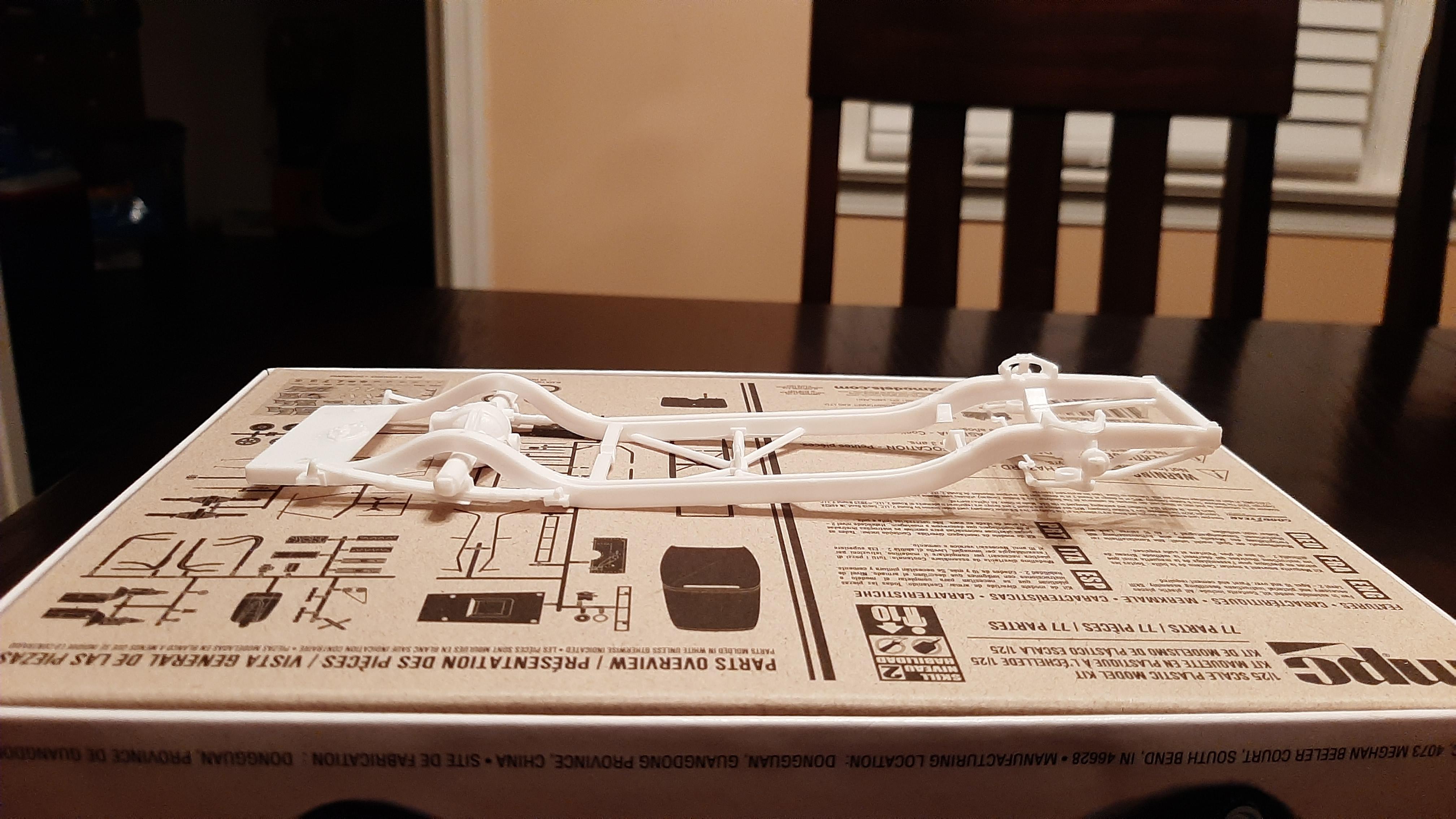

Danno Posted January 4, 2021 Posted January 4, 2021 Well, some of you guys are already way ahead of me (especially you, Scott!!), but that's okay . . . I have 332 days to go. But, I made great progress today (for me)! I grokked. In depth analysis indicates I apparently have a little chassis-stretching to do. Okay, that's enough for today. I'm tired already. PS: Don't be distressed by the color mismatch between cab and bed. The maroon truck was the intended vehicle (Sorry about that! -- Puns R Us.), but lo and behold when I popped open the box, the cab was AWOL. Weird. So, I robbed the cab from another kit. Onward! ??

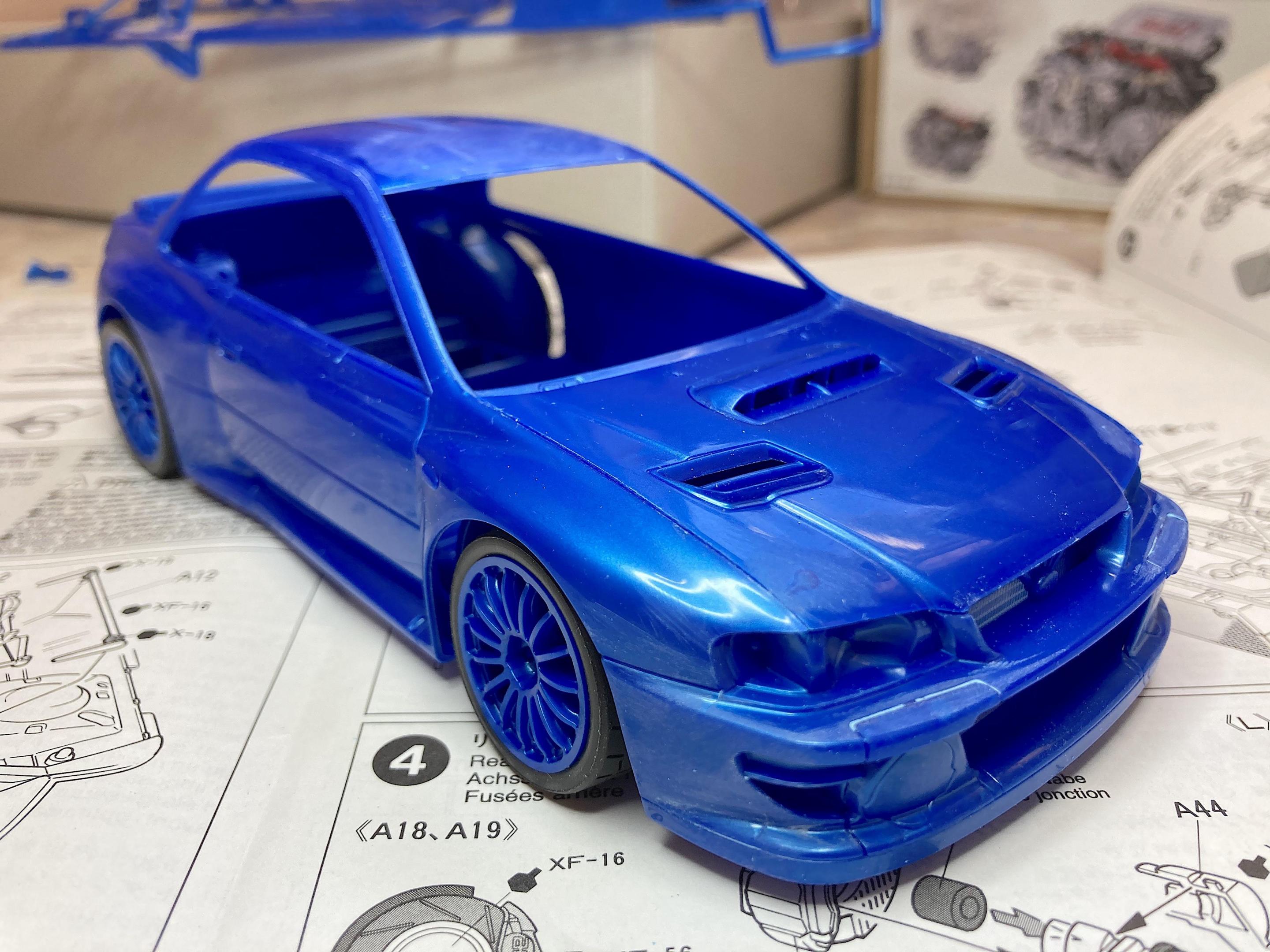

89AKurt Posted January 4, 2021 Posted January 4, 2021 #11 is started! Tamiya Subaru Impreza (not WRC but Cannonball Ruse) with Hobby Design engine
Jhedir6 Posted January 4, 2021 Posted January 4, 2021 On 1/4/2021 at 6:27 AM, 89AKurt said: #11 is started! Tamiya Subaru Impreza (not WRC but Cannonball Ruse) with Hobby Design engine Expand Love the Subaru WRC cars, looking forward to this one.
