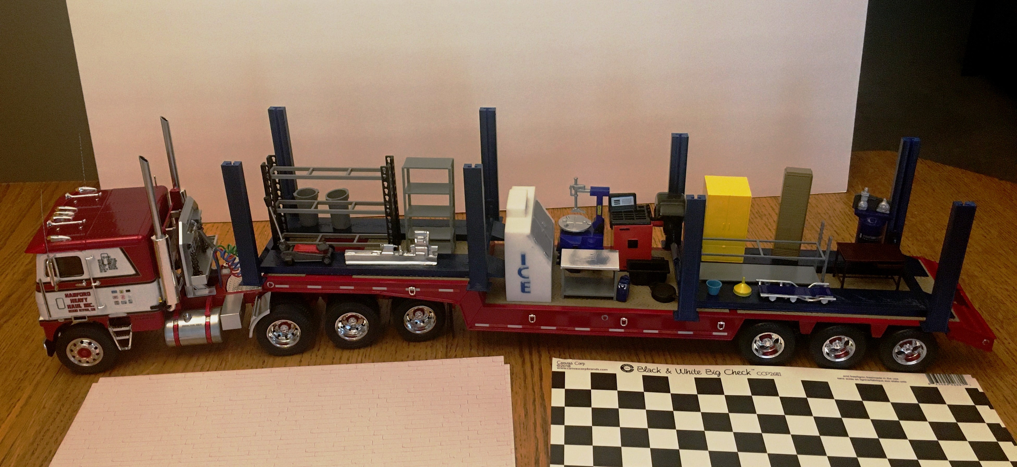

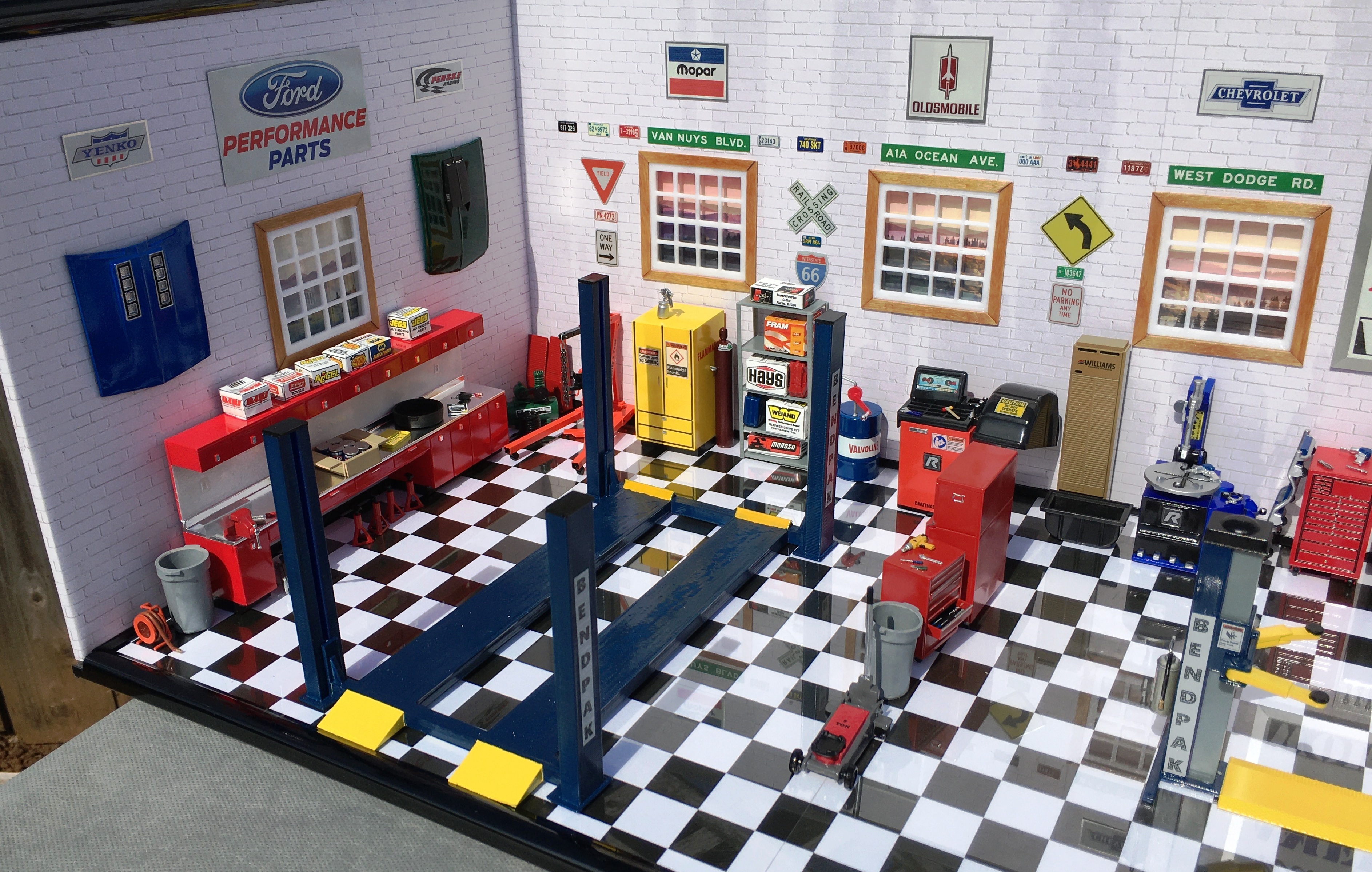

Bills72sj Posted May 8, 2021 Posted May 8, 2021 I have two 4 post lifts that were 3D printed in a medium blue material. If I leave them in the up position, I start to get some sag and splaying of the legs. Left down, they do ok. I think is basically the rigidness of the base material. I have painted them but I do not think it changes anything. For the price I paid, I am still happy for what they are.
