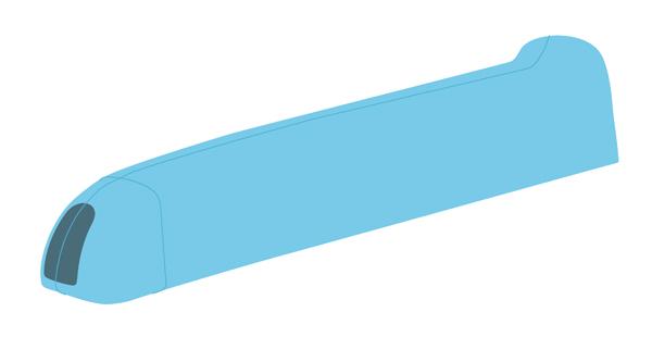

Big John Posted February 5, 2021 Posted February 5, 2021 Howdy, This is the lowdown on my 'What If' Bugatti LSR car. One day I was searching for a model of the Jean Bugatti conceived Land speed record car. Found a couple of sketches and a couple of models of his concept. His original concept had three typ.57 engines with the drive behind and a rather fat aerodynamic body. I wanted to add a Bugatti to my 1/24th collection of LSR cars but wasn't sold on Jean's design so... What if I could work with him on developing a unique and successful car? What would I bring to the table design wise? I wanted to use the big Autorail / Royale engines modified to a twin cams and supercharged configuration. I first toyed with the front engine concept. but wasn't convinced with having the driver sticking up into the air stream. so I decided to put the driver up front and streamlining the body.
Big John Posted February 5, 2021 Author Posted February 5, 2021 (edited) I am fortunate to have the special set of skills to bring to this project. Some automotive knowledge, AutoCAD drafting , and Photoshop. Using section views of the type 57 engine and it to a section drawing of the Royale bore and stroke of 4.94 x 5.125 in. I could do a rough engine layout and I basing the wheel size on the Royale tire size (6.75 x 35) and later found that they matched the tires on the Golden Arrow model from 'Profile 24' so I had some proven tires. I could now begin building the body loosely based on the Autrail and type 31 Tank both of which set speed records. To keep the profile low I went with the driver sitting low and in front of the business end of the car. I went about designing the CAD drawings in full size which I could scale down and print out plan views and elevations. I was also fortunate to have a large format printer to plot out full 1/24 scale plans. These I laid out with extra parts to use in the model parts layout. Edited February 5, 2021 by Big John added photo

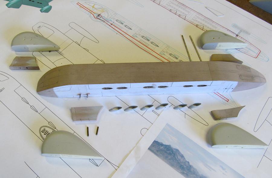

Big John Posted February 5, 2021 Author Posted February 5, 2021 (edited) This was to be a curbside model so I didn't go into all the internal structures and running gear but gave a reasonable space for transfer cases etc. The next step was to break out the renshape and paste the paper patterns on for rough cutting and preliminary sanding. Here are some shots of the rough shaped parts using coat hanger wire for connecting pins. Edited February 5, 2021 by Big John

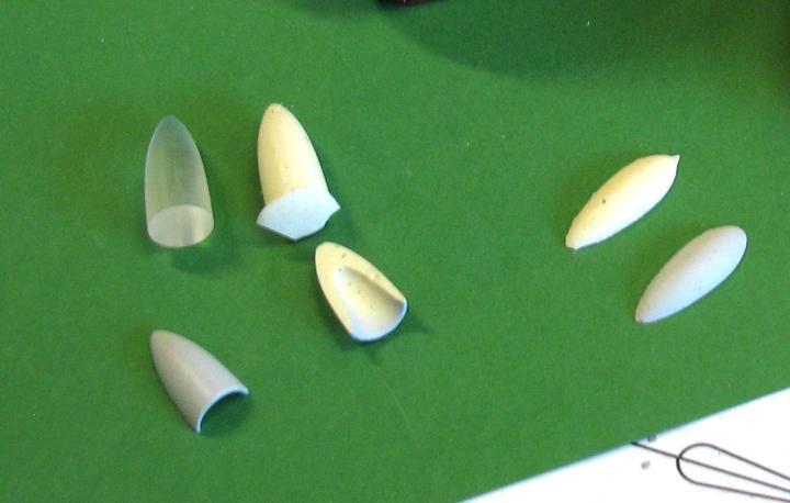

Big John Posted February 5, 2021 Author Posted February 5, 2021 My original layout had flat sides on the wheel spats which I decided didn't fit the Deco liner feel so I made them more curved and sleek looking. Any time I need multiple items I will make resin copies, and always save the original prototype. Here I've used plex rod to make a rough casting that I can work into the intake scoops then cast the finished scoop x6.

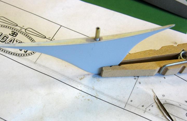

Big John Posted February 5, 2021 Author Posted February 5, 2021 (edited) On my rocket car I developed a technique for the fin/wing using a rod and wrapping it within thin styrene sheets cut to size, glued the edges together and then filled with resin. As noted by a fellow contributor, can't find the reference now but, Plans are only suggestions and guides, reality is what's left at the end. Edited February 6, 2021 by Big John Spelling
Big John Posted February 5, 2021 Author Posted February 5, 2021 Here are a couple of more views after further shaping and beginning to do layouts for panel lines. My driver is one of our late friend Chris Etzel's castings. I treasure this little guy. good for relating scale.

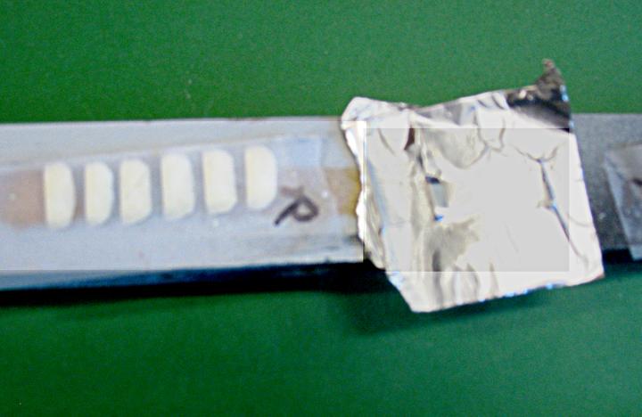

Big John Posted February 5, 2021 Author Posted February 5, 2021 (edited) I am trying to decide whether I want to add louvers to the back panels for radiator exhaust. Innies or outies? Innies I will have to carve into the block, outies I am considering casting. I am using a technique that I've adapted from another mag. tip page, using alum. foil to make a quick mold and then pour, in this case one drop does it, resin go make copies. Edited February 5, 2021 by Big John Photo Change

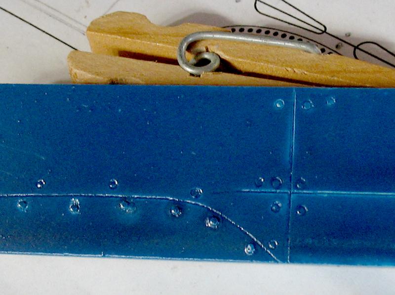

Big John Posted February 5, 2021 Author Posted February 5, 2021 At this point I've done a rough color shoot to test my panel line depth and the best size for panel fasteners and rivets.

Big John Posted February 6, 2021 Author Posted February 6, 2021 On 2/5/2021 at 10:27 PM, Dave Van said: LOVE your design!!!! Expand Thanks Dave, I like the whole Van Vooren Deco look and Jean Bugatti's typ. 57 roadster show car. The back came out really nice. I think the innie louvers well be best.

absmiami Posted February 6, 2021 Posted February 6, 2021 And by the way. The renshape is soft enough for you to hammer some Louver patterns on to the body - if you want some female louvers ...
