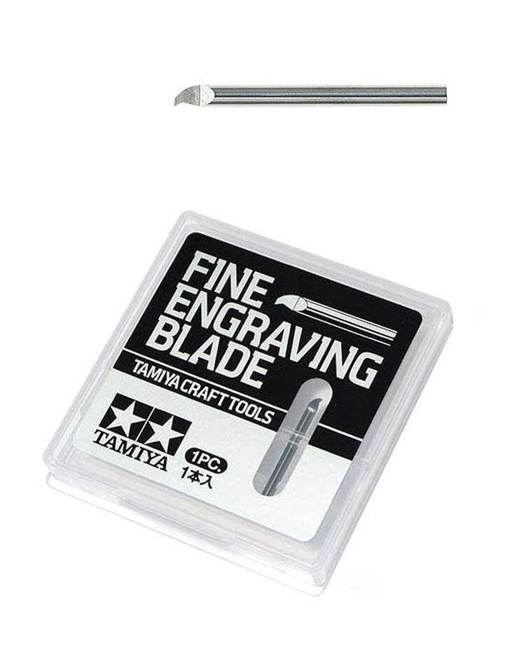

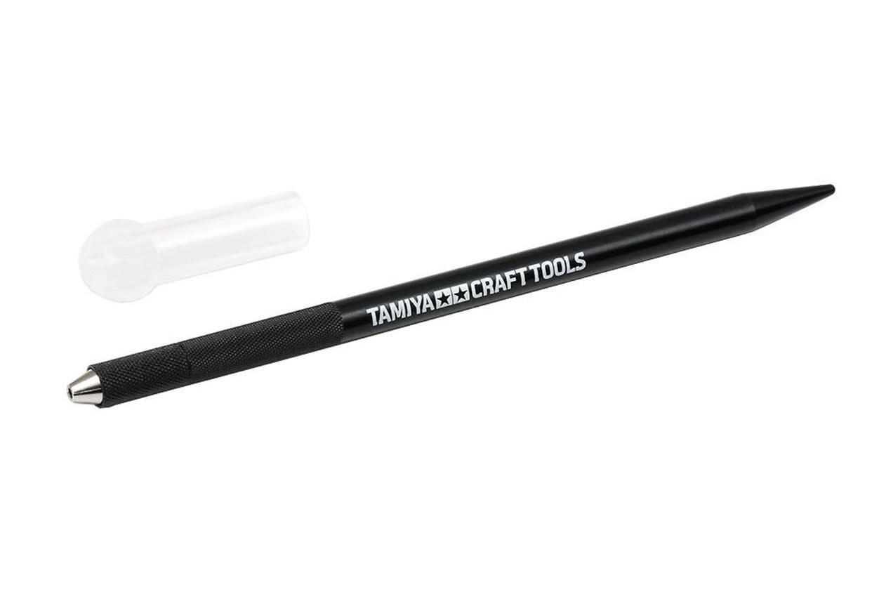

Erik Smith Posted February 7, 2021 Posted February 7, 2021 On 2/7/2021 at 8:39 AM, Pete75 said: Tamiya line scriber Expand I recently purchased the Tamiya Fine Engraving Tool. They make a few different widths and they attach to the handle like an exacto blade. The Tamiya engravers are expensive but are very well made and work very well. The different widths allow deeper grooves in door and trunk lines, or wider ones to give the gap more room. I purchased the handle from Burbank’s hobbies and the “blades” from Plaza Japan. You can always use the #11 blade trick or make you own, but the Tamiya tool is easier for me to control and, so far, takes a nice spiraling piece of plastic out with each light pass.

89AKurt Posted February 7, 2021 Posted February 7, 2021 On 2/7/2021 at 1:32 PM, Erik Smith said: I recently purchased the Tamiya Fine Engraving Tool. They make a few different widths and they attach to the handle like an exacto blade. The Tamiya engravers are expensive but are very well made and work very well. The different widths allow deeper grooves in door and trunk lines, or wider ones to give the gap more room. I purchased the handle from Burbank’s hobbies and the “blades” from Plaza Japan. You can always use the #11 blade trick or make you own, but the Tamiya tool is easier for me to control and, so far, takes a nice spiraling piece of plastic out with each light pass. Expand I was also going to suggest this. It's expensive, but you get what you pay for. I have the green tip.
