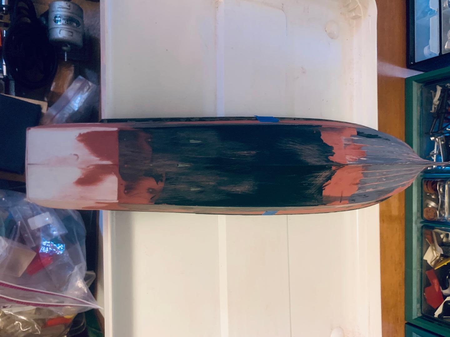

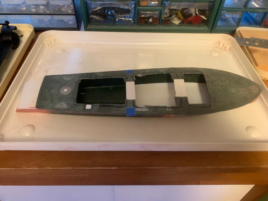

Paul Payne Posted February 14, 2021 Author Posted February 14, 2021 Well, let's look at the boat first. I have removed all the details on the deck, prior to sawing off and sanding down all the details except the actual planking which will be left as much as possible for a guide for the real wood. Many of the deck details were molded in relief, which meant a depression was created on the deck underside. Most of these have been filled with epoxy. I have also marked out the general cockpit locations and the windscreen location. The hull will also have some recesses on the inside filled with epoxy as well, primarily the prop shaft indentations and the inside of the bow, since I plan on some major rework in both areas. The runabout I am creating will have 2 propellers instead of 3, and 2 rudders as well. Once the cockpit and engine areas are cut out, I will probably add some filler plastic for strength. So, out comes the saw, with more progress pix soon.

Paul Payne Posted May 20, 2021 Author Posted May 20, 2021 More progress- the stern has been completed and the hull has been faired and scale 3" planks are being cut from the cedar cigar wrapper. Also, the floor for the skipper's and passenger's compartments has been laid in. The deck has been challenging- the plastic is somewhat brittle and some of the patches have come loose. The cockpit openings are very rough and will need a lot of refining. In addition, fairing the hull has altered its top outline a bit so the deck will need some edge sanding for a flush fit. By the way, the Power Wagon has been partially disassembled, with certain attachments still somewhat of a mystery.

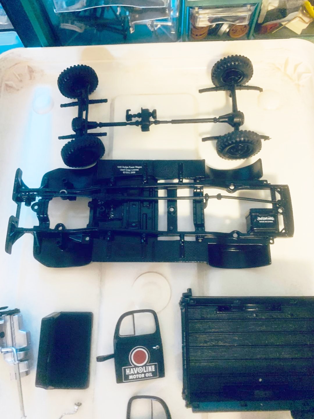

Paul Payne Posted June 5, 2021 Author Posted June 5, 2021 You are all probably wondering what the heck is going on when there is almost nothing about a truck? Well, the Dodge power wagon finally succumbed to disassembly- a daunting process with any plastic and die cast model. This model is extremely well detailed and I strongly recommend it to any pickup or Mopar fan. The first thing to be disassembled was the towing boom assembly from the bed. persistent gentle prying and suddenly it detached. So far only the front winch on the bumper broke off, looks like an easy fix- may remount it with a couple of scale carriage bolts through the bumper. Another step in the process is to investigate the front windshield and frame to see if they can be detached since I would love to have them open up like the real thing. Today I was able to detach the power train from the frame, then, with a lot of careful prying, the engine, transmission and exhaust popped off. The transmission was mounted to a big boss on the underside of the chassis, hence the resistance. From the beginning I have wanted to replace the 6 cylinder engine with a hemi, but retain the original transmission. I pirated the hemi from the AMT 53 Studebaker and have glued the block and transmission halves together as well as stripping chrome parts in the oven cleaner bath. Like most diecasts, the door hinges are really klunky and look like poop, but they did work well.... The hood hinge is actually very nice- a thin wire threaded through cast hinge sections. The doors themselves have what would be the actual door hinges molded in- nothing on the cab, just the doors. For years I have had a Trimaster hinge package I haven't had the courage to use- maybe I will try to create more realistic hinges with it. I plan on weathering the truck as well- found a picture on the internet I really like. I want to run vertical exhaust stacks through the running boards just behind the cab- not sure if I will have to move the spare tire or not to clear them. Oh, I also sanded the tire treads but need to knock down the shine on the rest of the tires as well.

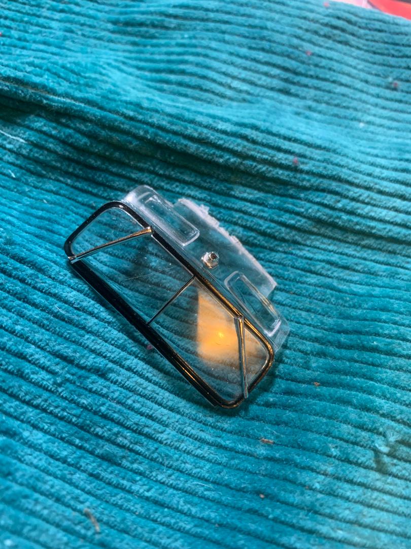

Paul Payne Posted June 5, 2021 Author Posted June 5, 2021 Success! I was able to separate the windshield assembly from the cab. Also a picture of a gathering of hemi parts- we shall see which ones make it to the final assembly!
