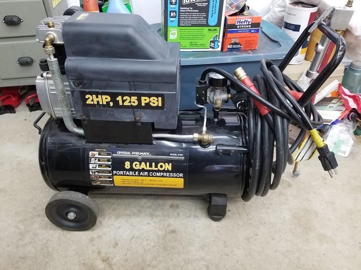

Zippi Posted March 14, 2021 Author Posted March 14, 2021 Got my Paasche H airbrush last night. Hooked it up this morning to give it a try. I had some Ceramcoat paint so I thinned it with thinner. Took a few try's to get it spraying correctly but I think I finally have it close. I have my air pressure set to 25 PSI. I never change the PSI, I just worked on thinning the paint more. It sprayed the best when it was almost like water. I'll probably practice a lot before I attempt to spray my first kit.
