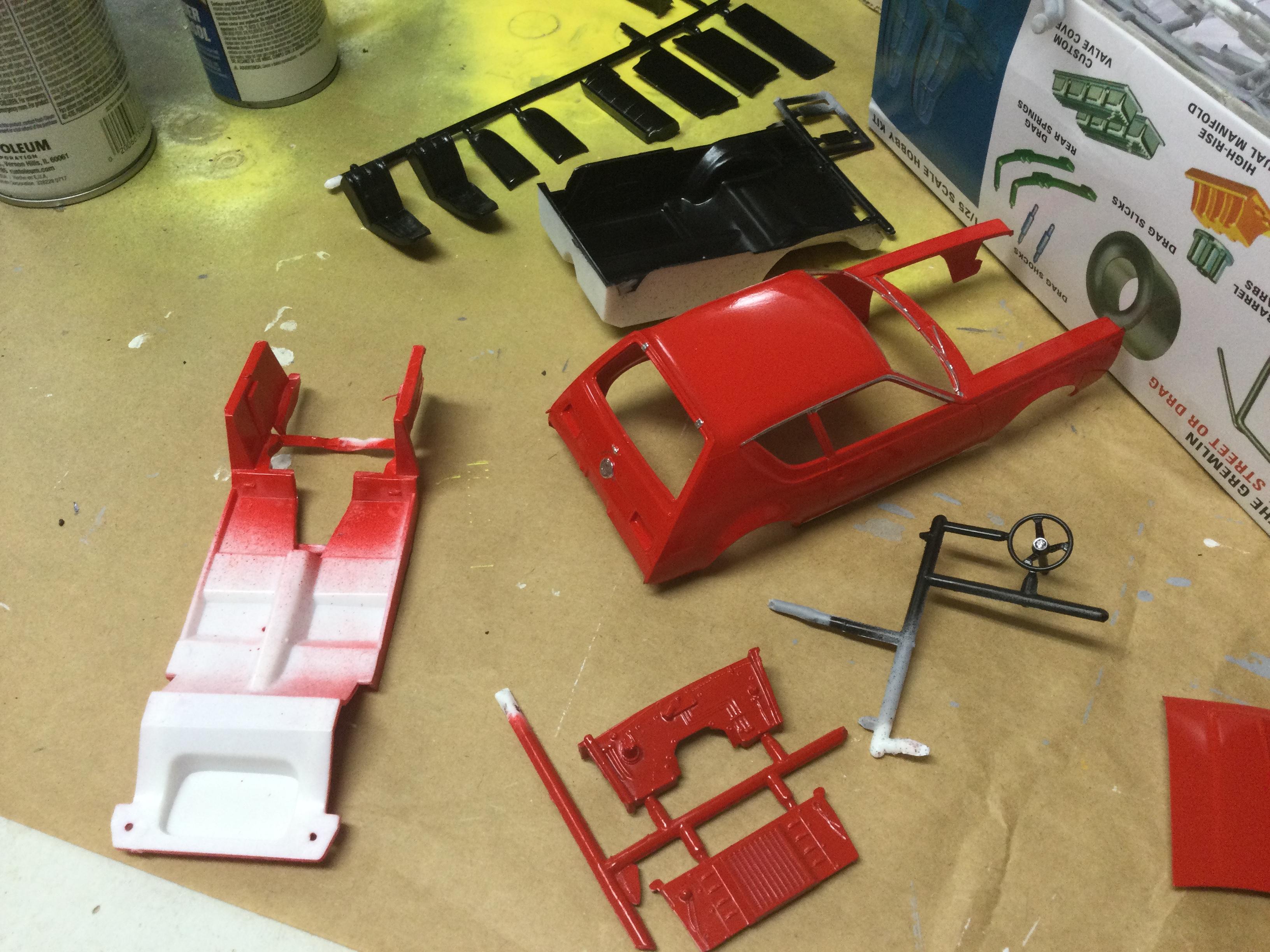

Exactly David. In upstate NY. Winters can be brutal. So I paint the bodies of numerous kits with the spray booth. But you really don't want to do that every day. I then prime the other parts. And then paint those parts. And I build a little bit on each kit so the glue will dry. Some times it works out. Sometimes not. ^_^

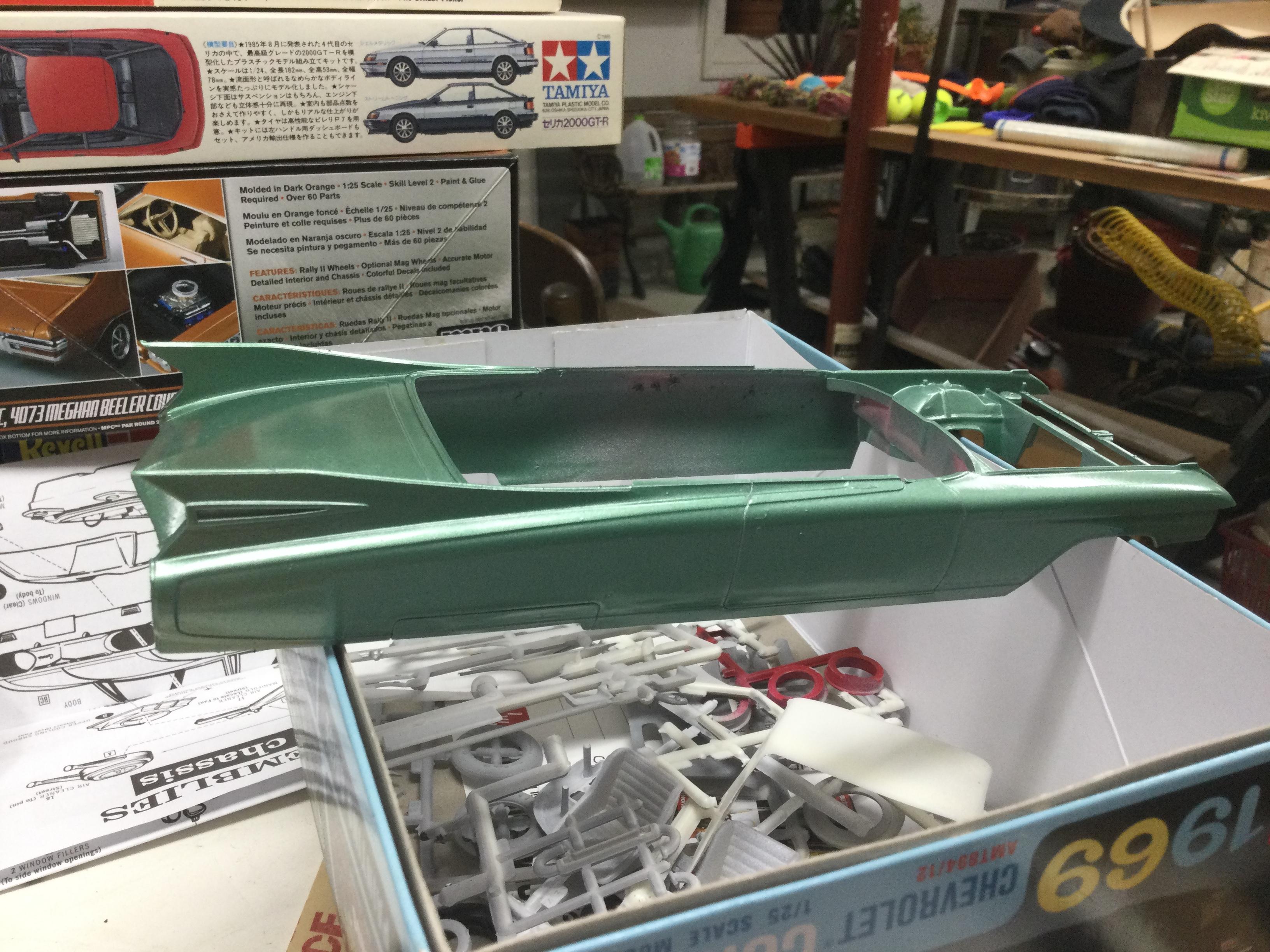

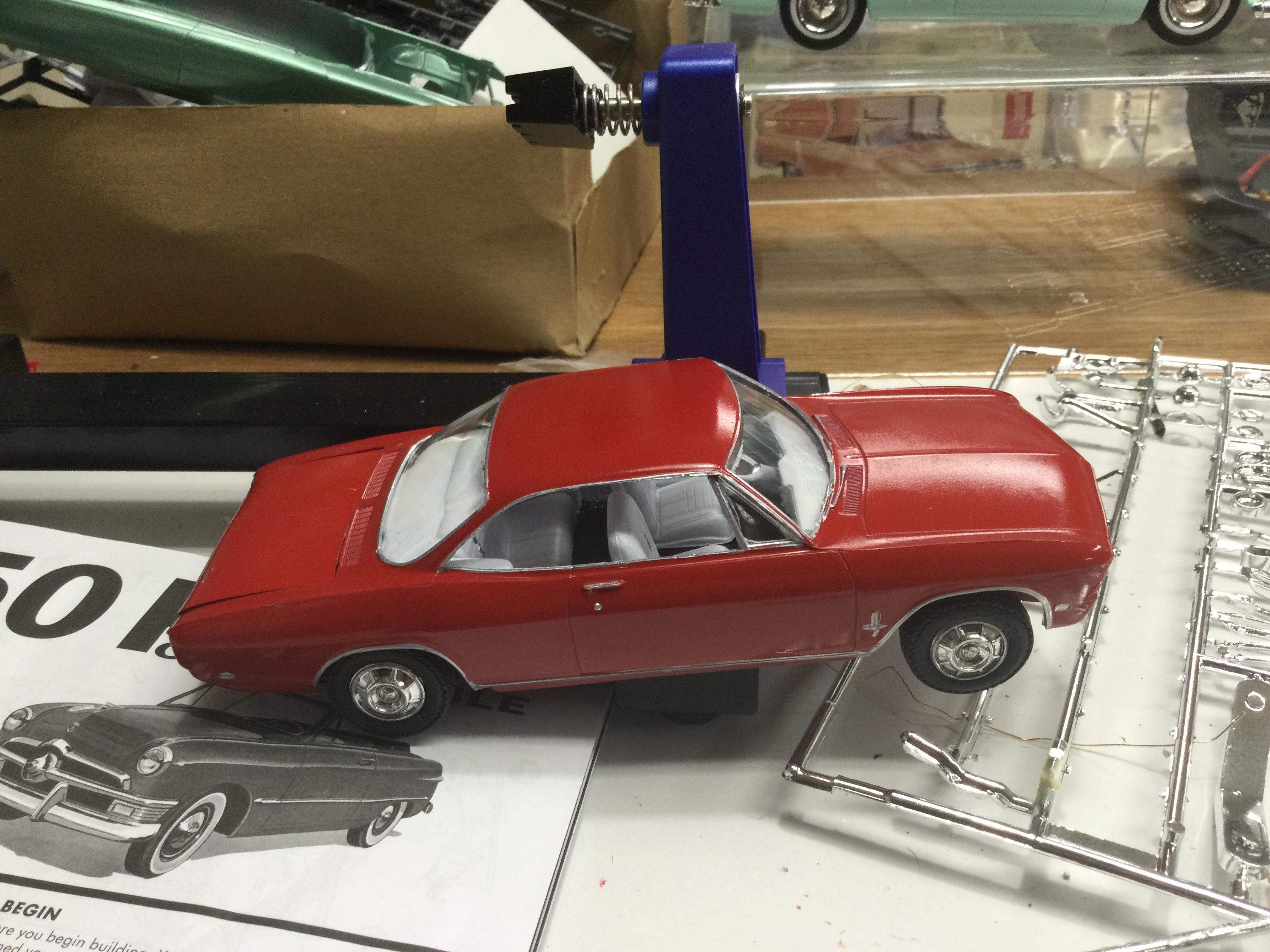

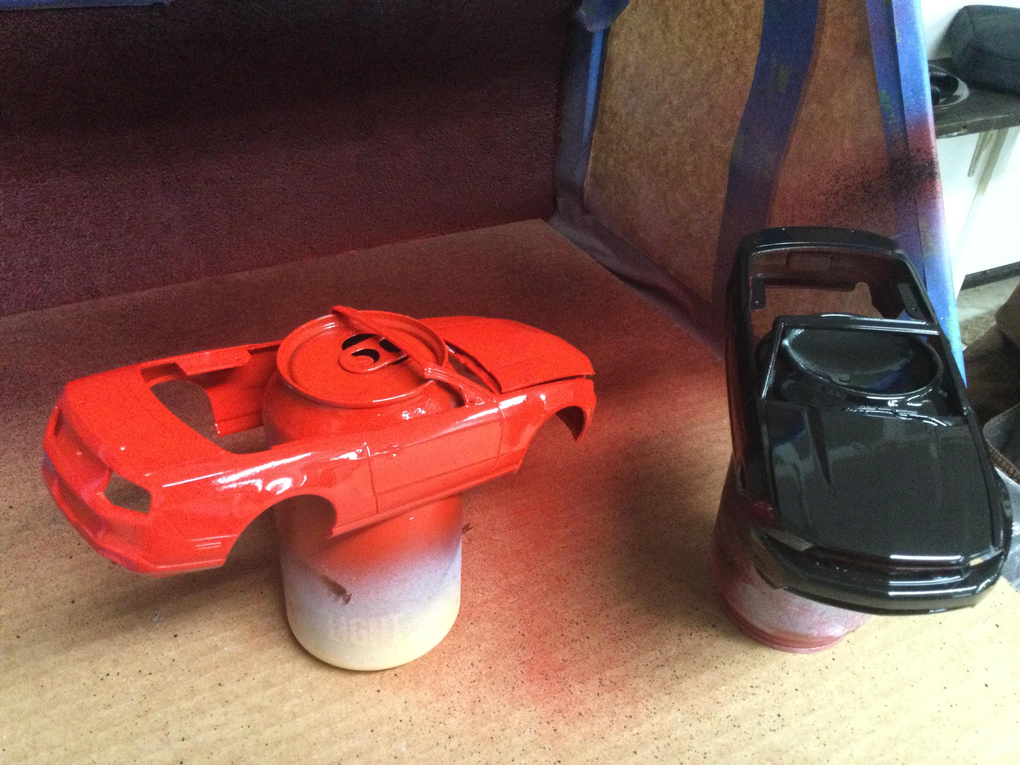

The Corvair is a horrible kit if you ask me. Tires are terrible. The engine posts didn't line up. I have 2 more in my stash and they are going on Ebay Snake. LOL. The caddy is in the purple pond. I used the cheaper Duplicolor primer for the first time and it pays to buy the more expensive one. I don't know if I can save the mustangs. I think I can save one. But after spraying them with the cheaper primer. The enamel ate right through the primer and screwed up the plastic. The red one I might be able to save but the black. I don't know. I've never used clear coat before. Do you wait days before you spray that on? Thanks.

You can save the plastic on that Mustang with some BIN.
I've repaired the surface on lacquer burnt kits by spraying a coat of BIN, wet sand smooth with about 1000 or 2000 grit, do it again and possibly once again if needed.

David, I always clear coat in the same session as I am painting. I wait 10-15 minutes after each color coat and each clear coat. Normally, I do two color coat and two clear coats of lacquer. I don't know what clear you are using but if you use Testors Wet Coat (a lacquer) make sure you use it sparingly - one pass per surface during each session as it will run in a heartbeat!  I normally use Krylon Clear Lacquer also referred to as 'Special Purpose" lacquer as it is less likely to run and dried very hard usually overnight. Also make sure the clear is compatible with the paint. I usually test that on the underside of a hood. Easier to fix.

Painting bodies. In good weather is what I d. Make hay while the sun is shining. All are looking good David. What color is your Cadillac? I like it..

I happen to like your Corvair probably because I owned and raced one back in the day. I've also built that kit and don't remember any problems ans wish that I still had it. I do have a Corvair Prestige kit in my stash though, but who knows when and if I'll ever get to it?

Thanks Carl. it’s a GM green from 1966. I don’t remember the name. Thank you Steve. I’ll have to look into that. Nick. I’m told the prestige kit is much better.
