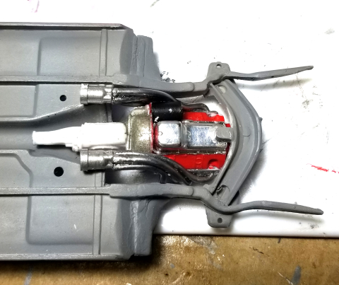

TransAmMike Posted April 29, 2021 Author Posted April 29, 2021 Since the AMT '55 kit has moulded in exhaust system and I'm using the '66 Nova Pro Stock chassis, I needed mufflers and pipes. So, I made two mufflers and will be using the 2mm aluminum "wire" for the exhaust and tail pipes. Another first in my modelling history. Below are what I'm calling a mockup so far. I haven't decided to work on bending the "wire" to bring the tailpipes out the rear or go simple and exit the pipes to each side in front of the rear tires.
Zippi Posted April 29, 2021 Posted April 29, 2021 (edited) Looking nice Mike. I'd run the pipes all the way out the back if it were me. What did you make the mufflers out of? Edited April 29, 2021 by Zippi
TransAmMike Posted April 29, 2021 Author Posted April 29, 2021 15 hours ago, Zippi said: Looking nice Mike. I'd run the pipes all the way out the back if it were me. What did you make the mufflers out of? I agree it would look better out the back, will be a bit of a challenge to get all the bends right. The mufflers are made using .100 evergreen rod and very thin sheet material. I cut 3 same length pieces of rod (what ever length you want the muffler to be) and glue them flat side by side. Then cut the sheet the same length and wide enough so it wraps around the rod with a bit of overlap. I cut small pieces of thre thin sheet for the ends and trim and sand them to the shape of the oval ends of the muffler.

MarkJ Posted April 29, 2021 Posted April 29, 2021 20 minutes ago, TransAmMike said: I agree it would look better out the back, will be a bit of a challenge to get all the bends right. The mufflers are made using .100 evergreen rod and very thin sheet material. I cut 3 same length pieces of rod (what ever length you want the muffler to be) and glue them flat side by side. Then cut the sheet the same length and wide enough so it wraps around the rod with a bit of overlap. I cut small pieces of thre thin sheet for the ends and trim and sand them to the shape of the oval ends of the muffler. Great idea for the mufflers. I will have to remember that if I ever build a car with mufflers that aren't correct in the kit.
TransAmMike Posted April 29, 2021 Author Posted April 29, 2021 2 hours ago, Dann Tier said: Its gonna be Killer, bud!!!! Thanks Dann. Not sure about "killer" but I'm tryin'? 2 hours ago, MarkJ said: Great idea for the mufflers. I will have to remember that if I ever build a car with mufflers that aren't correct in the kit. Yeah, I surprised myself on that one?
