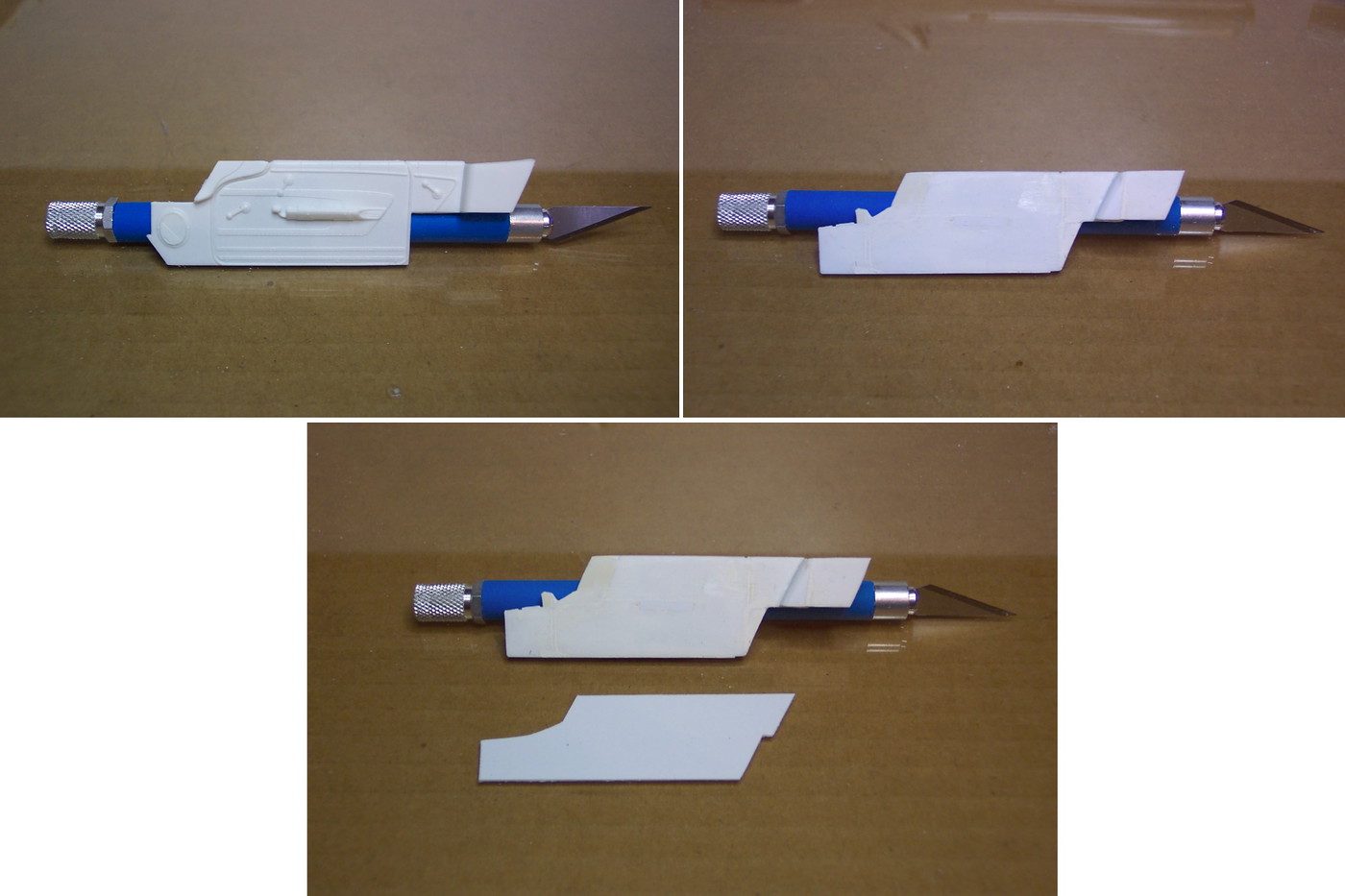

TooOld Posted May 29, 2021 Author Posted May 29, 2021 Started working on the interior by modifying the rear arm rests . The Dodge arm rests are angled reward so a little cutting and some filler gave me the proper shape . The Impala interior was originally too long so I also lengthened the slots in the floor so the front seat could be moved reward about 3/16 inch . Some more filler and now the rear seat is smooth and ready to become a Dodge ! For the side panels I began by removing all of the molded in detail , then the pocket for the top mechanism was angled to match the rear arm rests . Instead of trying to scribe the Dodge door panels into it I decided to make an upholstery panel out of .020" sheet . The plan is to draw the Dodge upholstery onto this and cut it apart into separate pieces , then glue those pieces onto the original side panel . Sounds good in my head . . . we'll see . To modify the front seat (#1) I first filled the gap in the seat backs with plastic (#2) . Next filler was used and all of the molded in detail was sanded off so the seat was smooth , then the left and right ends were reshaped (#3) . The last step was to cut the seat back into a 60/40 split and add to the top of the drivers seat back (#4) . Some more filler and sanding gives me the basic shape of the front seat . Now I have the beginning of the Dodge interior ready for some detailing . There's still a lot of finish work to do then I can start adding some piping and other details .
