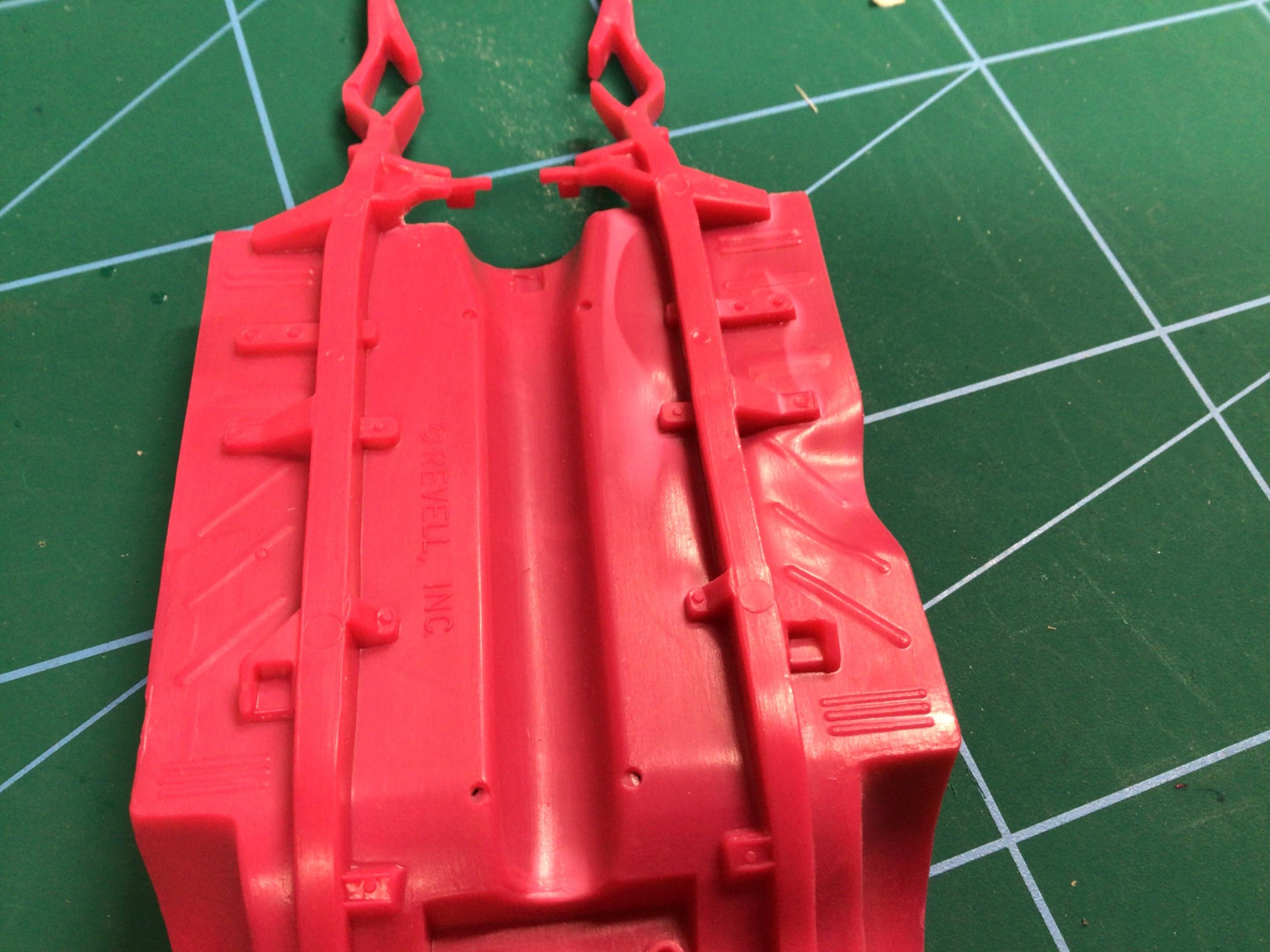

NOBLNG Posted May 20, 2021 Share Posted May 20, 2021 (edited) Anybody have any things you have done that did not turn out as planned or needed correction...kind of an anti-tip? I made a copy of the Revell Jeep Honcho frame out of styrene sheet. To make matters worse, I laminated .060” and .040” to get the .100” that I wanted. It worked OK, but the seam of the lamination is a pain to fill. Next time I will invest in the proper thickness of sheet or use rectangular stock. Well, live and learn.😳 Edited May 20, 2021 by NOBLNG Quote Link to comment Share on other sites More sharing options...
Vince Nemanic Posted May 20, 2021 Share Posted May 20, 2021 Try stretching some sprue and installing it with liquid glue. It will melt into the styrene and it sands well. You may still need a tiny amount of putty. 1 Quote Link to comment Share on other sites More sharing options...

misterNNL Posted May 20, 2021 Share Posted May 20, 2021 When laminating sheets I typically bevel the mating edges so there is room for filler at seams. Quote Link to comment Share on other sites More sharing options...

NOBLNG Posted May 20, 2021 Author Share Posted May 20, 2021 3 hours ago, Vince Nemanic said: Try stretching some sprue and installing it with liquid glue. It will melt into the styrene and it sands well. You may still need a tiny amount of putty. Good idea, I should have done that at the beginning. 5 minutes ago, misterNNL said: When laminating sheets I typically bevel the mating edges so there is room for filler at seams. Good idea also. Quote Link to comment Share on other sites More sharing options...

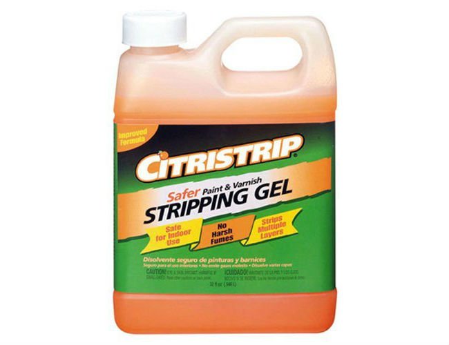

Beans Posted May 24, 2021 Share Posted May 24, 2021 Never again will I forget about the body in the plastic bag with a bunch of the below stripper for about 36 hours. Quote Link to comment Share on other sites More sharing options...

jaftygas Posted May 22, 2023 Share Posted May 22, 2023 On 5/20/2021 at 9:14 AM, NOBLNG said: Anybody have any things you have done that did not turn out as planned or needed correction...kind of an anti-tip? I made a copy of the Revell Jeep Honcho frame out of styrene sheet. To make matters worse, I laminated .060” and .040” to get the .100” that I wanted. It worked OK, but the seam of the lamination is a pain to fill. Next time I will invest in the proper thickness of sheet or use rectangular stock. Well, live and learn.😳 This is a pretty sweet looking frame. We do what we can with what we got! In light of this, I’d say you nailed it. BTW, I think the anti tips and tricks is a start of a great subject. Quote Link to comment Share on other sites More sharing options...
