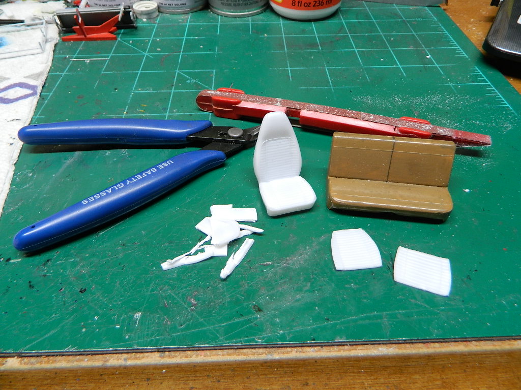

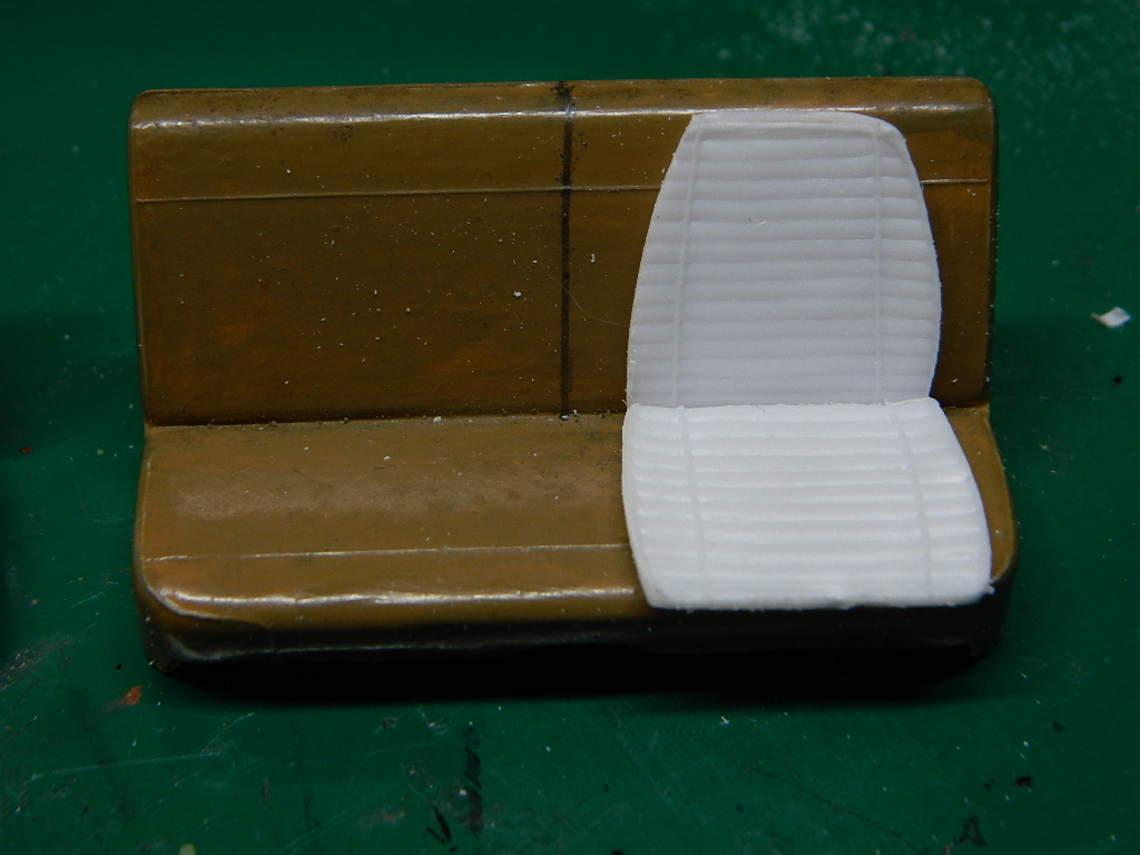

I have never done this before.  I'm changing the seat pattern on a Jo-Han bench seat from a long departed '68 Plymouth Fury Patrol Car.  The Fury seat has no pattern to it at all and cutting up the bucket seats to get the GTX pattern only took a few minutes.  So now I have to get the seat patterns down to the size of the Fury seat.  I saved the head rests and will cut them down for the Fury seat.  I drew a line on the center of the seat back so I can slice it into two seat backs for a 2-door.

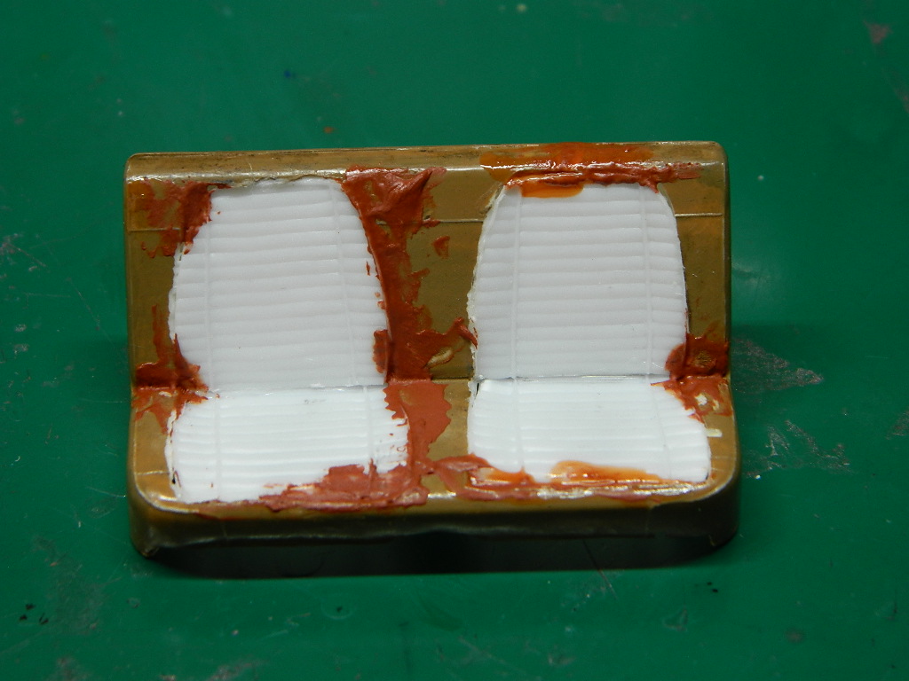

Using my Dremel, I hollowed out the seating surfaces to the new inserts.  I added the new seating surfaces and filled the edges with Bondo Glazing & Spot Putty.  I'll sand this when the putty has set and dried.

Okay Stu.  Please understand that this is a Day 2 car and the pleated bucket seats are not a concern for me.  If I was to change out the seats for factory correct  pattern, I would have to change the back seat as well, and I am not about to do that.  Adding the seat pattern to a bare bench seat is something I have never done before.  This is a new challenge for me and one that I hope to be worthwhile!

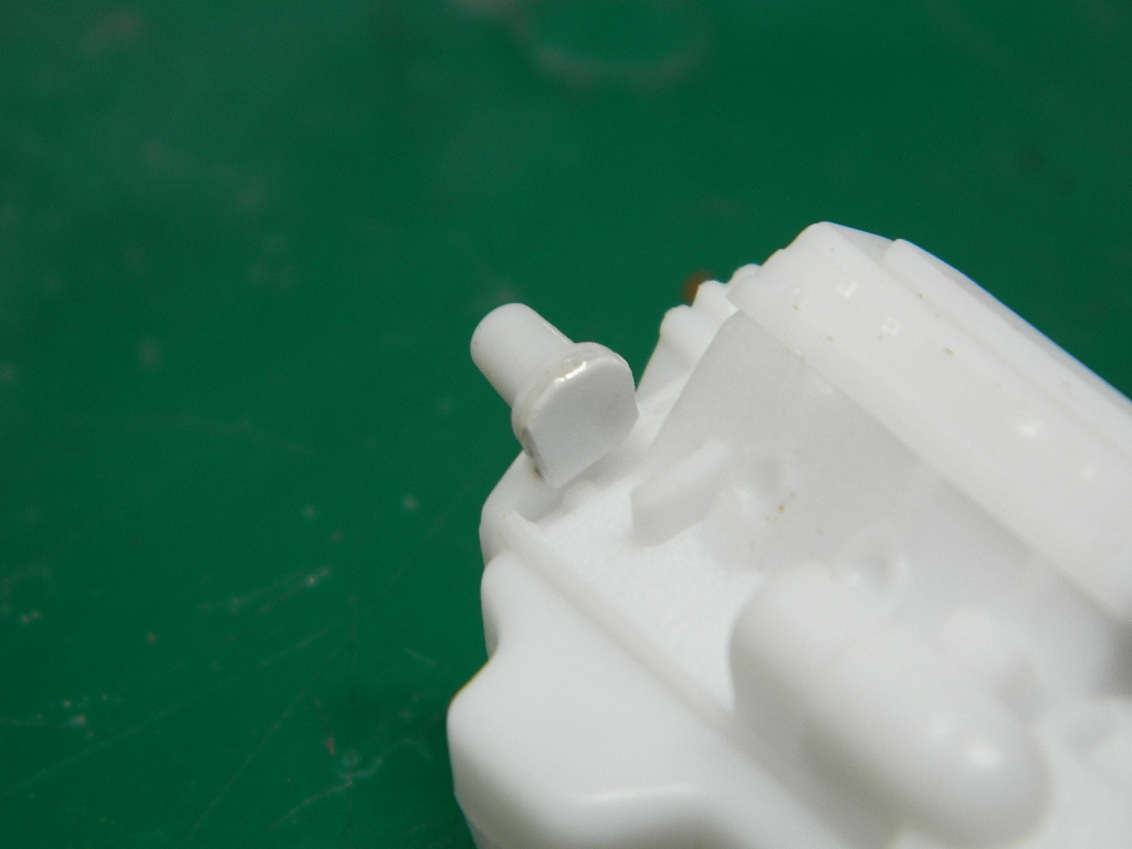

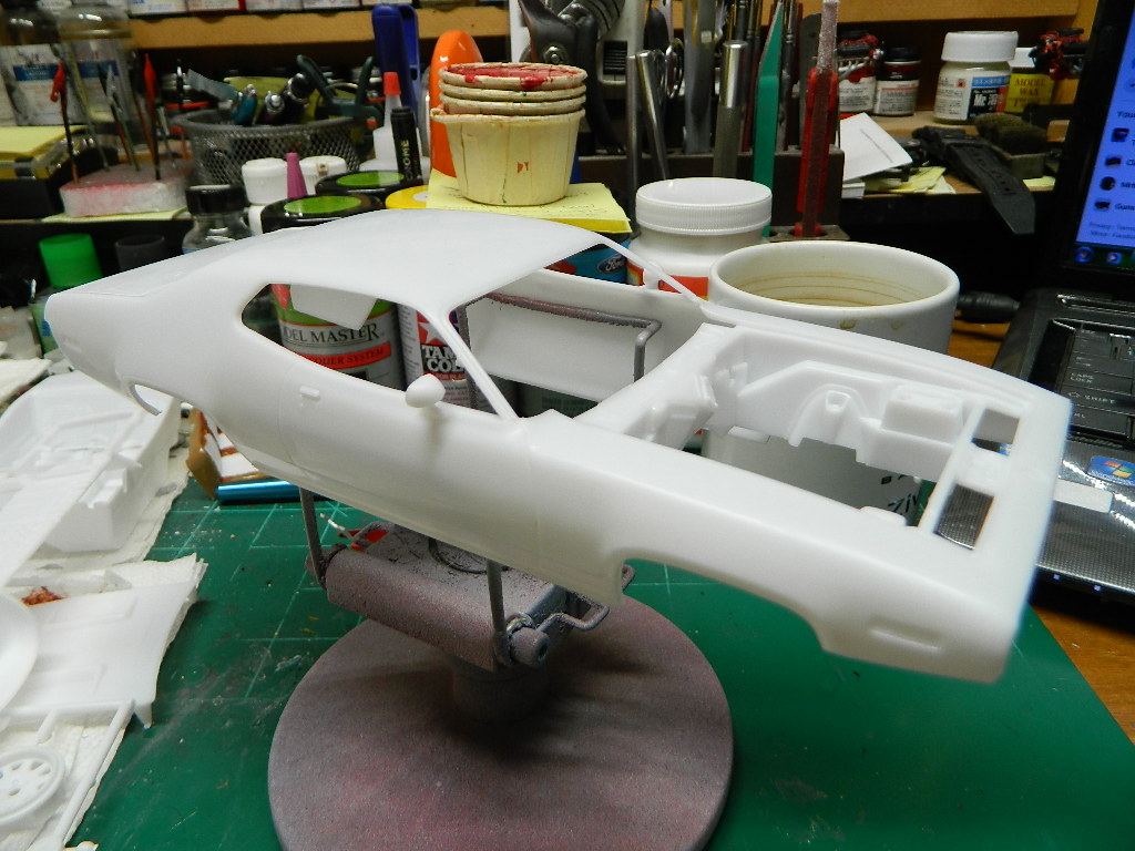

I have been looking at the engine in this kit and it has a hole in the oil filter.  I covered the hole with a piece of rounded styrene.  The hole might not be seen once the model is assembled, but I know that the hole is there and covered.  I have also been sanding the trunk lid to remove the mounts for the rear spoiler that I am not going to use.

I have been looking at Sassy Grass Green '71 Roadrunners on Google Images and pictures of Roadrunners with painted bumpers are starting to appeal to me.  I have a '71 GTX and a '71 Satellite on the shelf without the painted bumpers and painting the bumpers will give me a different "Fuselage" body style.  I clipped the front and rear bumpers from the chrome sprue and covered them with Easy-Off Oven Cleaner and the chrome disappeared in 10 minutes.  Now to paint them and the rest of the body parts!
