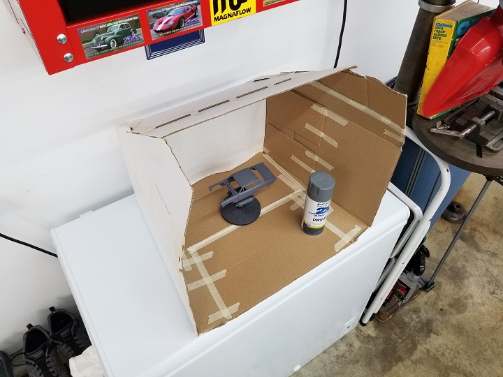

youpey Posted June 17, 2021 Posted June 17, 2021 I dont have a permenant work area either and i bought a platic bin to paint in. You definitely dont want to paint in windy conditions.

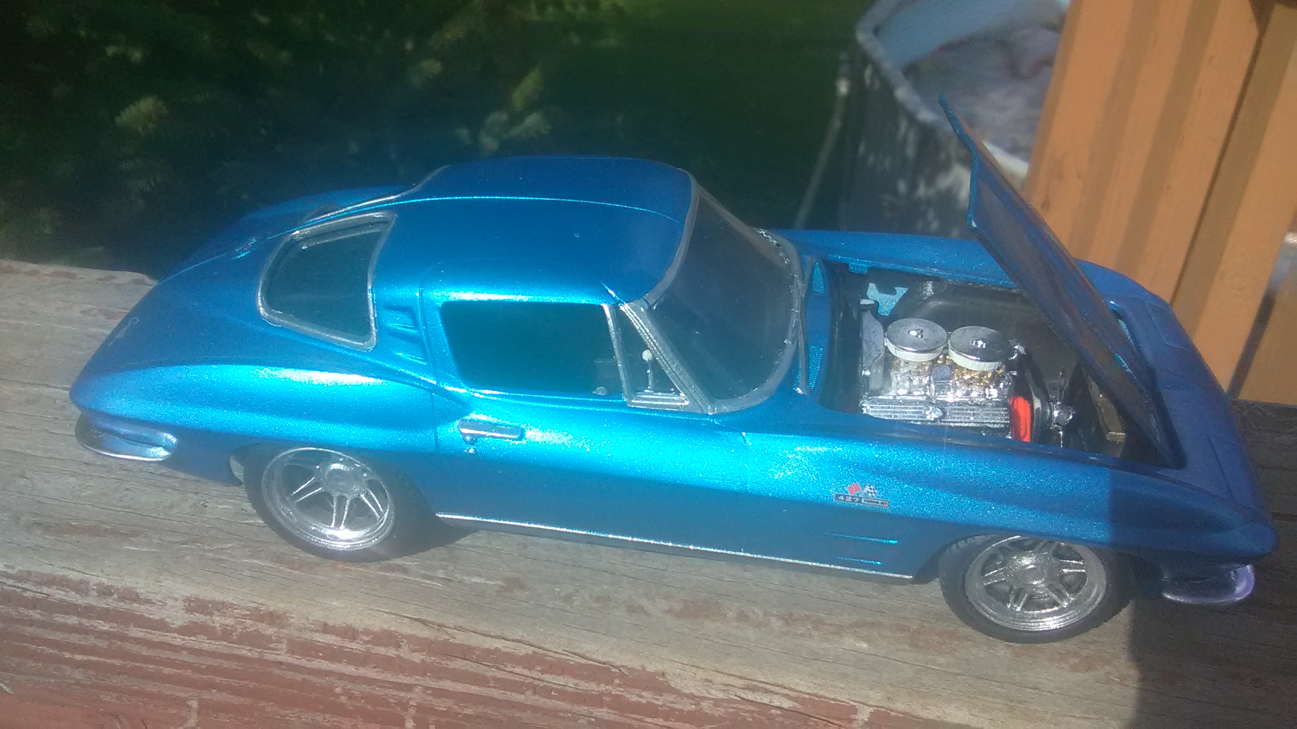

Sledsel Posted July 23, 2021 Posted July 23, 2021 On all mine I prefer to lay a coat down and let it dry for a few days, then some 2000 grit and 2 more coats. If it is a solid color and I do not like the finish I take 3000 grit and polish. Metallic paint seam to lay better for me but I will clear and wet sand and polish when needed. This is a duplicolor paint job with one coat of Testors Wet look clear, no buffing
