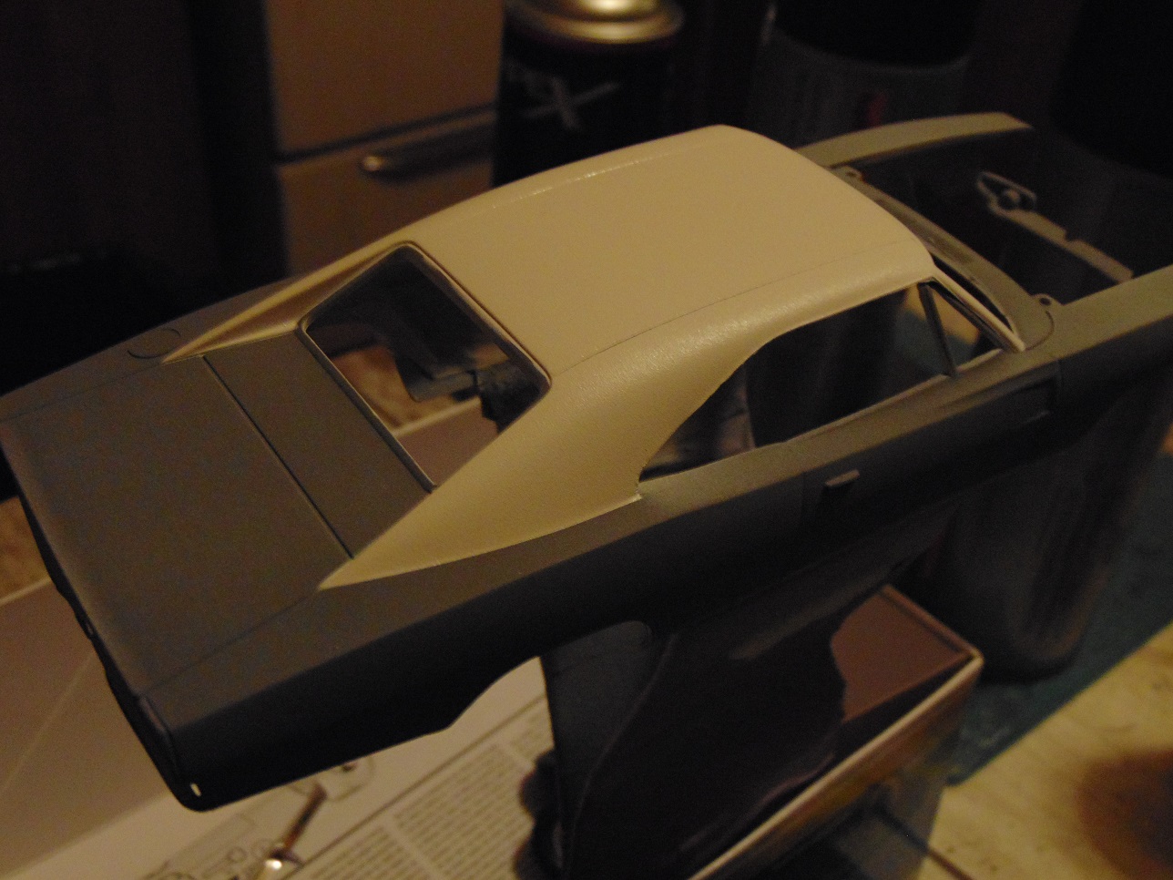

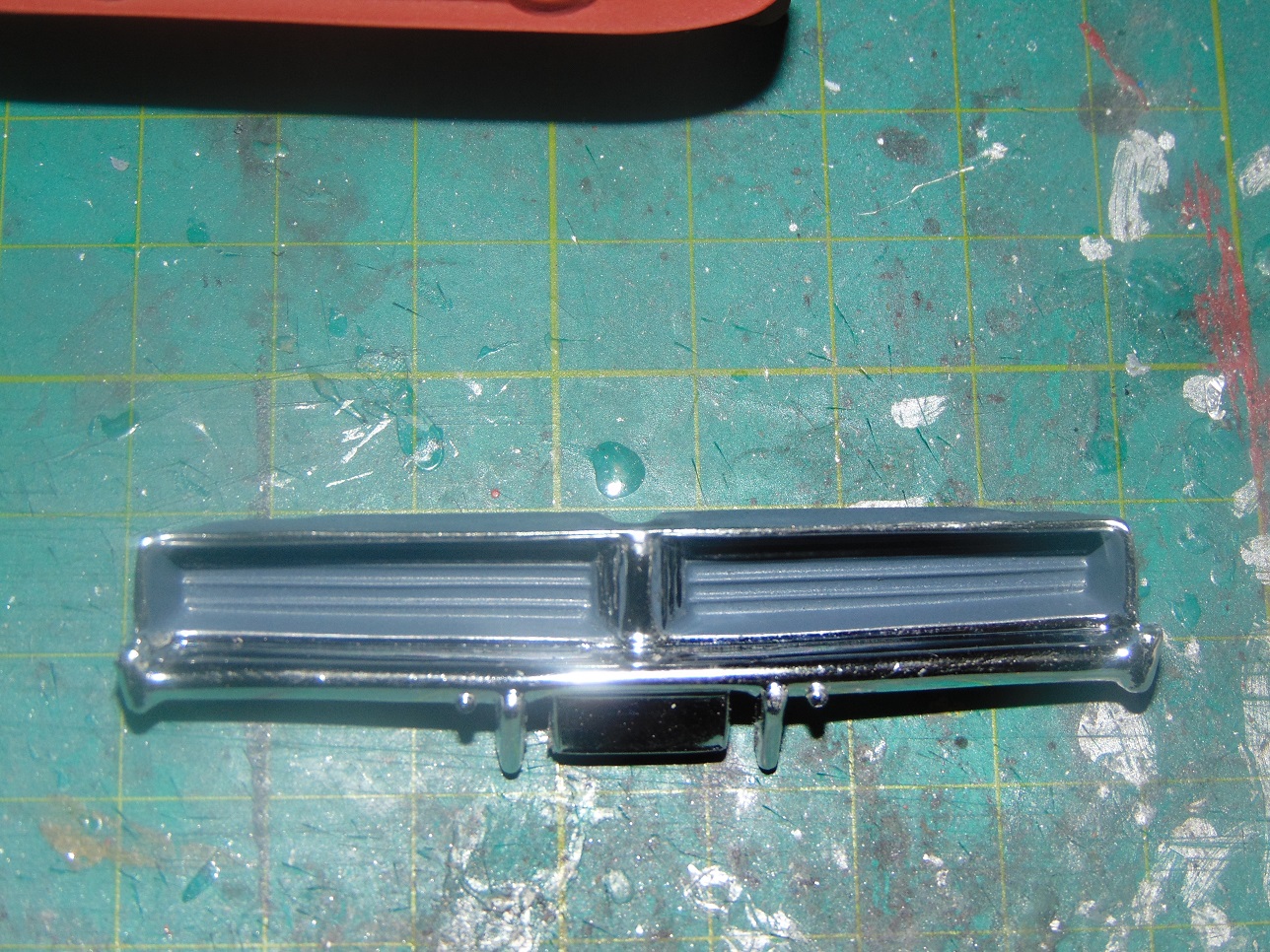

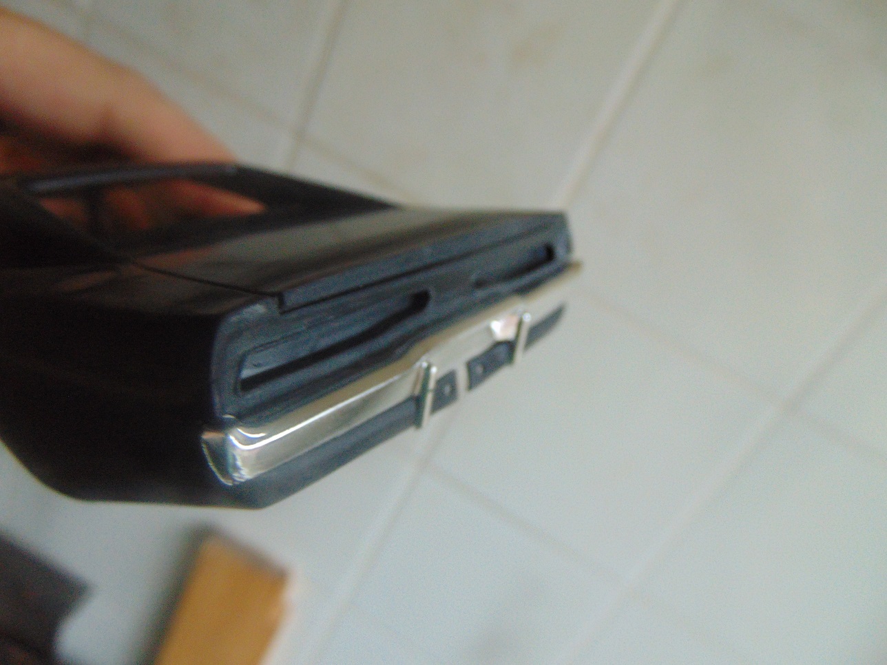

I heard this kit suffers from horrendous fit issues and requires a ton of work to even make it look half good.... so on that note I went ahead and bought one! I'm going with turquoise blue metallic with white vinyl roof and white interior. I've always liked the look of these cars with Magnum 500 wheels but this kit doesn't come with them, so I'll be using a set from my spares tin. On opening the box I could see straight away how much millage they've got out of this mould over the years. I've spent the best part of three days shaving, cutting, trimming, and even adding some filler to get the bumpers and grill to fit the body, even the body needed work, otherwise I'd have no grill or bumpers left to trim! I honestly thought the rear bumper was a mistake and not for this kit, xD!  Anyway, bad kits don't really bother me and I enjoyed fixing these crazy fit issues, certainly the worst I've worked with so far. If you don't like fit issues I recommend you stay well away from this one, Lol!

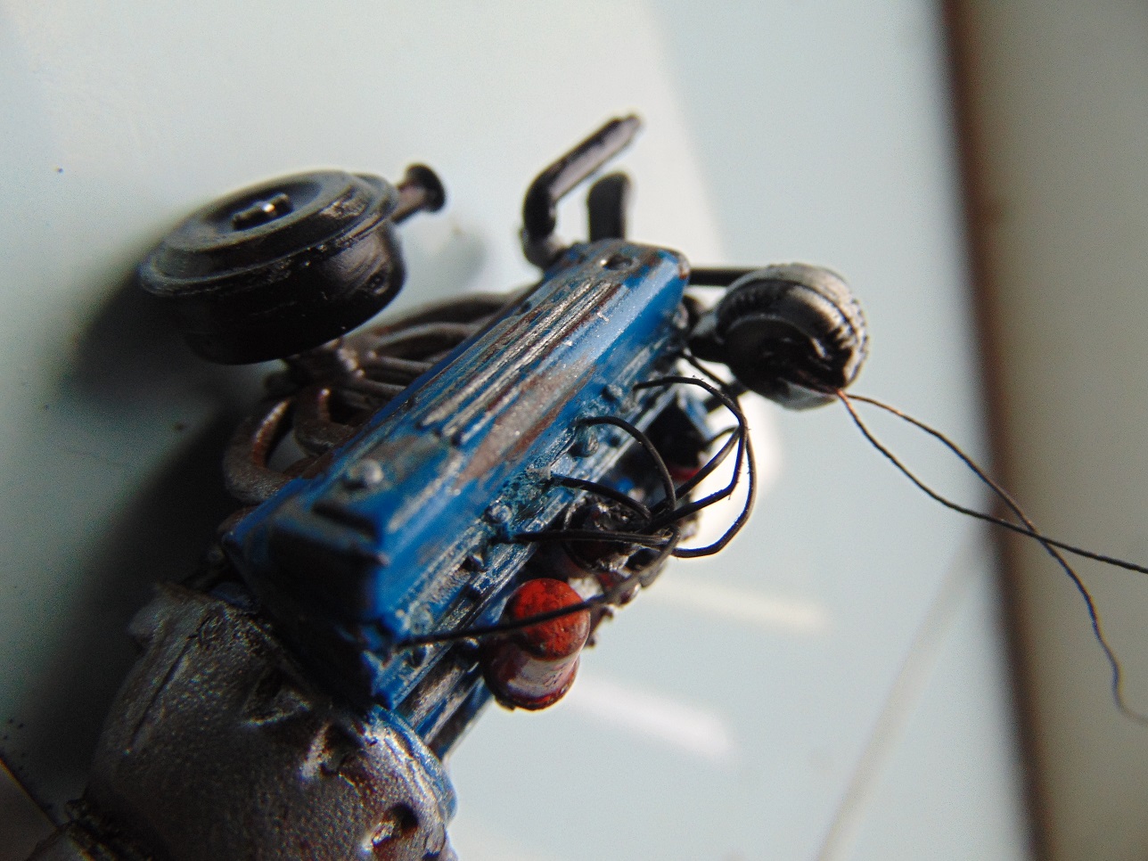

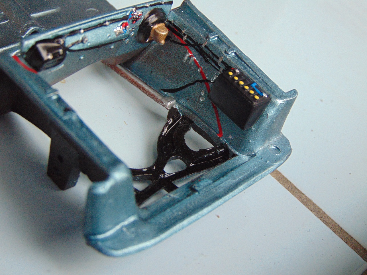

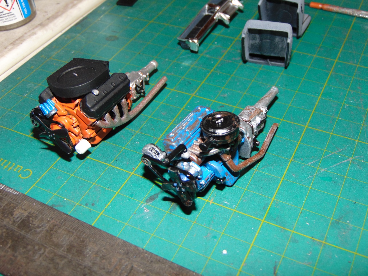

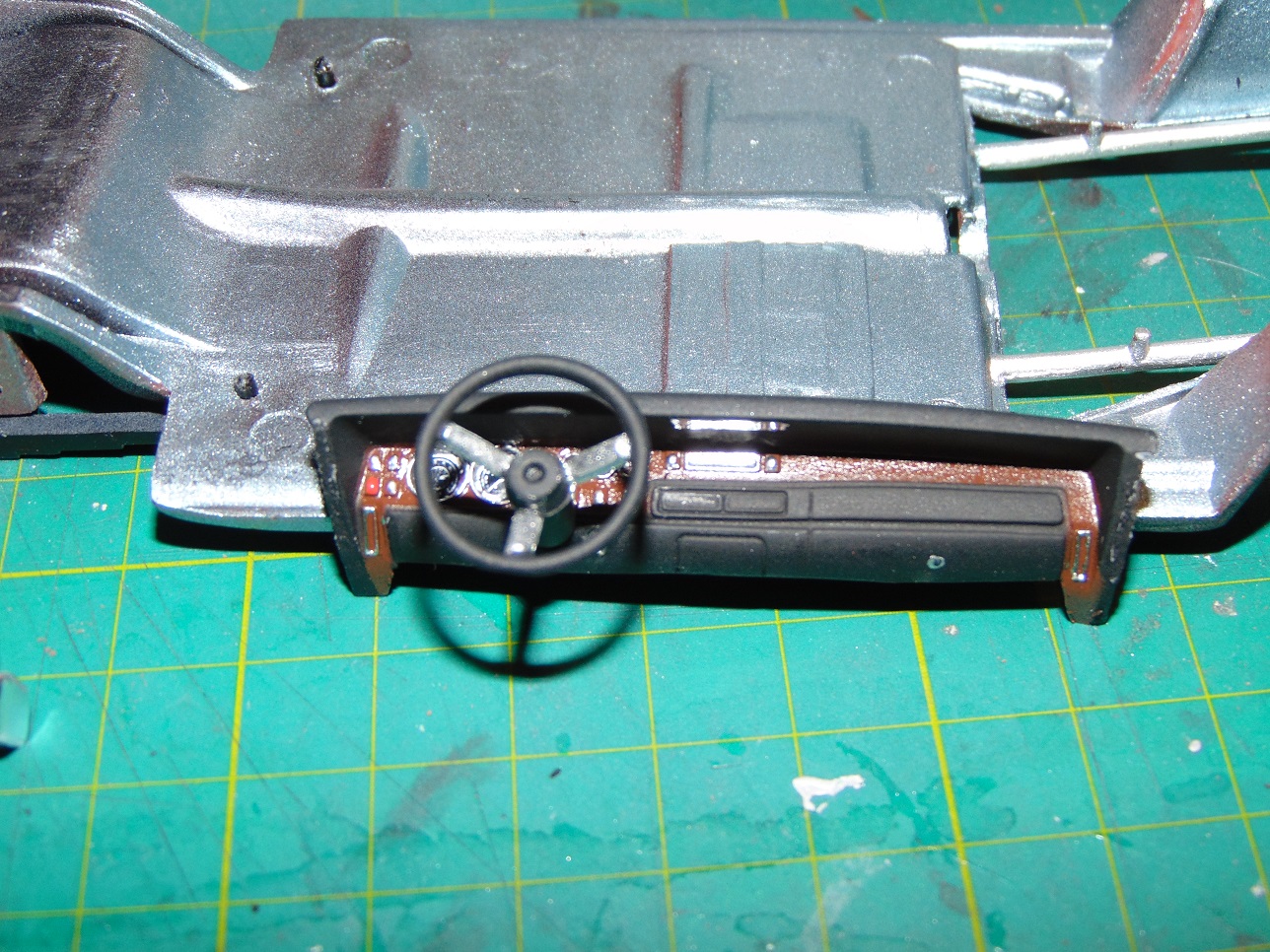

Lol. c'mon guys, where's the love for this old MPC kit? xD it is pretty bad though. I've decided to go to town on this kit now, so I added some detail like the filler pieces on the rear wings and added panel lines to separate the front wings from the rocker panels. I have electric window switches in my spares tin for the interior and I might make a pistol grip shift from one of the many many guns that came with the MPC Squad Rod! There are no RT decals in this kit and no scripts on the body, so, I thought why not put the slant six in there from my '64 Belvedere?! It drops straight in and fits nicely, the only mod needed is to cut off one of the exhausts from the axle. The vinyl roof is done, and I got some detailing done on the dashboard and firewall. I might even wire the engine and add hoses and such, might as well now with the amount of work it took getting it to this point!

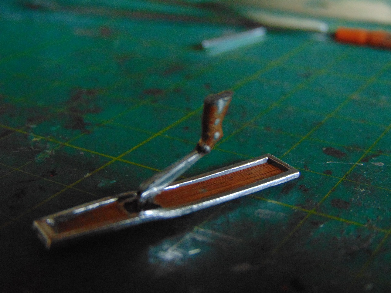

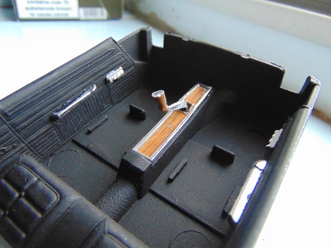

Thanks guys. Got some more done today. Engine bay detailing is mostly finished. Made a pistol grip shift from a riffle I had in the spares tin, made some arm rests up for the doors and put electric window switches in there, I think the switches are from the '57 Fairlane. I've wired up the slant six distributor including one for the coil, and even added some wires for the alternator. I'll add heater hoses too when I get the engine in, Lol!

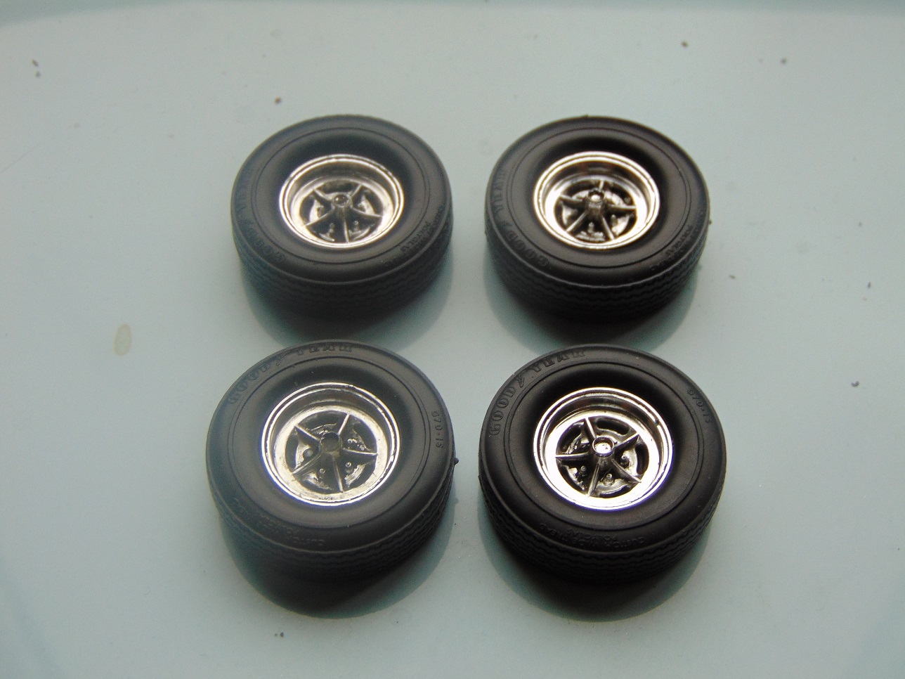

I hope you won't mind me saying so, but I think you should find a better set of wheels for this build.
Judging by the curvature of the spokes, these appear to be Buick wheels.
Here are some authentic Mopar wheels on a Challenger
Notice how the spokes "crown" toward the center of the wheel?
They shouldn't be too hard to find, especially among this bunch of builders.
I was thinking exactly the same thing. :unsure:
Not at all, I welcome any info like this if it can help me build a more accurate model. Thanks, Monty.

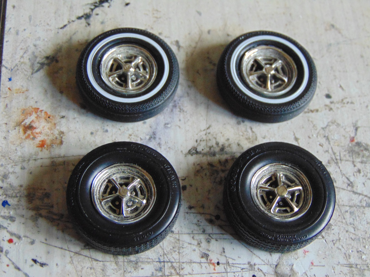

Found some wheels that look close to what Monty suggested but they needed a lot of work. They were too wide and pushed the wheel hubs out, so I sanded the back of them flat, also, the rims covered too much of the tyre so I had to carefully sand them down without creating flat spots! Thanks to Monty pointing out the wrong wheels I was going to use, these look a little better, even though I spent more time than I should have on them, Lol! While digging through the spares I found some whitewalls, I don't know if I'll use them, I'll see which I prefer when I finish the car. The interior is finished and the engine bay is packed! I still have a steering box to put in there!
