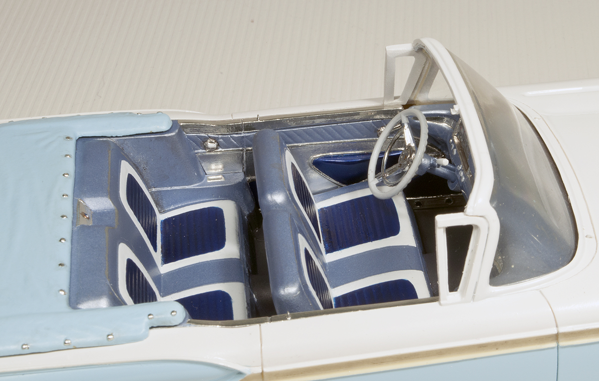

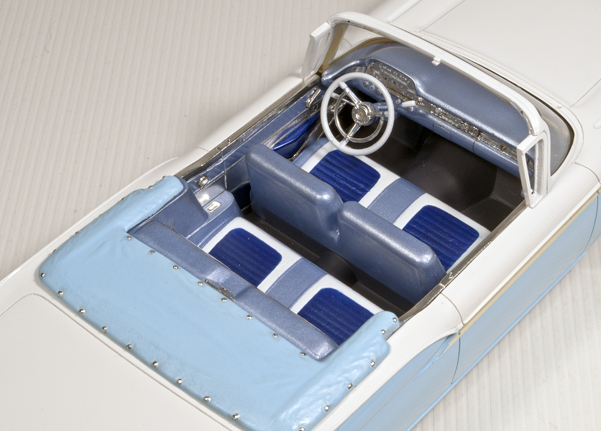

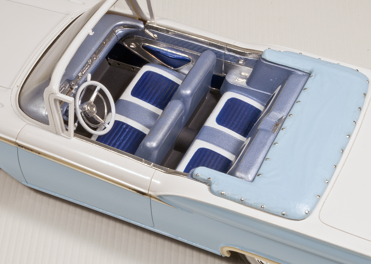

John Goschke Posted July 9, 2021 Posted July 9, 2021 (edited) You have your seat colors correct. The interior side panels should be black where you have the Global blue. The armrests should be black. Here are shots of the interior in my '59 Sunliner model. Where this interior is dark blue, would be black in your model, substitute Coral Blue (Indian Turquoise) for the light metallic blue here. The door top moldings that I foiled would be Coral Blue painted metal in your replica stock build. The large panel that surrounds the door handle should be foil or bright silver, along with the molding with the holes in it at the bottom of the door. Hope this helps a little. Your build is great so far! I built one Skyliner years ago for a friend – the kit is definitely a challenge! Edited July 9, 2021 by John Goschke
