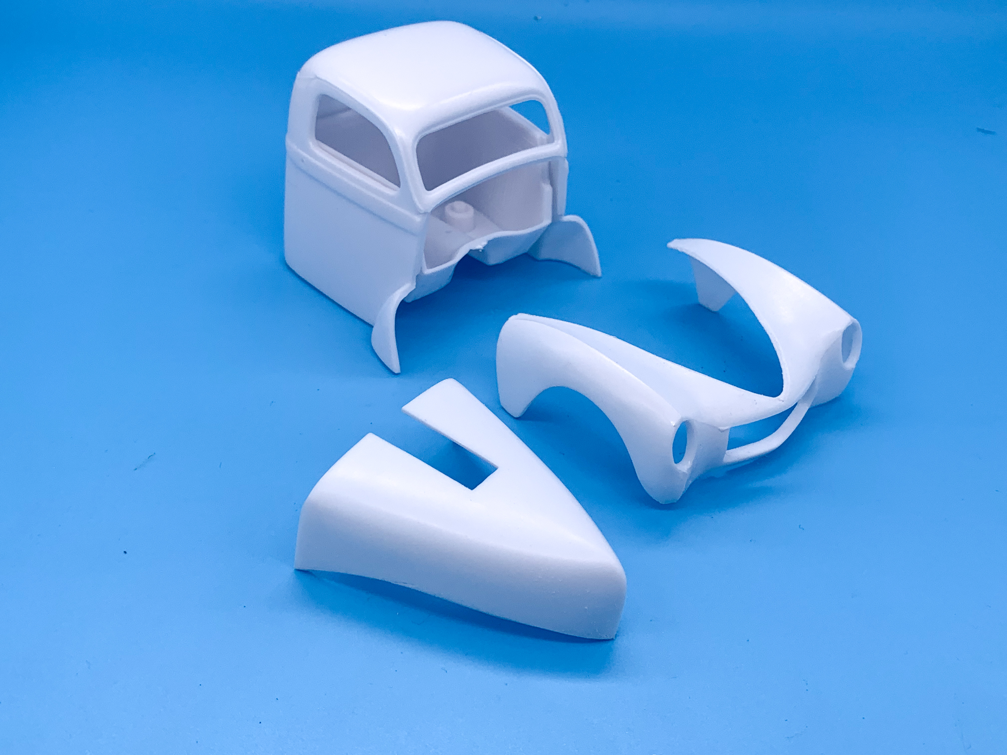

I’ll be building the AMT 40 Willys kit; the one with the terrible-fitting flip front:

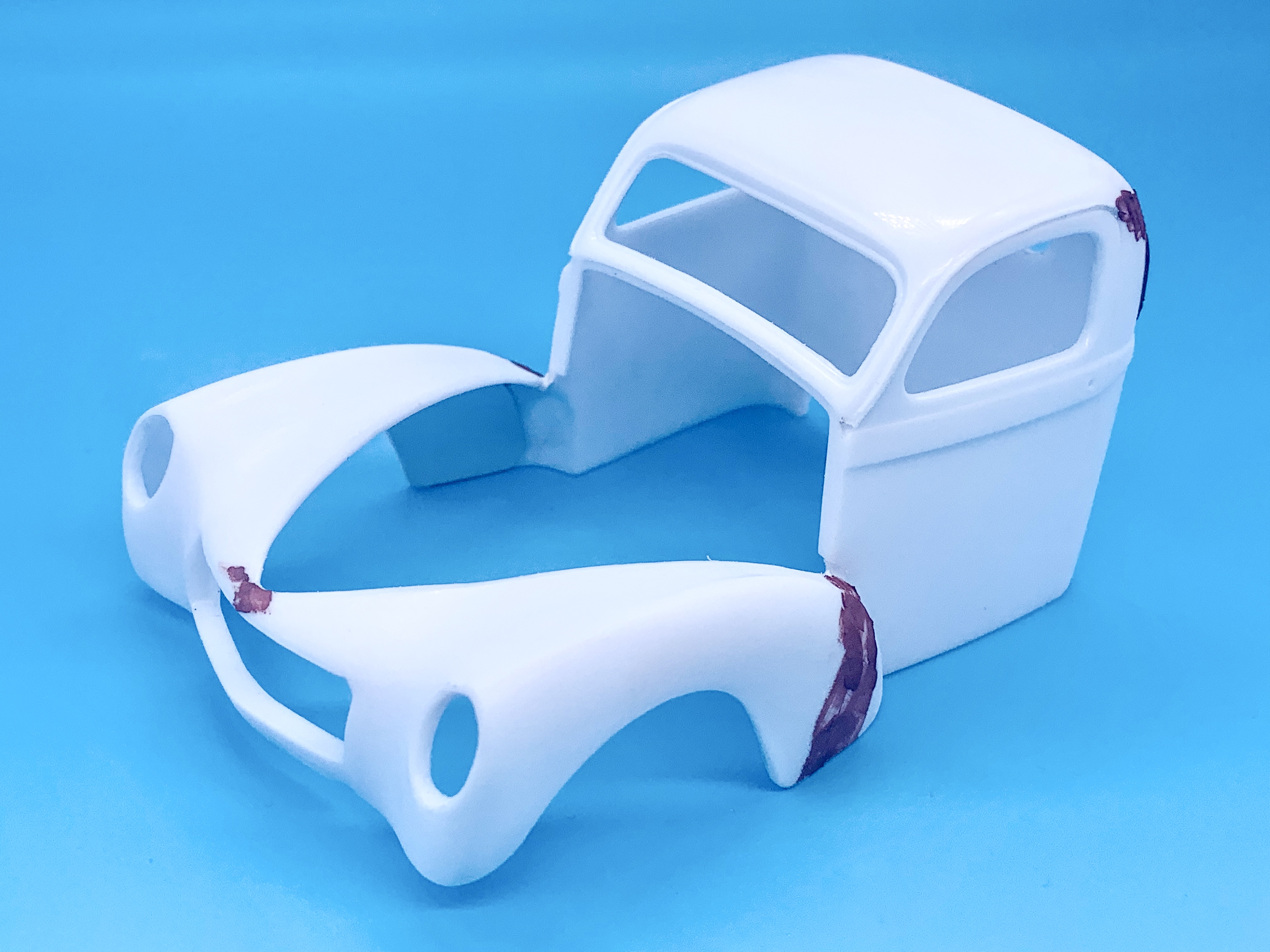

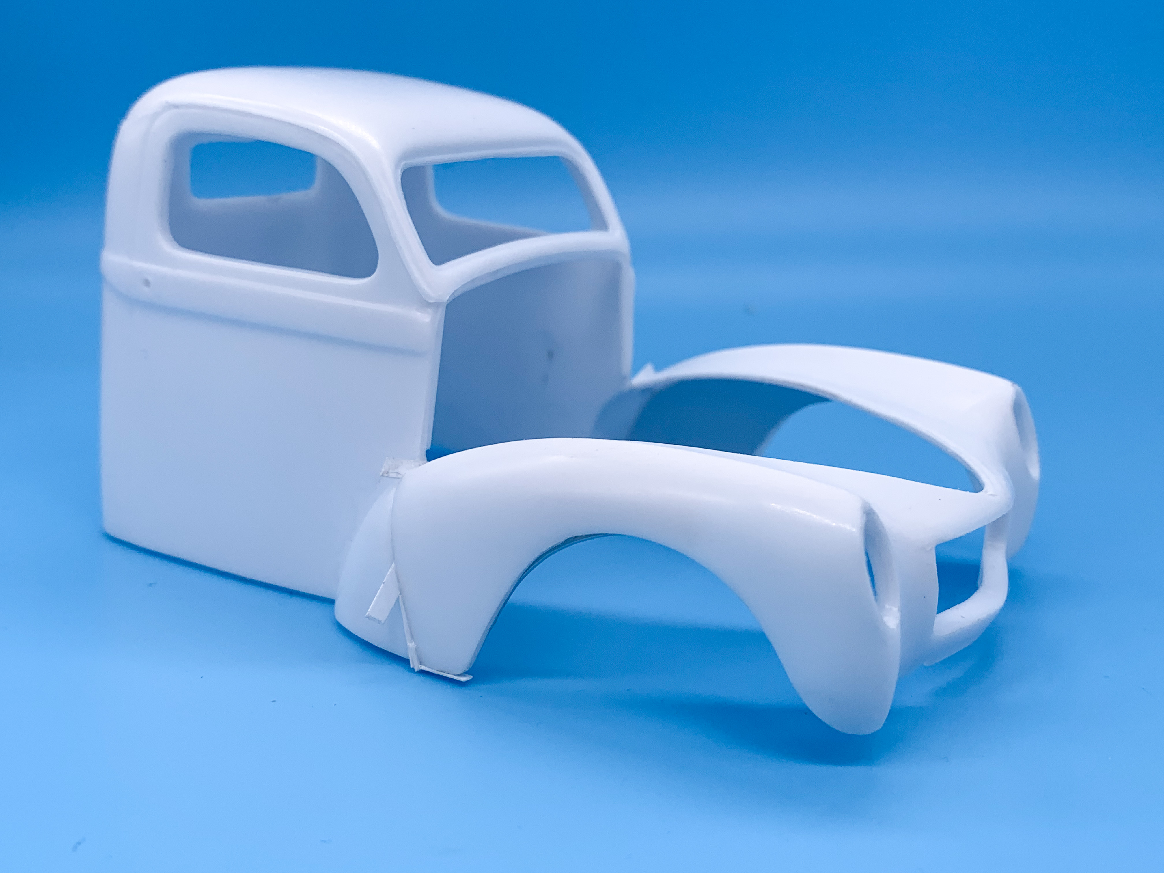

I already started slicing up the hood so that I can fix that whole affair…
…and that’s about as far as I got so far ?
I haven’t built any of these AMT gasser kits before - posting this thread a little too prematurely to see if anyone has any good build tips before I get going here properly?

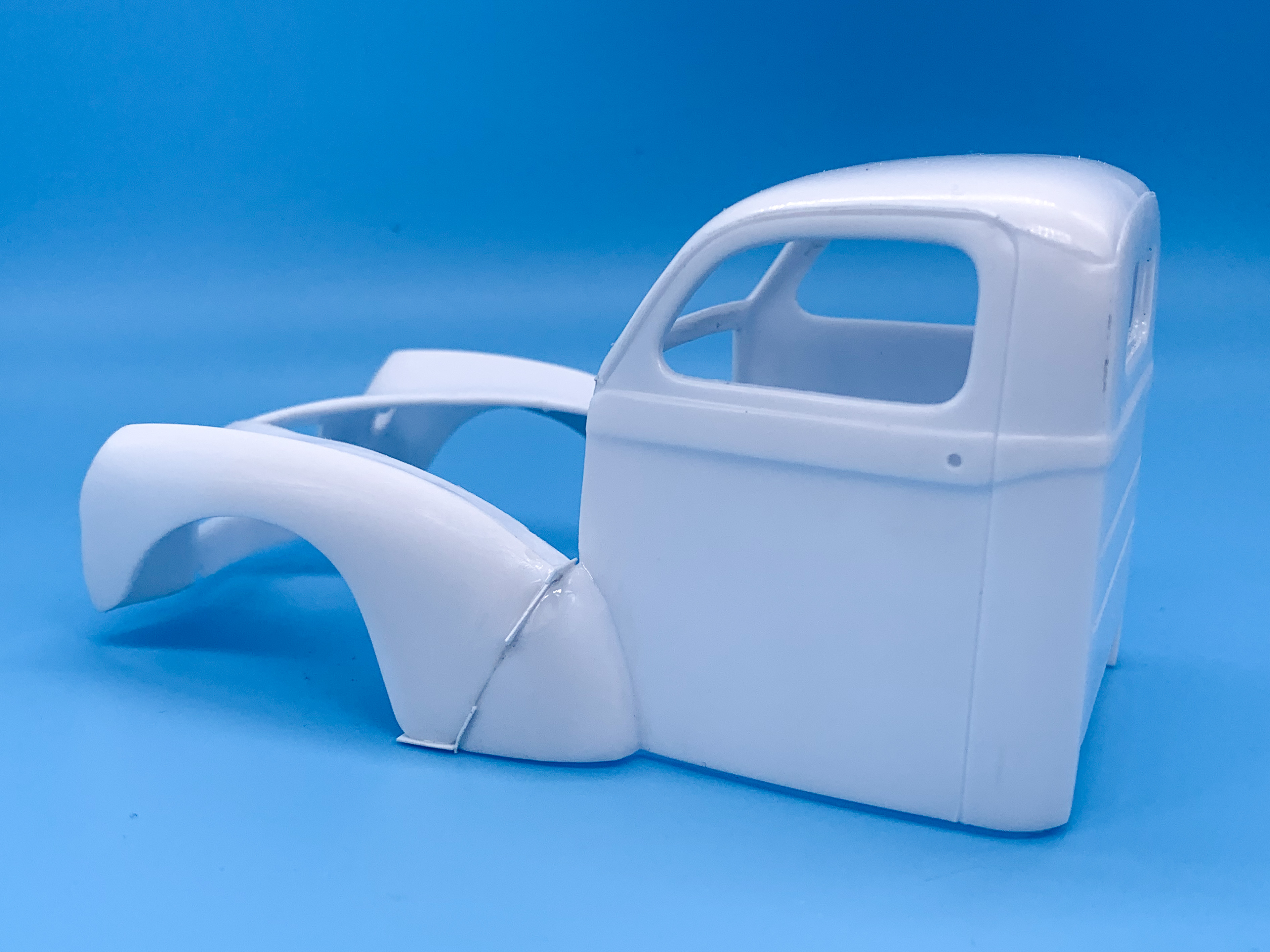

I wanted a nice secure bond of cab to fenders so I cut some little styrene pieces that fit right inside the arches, tacked it all in place with Loctite gel, and then after I got it all straight used styrene cement to lock it all in place.  Once that was done, I filled the gaps with some little slithers of styrene to plug any gap big enough to take a slither of styrene:
This body isn’t super straight and will need some fettling before paint, especially as I’m going to go nice deep gloss black for this one…started some puttying tonight to help get it straight:

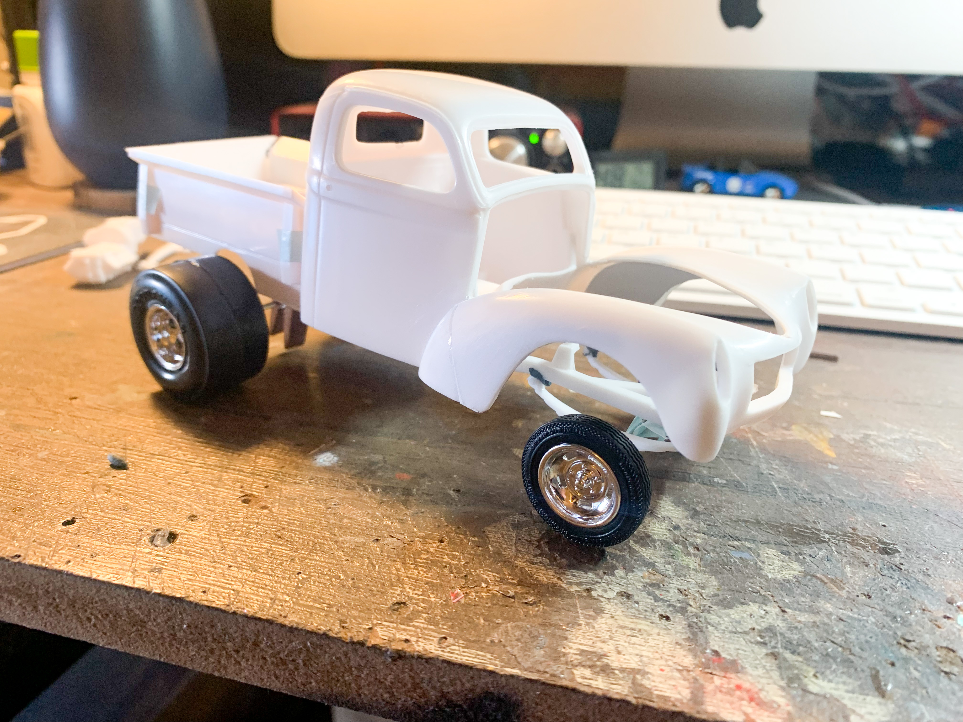

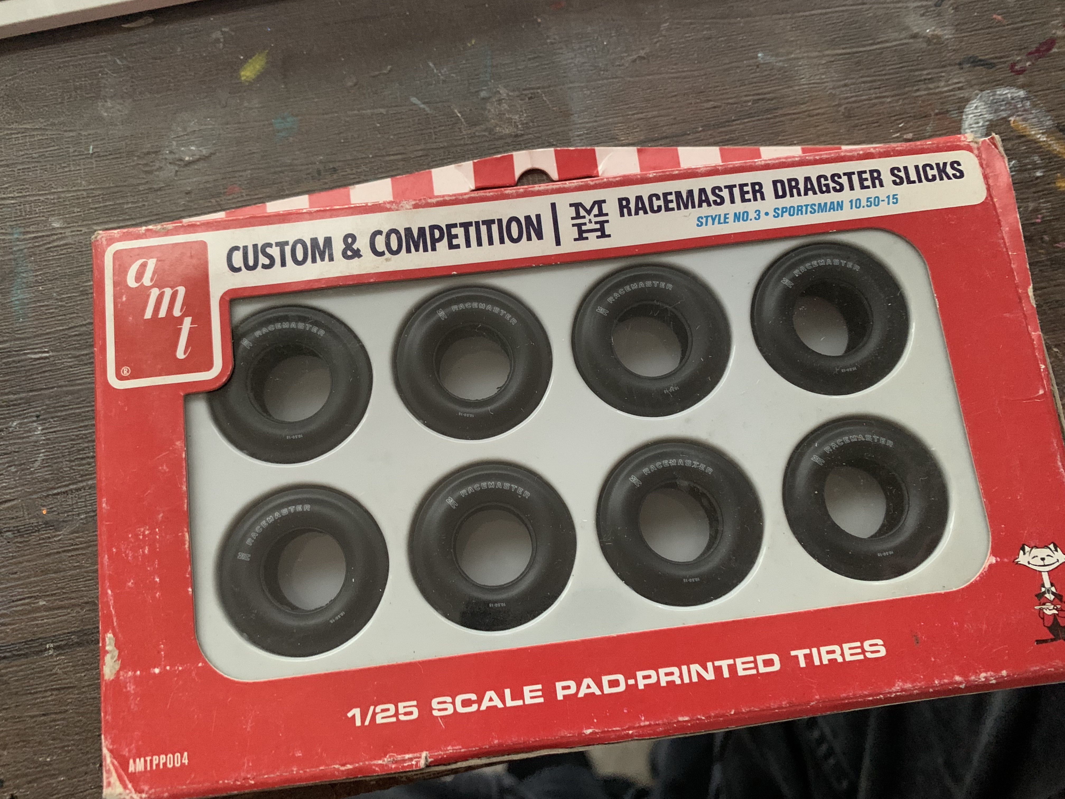

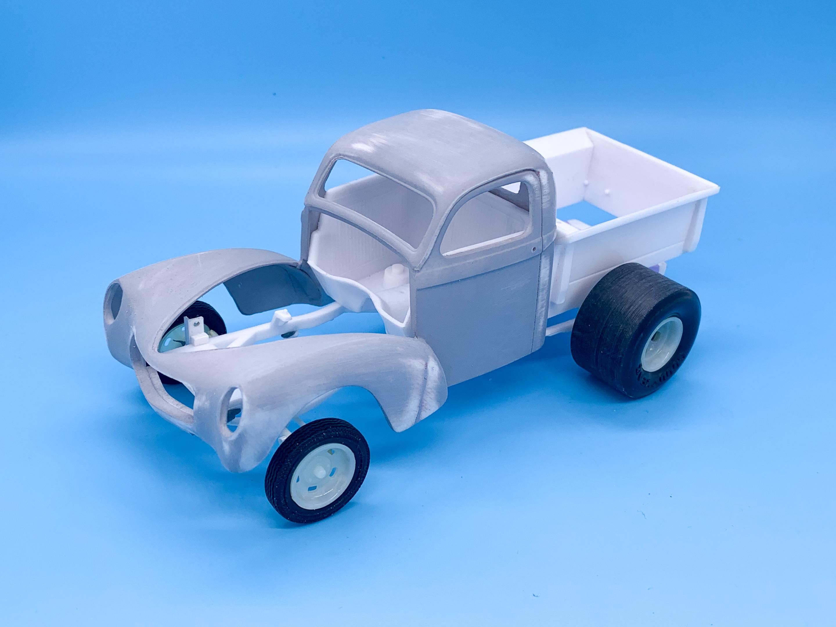

The kit tires rear are pretty skinny, and whilst I was researching 1:1 builds I got attached to this wider-tire look:
I ordered a set of AMT Jumbo drag slicks, but the seller sent me the exact size tires I had already:
So, some parts-box digging later I came up with these instead:
The stance isn’t right here at all, but I love that combo of bigs ‘n’ littles…they’re not as big as some I’ve seen, but big and dumb enough to look cool, and close to what I have in mind.

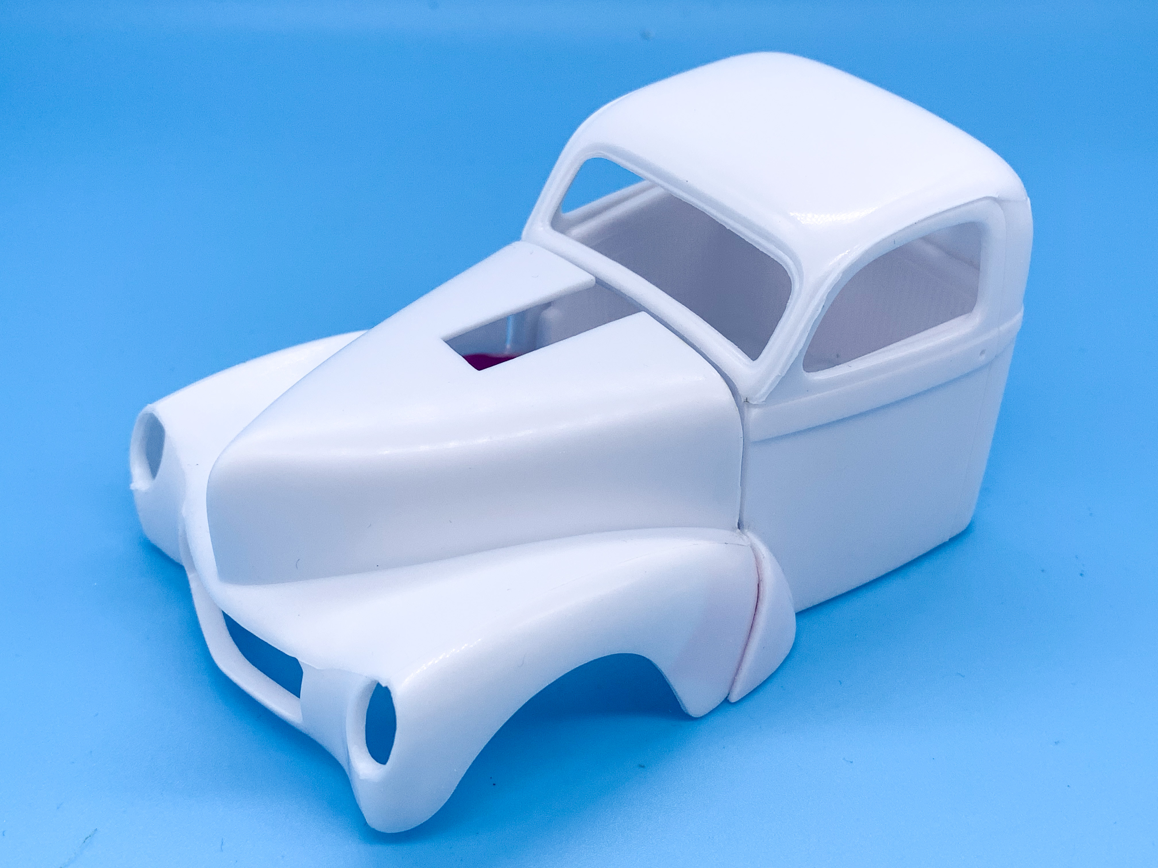

Next jobs will be messing with the frame and suspension to get the stance how I imagined it, and figuring out how to have the hood attach back on nicely after I cut it all off…more soon!

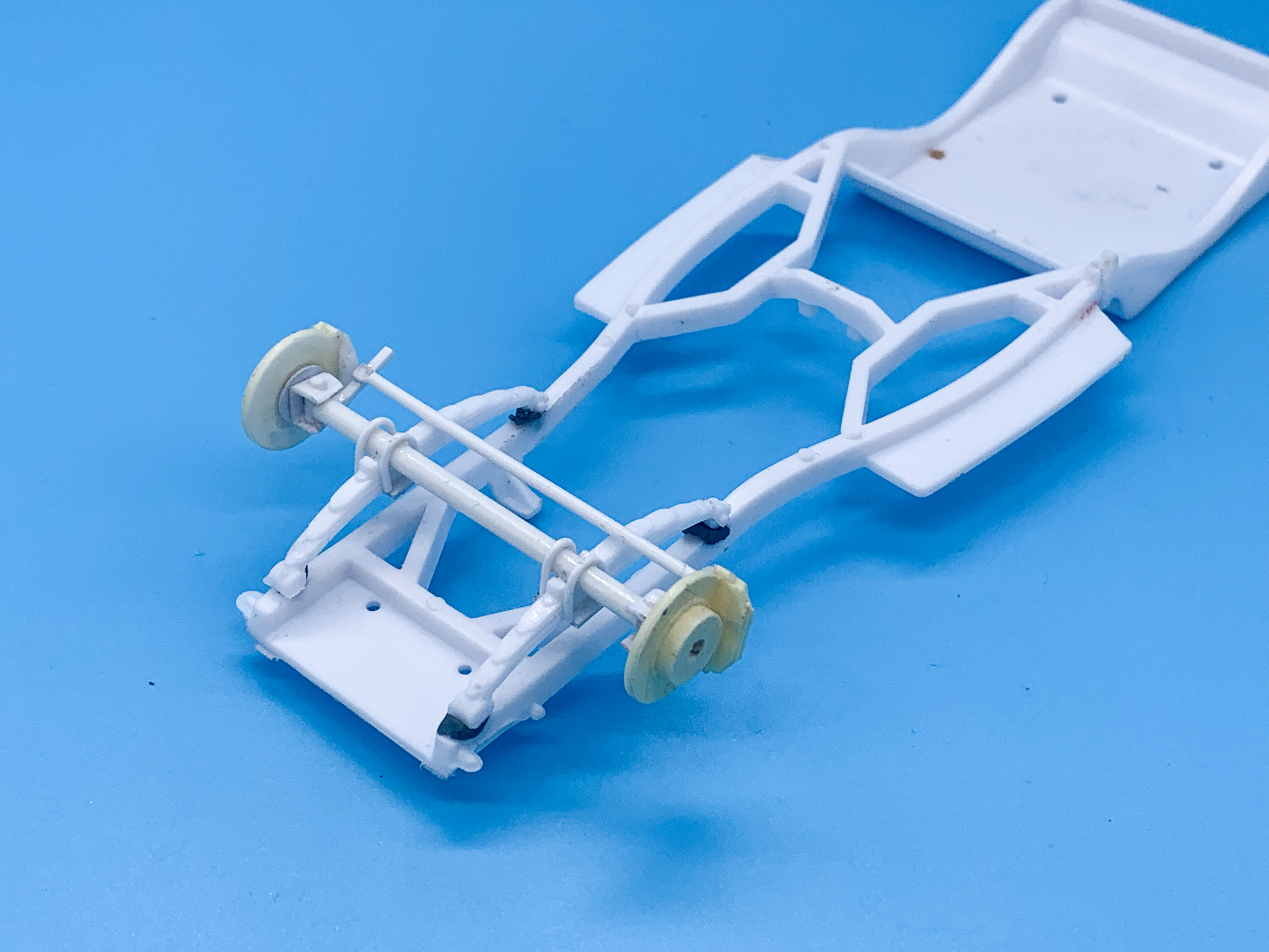

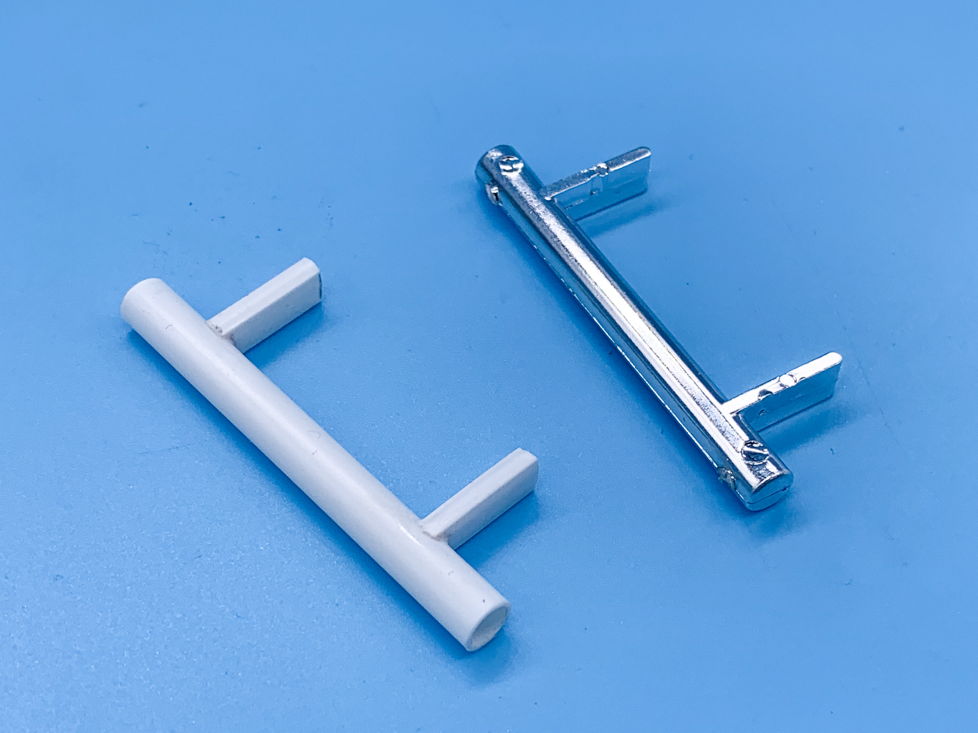

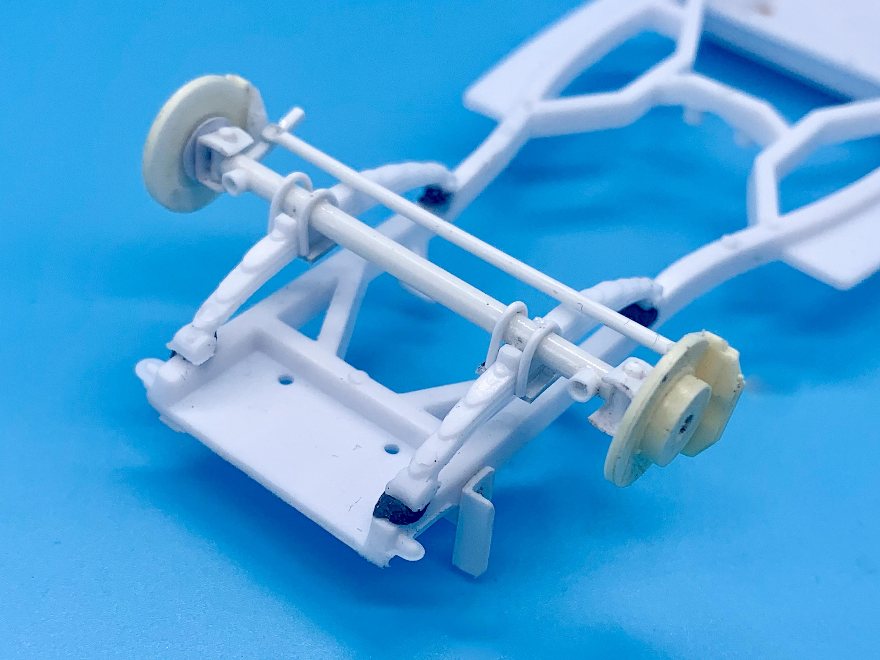

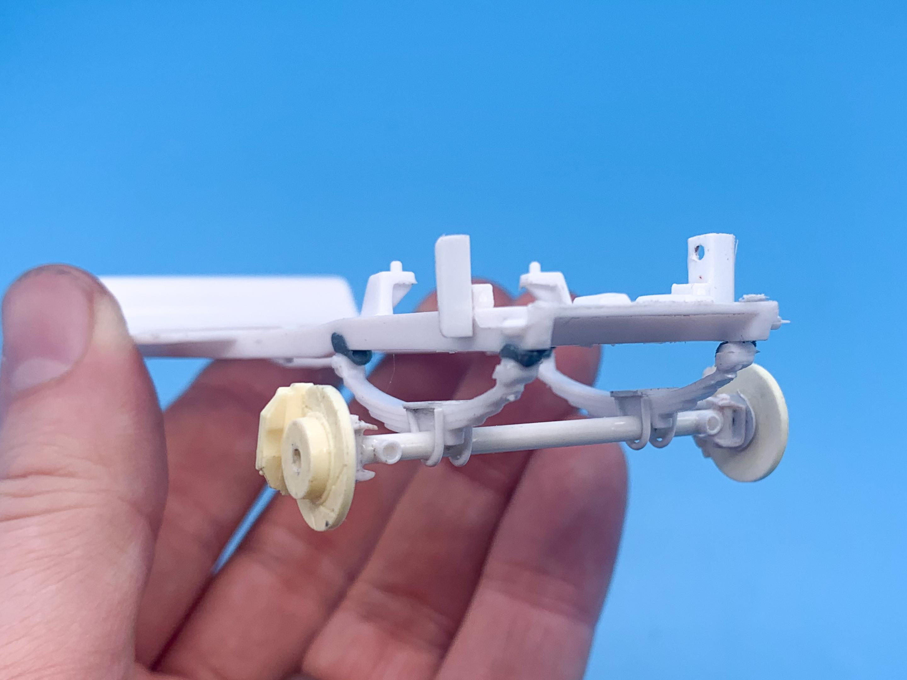

Spent the day at the bench today - I didn’t like the front axle that came with the kit too much:
It’s not BAD, I guess, but I wanted to scratchbuild a straight axle for it seeing as all those suspension parts at the front especially are so visible on a car like this.
Some hours later…
Took me longer than I thought it would considering this is just a straight piece of styrene round bar connected to the springs out of the box ??. Looks better though, I think…

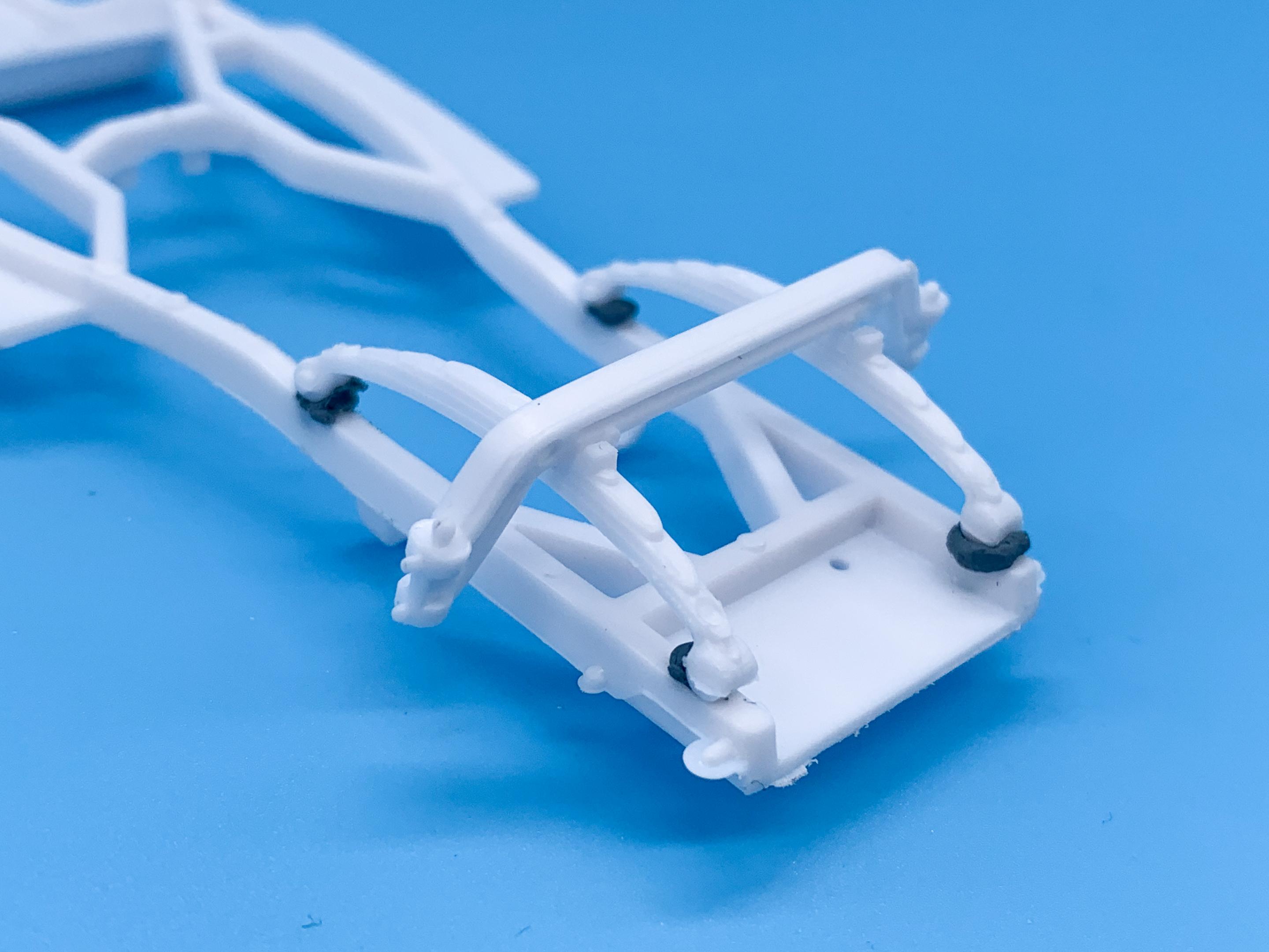

Tomorrow’s job will be replacing the kit front shocks with some home made ones - replaced the mounting bracket part already and added receivers to the axle, just gotta make the actual shocks:

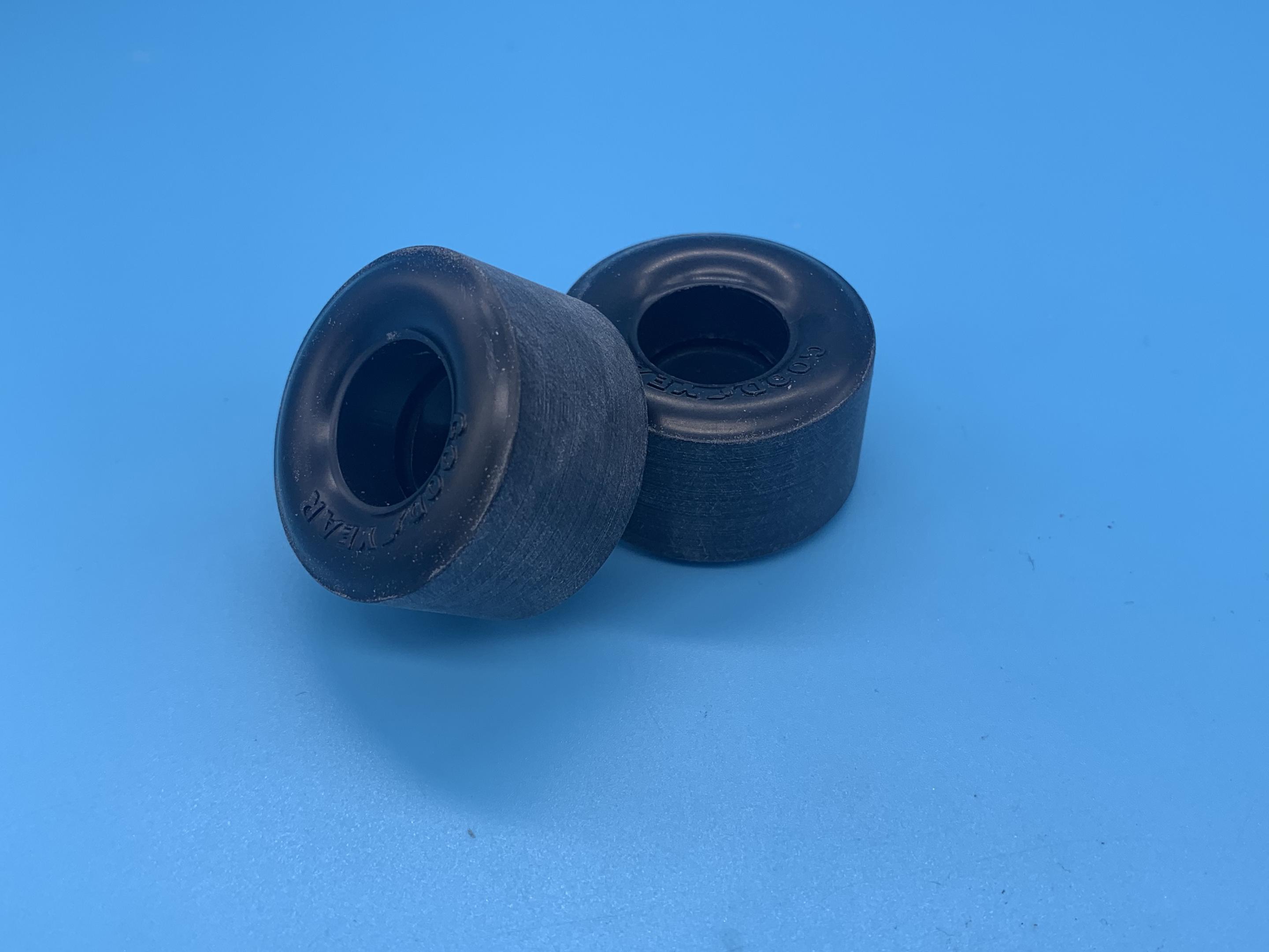

Oh, and when I was waiting for the glue to dry I spun up those two-piece plastic tires in the lathe and levelled them out nice and smooth to get rid of the visible seam:

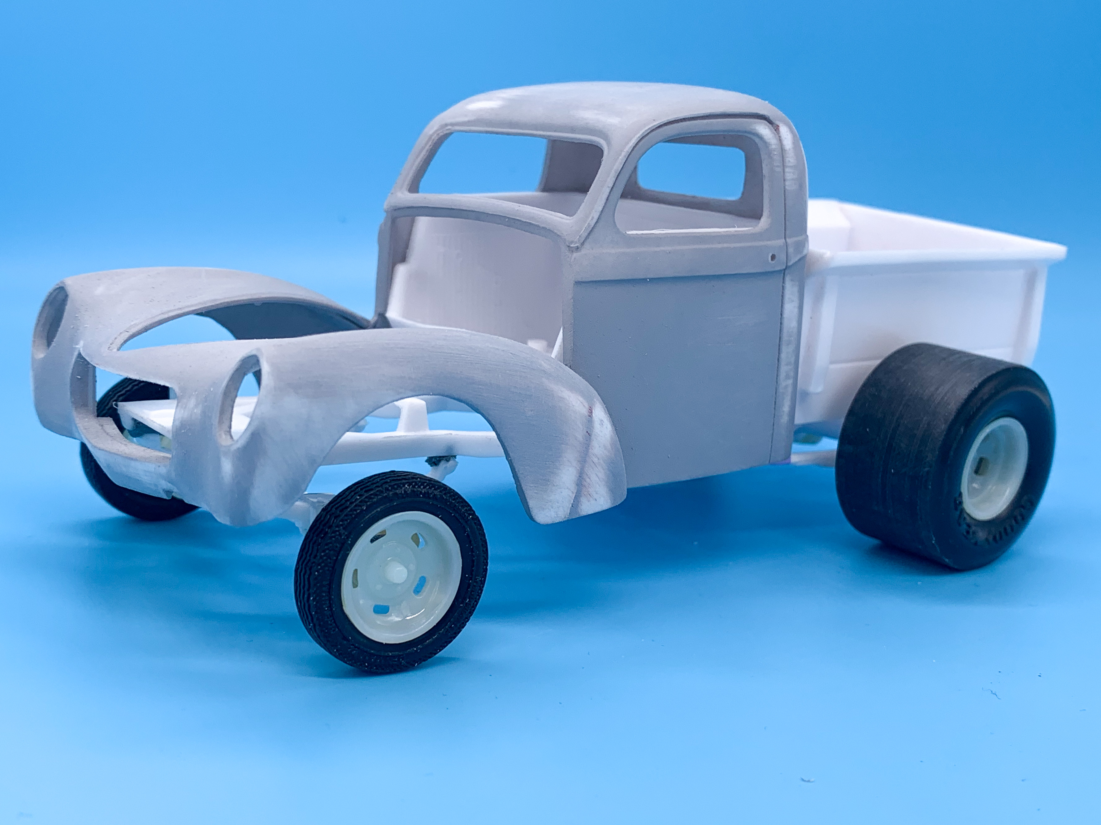

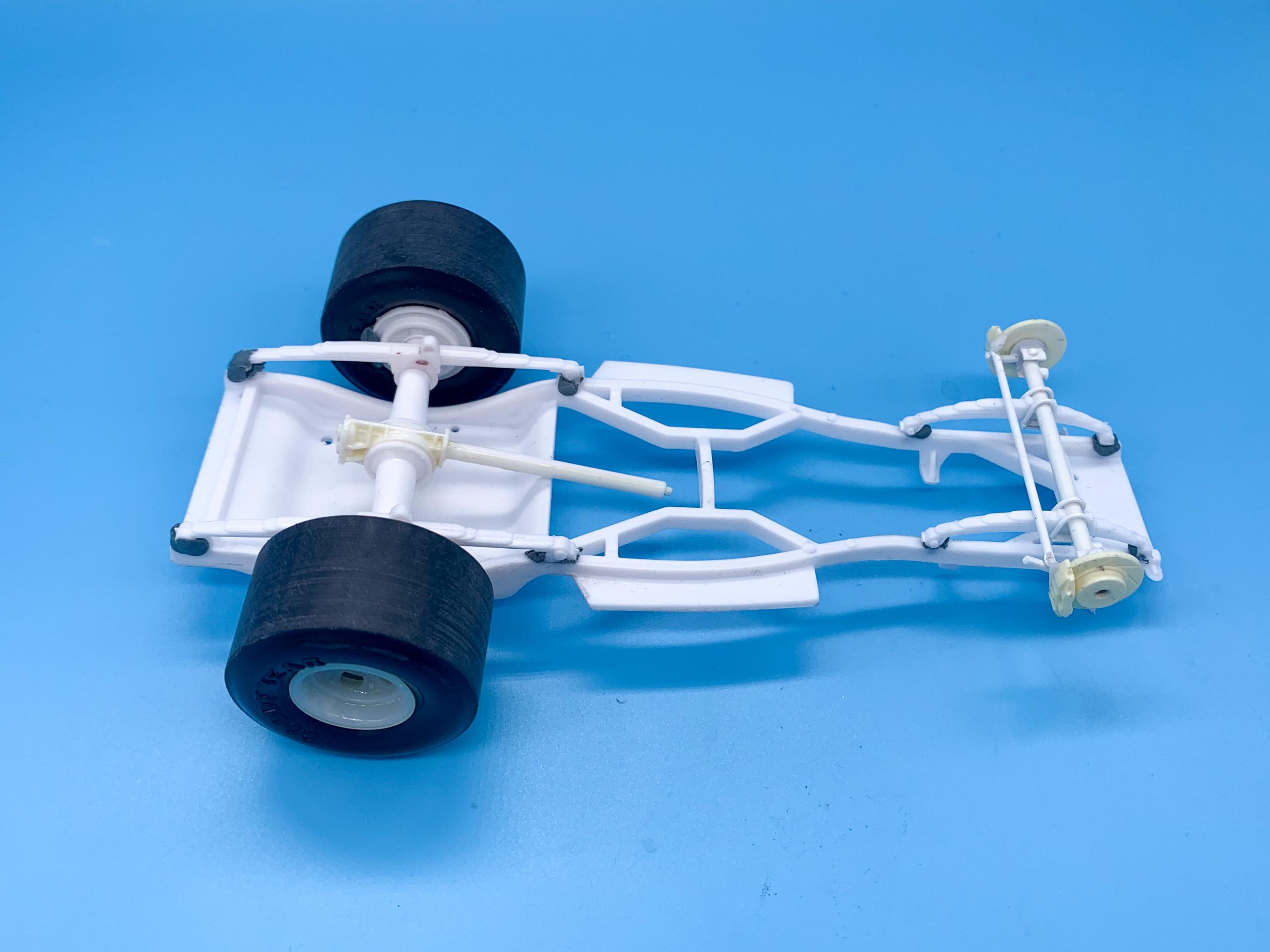

Today’s (small amount of) progress…
Stripped the chrome from the rear axle and got that assembled…not going wild on messing with the rear end as it’s nowhere near as visible as the front:
Those tires look huge on there!  With the cab and bed on there they look like what I was shooting for though:
As you can see, I squirted a little primer on there to see how much work the body will need - I’ll need to do some more fine tuning but overall it isn’t too bad.

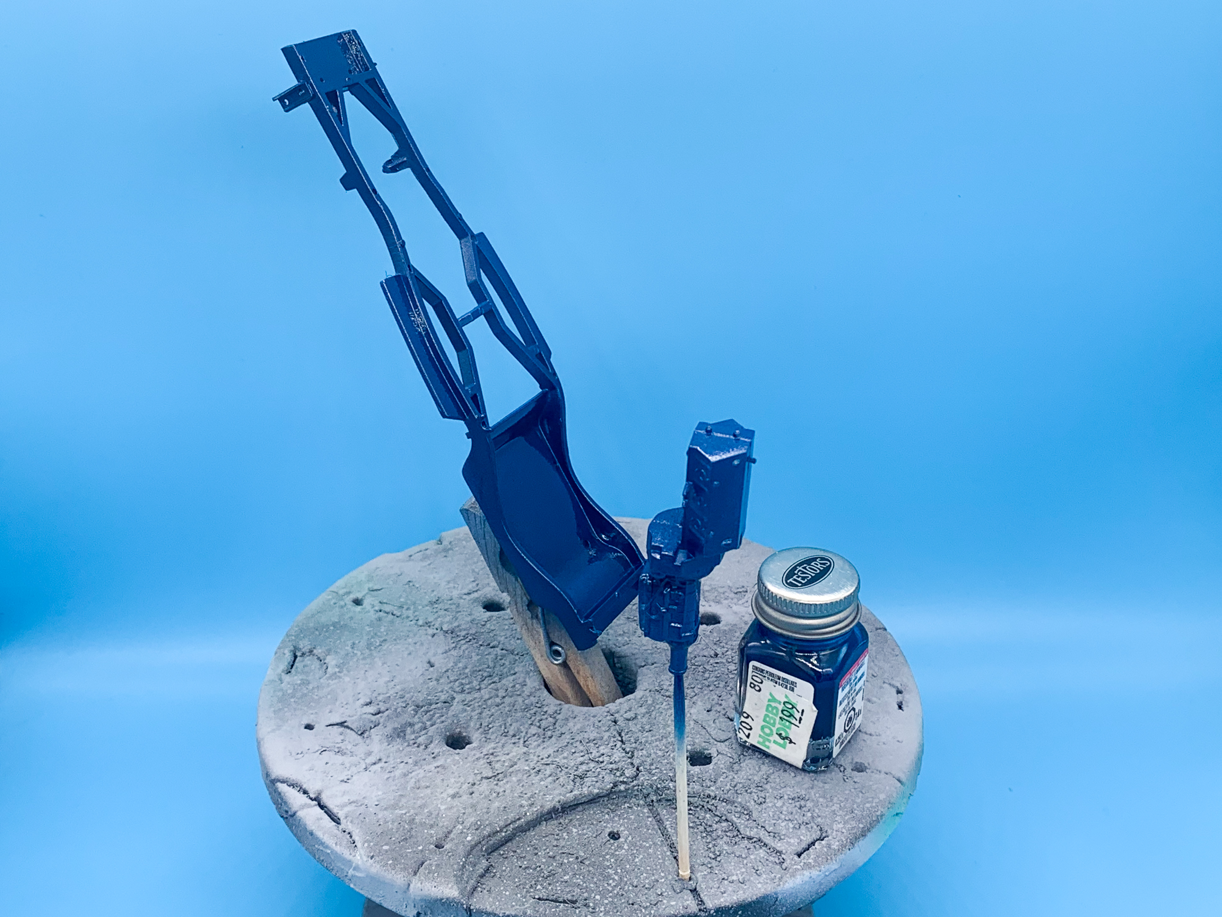

Shot the engine and frame in Testors metallic blue:
Then painted the bits I forgot the first time…

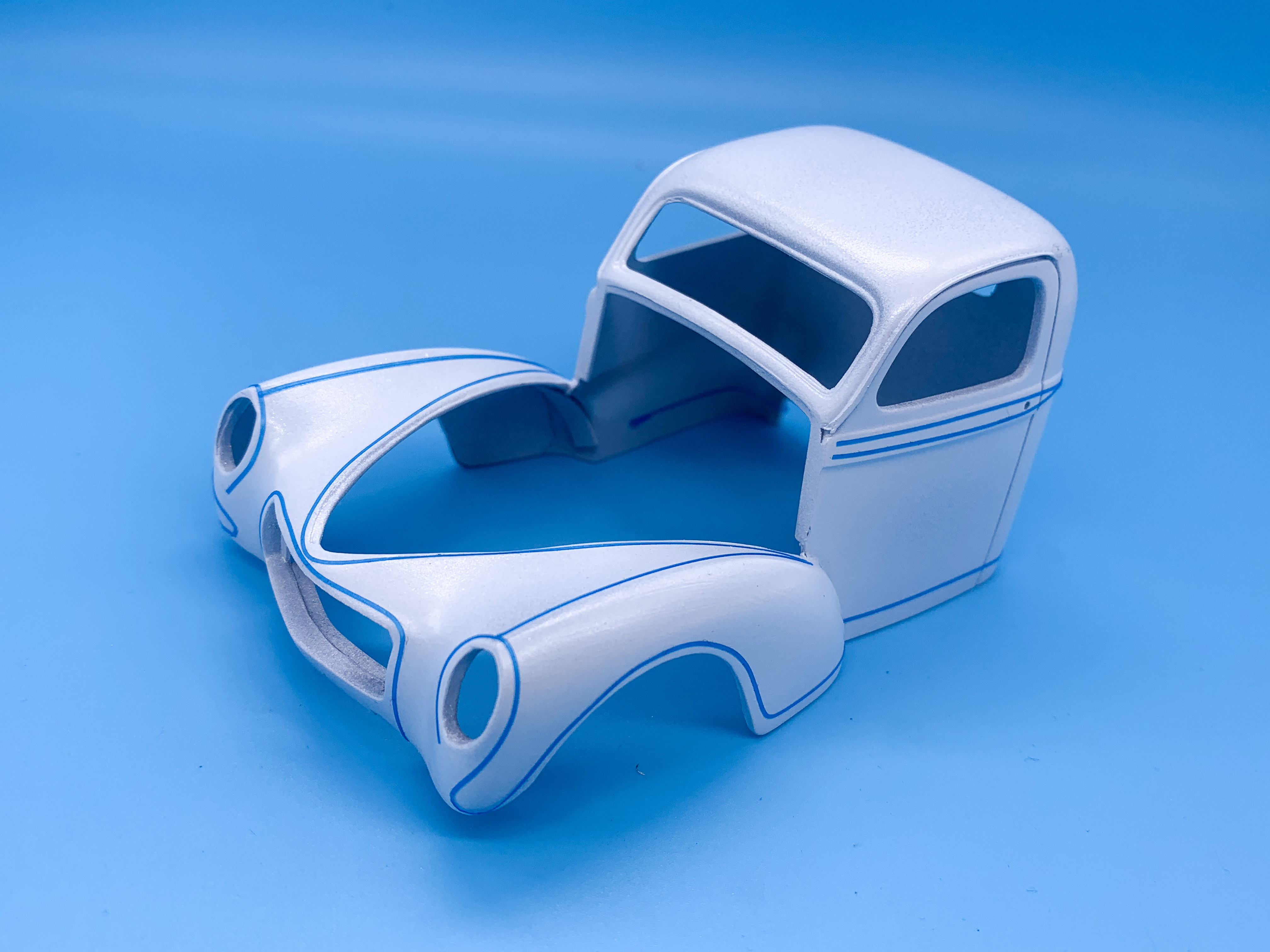

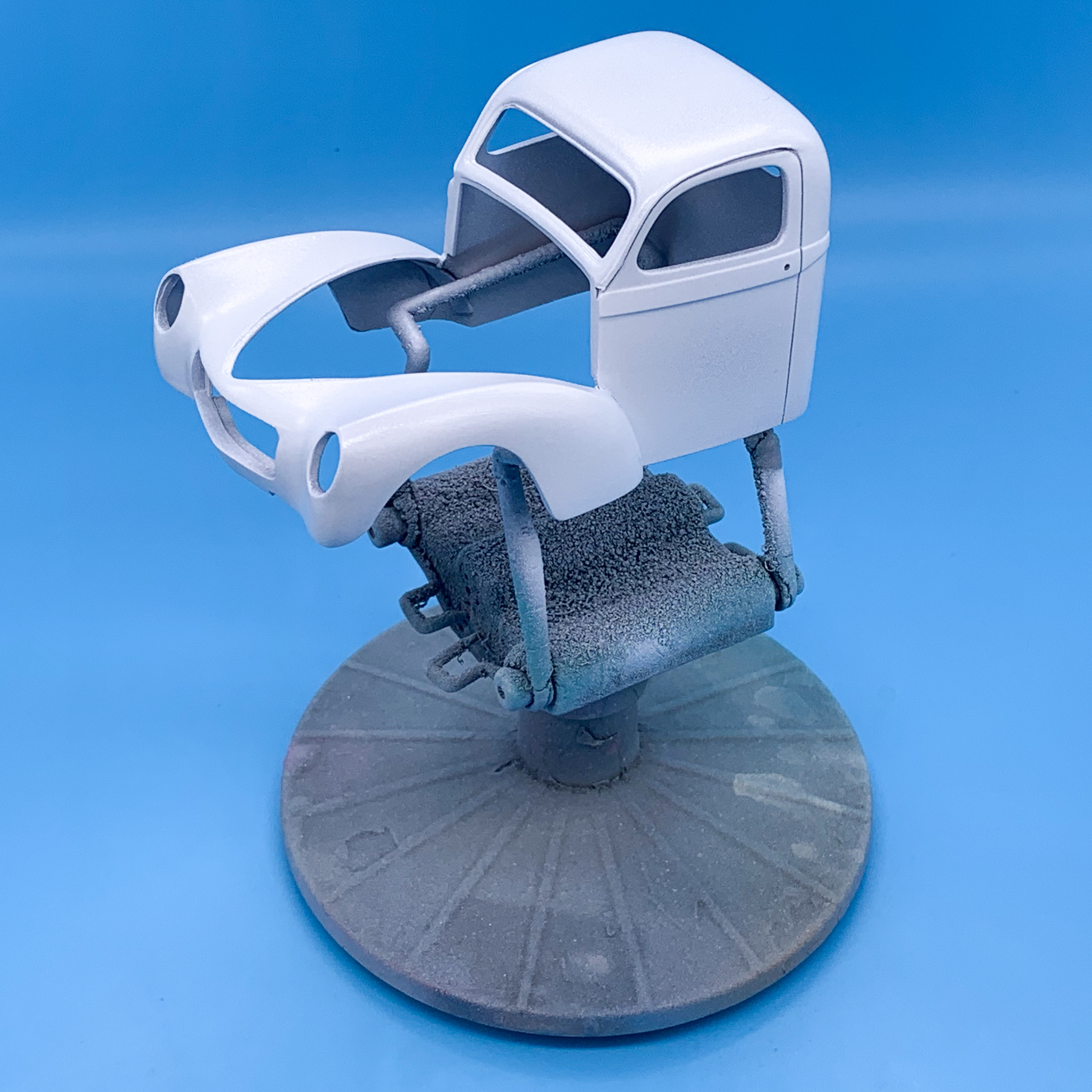

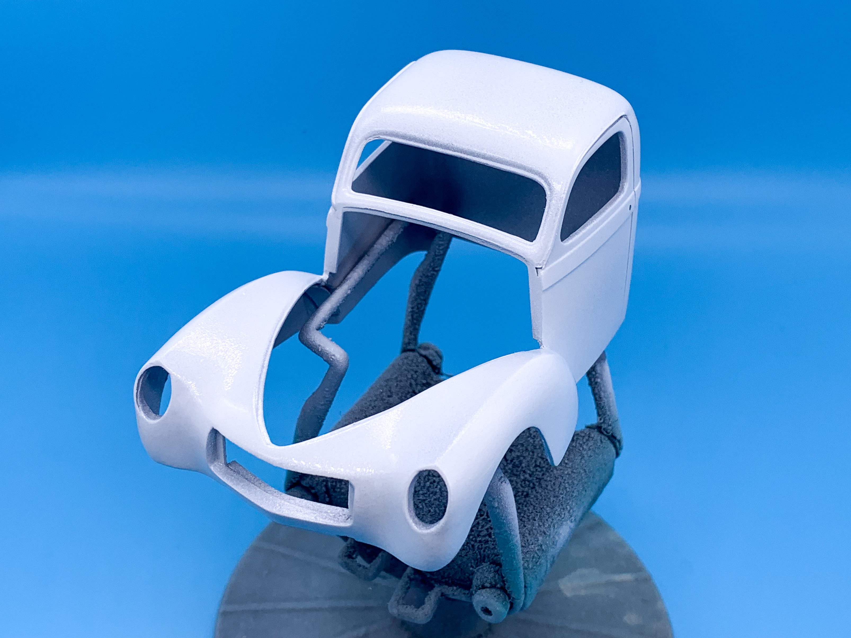

Got the body straight enough to start laying down some paint, so tonight I shot one last thin coat of primer, followed by Createx pure white base, followed by Pearl Ex macropearl:
This thing is actually going to be black with some white graphics, but it’s way easier to paint black over white than white over black…
Not a bunch of progress, but excited to do more on the body next and see if I can hit the idea in my head…more soon!

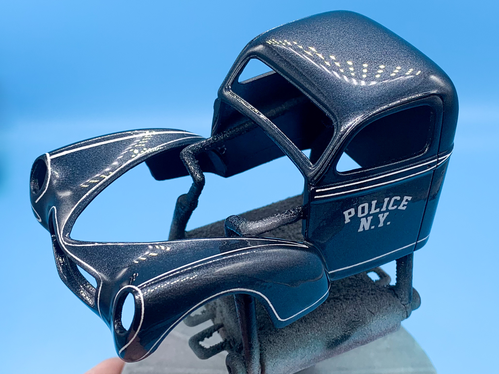

Thanks fellas!  A little more progress…

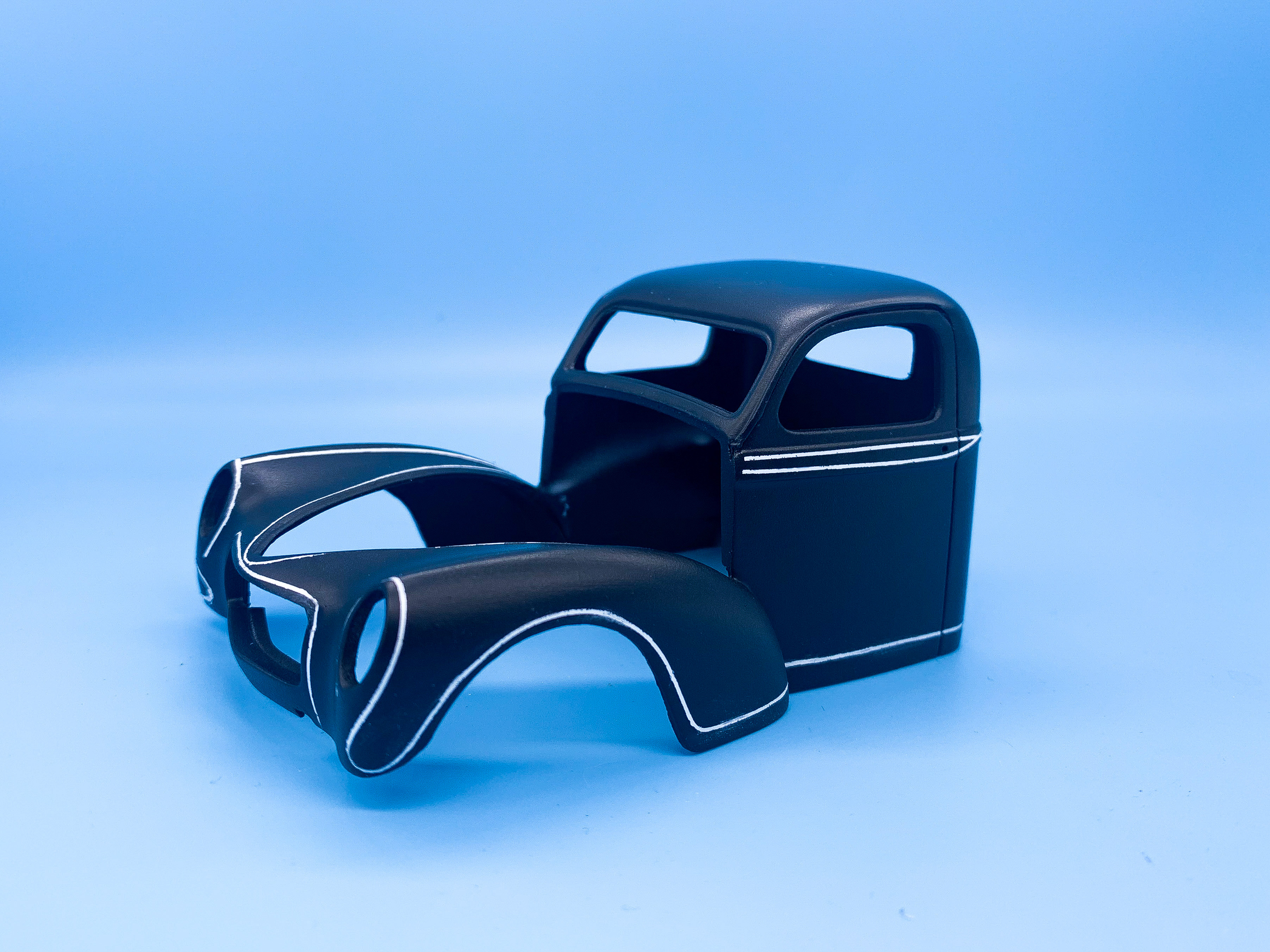

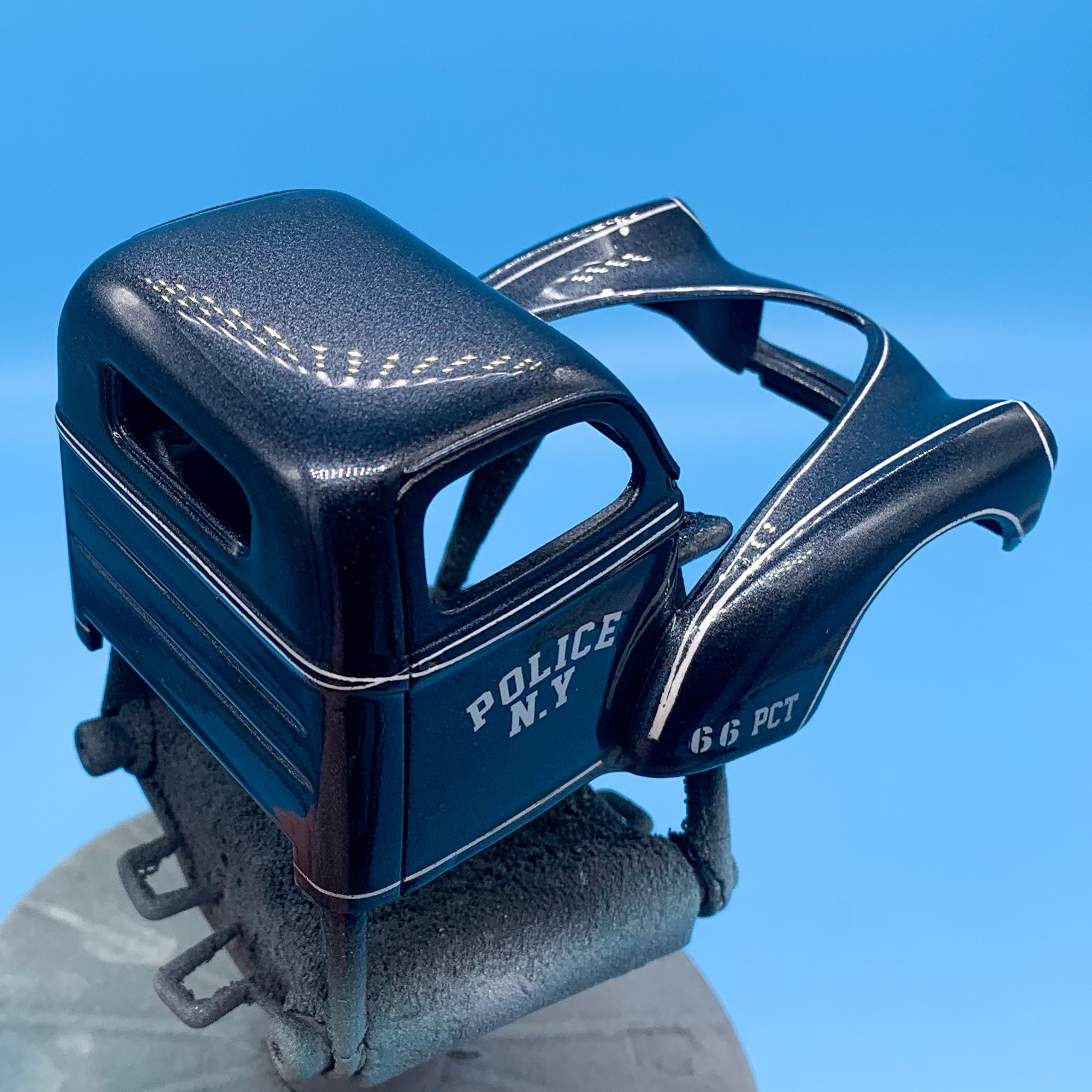

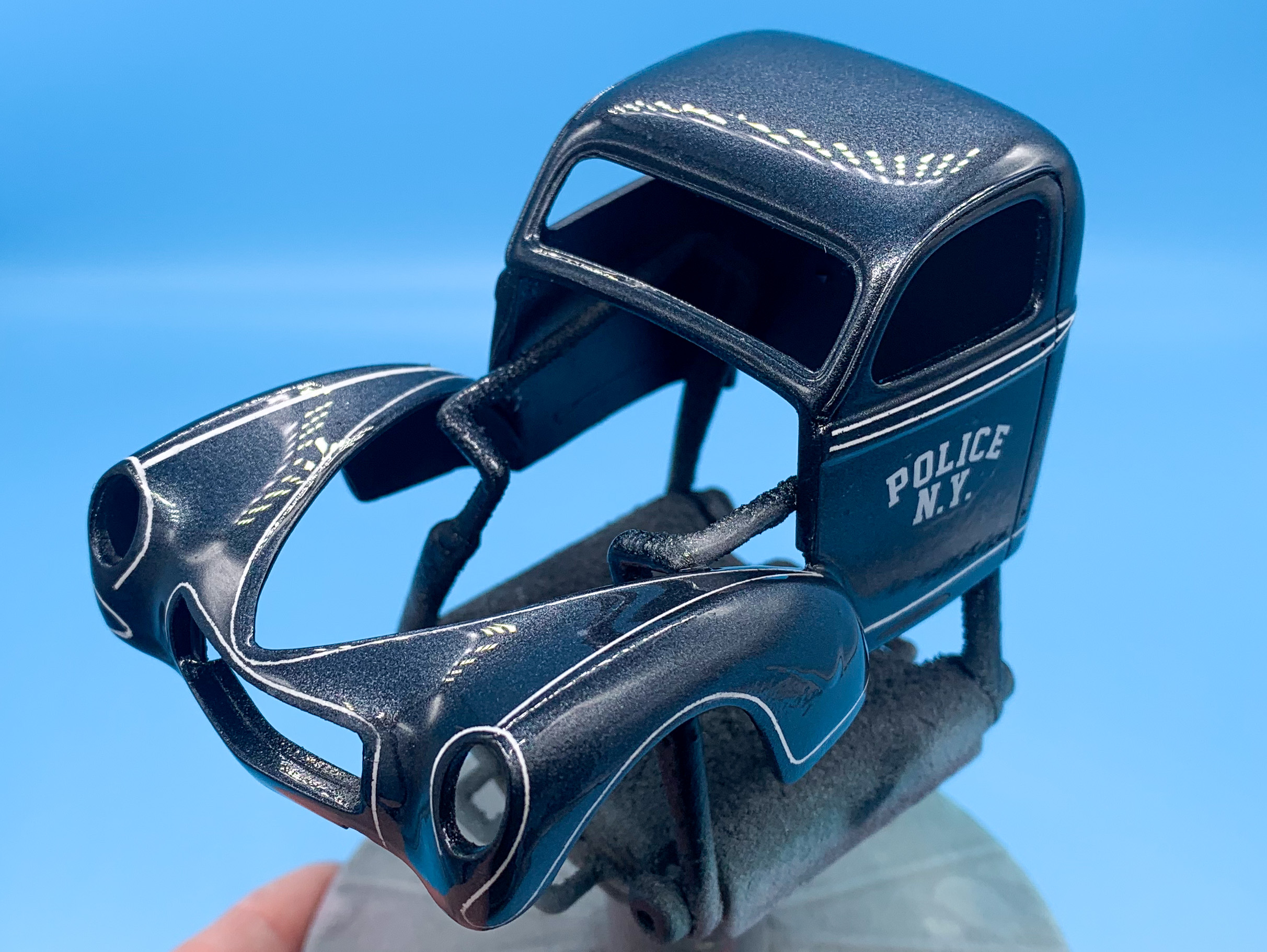

Cut some skinny strips of mask and laid down some simple pinstripes, rather than just have the body all black…

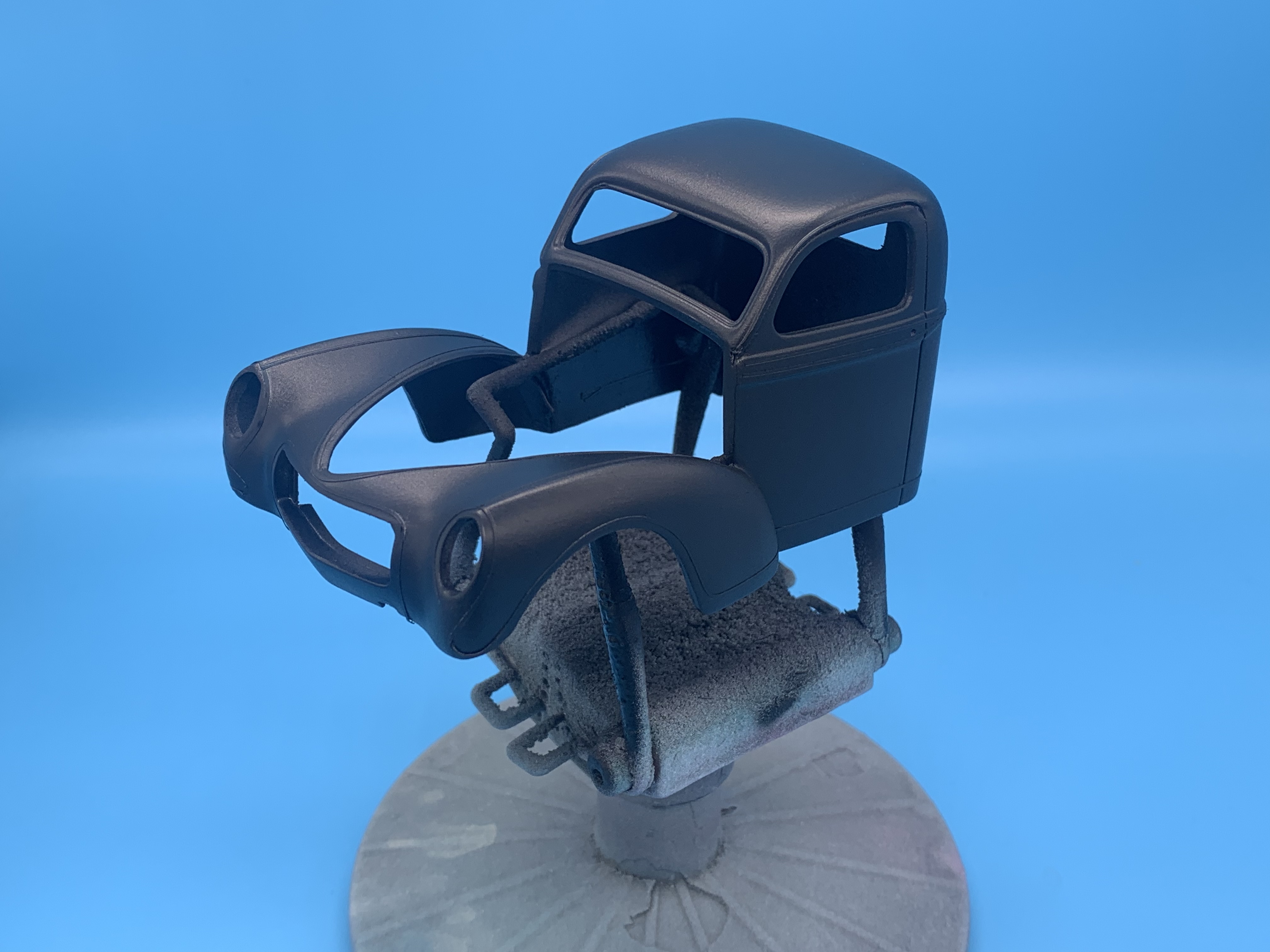

Then shot black:
Then peeled the masks:
Then did some cleanup on the stripes (this mask that I tried isn’t quite sticky enough - need to try a something else next time…) then added a coupla three decals and shot it all with gunmetal Pearl Ex followed by Testors acrylic clear:
Was going for a fantasy vintage NYPD livery - the idea of an illegal street racer in police insignia amused me…

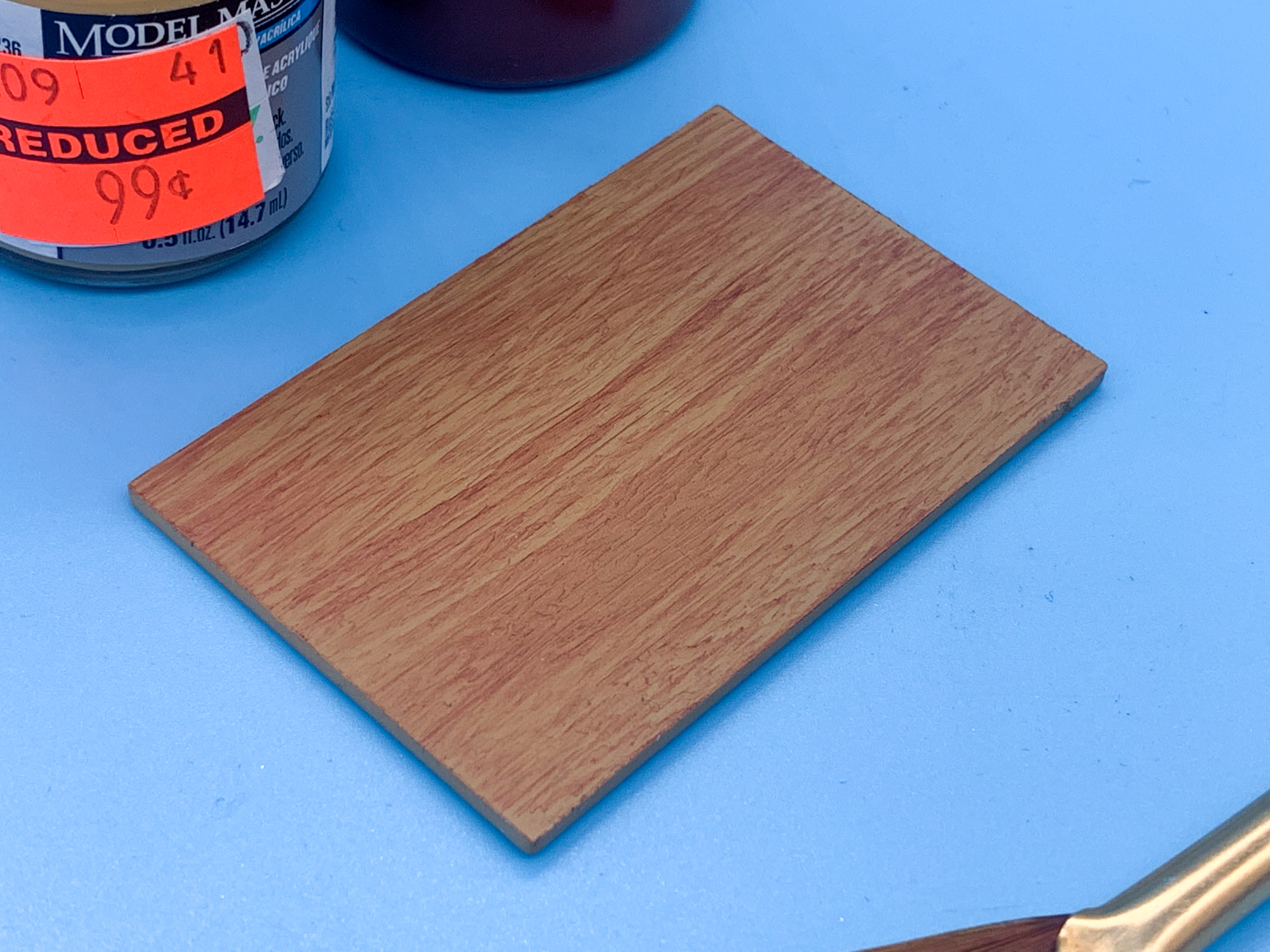

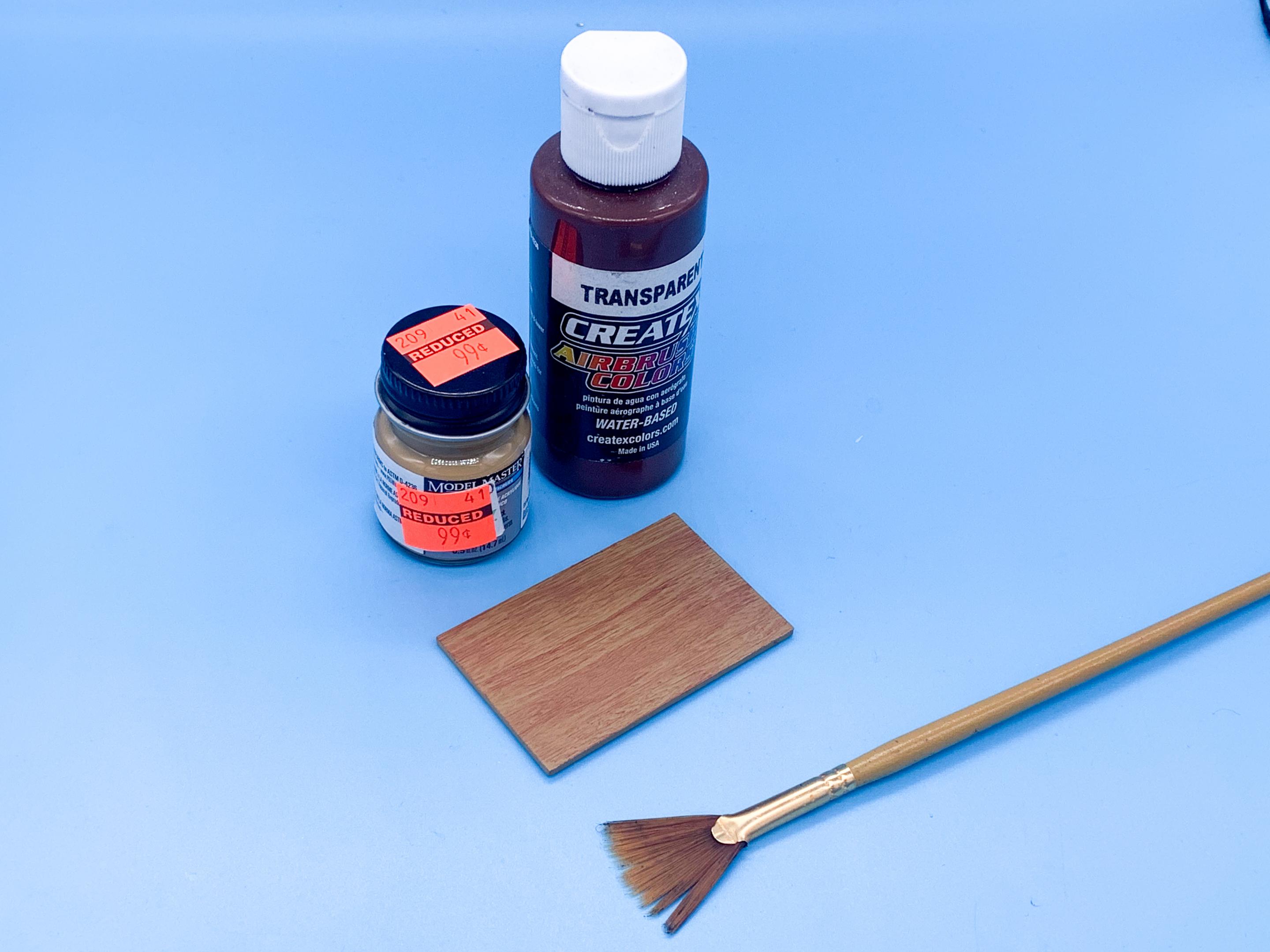

That’s in the dehydrator baking now ready for polishing in a couple of days; meanwhile, painted the bed and started detailing that with some woodgrain:
Got some more painting to do on that bed, but it’s a start…need to start painting the suspension and wheels this afternoon so I can start assembling the frame.  More soon!
