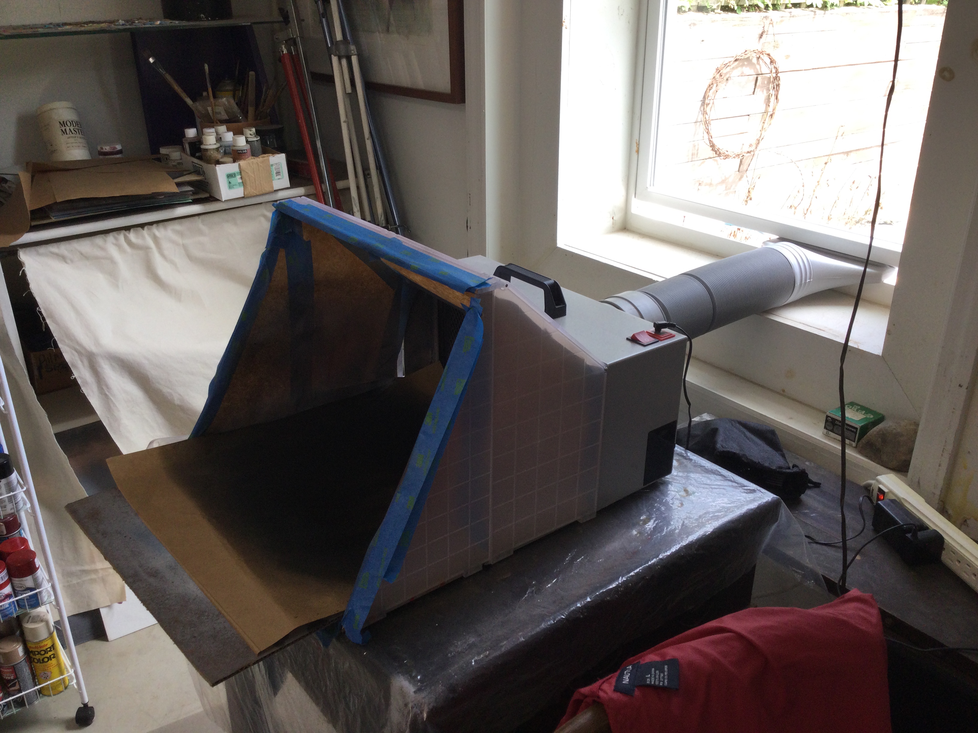

Is there a way you can place a low table in front of the window and run it straight out? I don't have the Pace but this is how mine is set up. You could always move it away from the window when not in use. Just a thought.
  • Like 2

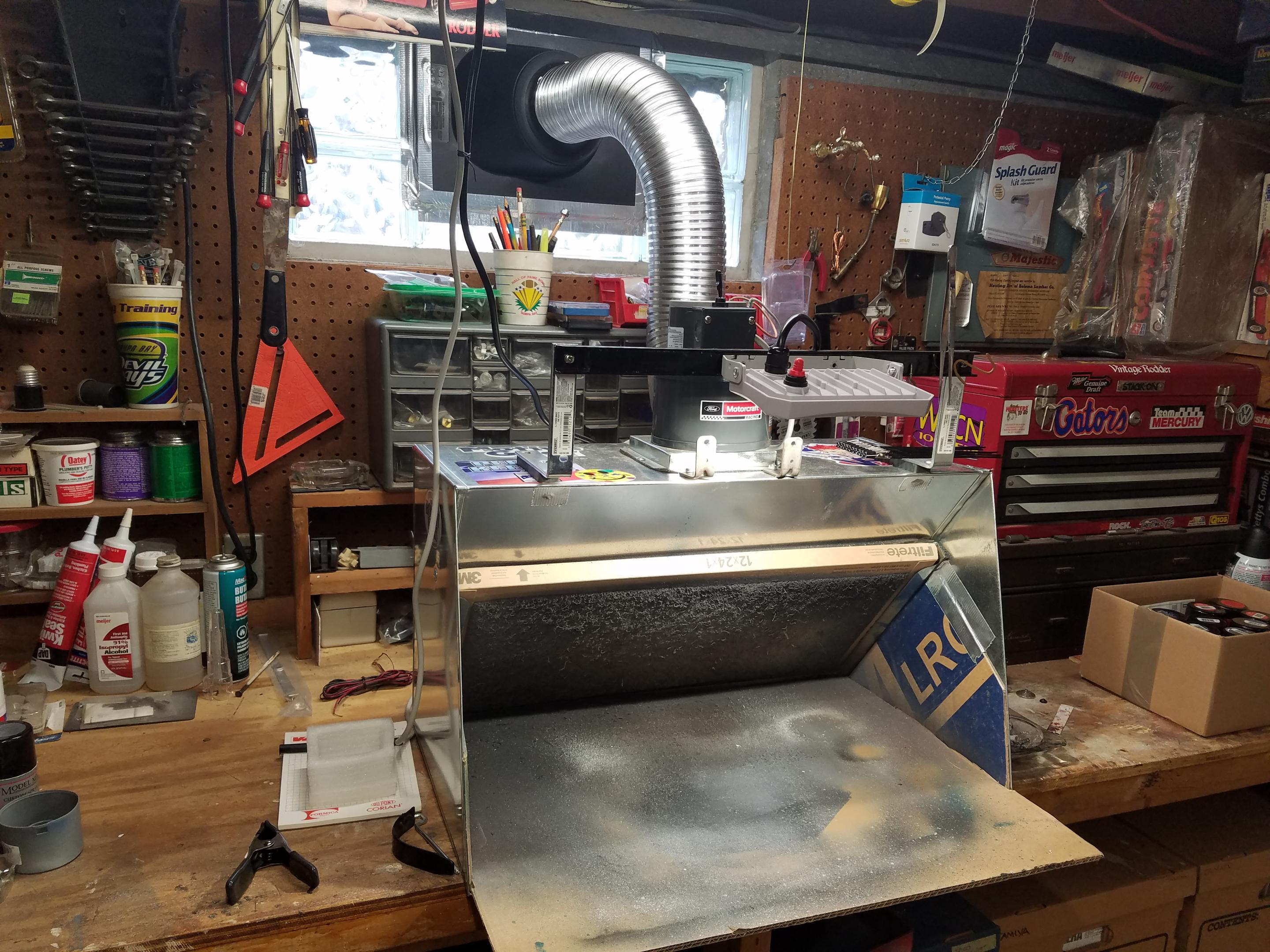

Here is my setup.........
Nice setup.. is that the stock fan?  Yours looks different and more powerful.  When mine gets any paint on the filter it doesn't pull much air at all.
