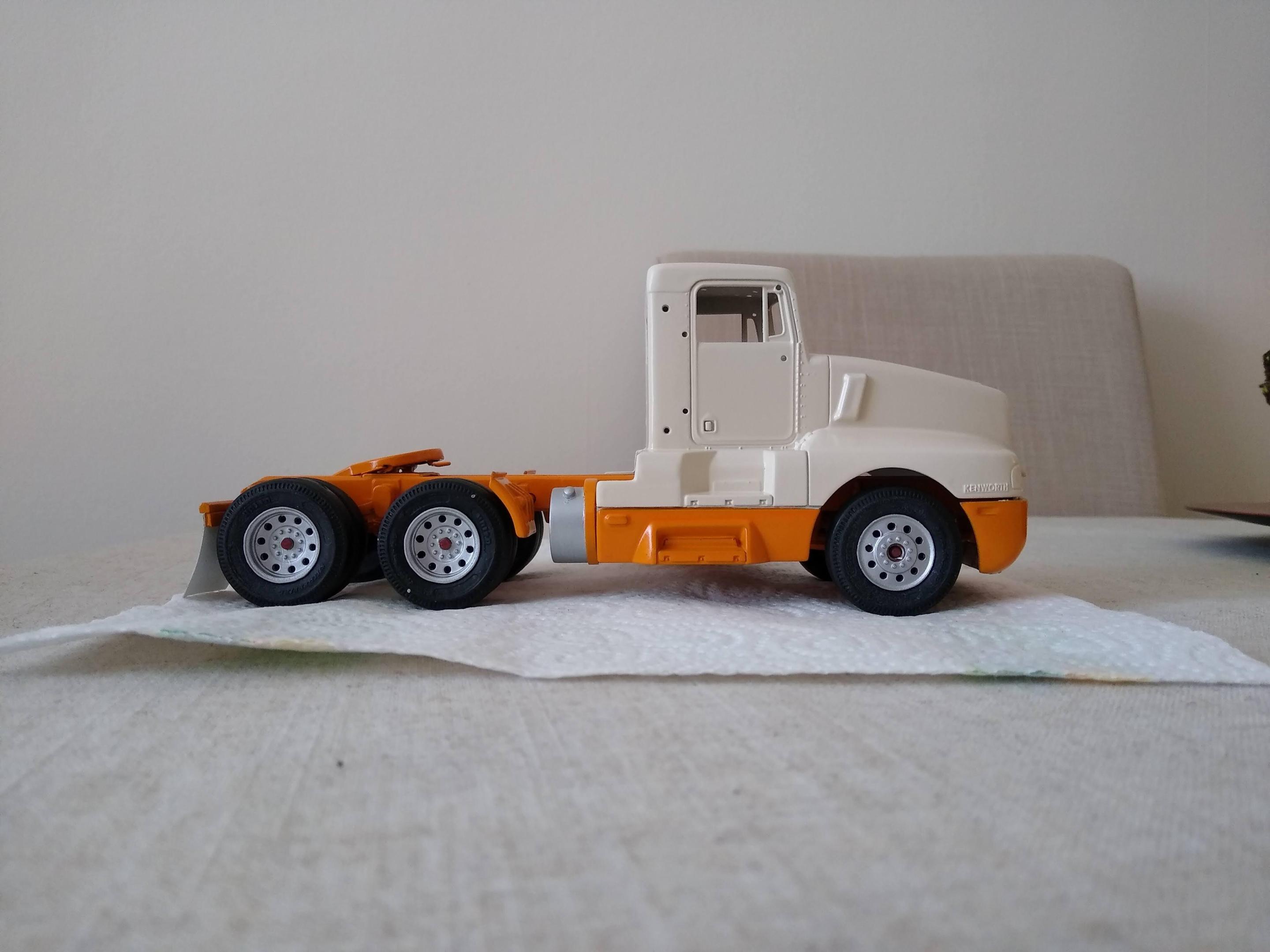

Rockford Posted October 22, 2021 Author Posted October 22, 2021 Well gents, as ever I'm impressed by your experience and willingness to help. Many thanks. I took the advice and used primer and topcoat in the intervals mentioned by the manufacturer, 15 minutes before recoats, applying that to primer and topcoat. The finish is excellent with no adverse reactions and it has enabled me to get the job done in one day before the weather gets too cold or humid to be able to spray paint anything. It used to take me weeks to paint anything. Once again, thanks for your help.
Dpate Posted October 22, 2021 Posted October 22, 2021 On 10/22/2021 at 2:51 PM, Rockford said: Well gents, as ever I'm impressed by your experience and willingness to help. Many thanks. I took the advice and used primer and topcoat in the intervals mentioned by the manufacturer, 15 minutes before recoats, applying that to primer and topcoat. The finish is excellent with no adverse reactions and it has enabled me to get the job done in one day before the weather gets too cold or humid to be able to spray paint anything. It used to take me weeks to paint anything. Once again, thanks for your help. Expand Looks good man.
