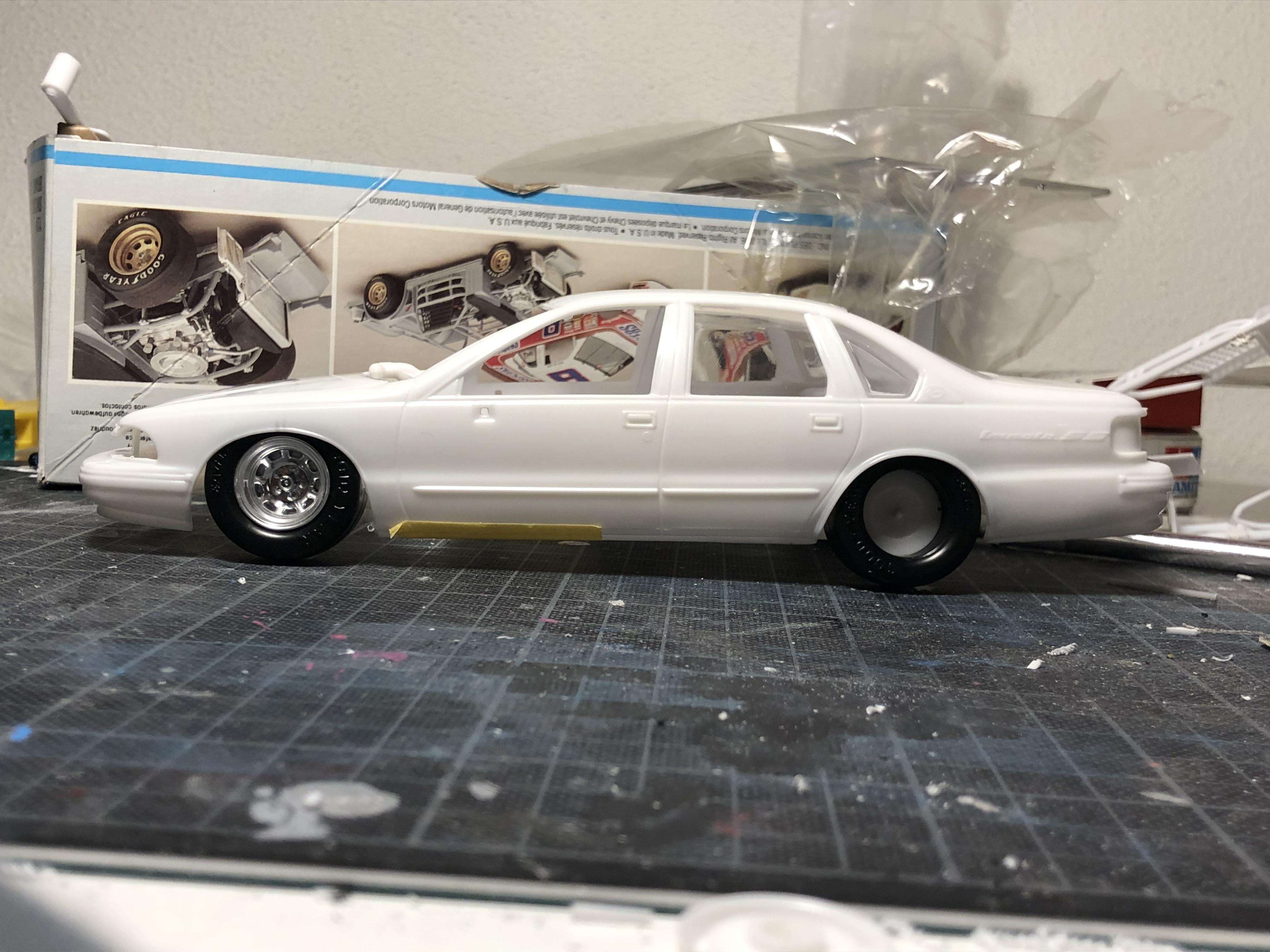

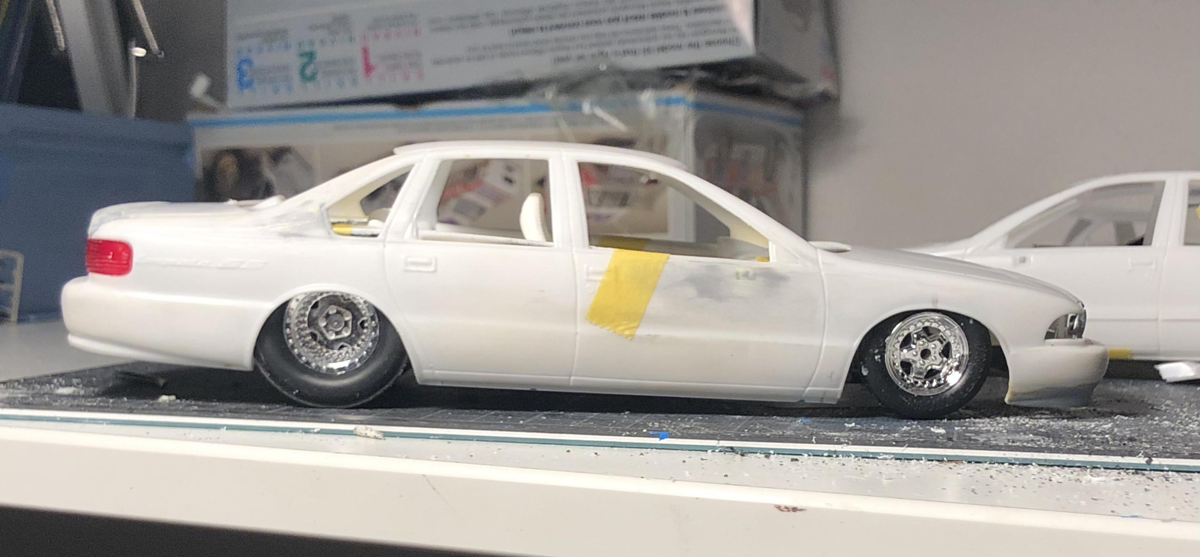

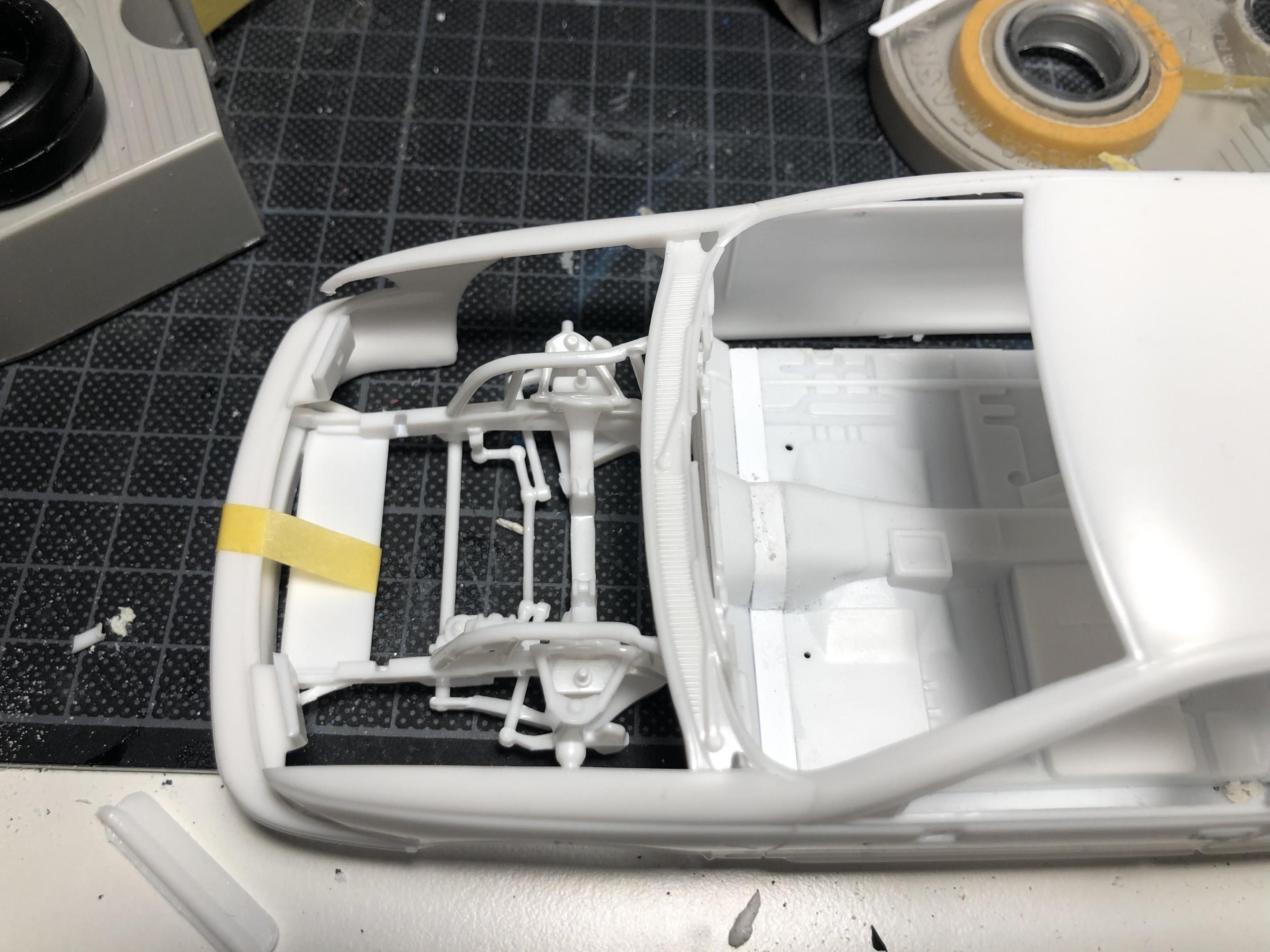

While working on the PS Impala and going through my chassis for a front end I noticed how close a monogram nascar chassi was in wheel base. So now when I found a Snickers nascar on a auction site I took the opportunity to mock up the chassi to get it to sit where I wanted it to.
I do this since I have two sets of bodies thanks to an forum member ?
The difference in wheel base was so minor so I slid the rear axle a bit backwards, about 1,5 mm, on the truckarms and it seems to do the trick. Next issue is the track is to wide. And I want to keep it without flairs, so some missing of the wheels are needed. Except for that and the firewall being far back in the car leaving the driving position to be pushed back, which is ok. New dash board needs to be made and a new front cage. Also engine have to come forward.  We will se if I do anything on this I just had to get it out of my mind ?
I figure i can move the firewall forward 4mm really easy and move the motor as well so I will do that.
Stock wheel base. Front wheels are to far back when rears are centered.
altered wheel base.7F7BE1B7-AD67-4BCD-A8E4-306F574798FD.thumb.jpeg.9d8f297947b17438840f76ee453f11cb.jpeg

Surprising how well the Nascar chassis fits, that will cut down on the amount of scratch building.. Looking forward to seeing how you fully adapt the chassis into the build.
Thanks, yes will se if I use the other one for my PS build, the interior is the issue then.. will have to think about that but for the second impala it’s ideal.

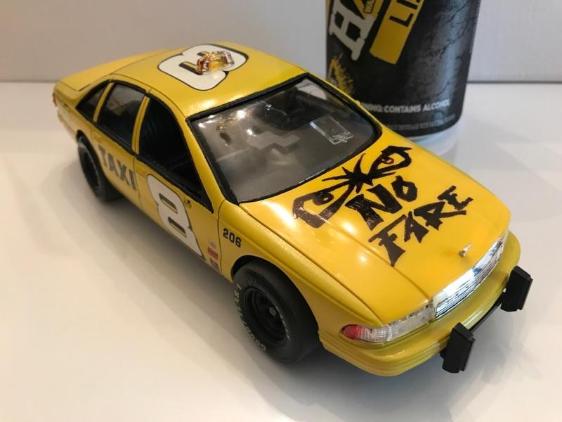

Looking good ? I think she would look good Taxi Cab Yellow, Just sayin... ? here is my buddy's 24hrs of Lemons challenge. I collect real cars and (buy sell and trade) this guy wanted to trade me for a Nova I had a few years ago for a 96 Impala SS it was Awesome but the deal didn't work out as far as value but I would've loved to own it.
  • Like 3
Thanks! Thats a sweet build, I like the idea and concept of lemons, have seen Roadkill on that event several times ?  Nice, thats a nice hobby/ocupation! I have traded allot of cars but i am no collector since i only have 2 at the time!

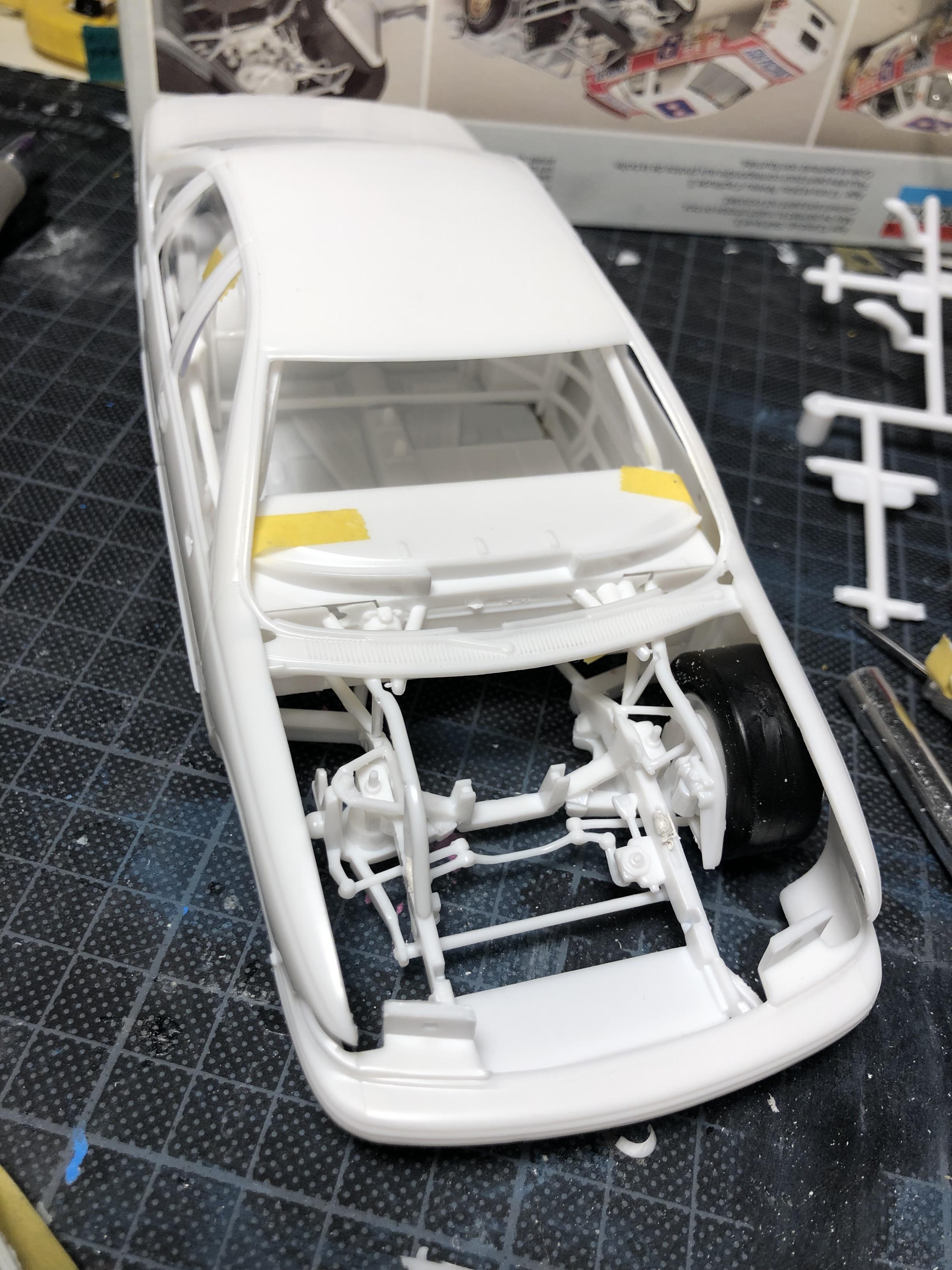

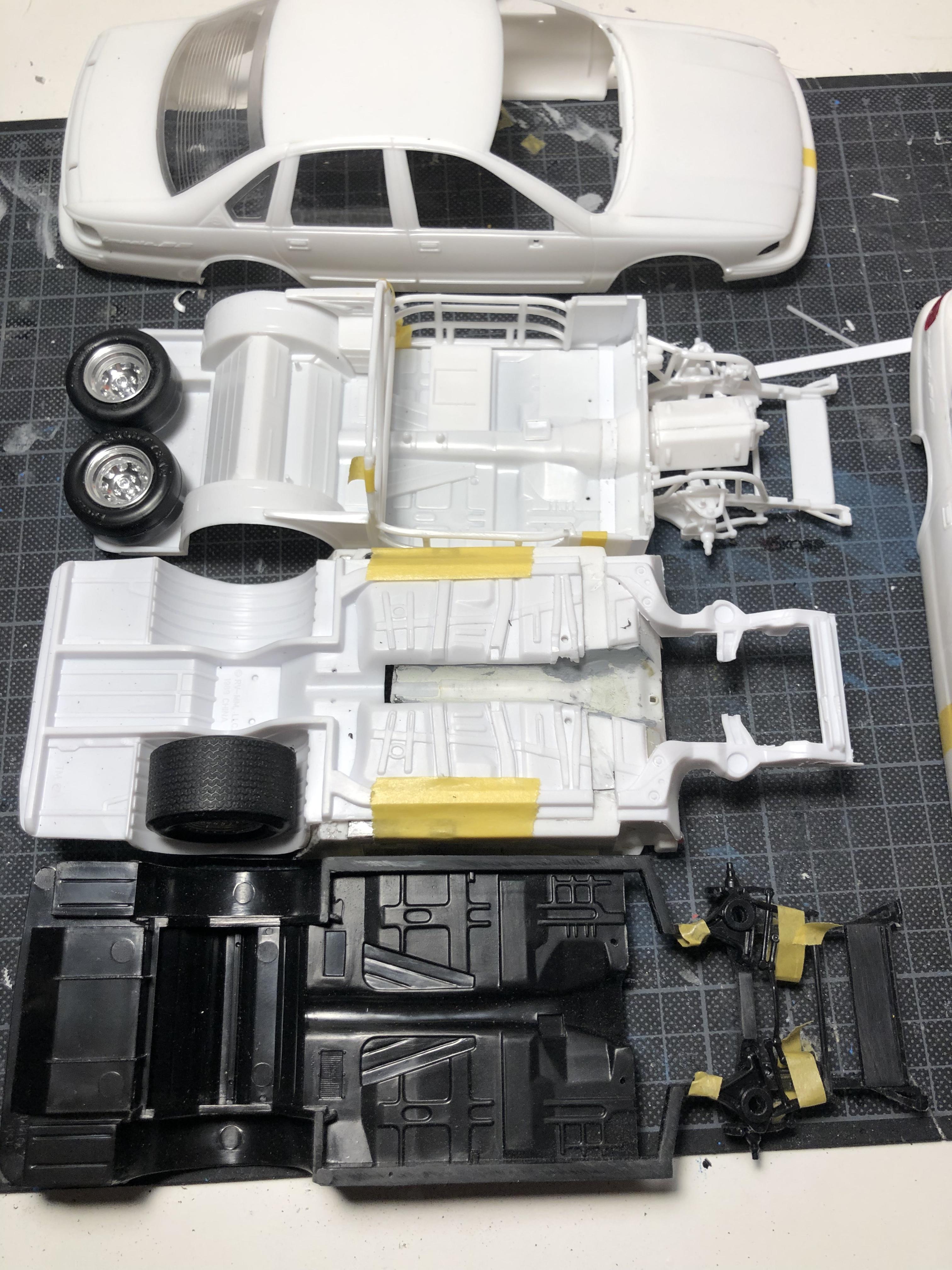

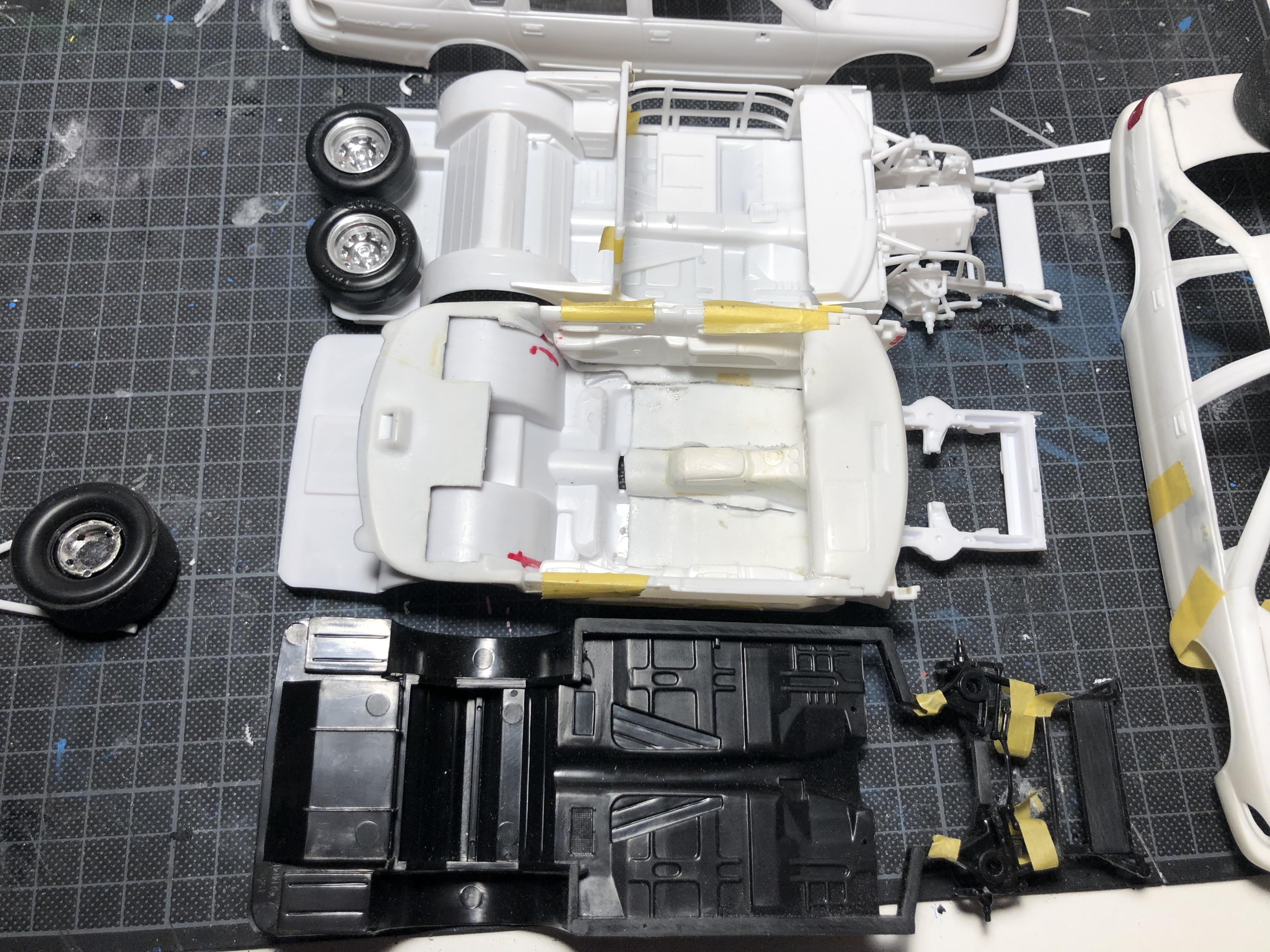

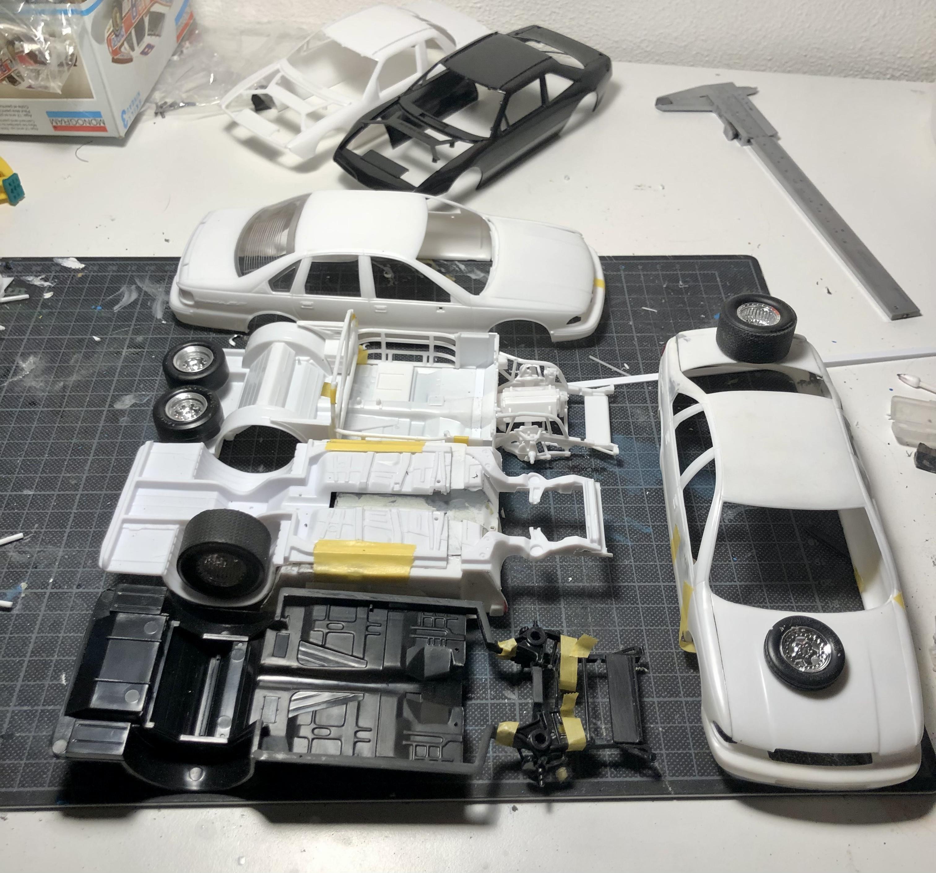

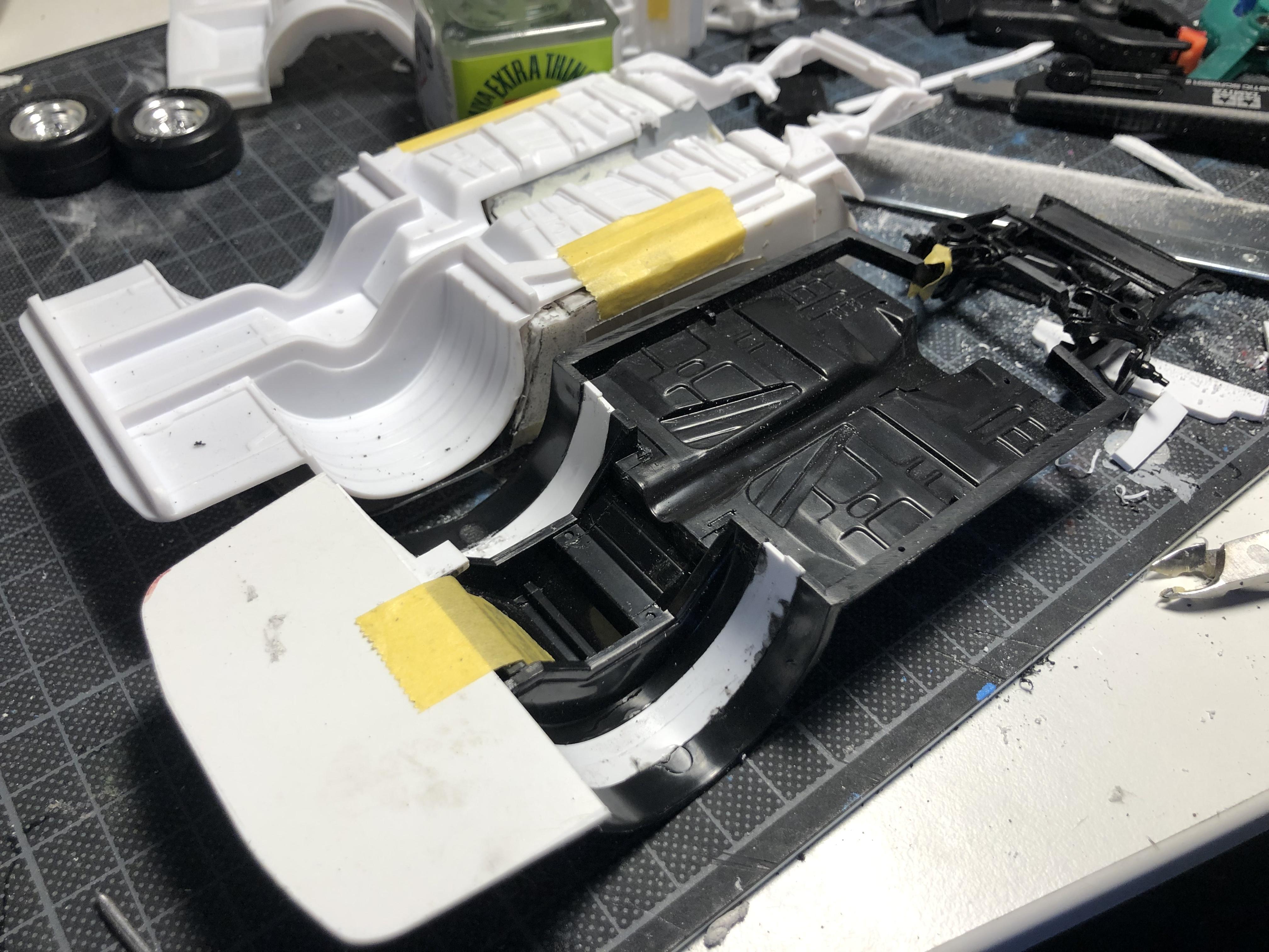

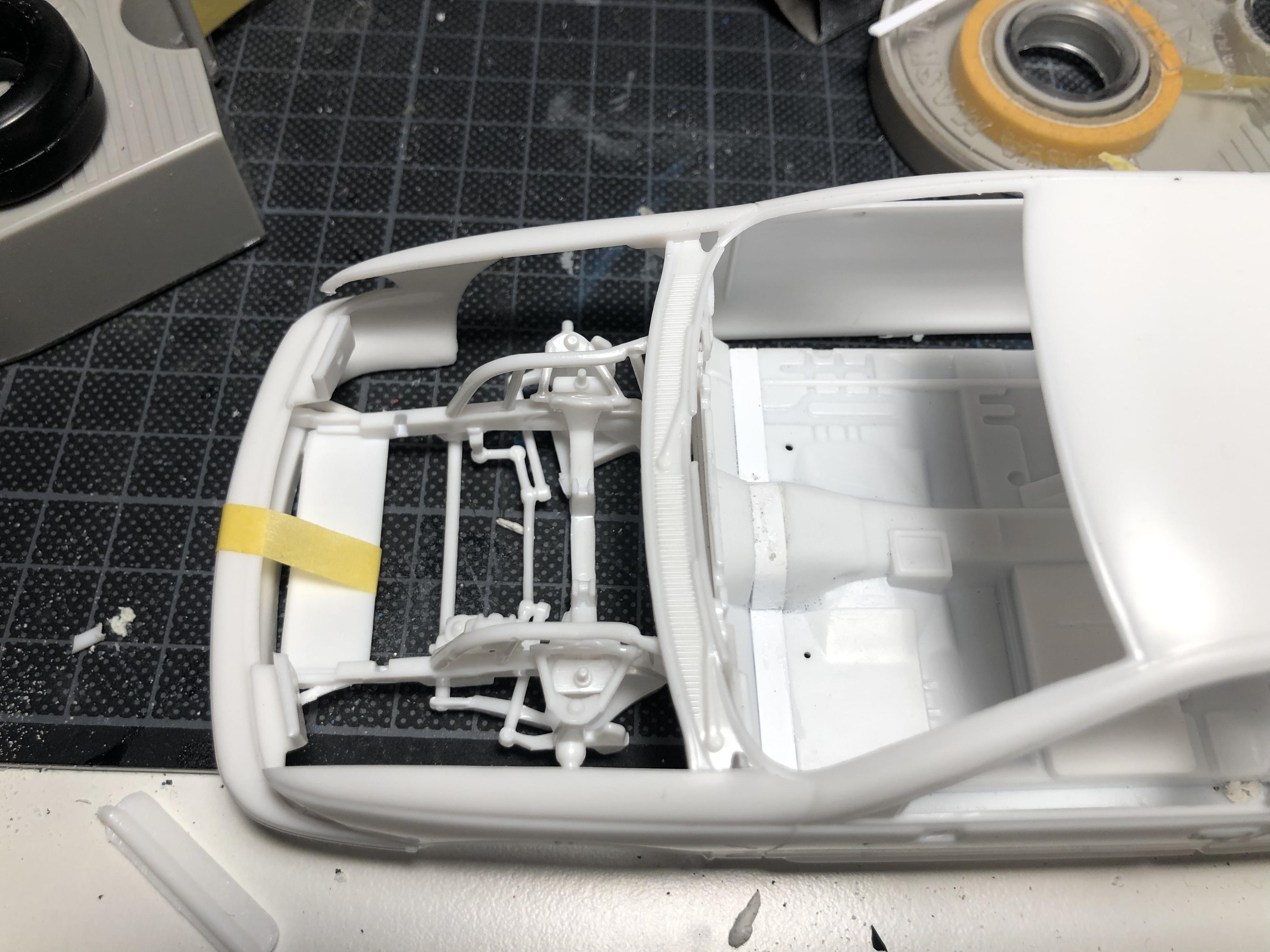

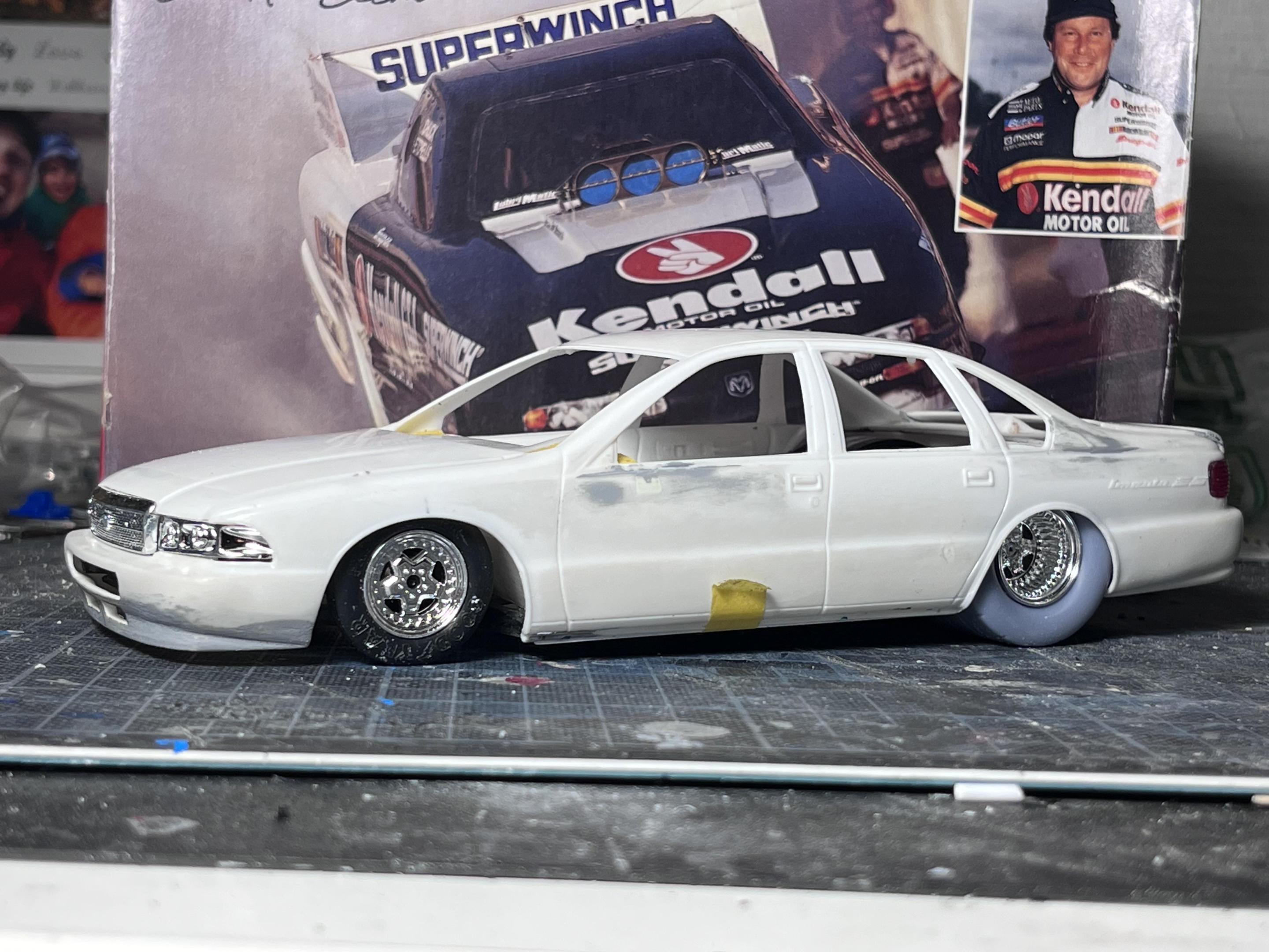

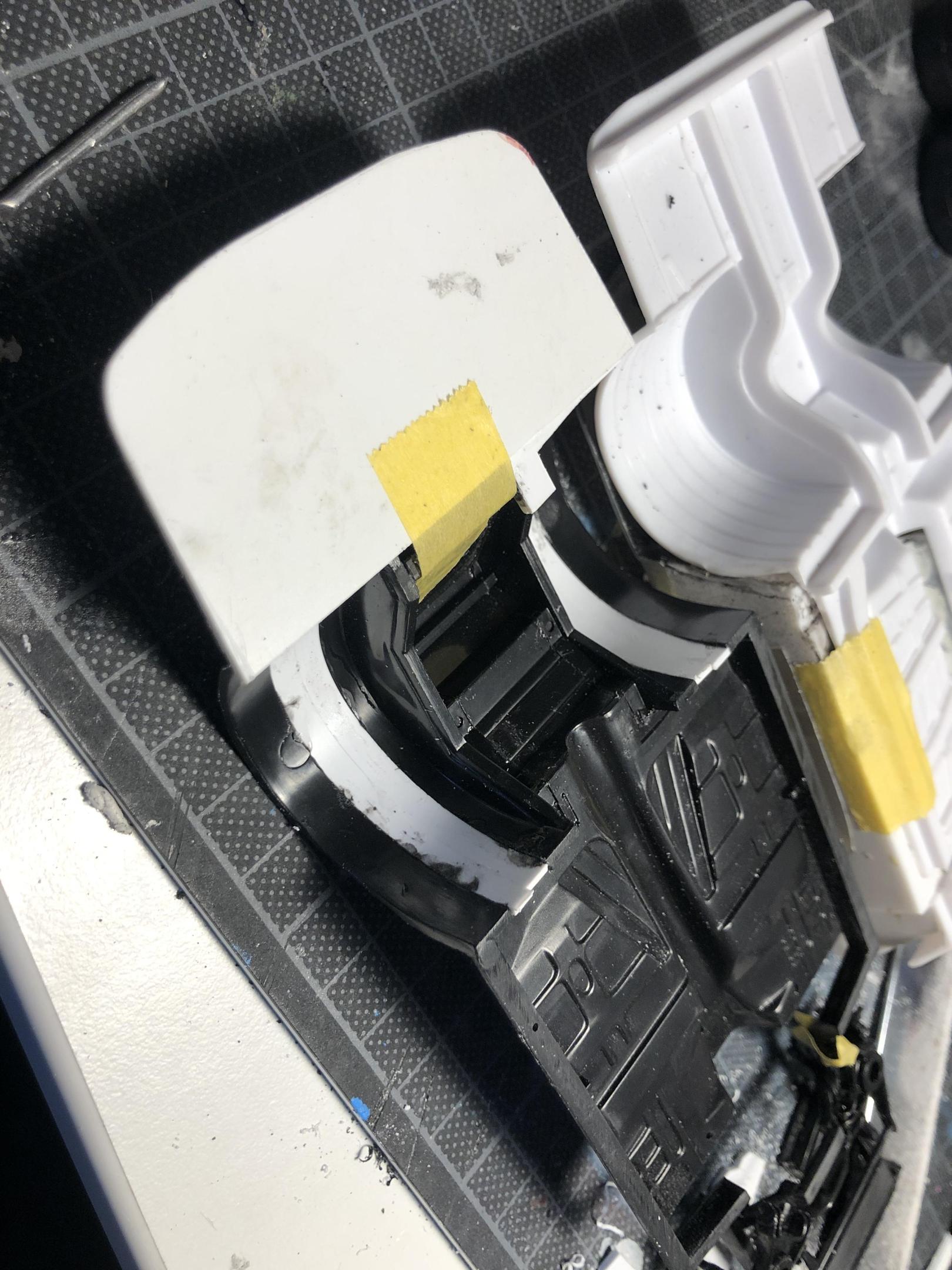

So I have been playing around with two monogram nascars today. One will be the Track Day(TD/TA) Impala and the other one will be the Pro Street(PS) Impala.. so this will be a twin build and I don’t expect them to be built within 2022.  But we will se, allot can change.
The white TD chassi have gotten the firewall moved forward 4mm with styrene strips. picture #1-2
This sorted almost al problems. Still far back compared to where the window sit but can’t have it more forward due to tire clearance. In comparison with the stock interior tub it looks good, picture #3
#1
#2
#3

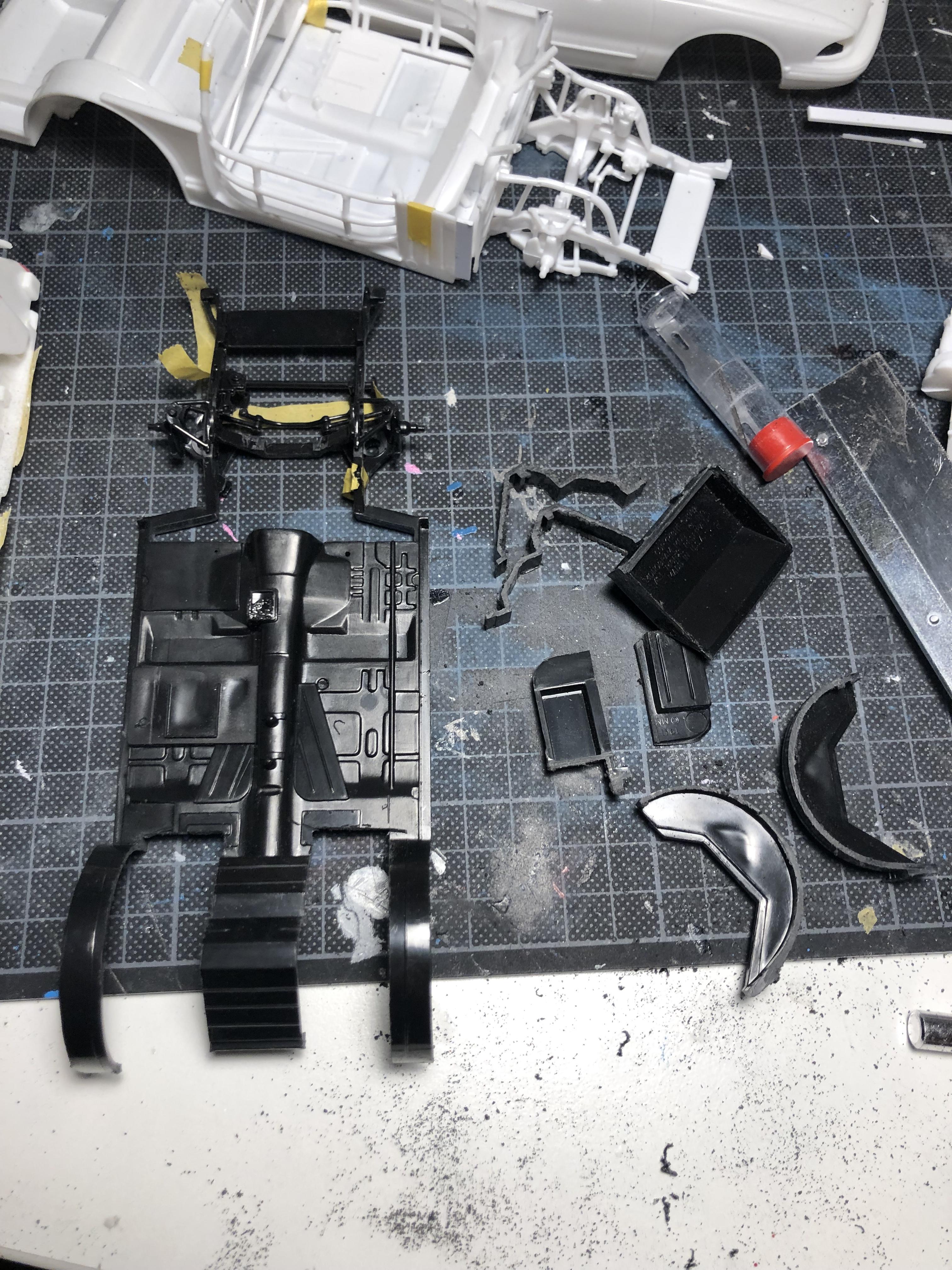

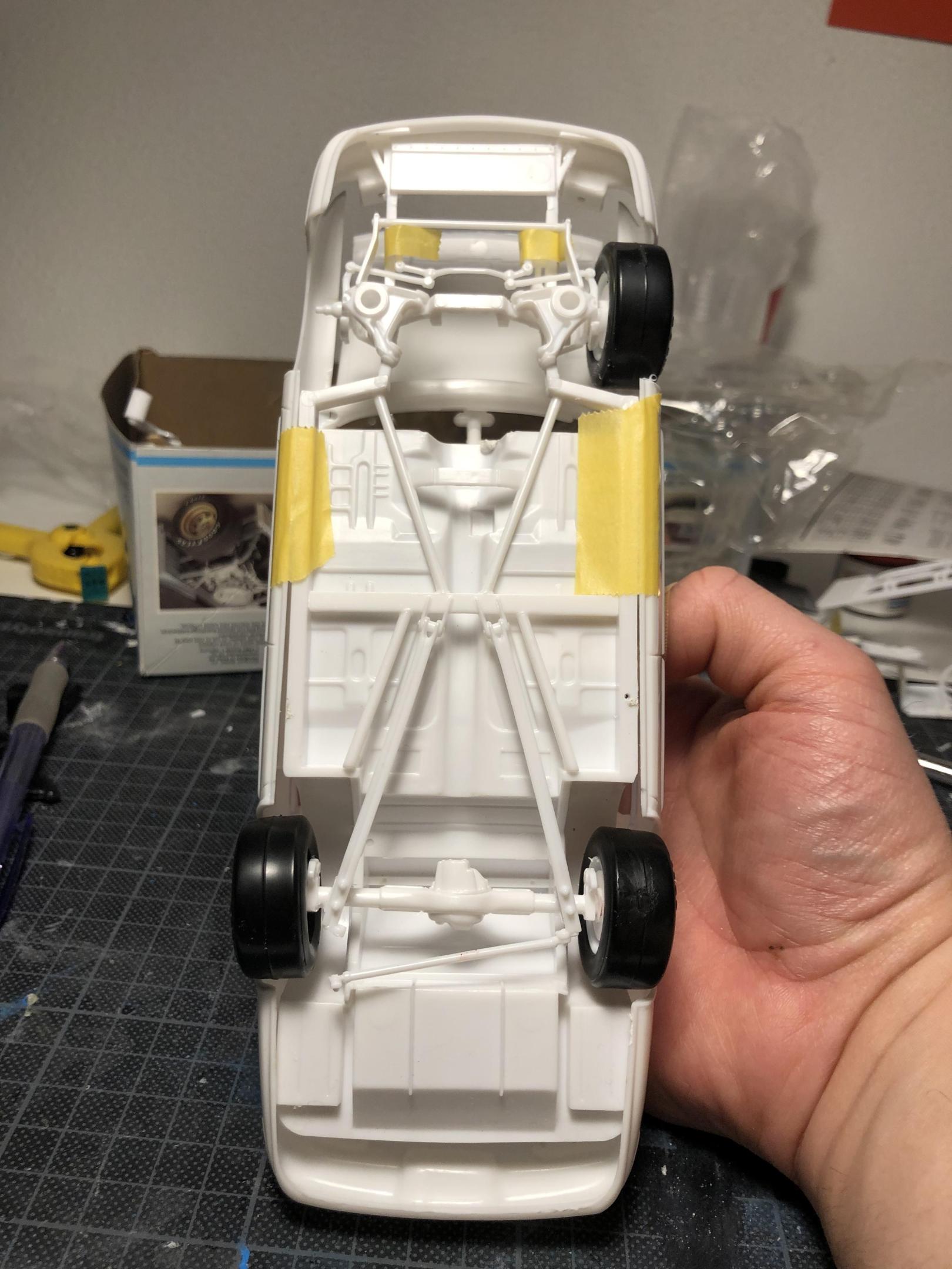

The PS chassi will be cut and merged with the black nascar chassi, that have been striped of its front coil springs to be able to run coilovers. Will have to remove the floor of the original interior tub but no hard feelings there. #4
#4848A1337-77F5-4567-BAE7-8DF0B1C55212.thumb.jpeg.7ca9c88ffb3448d1fc6168eb5a12a45d.jpeg
Here both the projects can be seen, the all original body on top, thanks @stitchdup For the extra set of parts! I found a extra set of headlights so I have two complete body’s now. Strangely I found a set of ‘96 impala lights on the same tree as parts that seem to belong to a 57 Chevy, a strange parts pack?
And the customized body to the right. And far top is the nascars that happily donated their chassis?

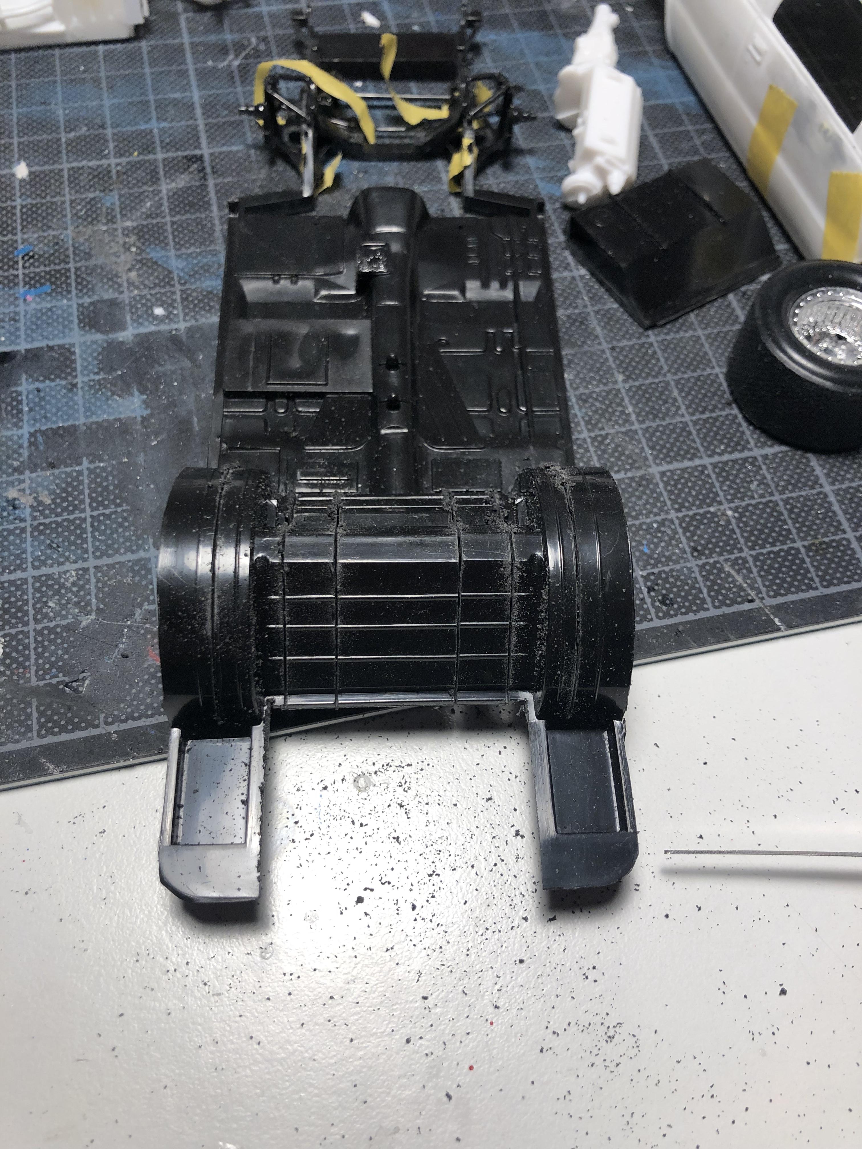

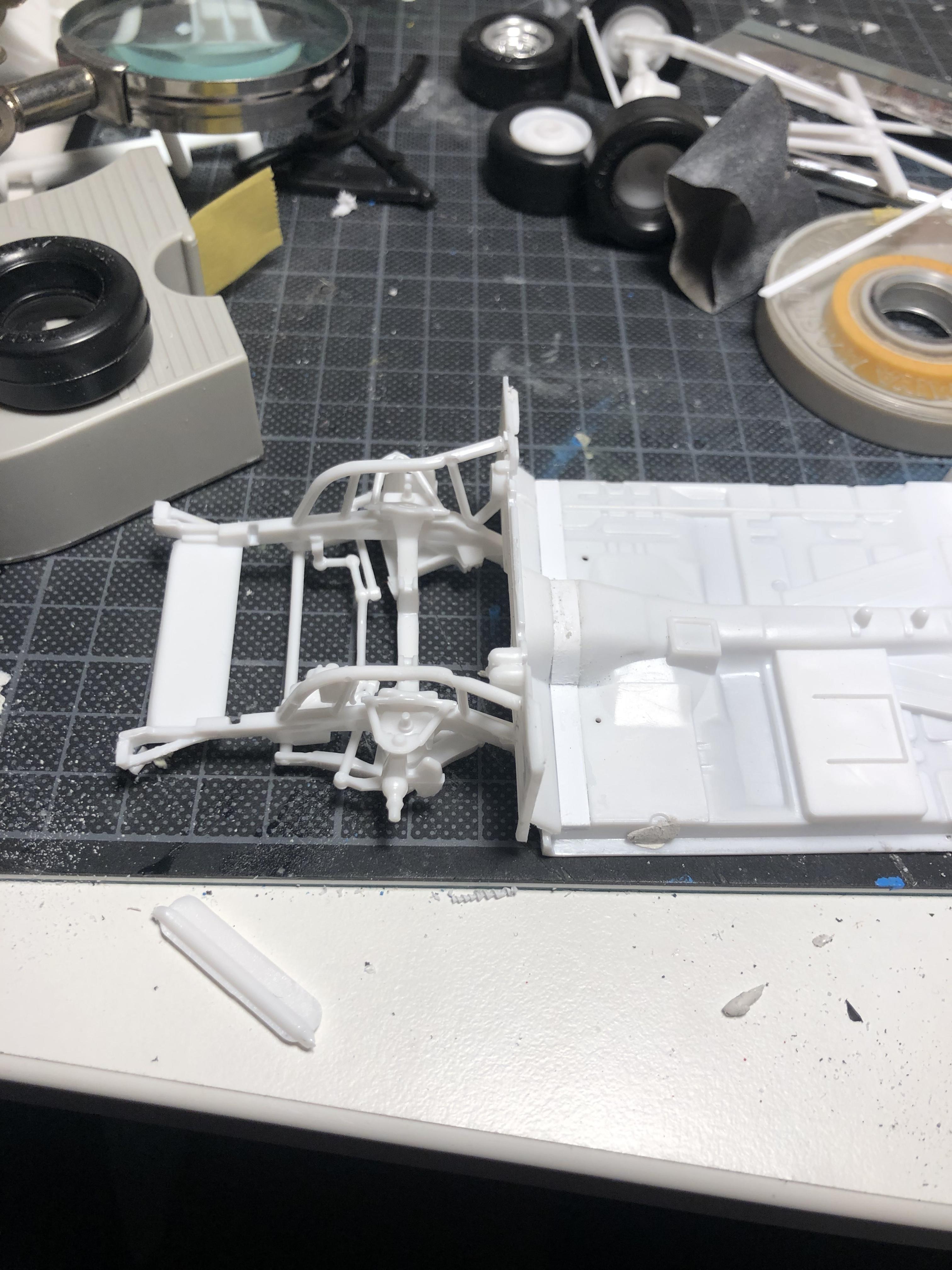

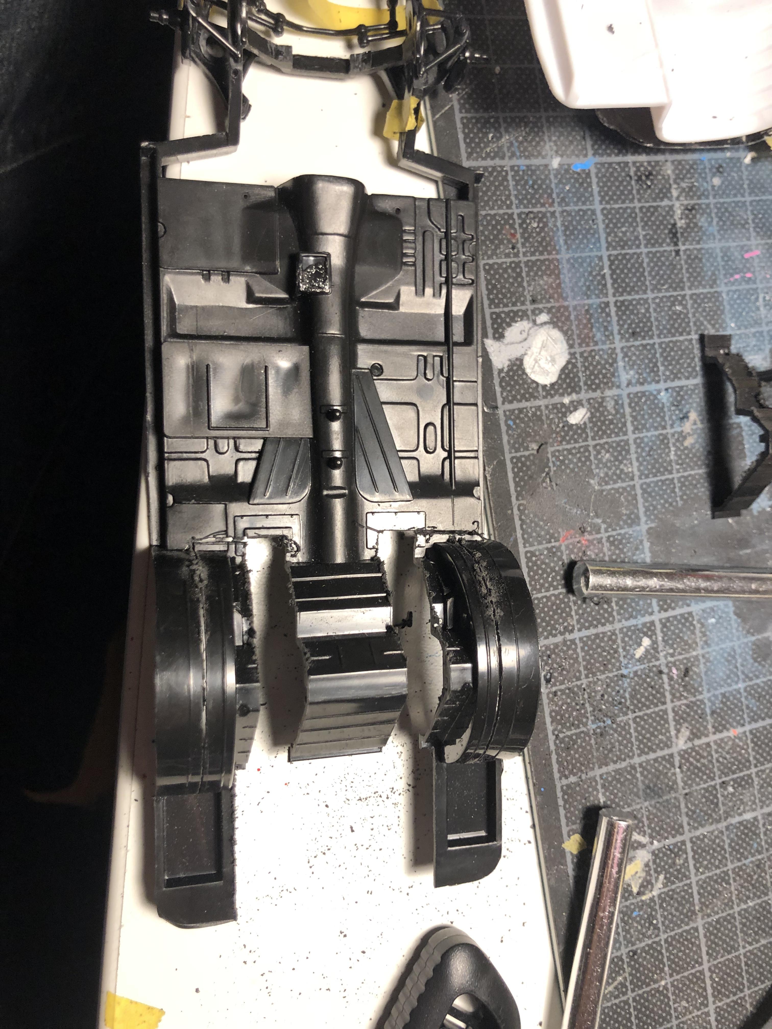

I changed my plan and tubed by black chassis, I thought it was a good first subject since the chassi is so angular. Turned out ok but I wish I had a 8mm strip instead of two 4mm. Also missed a cut early on which made for a sloppy cut late in the process which forces me for some more patch Jobb. Over all, came out good, will se if the interior and rear seats still fit. ?
  • Like 1

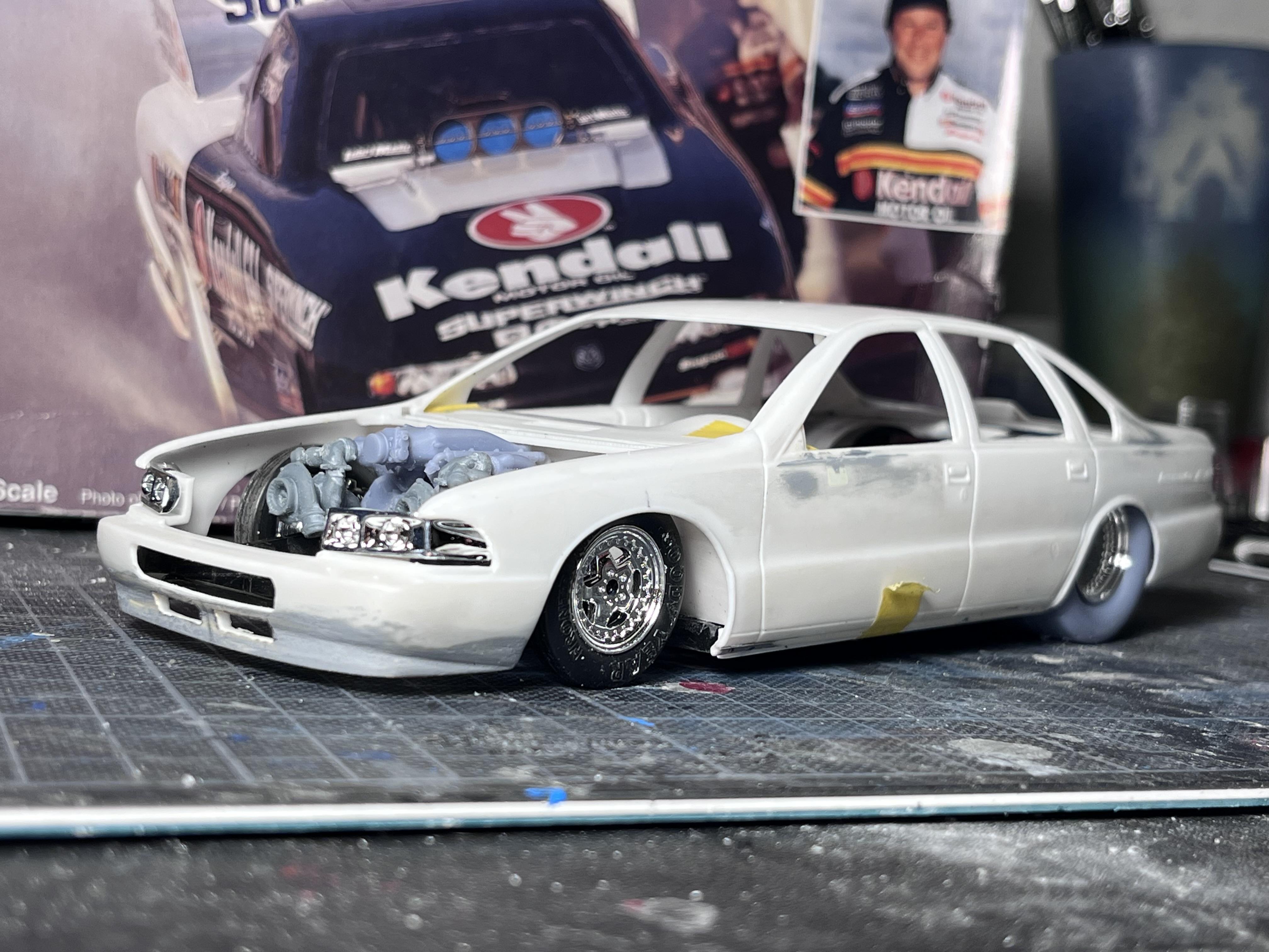

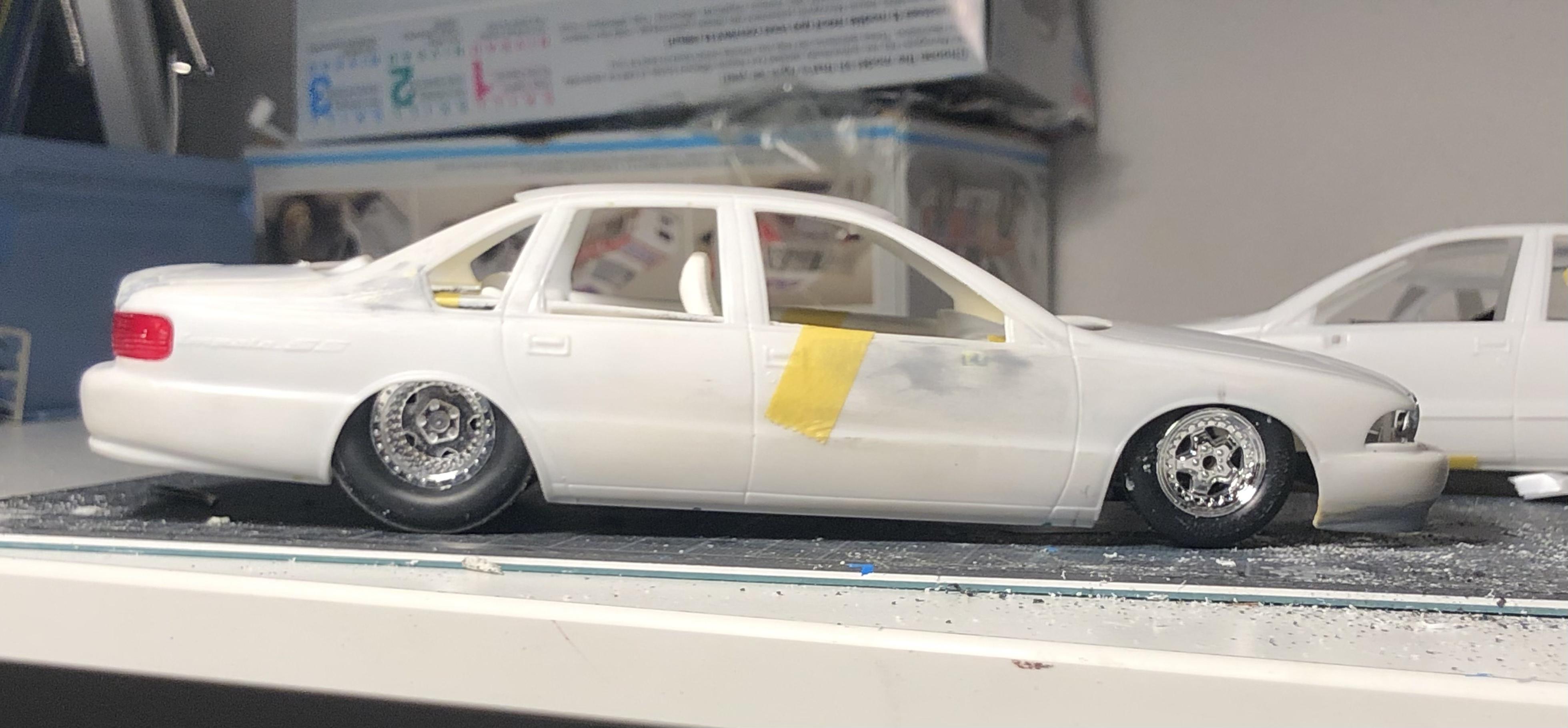

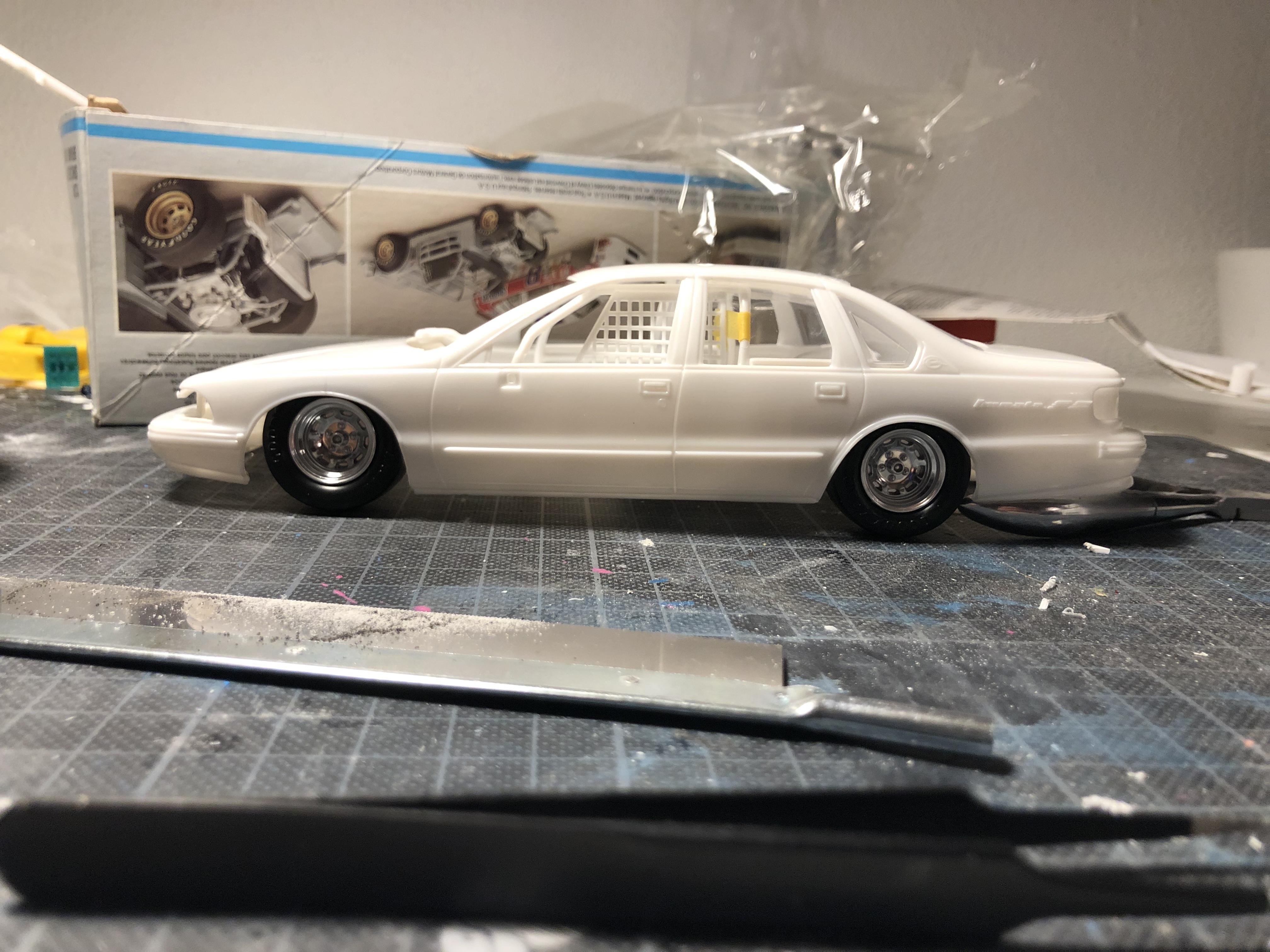

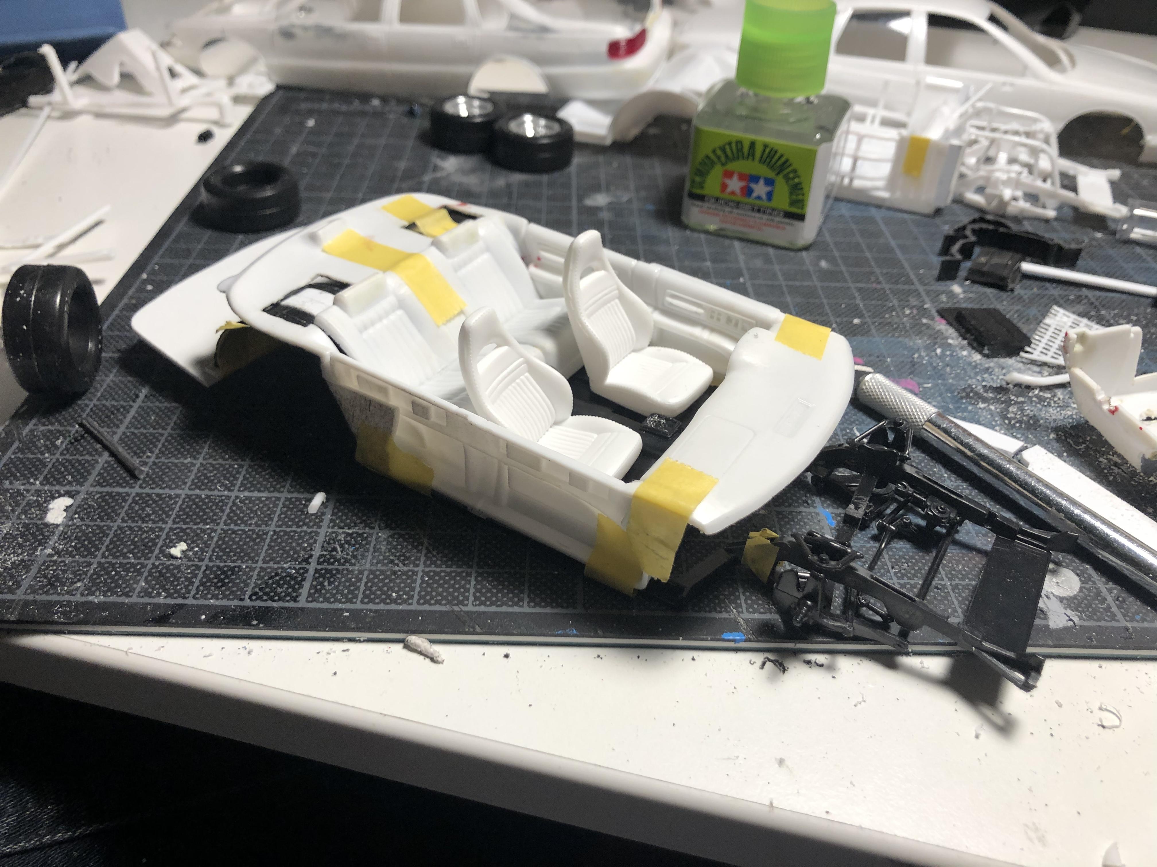

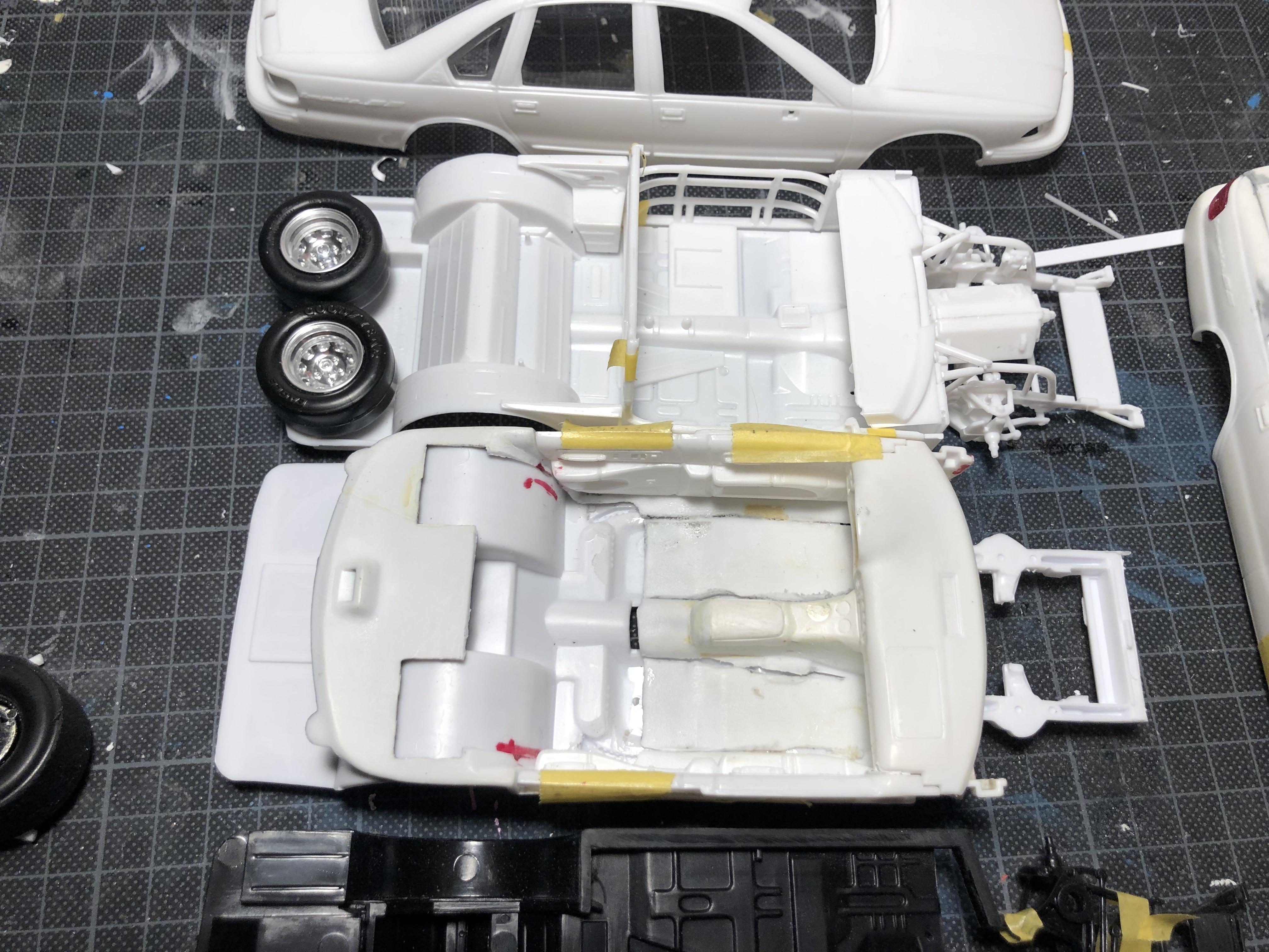

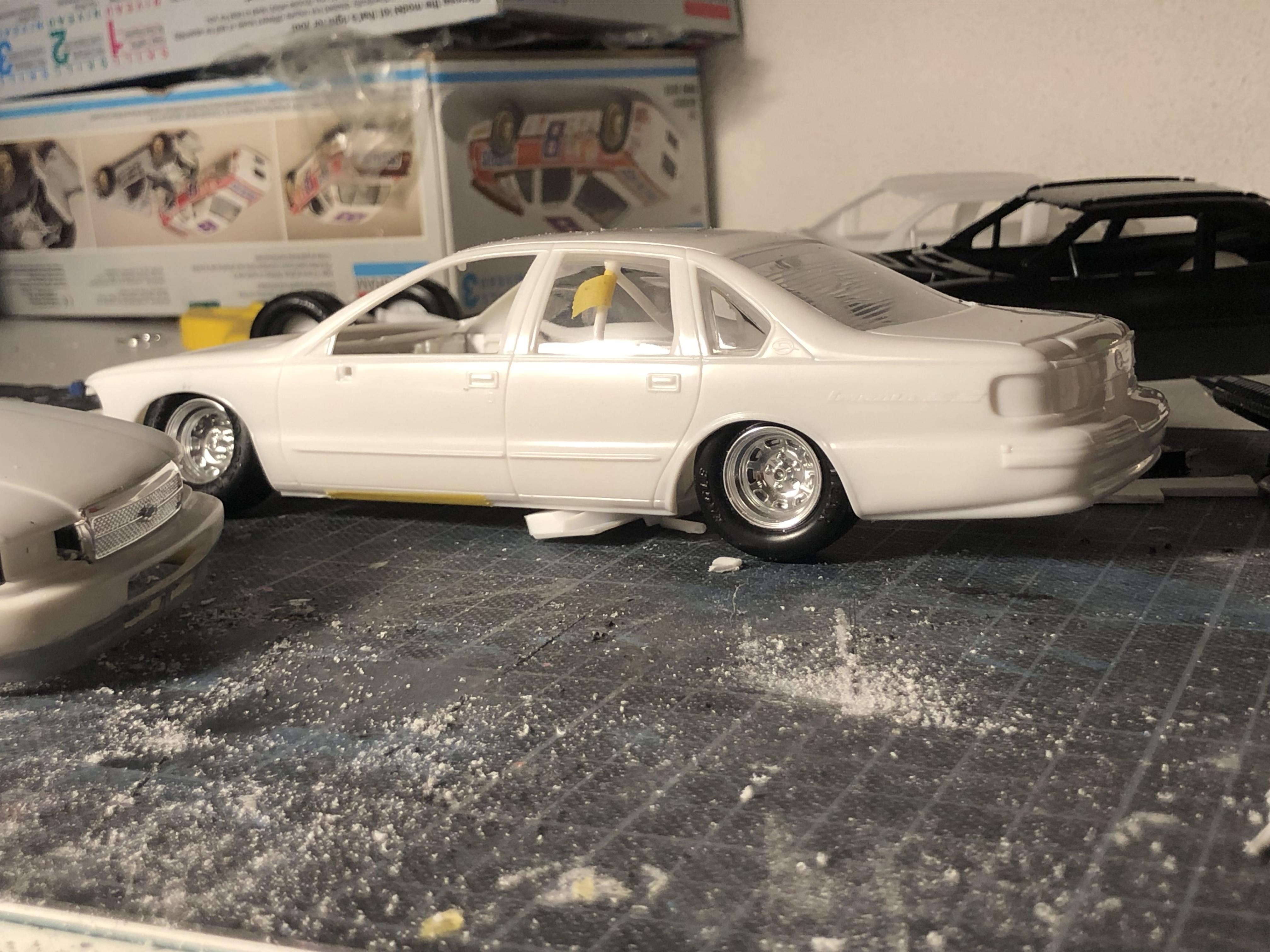

Good news! I have managed to make the interior to fit even though I have changed the chassis allot. But I will need to extend the black frame with 5mm so the front wheels are where I want them to be.
The stance in the photos are as low as it can go in the back. But even this low I will be able to have an exhaust since the floor is much higher up now.
some photos
and last but not least the TD(TA)
the problem with the front track can be seen, have to think about this later.

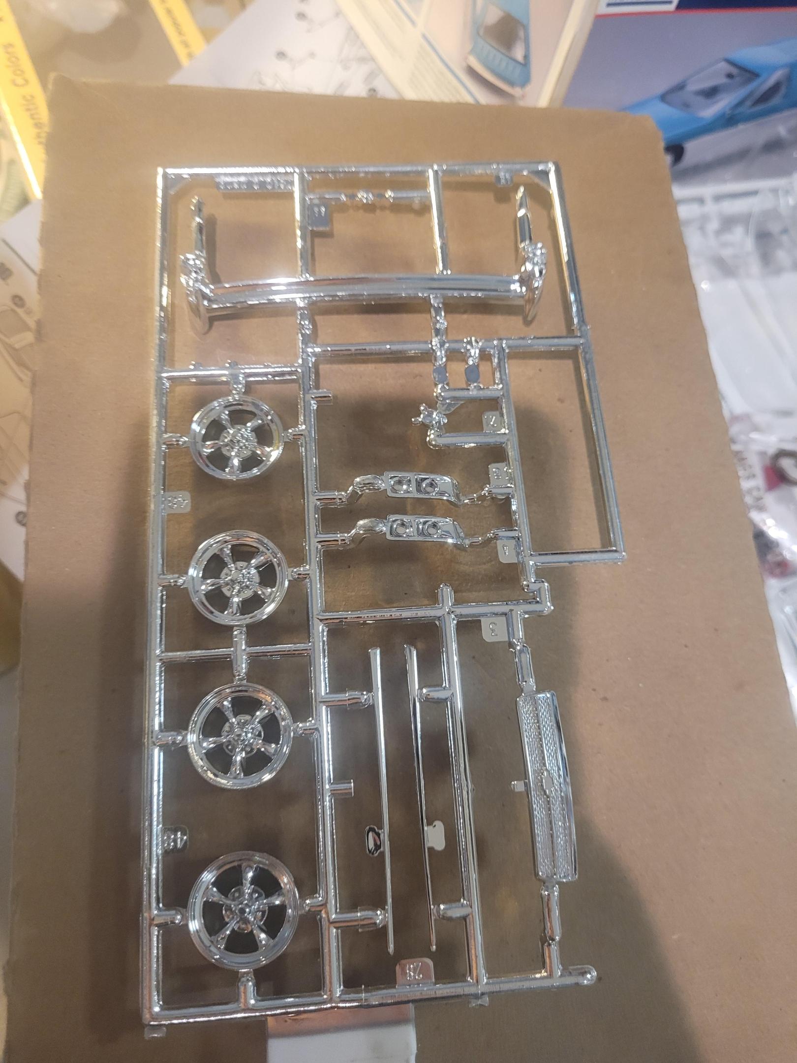

20220124_195551.thumb.jpg.6d28f92c118e7a82bd119bcf186dab0f.jpgDid the sprue look like this? This is from my alternomad kit.
  • Thanks 1
That’s correct with the chrome piece for the bumper and the lights! Strange thing is that I never had a alternomad.. must have made a trade at some point that I can’t remember.

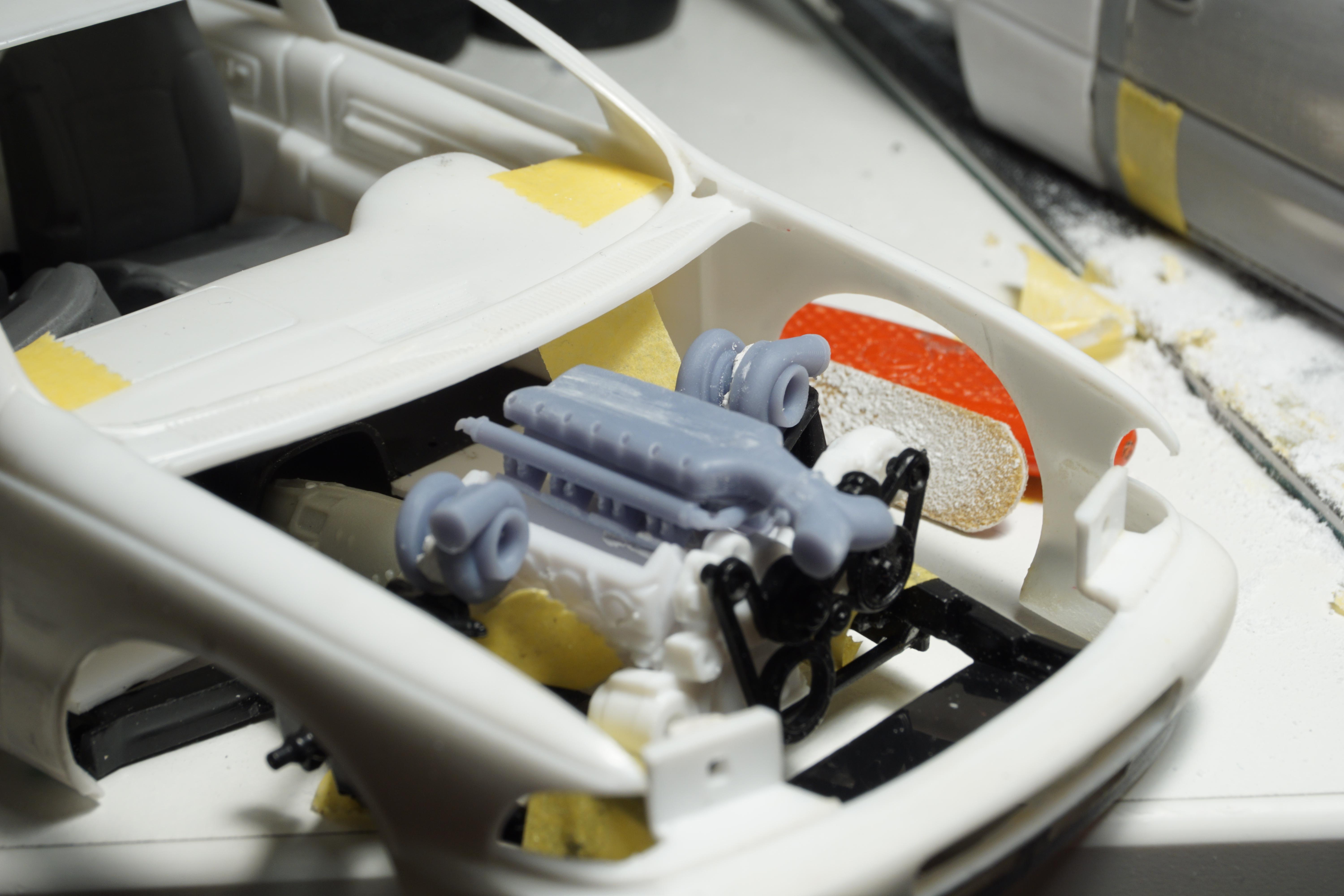

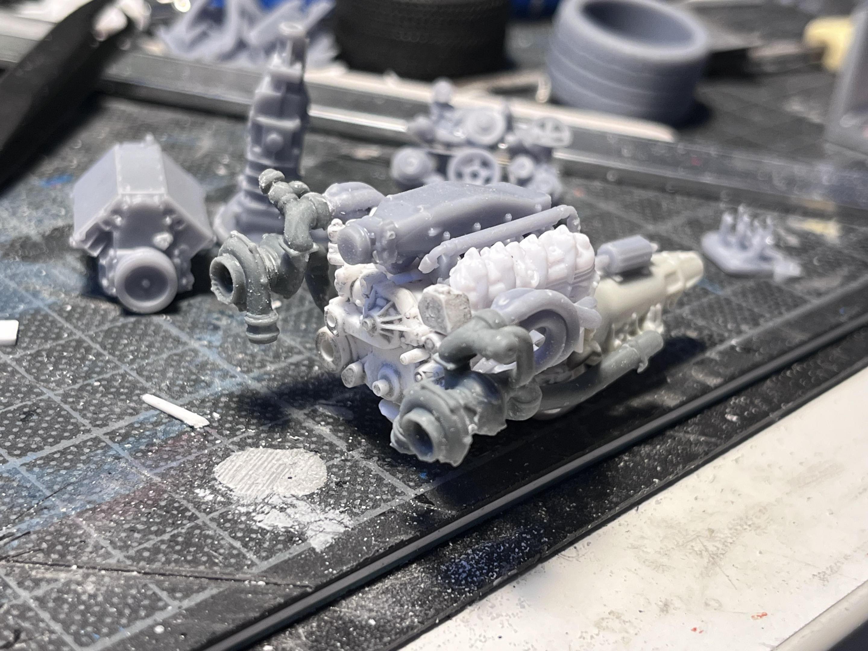

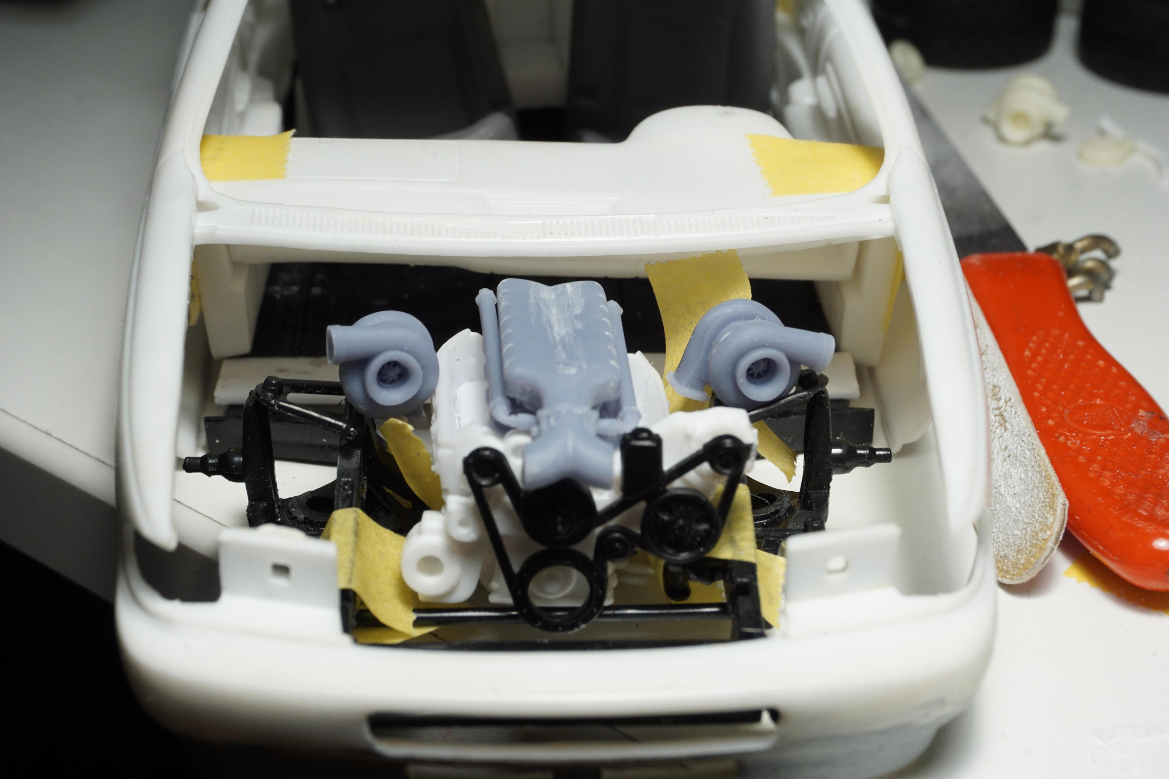

Got me som printed parts from a forum member to get me going on these. Since it’s a “street” car I will be needing the AC and alternator so I could not place the turbos where the kit made them to go so I will be needing to make different headers from solder. Intake got the charge cooler removed to have a chance to stuff it underneath the stock hood, seems good so far!
Thanks @Ghost_33for helping out!

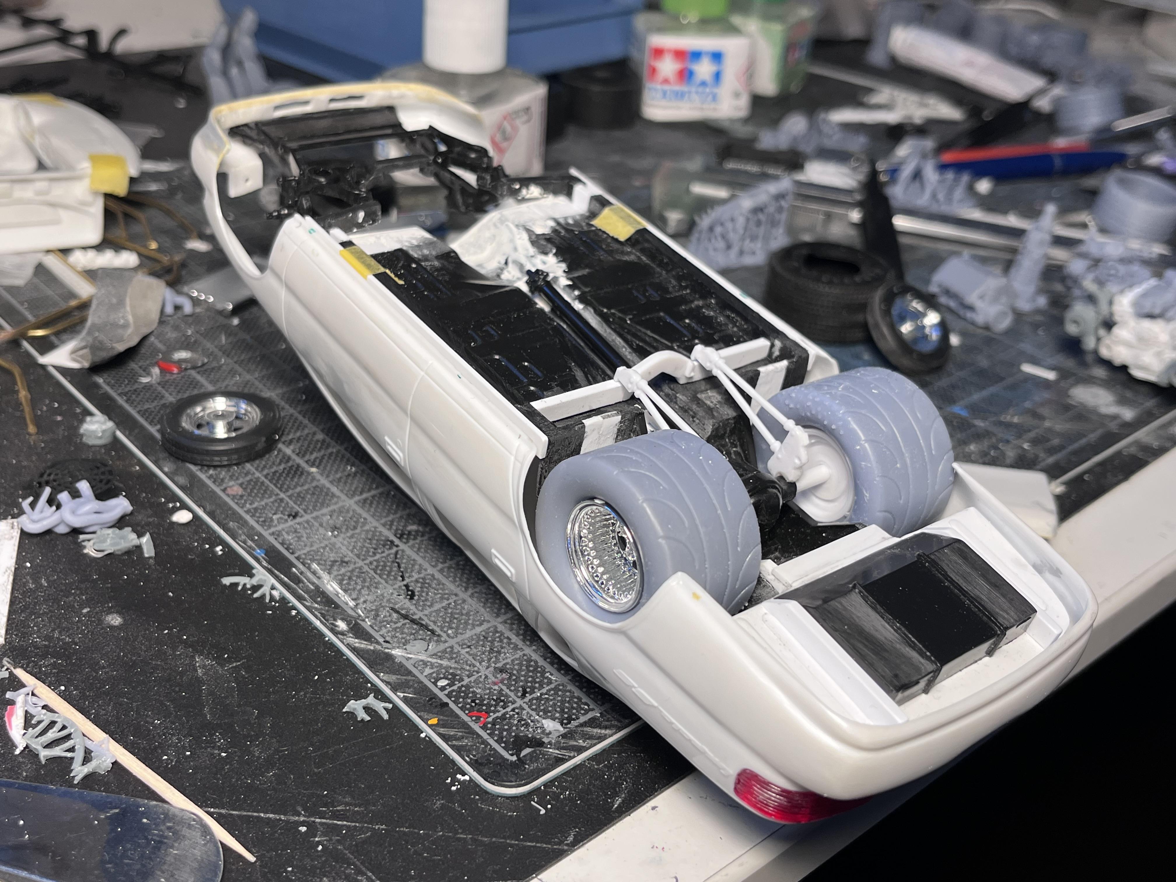

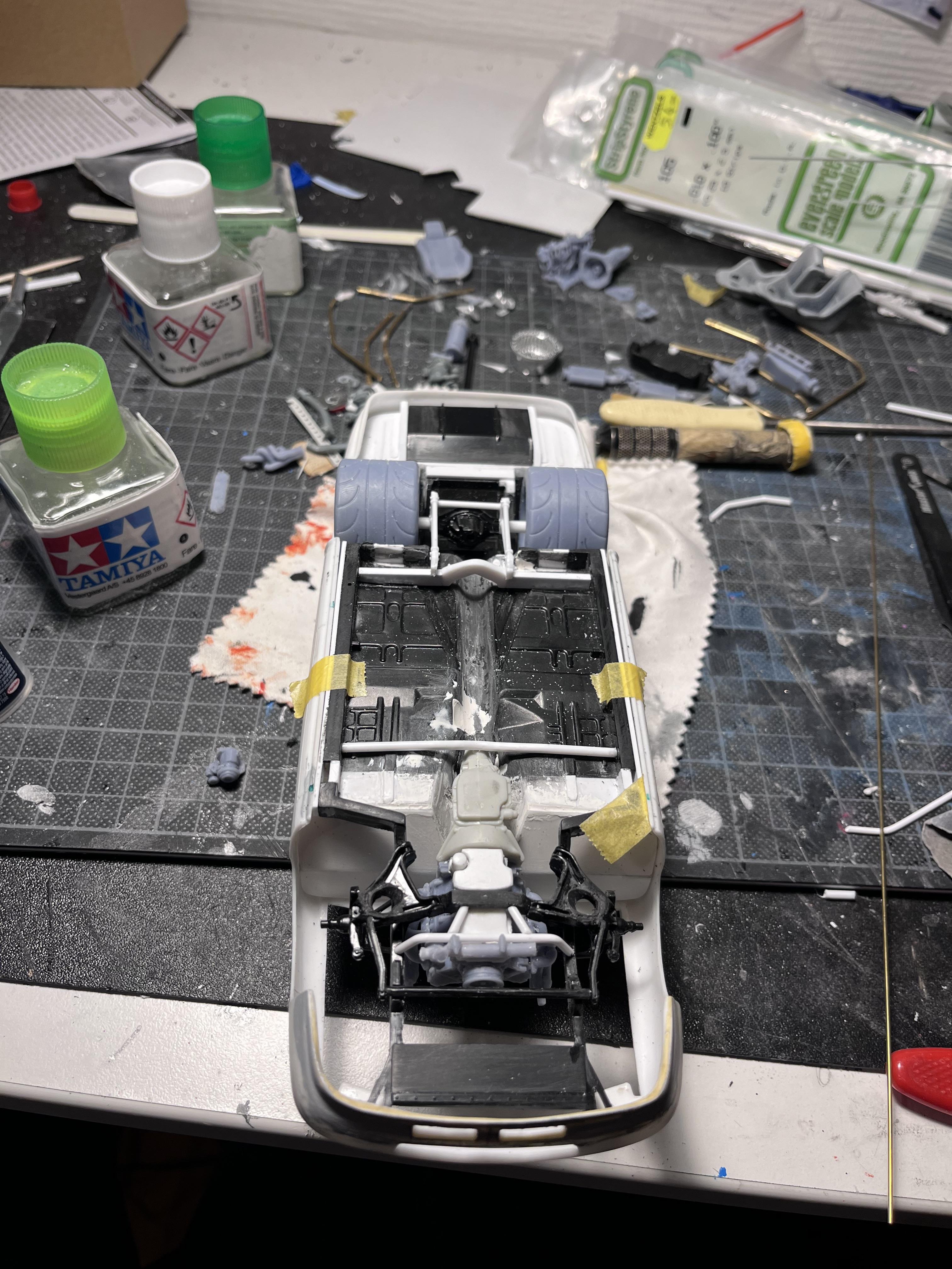

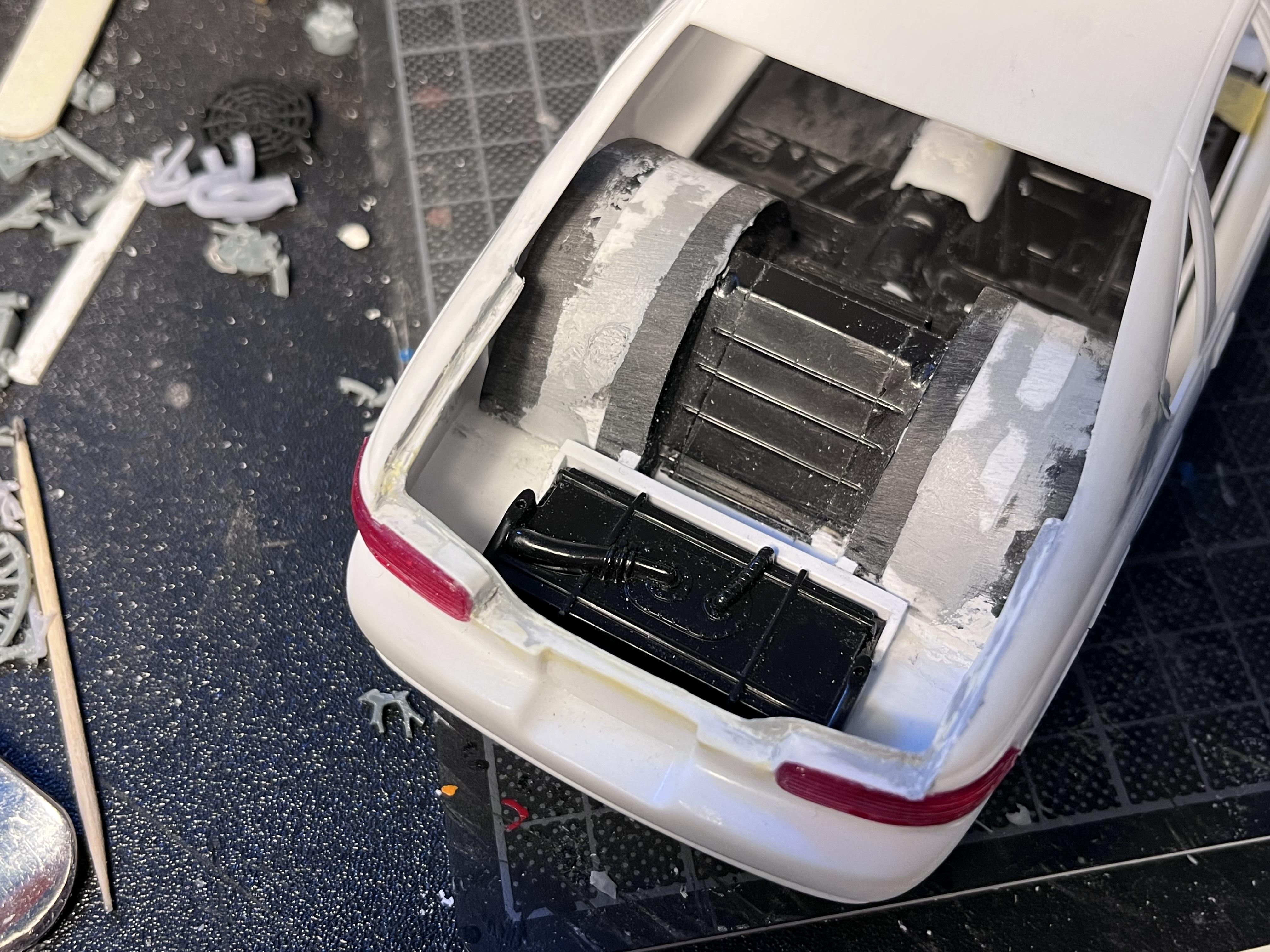

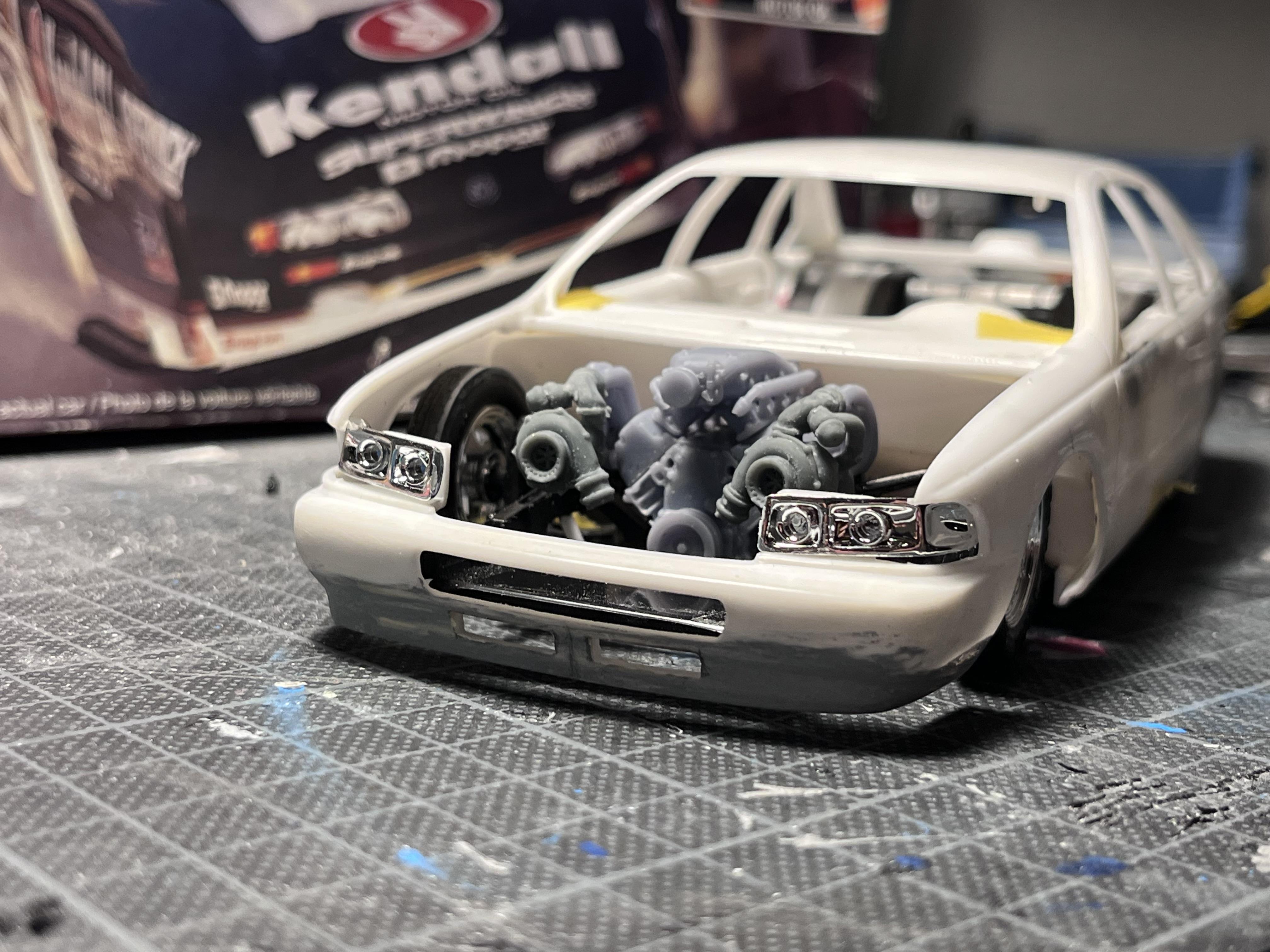

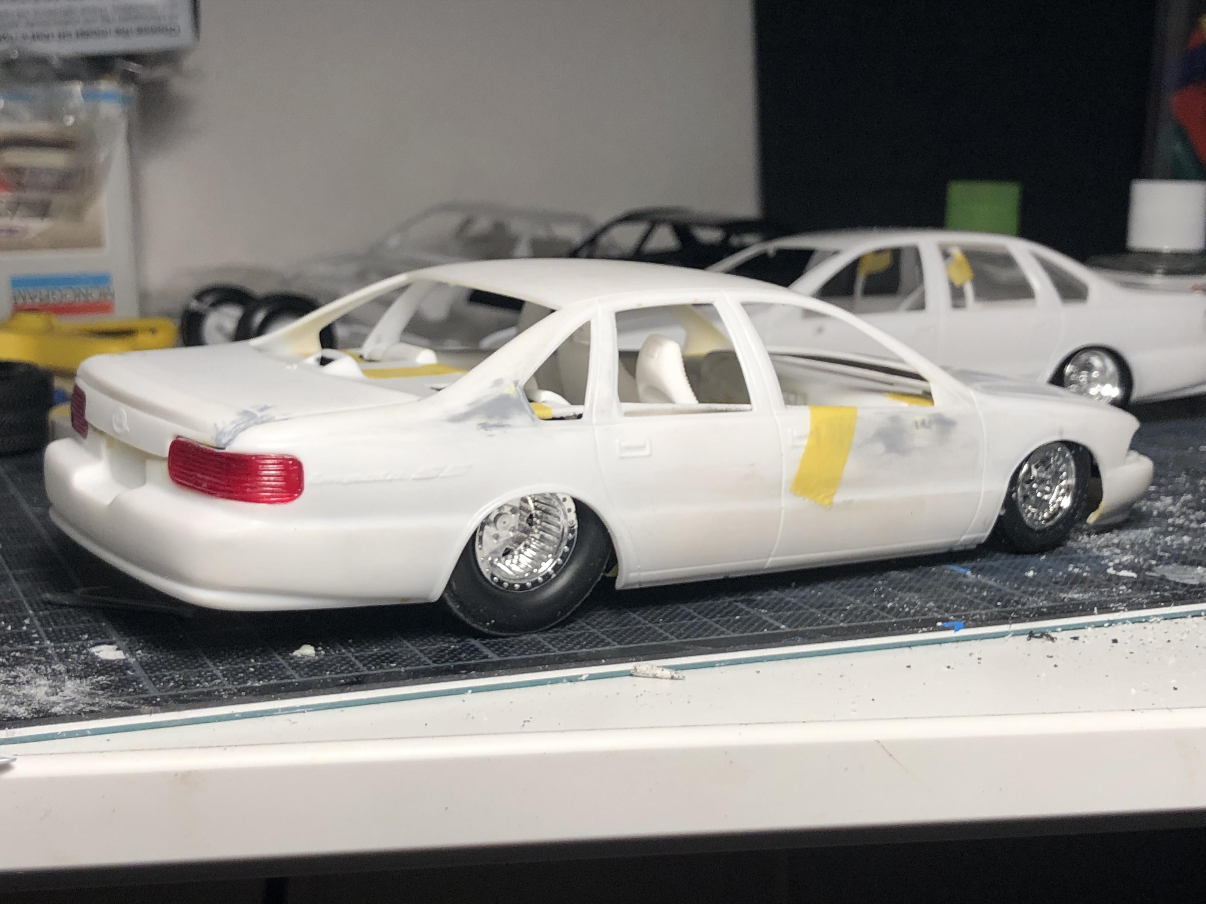

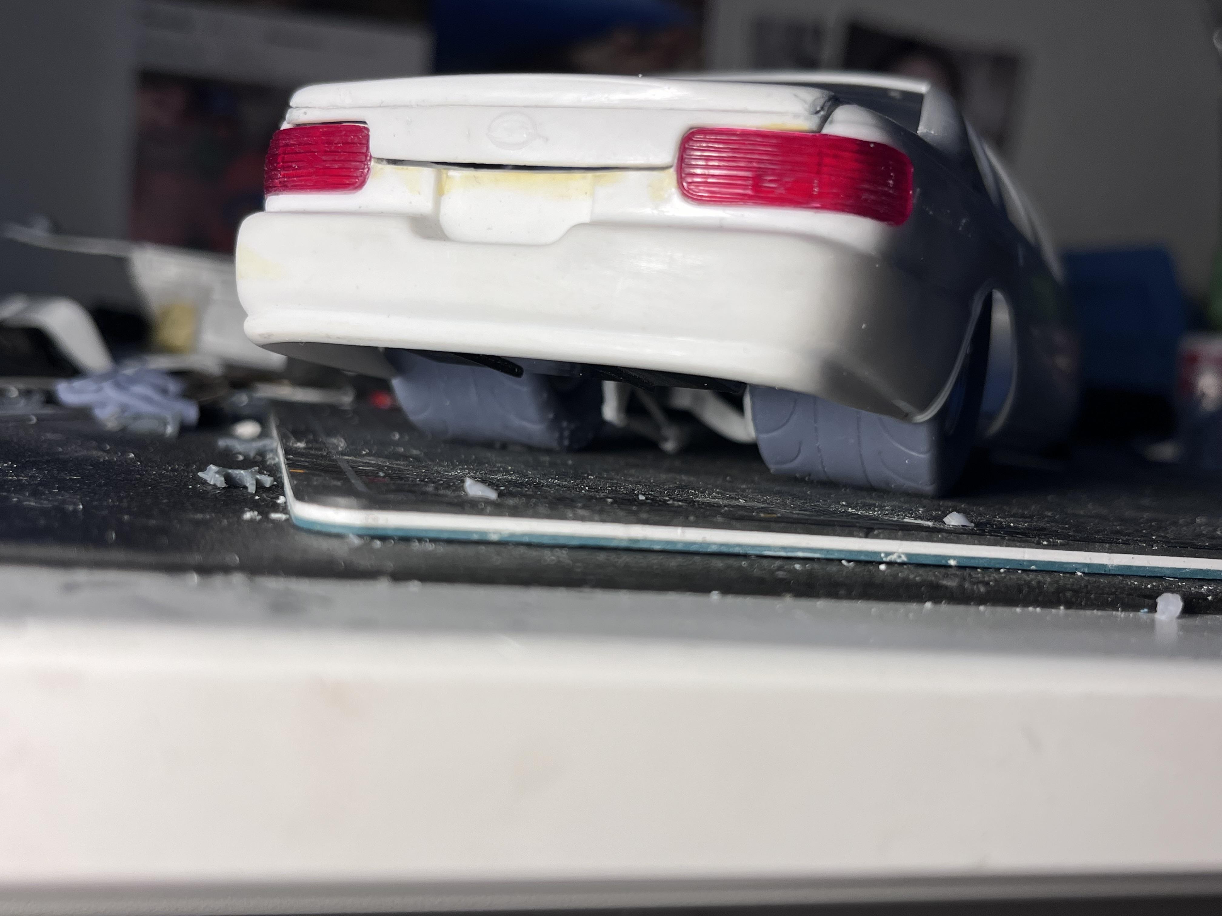

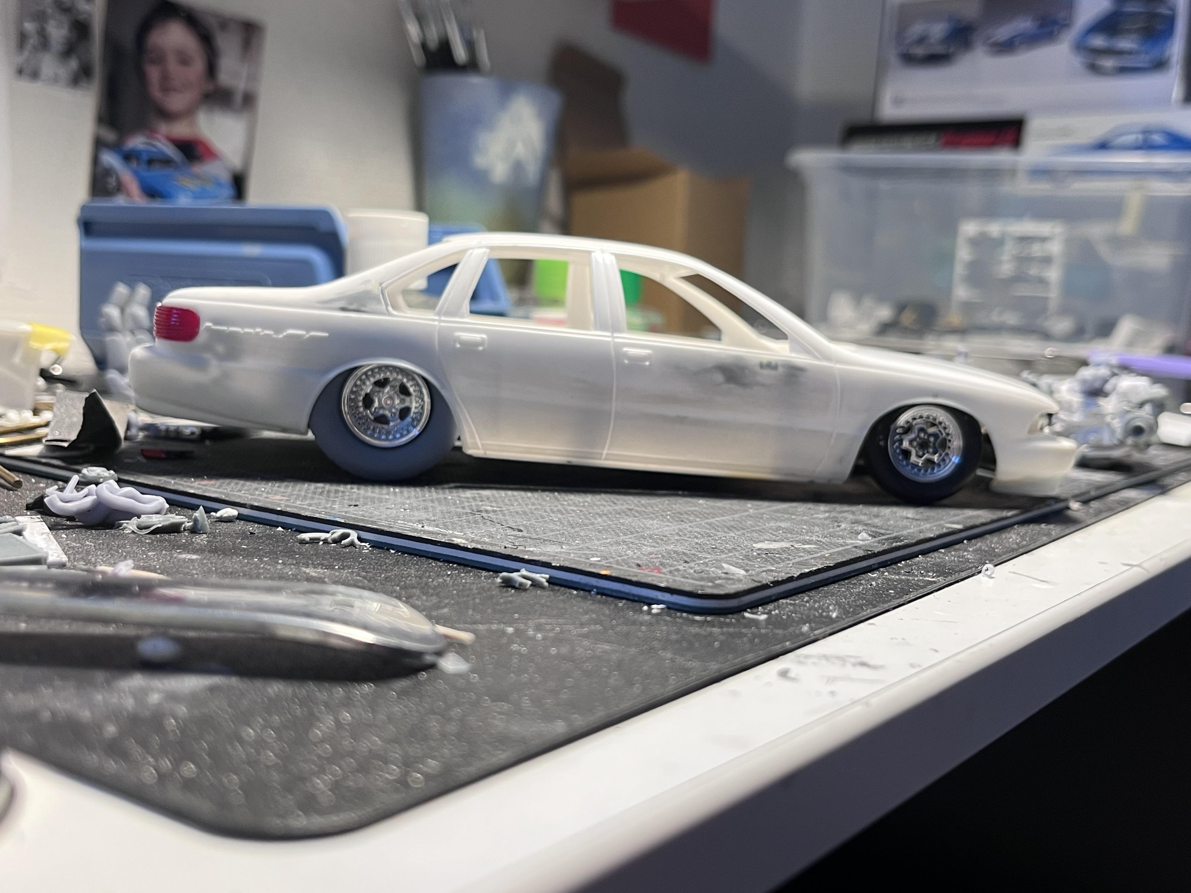

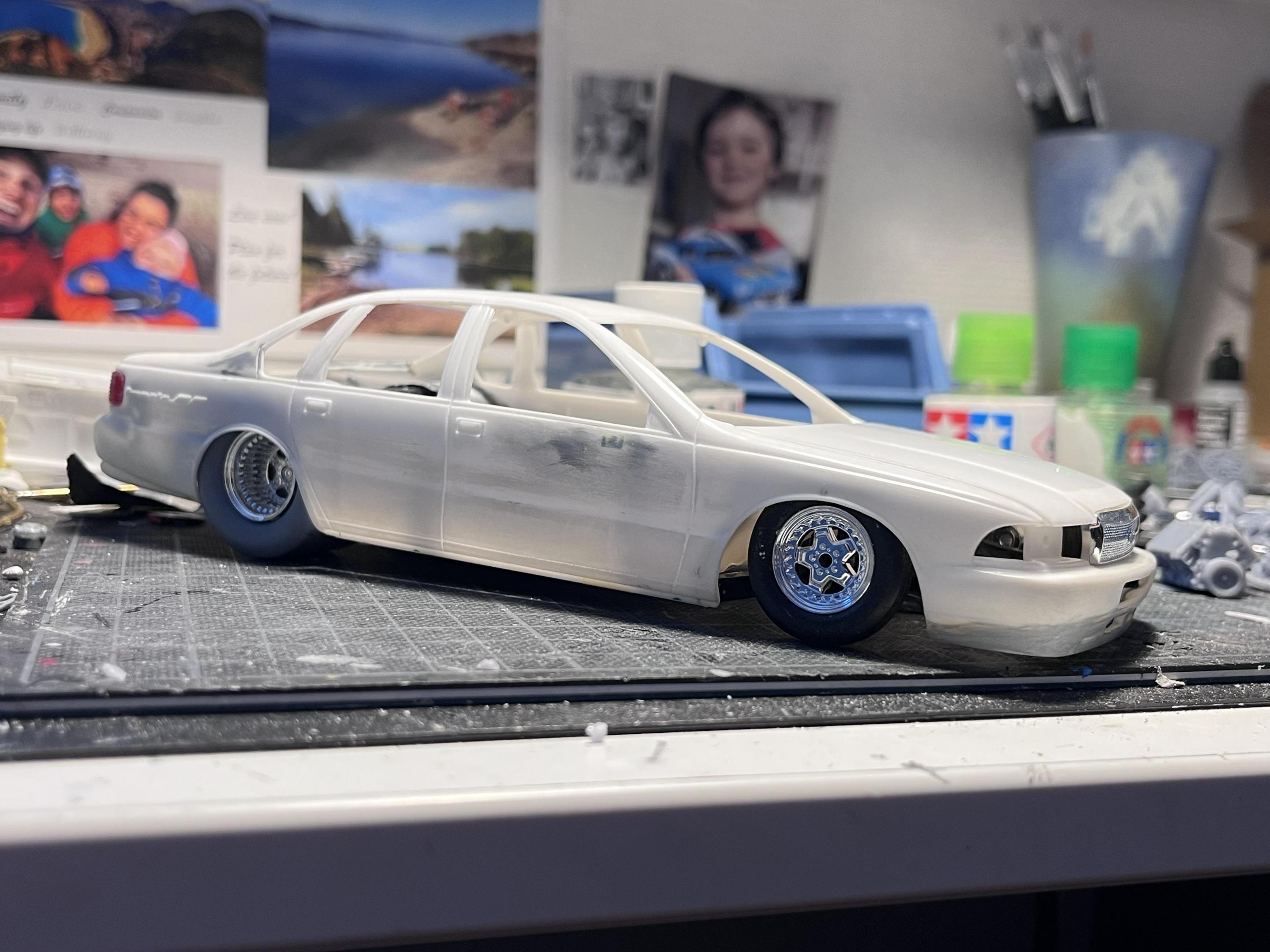

So i got an other build done and started working on this beast.. then I got access to a printer and made some parts for it as well as bought some.
Made the rear part of the chassi more or less done, both underneath and inside. Need to finish the shocks and brakes as well as wheelie bars. Also made space for the battery, fuel cell, Aeromotive fuel pump, and an extra bottle for go if somebody extreme come up to the lights.
Made a set of tires as well, wider and lower than the revell pro street tires, I think they suit the look of the build nicely.
I have also made some changes to the floor and transmission tunnel, as well as a new fire wall and some new supports.

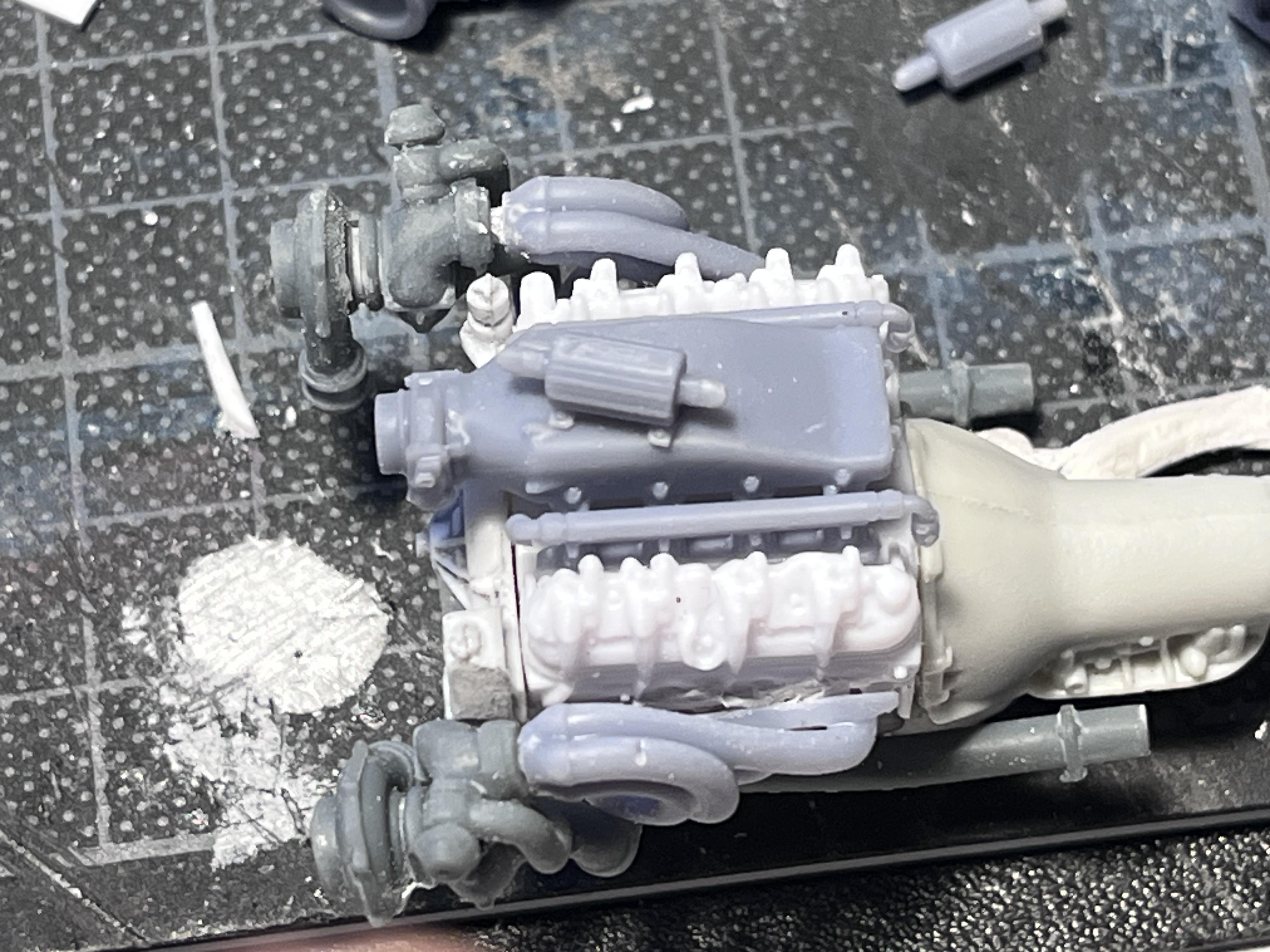

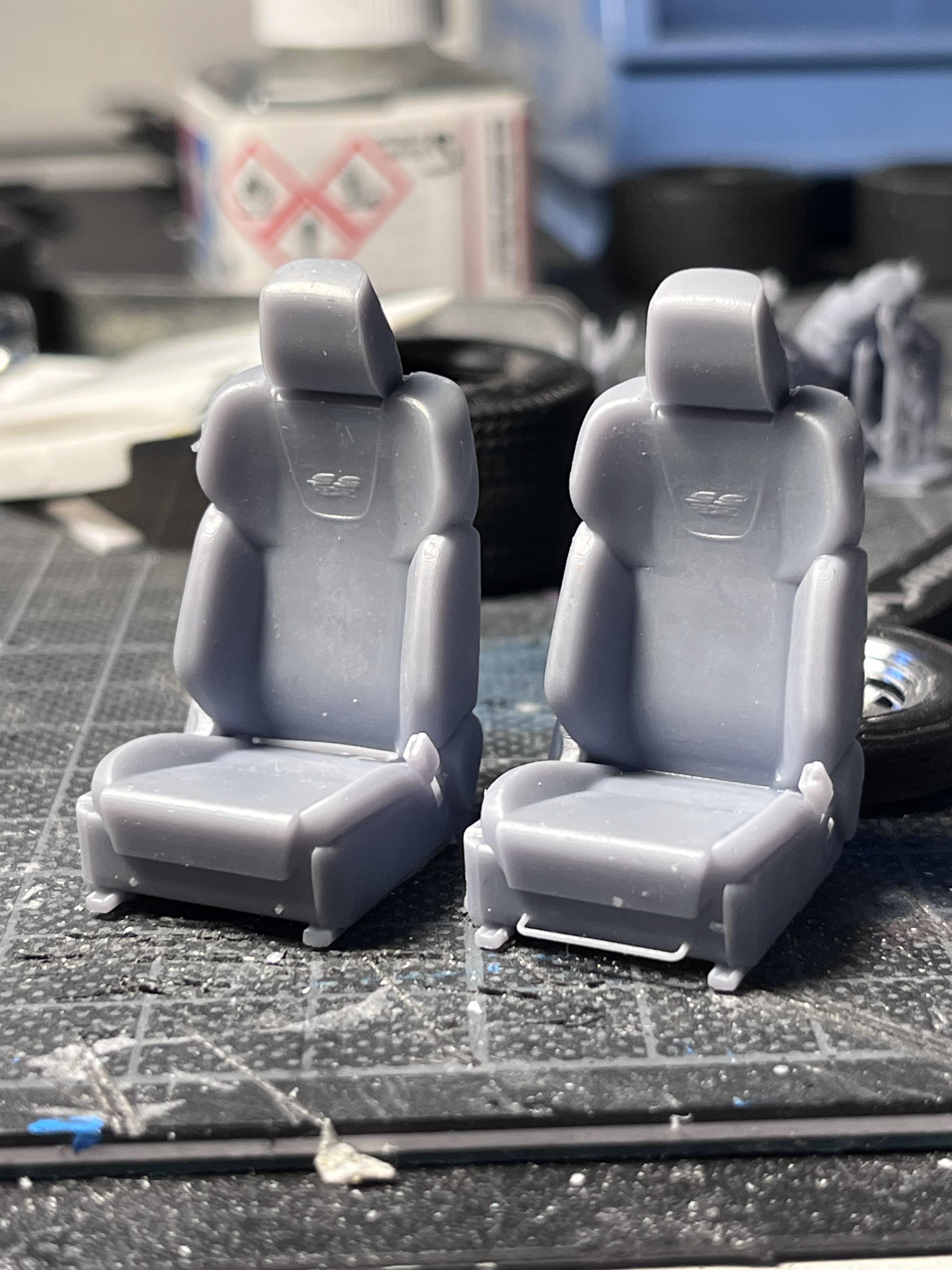

Also printed new seats, turbos, headers, engine and details, as well as new intake scaled down from 1:1.
Re modeled the front A-arms as well.
Made other things as well I guess.
A LQ”LS” with new intake.. built the other engine afterwards.
notice the SS on the seat back. I have also cut the seat apart so I could angle it back so it looks right. I am thinking if I should cut the upper part of the headrest to make it look more like the original one. Your thoughts on that?
  • Like 2
