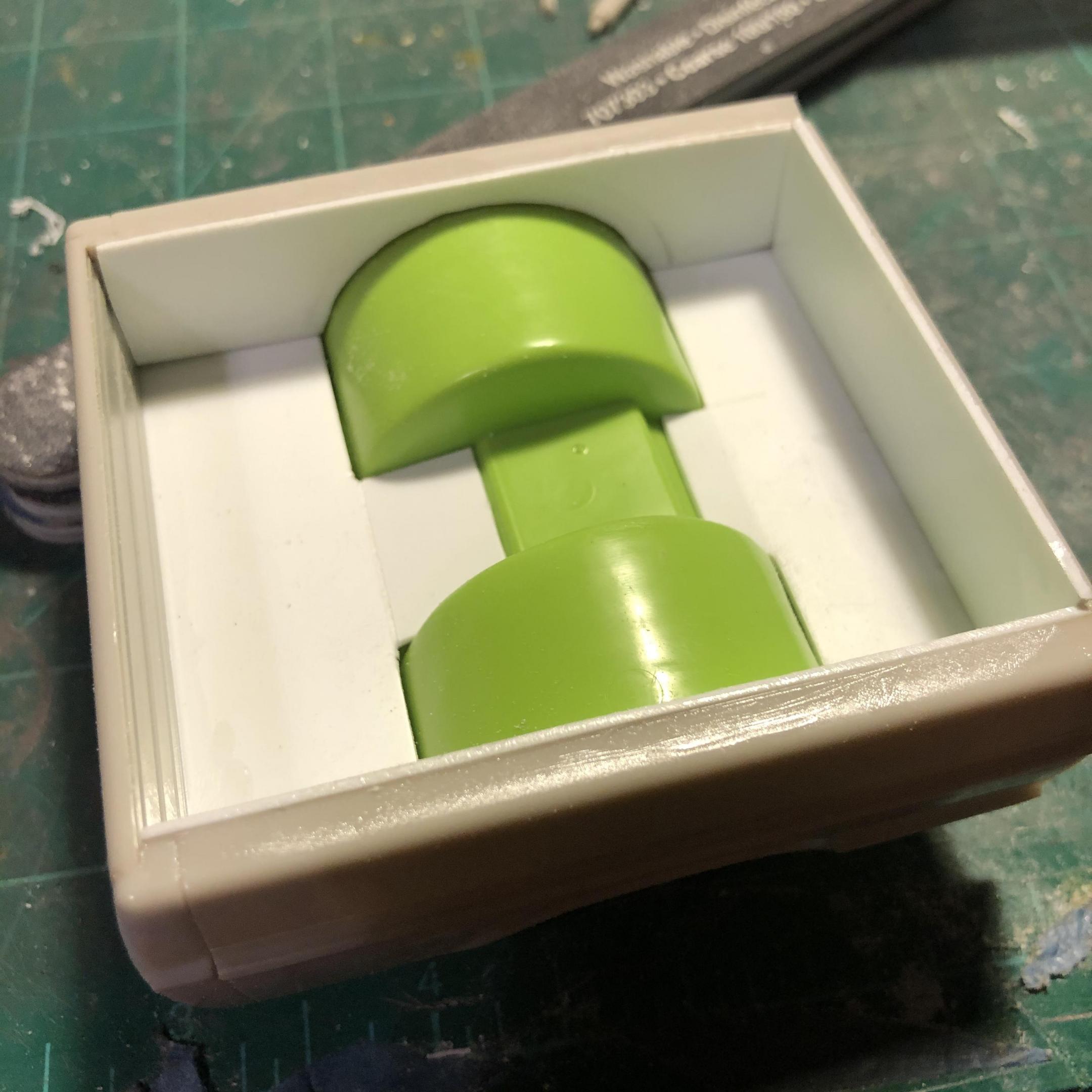

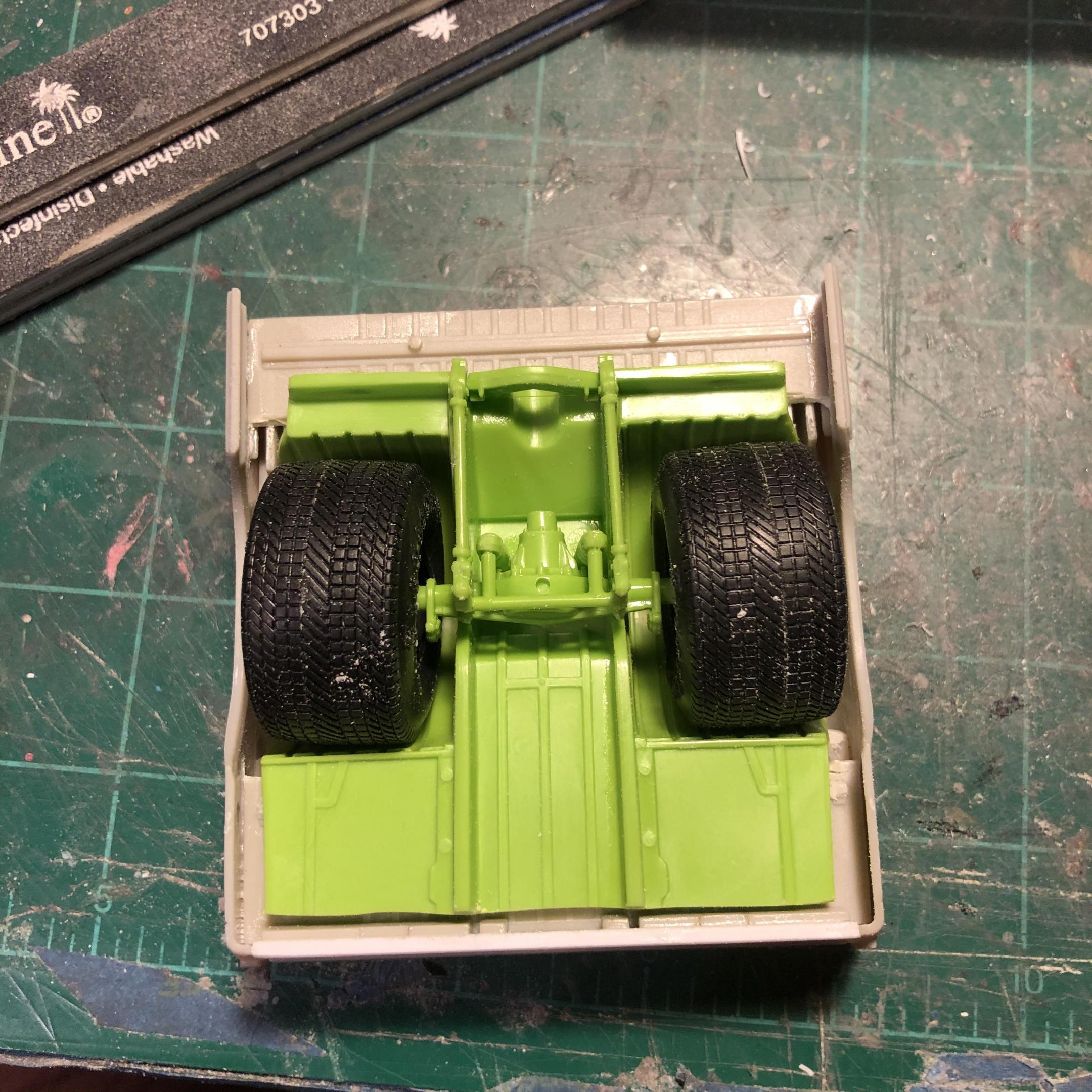

How would it look with the big meats sticking out beyond the fenders. I think I've got the axles figured out and I cut some spacers to bring the tires further out. I can also raise the rear end slightly for the big tires to clear the top of the fenders. I was first thinking of going without the fenders, but really don't like that look.

Well....I gotta be honest here James.  I think those tires need to be moved inward and not stick out beyond the fenders.  It would require removing the flat inner panel on the wheel well and then you'll have to cut into the bed.  Pill bottles make nice tubs for those big ol meats. Like you, that is all new to me but ill be doing one soon er or later.  Having said all that, its your model so you need to build it the way it looks good to you.

I would agree with Zippi on the rear tire placement. Another thing you might want to look at is the shape of the rear fender in relationship to the diameter of the rear tire. Think of the tire as an eye ball and the fenders as an arched eye brow. Not sure if that's the look you're wanting.

I think it would need to be tubbed James, so the tires are inside the fenders…if you go with fenders. The spare tire well could be cut out and capped with a chunk of styrene and a bit of milliput. It looks like there are so many possibilities, I just may have to get one of these kits.?
